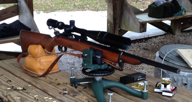

I just traded my 52B for a MPR. It's fun trying out these nice 22's. Each one has things about it I like and don't like. Next one I try will be a 40X.
What's that springy thingy hanging out of your trigger mechanism?
Re: Any Winchester 52 people out there?
<div class="ubbcode-block"><div class="ubbcode-header">Originally Posted By: DFOOSKING</div><div class="ubbcode-body">Looking for info on this...
Obviously the butt pad is missing but the LOP is 13.5" ...so I'm hoping that is all.
The safety has been deleted and the trigger has zero over travel and it around 2lbs...maybe a little less.
Any info is appreciated.
</div></div>
DFOOSKING,
Congrats. Nice snatch for what you traded it for
Model 52B with Heavy Target Barrel in a Marksman Series prone stock.
The serial number puts it between August 22 1939 and January 5 1940. I can get you a more exact date if you want to pm me.
LOP is correct.
Unknown maker aftermarket adjustable dovetail buttplate. There were a few of that era and the name may be stamped on the underside if you remeove it. It probably also had an offhand hook you could swap out for the flat plate. Also there was probably a padded one. Not aftermarket Al Freeland, so his accessories probably will not fit.
You can probably find a factory butplate on flea bay, gb, or rimfire central. Repros I think can be had thru Numrich or Champions Choice?
Forward short rail with tapped holes for length adjustments with seperate plastic handstop with sling mount are factory correct accessories.
Cutout and horizontal compression mark on stock are typical of rifles that originially came with Lyman Models 48JH, 48F and 57F Micrometer rear sights. If you have a forward mounting block, the front sight would have been a Lymann Model 77. If you have a raised pad with a dovetail, it would have been a Lyman Modle 17A.
Large head screw attaching the floorplate is not factory. They were originally countersunk.
The missing thumb actuated sliding catch saftey was first introduced on the Model 52B and was a great improvement over earlier versions. Earlier safety versions locked the firing pin in the cocked position, while the 52B safety disengaged the sear from the trigger.
Trigger is aftermarket, the wire is a pull down to release the bolt gizmo. There were a few of this period that made them like this. Some were made from scratch. Some were reworked factory units. I will look around to see if I can get more info on the trigger. Better picks of it would help if it matters that much to you.
Does it still have the forward barrel band? That method of barrel to stock attachment was the "new and improved" method for the 52B Target model in the Marksman Series Stock.
Hope this helps and good plinking.
Have a great day,
DS

<div class="ubbcode-block"><div class="ubbcode-header">Originally Posted By: DFOOSKING</div><div class="ubbcode-body">Boom!
Hopefully test for groups tomorrow!</div></div>
Looking good DFOOSKING! How does she shoot?
The trigger looks to be a canjar that did not have the release wire broken off yet. The release wire broken off is not uncommon. From a timeline standpoint, the canjars were not available earlier on when the 52B was introduced, it became available much later. When the B was new, there were several custom triggers that were popular on the Model B: Thomas, Sweeney, Garrison, etc..

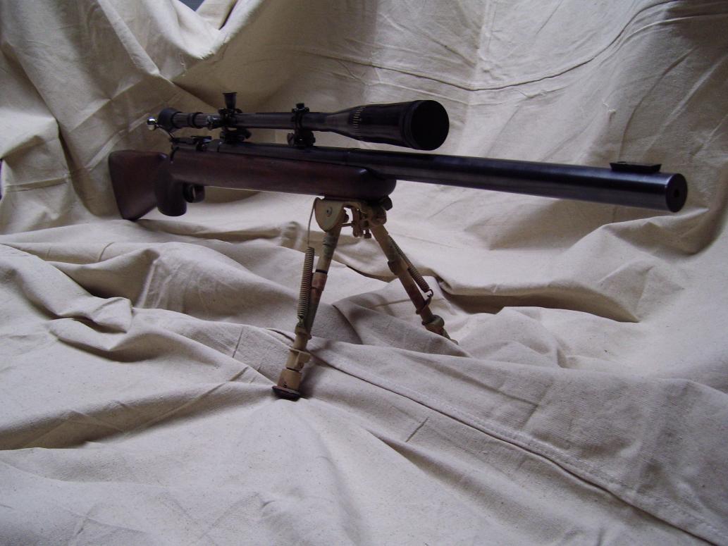

I'm just popping in to say I love Winchester Model 52s. More specifically the early A models and Pre-A models. With few exceptions, the Model 52 is hands down my favorite .22 firearm, including other rifles and handguns. It's the only gun that I plan to buy multiple of. This has to do with the fact that my favorite firearms overall are heavy barreled target bolt actions and, I have to say, that the Winchester 52 reigns supreme. It's so d*** accurate and it feels just like a real rifle. When the make a 40X repeater, I may be interested. Aww, who am I kidding, no I wouldn't be. I'm sticking with the 52.
Finished putting this together. Started out with nothing but a stripped 52D receiver. Had to get the stuck bolt stop/plunger out of the receiver as it was jammed all the way in. Picked the stock up. Found a bolt and bolt guide. We made the barrel of course. It duplicates the heavy 52D contour but in S.S. it has 8 grooves and a left hand twist and gain twist rifling. My spec'd match reamer. Picked up and installed a Kenyon trigger. Had Steve Kostanich install the barrel for me. He had the different cutters to make the extractor cuts and has built .22rf benchrest rifles on the Win. 52 so no sense in me reinventing the wheel. Had Andy and I at work made the recoil lug that I came up with/designed for the receiver. I opened up the stock for the lug and stripped the old bedding compound out of the stock and rebidded the stock with Devcon Steel. Picked up a set of original Unertl blocks and a dual step iron sight mount for the front sight and did all the installation. Got a NOS Redfield rear sight mount from my old buddy Roy. The mount was still in the Redfield package and he only charged me $15 for it to boot!
The picture with the unertl scope on it was when I tested it with my test stock to make sure everything was working before I did all the work to the nice stock. Think it will be a great shooter! Thru on a set of vintage Redfield Olympics for the pics.
Later, Frank

I just realized I have not posted my pride and joy in this thread yet. It is a 52B Heavy Target circa 1950 with a Canjar trigger and beautiful wood. I acquired this gun in July 2012 by complete serendipity through my hometown FFL, whom had very recently acquired it through an Estate sale. Neither of us were aware of the value of the Canjar trigger at the time of the transaction, so I got that as a freebie. :) The rifle was in rough shape having sat in a closet for over 25 years collecting dust. The finish was pretty worn and my first task aside from a heavy dusting was to remove the old oil finish. I left the original stain and refinished with pure Tung oil. It's an absolute shooter with any lot of SK I have fed it, and the few rounds of Center-X through it were quite impressive scoring hits on 6in IDPA steel at 300yds. The last picture is of my first "kill" with the rifle. An very unfortunate dragofly decided to land on the 100 yd target board I was shooting groups on. The group I was shooting is the 3rd image, my 5th shot was the dragonfly. :)
I've also acquired a lovely CMP 52D circa 1962 that is as accurate as my 52B, but I'm still refinishing the stock on it so no photos of it...yet.
