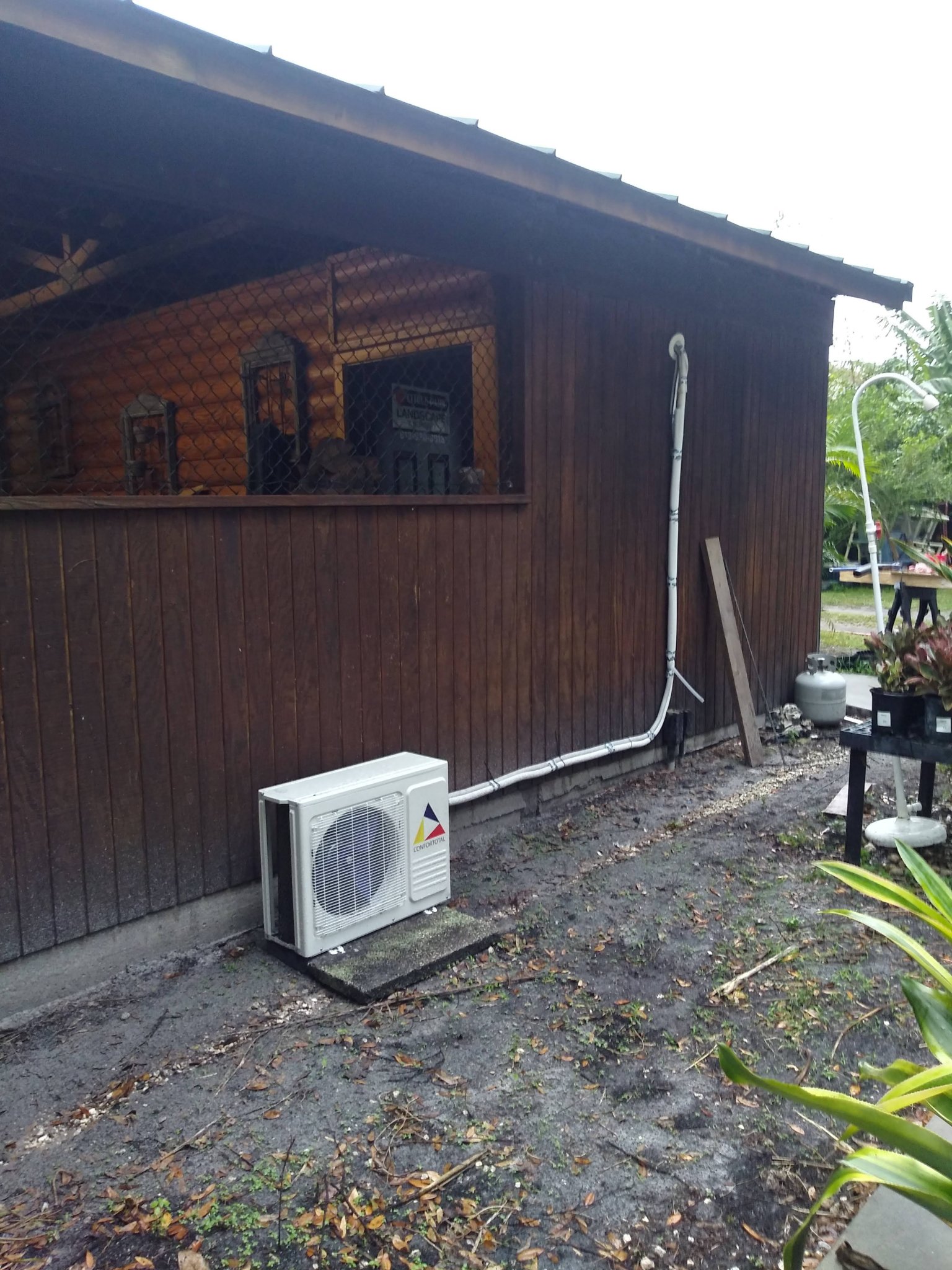

    1 ton 20 Seer “AUX", inverter driven, sold in Mexico with Toshiba guts, imported to the US, purchased for $500. Very easy to do your own install (youtube has a couple of excellent step by step videos). It took me about 6 hours total to install it, mainly because I wanted the pipes and drain hidden between the bricks and sheetrock and not inside a 3" tube on the outside of the house. Otherwise 2-4 hours. They come precharged, and are almost plug and play.
    I have an app that lets me control it from my smartphone, and could control multiple from the same app if I had more.
    It does everything my central units do, but much lower cost and higher efficiency, and they have a dehumidification mode.
    But the big kicker is IF I lose one unit, that's only 1 room, not 1/2 the house.
    The house I'm building in a couple of years is only going to have mini-splits: Each room gets their own.
    AC contractors we talked to don't seem to like them.
    Toshiba, Fujitsu and Mitsubishi are the top brands.
    There are also a large number of AC sales companies out of Florida (they allow sales to non-installers) that you can get a smoking deal on if you want to try a DIY.

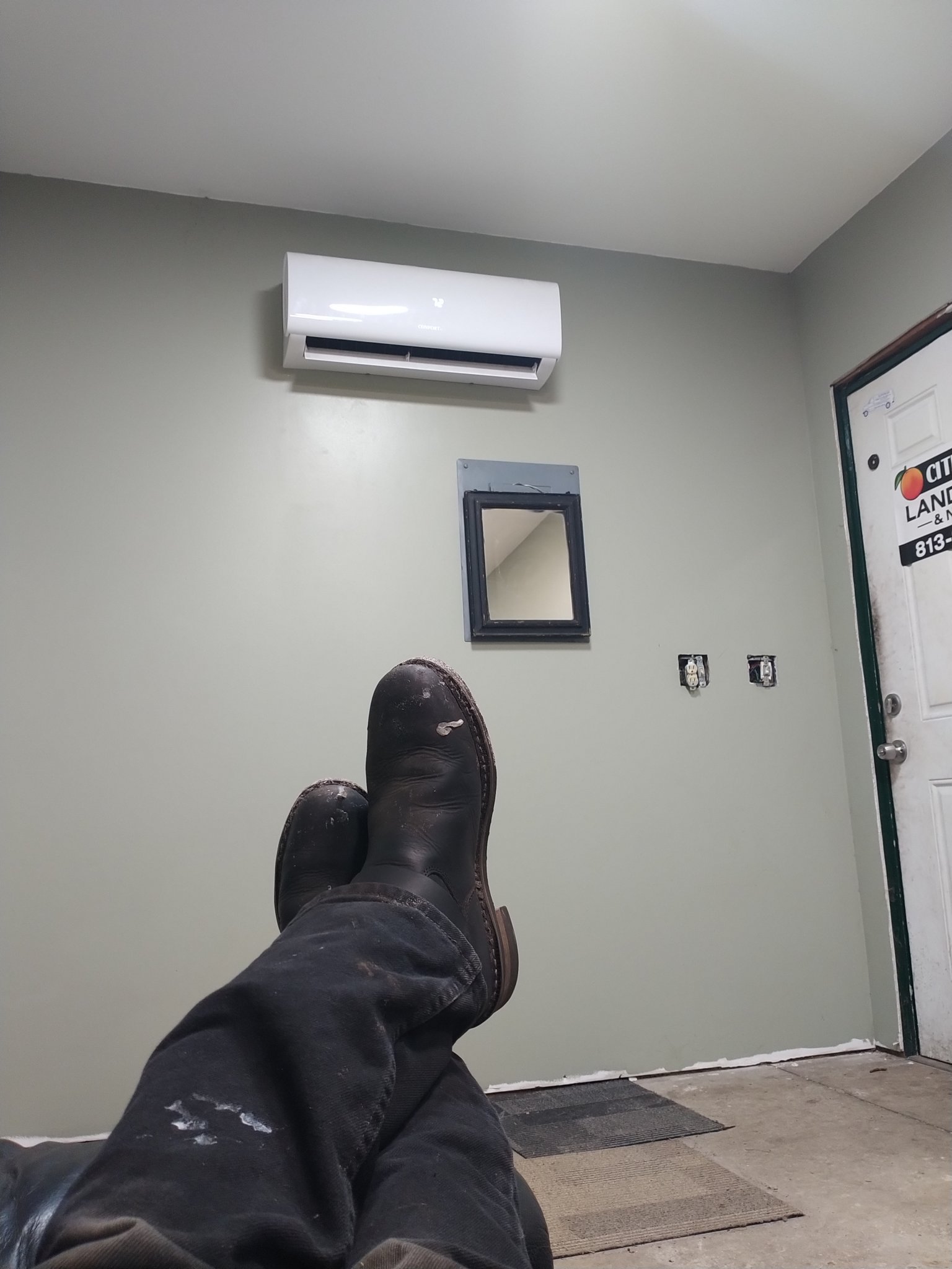

    Have one in my shop, it was a gently used model my HVAC contractor sold me. AC is fantastic, the heat can't keep up if it's very cold for a long time. (Well below zero for days). With your redundancies, you should be happy.
