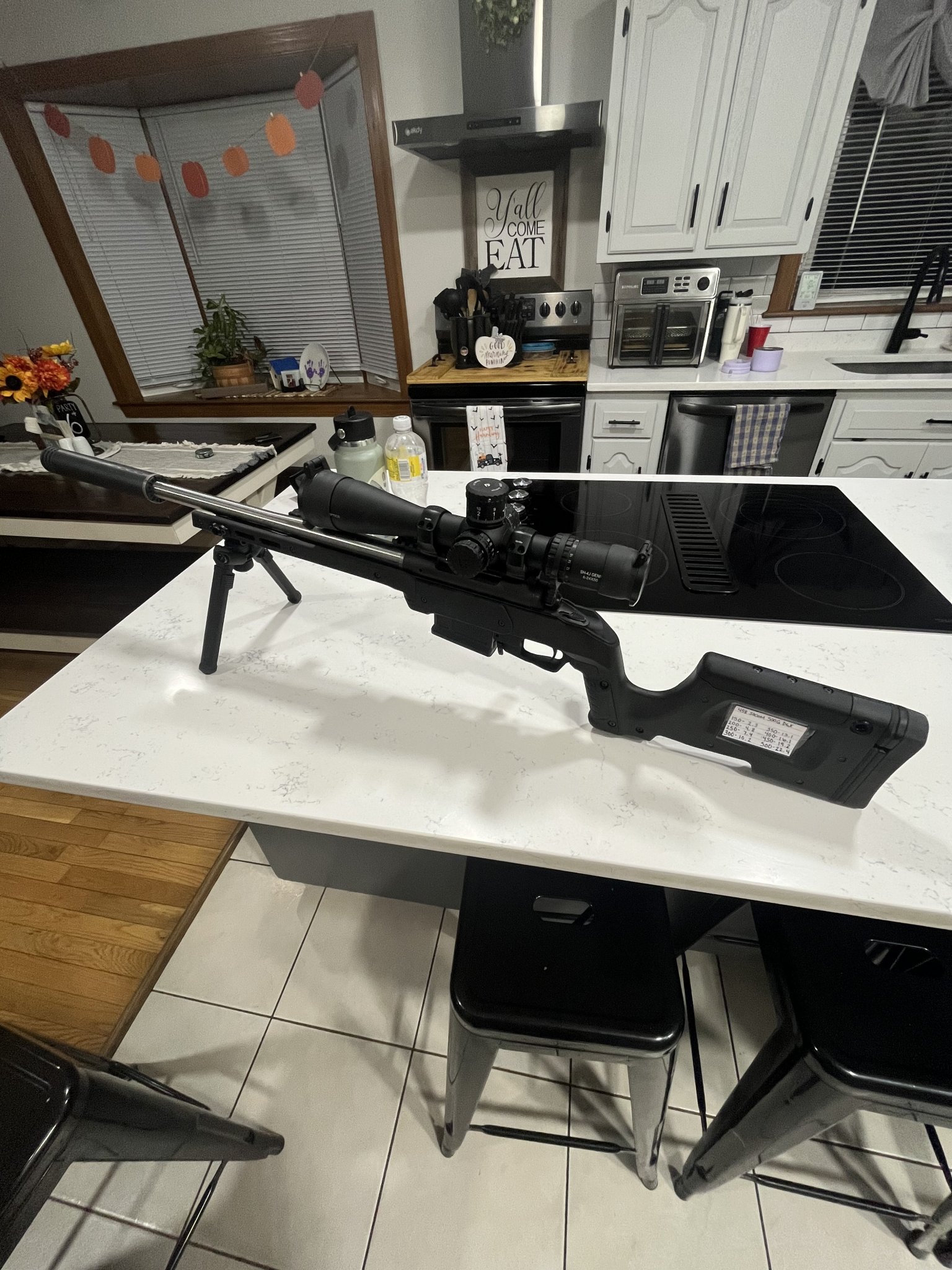

Gunsmithing Anyone built a bolt action 458 Socom?
How accurate are you finding that Tromix barrel?
Too early to say for certain. Still working on load development. Haven’t been able to shoot it much due to life but it’s grouping 1.5” at a hundred yards currently. I’ve shot nine rounds down the barrel so it’s still building copper. Really hopefully to be sub-MOA. Realistically I’ll be happy with that out of a subsonic load since the projectile is the size of my thumb.
This fella right here was honestly the whole reason I built the rifle. Check out his “1000 yard shot” video with it. I’ll be happy with 300-400 out of mine. Debating on a form 1 suppressor in place of my SilencerCo hybrid for maximum suppressor, but not sure if the noise level can really be brought down any further. Also wanna try the Lehigh’s but can’t bring myself to $3 / per click.
