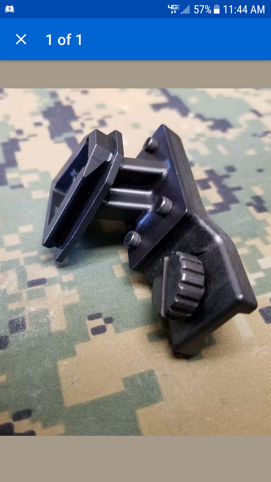

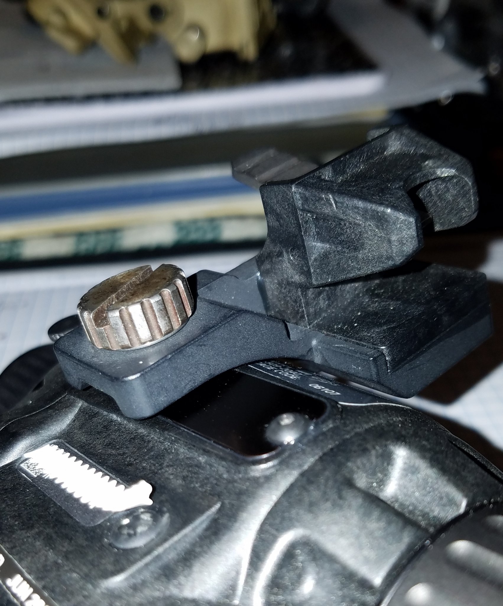

Mtm makes a bayonet helmet arm and a dovetail helmet arm, both are very hard to find. And pricey.
Pic of dovetail mount.

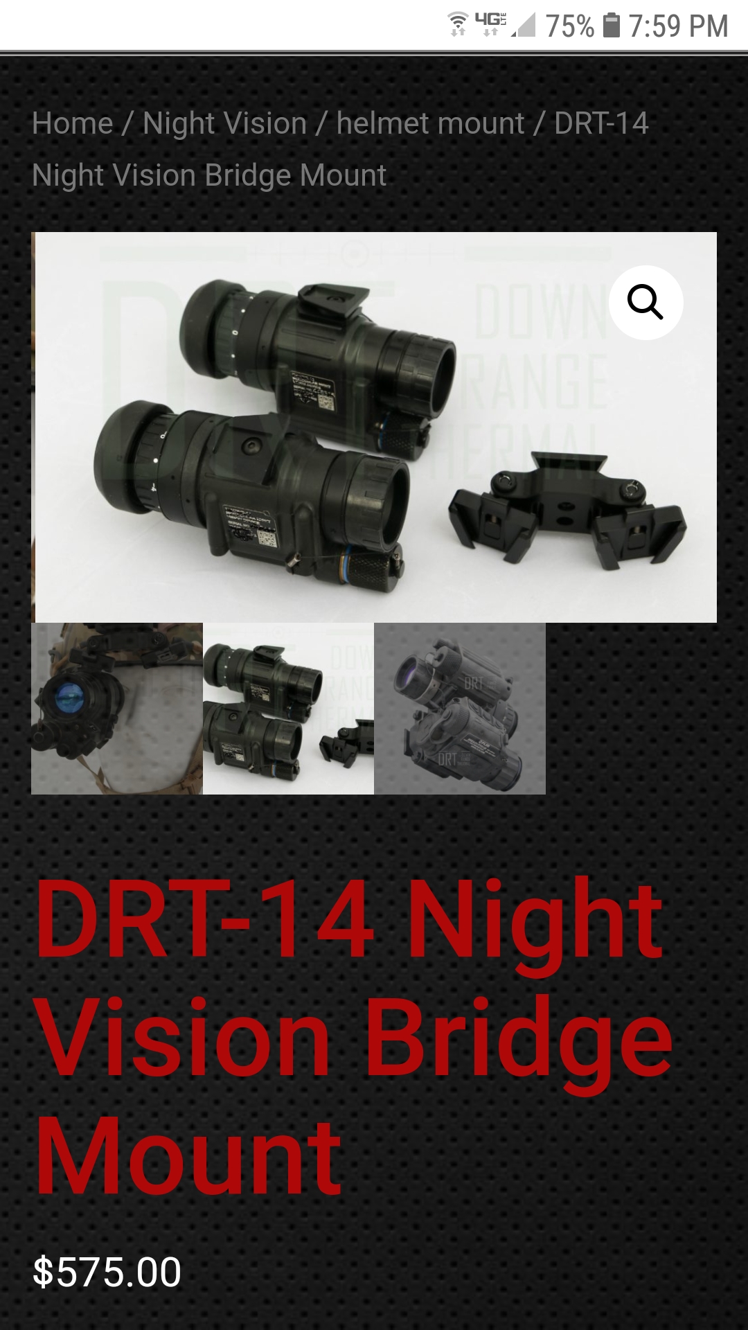

You can get a wilcox bridge or other bridge and a dovetail shoe and put it over either eye.
DRT bridge pic:

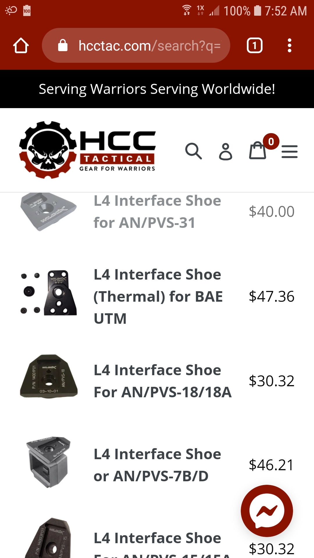

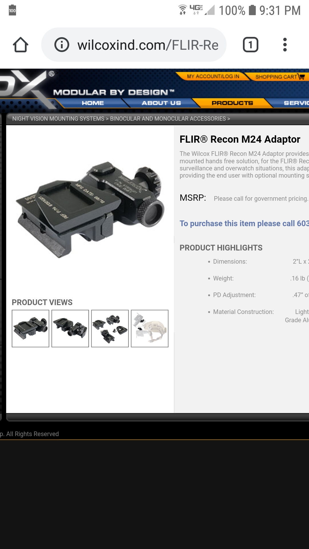

Dovetail shoe options.
The pvs18 shoe will work on the mtm.
And you can use the flir m24 adaptor and the pvs15 or 18 dovetail shoe on the mtm. Not perfect, but works.

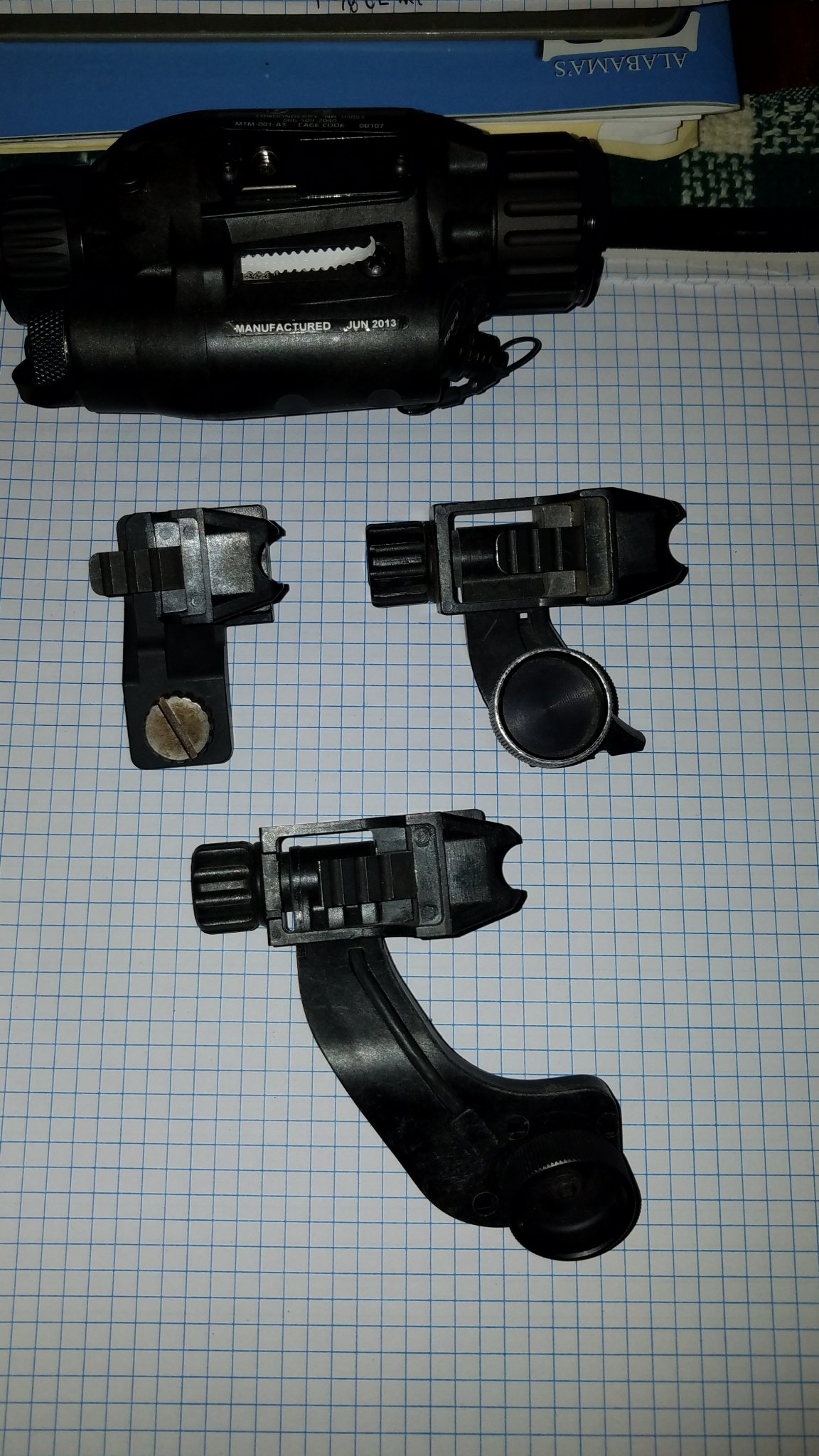

So, repeat of the mtm dovetail mount.

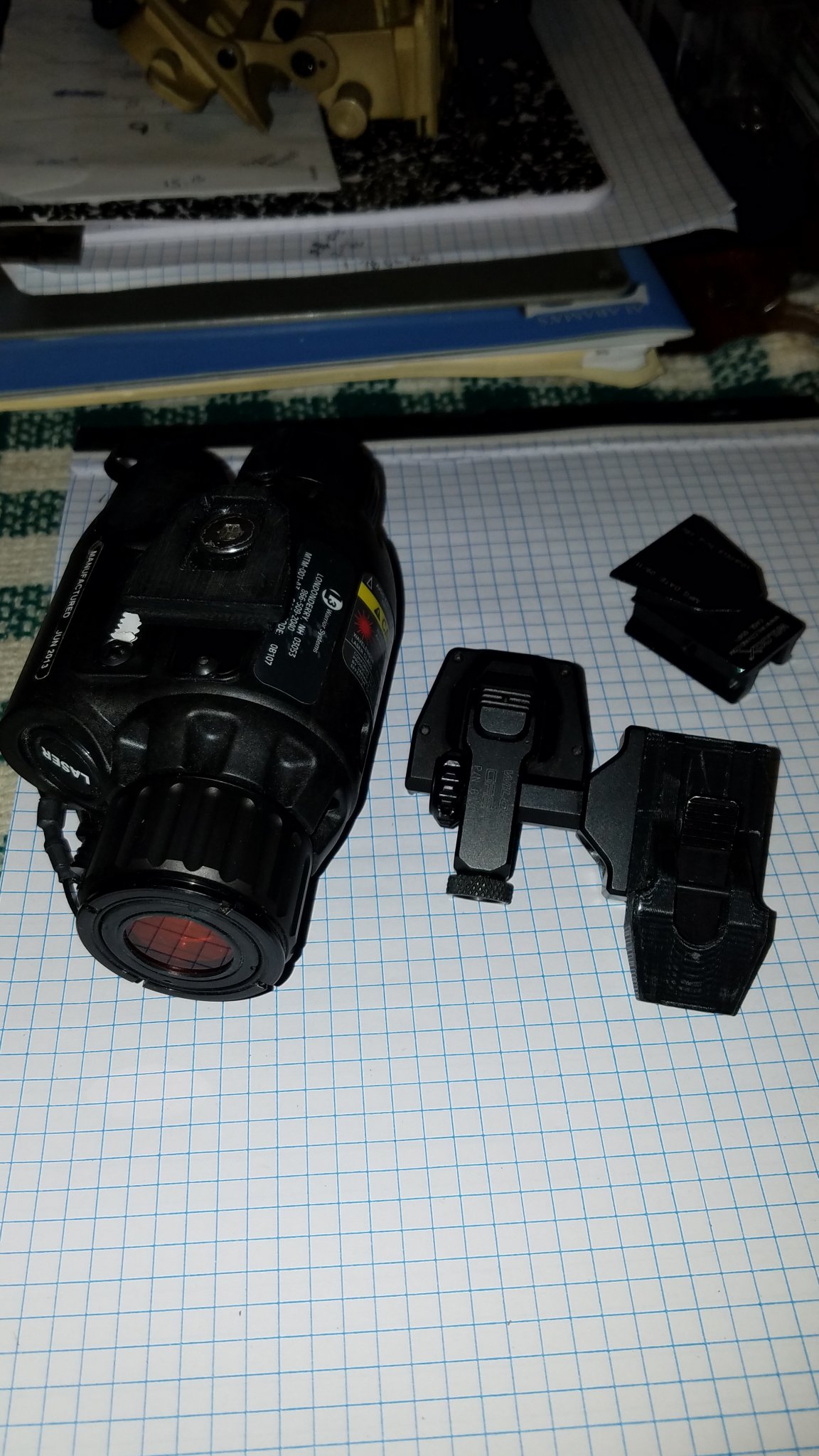

Mtm bayonet mount.

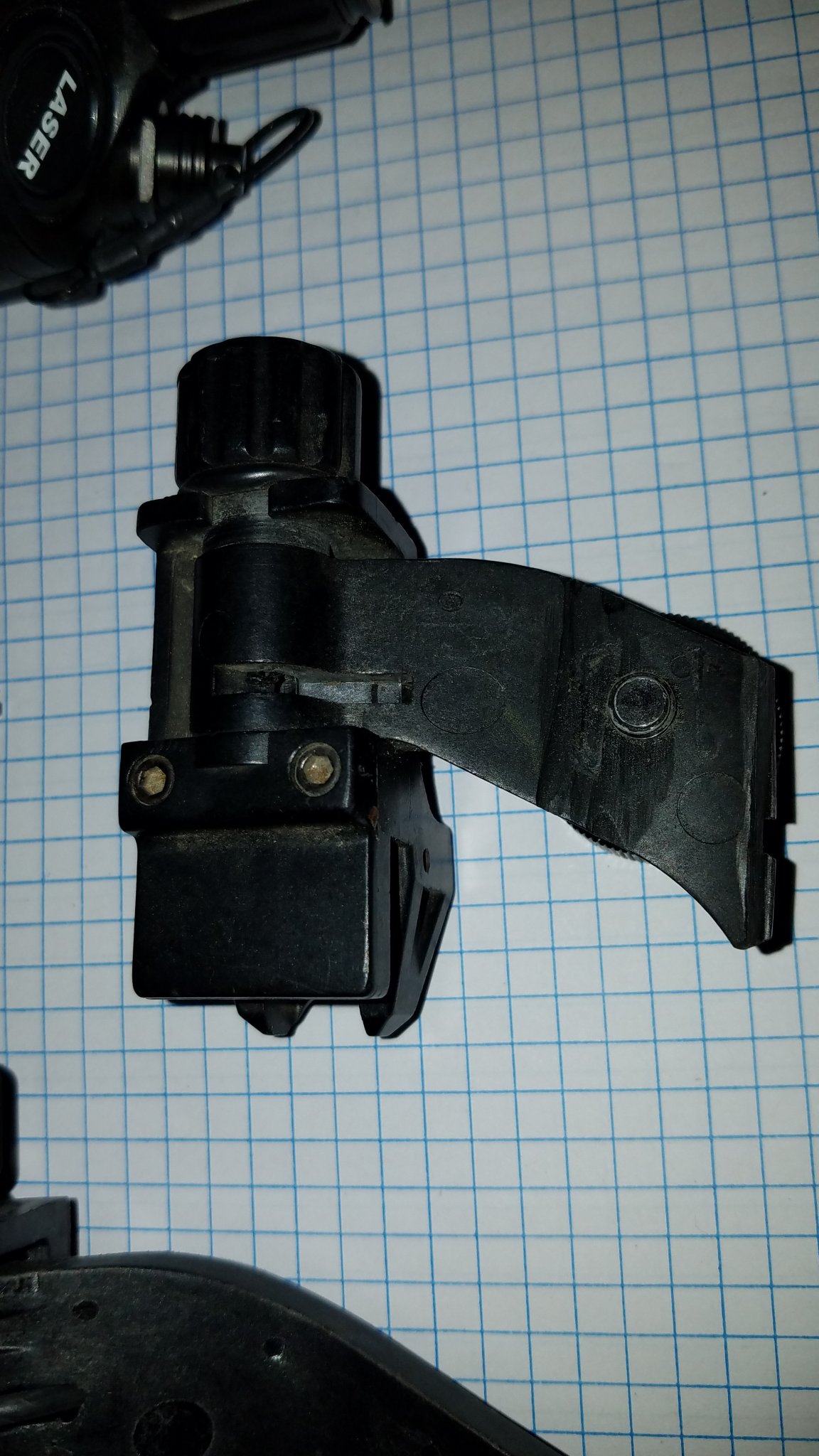

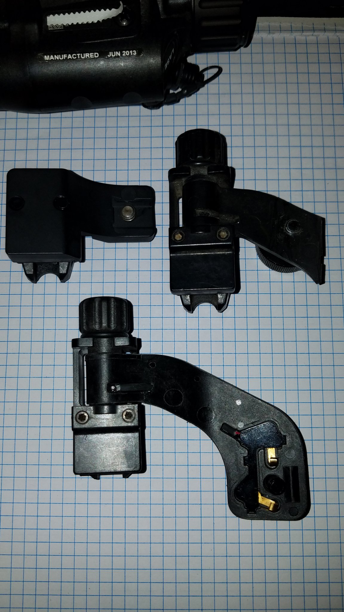

Pic of mtm, modified j arm, and non mod j arm
Another
The modified arm

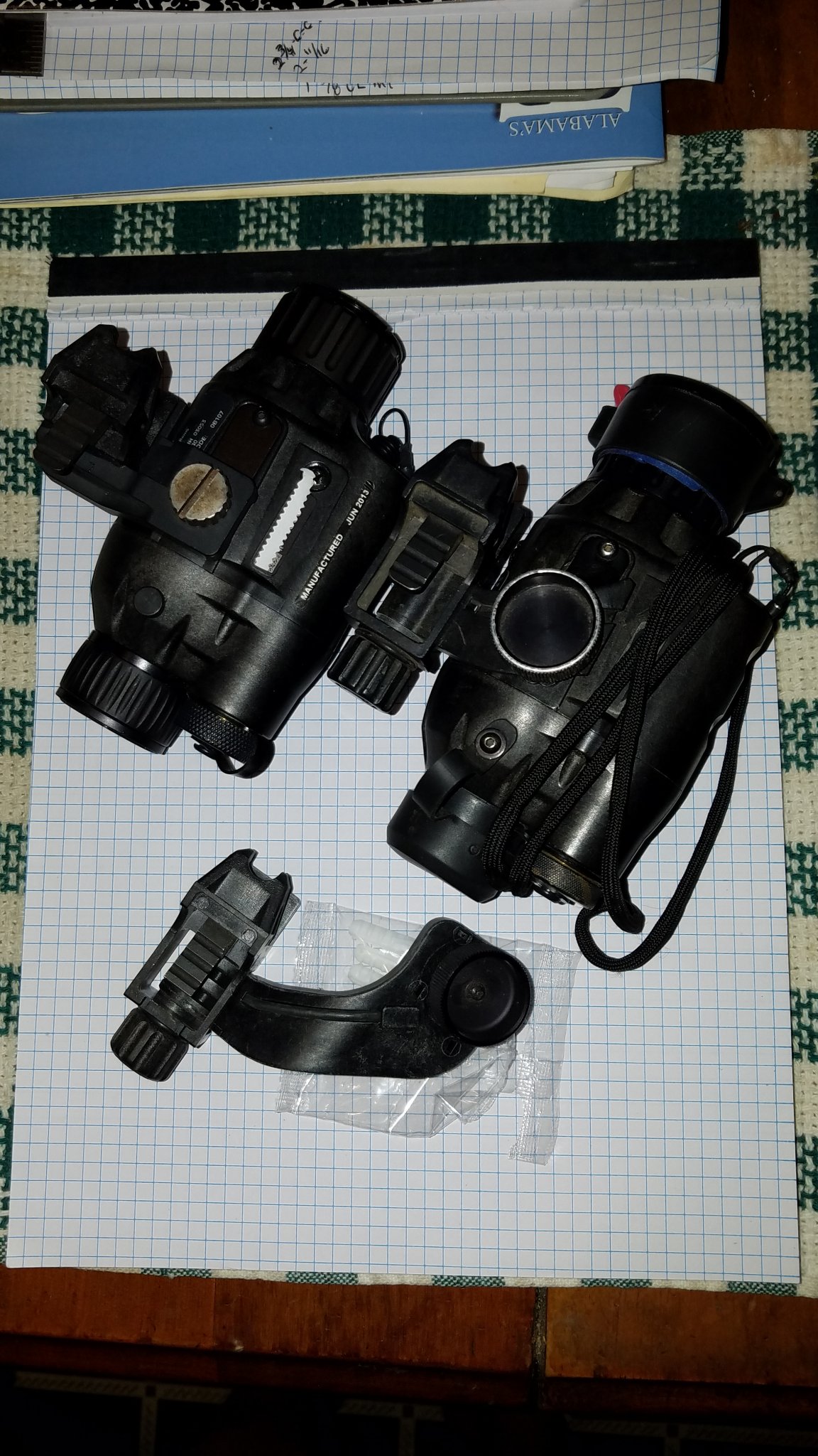

Mtm's with std arm and modified arm mounted.
Yes, if you are a little tool friendly, you can make a j-arm work. Best to you.

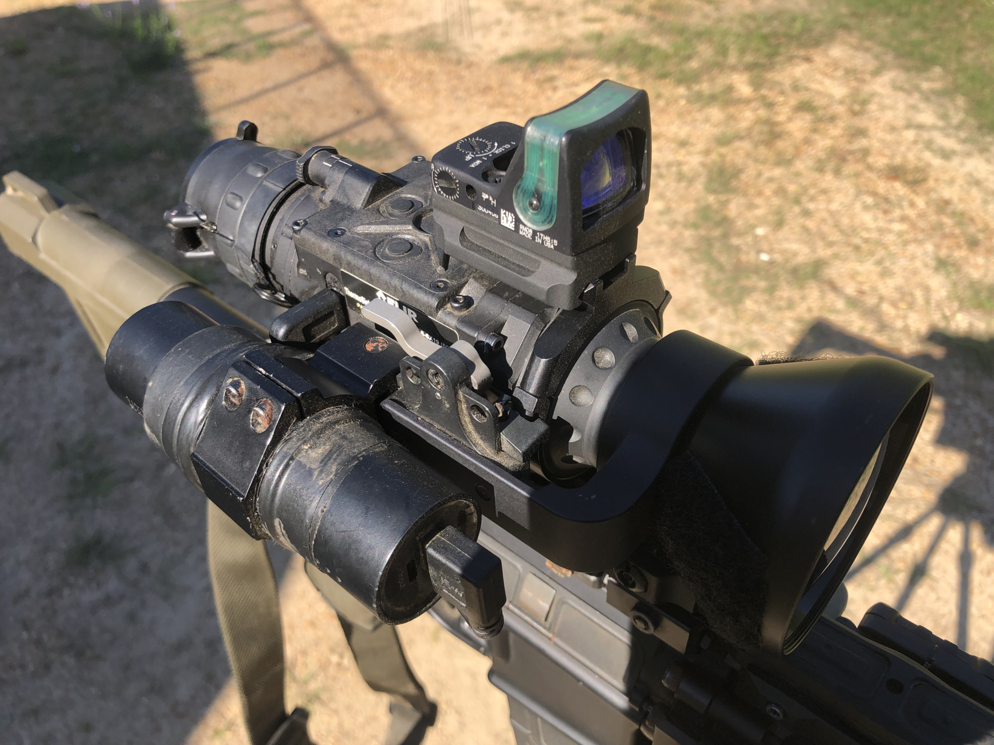

Yep, but performance comes at a price both in weight and dollars. A buddy of mine bought a 3x Magnifier for his Patrol thinking all he had to do was clip it on and it would turn it into a longer range tack shooter on his AR. I kept telling him he better get a solid lock down on that Magnifier cause any movement will change your POA/POI. Well he wouldn't listen at first, but after embarrassing himself missing some critters, the light bulb when on in his head. I had actually sent him a copy of your findings but he was too busy/lazy to study what you were reporting. When you get Gen 2 clamp all tested out, I might want to see if we can get with you and get a clamp if possible. His Magnifier is a TPL 3x 62 mm which I believe will be almost identical to the Raytheon Magnifier you have there.
Well, yup, I tried zeroing with it on there before shooting at critters ... and I was getting 4 foot POI shifts between each shot at 100yds ... so I never tried it on critters ... no elephants around here :)
What is that a 46 MOA group at 100yds !!?? :D I was fortunate to put a BIG piece of paper out there (backwards facing NRA 500yd target) ... or I might not have even seen the holes !
... TPL 3x 62 mm which I believe will be almost identical to the Raytheon Magnifier ...
Yes AFAIK they are functionally equiv, though when you could get them, the Raytheon's were $1500 ... vs ... something under $2500 for the TPLs.
I told my buddy if it shifted he was SOL, so he sighted it in and said he would check throughout the night that he would keep checking that the 2 clamp ears remained in the same position when he sighted it in. LOL, he found out quickly that close enough on the clamps wasn't good enough. LOL That one episode missing hogs taught him a lesson. LOL
On the Flir PTS 233 Magnifiers I had TPL make, they charged me $2050 each for the Magnifiers and the one off designing/building the arms and attaching the Steiner Quick Disconnect Mounts for me. I had to ship them a PTS 233 and the Steiner QD Mounts but the result was very well done. I thought that was a very fair price for all they added and did. I have a lot of respect for Dr. Leo Volfson and all TPL personnel involved. They are first rate expert people whom understand thermal and designing very well. And are very polite and professional to deal with.

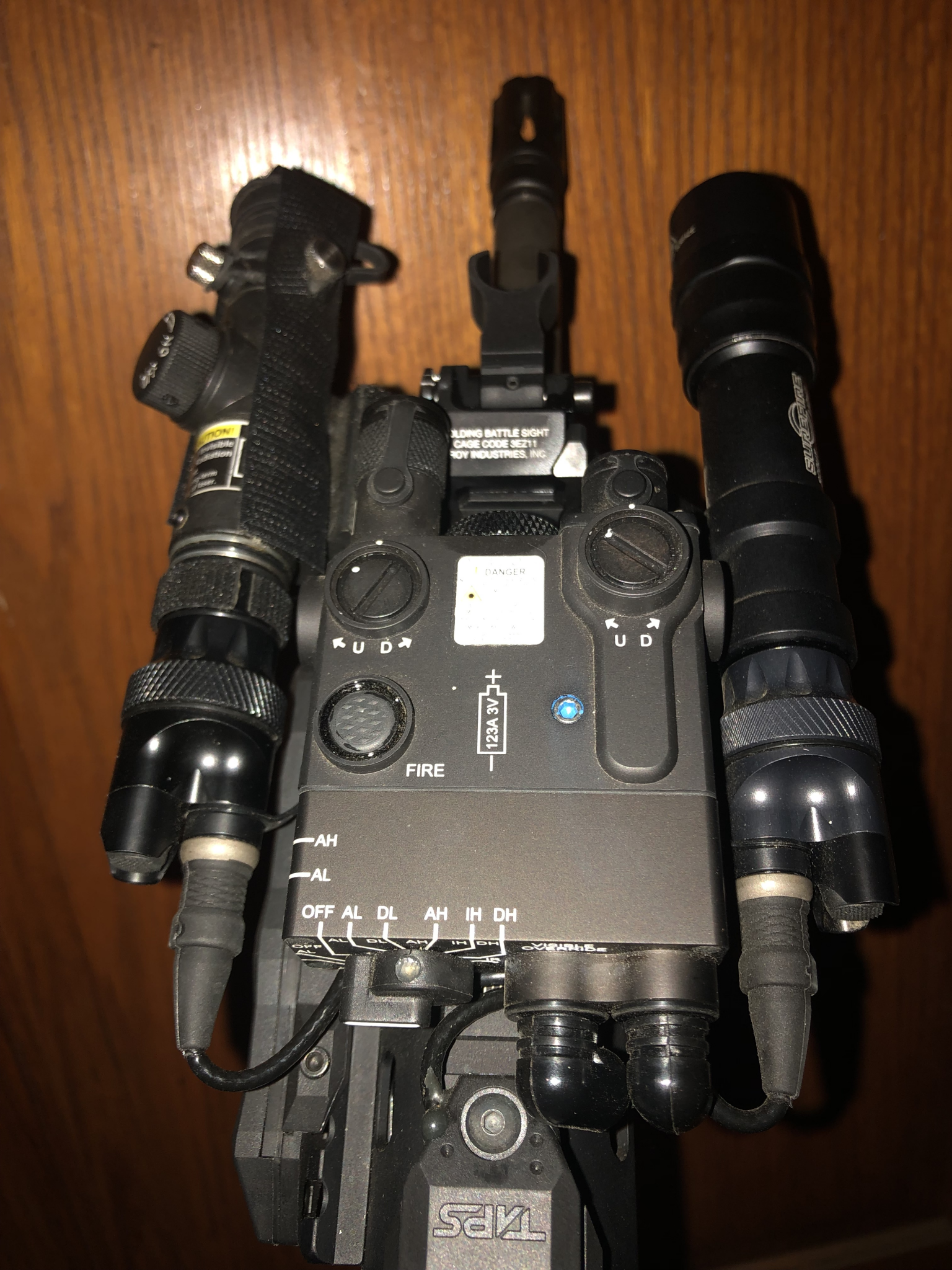

Wig, here is the laser end. Marry up the Luna Elir 3 (tuned LOL) to a civi Dbal A3 which is slaved with the Taps Pro at 9 O'clock and one press gives you IR Illuminate plus IR Point such that you have IR Illumination that will stand toe to toe with a LA-5B PEQ all night long with a nice crisp non bloomed out IR Point for a fine aiming solution. 12 O'clock Taps Pro slave Surefire DF with Vis Point Over-Ride for instant white light and Vis Point should you need it. Velcro over Lens Cap is just additional safety feature I put on Luna's during non use to make sure Lens Cap doesn't come off. Also running Modlite OKW heads on Surefire DF now and they are worth every penny. The secret sauce component is the Mod Armory manufactured Luna/Surefire adapter. They have come back into availability for folks that are looking for them. Mod Armory isn't selling them directly but made a bunch more for Luna Optics and they can be purchased from dealers like Jay at Sureshot. Still waiting on the release of the Unity Hot Button and that will be an excellent solution for slaving 2 devices.
Cool !! ... You must be crawling around in my head :D ...
I've actually been picking out the parts I need to get to double switch one of my ELIR-3 with an AIM2000 ... and if that works ... I'll do it again with my other ELIR-3 and a laser I still need to buy.
For me its not a matter of "either/or" ... I run the thermal spotter on the left eye ... and the 14/coti o the right eye. Best of both worlds.
