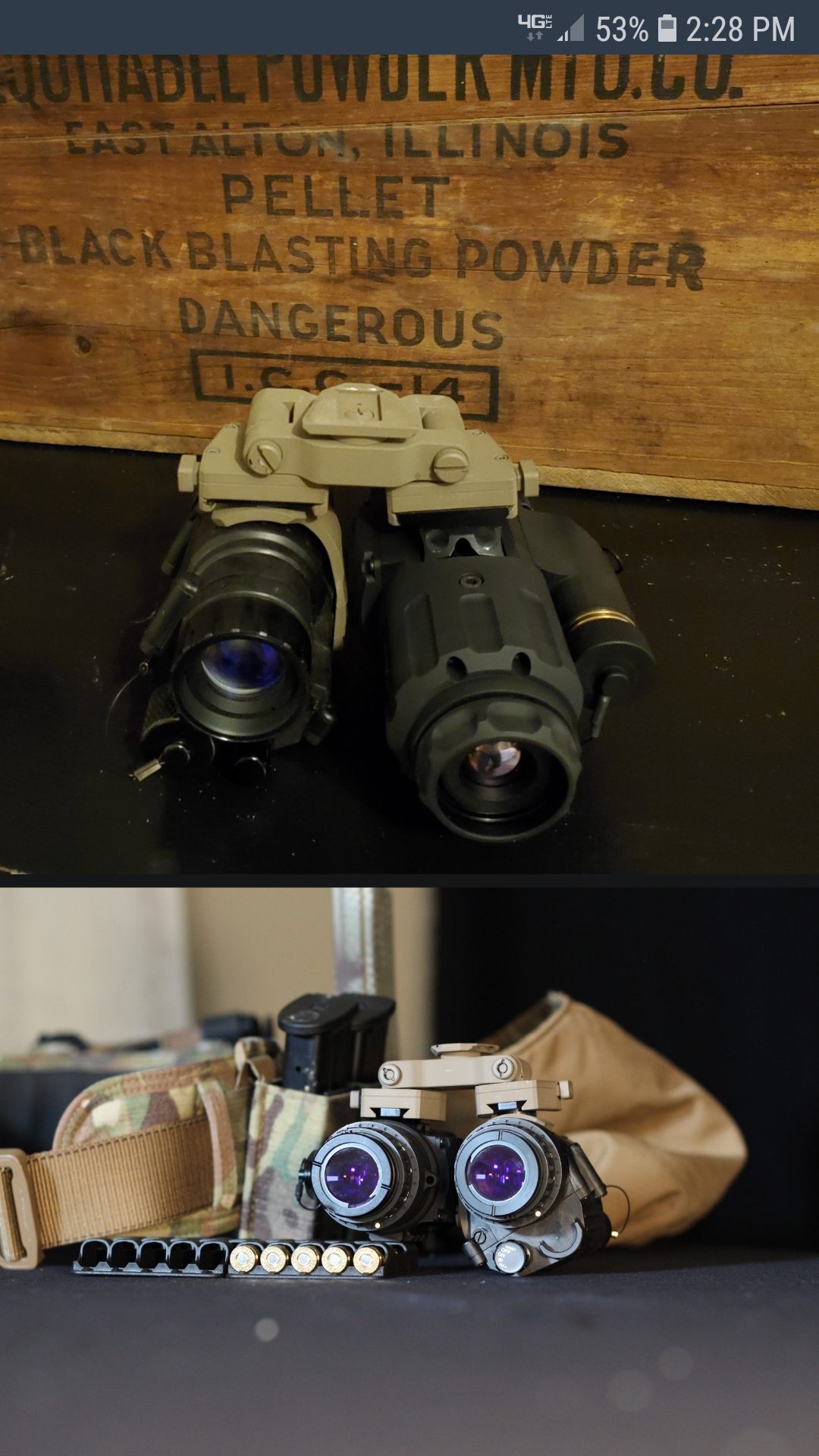

Night Vision Anyone running dual band goggle setup?
Both, didn't fall of the back of truck and not beat up. On fox and coyote at 150 yards. If in clean area it will do it if thermal conditions are decent. But that is about the absolute furtherest that I have been able to spot a fox in outline mode. If there is any vegetation the distance will drop significantly depending on how thick.
Reactions: Eliteuas
If you want a head mounted thermal spotter, the MTM or even the Breach would be a better choice ... the breach is lower cost. The plus of the coti is for helping the 14 aim with the laser when the 14 can't see the critter.
I do occasionally go "minimalist" with only 1x14 and the coti. But that's usually in open pasture ... and for whatever reason I also use outline mode for that :D ... And it works great for detection. Out to about 600yds, ,depending on thermal condiions. But I still don't consider the coti to be much of a spotter. The MTM and Breach are your under $4k solutions for head mounted spotting.

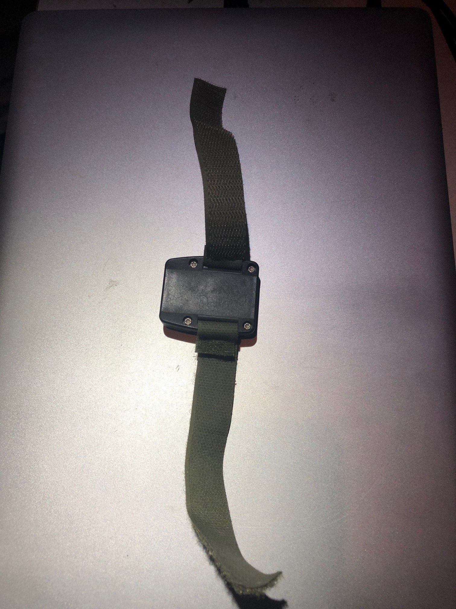

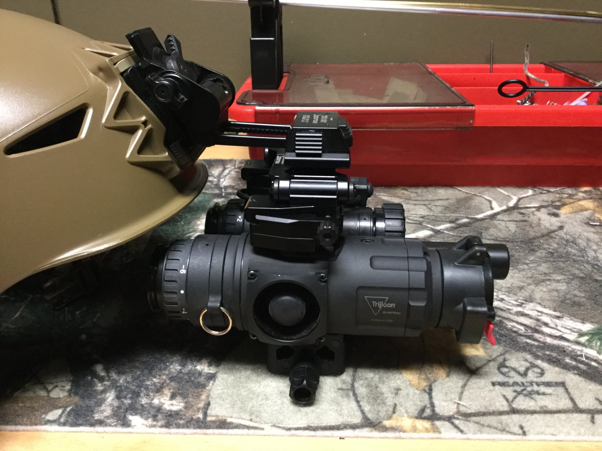

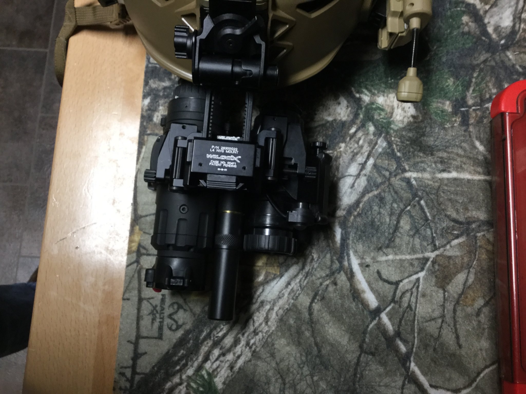

I take hook and loop and make a watch band for mine after removing it out of the rubber picatinny rail holder. Put it on just like a watch and it makes it super easy to zoom in and out plus access any other menu features. These 5 Button Remotes run off of CR123 Batteries and you just screw off the back plate and put a new one to change.

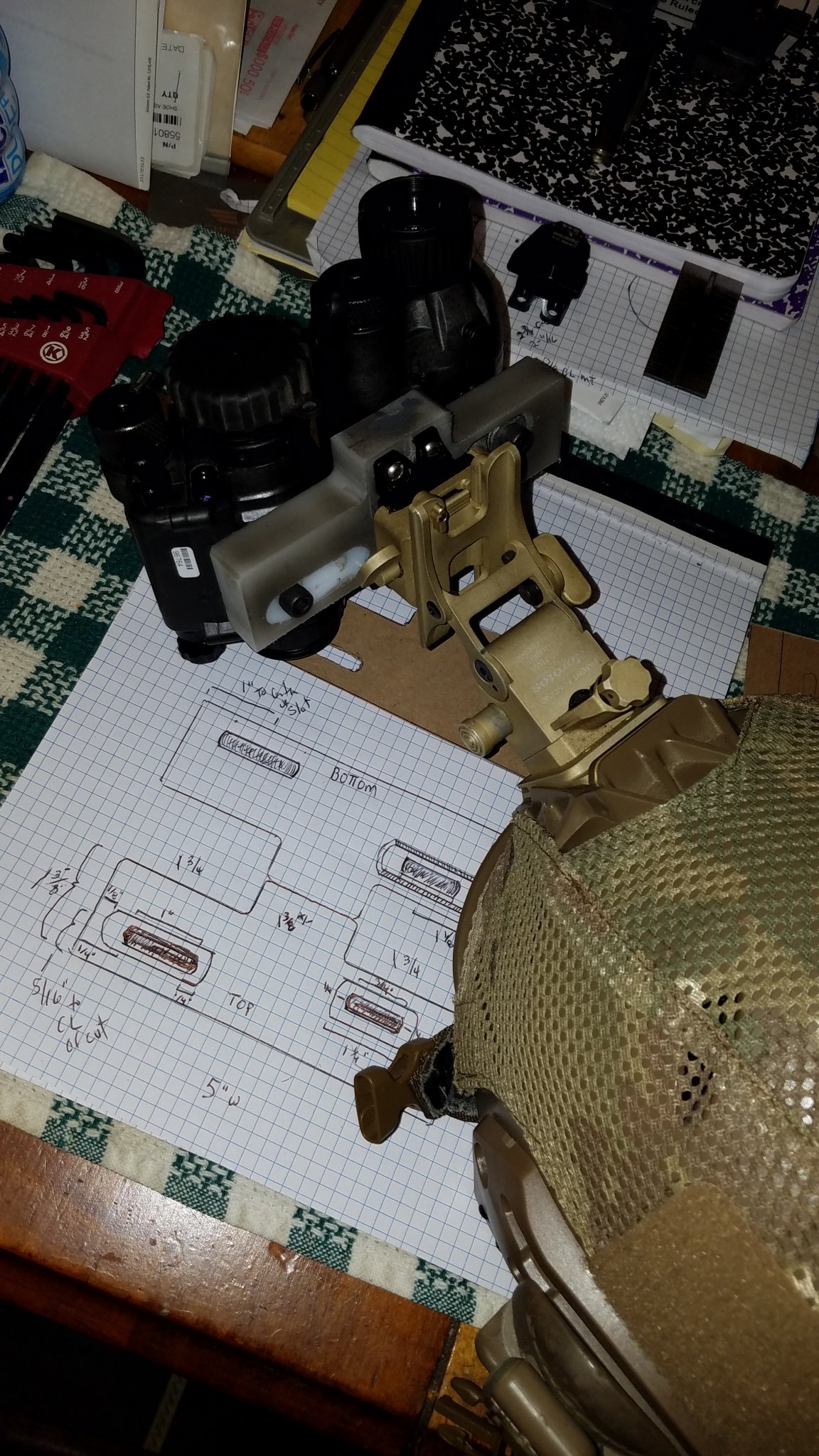

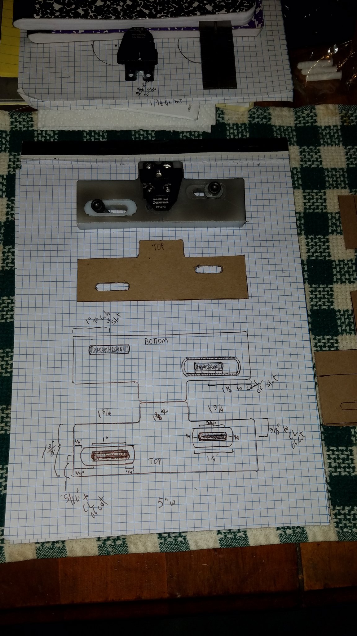

Hand made Con-Trap-shun..... (contraption).....
Rear view
Front view
Pictured with Wilcox bridge.
Thing works fine right now hand held. Got to make adjustments to center units when on helmet mount. Need to move both units left.
Re-do/lengthen left slot, and see what happens. No, they wont flip out sideways, out of the way, but, this will work on the super inexpensive side. For the do it at home handyman.

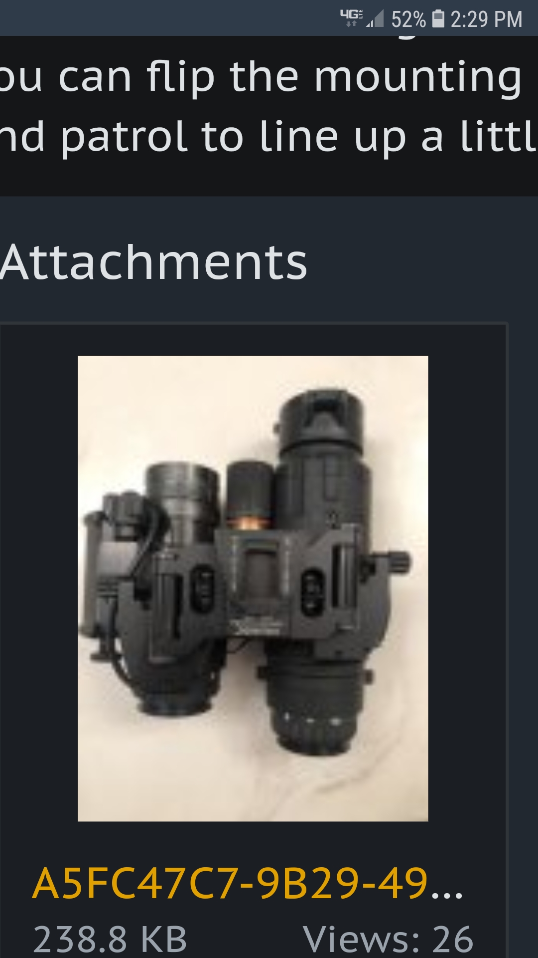

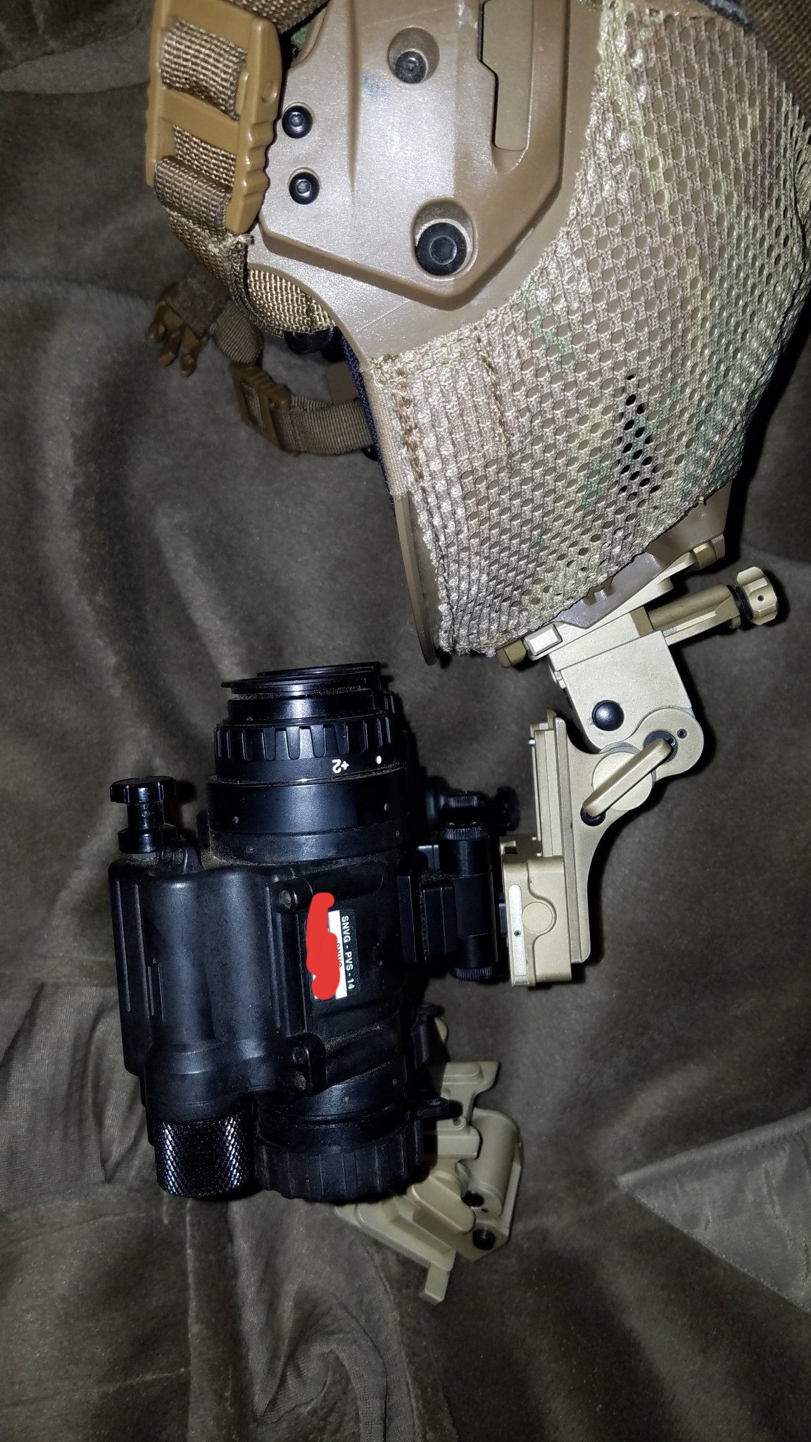

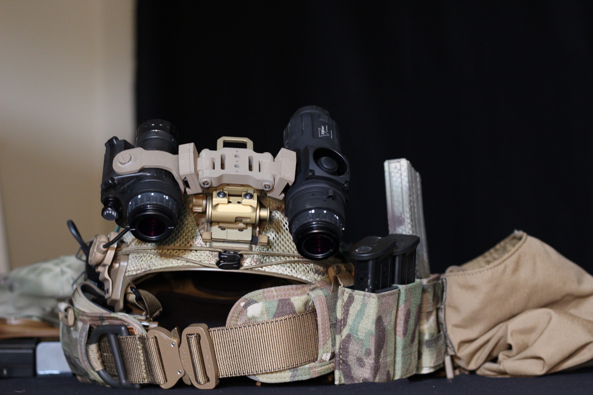

Thanks to all, this has been a very instructive thread for me. Has anyone tried to run a Patrol/PVS14 dual setup that wears glasses? If so, is there a dual mount that will push the Patrol further forward? I currently have a Wilcox G22 and their dual bridge and even with one arm on the dual bridge flipped and reversed to provide more forward movement of the Patrol, I still cannot wear my glasses.

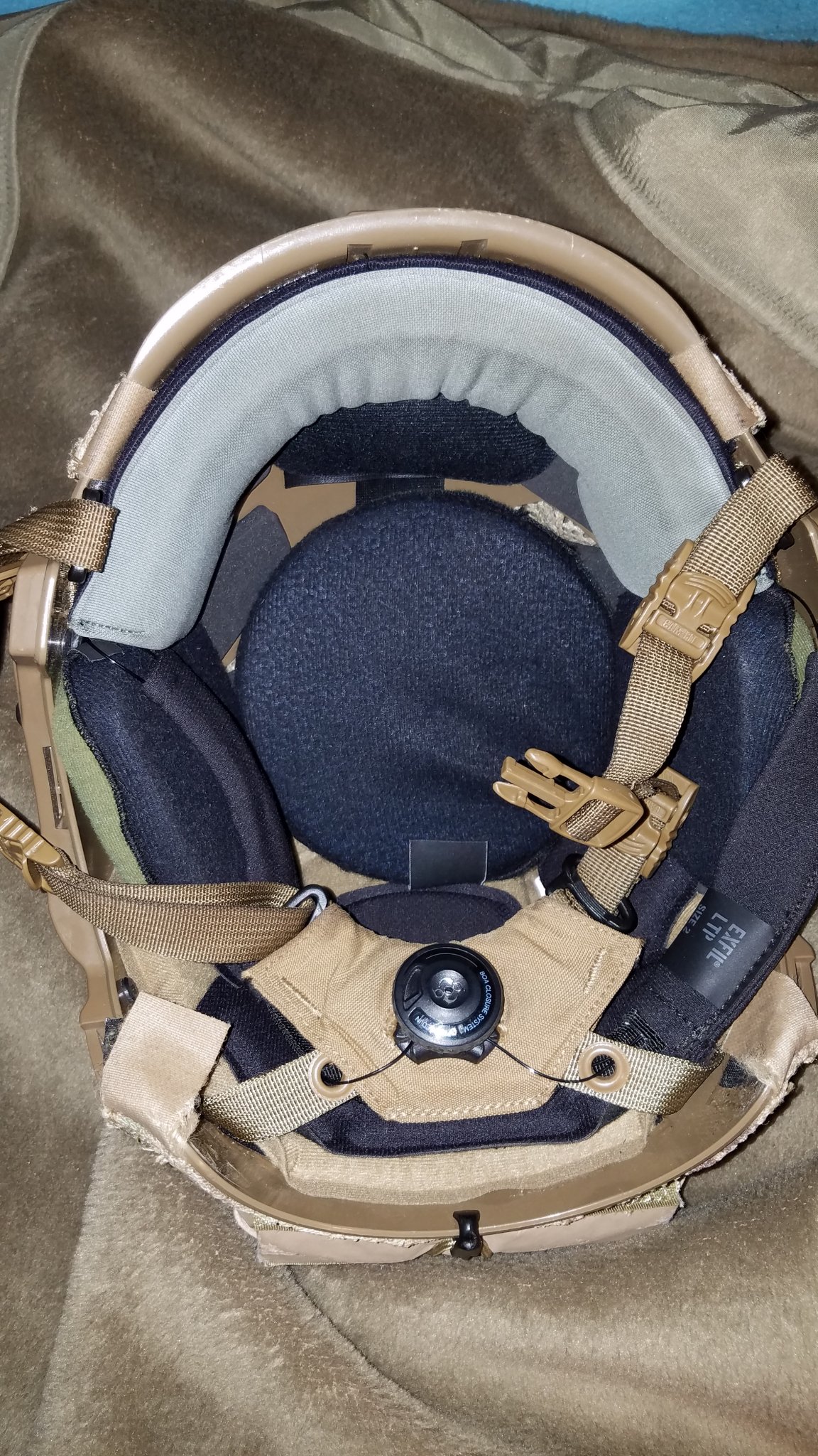

Not sure what kind of helmet you are running but here is a thought for you to maybe consider. You can take the thicker 4D brow pad and put in a helmet and it pushes your face away from the mount say 1/2 to maybe 3/4" ish and that will put your NODS/Devices a little bit further out.
Just a thought on how you position a helmet on your head via pads, H Nape Ratchet band etc.
T
Thanks, have not thought of that but will check. Running with a Team Wendy bump helmet.
Frog05's pic, showing patrol and pvs 14, eye pieces even. Should work on AKA2.
NewGuys pic, eyepieces not even. Doesnt look like it will work with AKA2.

@j-huskey . I can tell just by looking at those pics it is comfortable. I hear some crying about the weight of a dual set of PVS 14's and I think most of that comes from they don't have the inside of their helmets set up/padded correctly and or properly counter weighted.
Also, because of not being setup up correctly, quite often they are having to run their chinstraps way too tight. Setting up a helmet correctly is probably the most important thing to enjoying a night out under NODS IMHO.
Reactions: j-huskey
You and I are in agreement on proper setup. Do it wrong and suffer, badly. Do it right, still not the most fun, but works well enough to have fun removing mr yote or ms pig.

Thanks for sharing this. I will share a picture of the setup, but it will be a couple days before I am back and town and can do so. It looks just like the last pic with the right Wilcox arm flipped too.
@BamaSE
Frog05's bridge is an Integrated Components unit, using the unit's removable arm on the 14, and the bridge receptacle (minus that arm) for the patrol's dovetail.

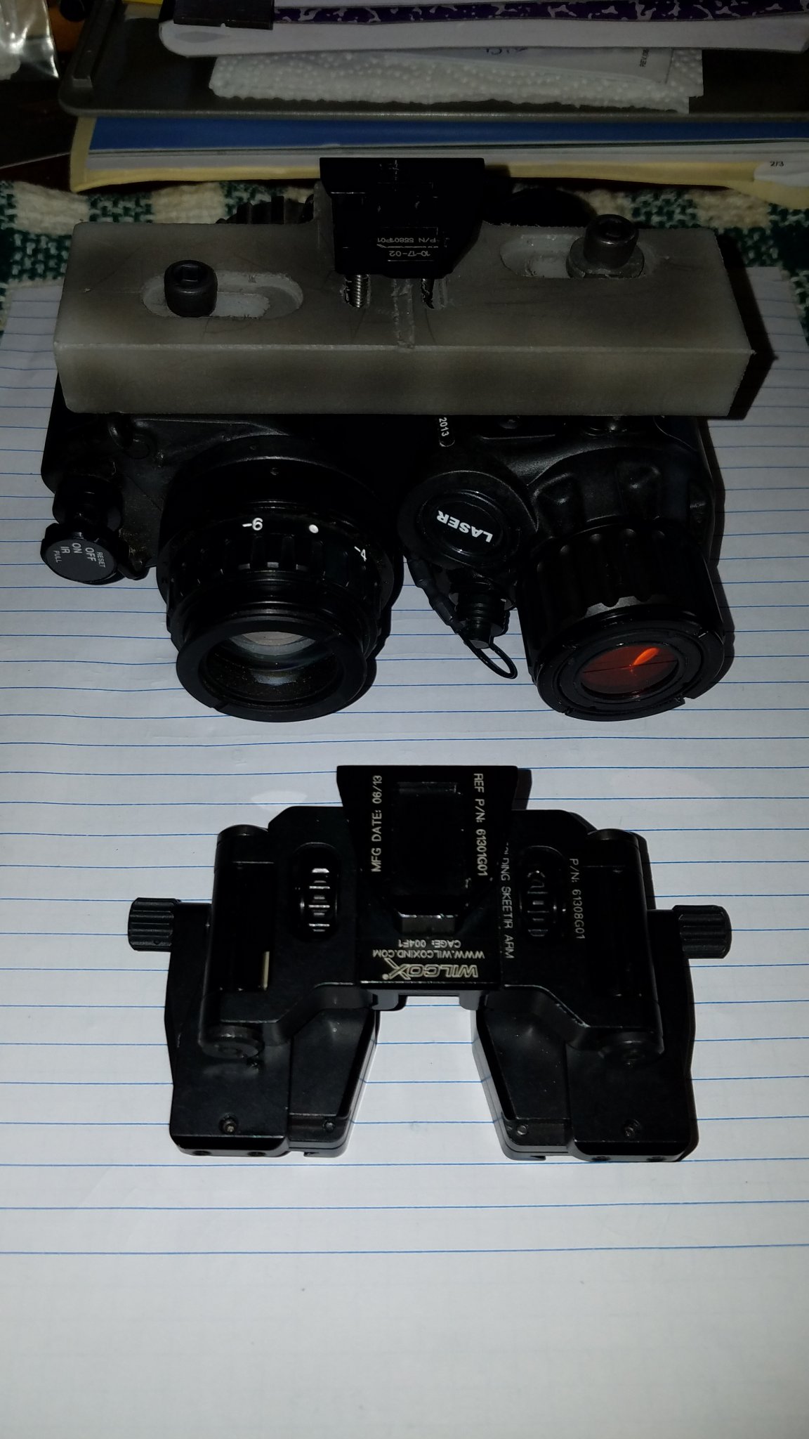

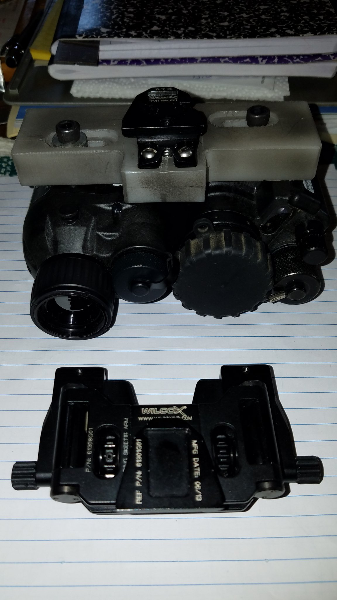

Newguys setup is the wilcox bridge. I have spent about an hour screwing with my wilcox bridge and my Reap/IR, which is the same body fit as the patrol. I cant get any different setup than the pic shown.
And.... it's back under the helmet lip, around 3/8" at full forward extension.
Real close to my glasses experiment.
Cant say how it might work for you without you actually trying an aka2.

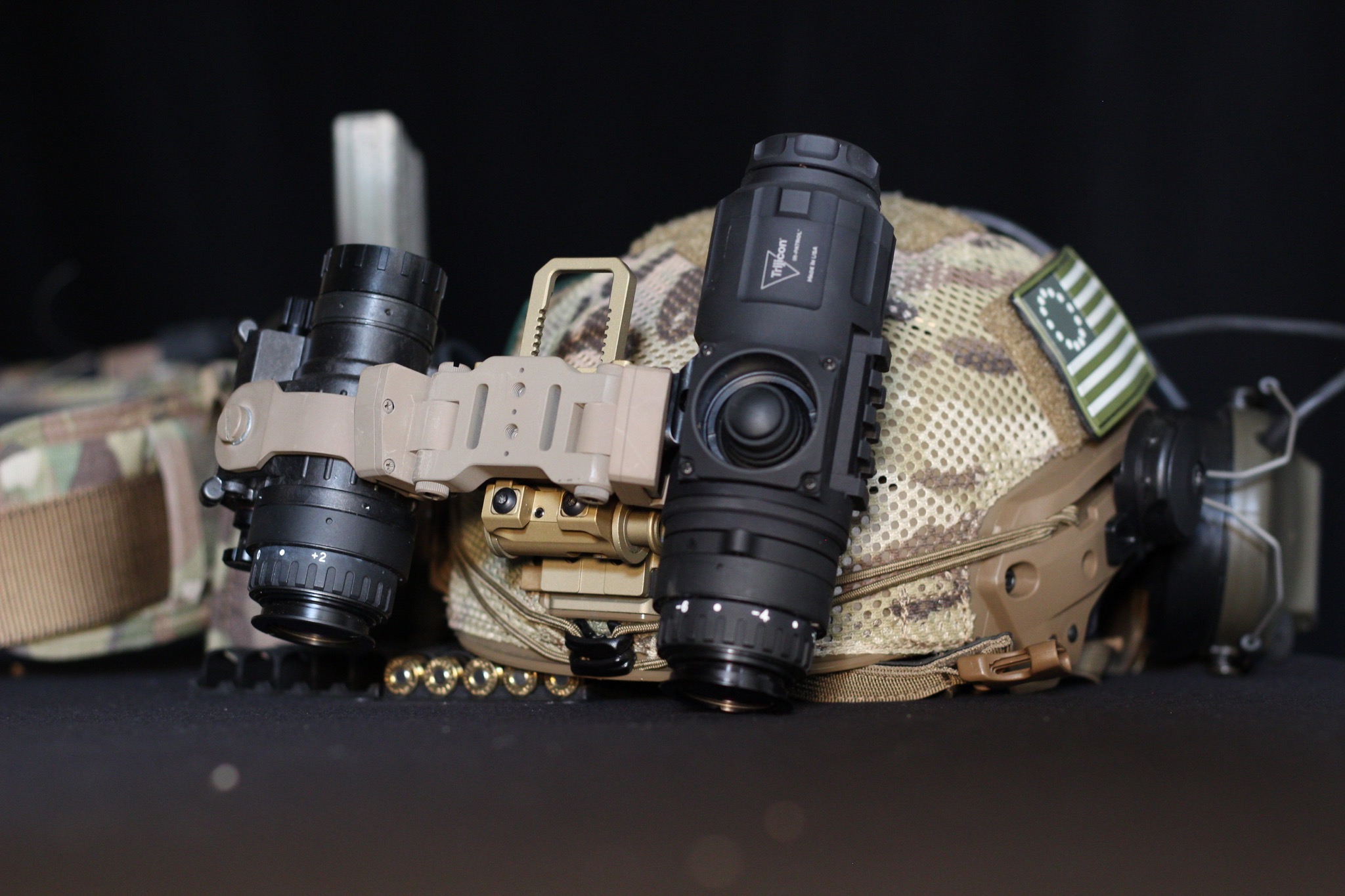

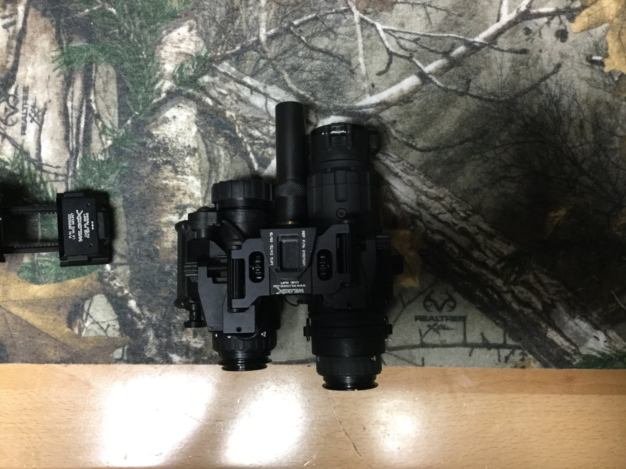

My cheap solution to the 14 and mtm unit mounting after revision 2.
It does work, but takes a ton of getting used to. Would work better with a white phosphor 14 than the green.
Still working on dovetail shoes to adapt to the wilcox bridge, shoes should arrive in mail Friday, then we play some more....
Pics will follow.

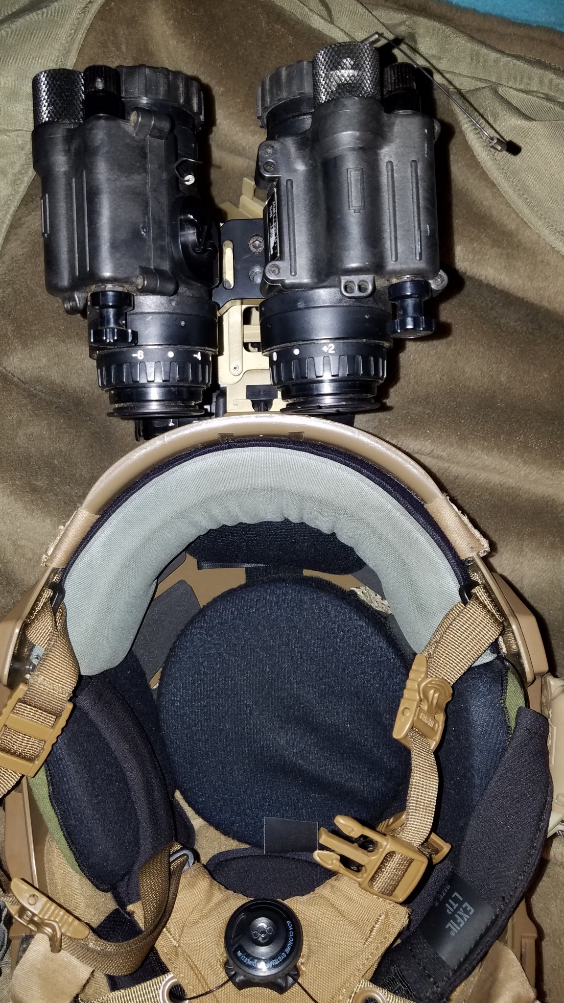

Finally got back to where I can post some pictures and thanks again for all the input, that IC setup sure looks sweet. And ditto on the expense of this stuff. I considered even going with a Breach but the expense of the unit plus all the pieces and parts to run it dual with the 14 was more than I could handle for such a limited use. And I am spoiled by the Patrol clarity. One thing flipping the arm for the Patrol did accomplish is allowing it to even be functional at all with this setup even though without glasses, it was almost pushing on my eyeballs. So folks without glasses should be okay. I have every weight that came with my setup in the pouch plus when I run it I have to strap on a full 20 round 6.8 magazine to get the balance right. It is heavy. I have also found when running either unit solo to just use the Wilcox mount that came with the Patrol. It does allow glasses on the G22 and with the dovetail added to the 14 at least makes it quick and easy in the field to swap out as needed.
Pics will follow.
