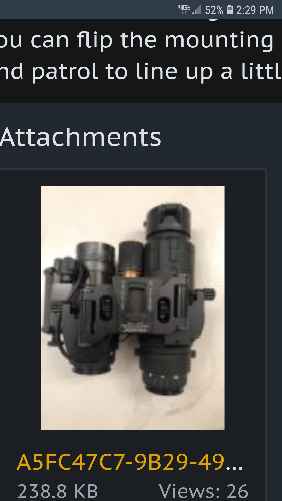

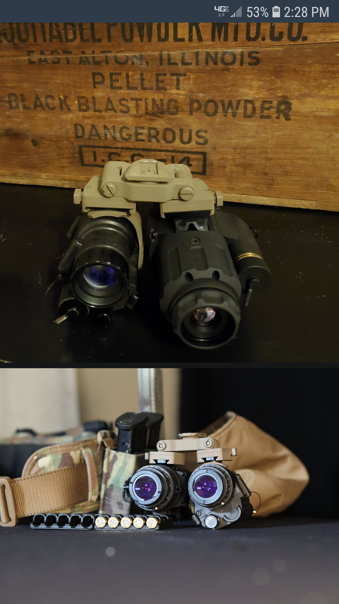

Frog05's pic, showing patrol and pvs 14, eye pieces even. Should work on AKA2.
NewGuys pic, eyepieces not even. Doesnt look like it will work with AKA2.
@BamaSE
Can you post a pic of your unit, laid out like new guys. Give us an idea.
I need to give a shout out thank you to Frog05....back when my buddy and I were trying to figure this same setup out we were Googling how to do it and this picture popped up. My engineering buddy said that's what we need to try and that's how the idea came up to flip the arm on the Wilcox dual mount. After looking at the picture again I am certain it is the same picture we came across.
