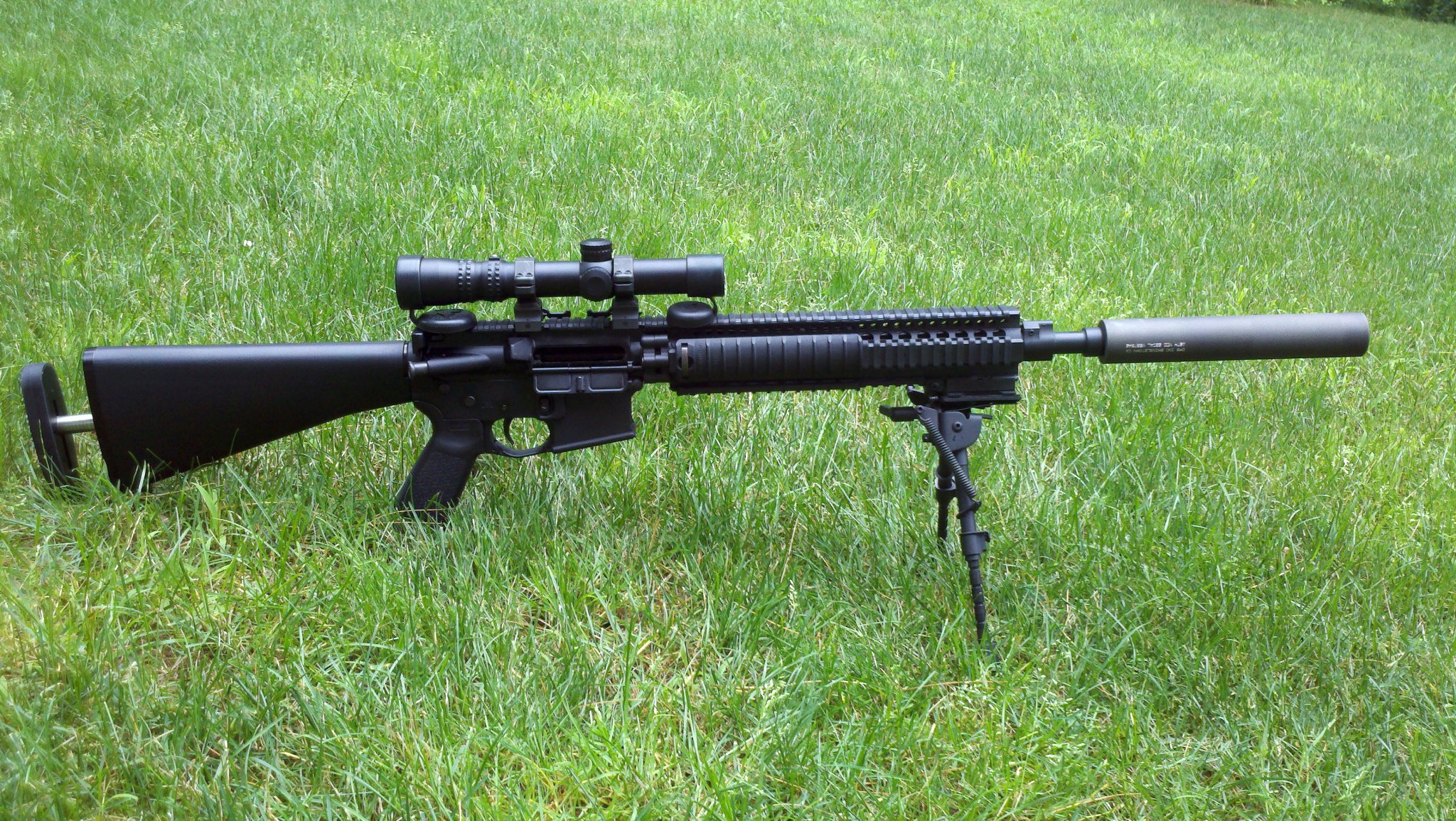

Here's a pic of a 12th model anyway lol

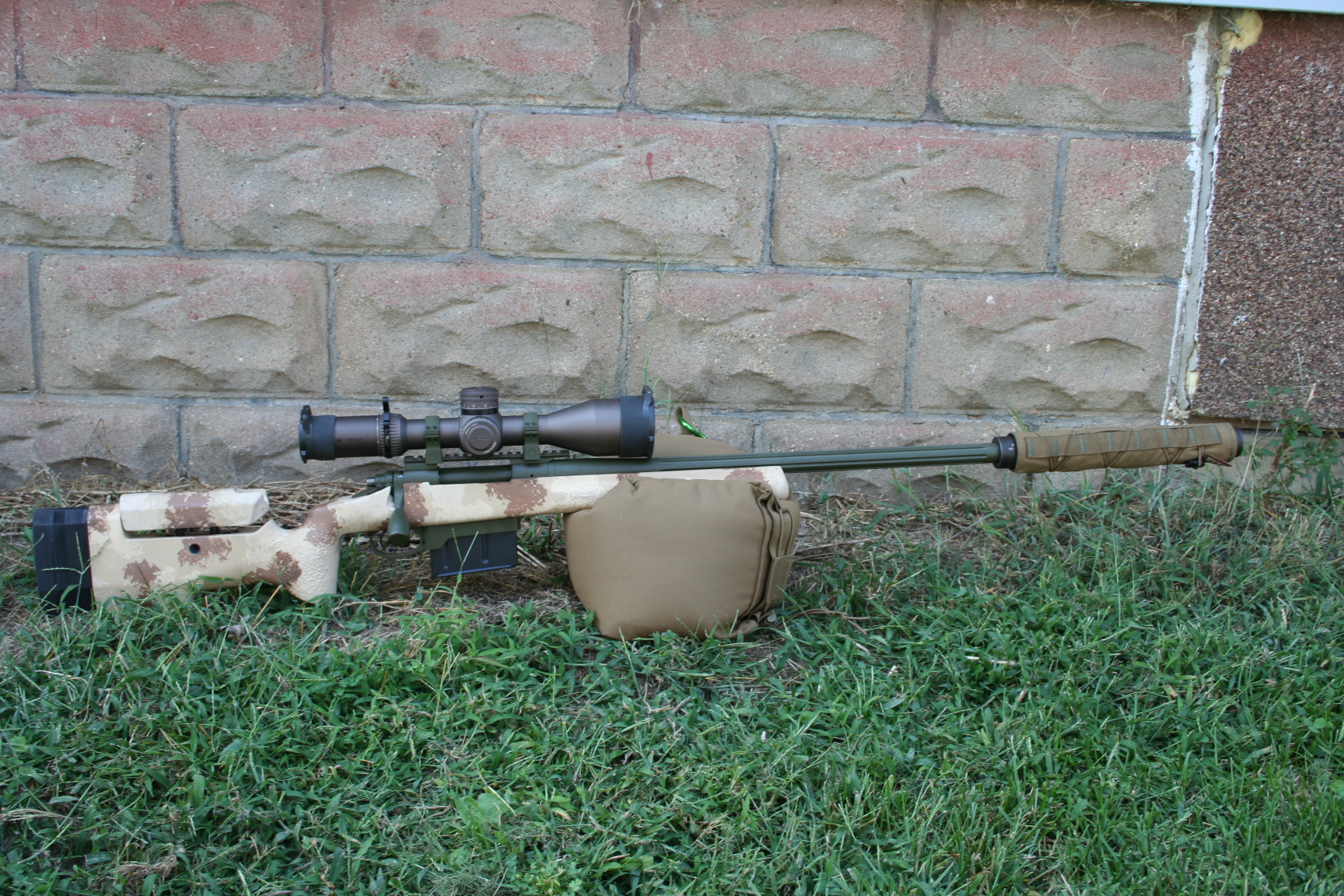

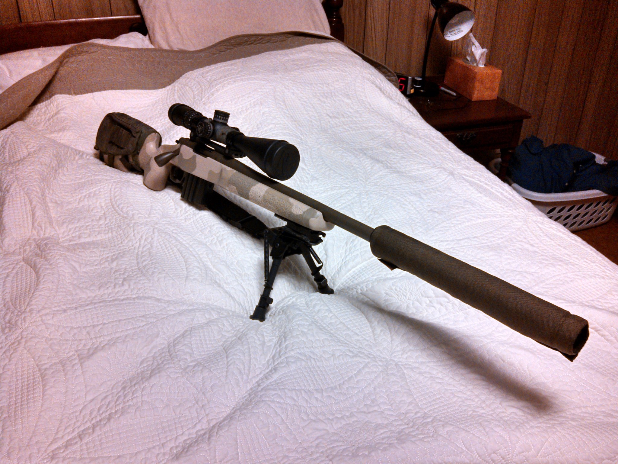

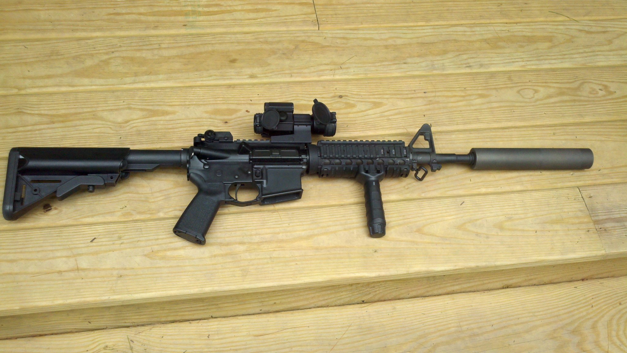

I have owned an Ops Inc 12th Model since 2010 and what must be one of the last 3rd Models since 2012.
Both are excellent performers, with the 12th seeing time on my MK12 and M4, putting up with both high-volume fire and high accuracy expectations.

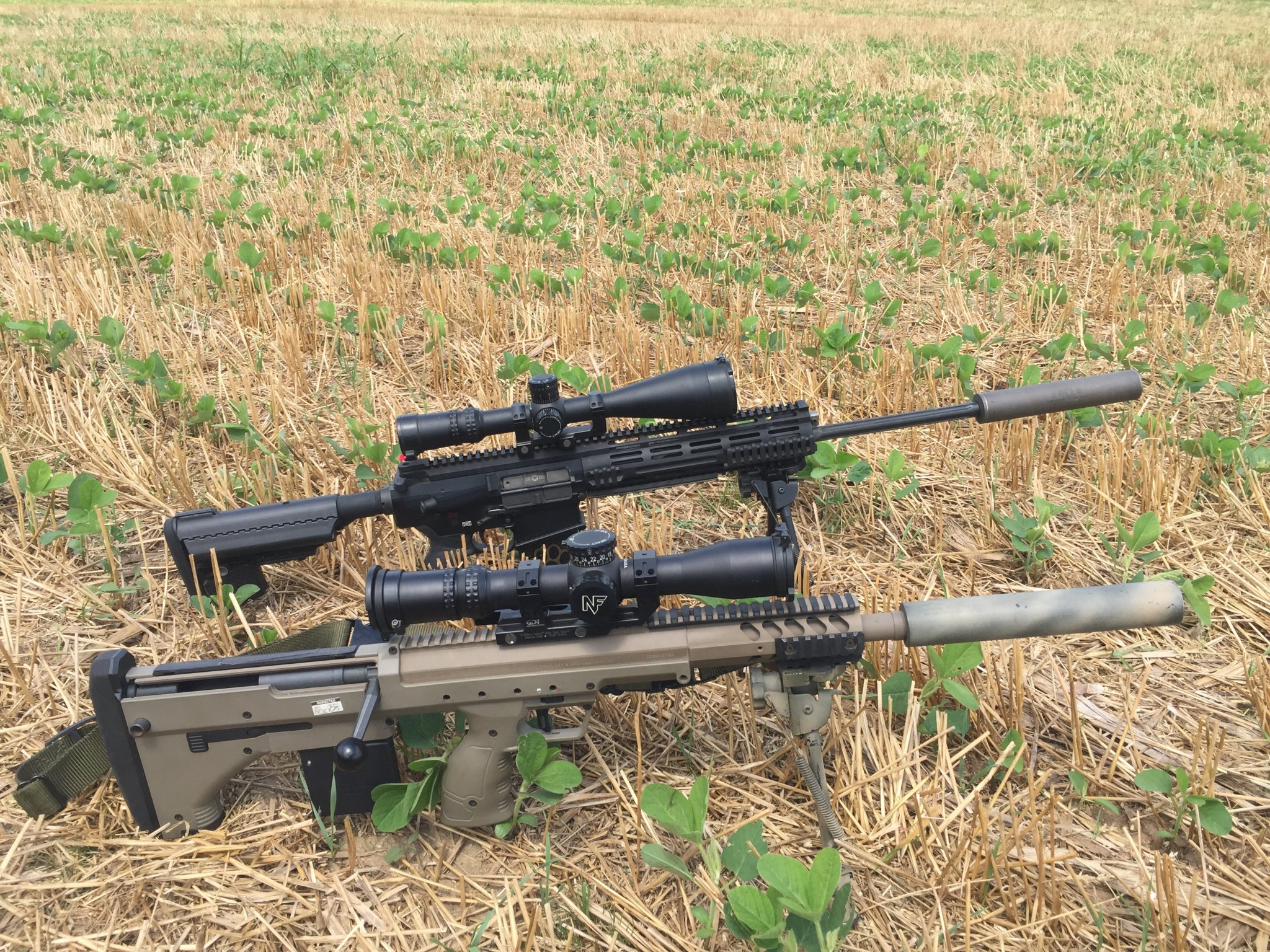

The 3rd has seen time on 308 bolt rifles, AR10 in 308, GAP10 G2 in 260, 260 bolt rifle and 2 different 300wm bolt rifles. I gain about 25fps with it on the rifle and POI shifts are very repeatable and within about 1-2/10 mrad. Noise performance on both is excellent. No numbers for me but when I ran the 300wm with the 3rd on it at a match, all the ROs thanked me ?. Only beef I have is that the 3rd Model uses 11/16-24 threads instead of 5/8 or 3/4. Pretty sure the AE30 uses 5/8-24.
3rd on 308
7065077
3rd on 300wm
7065080
12th on MK12
7065091

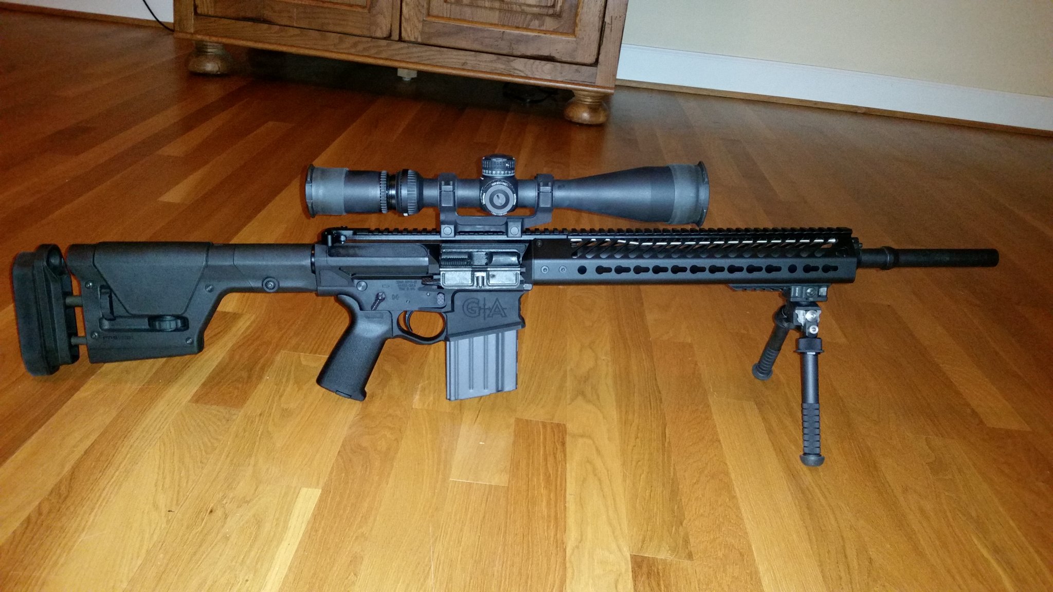

GAP10 bare (notice collar on barrel)
7065093
GAP10 with 3rd
7065094

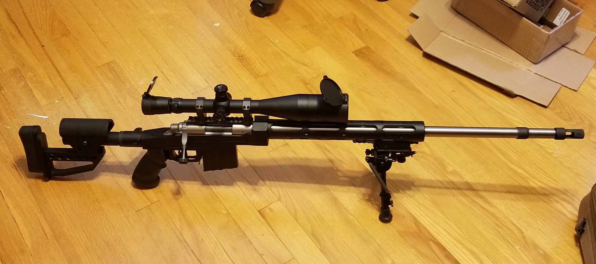

The downfall to this suppressor vs something like the AE is size. It's a big can, but on my 26" 308 Howa 1500 it only adds 3.5" of length to the barrel and the weight of it significantly reduced the barrel harmonics transferred to the chassis. Without it, the barrel vibrates the whole chassis creating a "thunk" noise but the suppressor almost completely eliminates it.

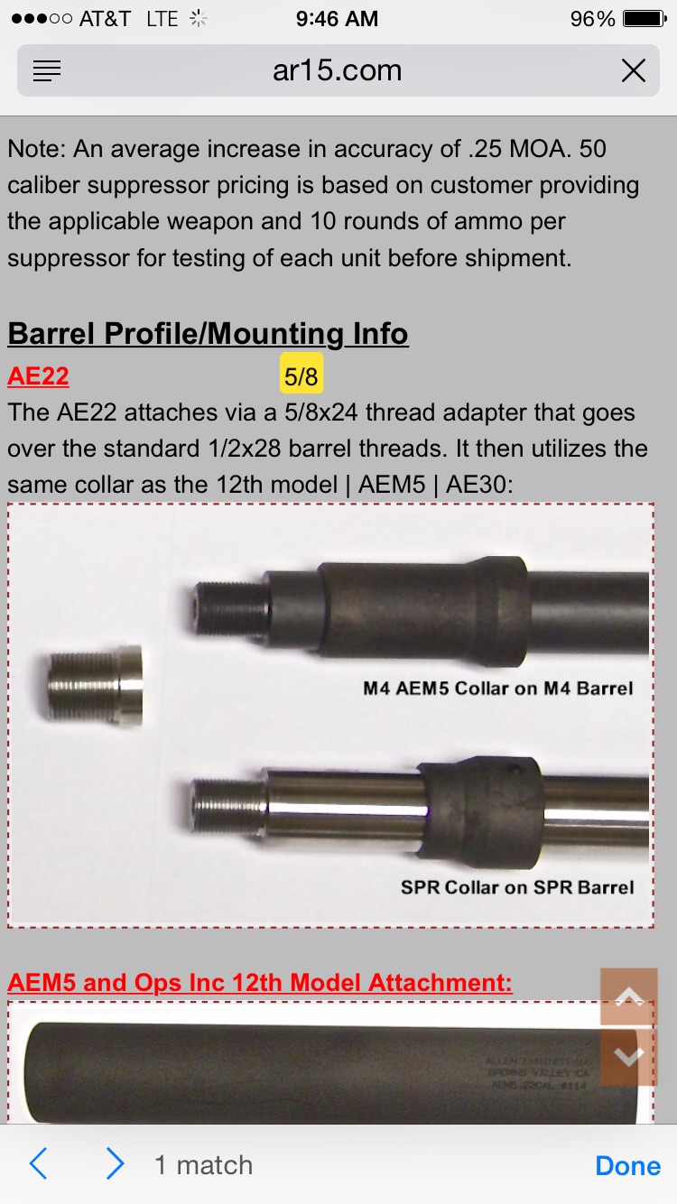

Older thread, but question on current topic. I have had an OPS Inc 15th (5.56) model since '09, love it, very first suppressor.
I've normally run this setup on AR15s, but recently came into possession of a .223 bolt gun setup I'd like to suppress. The barrel is currently a m24 contour, 20in, threaded 5/8-24.
I know I'd have to recontour the barrel to build in the integral collar, but given the threads, I assume I would have have to cut this barrel shorter to rethread? Would rather not lose the full 20in, but I will if I have to.
Talk to Ron at Allen Engineering. I am pretty sure he makes or made an adapter that threads onto 1/2-28 that allows you to attach the can. I had one for my 12th model on my M4

Ron is excellent to deal with. Call him he will set you up or tell you what to buy to make it work. He made custom colors for a couple POFs to fit their barrel contours for me.
Here's a big informative thread about opsinc/AE
Reactions: chrome
@RonA - Awesome news, highly suggests I can keep the full 20inch on the barrel. I am on the AE website - would I need to special/direct order the .223 brake in 5/8-24 from AE or would a dealer have those in stock?
