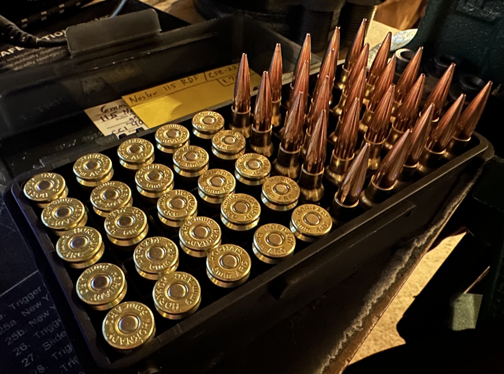

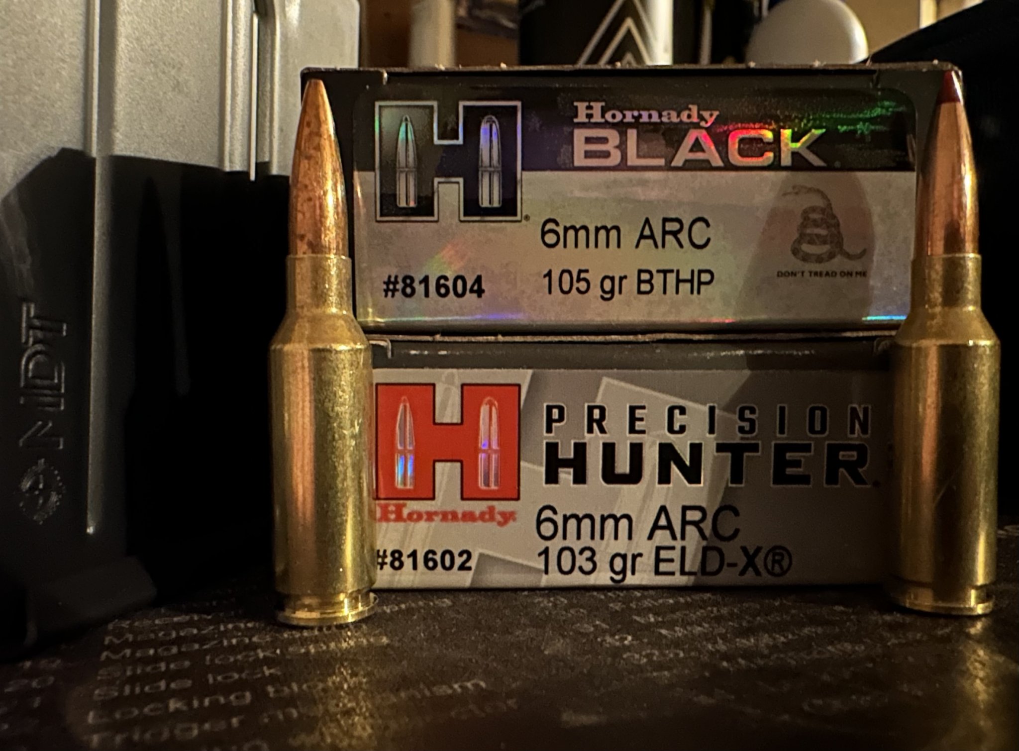

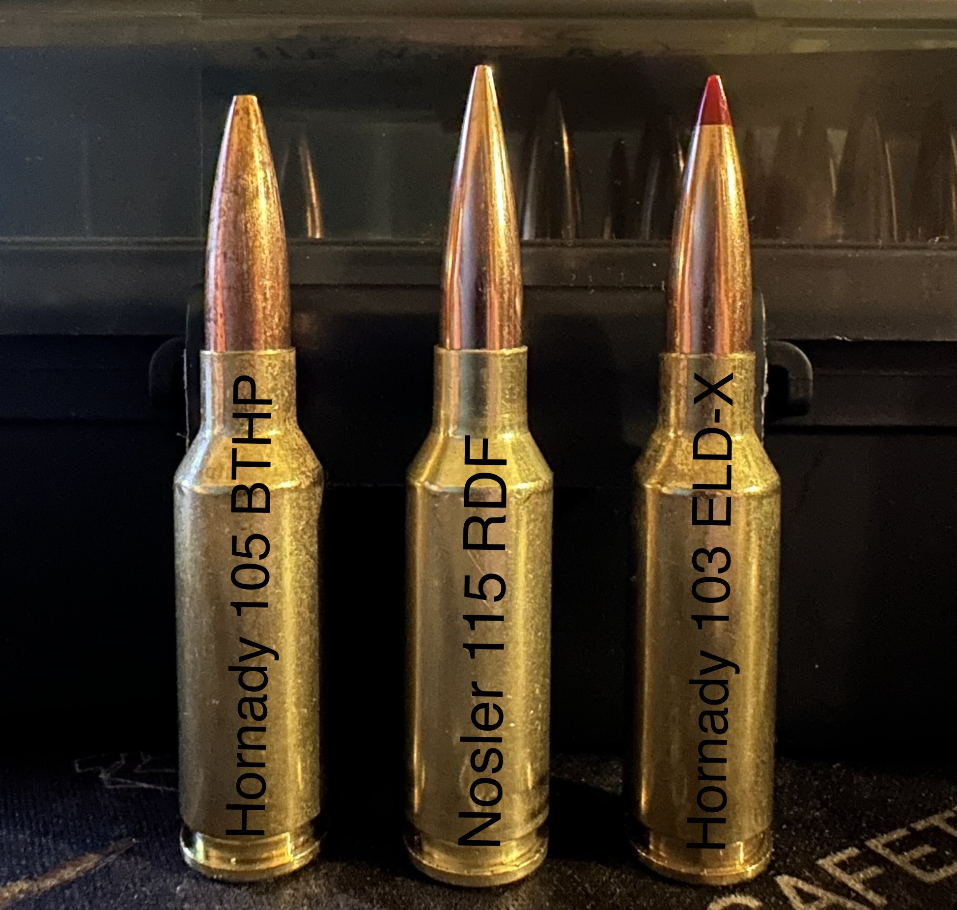

Honestly, after shooting it a lot, and doing development, and running ballistics with the 115 RDF load…My mind has changed. A 115gr 6mm bullet outperforms the 123gr 6.5mm bullet in the 6.5 Grendel. I really like the cartridge.
Factory ammo sucked, but I needed to shoot it for the brass, because it was impossible to find brass at the time.

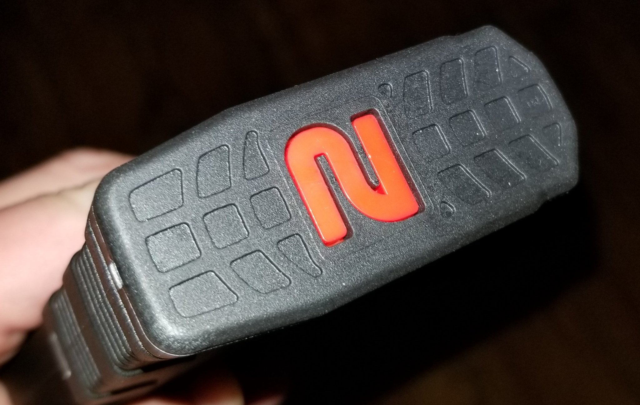

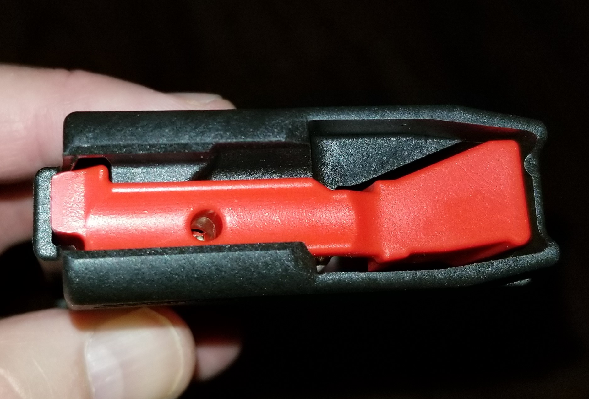

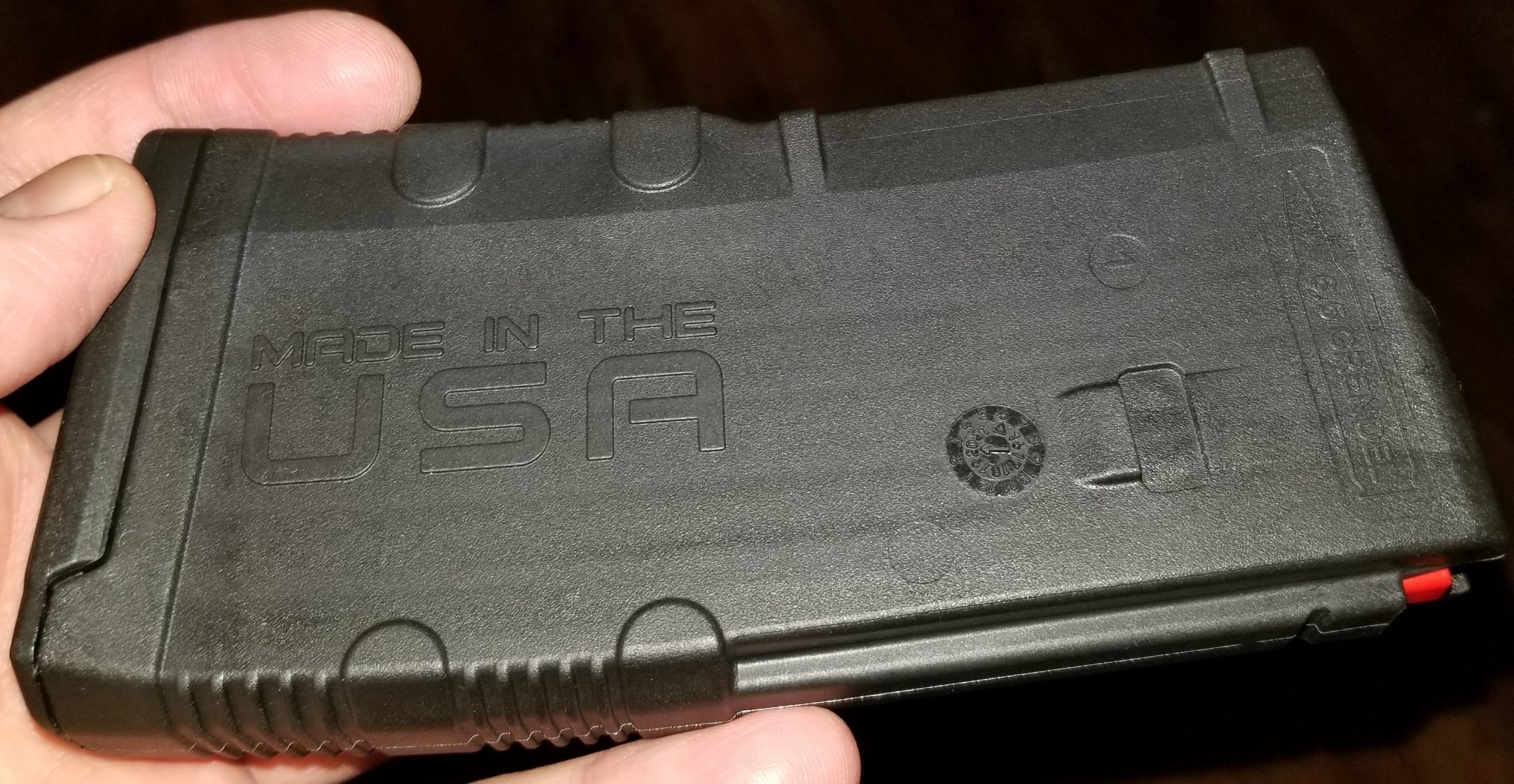

It's a really great round but I recommend a rifle-length gas system and a good mag, like Amend2, or E-lander, and don't expect to fill the mag all the way up (save the 10rd Amend2 as they are single-stack staggered)

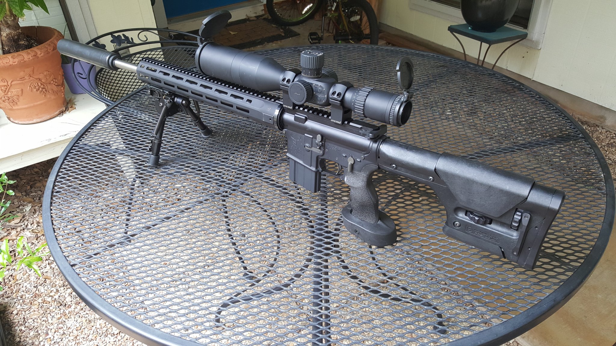

I run a 20" custom SS 5r bbl and Wilson combat rifle-length gas system, suppressed and an H3 bufer + rifle-length buffer spring, and the damned thing is amazing. I've got a video of my friend shooting it at 500 yards in rapid strings of two or three, and it's like:
'pffttscheeeewwwww... pffttscheeeewwwww............... clink clink...' on steel.
Hardly any recoil and totally addictive.

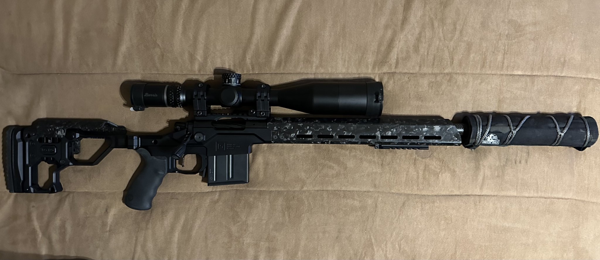

That being said, I'm looking to build a 6 max rig ASAP.
