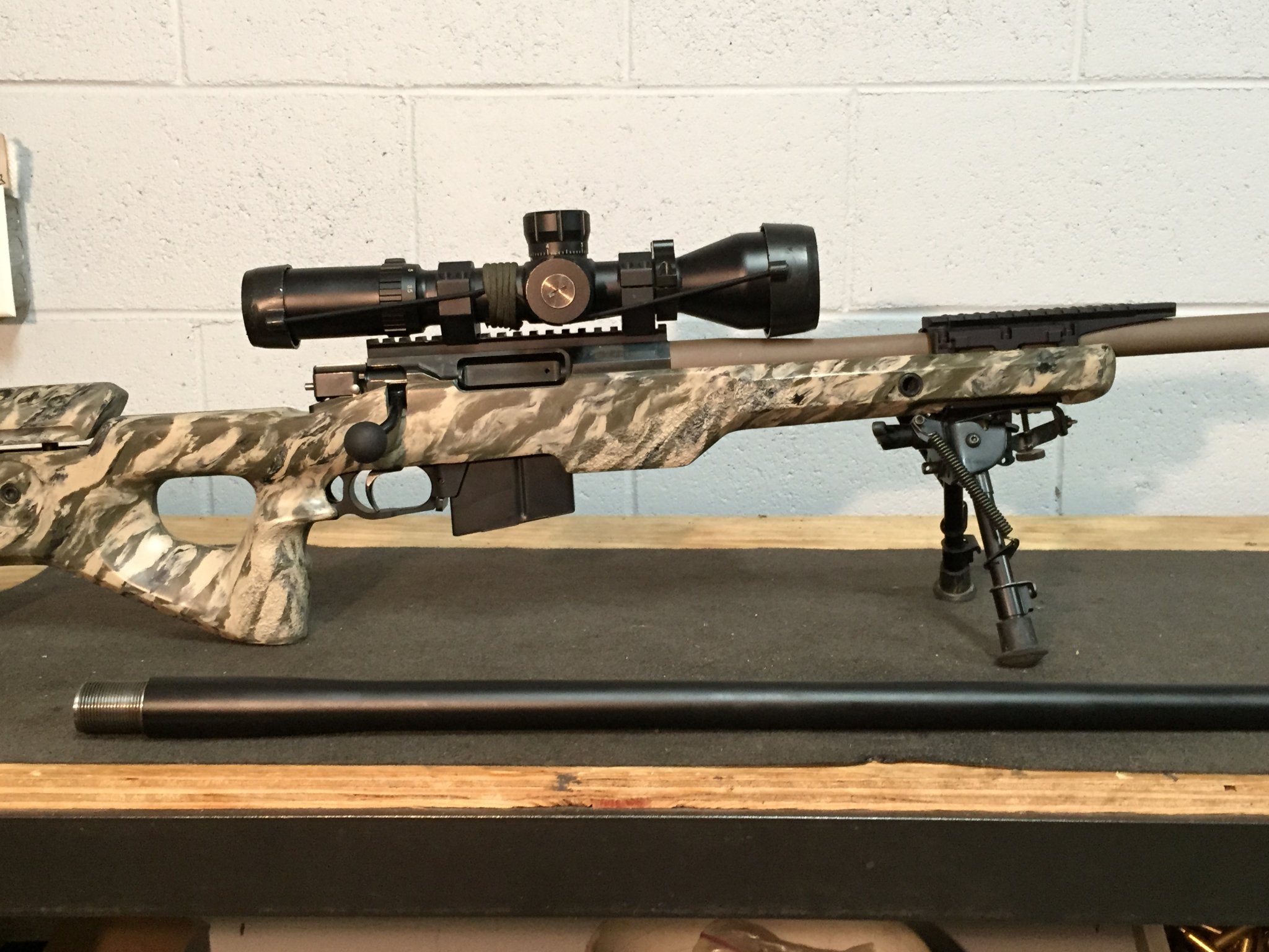

I have a pair of 6mm Creedmoors. The bolt gun is old school cool, a Badger M2013 action in a Sentinel stock with a 28” Bartlein barrel. The gas gun is a Mega Maten, JP SCS, JP lightweight carrier with LMT bolt and a 23”ish Bartlein with rifle +2” gas system- the barrel was a takeoff from the bolt gun when I switched them both from 6SLR to 6CM.
Both were chambered by me with the same reamer. Accuracy is almost identical between them, they’re both scary accurate. The bolt gun is easier to shoot well, but the gas gun is more fun.

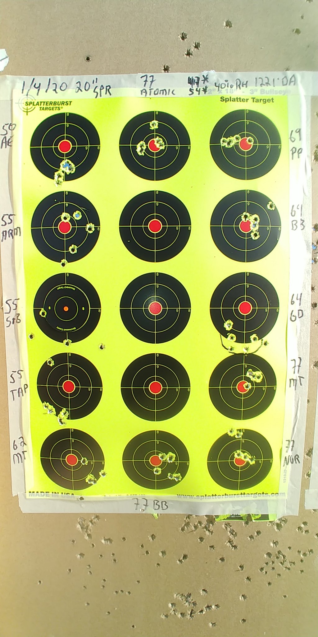

As always you gotta find what your rifle likes. This is a test I did with a 20" AR I built for PRS style comps. Ballistic Advantage barrel, Timmney trigger, Superlative Arms block, and APA brake, nothing else special. It shoots dimes with the right ammo. BTW, most of the best groups came from .223 ammo, while the barrel is chambered in 5.56...make that of it what you will. Also note that the 50g AE grey tip varmint ammo did great, regardless of the 1:7 barrel.
Do your own testing.
And I've got a 24" target crowned Les Baer that will do even better than that, approaching 1/2 MOA.
Everything is better now. Better bullets, better powders, machining, optics, tolerances, it's a golden age.
There's no dimensional differences in 223 /556 ammo, assuming a 2.250" mag length max OAL constraint.
