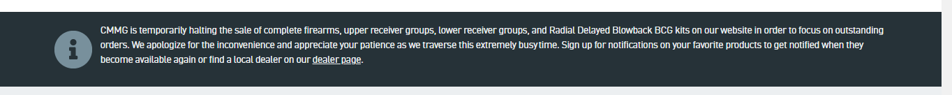

Been wanting to buy a CMMG upper for about 8 months now. They are not available. At close to $600 each, I can't believe they aren't cranking them out. Probably a huge profit margin item for them. Have my suppressor at the FFL now. With eforms, I should be able to pick it up in 3-4 months. But I will not have a AR-22 to shoot with it.
This is what CMMG says...not selling, complete rifles, upper receivers, lowers, etc.

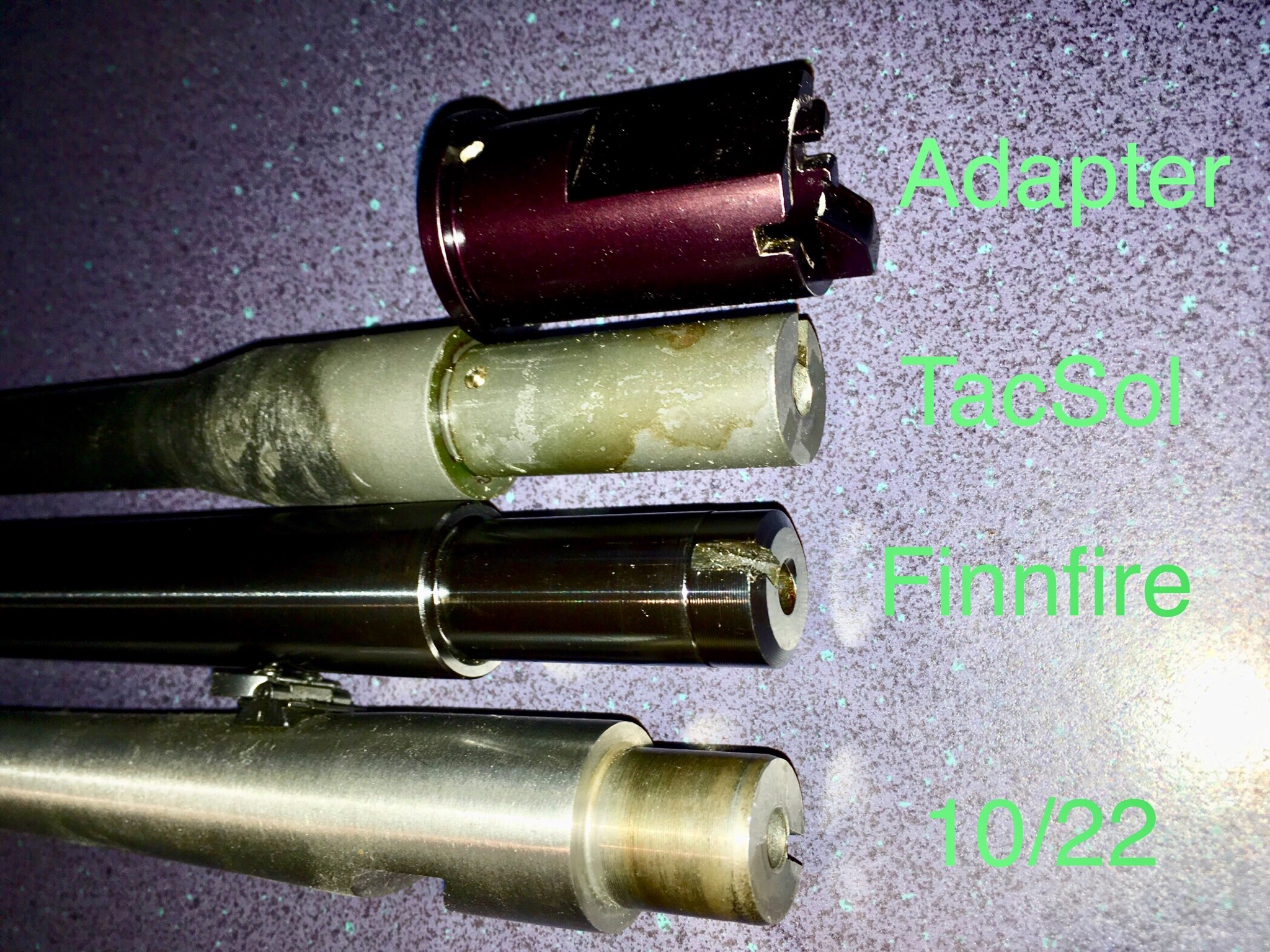

I have two Tac-Sol uppers. One with the lightweight aluminum barrel with the steel (or sst) liner and one of the M4 profile steel barrels. I've never shot either of them for dead on accuracy but they do feed everything I've put in them. I disassembled the lightweight barrel once. The barrel has a sleeve over the breech end which accepts the TacSol bolt. It is removable and once removed the barrel doesn't look too different than a 10/22 barrel (w/o the notch of course). If you can get that sleeve off and get some dimensions, I bet a smith could spin a barrel from your blank of choice pretty easy. The sleeve is glued on; I assume with blue loctite and two set screws. I was able to remove it pretty easy.
I feel like it was on this forum where someone was planning to do it and he shared a photo of the barrel sans sleeve (collar). I'll see if I can find the picture. I know I saved it.

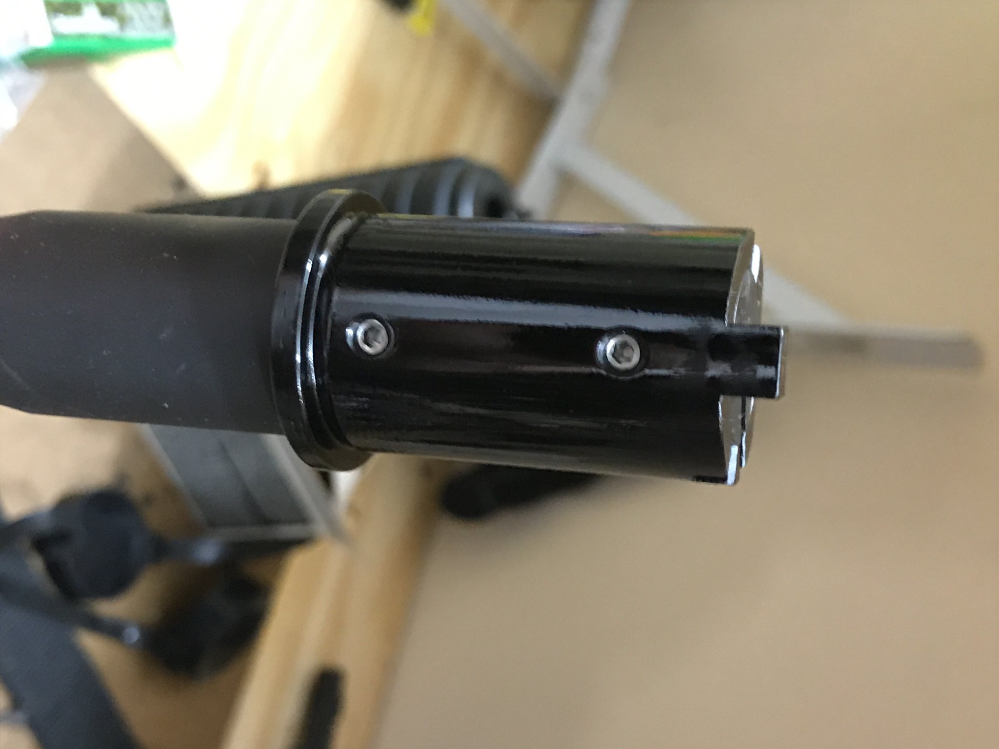

Here are a few pictures of my barrel showing the sleeve. Sadly, I did not take any pictures when I had the sleeve off. I really like the Tac-Sol bolt. In my opinion it's a much improved version of the CMMG bolt. Nearly identical except the Tac-sol and CMMG are "clocked" just slightly different at the ejector relief cut and rail cuts.

Oh hell! That was you that posted that picture. That's funny! I was wondering the other day if you'd had any success doing that. I actually purchased a couple of those Anschutz blanks from Numrich like I mentioned. My brother is capable of doing this project, he's just not able to do "gummit" work on a Government Installation (Edwards AFB).
I did correspond with another fella at Accurateshooter that has turned a couple of his own barrels by making a similar sleeve to use the 1" green mountain blanks. This is just to fit into the receiver. He used the CMMG barrel stub and collar for the chamber.

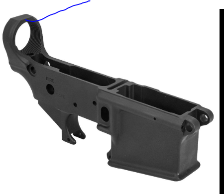

Quick question. I just read that some have report damage to the lower at about 12 o'clock above the buffer when using the dedicated upper. I guess it would be here. Since my lower is precious (can't get another due to where I live), I don't want to damage it in any way. Is there a work around to this? I just came across this today so, have not read too much on it.
Thanks. Checked with borebuddy, they said there could still be some damage to the lower even with the plug.

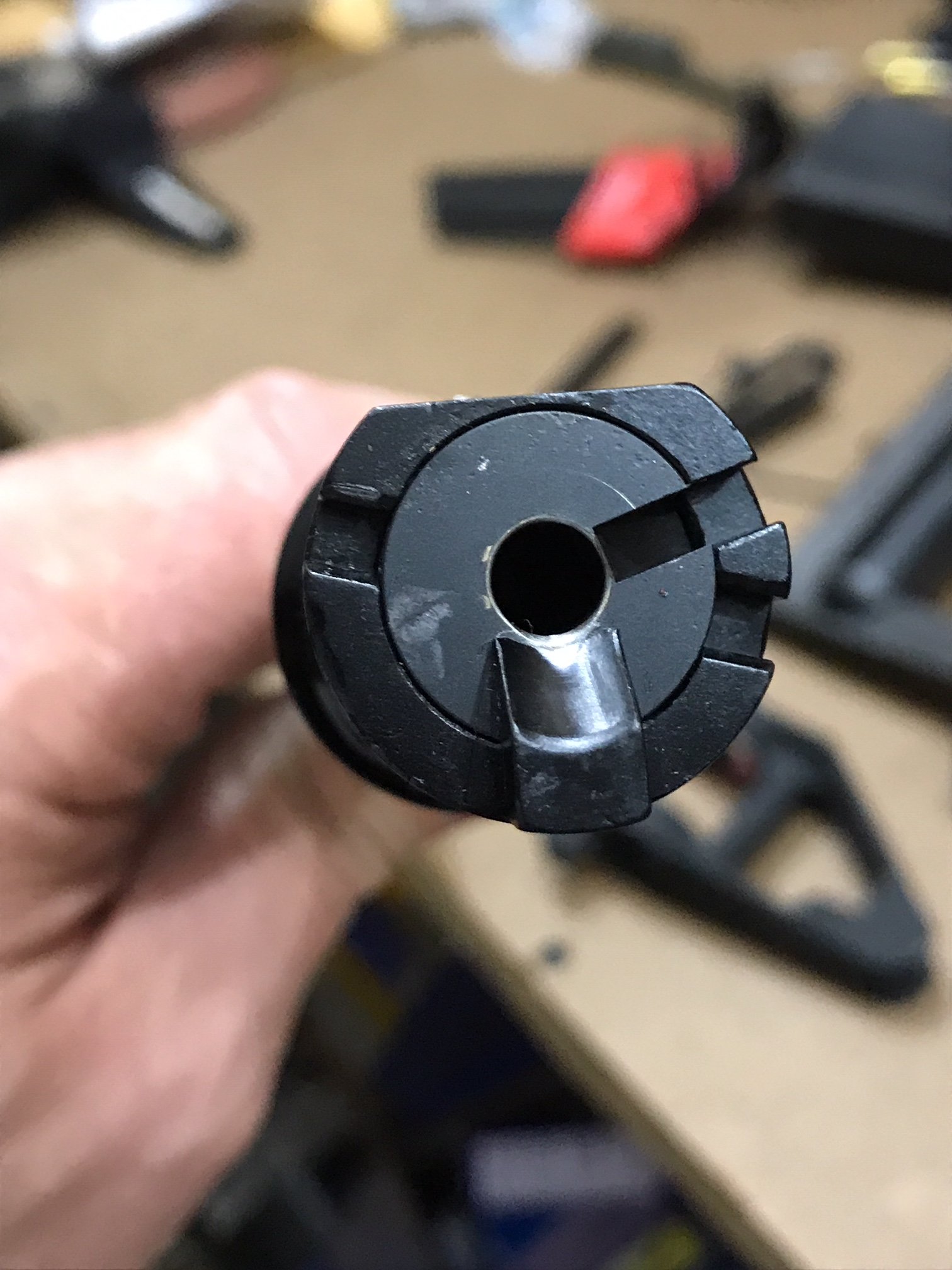

Do yourself a favor and get the cmmg or rtb 22lr charging handle. It virtually eliminates hangups in the charging handle/bolt slot. Rtb also sells an extended latch for 22lr. I love it especially when running a scope.

That was the biggest change to the reliability. I used 2 part epoxy ‘metal filler’ to fill the right parts of the CH groove. Stops 22lr cases from getting stuck up there.

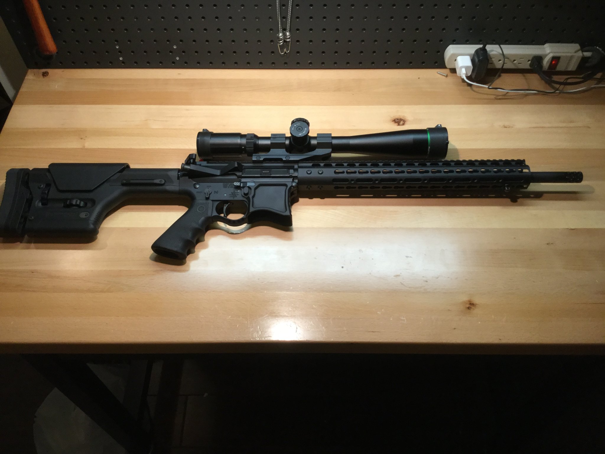

I just received my second Keystone Accuracy 22LR upper with Green Mountain blank. I've been shooting a 12" SBR Keystone upper for years. Very accurate and runs great with CCI SV, Eley Tenex, SK, etc
Received this 18" Keystone 22LR Green Mountain 2 months ago but been busy with baby coming. Here is the 1st time I got it out to the range a month ago... ran flawless and very accurate with no barrel break in, no cleaning between ammo types, etc. No lot testing. Just wanted to get. A bunch of rounds through it
Shot 100% supressed at 50yd... all 10 Shot groups.
The CCI AR Tacrical Target really surprised me. Was more accurate then I suspected.
Nice thing is you can specify contour, length, threads etc from Keystone. These Green Mountain barrels are one of the best 22lr values out there. From my experience they really tighten up at that 200-300yd round mark because GM are not lapped.
I haven't finished measuring this Target as baby came but will shortly. All 10shot groups.
Keystone machines everything right into the barrel. No CMMG chamber insert. You get everything machined in with a match chamber
