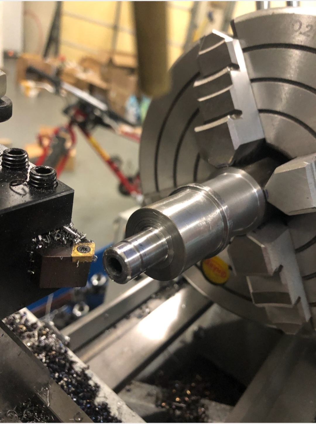

Not a Keystone, Anschutz barrel blank I had made

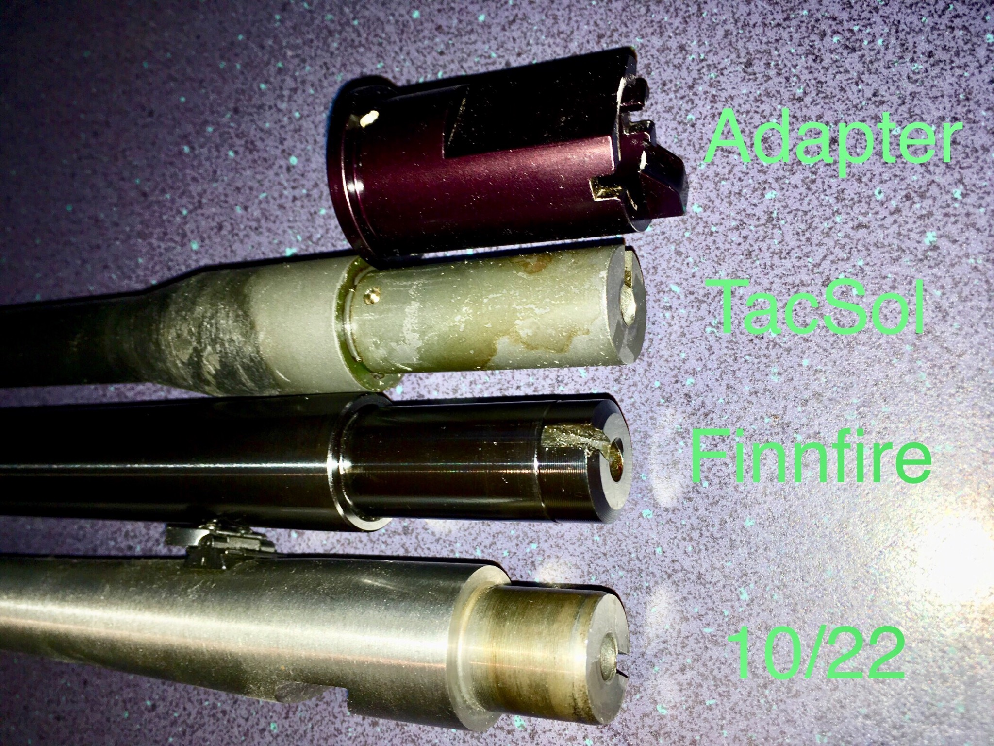

Did you turn it to accept the CMMG bolt/collar? Or did you do something similar to what Keystone does and machine the breech to accept the CMMG bolt w/out the collar. I have a couple of those Anschutz blanks from Numrich Gunparts.
edit: I see you have the Chiappa Upper. Their bolt does not have a collar; very similar to the Tactical Solutions. You did machine the breech face then? Or do they have their own adapter/collar. I know my Tactical Solutions aluminum lightweight barrel has a removable collar.

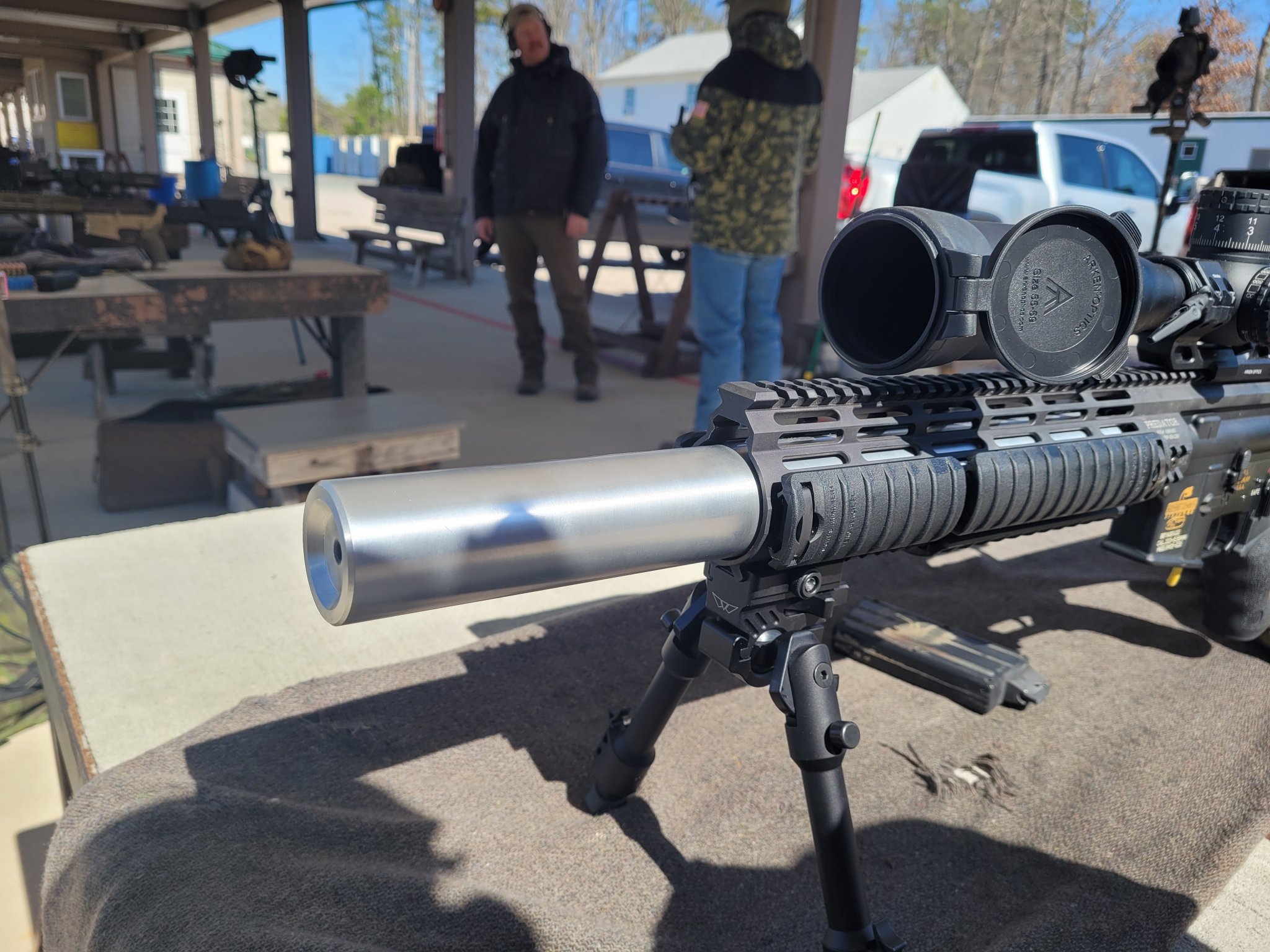

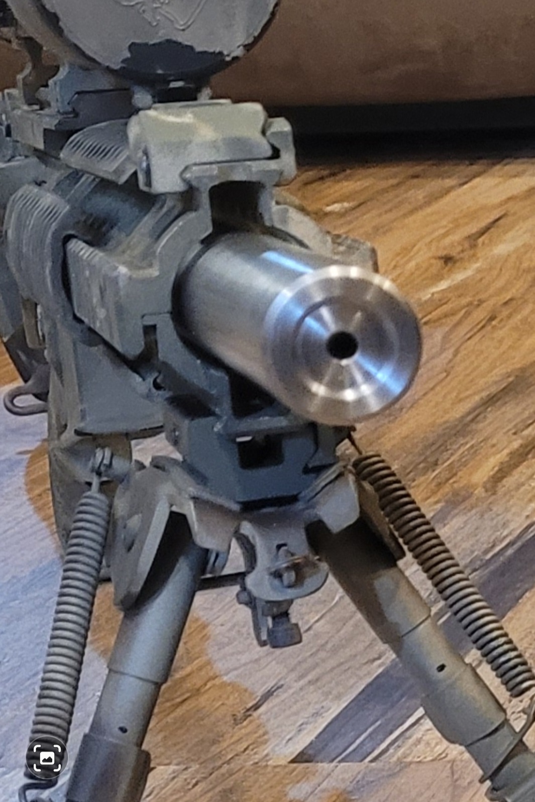

Barrel is a true 1.25" diameter
WOW! I gotta admit I’m surprised the stack of alloy parts could hold up that weight without deforming and screwing your bore to scope alignment! I was thinking of going a lot lighter, but now you got me pondering…..

Running a 24" match rifle profile (1" under the handguard and .850" gas block forward) is pretty common with AR setups. I would think that the way Exscooze has his set up being shorter would be even less stressful. I like it.

That's the exact blank I bought.
Machined it to accept the cmmg collar the other one I used a reciever extension like Tac sol use to use
That is cool! I actually sent one blank to Keystone Accuracy. I'm anxiously awaiting that one to show up. He's machining it to accept the CMMG bolt sans collar. I have another one of his that is an 18" Green Mountain barrel and it shoots great. The Anschutz blank is going to be 12" with a straight 0.750" profile threaded.

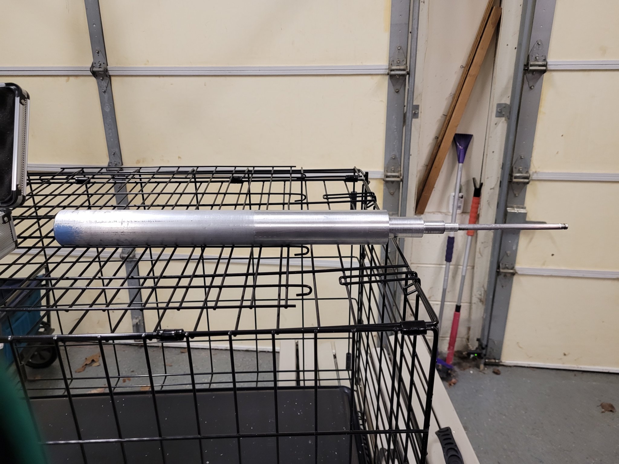

Latest build ,1-3/4"barrel for cmmg operating system.Groups are all ten shots @50 yds.
Holy Mackerel that thing's a pig! You machined that one to take the CMMG collar correct? What blank is that? On another note, I was able to procure a couple of those sleeves from Chiappa. I have a tactical solutions upper and the bolt face of the TS bolt lines up pretty dang well to the Chiappa barrel sleeve/adapter. I think to confirm further, I'll disassemble the TS barrel and put the Chiappa sleeve on it to function check. The end game for me is to utilize the Anschutz blank I have with the Tactical Solutions bolt/upper assembly. Maybe you and I can work something out.

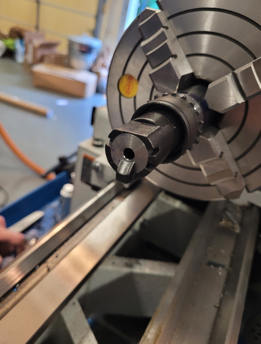

South bend 30" lathe ,12" 8mm drill bit, actually had to drill the round stock in two 10" pieces and thread together, between the drill length and round stock we didn't have enough throw on the lathe . picture is the first half with liner installed
