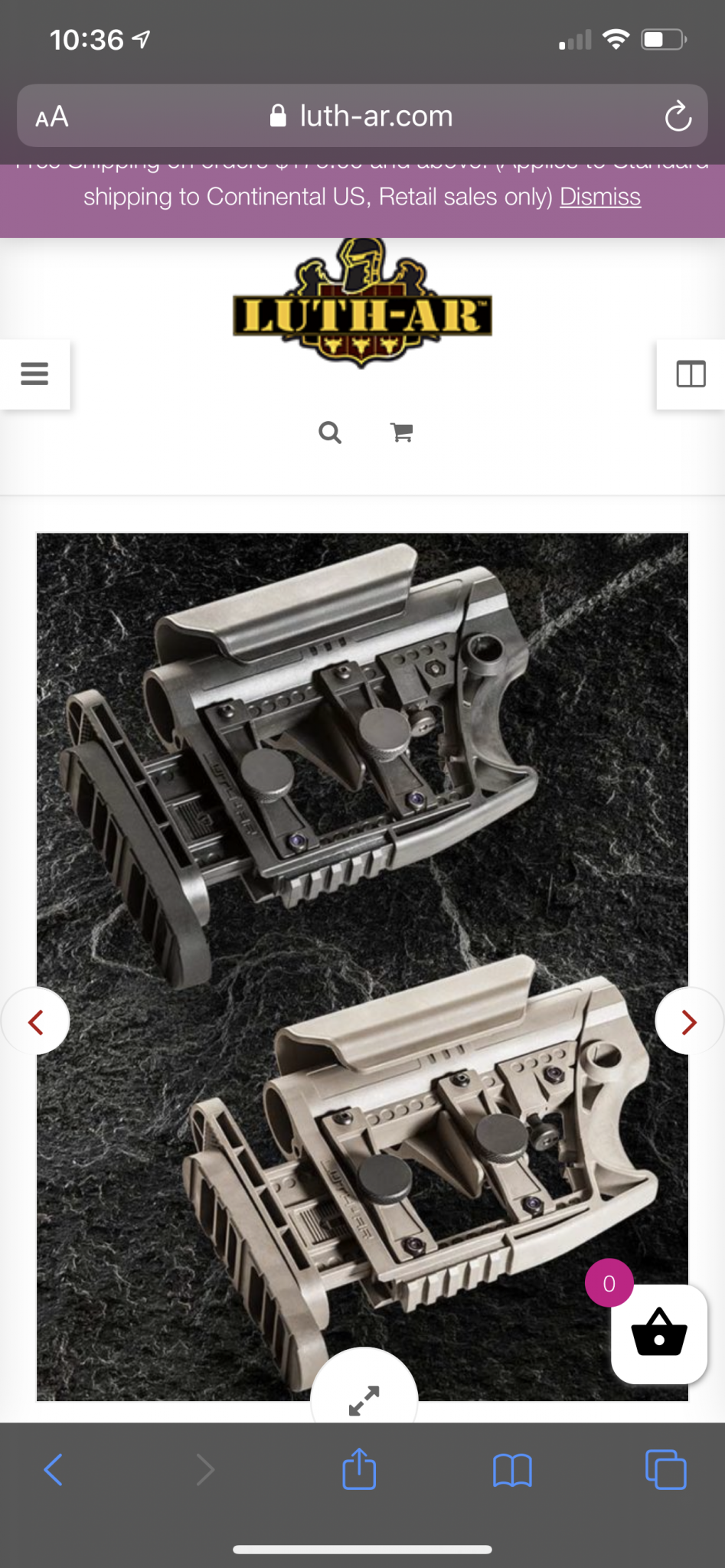

I wholeheartedly agree with the Luth-AR MBA-3. I just put one on my AR-10 (PWS MK220) because I switched to a magnified optic and needed a cheek riser. The Luth is a great piece of kit.
Reactions: Ravenworks
I have had the best luck with just the standard A2 stock. Doesn't have the cool look but the the length of pull is good and it rides a bag nice.
LuthAr is nice if you get the soft pad or limbsaver for it.

I’ve had Magpul PRS, Luth AR MBA 1 and 3 and the XLR.
XLR nice for weight saving. Very comfortable
MBA 1- I prefer this to my MBA 3. The 3 is adjustable and even with the set screw to tighten against the buffer tube it’s not as solid as the 1. The 1 however is to long of a LOP with a folding adapter if that matters to you
MBA 3- Nice option for a scoped AR. Does have a bit more slop if you intend to keep the collapsing stock option. I would definitely consider it great for a Varmint rig etc but not the best choice of these for a dedicated precision rig
Magpul PRS- I believe mine is the Gen 3. I’ve owned 2 so far and both are excellent. Everything is solid. It is heavier than the previous options if that matters. Doesn’t collapse like the mba 3 (but neither does the mba 1).
My choice for a Precision rig is the Magpul. Followed by the MBA 1 and then MBA 3. The XLR is solid and right there with the Magpul if you want the weight savings etc.
My Luth MBA 3 will be getting replaced with an XLR for this spring on my Ashbury chassis. I just don’t like the bit of slop it has even with the set screw. But I have a folding hinge on that gun and the mba 1 and Magpul are both to long of a LOP with the hinge
Otherwise I ran the Magpul on a Rock River AR10 LAR 8 and 338 Bolt gun. The Luth MBA 1 on the same gun Rock River. MBA 3 on a Precision AR15 and a bolt 260 gun. Run the XLR on a Rem 700 AAC SD. All said and done I’ll own Magpul PRS and 2 XLR

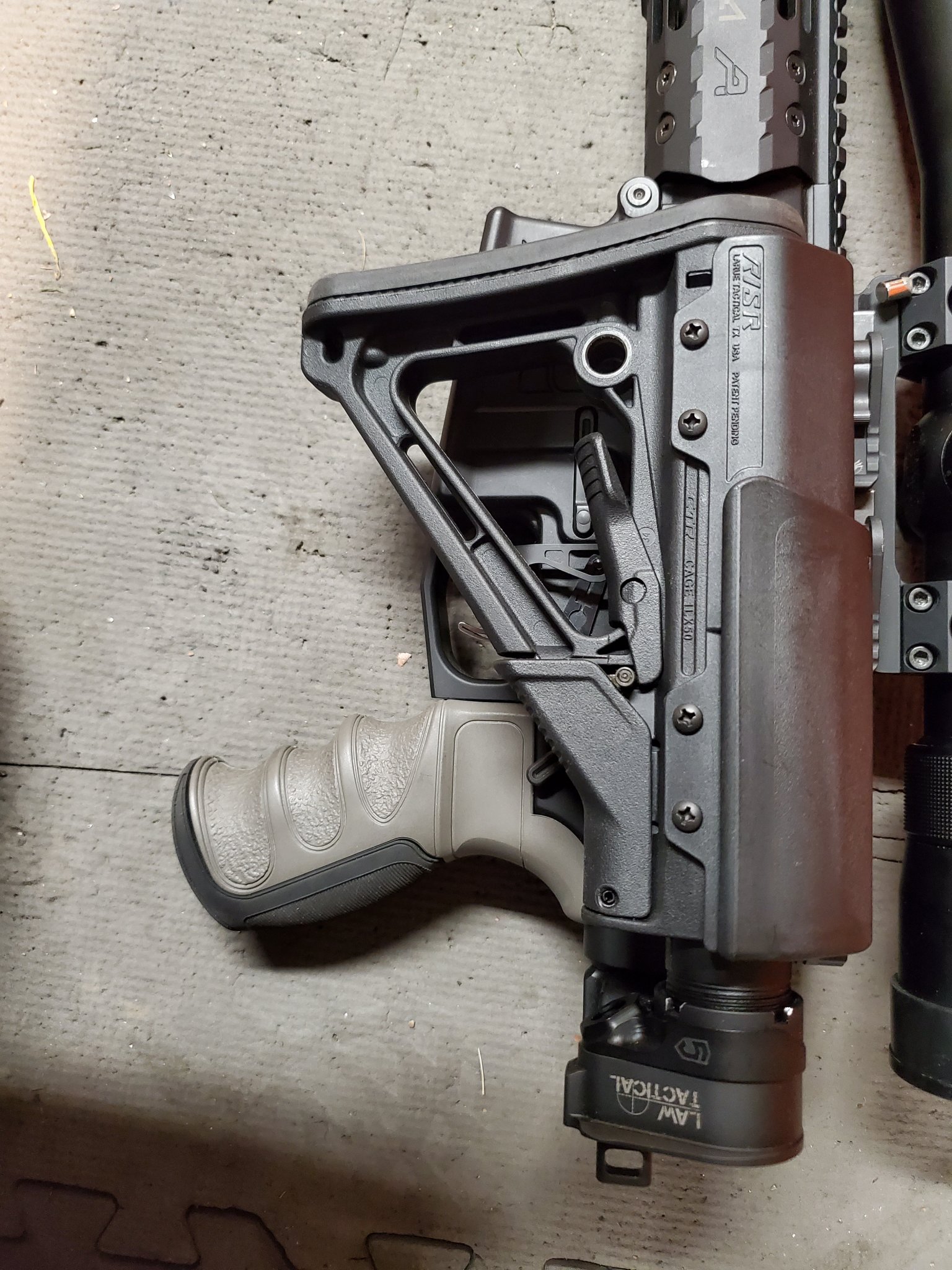

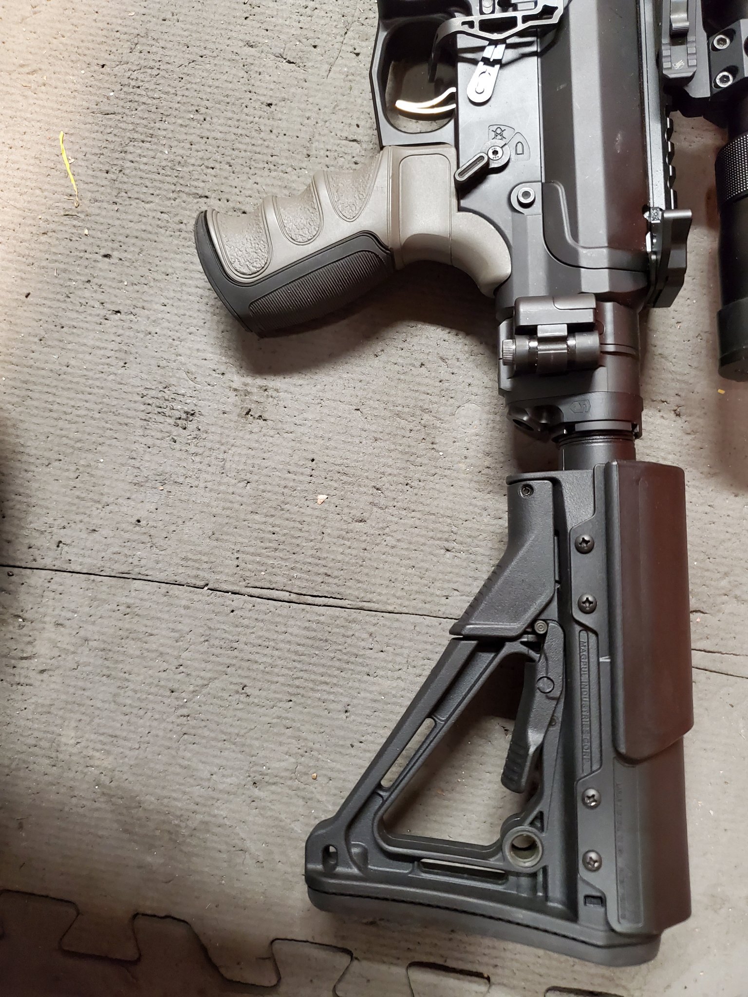

Sure.
The rod in the SCS that the bolt carrier usually slides around can't slide through the solid center of the bolt carrier extension of the Law Tactical folder. I tried, it obviously wouldn't work.
You drilled out the buffer extension.
What does Law Tactical say about that?
Wow that was a lot of vague back and forth posting to determine that the law folder and SCS don’t in fact work together without modification.
Reactions: 2aBaC̶a̶
Lol, its the internet. And when you tell someone you cant do that, it wont work. And they've already done it, and it does indeed work.
No modifications necessary. Simply use a different BCG plug. Literally plug and play.
Well actually it doesn't unless you change out parts.
So quit trying to be a wise ass.
