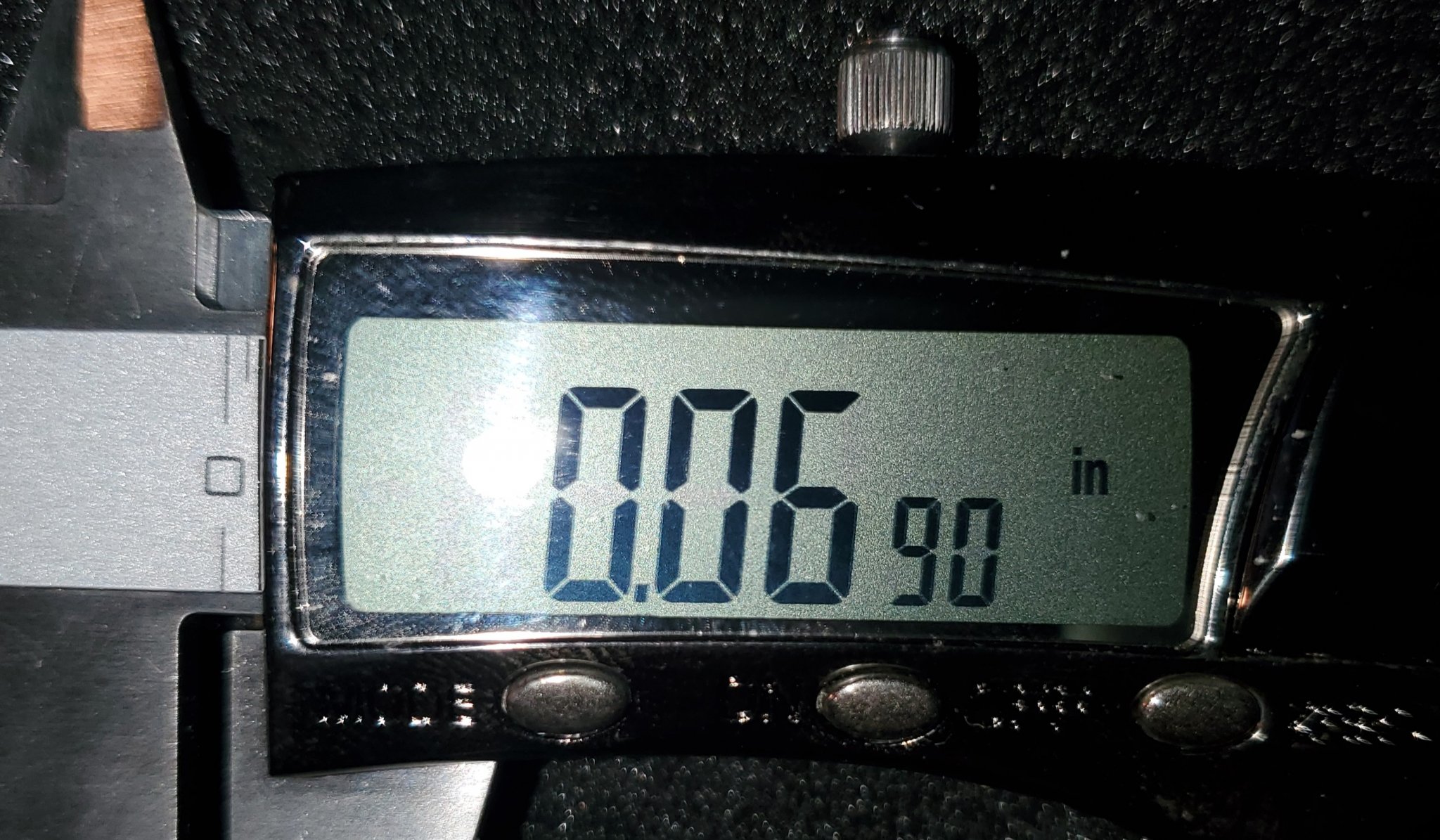

I took my latest out yesterday after drilling this one out from .069 to .085 (PSA 10.5/Carbine) and for the second barrel in a row from different manufacturers, the undergassing issue is fixed. A couple dozen singles with 3 different types of ammo and it locks back solid every time without excessive recoil.
The first was a BA 16/Carbine that came with a port size of .053. Way too small for that barrel. I drilled it out to .065 and it runs like a champ.

Friend, I measured the port on my BA barrel with a set of known accurate digital calipers. It measured 053. Which is drastically too small for a 16 inch carbine length barrel. I drilled it out with a 065 carbide drill bit, which instantly fixed my undergassing issue after trying everything else.
I'm not trying to be difficult for the sake of it, but I promise you my gas Port was too small.
I certainly don't know everything, but I am 58 years old and have been working on stuff my entire adult life, including firearms.

I did measure my port, it's 0.093".
