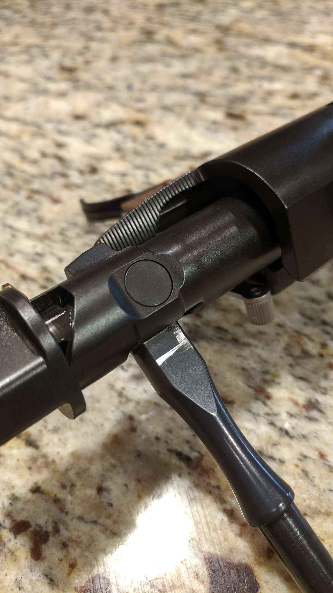

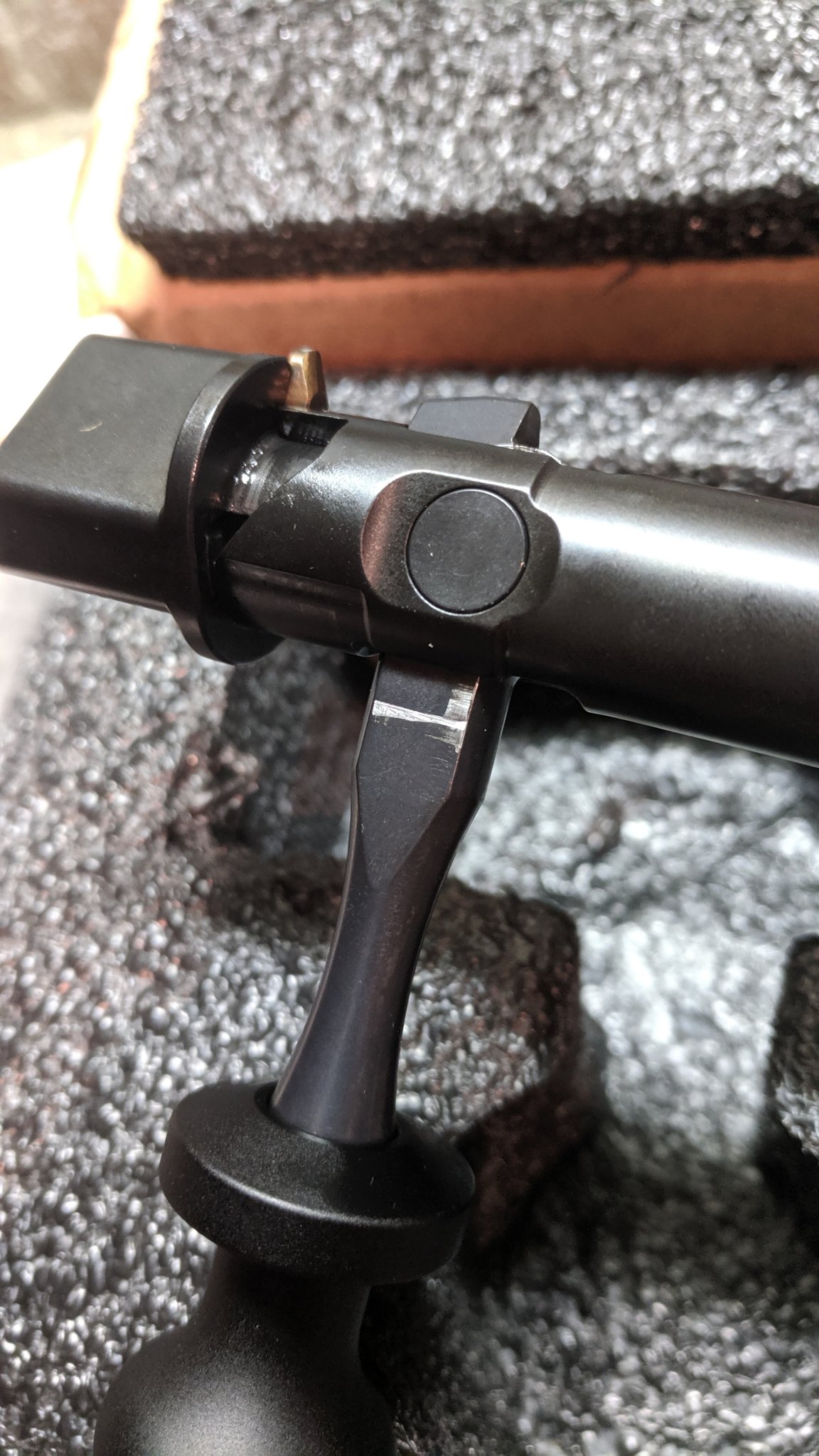

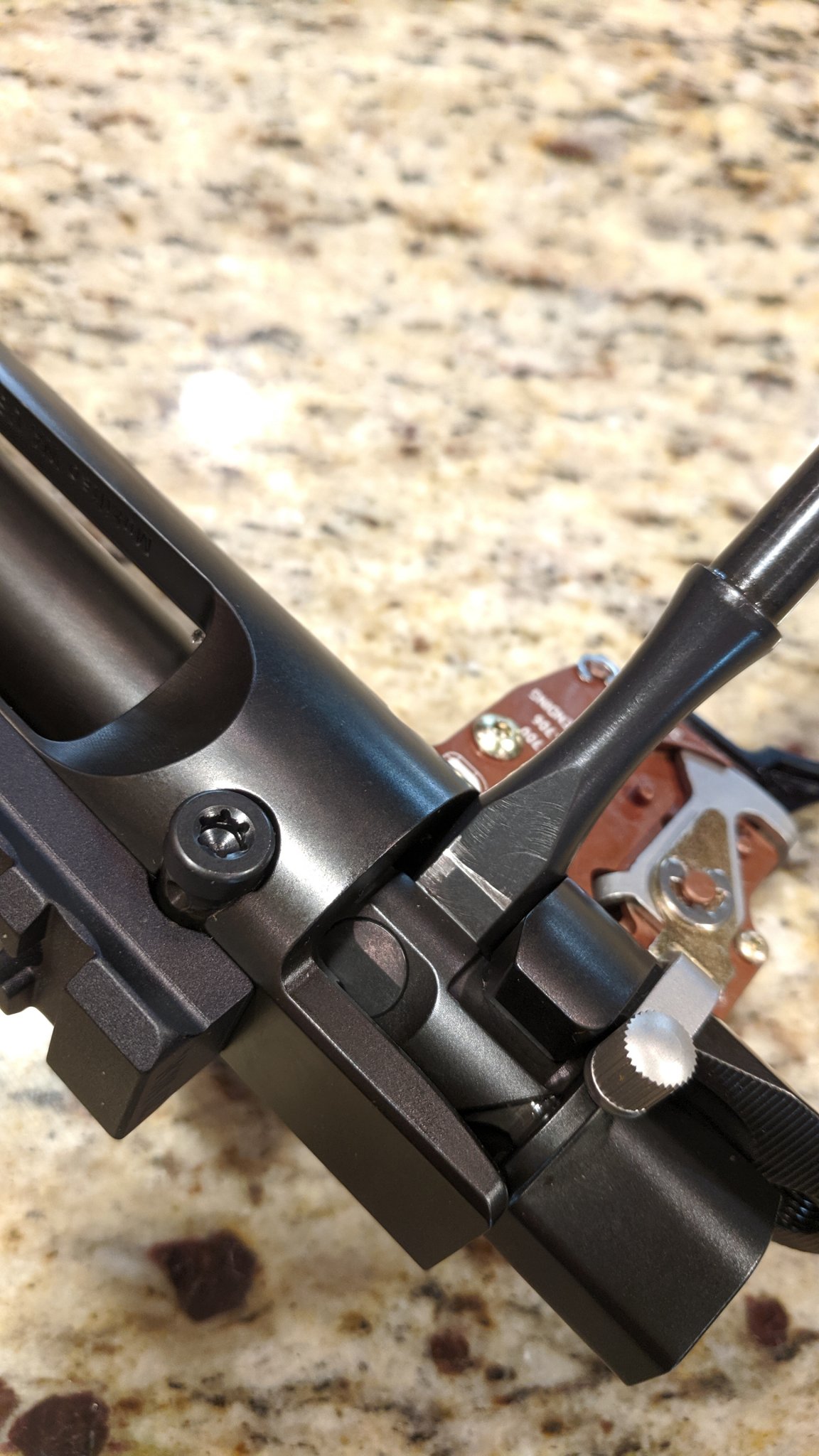

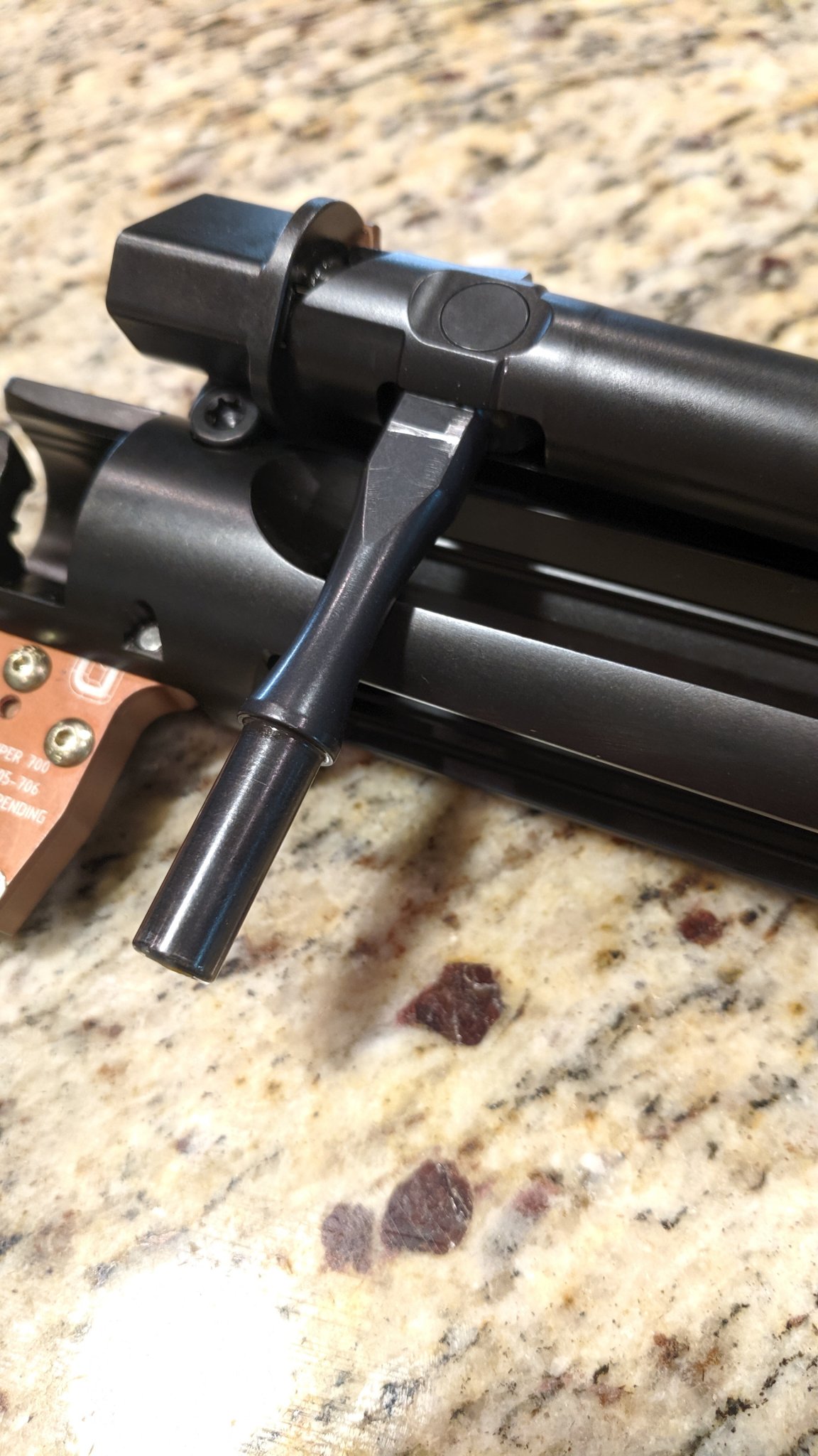

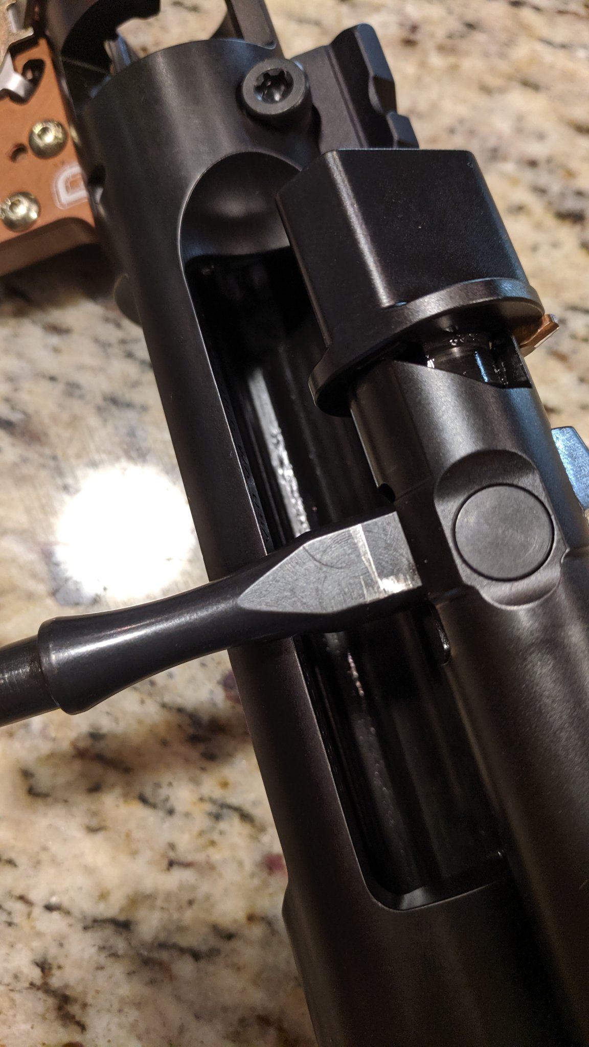

Just got my action back and the bolt handle has substantial wear down to bare metal. I was pretty upset about this as the action was going into a gun being given as a gift. I called ARC and apparently this is the result of running the bolt while testing the trigger. They said this is supposed to be a wear point. I wish they would have treated the handle to help prevent this. It's an awfully expensive action to have bare metal visible with the bolt closed.

Yikes. I actually like my nucleus action now, but it taught me a lot about pre-orders and ARC. Hopefully these things get worked out thanks to you guys and maybe in a year or two everything will be hammered out.
My bolt had some similar marks on it, but I'm not too worried about it. It's going to look like that anyways. I understand if it was for a gift that you would be upset.
