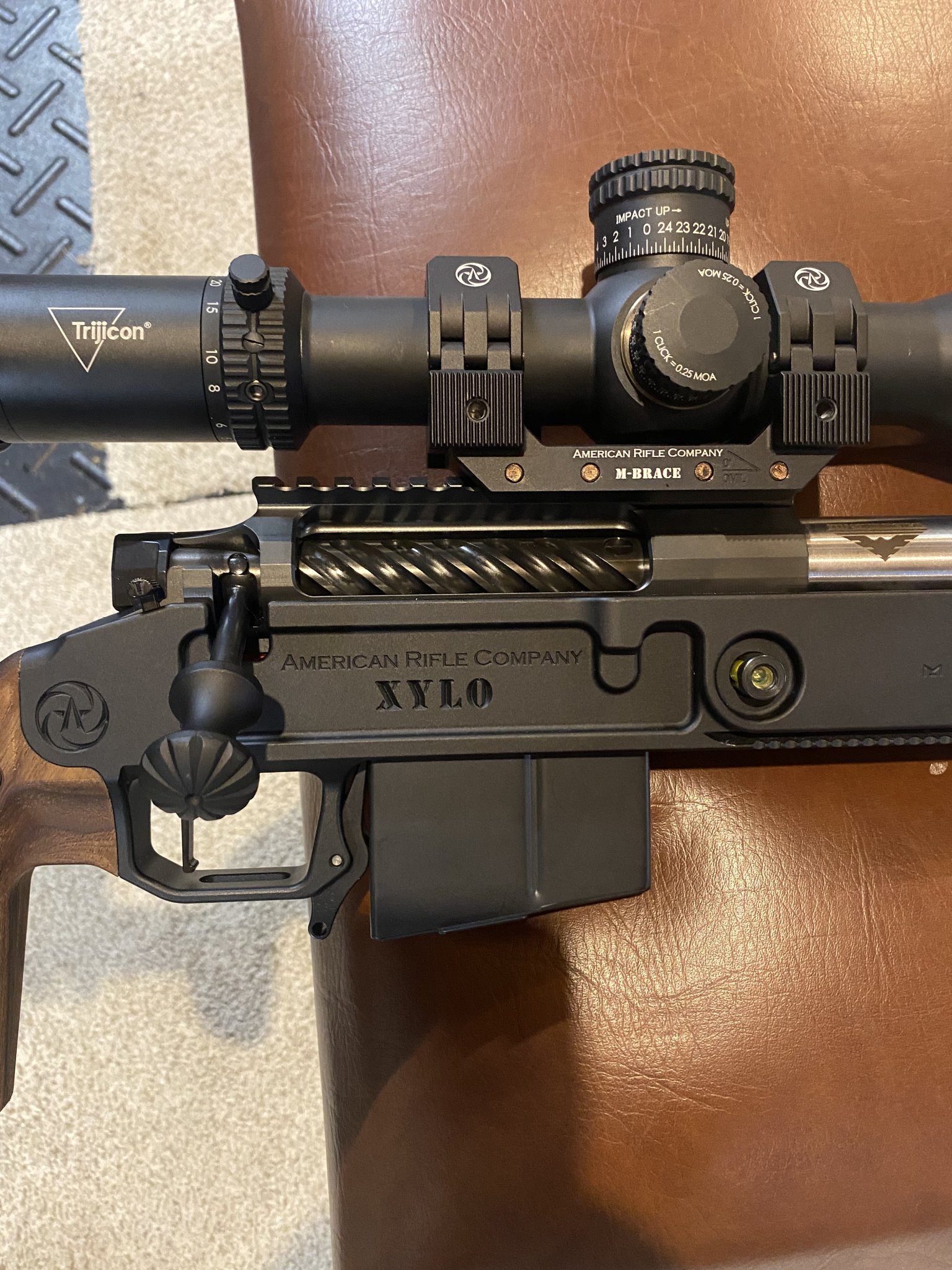

Any issues feeding? I know some posters had issues with the action overhanging the front of the magazine, wonder if its a real issue for someone using factory ammo?
Cut a notch with a mill, just had to do it on a Stiller to run a longer COAL in mags with no binder plate.
Not a big deal at all if needed but my understanding was the long action was cut to run CIP length mags.

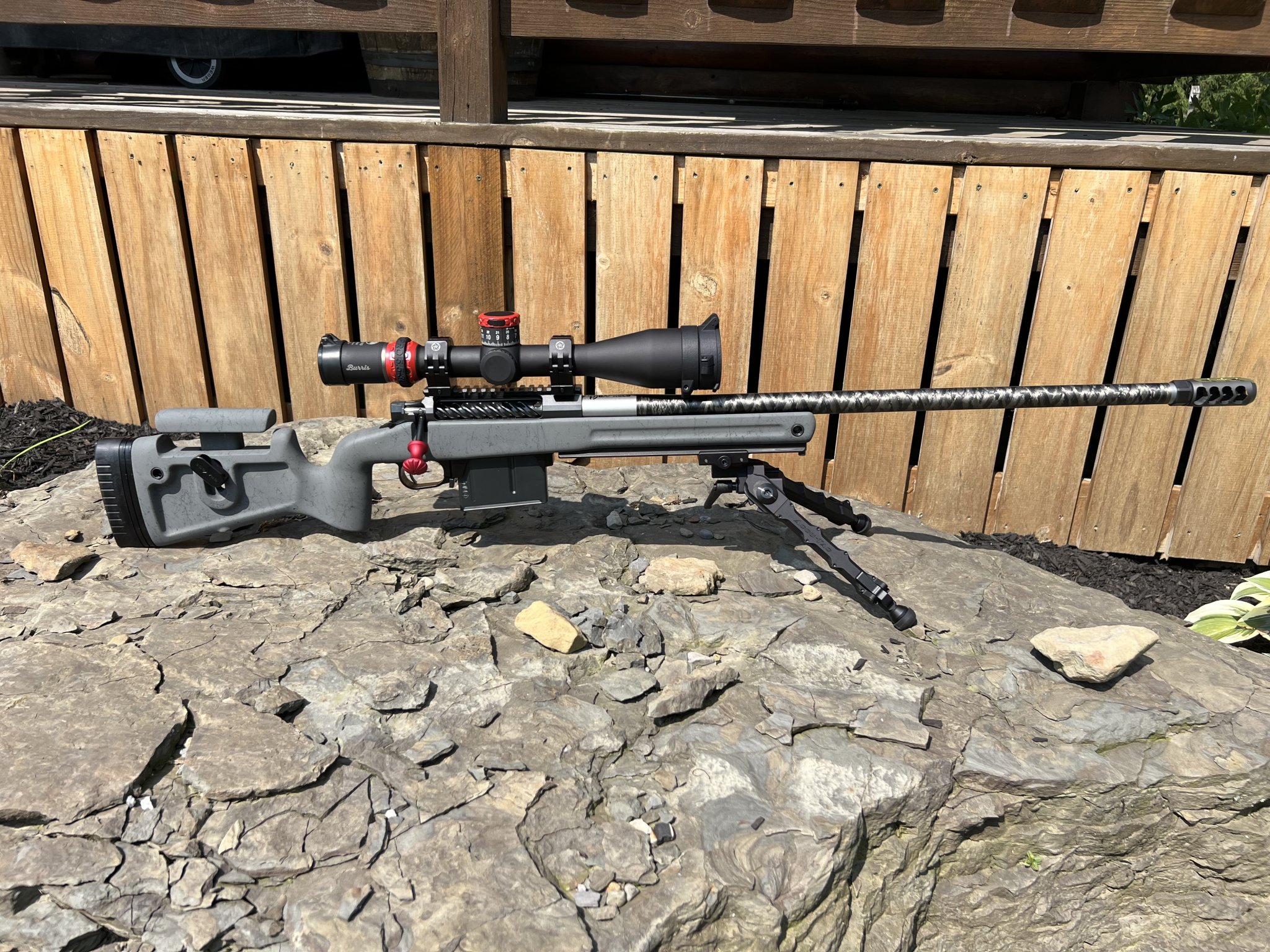

6mm creed
Benchmark Barrel
Benchmark Markhor stock

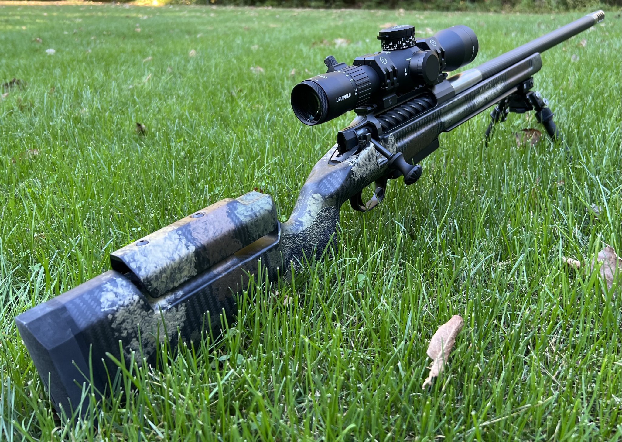

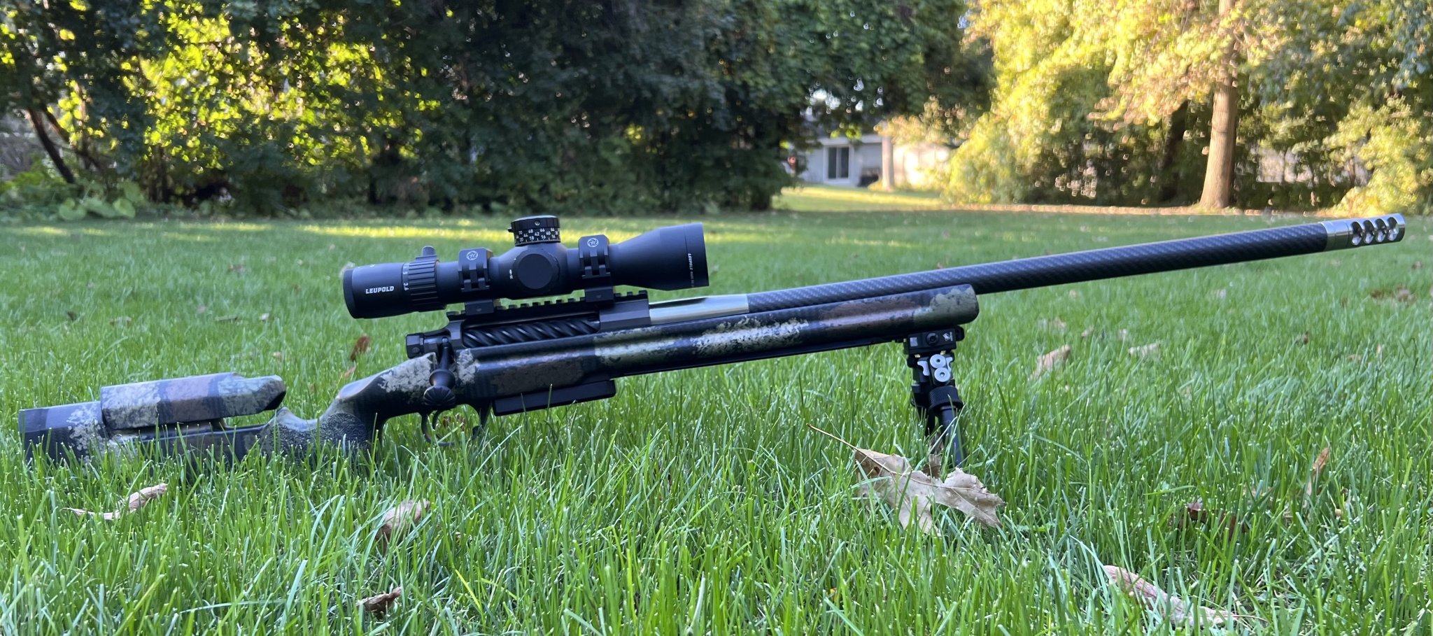

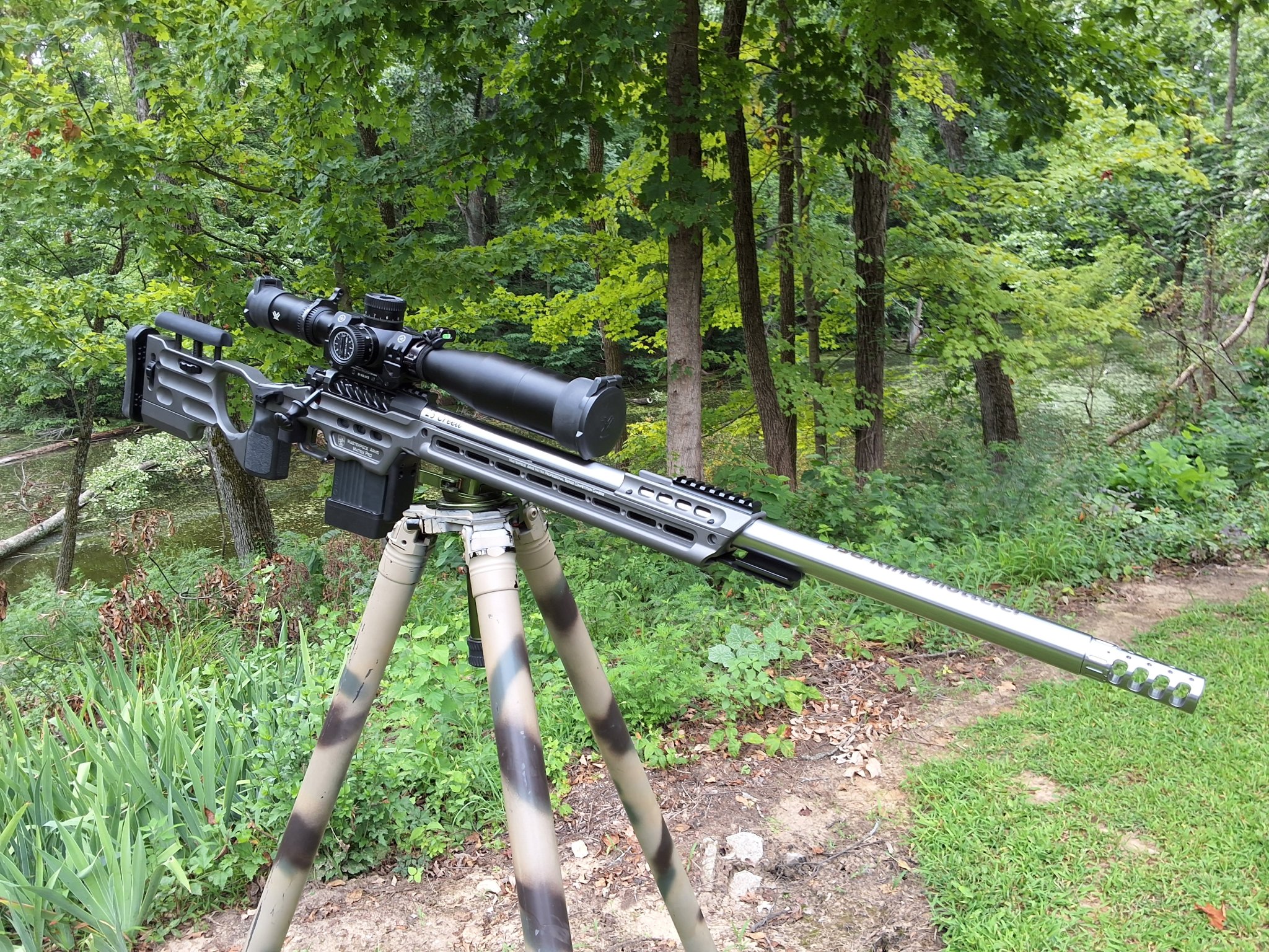

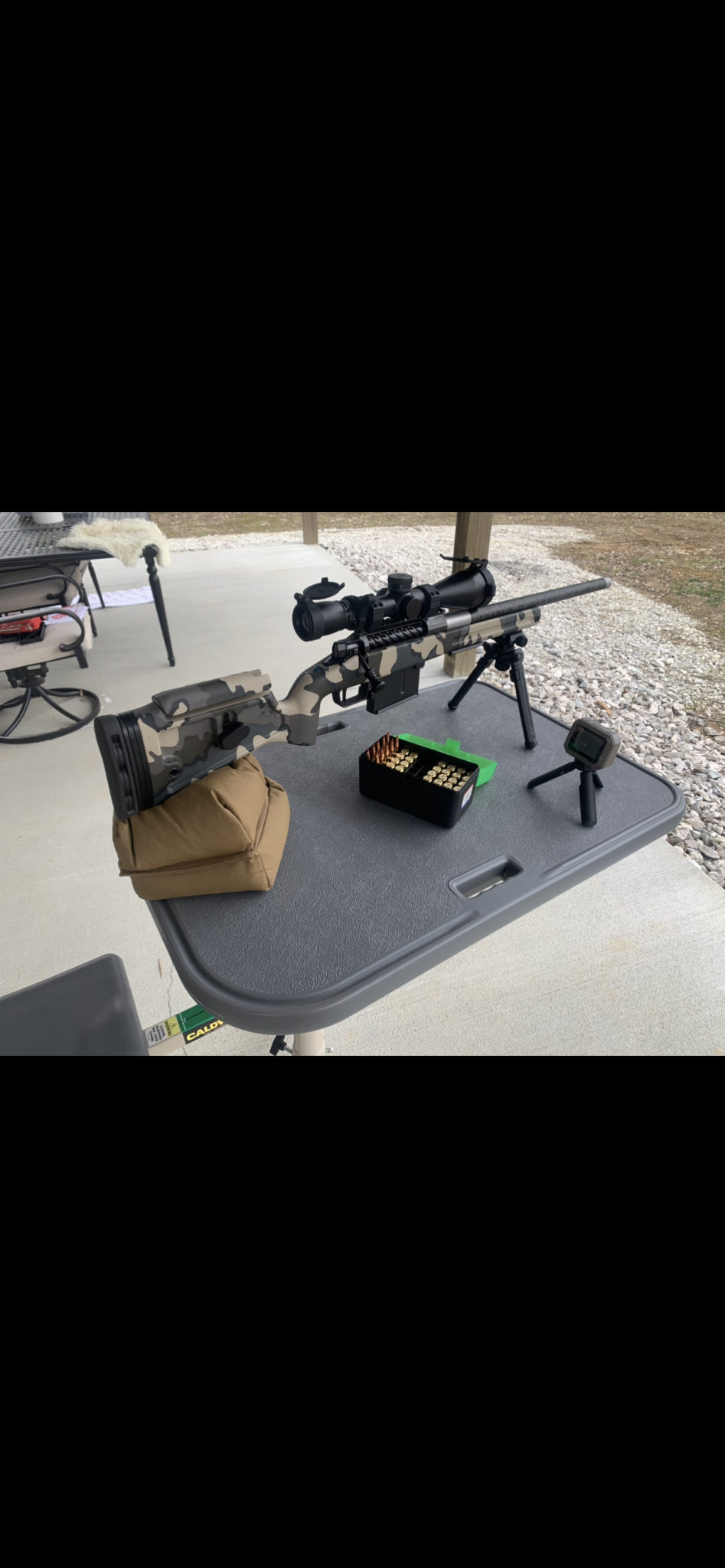

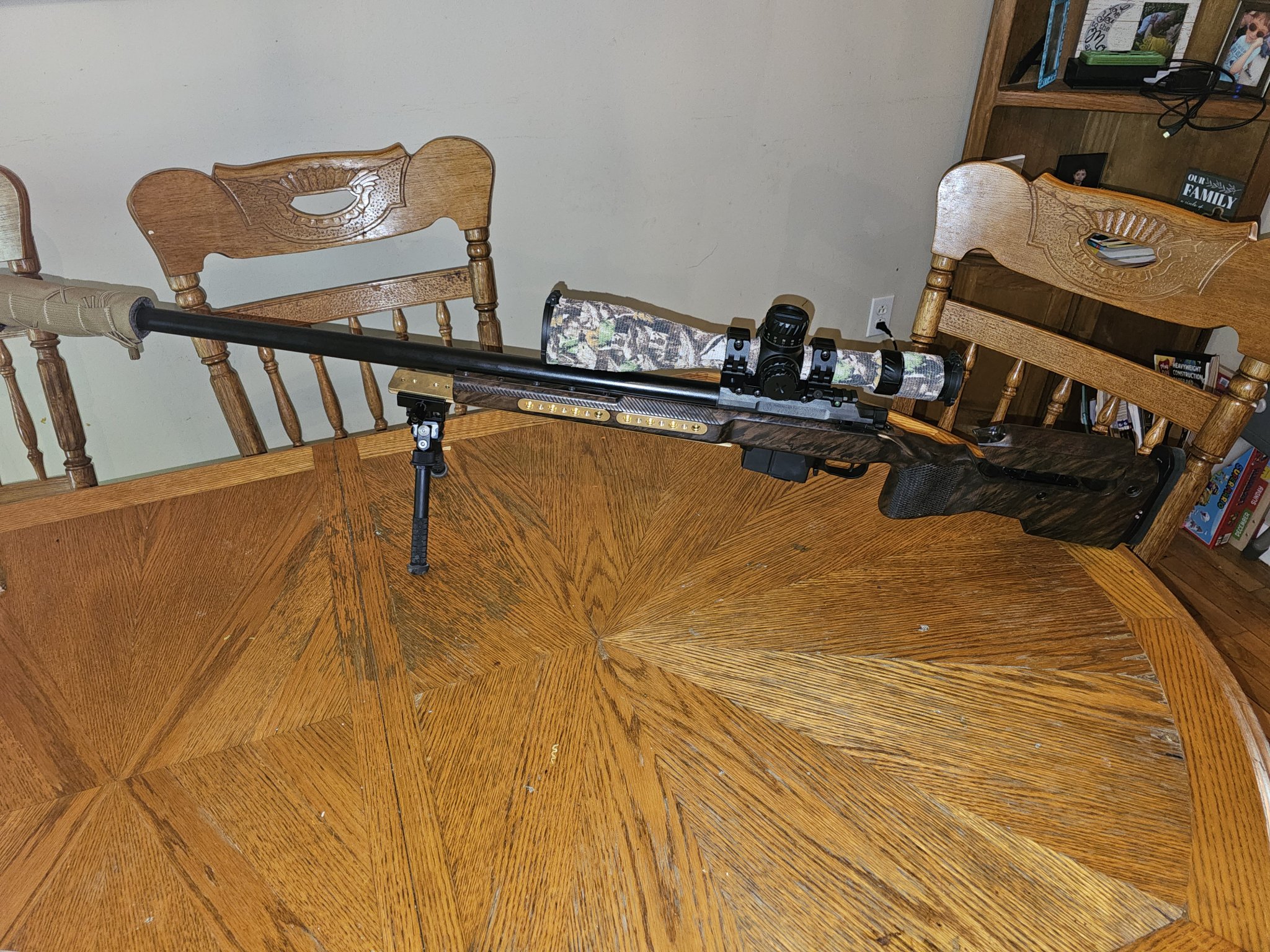

Just finished mine and sent the first rounds last weekend. Still working on loads because it’s hard to find data for my caliber of choice 338 Norma Mag, but thanks to others before me on forums I found a good place to start and work up from.
26” Preferred Barrel, Grayboe Phoenix 2, Hawkins M5, MDT mags and COMP Brake.

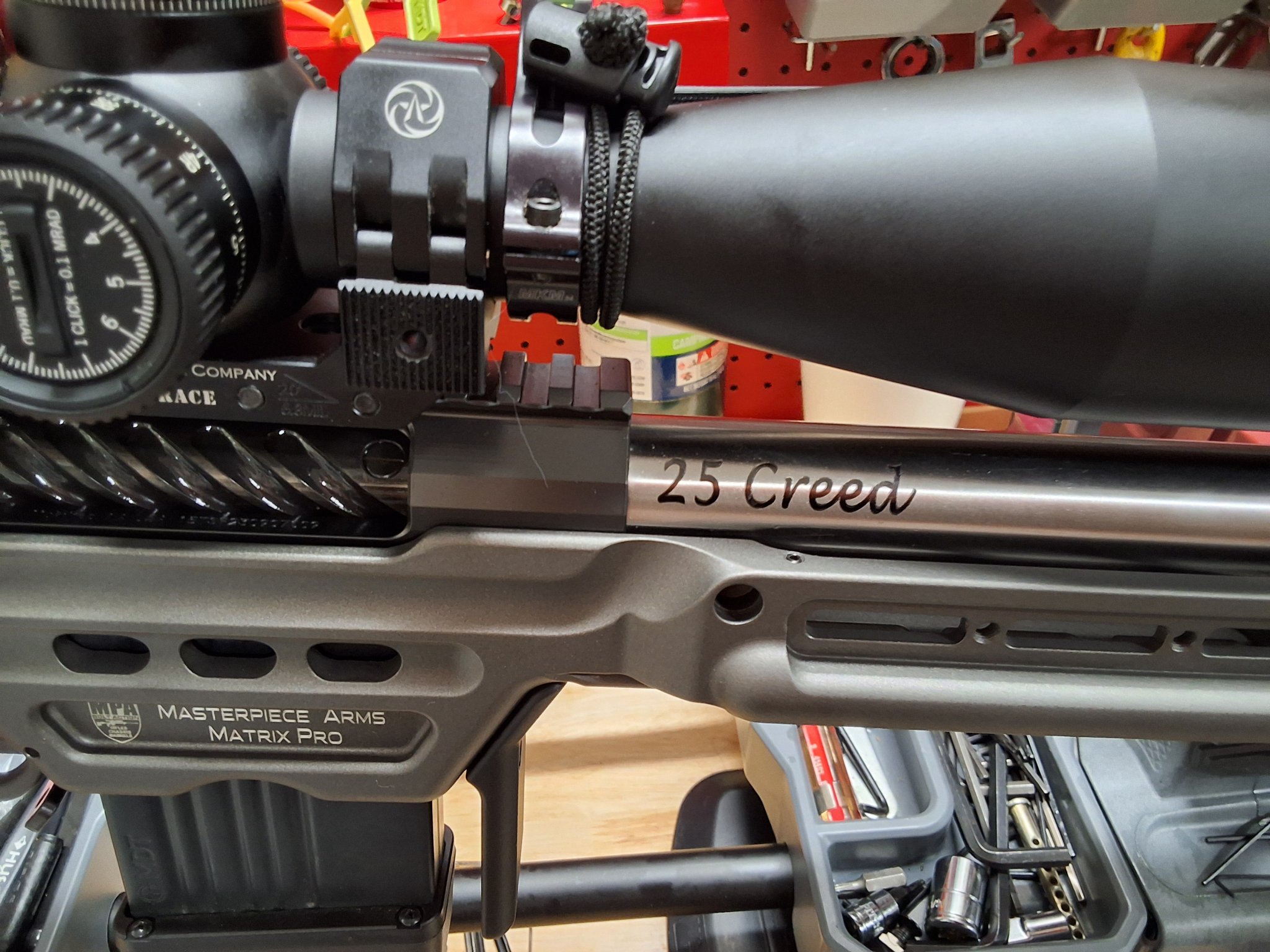

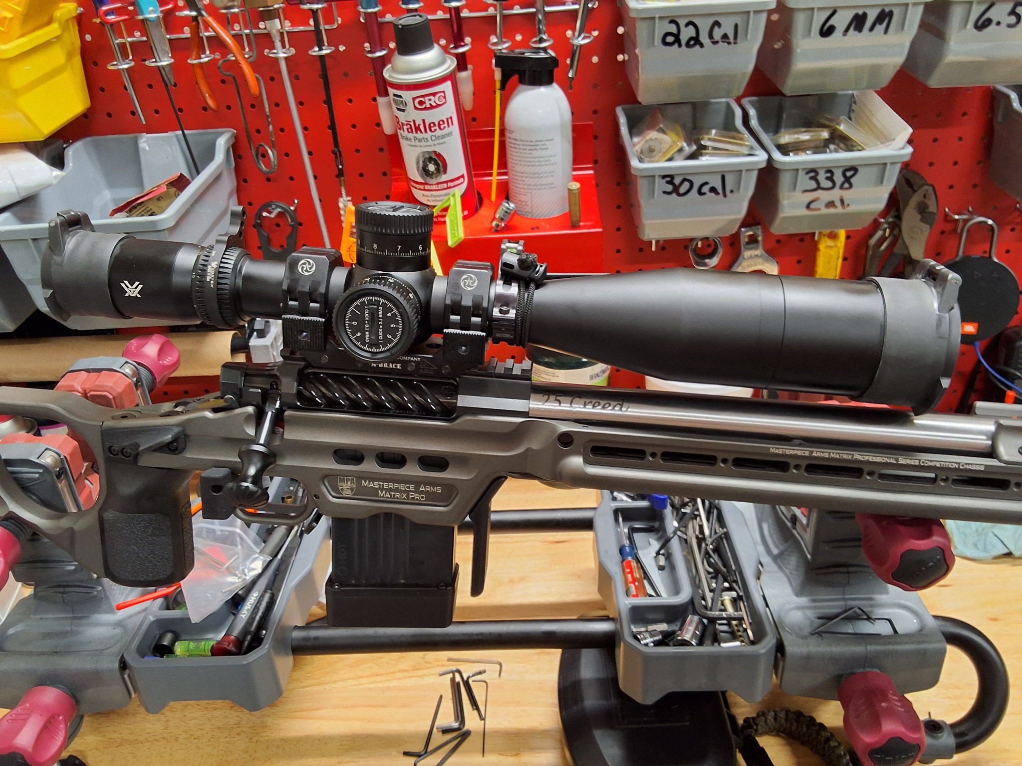

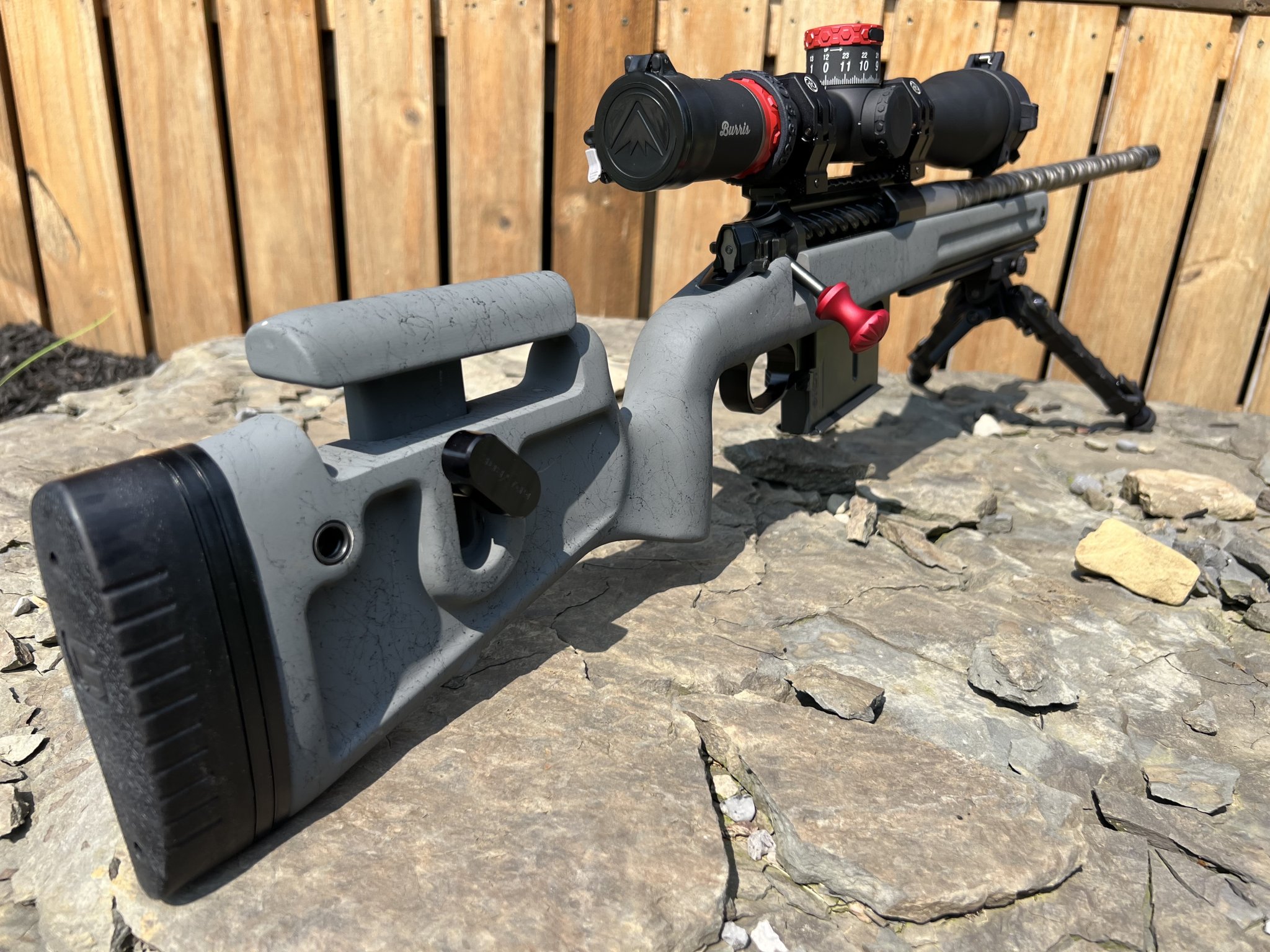

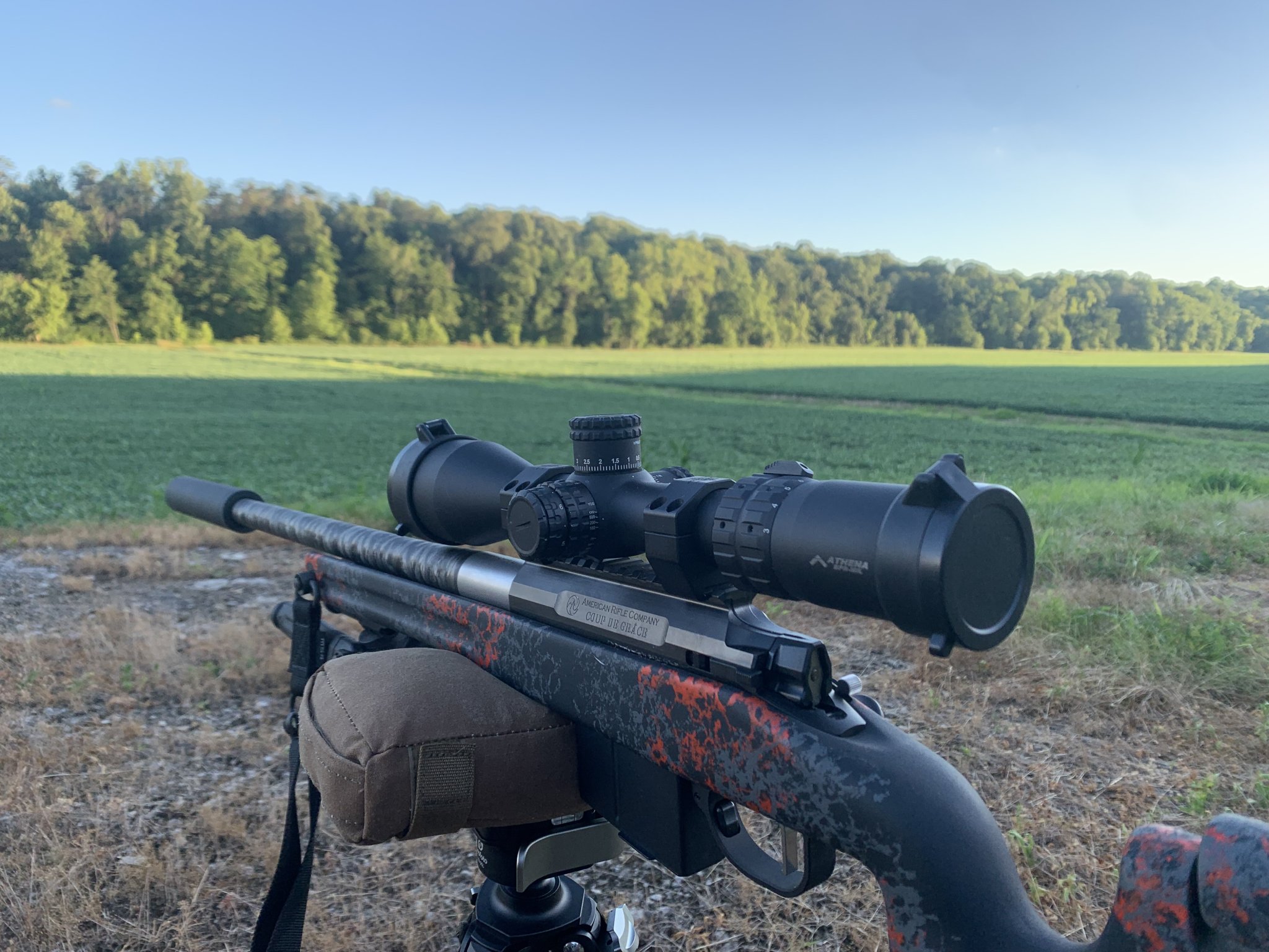

Well, here's my 2nd CDG build, I'm truly all in on these! They have became my favorite action by far over all my others including Stiller, Defiance, and Surgeon.
I also decided to jump into the 25creedmoor pool so here's my new stick.
ARC CDG
Brux 4gr at 28", 1.25" strait barrel
Triggertech Diamond
MPA Matrix Pro
Vortex Razor G3 6x36
ARC Mbrace

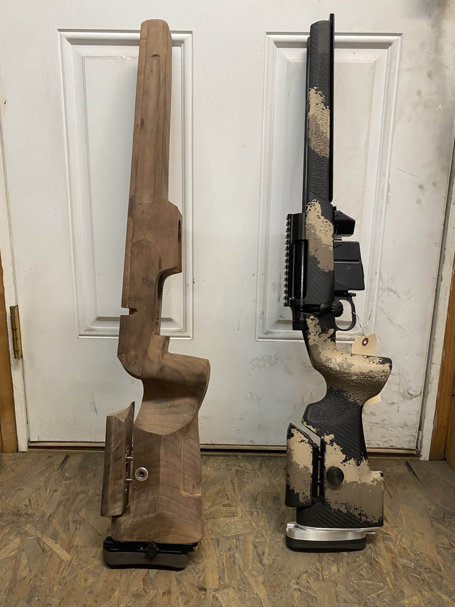

Where’d you get that from and what do you think of it?

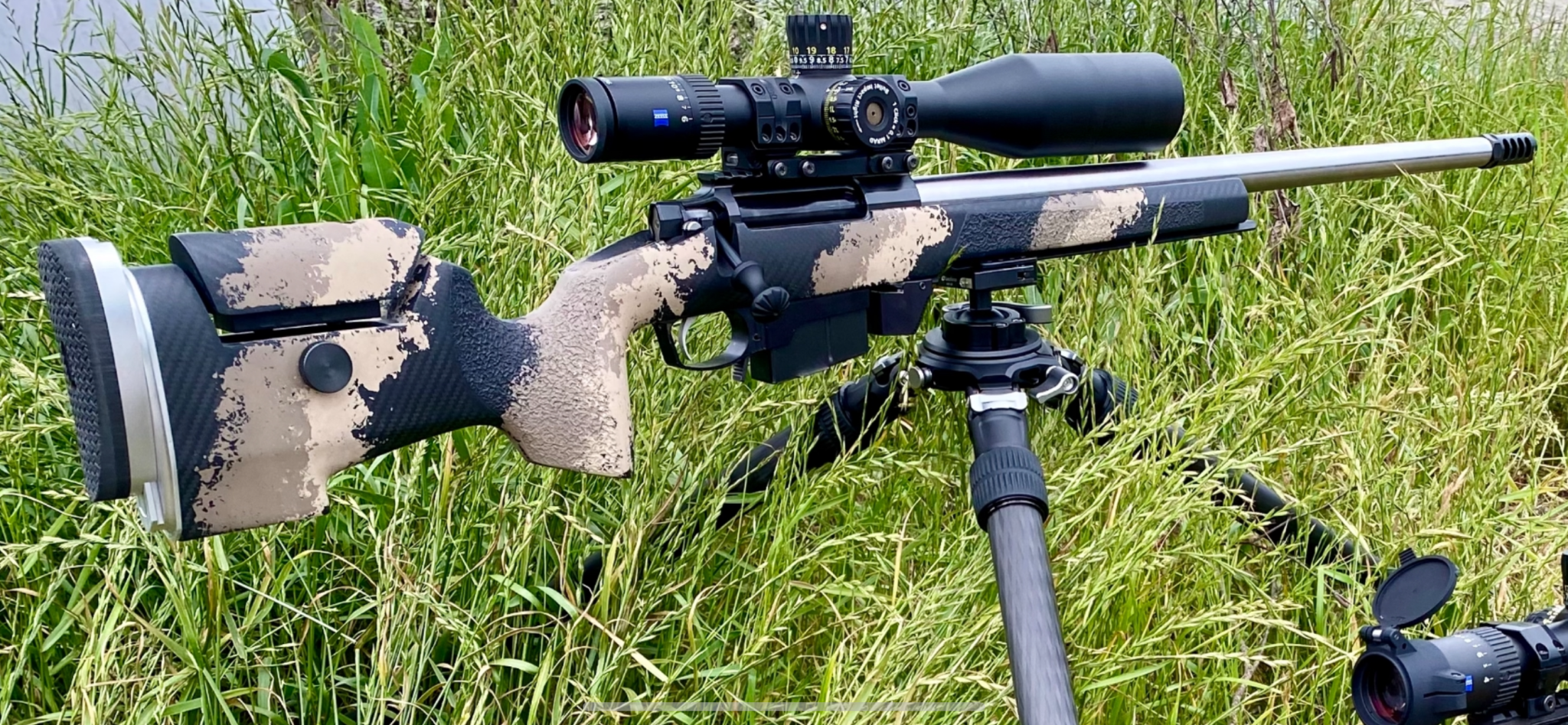

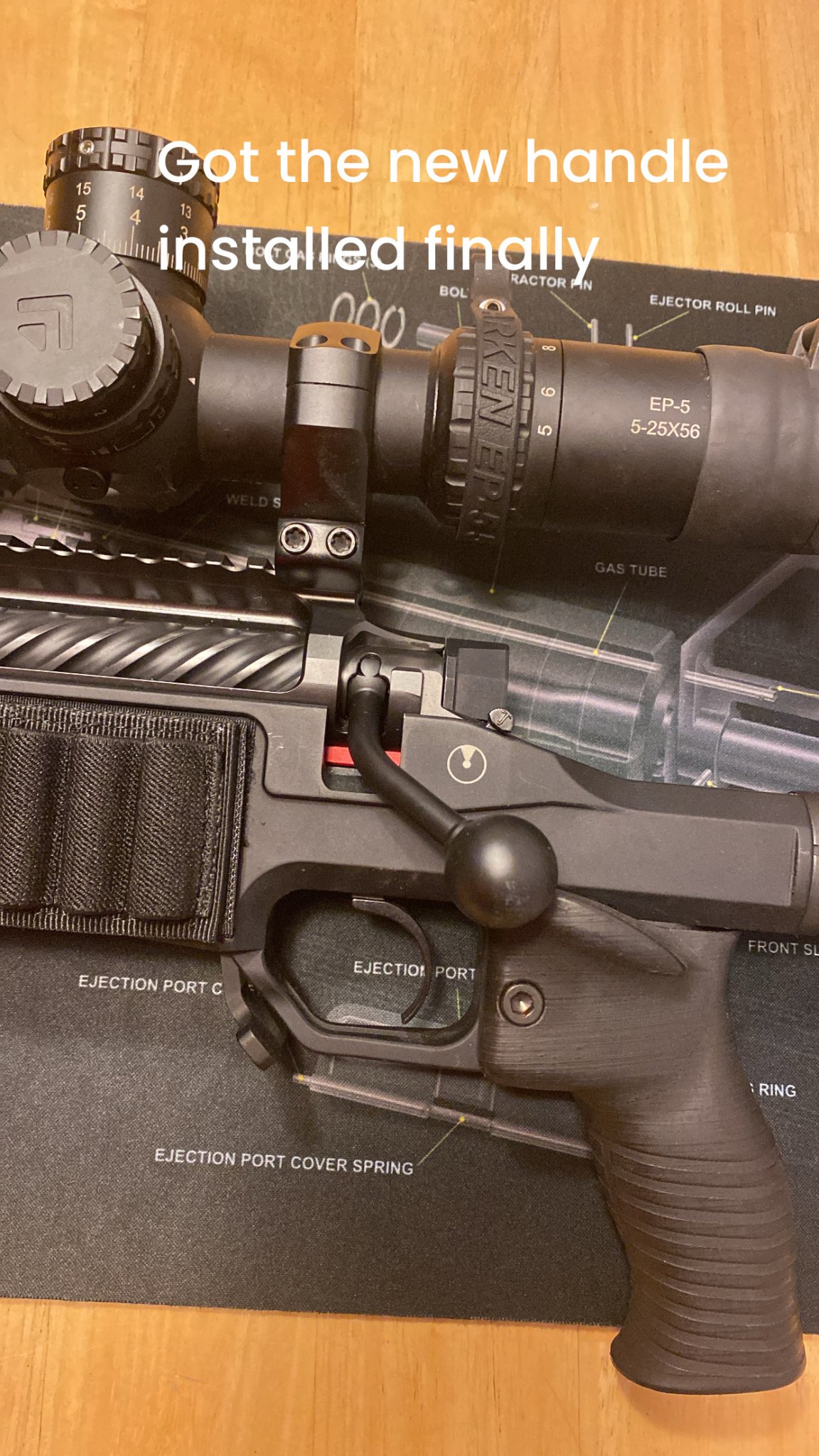

Had Fritz at Black Canyon Customs modify and coat it for me from a spare handle I bought from ARC, after seeing how @JaredCO had his and how it came out. I really like it and wish I could’ve gotten it this way from the start! I definitely see why people love the AI bolt handle form now

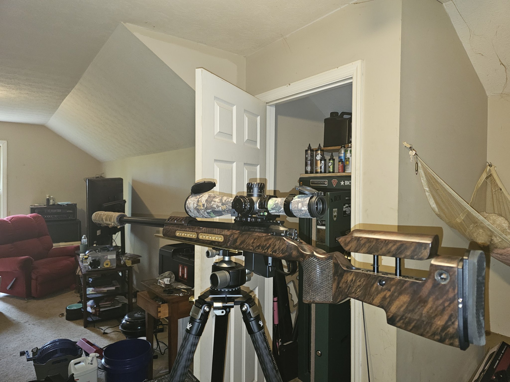

I really like this stock but can't find where to order one.
how much do they go for? it might be perfect for my 22 build coming up...
Unless you’re in Australia you can only get them directly from Benchmark Barrels. They aren’t advertising them. I’d recommend you call or e-mail benchmark barrels directly. They aren’t cheap stocks… definitely over 1k. I don’t remember the exact price.

What color is that MPA chassis? Tungsten? Going to be ordering an PMR soon debating between tungsten and black.

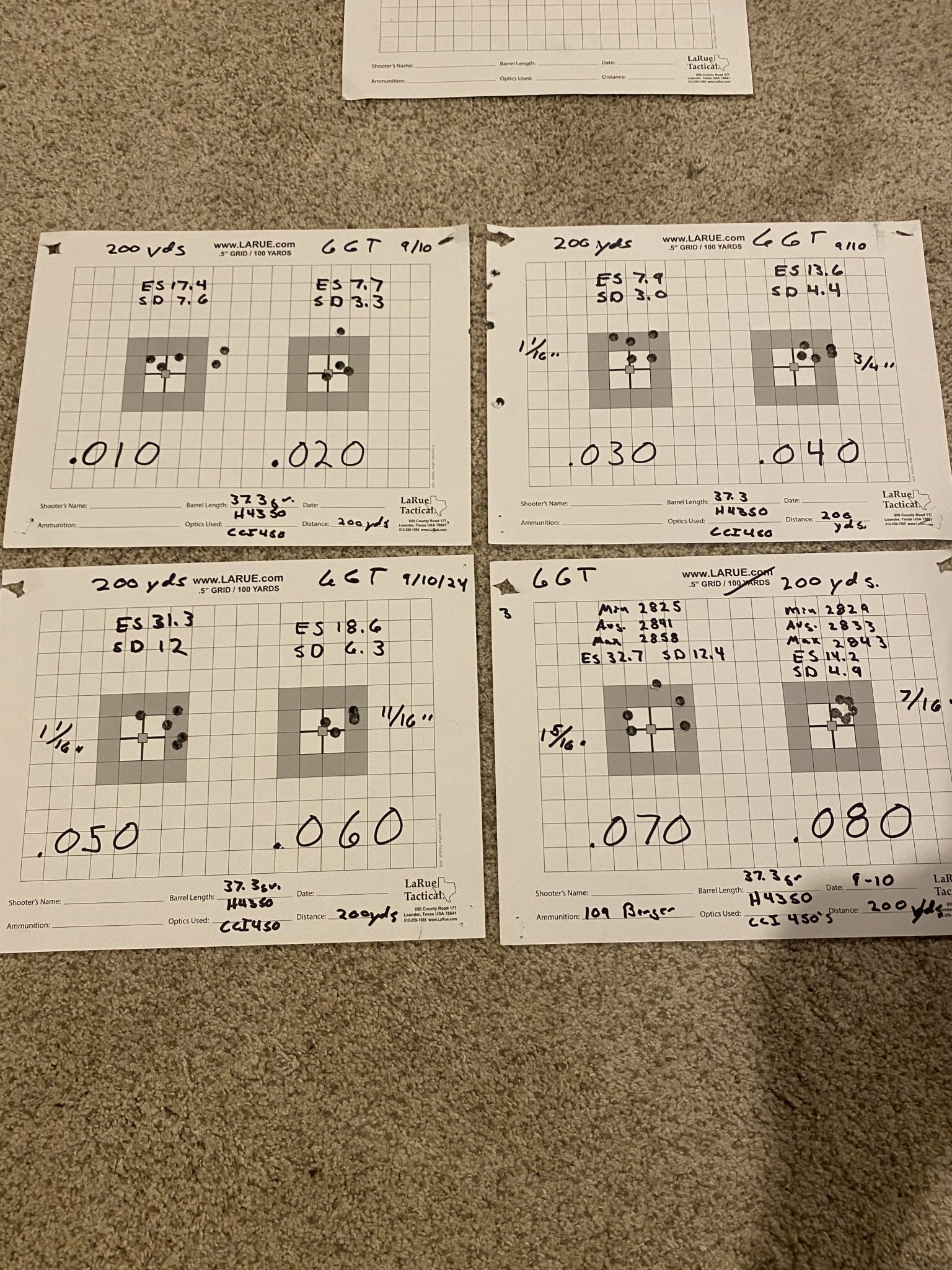

Finally got my build done and some initial testing. 6GT, Bartlein, ARC Chassis, ARC mount, Trigger Tech trigger, AI AW mag, etc. Going to do more testing but looks promising, I’ve done some initial velocity testing and here are some groups w/ different bullet jumps using 109 Bergers….the .080 group is sub 1/4 moa, that’s @200 yards.
Very nice!
Reactions: TKO
Load the .080 and go!
Reactions: lash and TKO
Looking good. What is your barrel twist, length and barrel length brand? SAAMI specs 6gt chambering?
Correction, the Bartlein is a 4 not a 4R, I have a 6.5 w/ a 5R and got them confused.
I have a ton of H4350 and I'm trying to load the 109 Berger slow at around 2750fps out of a 22in barrel. My concern was not having enough case fill in order to run them at 2750. But looking at your data with 37.3g and 2833, I think I will be okay to get 2750. Are you at full case capacity with 37.3?
I don’t think you will have a capacity problem using Alpha OCD brass trying to achieve that velocity. I would run a ladder test in .2-.3 increments checking for pressure signs along the way. You’ll probably end up around my powder charge? I was going to do some further bench side loading w/ my LE Wilson in line seating die but it was leaving a pressure ring around the nose of the bullet, I had planned on testing more velocities using my favorite “jump” value. I was planning on going up to 38.3 gr. Let us know how it works out👍

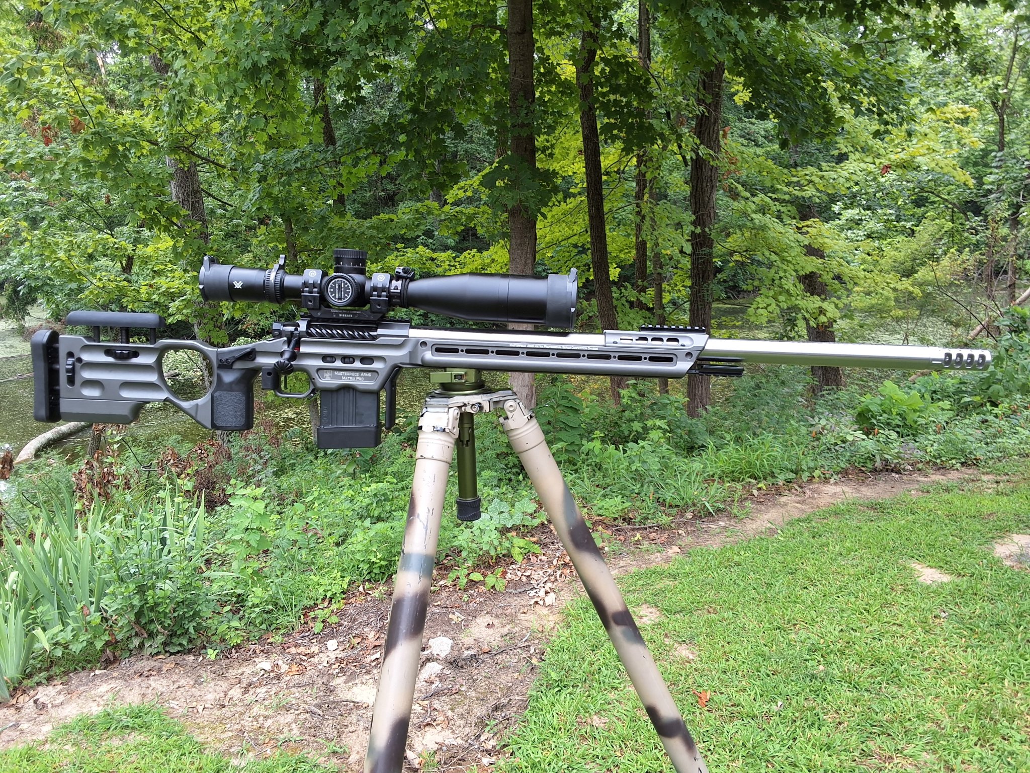

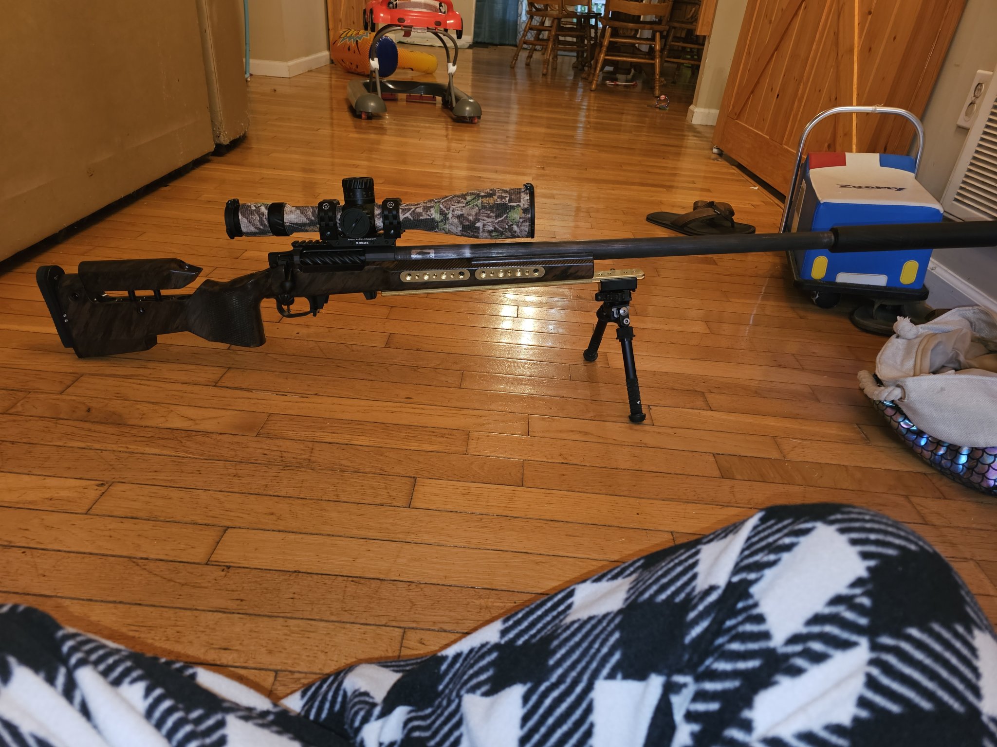

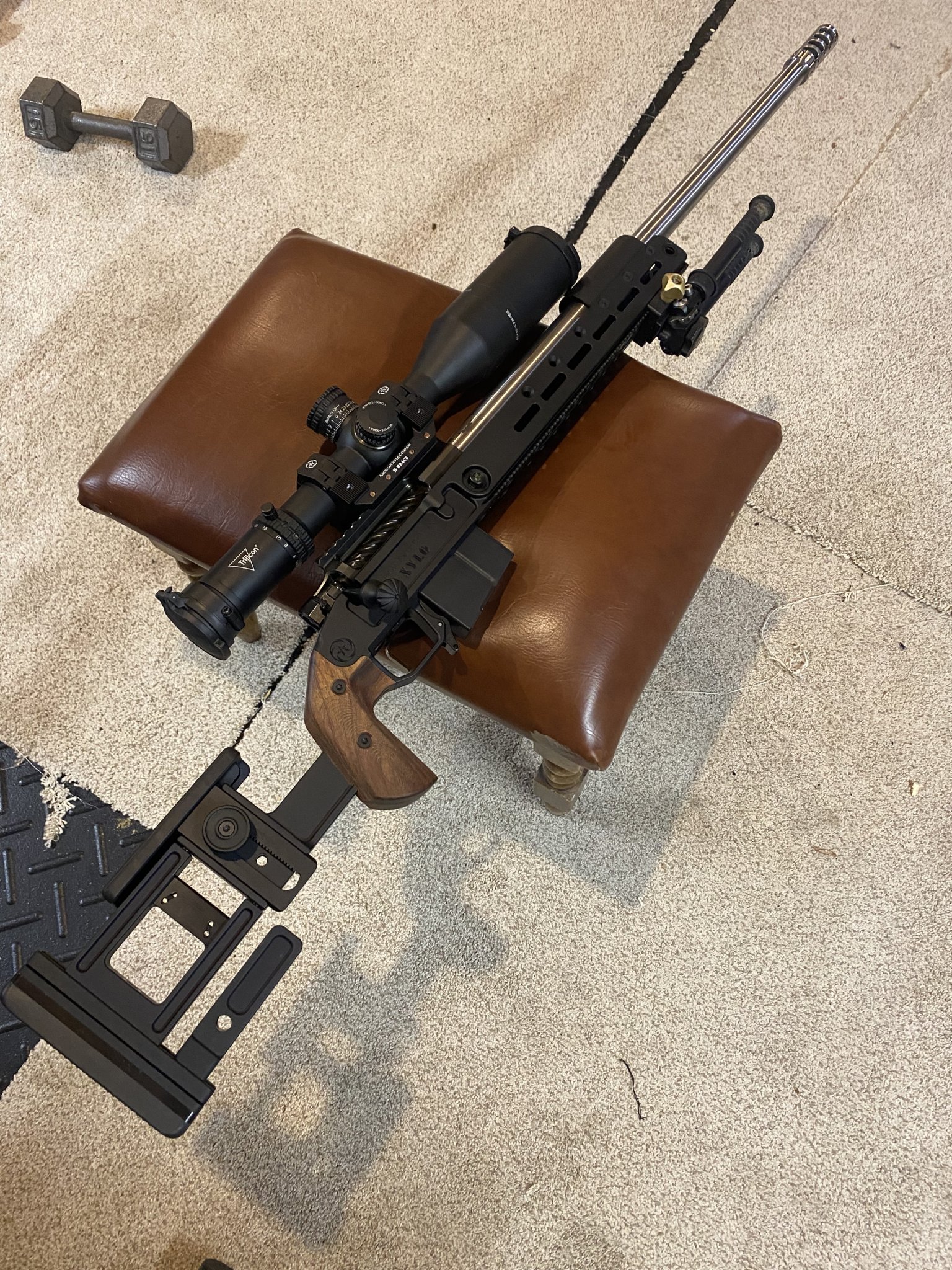

Just assembled my CDG .338 Lapua tonight, will have to get some photos to post.
CDG Action
Manners LRH with Micro Chassis
TT Special Two Stage
Hawkins Hunter Bottom Metal
OMR Carbon Barrel, 24"
SRS Ti Pro 4 Brake
SRS Hunter Rail
Rifle weighs 7lbs 15oz. Did have to remove a decent amount of material on the front of the micro chassis rear "pillar" to clear the trigger hanger. First impressions of the action is really good, it feeds smooth and the adjustable trigger hanger really lets you dial in the sear engagement. Excited to get it to the range.
