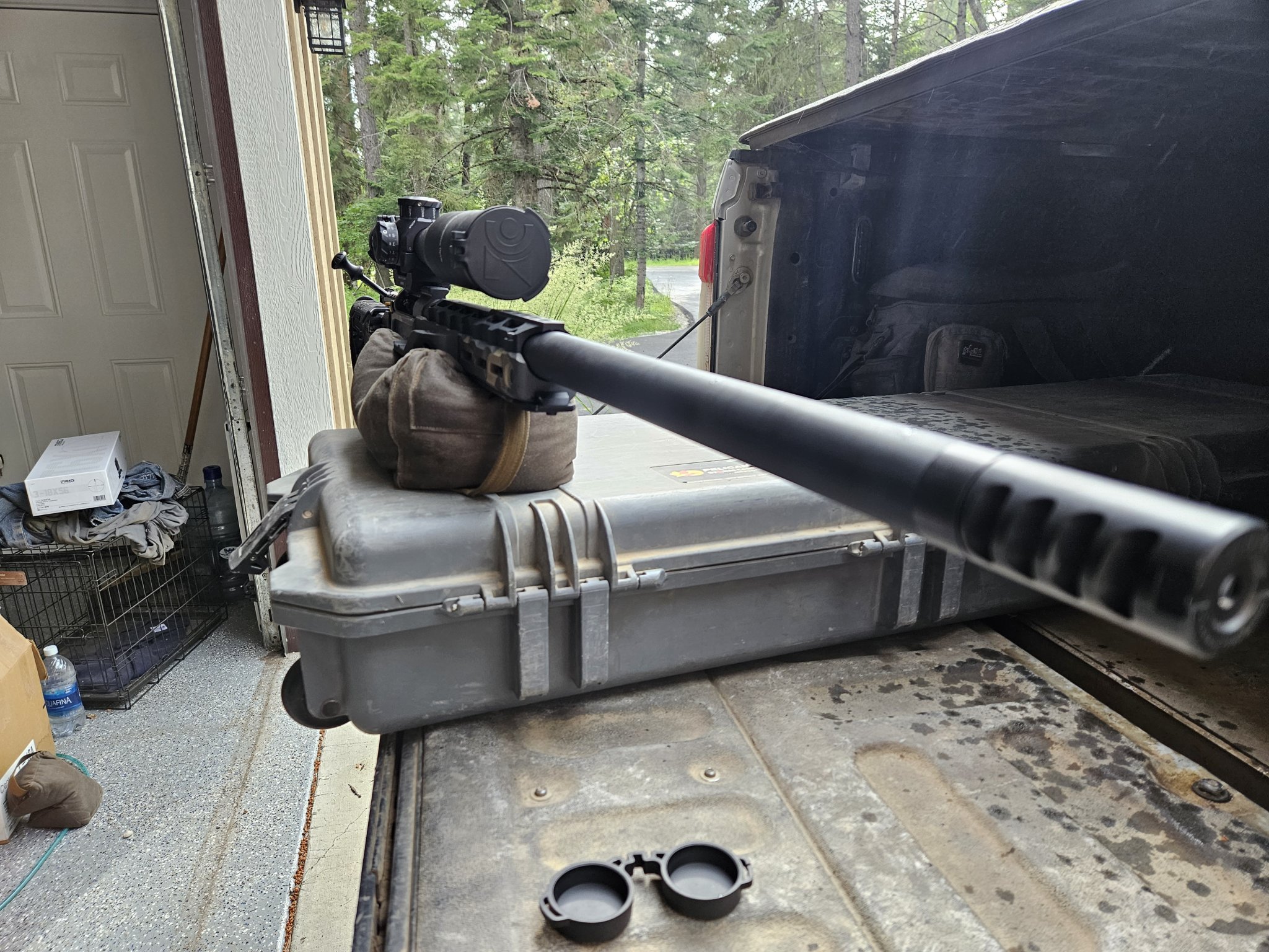

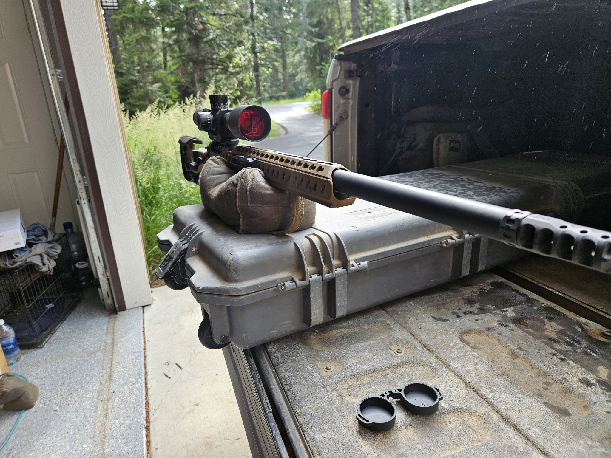

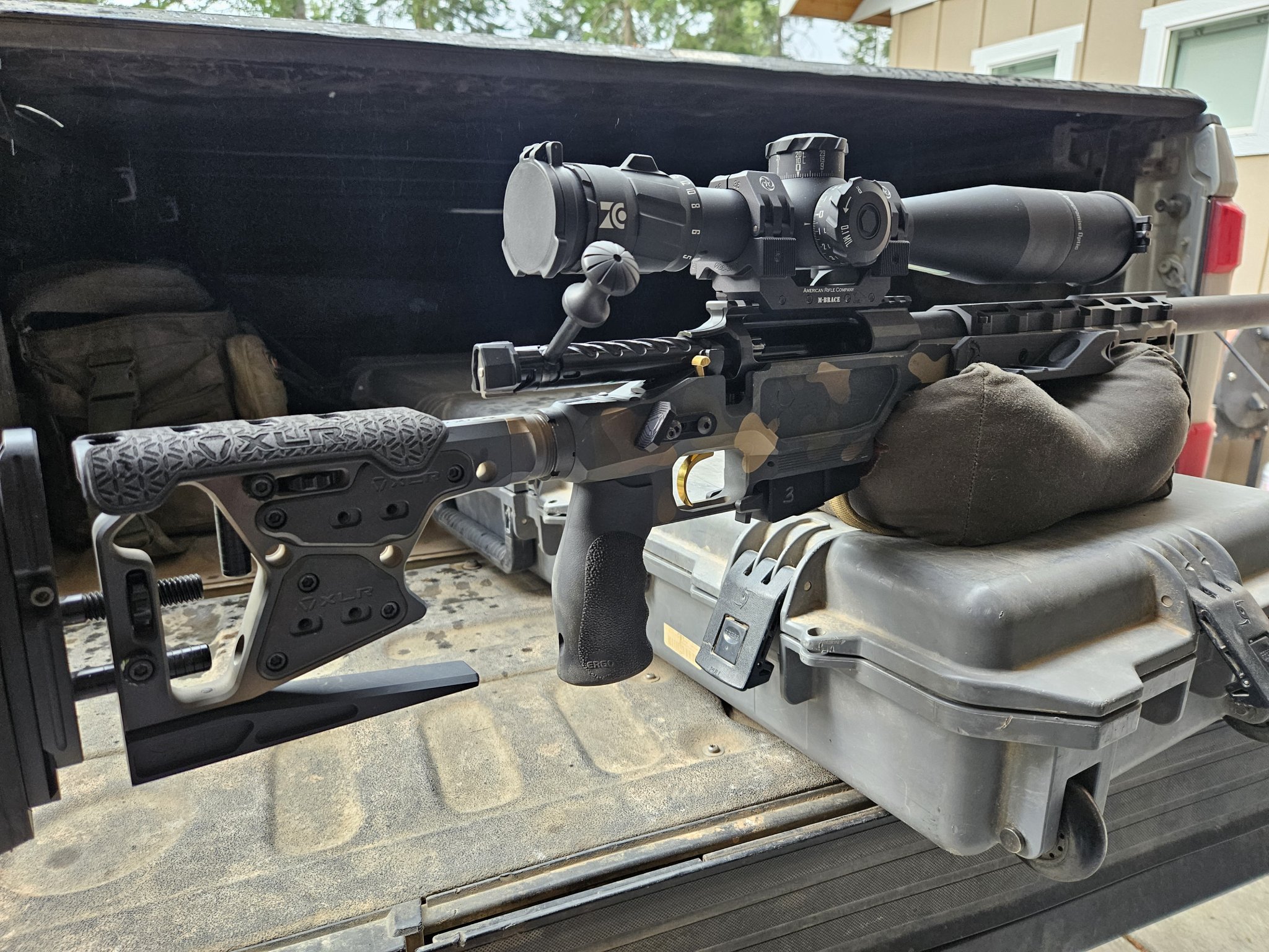

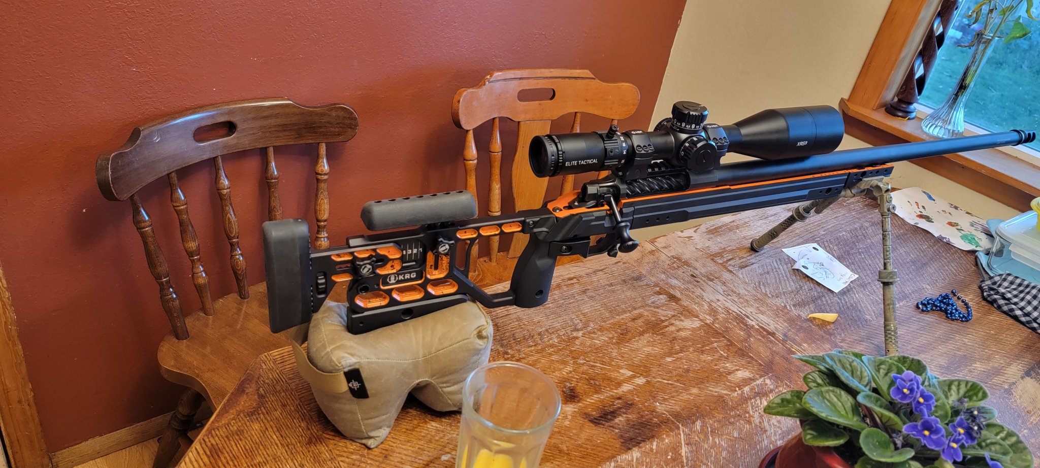

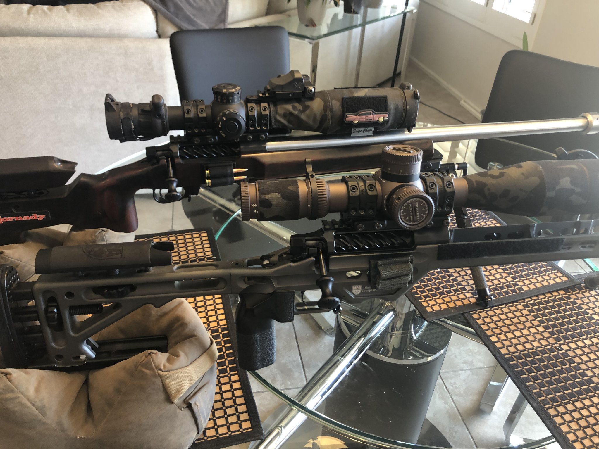

Finally made it to the range to break in 6 new barrels. The 2 CDG builds being among them.
Rifle #1, CDG 30 MOA rail, 28" 7.5tw hawkhill 1.25 straight cut with alpha 6bra reamer, mbm super beast brake, in an envy pro jv chassis, zco 527 10mil turret NLE, mbrace mount. TT diamond GOLD.

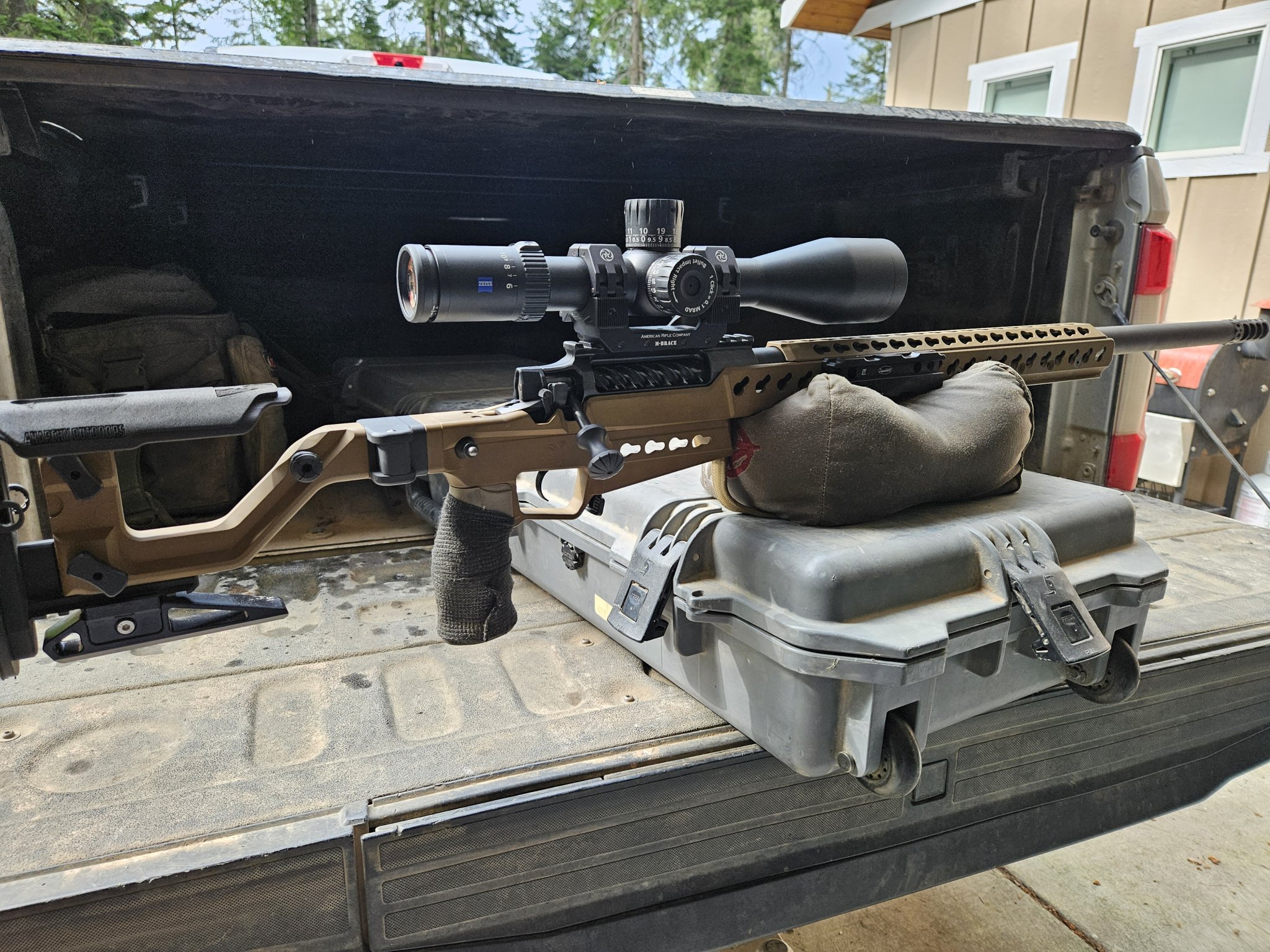

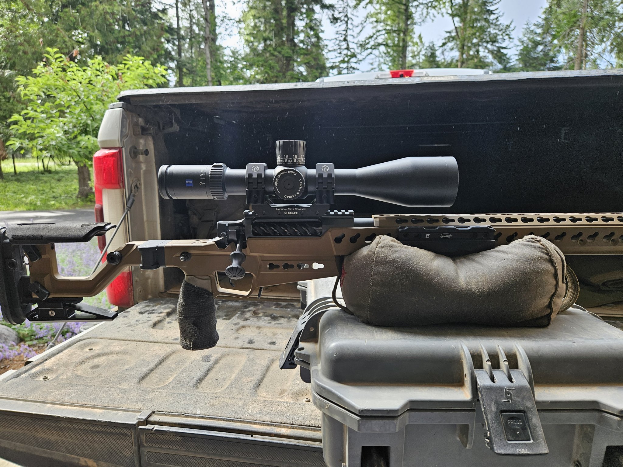

Rifle #2, CDG 30 MOA rail, 27" 7.5tw hawkhill hvy comp cut with saami 65creed, hypertap brake, AI atx FDE chassis, zeiss LRP S3 6-36, mbrace mount. AI AX mags work well in the atx chassis. TT Special.
All barrel work was done by Manzella Precision, fit is perfect. He stated both actions were 0.827 headspace VS the prints 0.825, the man does amazing work. He's cut me 6gt barrels for archimedes, Tl3, atx, and now a bat bumblebee, and they all headspace within 0.0005 based on measuring shoulder on fired brass. Dudes a master machinist. Random break in loads of 30.3gr 4166 with 108bt Berger 25k off in the bra shot just over 2" at 300y in heavy mirage, the 65 got 41.5gr 4451 with 140eld jumping 50k, this load shot 1.7" 5 shot group at 300y. All other rounds fired were postional practice on the 6" and 4" targets at 300y. The 65 was built in 7.5tw in plans of running 153.5 Bergers when they come available again. The 6bra will get 109 Bergers once it reaches 200 rounds for breakin.

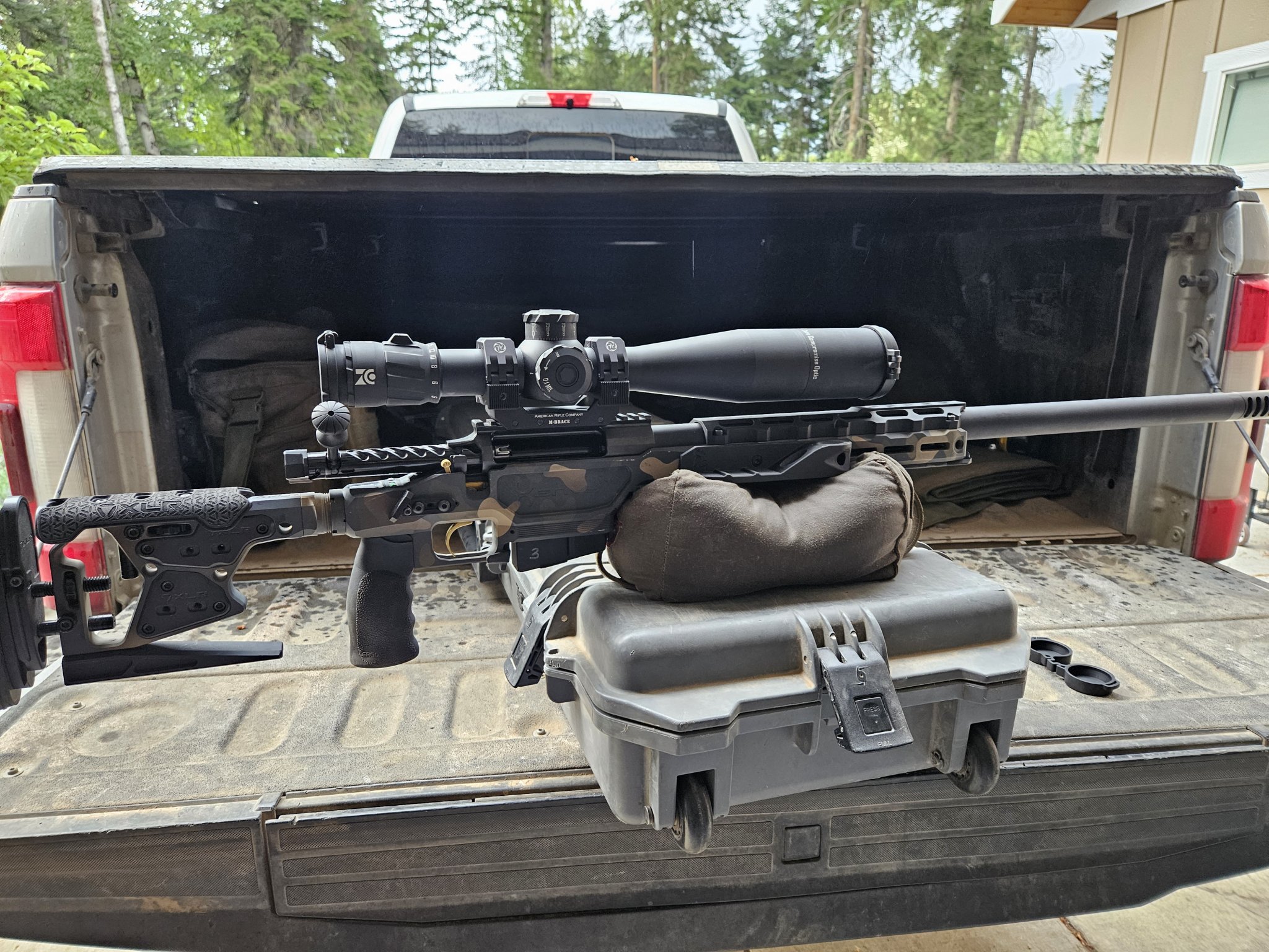

Pieced together CDG #2 for break-in duties for CDG #1’s spare barrel that’s arriving Friday. Then will see duty in 6XC when it’s barrel arrives.
In rifle 2 did you have to do any mods to get it to work in the atx chassis?
Negative, other than remove the mag block that's bolted into the chassis for aics mags. Now aw/ax mags work great!

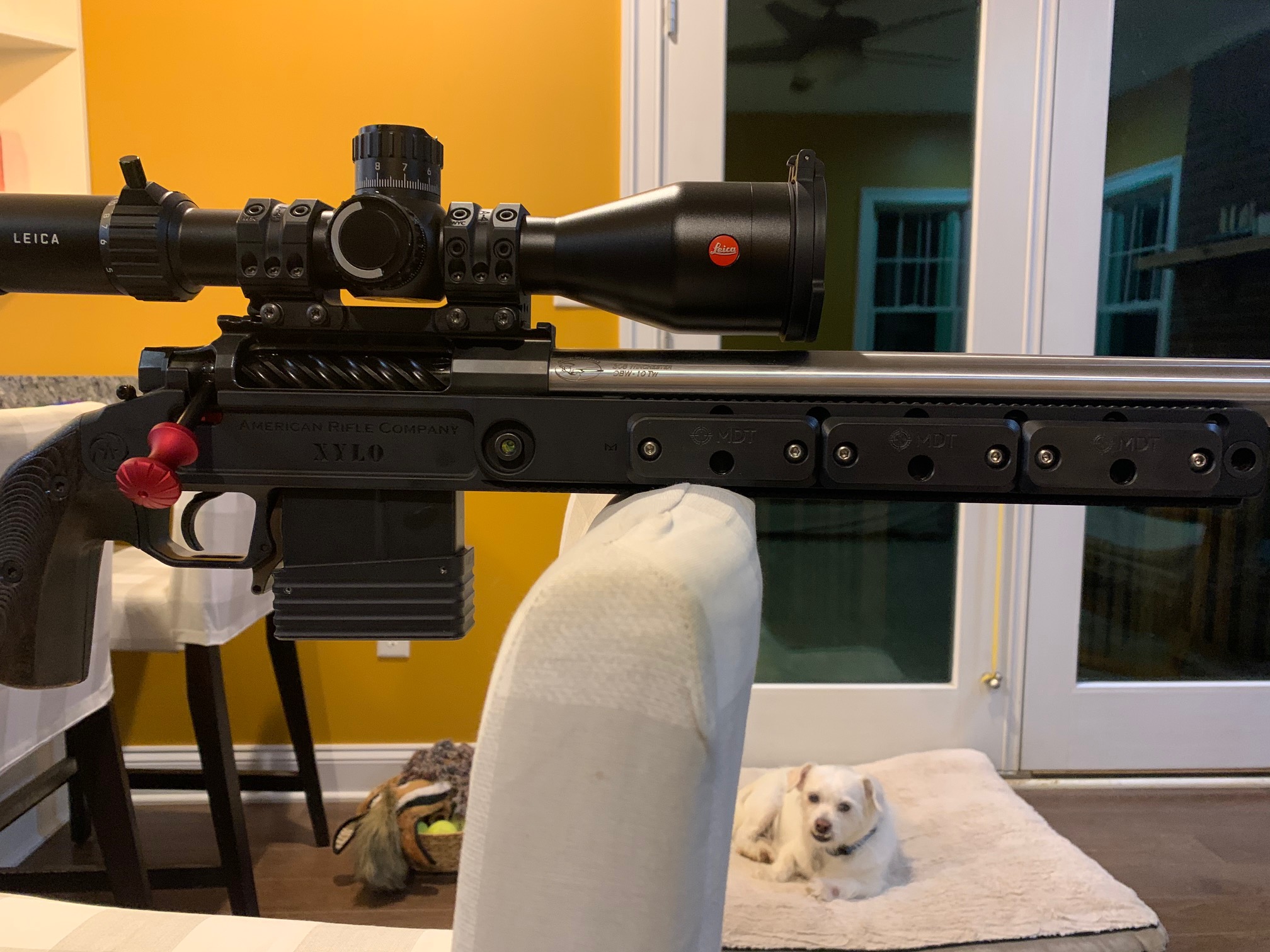

Got mine back from the Smith today, assembled and to the range. Here are rounds 21 to 26. Picking up a Matrix Pro at a match in a couple weeks for it.

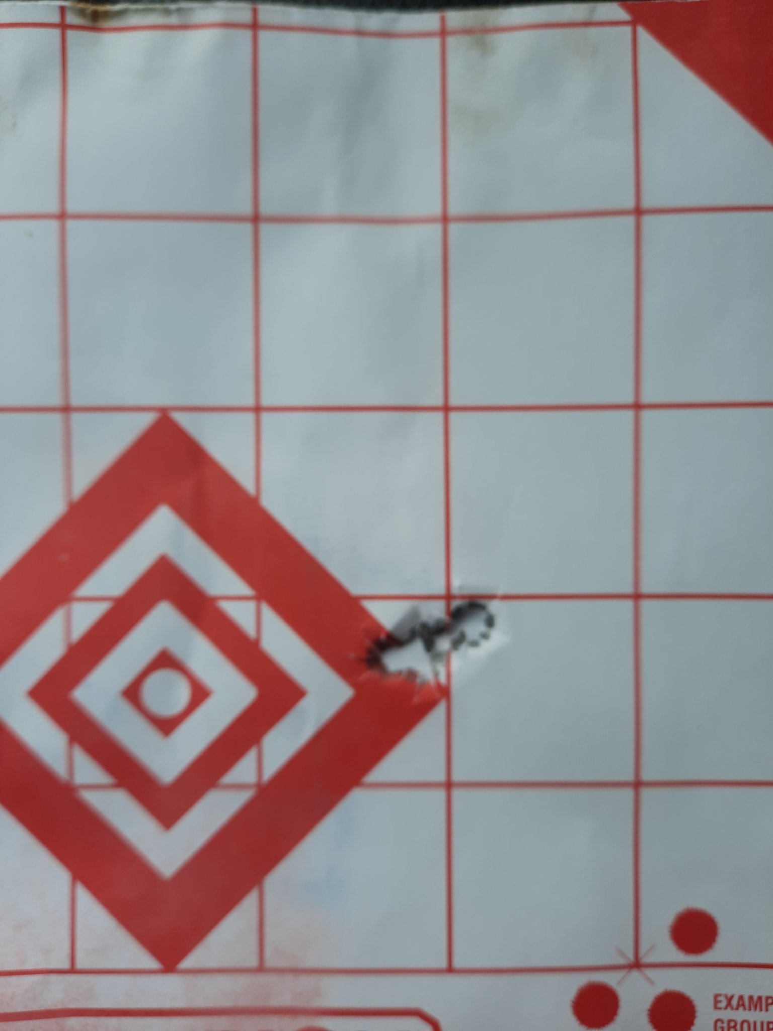

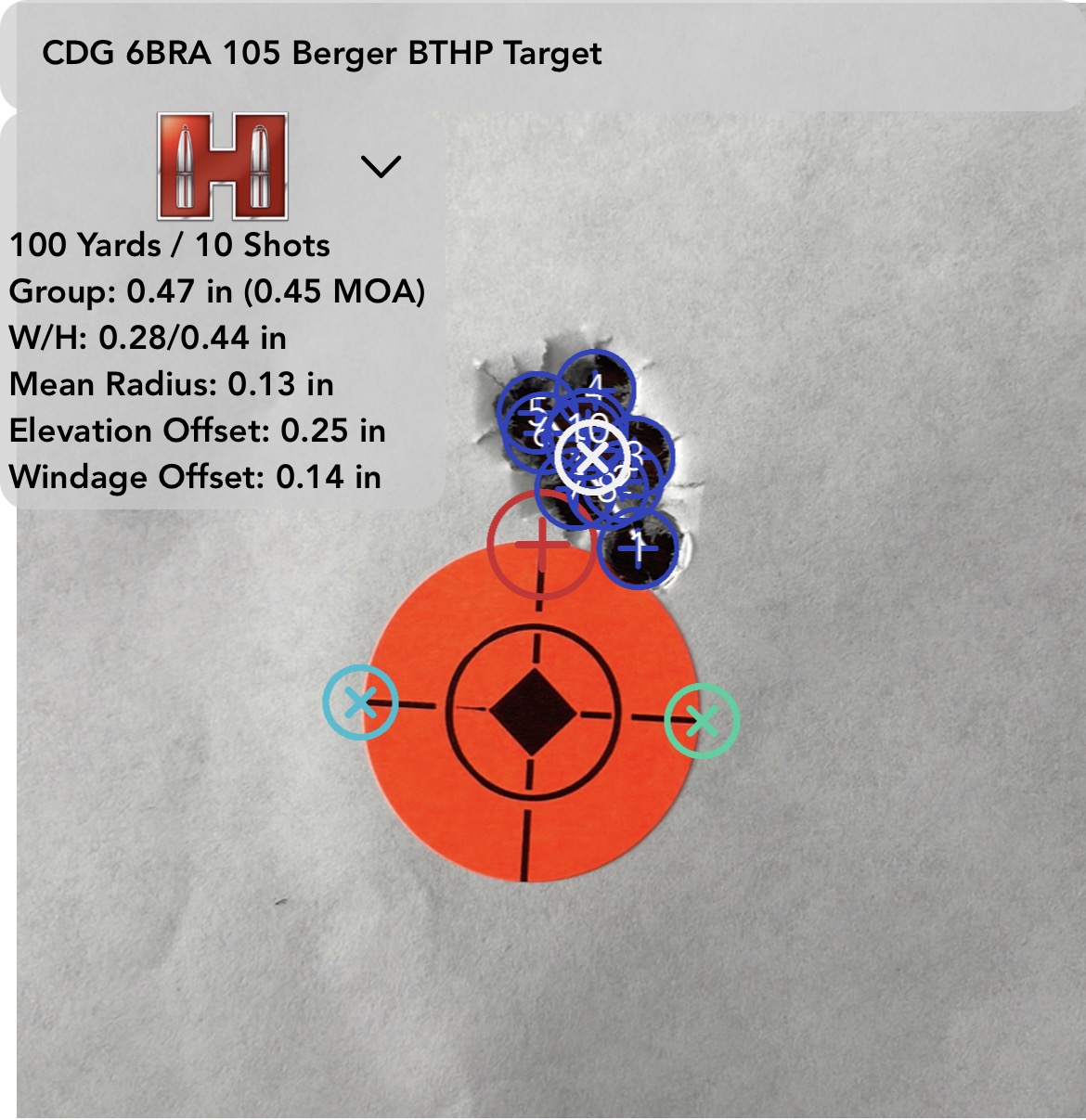

Update on my CDG 6BRA feeding issues from a page or two back. So I re-installed the HRD kit after using a dremmel and polishing compound to really smooth out the lips on the AW mag and it made a night and day improvement. Feeds like butter, no malfunctions, and I didn’t have to adjust the lips at all. This is my first AW mag setup and couldn’t be more impressed, with 5 or less rounds in the mag you can’t even feel the bolt pick one up. Pretty sweet. Here is a fire forming 10 shot group with Berger 105 target hpbt. This PVA barrel is a hammer. Thanks @bohem

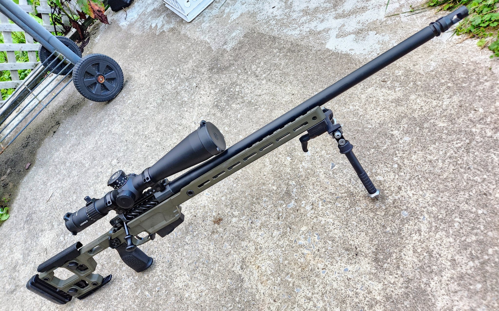

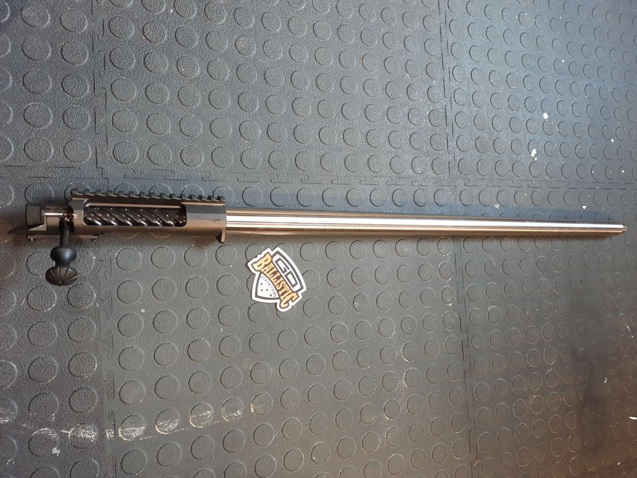

Got the barrel for CDG #1 spun up and coated today. 24" Proof Heavy Palma in the Solus chassis until I decide what it's going to live in. Did have to clearance for the front and rear of the trigger hanger.
