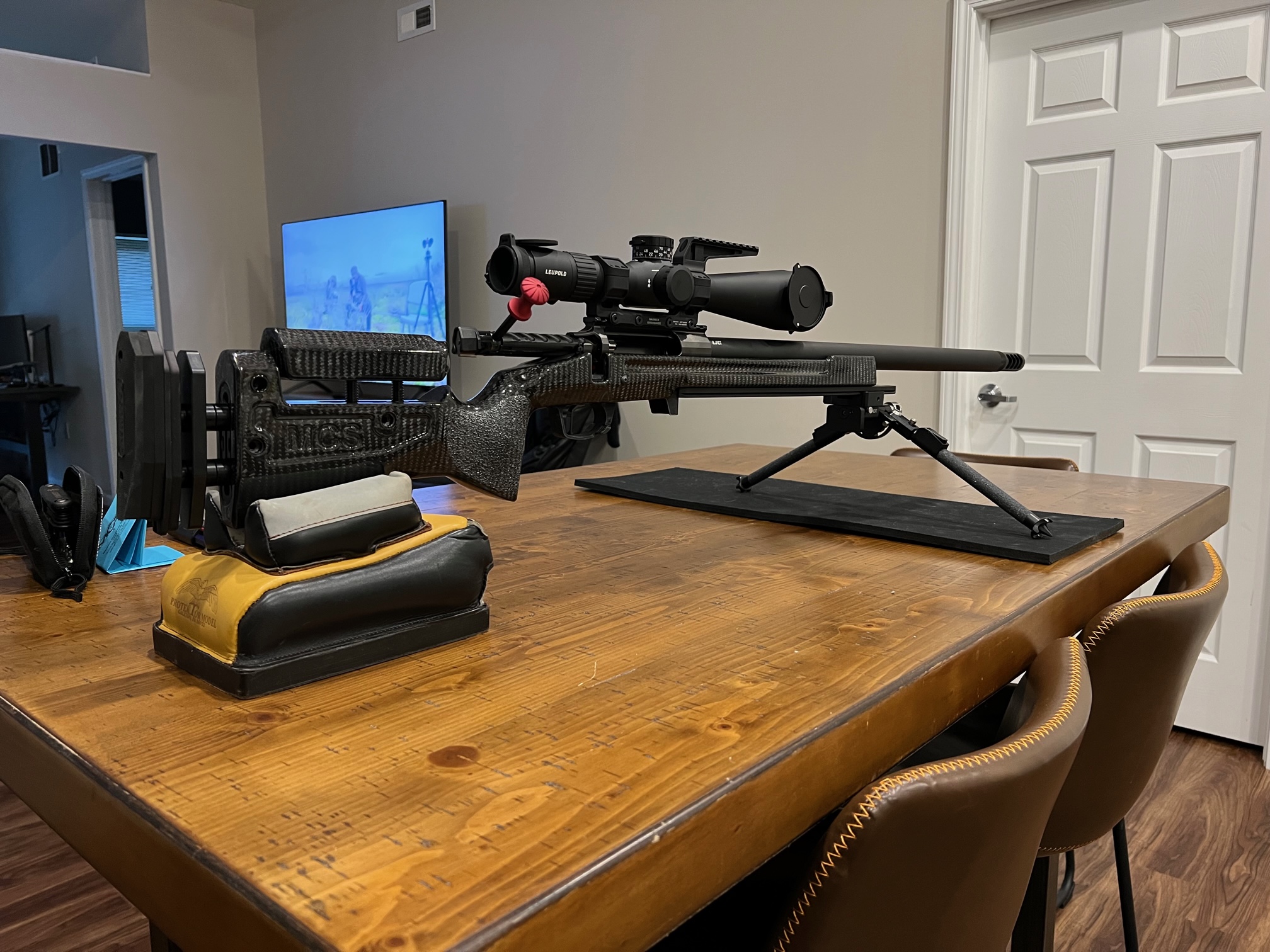

What scope ring height are yall using? I should get my rifle in the next week or two and I'm trying to get ahead on ordering rings.
I'll be using a Bushnell XRS3 (34mm tube, 56mm obj), an MPA ESR chassis, and ARC rings. I want to have the scope high enough to use a 1.250" straight barrel, although I have a light Palma contour on order. I'm think the 1.26" rings seem about right, or should I go with the medium 1.10" rings?
im using seelins 1.26, feels about right so far

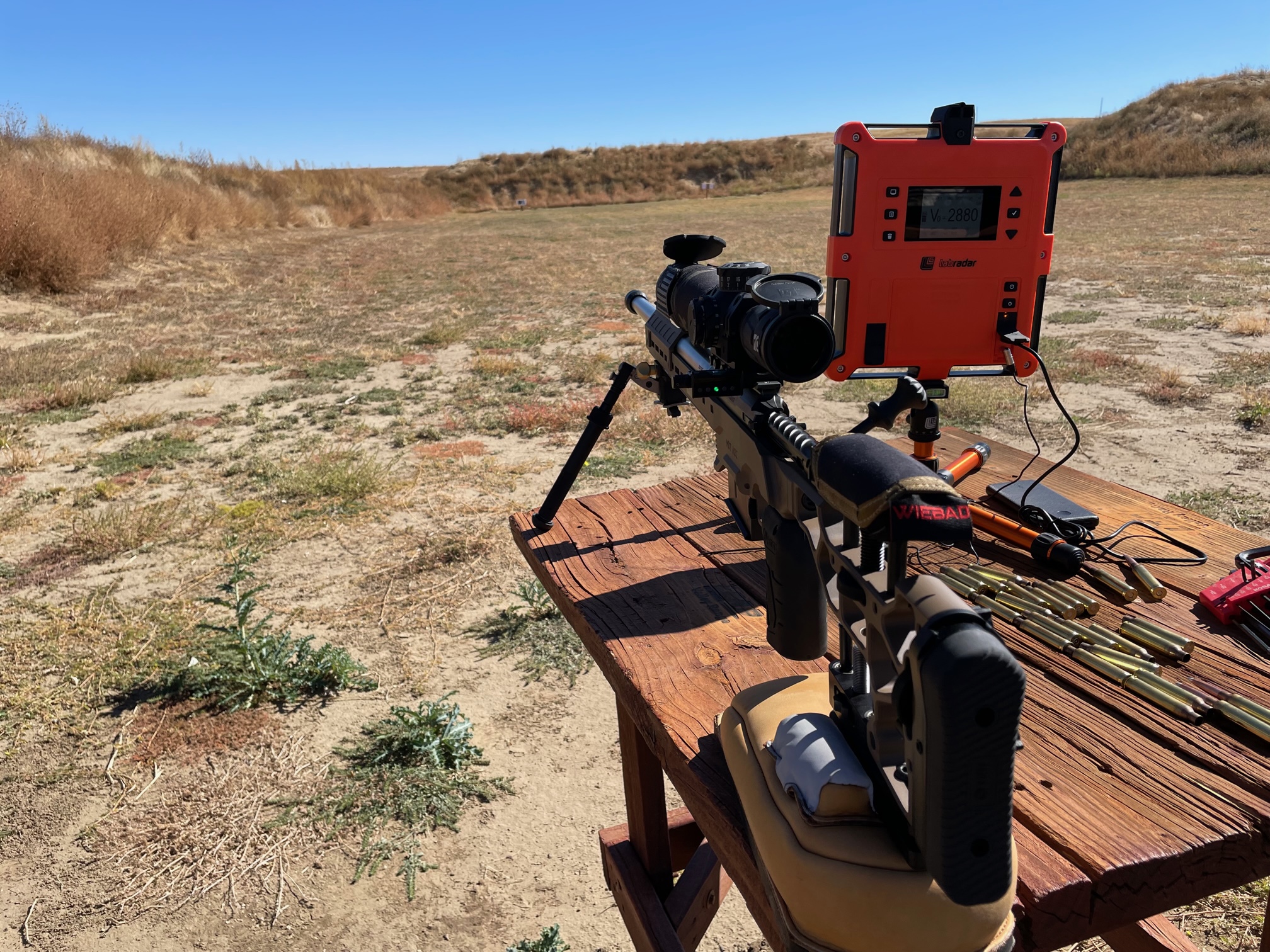

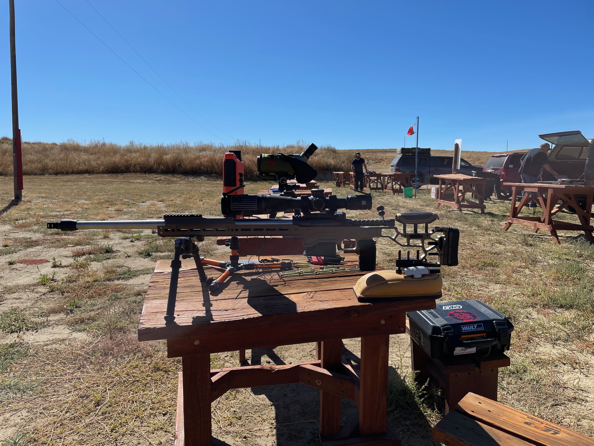

Got my new build out to the range today for load and tuner testing.
CDG Long Action in 300 PRC
30" 1:9 tw Bartlein barrel
MDT ACC Premier Chassis
Atlas BT-35 Bipod w/A419 Arcalock mount
Long Shot Precision Adjustable Bag Rider
Send It Level
ATS Barrel Tuner
TBAC Muzzle Brake
ZCO 5-27

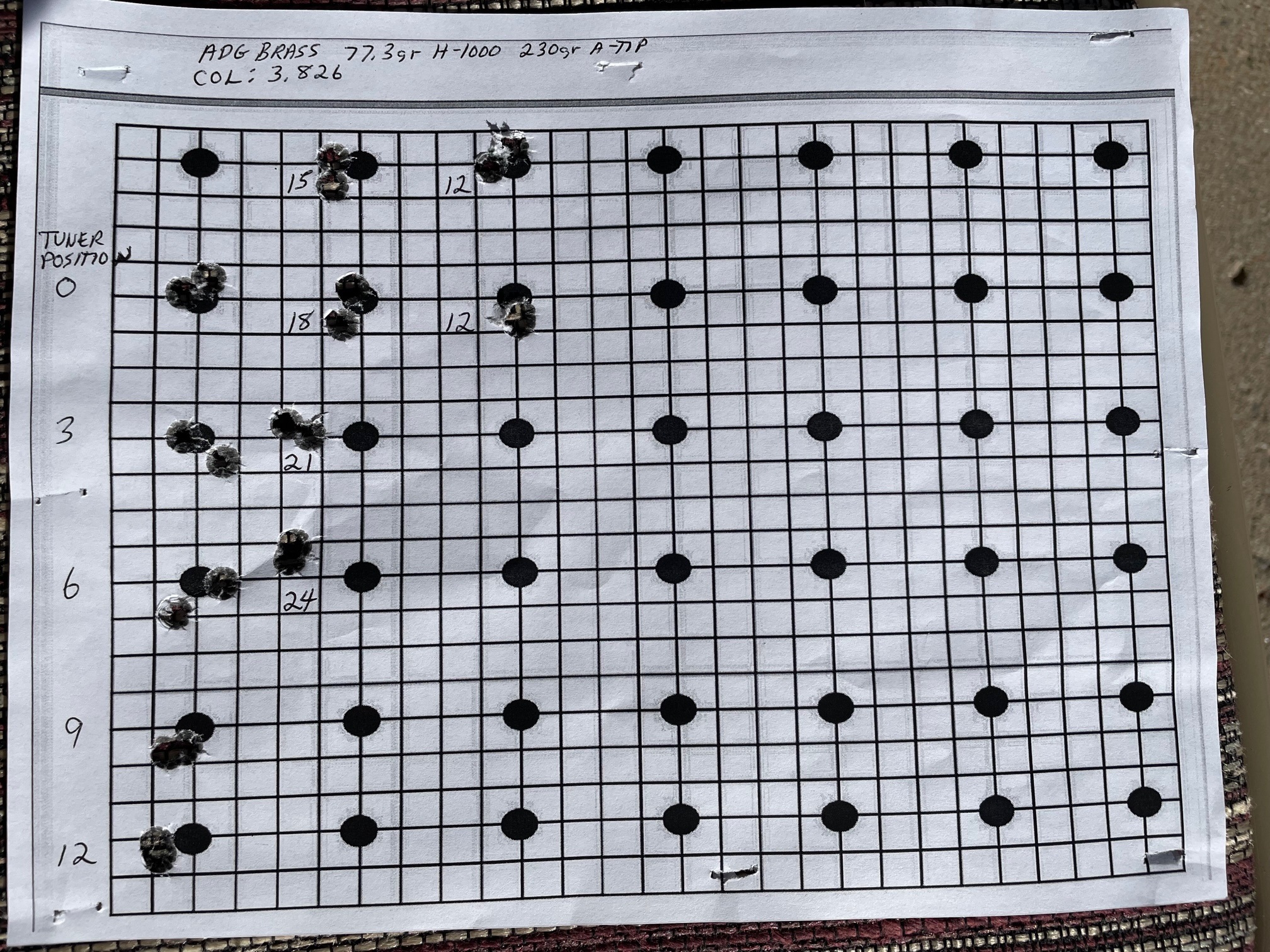

Tuner test target. Two shots on each position. Looks like position 12 on the tuner is best. Shot it that way 3 times to verify. Very pleased with this so far considering I was using virgin brass.

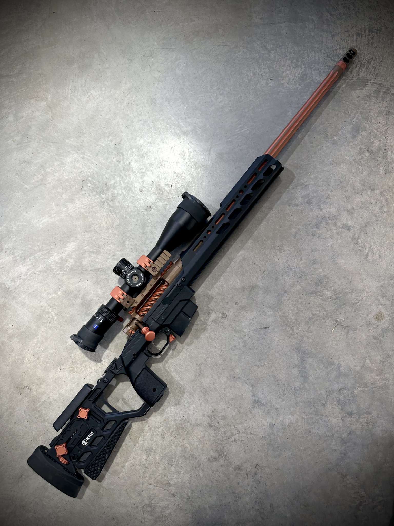

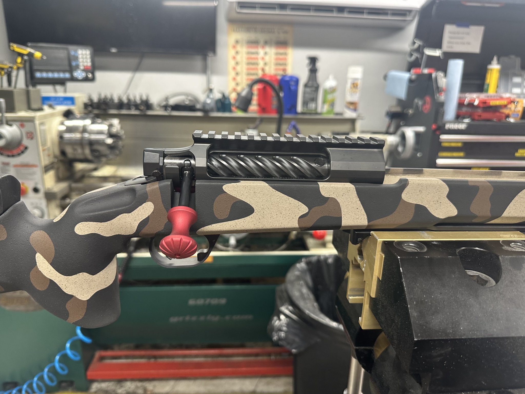

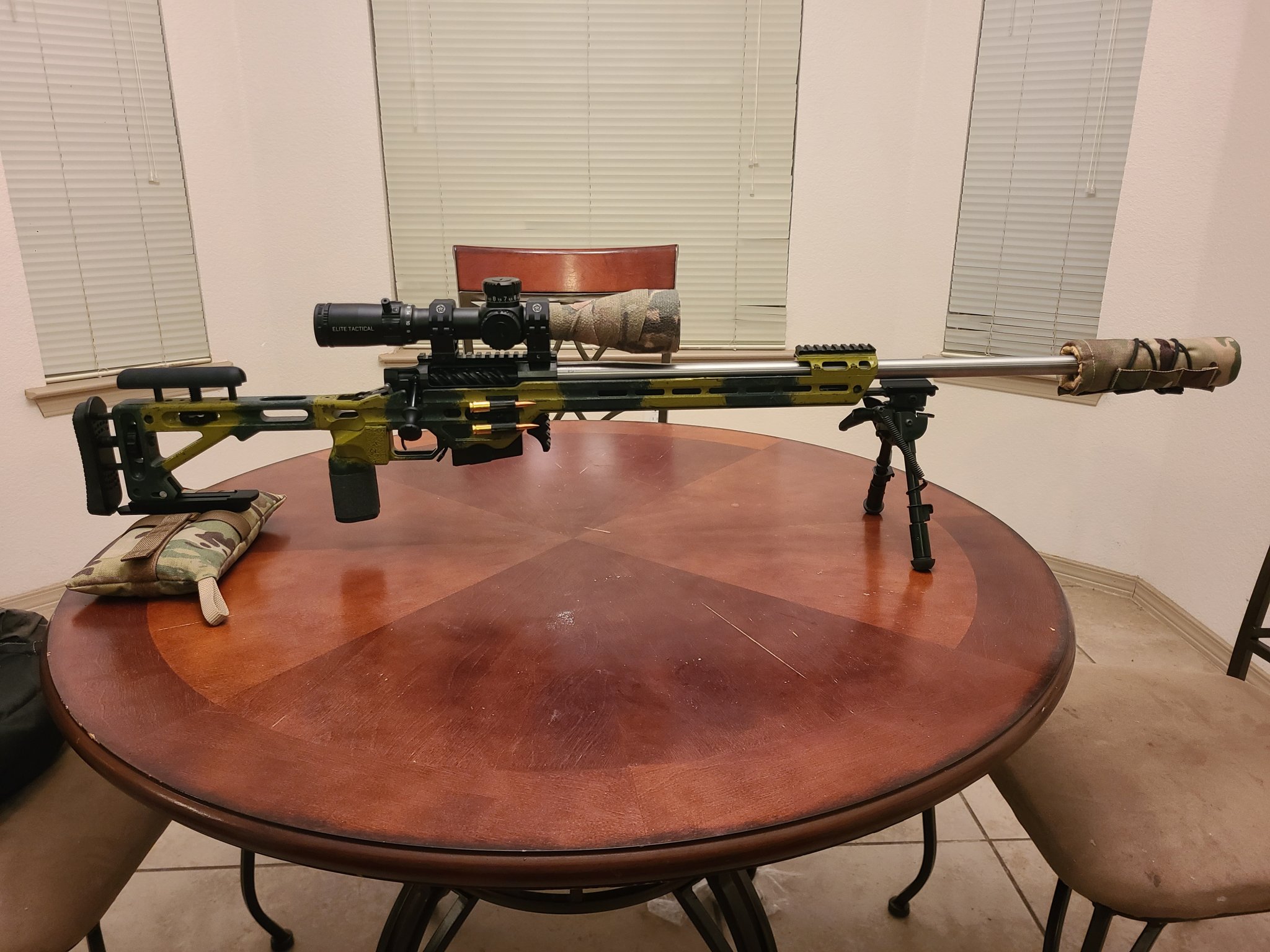

CDG
PVA Fluted 22GT with Jetblast
G6 Whiskey 3 Folder
Zeiss S3 6-36
ARC Mbrace
TT Special

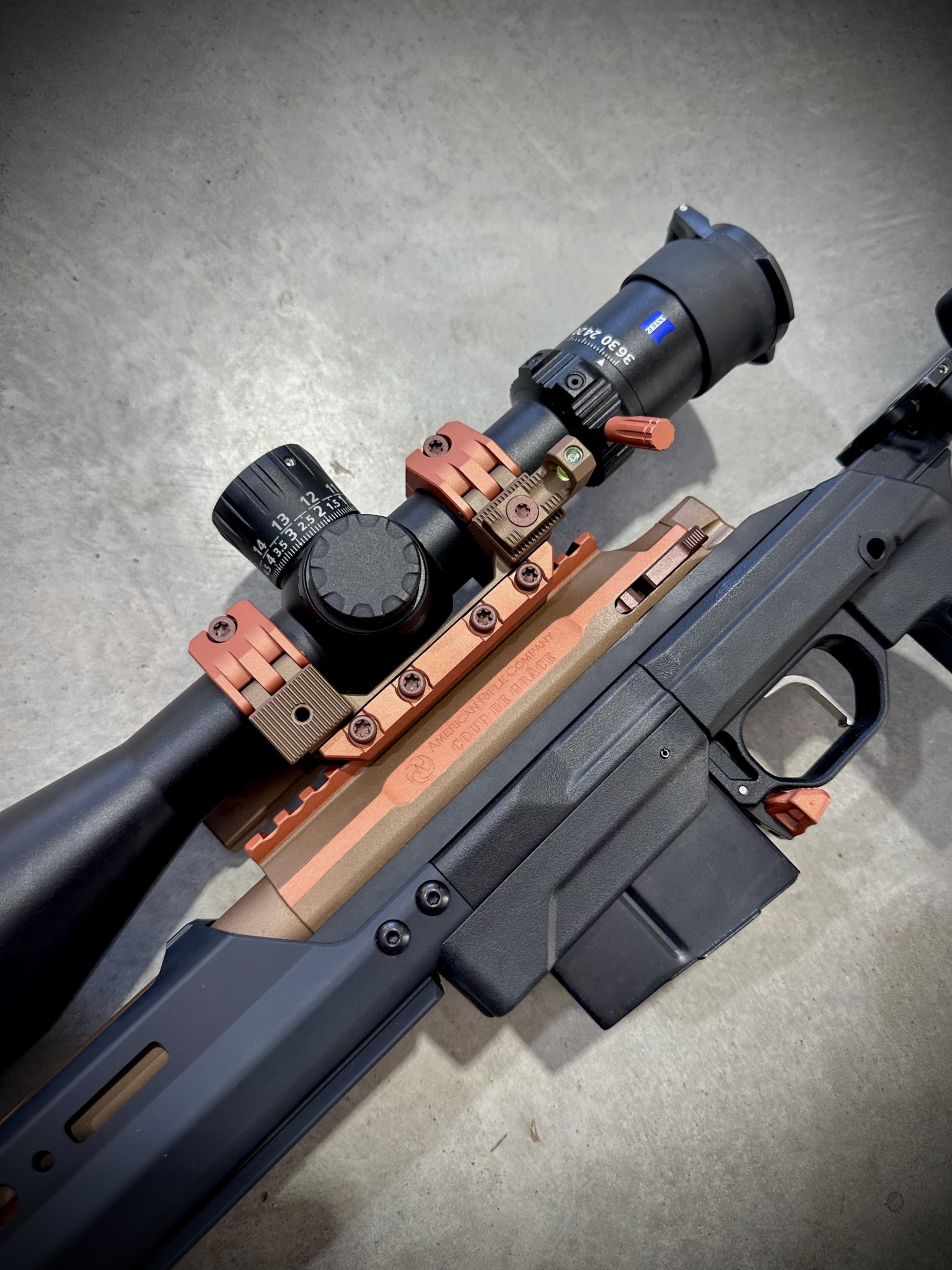

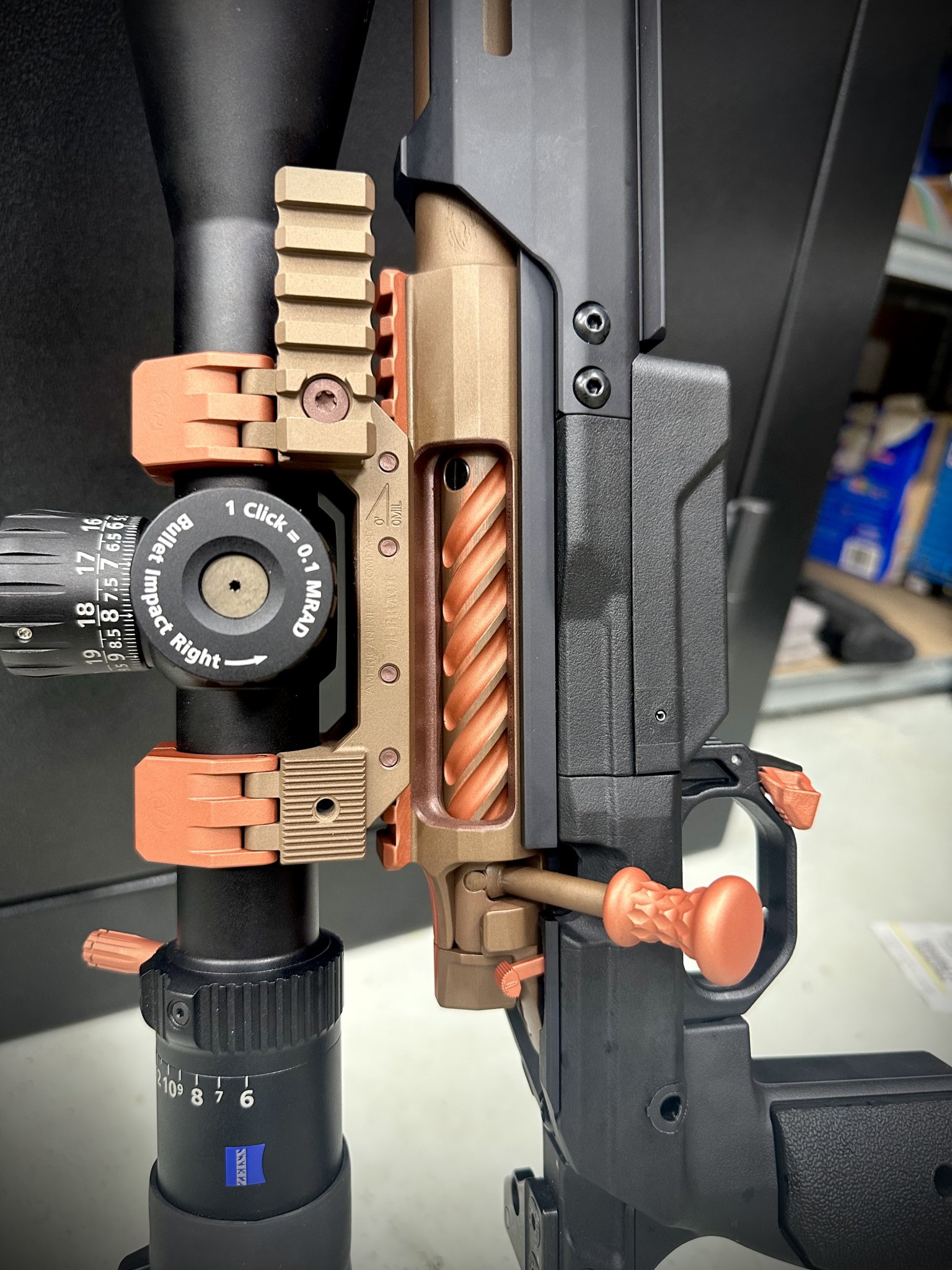

Just have to decide what forend to run (this, Alpha, Totalhunter) and then I’ll coat the rest.
I like it except for the top scope mount caps, they seem out of place to me but it could just be the picture. The mag release is really cool, where did you find that piece?
Reactions: Hennig
Aesthetics, of course, are in the eye of the beholder. Put 10 guys in separate rooms and the same setup and instruct them to decorate according to their vision. You’ll end up with ten different results, even if some are sort of similar.
100%
I started doing quirky and different stuff on my own builds once I really stopped caring what other people thought of them, and now they’re all my favorite schemes. Whenever I do stuff to resell, I stick to the normal browns, greens and greys.
When I first saw the CDG renders I was instantly thinking about how the aesthetic leant itself to an old coppery bronzey art deco kinda look.
100%
Steampunk(ish) with the Xylo, Nuke, CDG. The movie, "Rocketman" comes to mind with the motif/set props/dress.

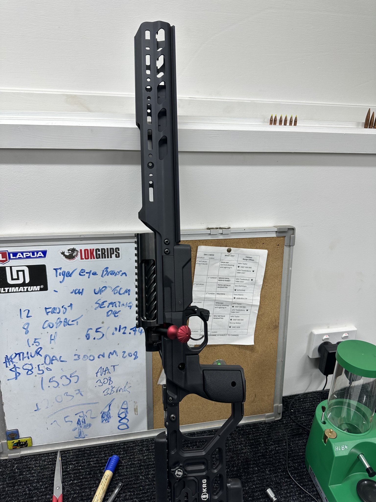

Can anyone comment on the correct mag latch spec for the CDG with a Xylo chassis for AICS vs AIAW? I have a short mag and a BRA barrel coming so I’m assuming I will use both, just curious.

Could you tell me where to get the short latch? After looking on their website for it I am only seeing the standard latch as well as the 0.030 longer latch. Under the CDG compatibility it also states to use a shorter latch but I’m having trouble finding it.
I think you’ll just need to order a spare std. latch & then fit it/shorten it for AICS. Should require + - .030 removed.

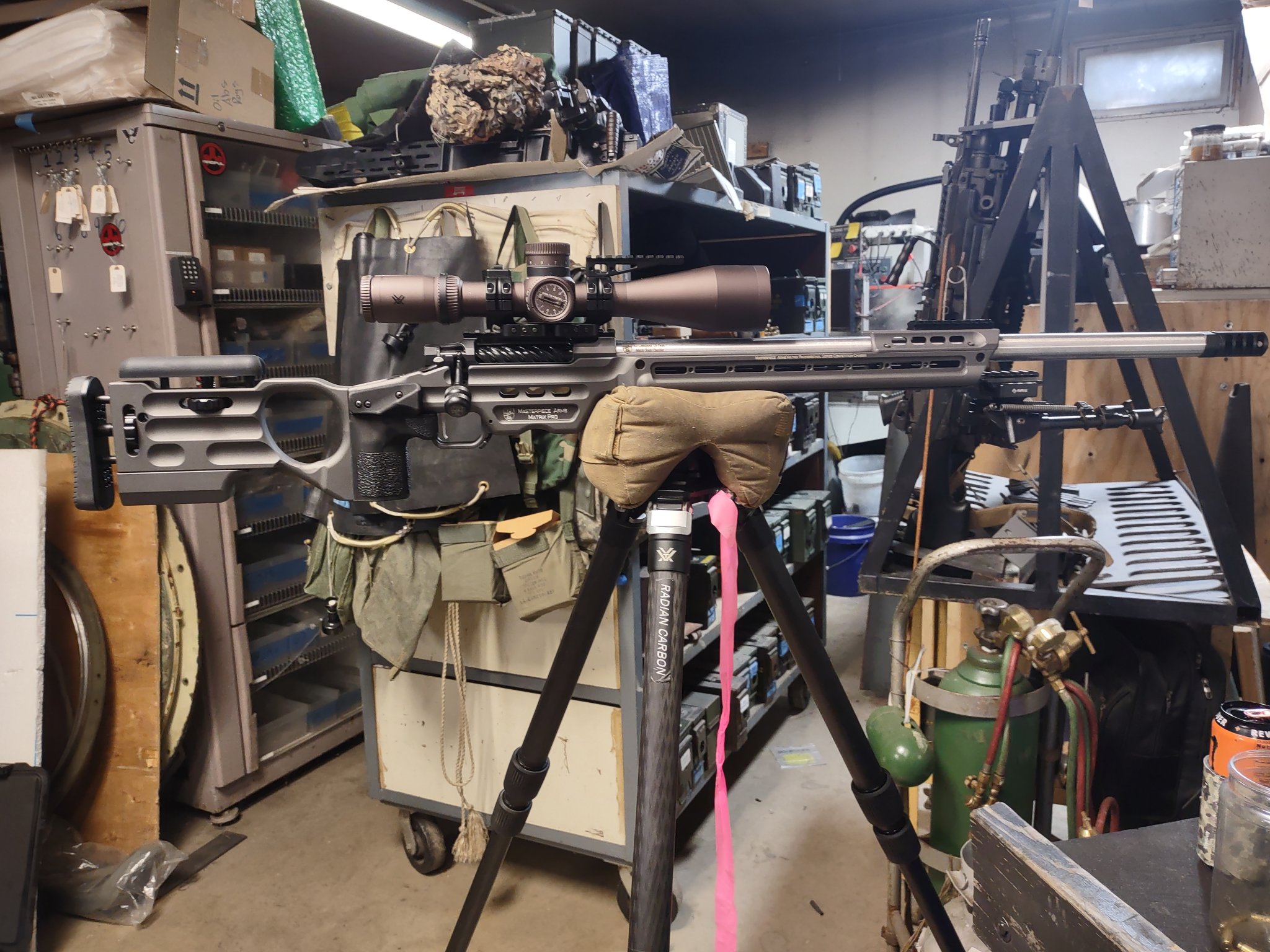

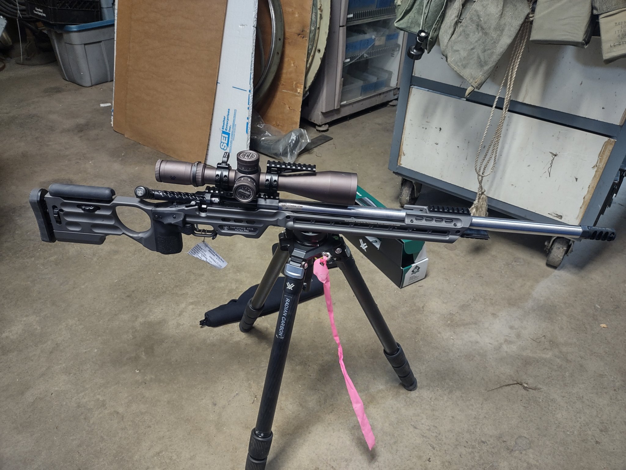

Not a great photo, but my CDG rifle is just about completed.
CDG action - LRI built
1:7 K&P 1.25 straight barrel 25" 6.5cm (planning to run 144 berger's on RL 16)
419 Hellfire Match brake
TT Special straight
Manners TCS black carbon high gloss
Leupold MK 5 7-35
Accuracy international AIAW mags (I ordered an extra mag lever and filed it down)
Badger Ordnance Condition 1 mount (I have a vortex 4000 on layaway that will sit on top)
