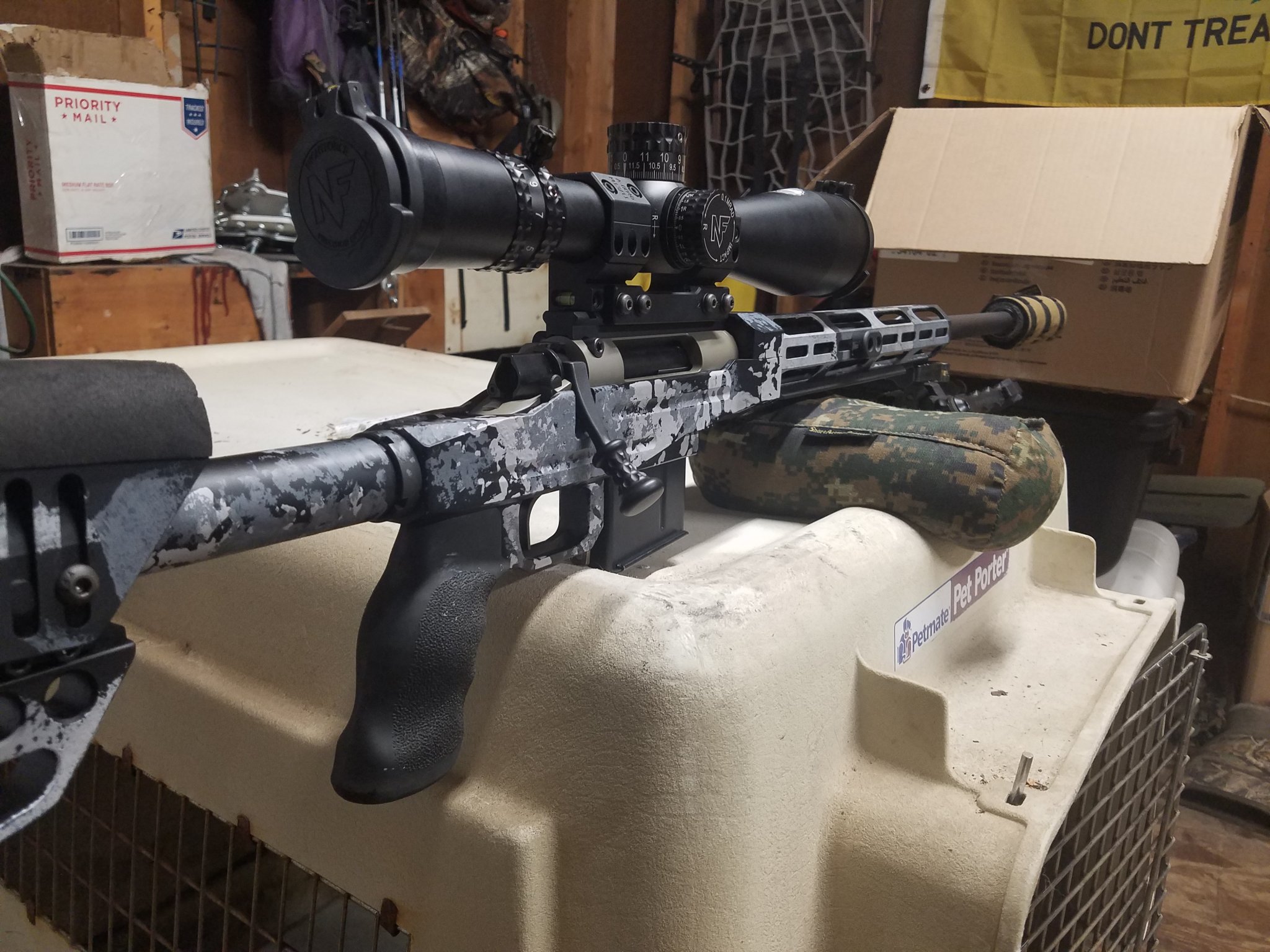

I've got a few PVA barrels and they are all lasers. be it prefit or shouldered. easy to do. I just put my PVA cut rifled rock creek barrel on to my Nucleus. You'll love it.
