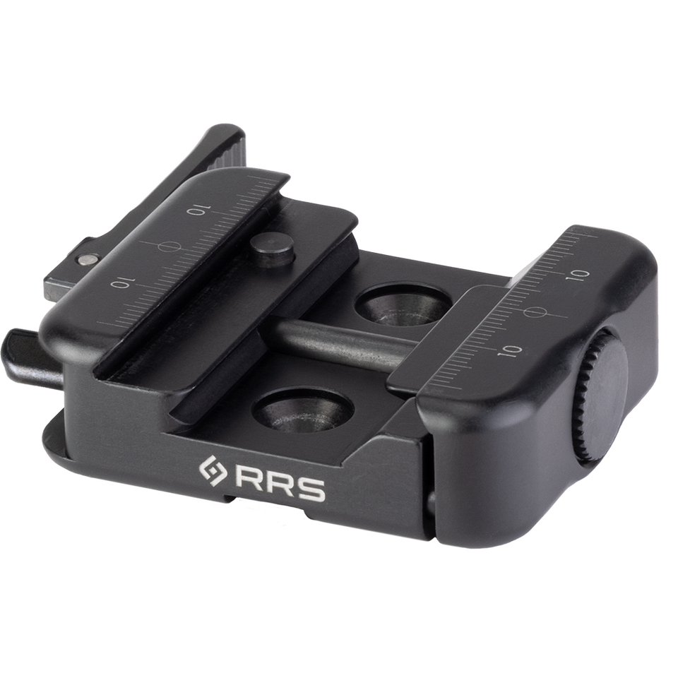

    For the bipod interface. Works with both. https://rrssoar.com/sc-arc
    I have an arca adapter for every single bipod I have, and I really don't like them. I wish they were all just arca instead of needing a pic to arca adapter and adding unnecessary height to the bipod. I don't think it makes me drop a point at a match, but I still don't like it.

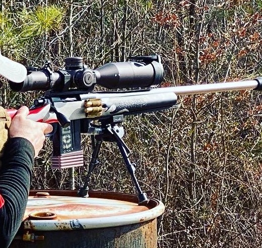

    just a bipod on the front? pic (think most hunting stocks)
    bipod front and tripod rear? pic front and arca rear (manners LRH)
    tons of possibilities with bipod/tripod positon? arca full length (any comp chassis/stock)

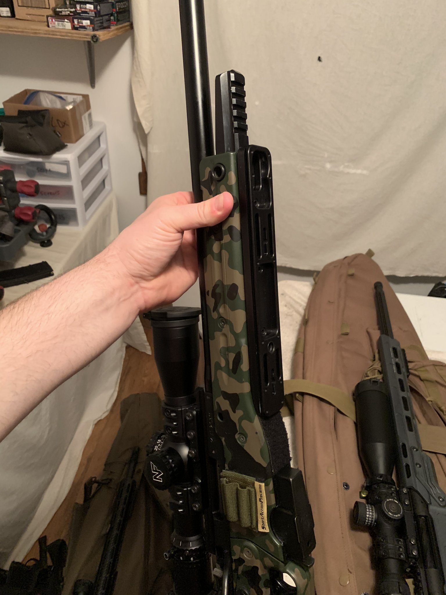

    I wouldn’t do that. I just put an Area 419 full length rail on my rifle and used the front action screw. It ruined accuracy. So I put one of the T-nuts just in front of the recoil lug and run it without the front action screw. I need to bed the rail to the bottom of the stock because there is considerable side to side flex in the system. With it being attached only at points along the center of the rail, that’s to be expected. But I’ve taken the rail off for hunting season and put a short pic rail up front. Incase it matters to you to know that. I have the RRS arca/pic hybrid adapter on my bipod

    @ryodlsl : Thanks for the included pic. That's a great setup!
    At this point I need to add an additional mount point T-nut to my stock if I want a longer rail. Thank you all who have responded!!

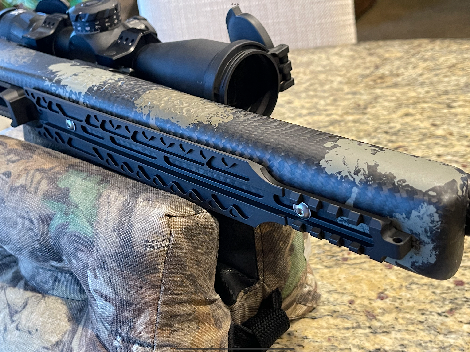

    There’s no issue with an ARCA rail that extends past stock of a quality unit. The Manners TCS are all like that and no issues. Same with the 14” Area419. I have used them at the end when needed and no issues with accuracy.
