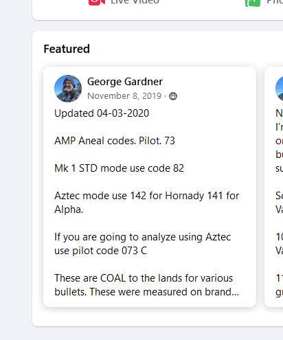

I'm needing the proper codes as well, for both the hornady and alpha brass.... burn that alpha and post that code :)
I'll burn a hornady case next time I have the AMP out and ready.

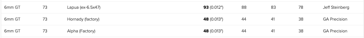

Here is a screenshot from the AMP website...
Thanks, I've reviewed what was posted on AMP's website. Which would lead one to believe that the thinner cases getting a setting of 38 versus the thicker (un-turned) necks get a AMP setting of 44.
