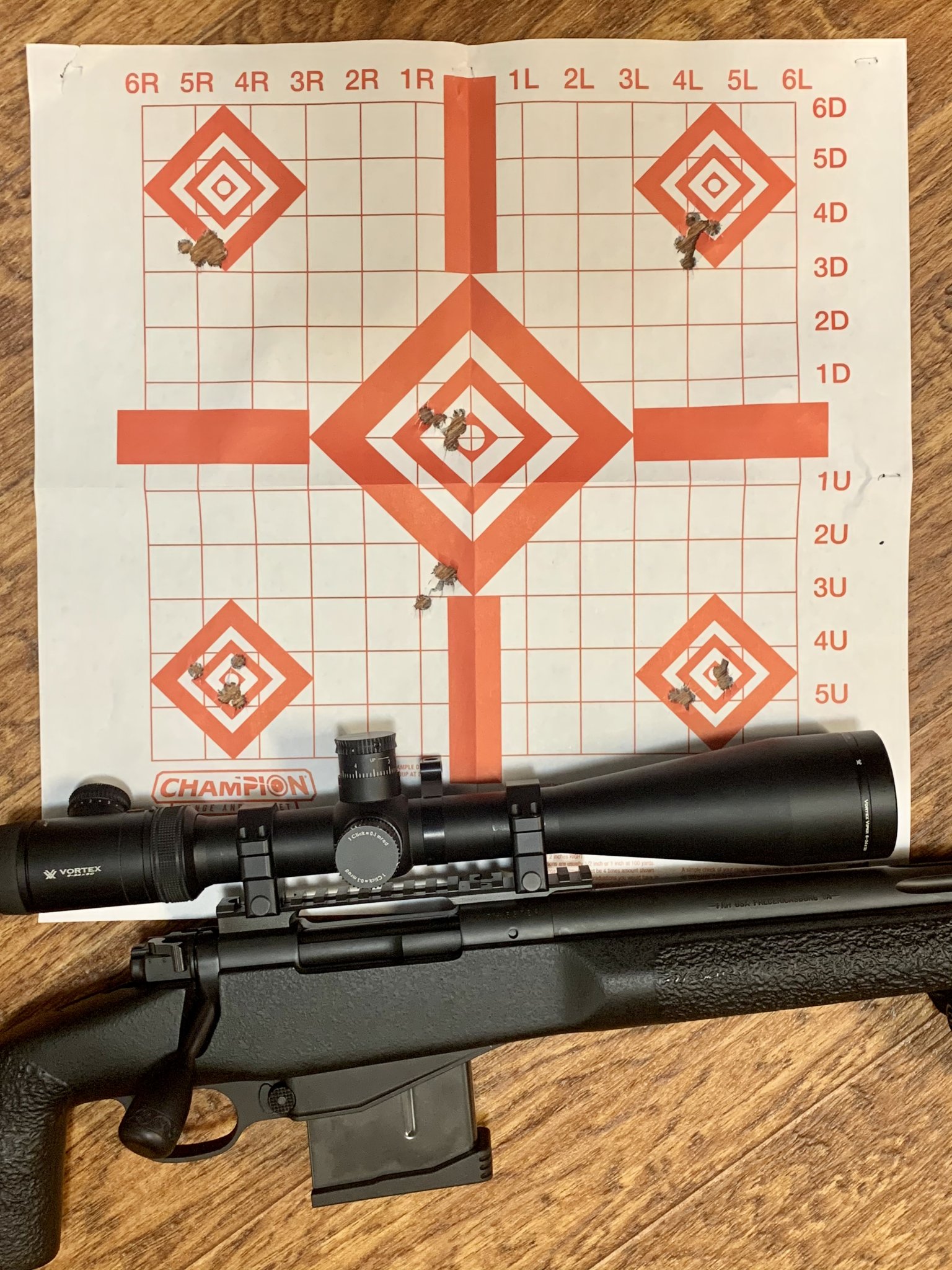

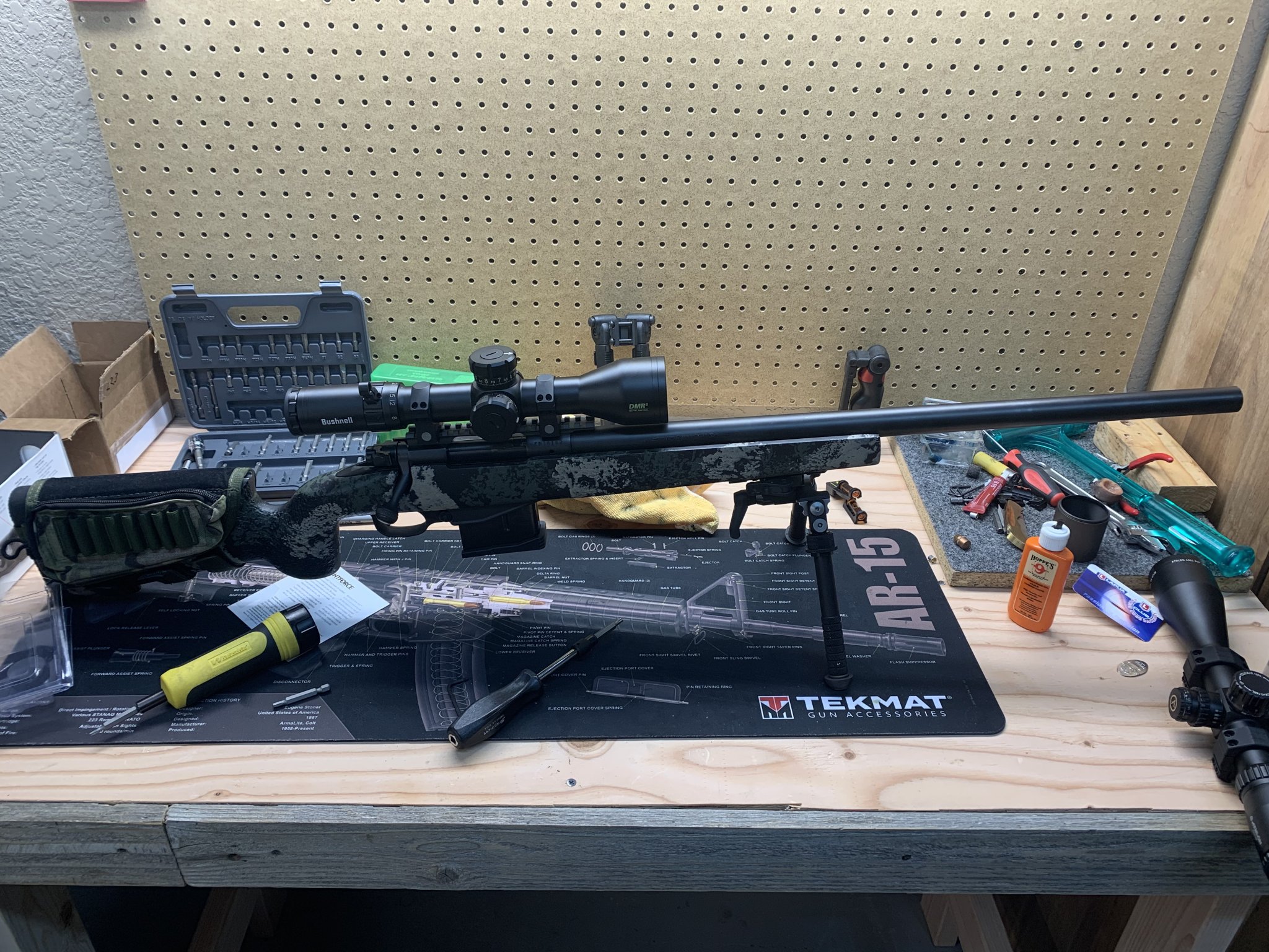

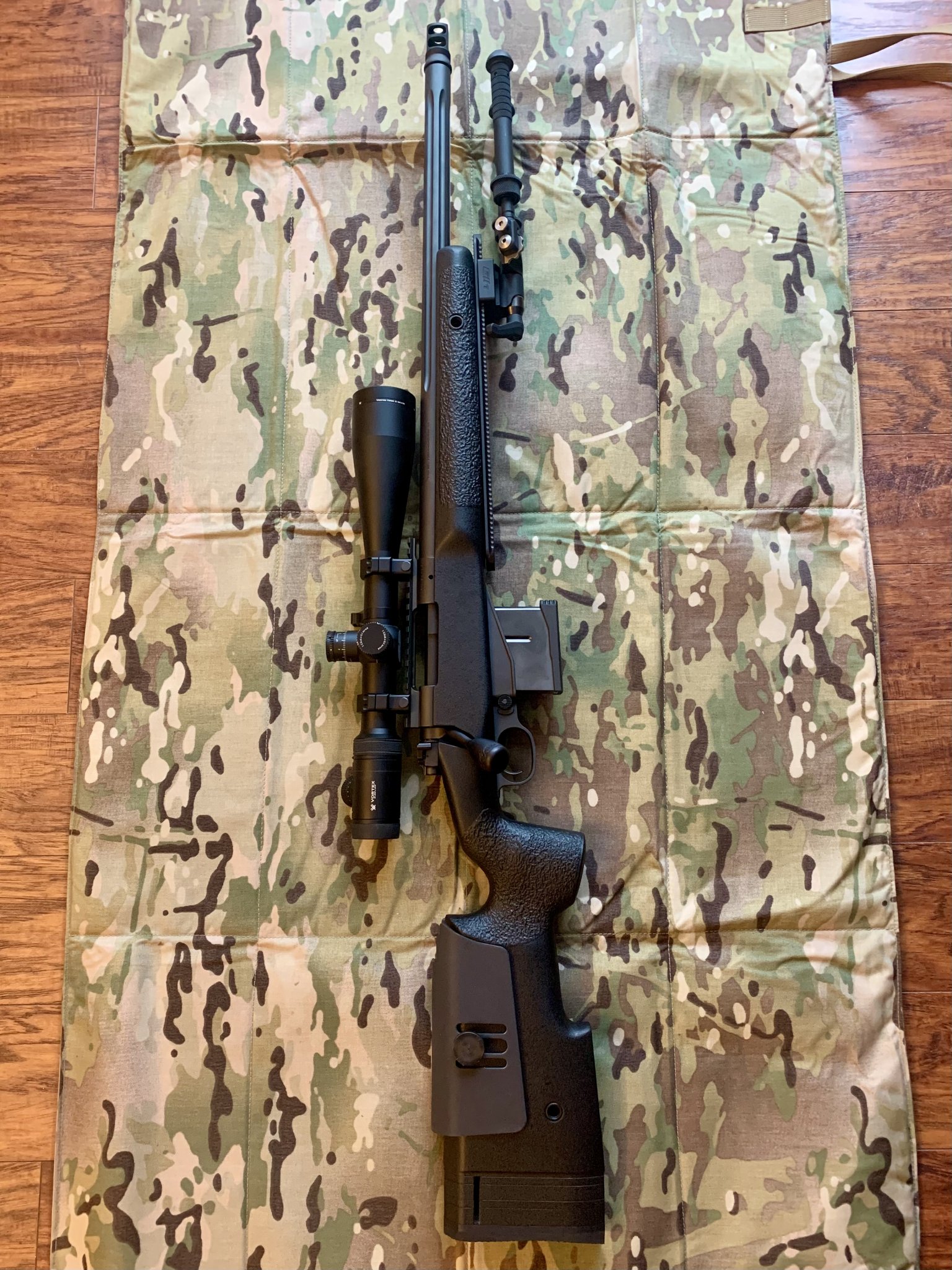

Got mine together for the first outing.
Temporarily swapped my Gen 1 Viper from my 22-250 just to get shooting. Will be getting better glass when funds recover. TBAC CB added for when the ultra 7 is finally paroled.
Have an 12” ARCA coming and MCARBO spring on the bench for when it gets taken apart for the ARCA. Picked up a few 10rd mags from MGW.

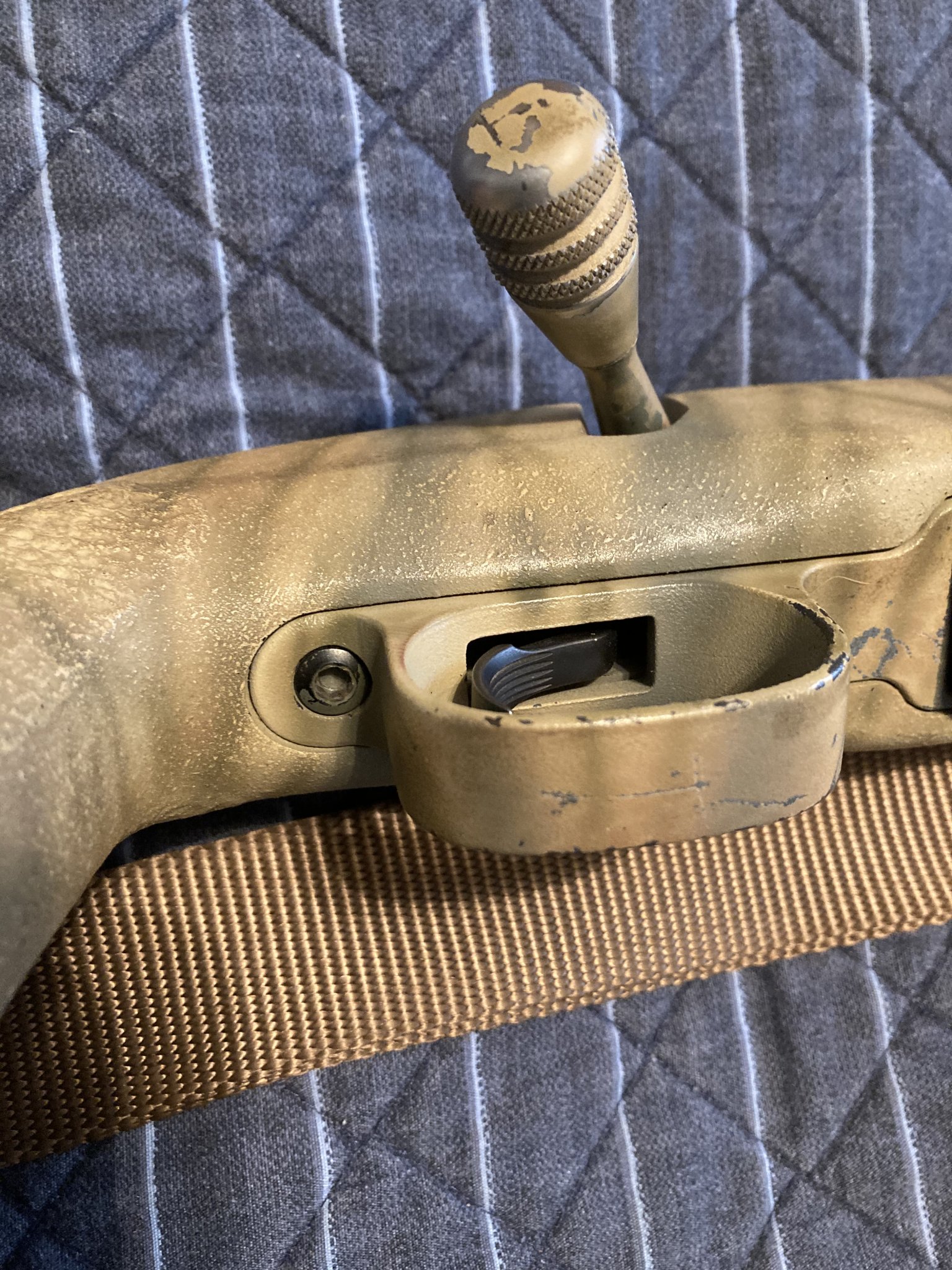

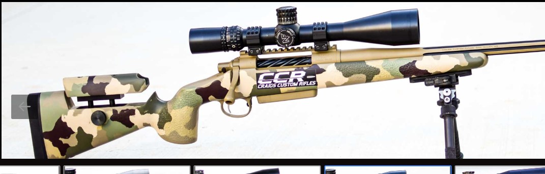

Considering a sponge camo but not to sure yet on my confidence of doing it haha.
175 SMK’s over Varget and IMR4895 to start.

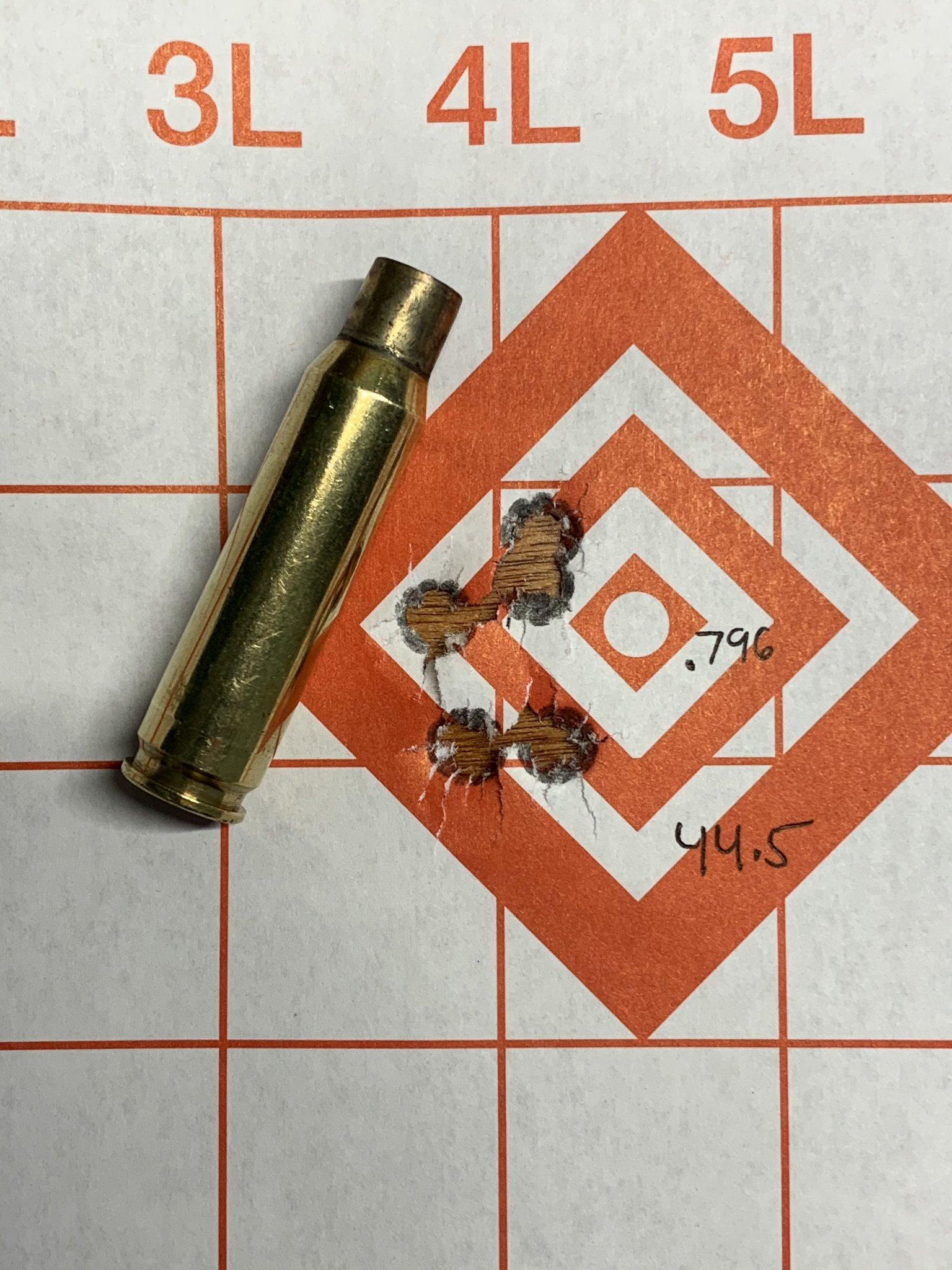

100yd prone. 175smk & IMR4895 @ 2648fps showing some promise. Little cool today 25f, 10mph gusting 15-18.
Varget was typical disappointment once again.

Highest probability if Varget isn’t behaving, you are too light in charge weight.

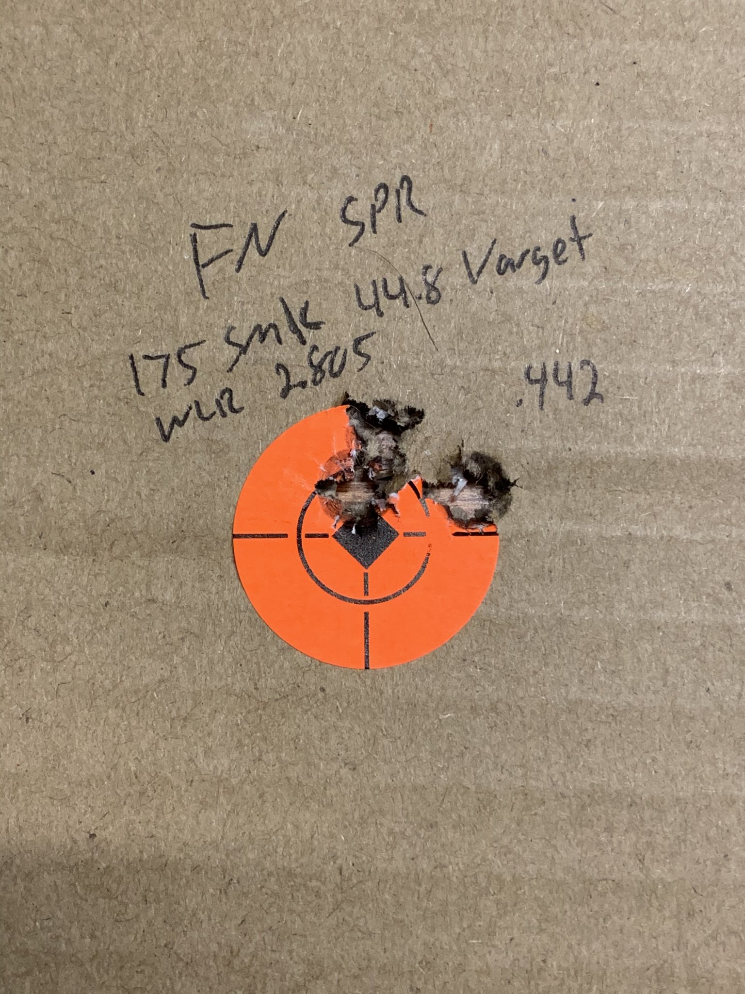

Went to 45 grains, 2630fps range.
It’s either lacked in speed or accuracy or both in 223,22-250,243, 308 and 375h&h for me. It’s strange because everyone raves about it. I’ve burned 3-4 pounds and never impressed.
Oddly, my FN's have done better with the 175 SMK over BLC-2. So I feed them BLC-2 and 175 SMK. Stay away from the ragged edge in the summer time.

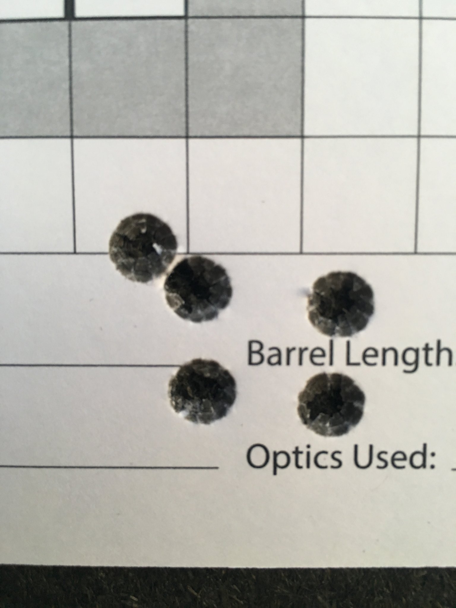

5 rds, 185 Juggernaut @ 100. Round out of group is in me, too much thinking about not messing up.
5 rds, 185 Juggernaut @ 200

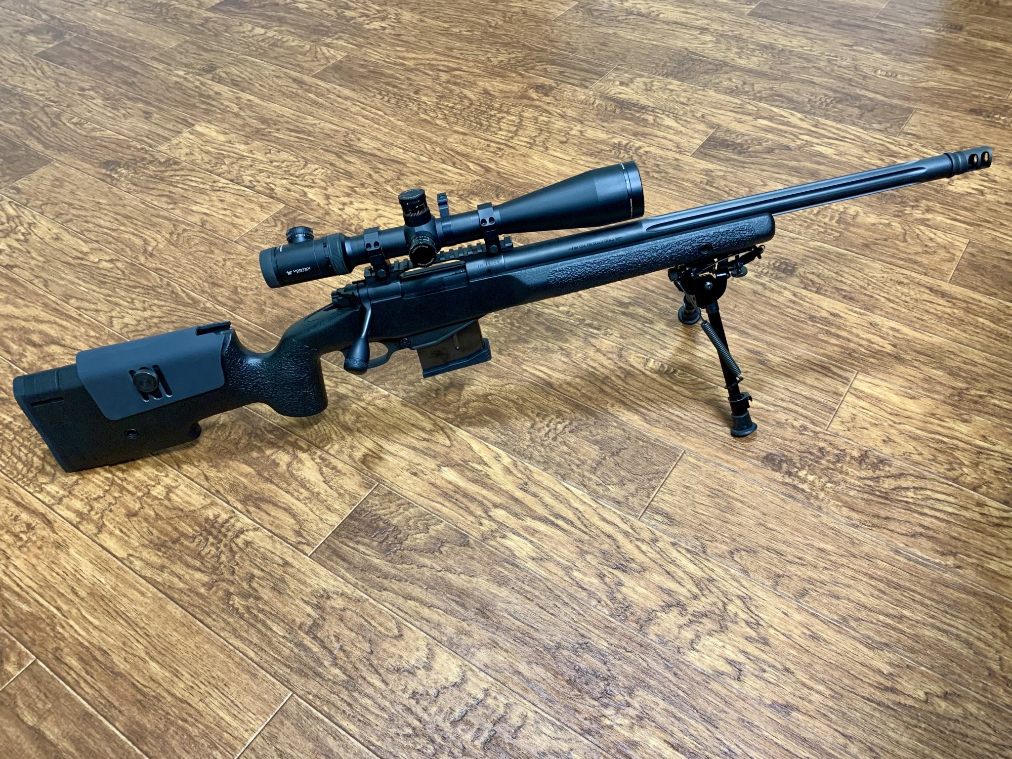

Couple of upgrades. 12” Area419 arca rail and MCARBO trigger spring added, 2.75lbs and smoother from the factory 4lbs. Looking forward to trying it with the Atlas.
Interestingly I was able to adjust the factory spring lighter than the MCARBO but it was inconsistent in pull weight when set under 3lbs.

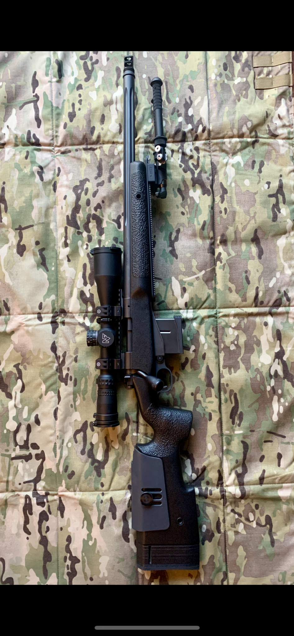

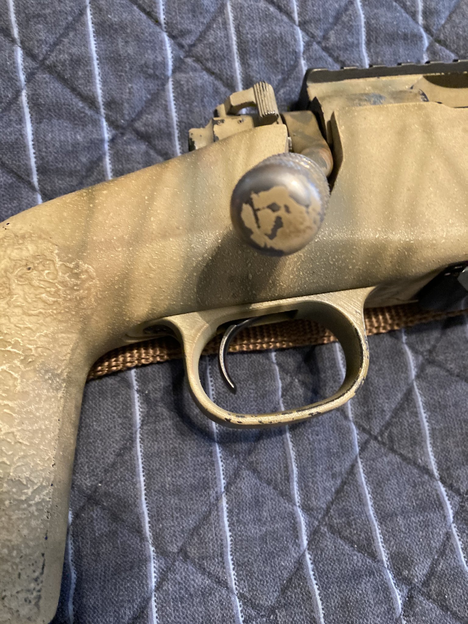

Mine SPR A5 XP has been getting some updates lately:

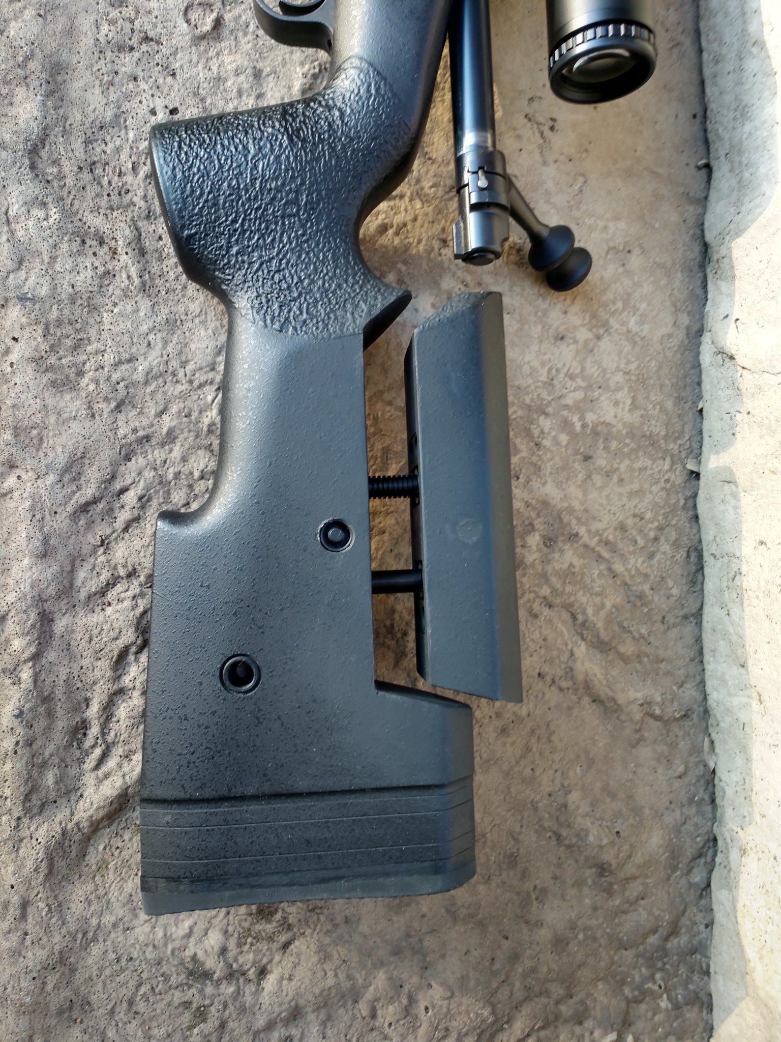

  1. I just got my A5 stock back from Joe Ducos, he replaced the saddle type cheek piece with Loggerhead hardware.
  2. I also had an Anschutz rail installed in the forend so I could install a hand stop for sling shooting and I've got a Atlas Pic rail section coming for easy installation of my Atlas CAL.

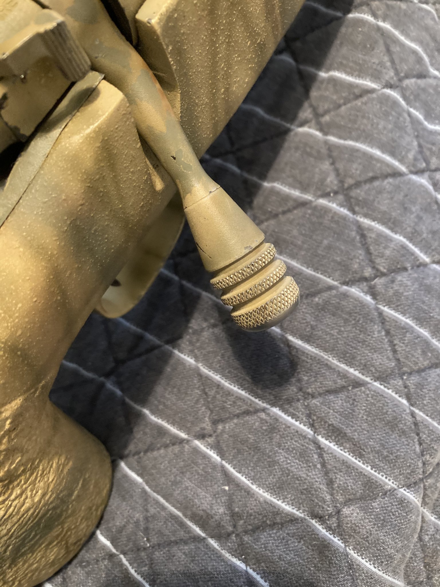

  3. I swapped the factory smooth teardrop bolt knob for an Area419 grooved bolt knob ( https://www.area419.com/product/419-bolt-knob/ ) This bolt knob mimics the feel of my ARC Archimedes knob.
  4. I swapped scopes, I picked up an Athlon Ares BTR Gen 2 4.5-27 on Black Friday. At less than half the price, the glass isn't as bright as my March scopes, but it is still excellent. I'm excited to have a floating dot reticle in this gun as well, it's my favorite type of reticle for targets and steel.
I'm thinking I might paint the stock just for some variety. When the weather warms up I'm going to rattle can it. I'm thinking either duck hunter camo or McMillan Camo. I still haven't decided yet.
Also, I've been shooting 2 stage triggers for so long that the trigger on this FN is starting to feel.....wrong. It's a good trigger, but I need to adjust it down. If I start shooting it more I may spring for a CG Xtreme 2-stage trigger for it. I had one of these on my Eliseo and I loved it. This would also allow me to move the trigger shoe forward to get better grip/trigger placement for my long fingers.

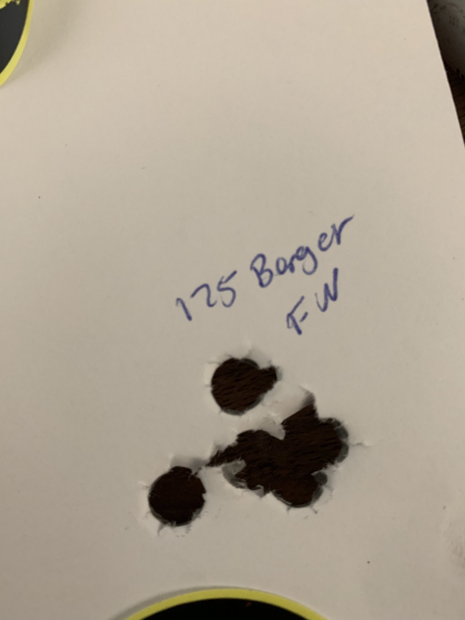

Factory barrel loves the Sierra 175 gr BTHP and BLC-2. Just make sure you do your load work up in the hot summer, and not the cold winter, lol.

Joe does amazing stock work, but do you have any photos of your stock after the Loggerhead install? The saddle cheek is one of my only gripes with the rifle, and I’ve been meaning to ask him if the swap was possible. I’d love to see an “after” photo! What did it cost you to get done?
Also, I too am a big 2-stage fan. What was your experience like with the CG X-Treme in regards to reliability and overall feel? I’m a huge fan of AI’s trigger, but don’t live on an AI budget anymore. That being said, I might spring for the CG if it’s worth it and can handle field/hunting use as well as comps. Anything you can offer there before I drop $300+ on it would be most welcomed!
If ya’ll are ditching the factory triggers, I’m in the market to buy one or two of them.
Reactions: stello1001

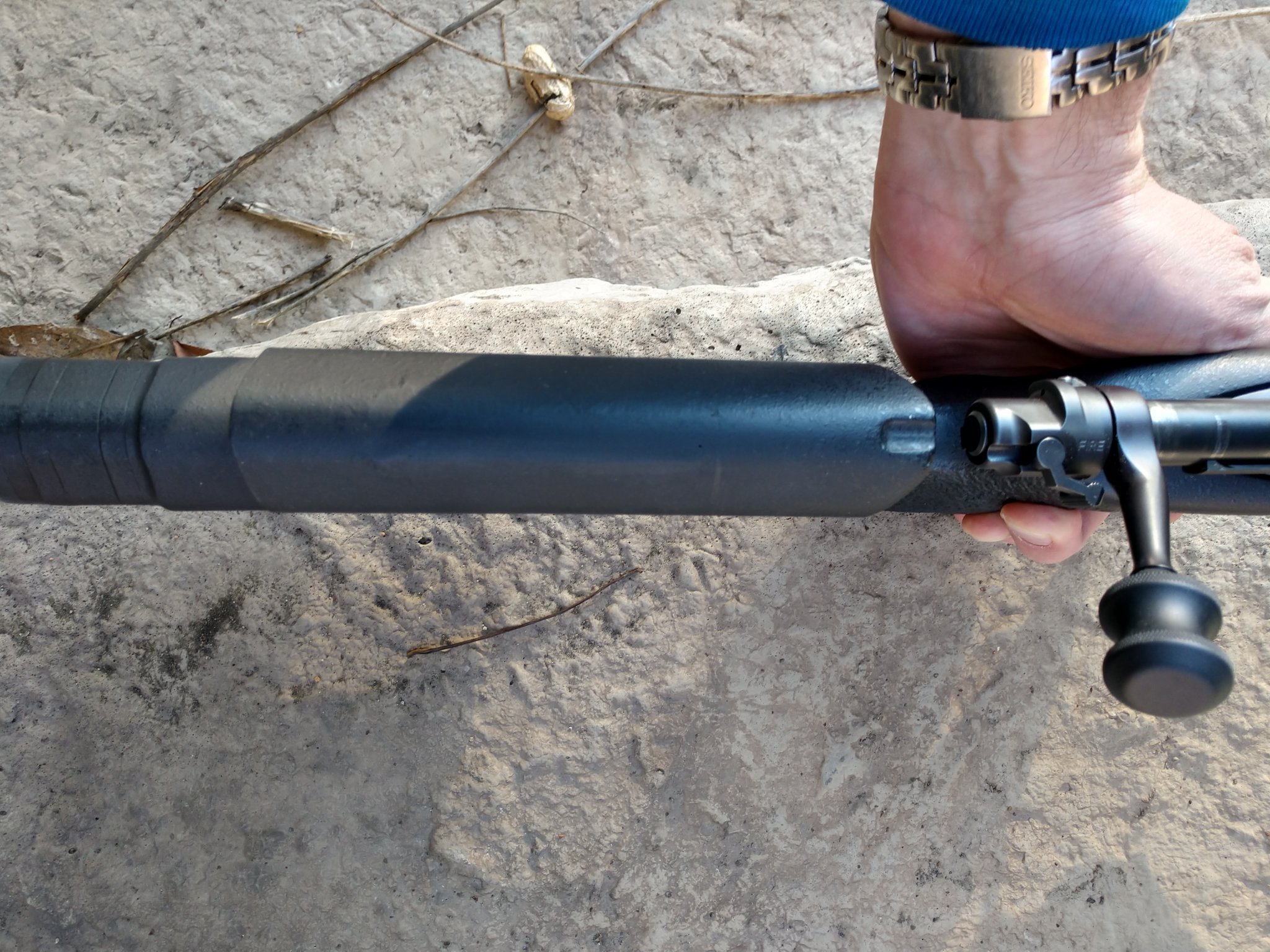

@Basher here are a couple of pics...
Typical Stock Doc work, looks amazing! I’ll have to drop him a note soon and see what he can do for me. The saddle works, but it’s not my favorite. Any thoughts on the trigger you can share? Are they truly worth the price of admission?
These are the bolt knobs I get made. Solid stainless and heavy. That mass and momentum makes working the bolt extremely fast.
