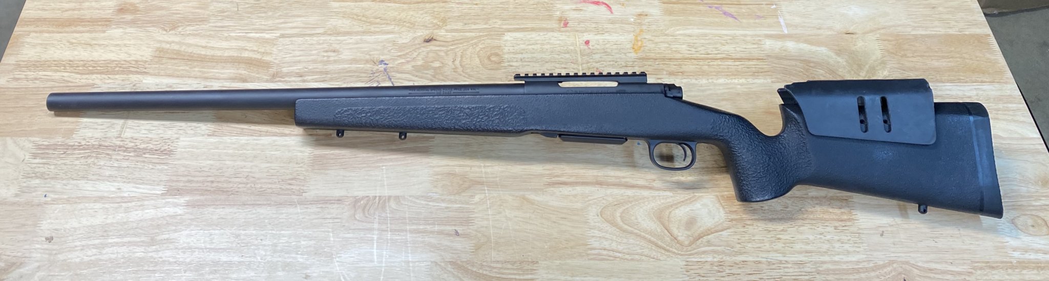

Winchester on the action, FN SPR on the barrel. There were 2 that were the proving rifles built on the LA - one FN has, the other one is floating out there somewhere, and I guarantee FN USA knows where it is. I can probably get a decent picture of my roll marks if you were curious.

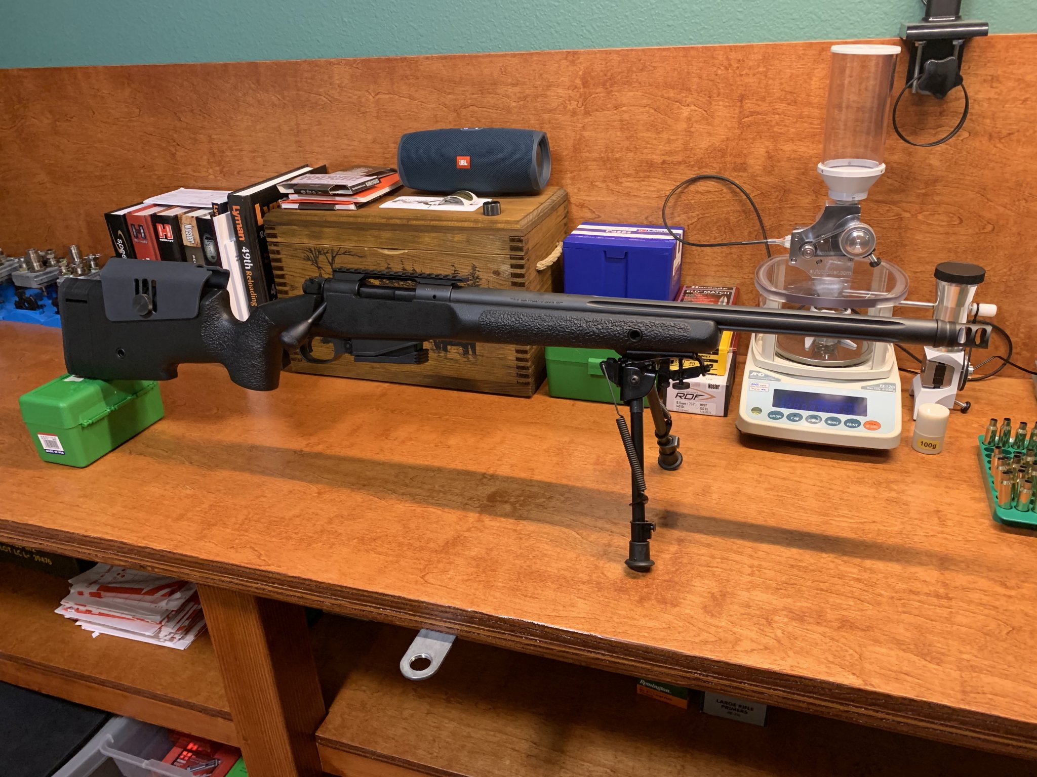

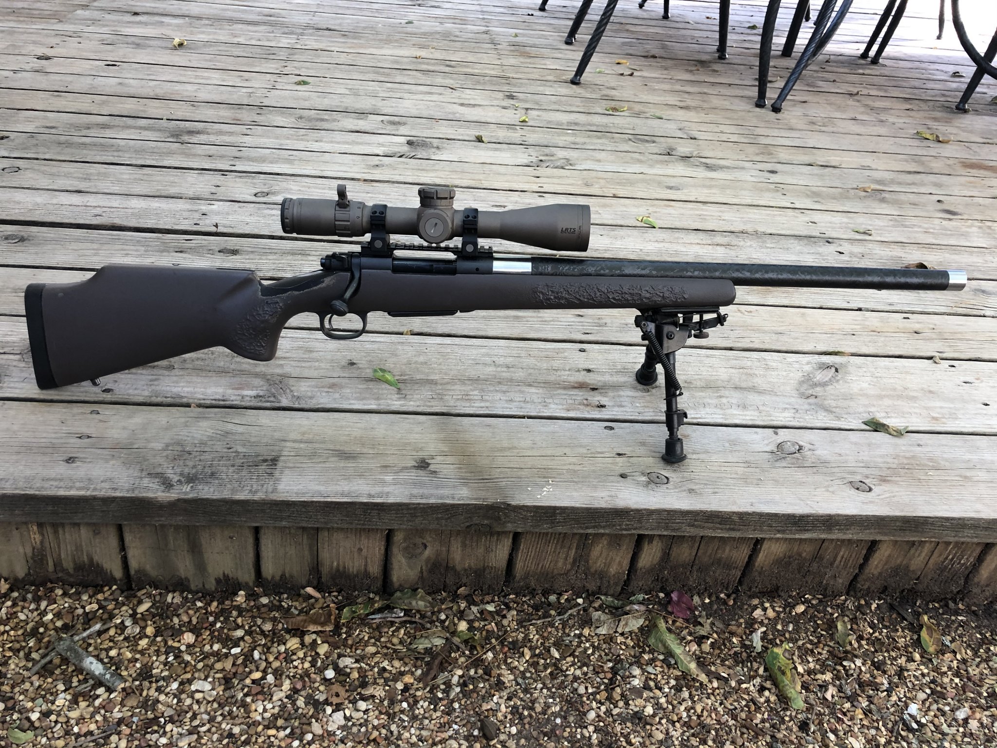

I just got this A1 for a good deal. She is portly but just feels right.
I plan to have a local Smith thread and do the bolt knob but could use some help with bottom metal. My old go to was CDI... Godspeed.

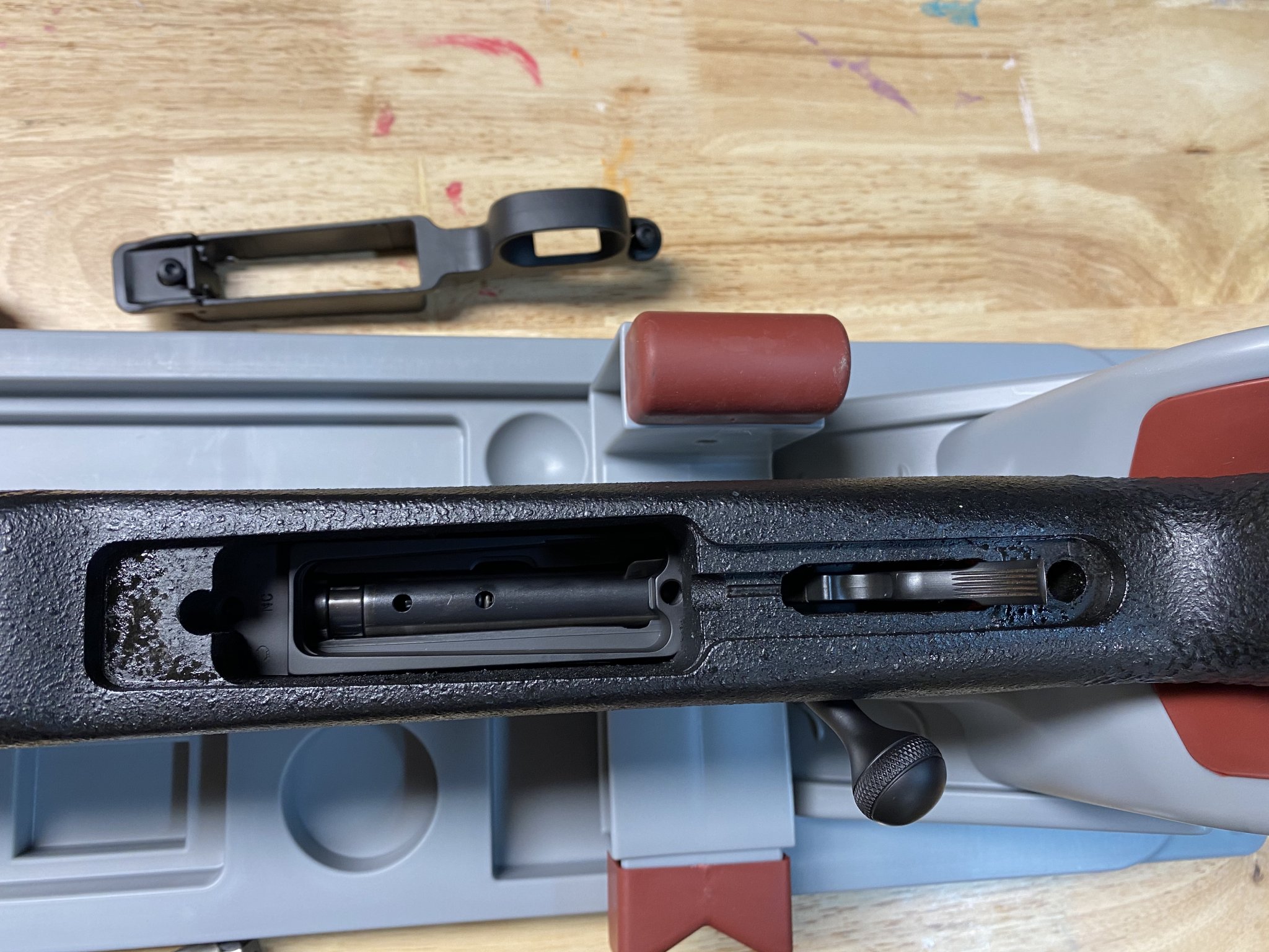

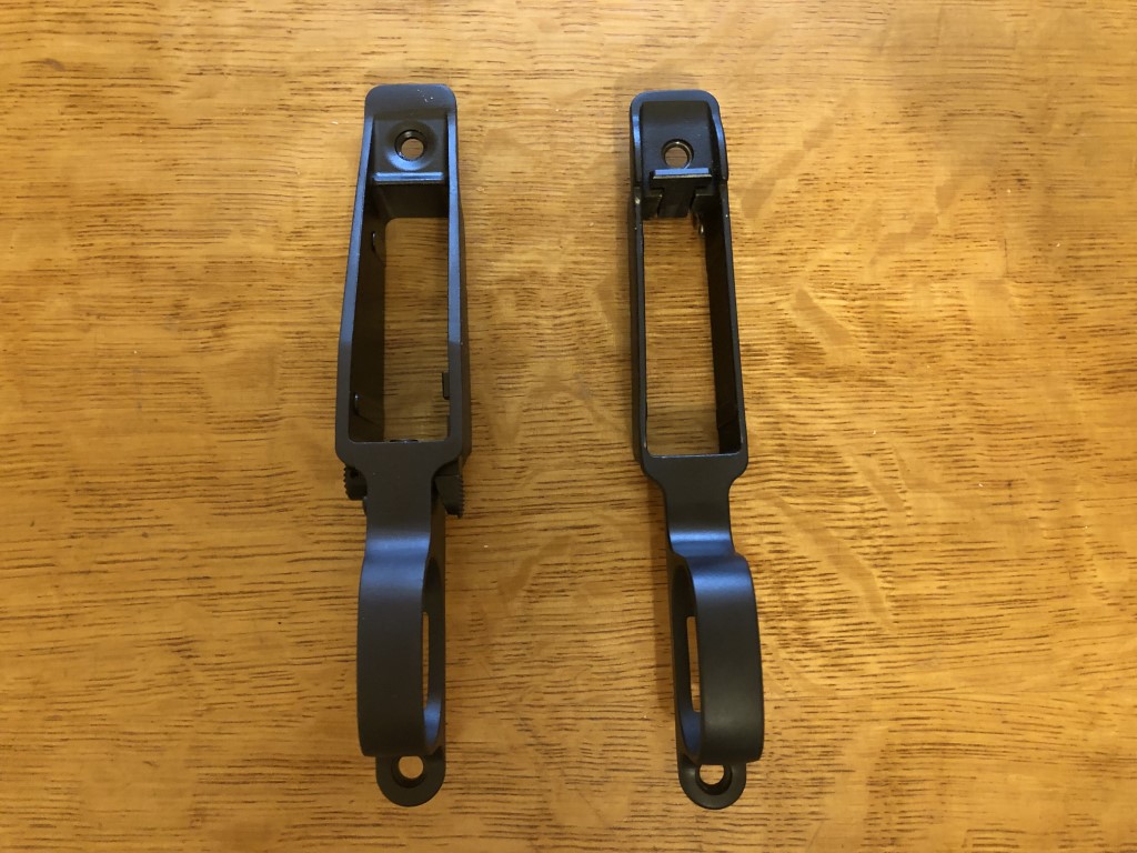

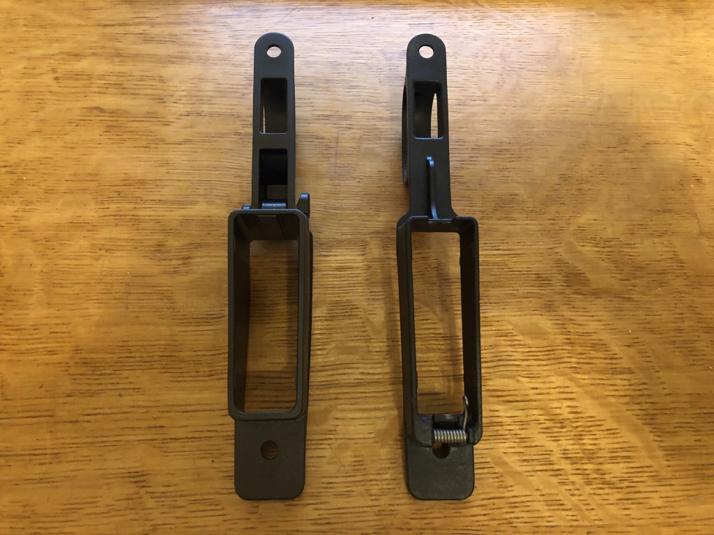

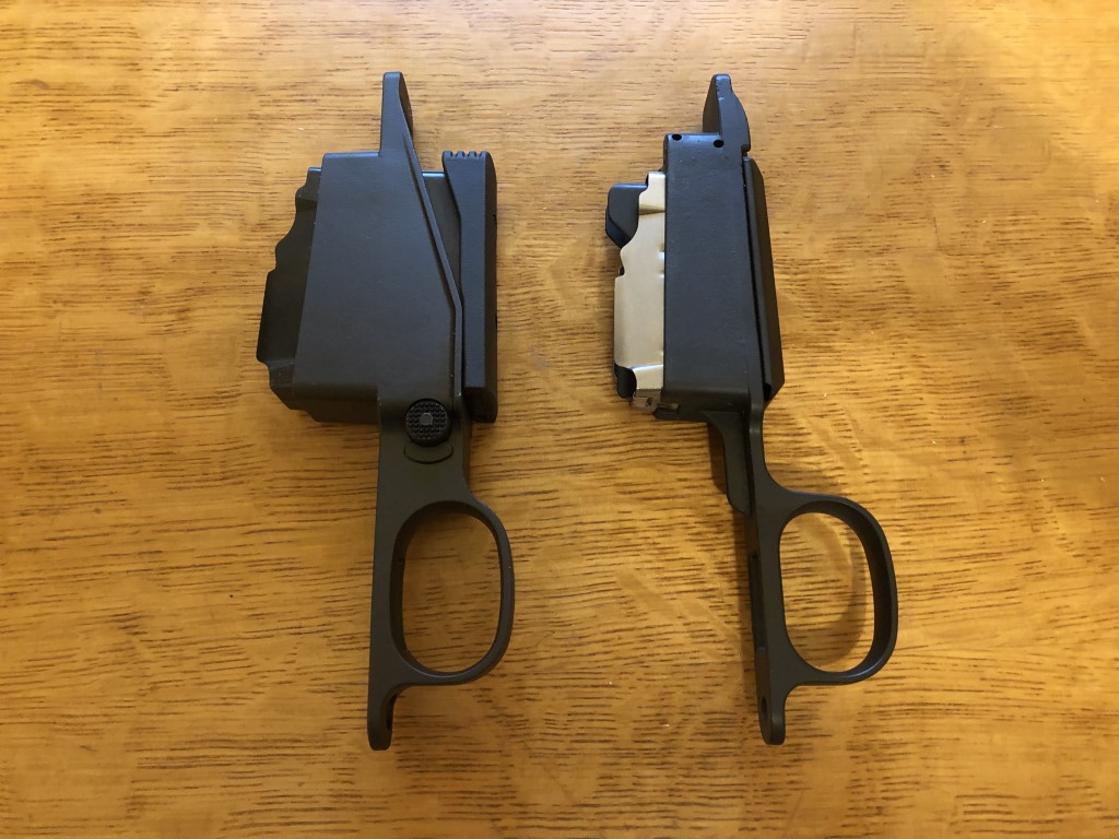

At the moment, you can either buy the bottom metal kit from Midwest GunWorks or take a shot at finding one on ebay, or use the really shitty one from PT&G. Using the FN bottom metal limits you to the 10 round mags, BUT you don't have to modify the AICS style mags. I have also heard of a possible solution coming from @LongRifles Inc. but i can't seem to find the story there. I use the FN bottom metal on my match gun with the FN mags and have no problems at all!
There was a guy here in Missouri selling the TBM bottom metal with a brand new OD green hogue stock on eBay for $75. I bought 3 of them. Might check it out and see if they are still available.
To be clear, these are direct drop ins even with the older mag system installed?
I literally took the 2 screws out of my bottom metal on the McMillan, pulled the barreled action, dropped the FN DBM in, reinserted the barreled action and torqued it down. Total time, about 3 minutes. I still have the green Hogue that he shipped with the DBM floating around if you would like to see?

That's not the TBM. That's the older style detachable mag. But the TBM should work. I was thinking it had a different footprint but dug one of each out and while slightly different mag box size, both seem to have the same outer footprint. Maybe someone w/ more experience swapping them will chime in. If you get the TBM and it doesn't fit, you could probably easily get your $ back out of it here.

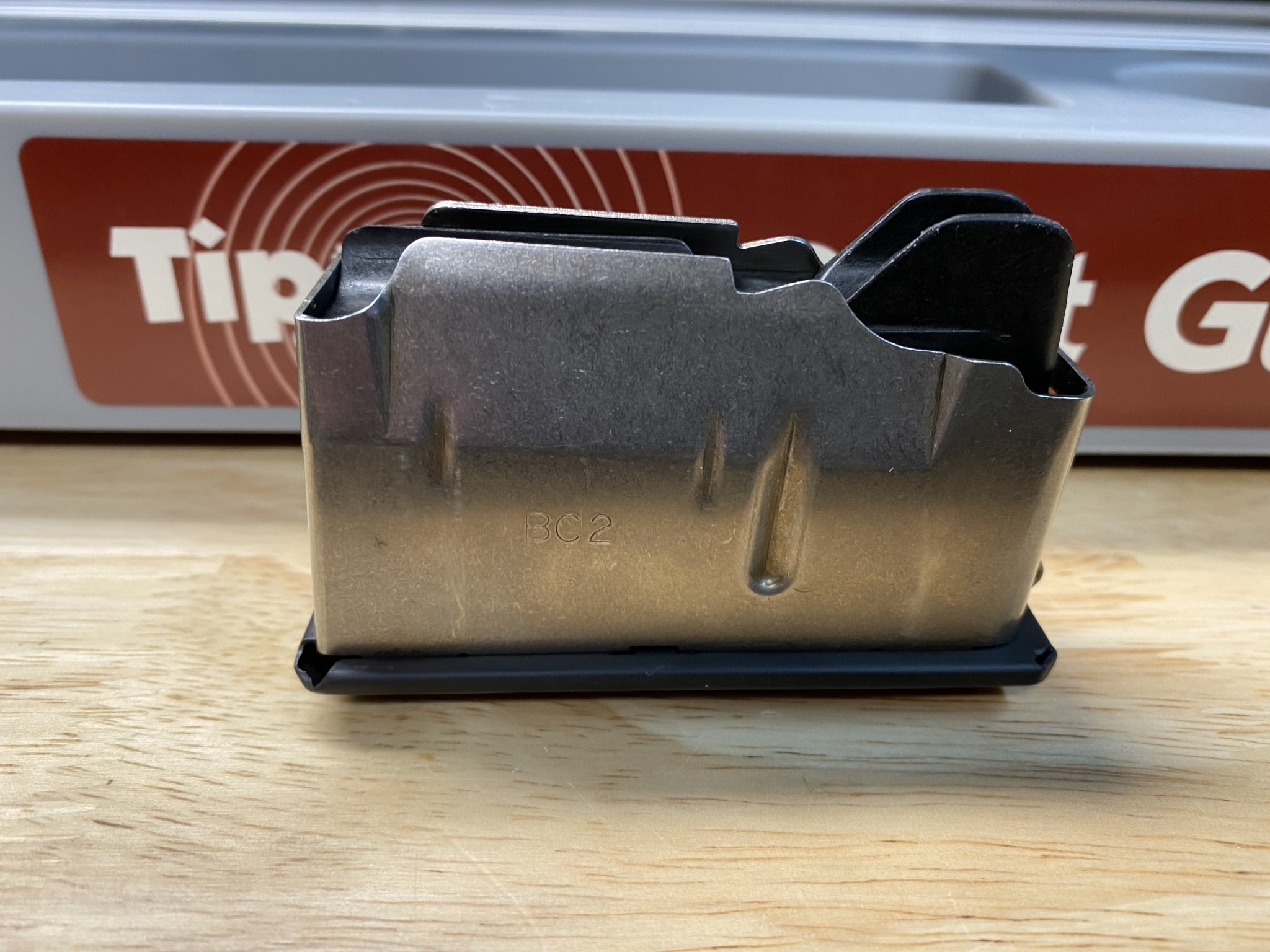

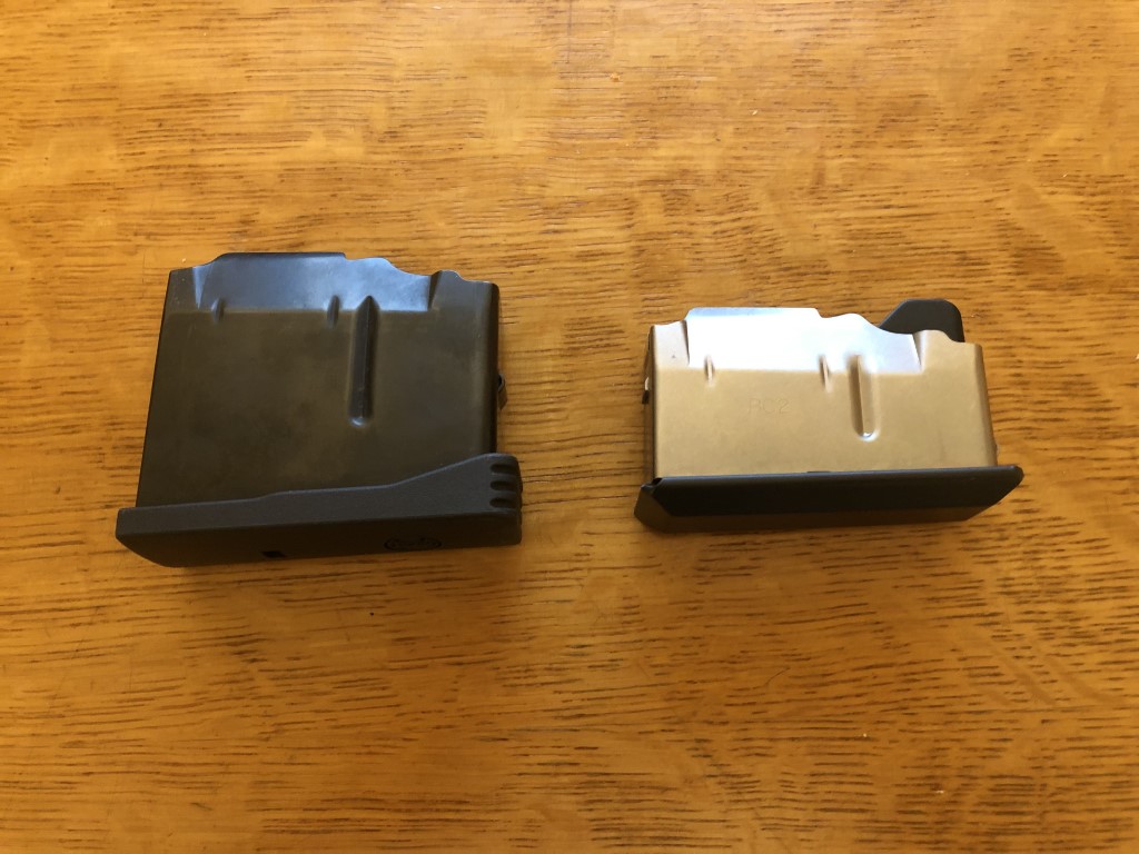

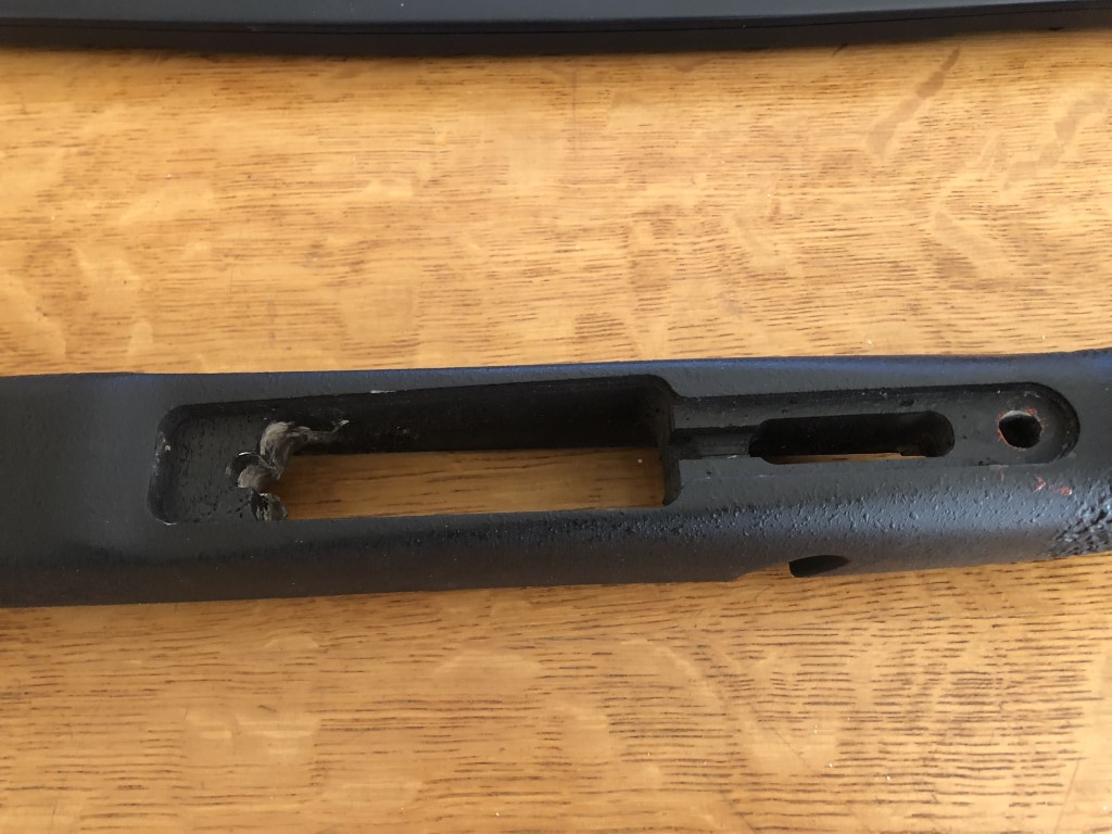

Those of you with a TBM, are your mags wobbly in there? I got a TBM and 2 mags, one 5 rounder and one 10 rounder. Both will click securely into place but still have a lot of play and they wobble.
Also, if there is some pressure applied to the mag from the bottom, the mag moves upward into the bolt a bit. I do not know if this will be a problem. My stock is not yet cut for this bottom metal so I was not able to run a few rounds and see if the there could be any potential problems.

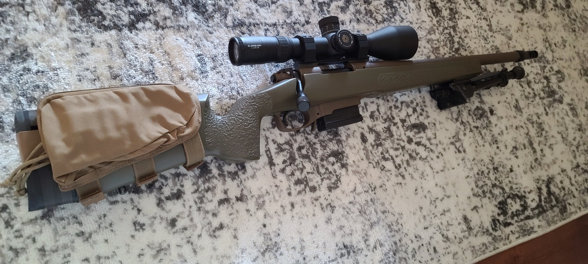

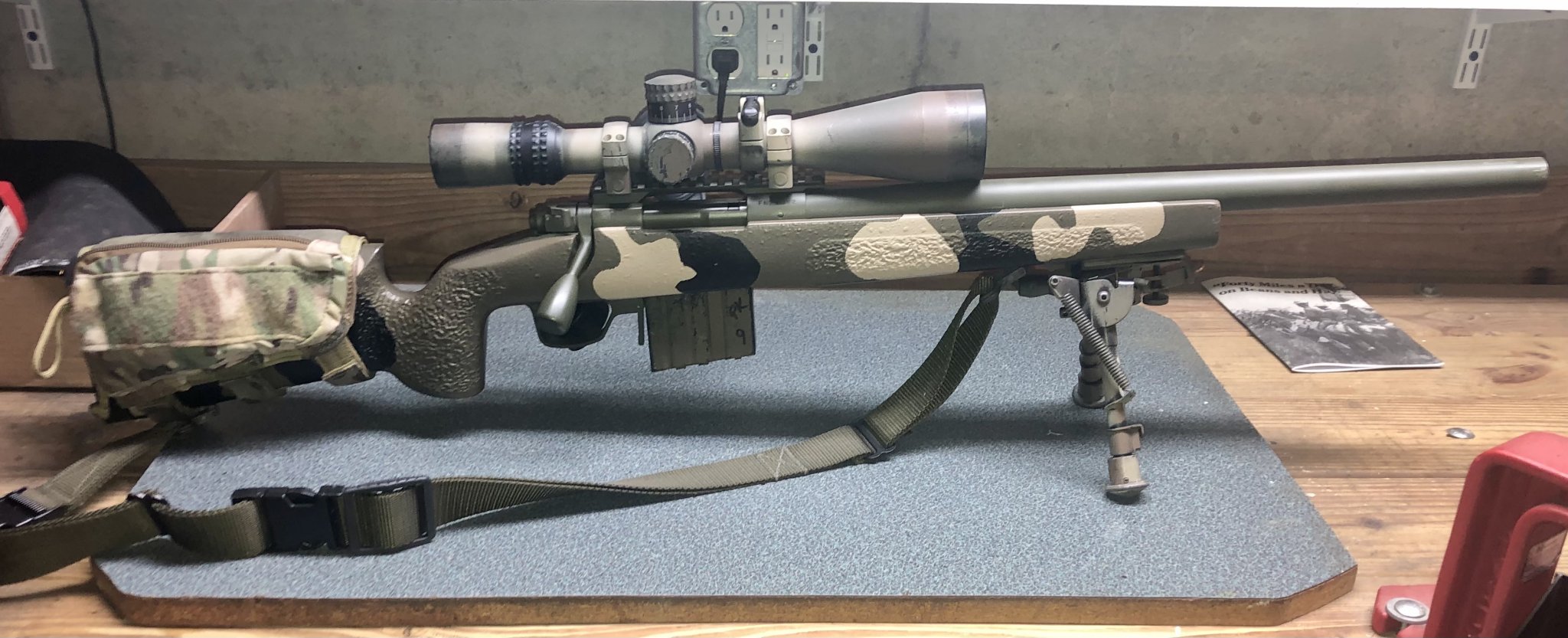

Picked mine up yesterday, just in time before heading to work for 3 weeks. Had to see what the CB brake is gonna look like, no time for decent pictures.
Pondering on glass now, not wanting to do ATACR money, but used NX8.... Brownells MPO... hmmm

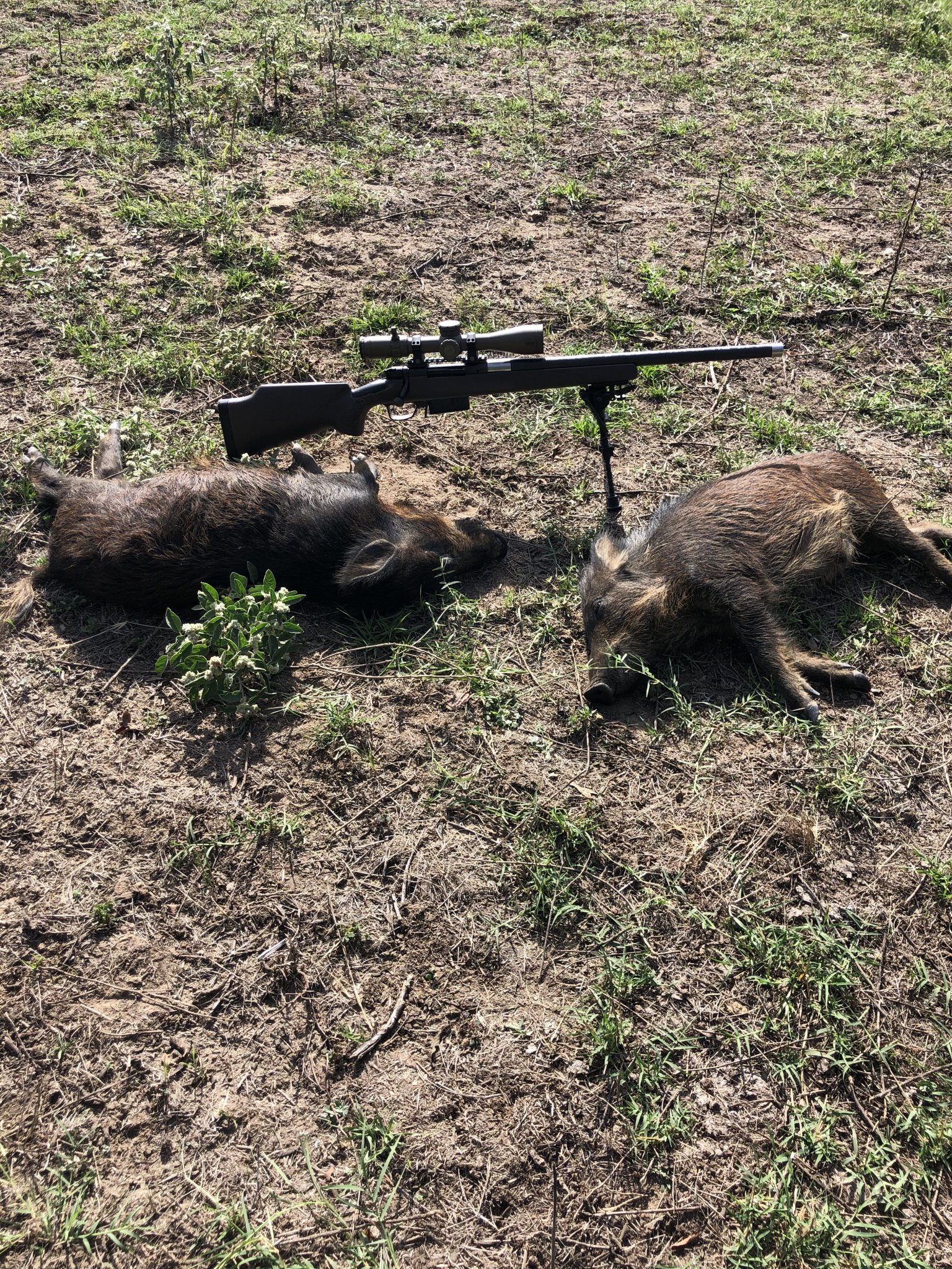

Have killed 15 in the last month.
got a doe Sunday morning and nice 8 point this morning.

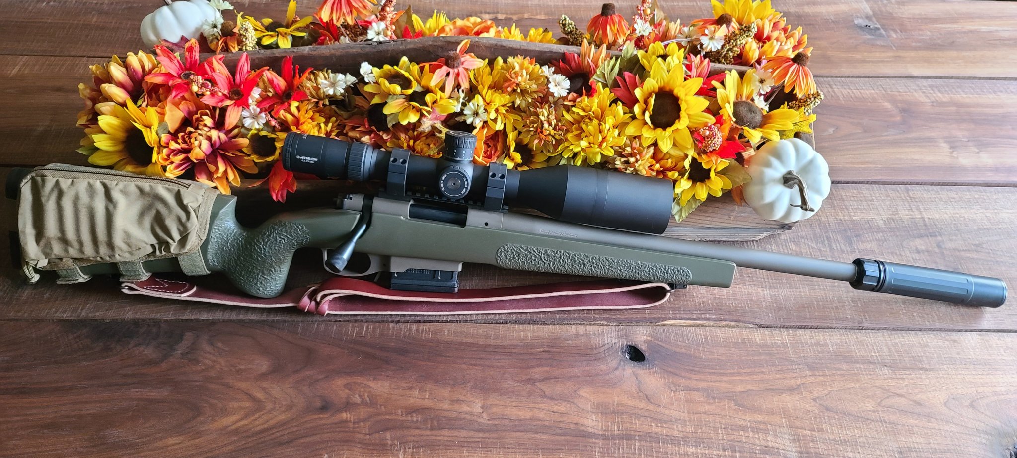

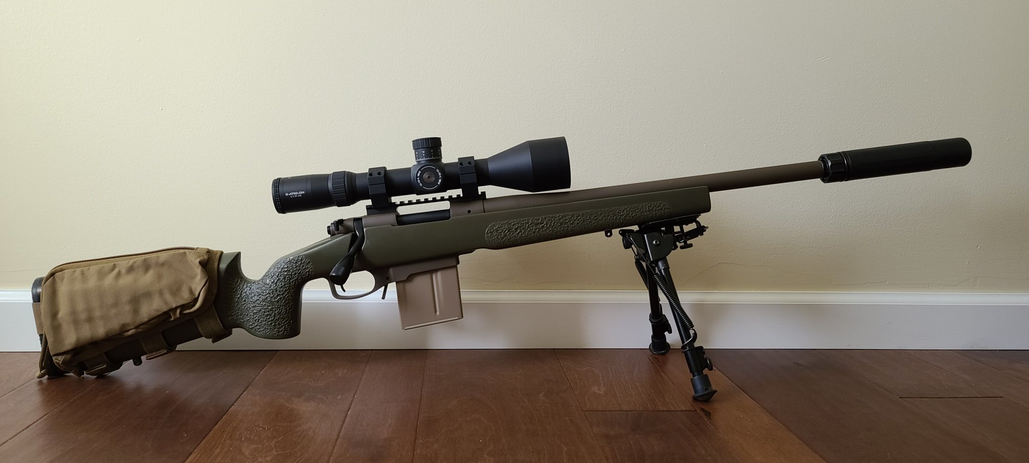

FN SPR rebarreled to 6.5 creed with 22” proof carbon. 10.5 lbs ready to hunt.
