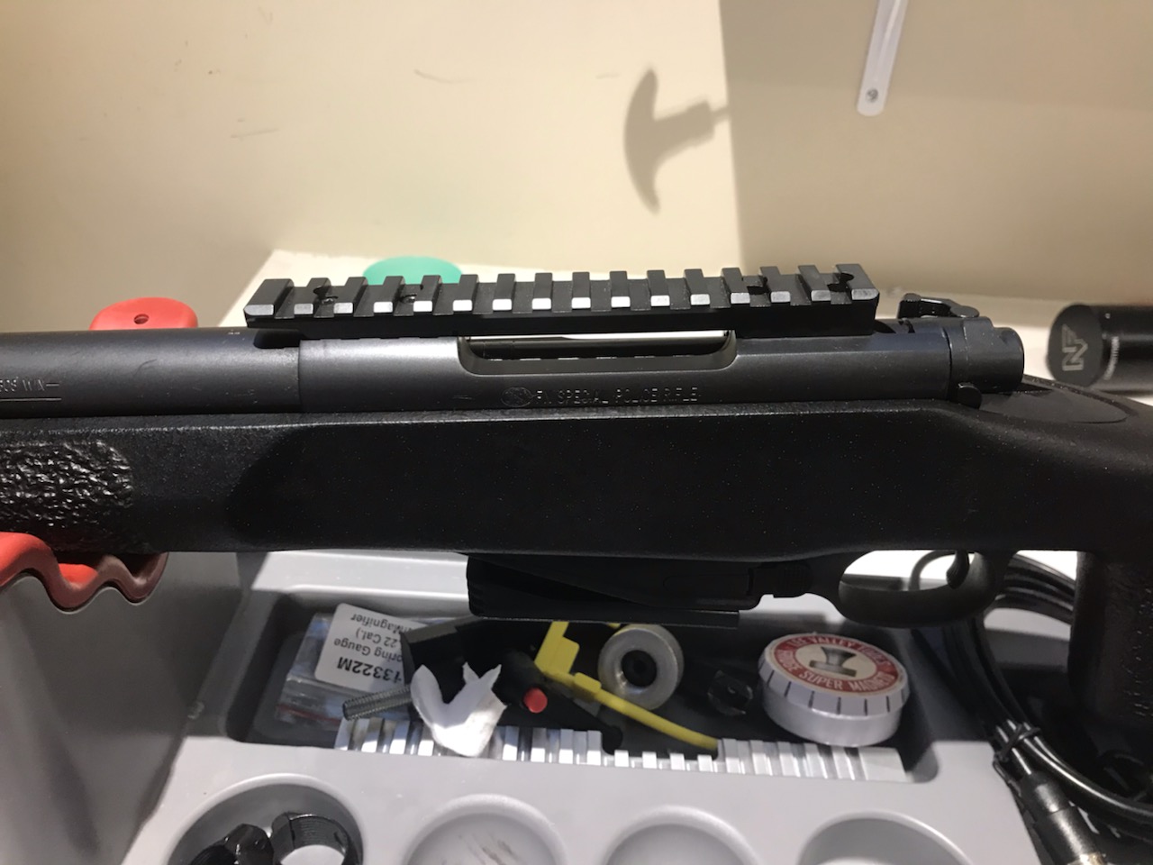

Well I bought the last 5 round spr mag .
3 others at midway .

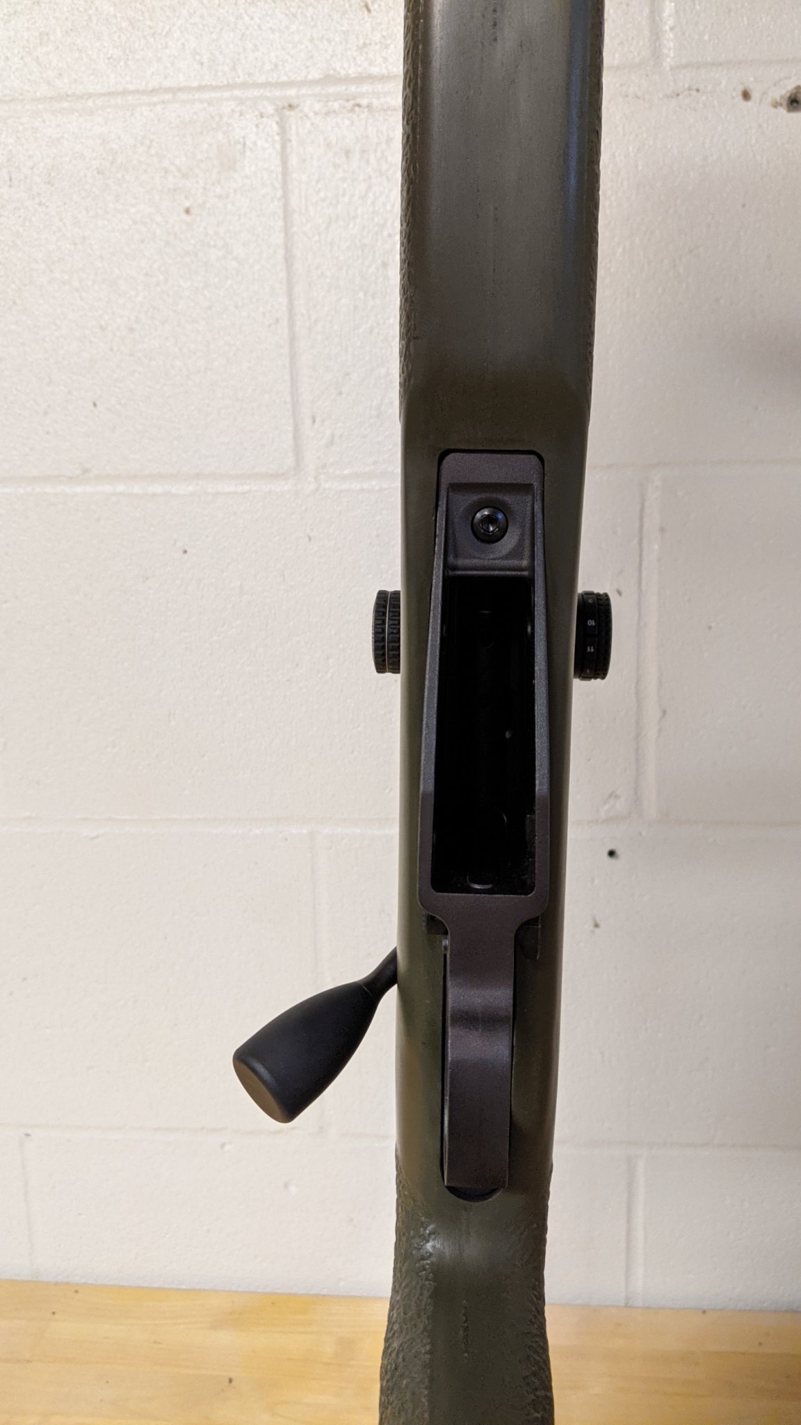

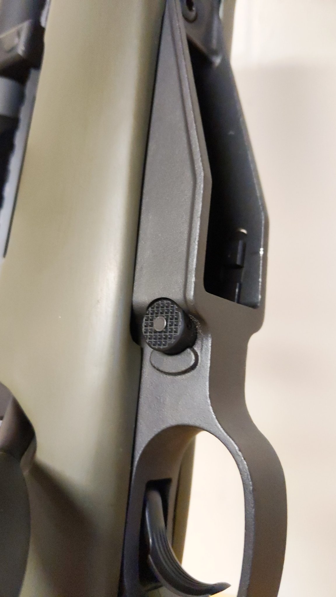

So if I cant find magazine...any options for an internal box magazine for the fn sprs?
I would think that any model 70 short action internal box magazine would work ...right?

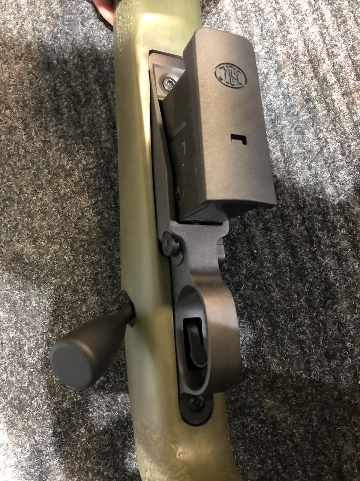

Is that the cci bottom metal?
It’s the PTG proprietary 5 round detachable mag. It’s not compatible with any other magazines. Originally I had the BDL internal mag system. Another Hider was looking for the BDL system. So we swapped. I planned from the beginning to drop this into a chassis, so I didn’t care about the crappy proprietary 5 round mag. Then life happened, but I’m back to slinging lead with the FN.

The PTG bottom metal that accepts AI mags is still available. Might have to do some minor inletting. If using a stock that is the route I would take. The AI pattern magazines are widely found and better in function.
That is great news. And no modification needed on the receiver itself?
I thought that was for the ai mags, maybe it was a byproduct of the cdi metal.
Depends on the mags. Some yes, some no. I think the new generation MDT metal double stack center feed mags work, but not sure. Their polymer mags work according to the last time I talked to their tech support.
Take me a few days, but I’ll try and pull my stock FN receiver out and mock up a MDT metal mag and see if it clears.
edit: just checked, nope. Have to clearance the front of the receiver mag well ever so slightly to fit the MDT metal mags.
Thanks for checking!.
It's great news though that the proprietary ptg 5 rounders work, which look like the old AE MK 1 mags.
A bit pricier than the FN 5 rounders, but it's good to have options in case FN halt the 5 round version.

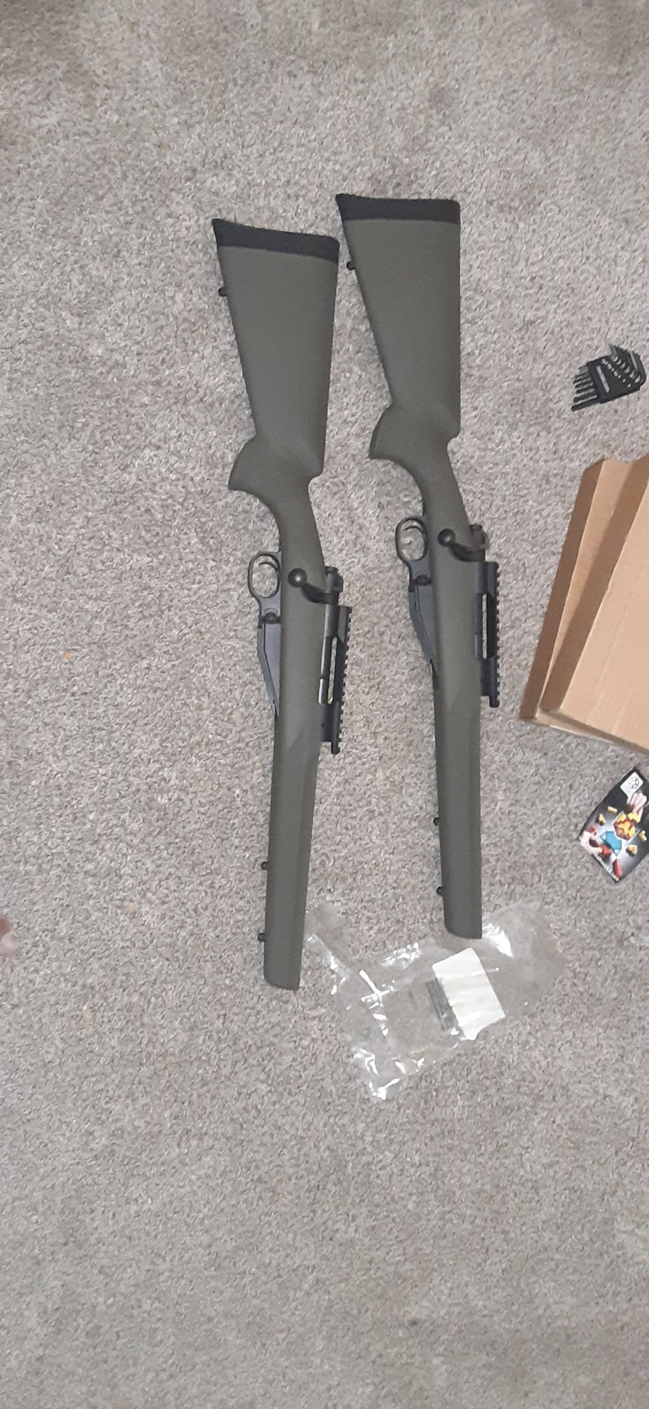

Picked up one today in Canada with 70 rounds down the pipe, 1 x 5 round and 1 x 10 round mags
pretty excite.
going to top it off with SPUHR rings and Minox LR

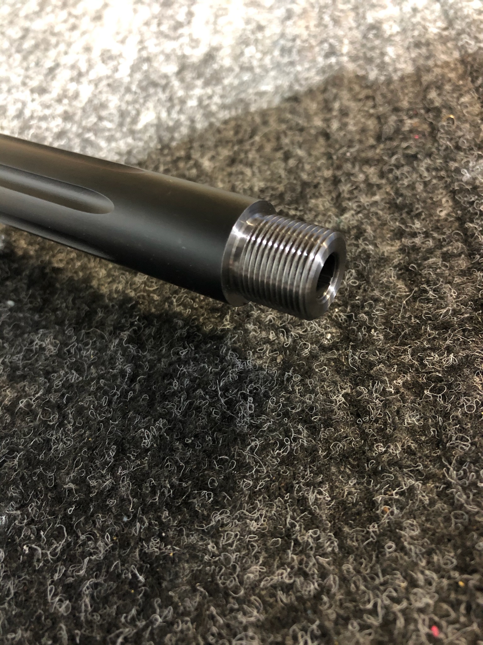

Anybody getting rid of a chrome lined FN SPR barrel?
Have a lead on one need a second one
Whats your plan with the barrels? I have one off an a3g (keeping it). Reason I ask is I have a spr action and all the parts to put another a3g together. I posted my intentions but was told that the likelihood of that barrel fitting the spr action was highly unlikely. So saving it to out on original action that is currently wearing a 260 barrel.
Similar idea. I figure spin it on and check with a go/no go gauges and see..either it will work or I will have a chrome.lined paper weight.
Now I did check the pre64win website and they sell old pre64 barrels for pre64 actions. And they have a barrel fitting service which sounds like they can make a takeoff barrel work on an action.
I emailed them to ask about if its doable with an fn spr takeoff barrel and a different receiver. May also check with moon or chad.
Not expecting a diy spin the barrel on and go kinda thing, but I wonder if a amoth can make it work.
I have absolutely no idea how to gunsmith or fit a barrel to a receiver but I've heard these barrels have a relief cut for the claw extractor. If that's the case and a take-off from a different rifle doesn't fit or time perfectly, can't you set it back a bit and start from scratch like if you were doing a new barrel?
