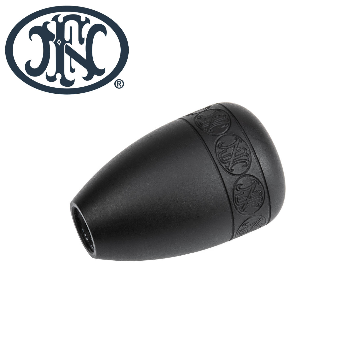

Can anyone recommend a good place to send my FN SPR bolt to be upgraded to a larger, tactical bolt knob? Also, if you have pictures of work, can you share?
Thanks,
One Holer
Hit up SAC. I think I had a week turn around on mine a few years back. Perfect fit and finish.
scroll up and you’ll see the pics I posted. That knob is their handy work.
100/10 would contact them again if I had another knob to do.
Reactions: One Holer
Hot up SAC. I think I had a week turn around on mine a few years back. Perfect fit and finish.
Thanks for the info.
Mark at Short Action Customs did mine over a decade ago. The work is amazing and would absolutely recommend him.
Thanks.
Reactions: M8541Reaper
