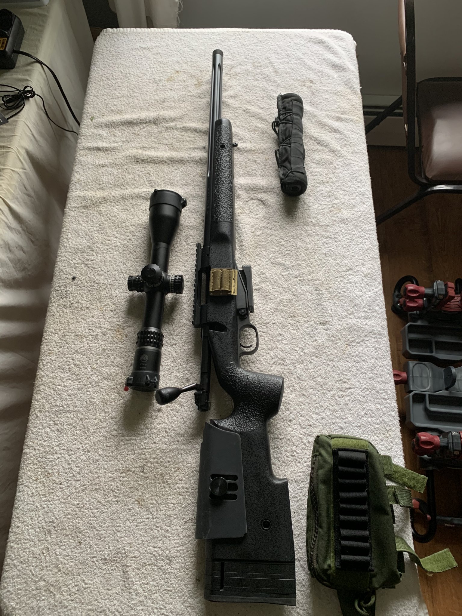

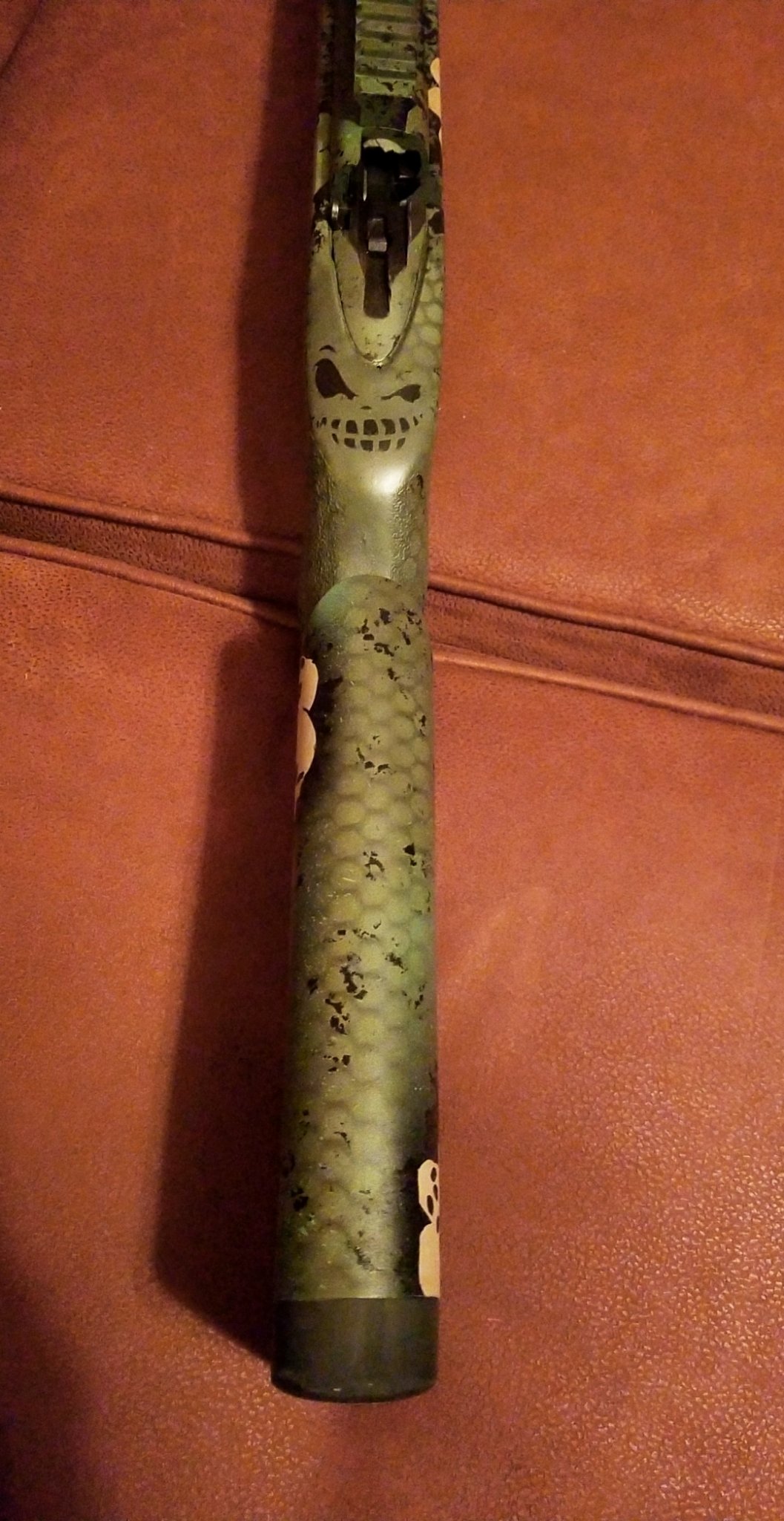

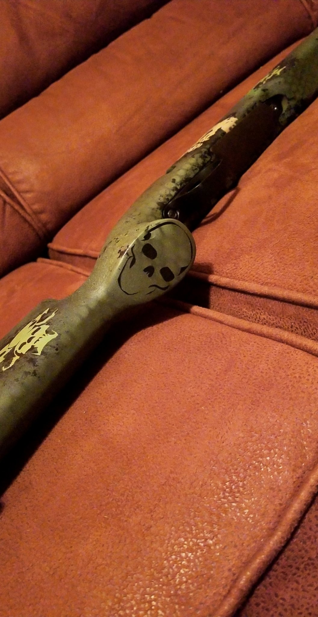

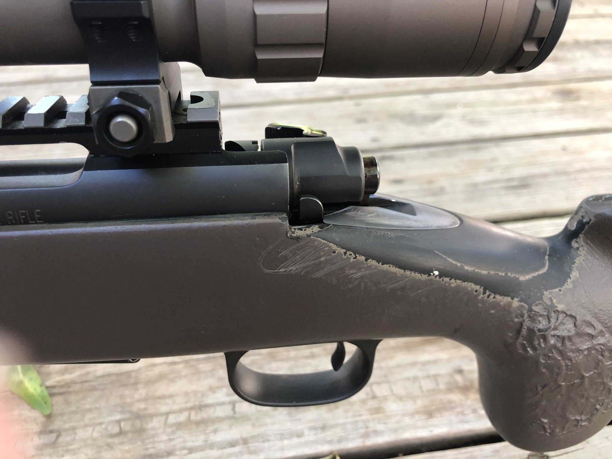

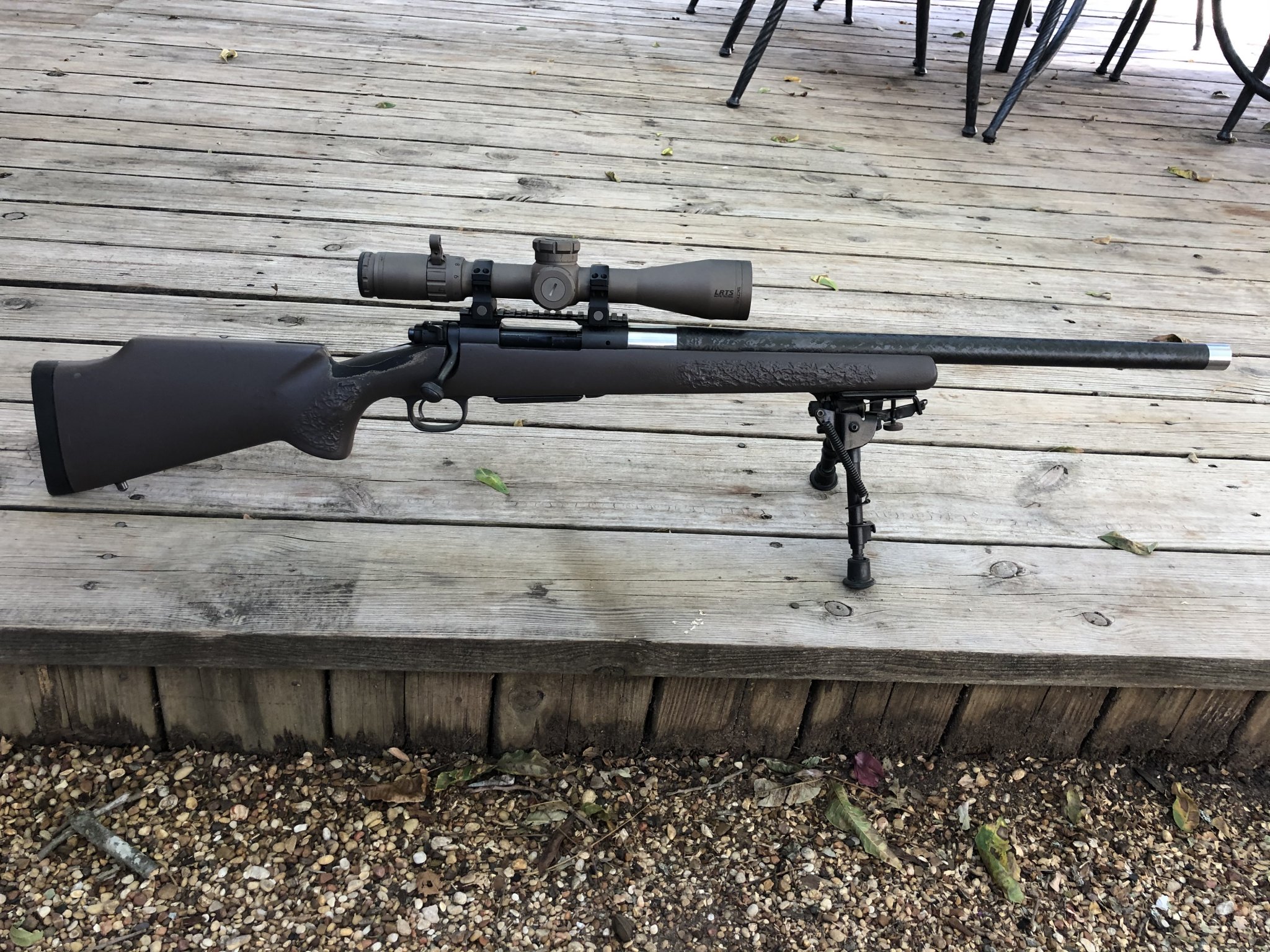

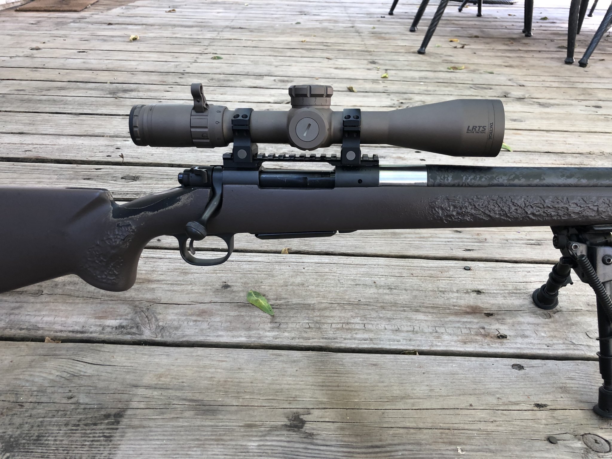

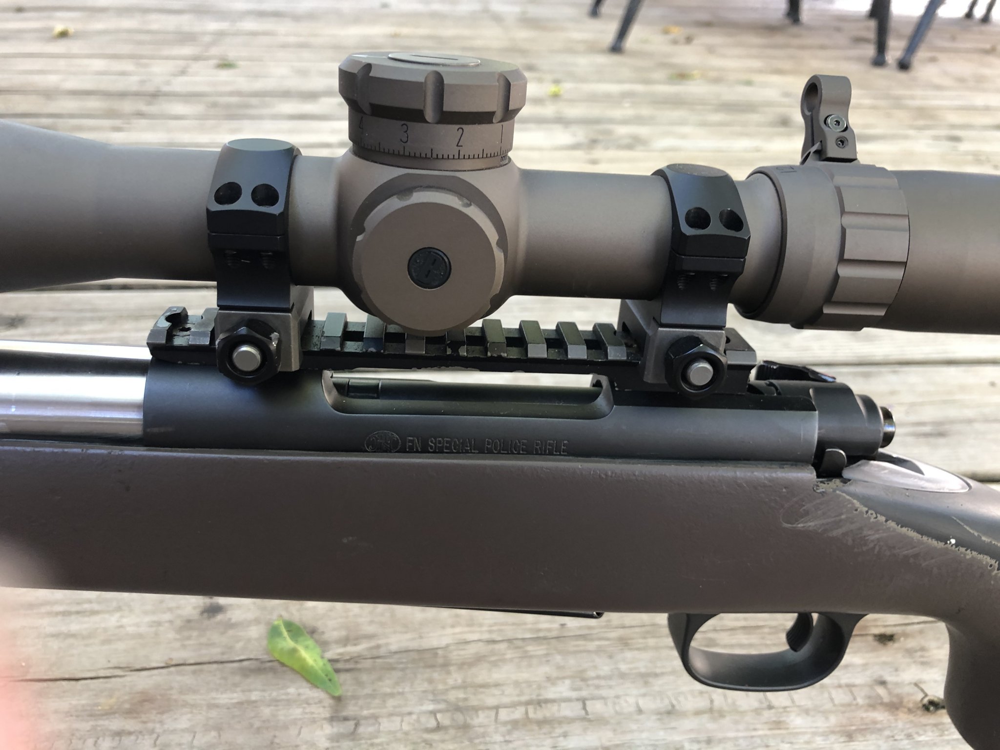

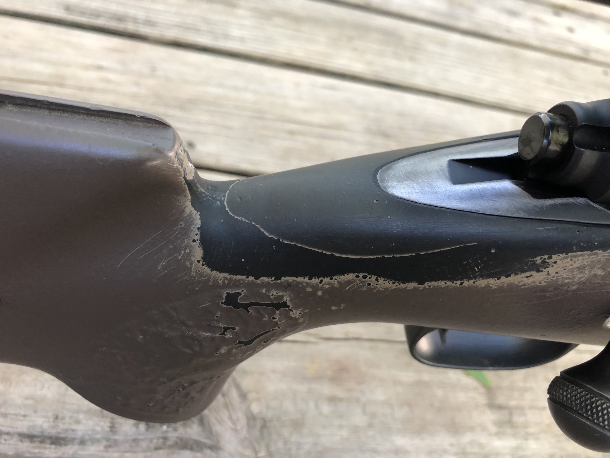

Since we been talking about the spr I picked up the other day I thought I would post some pictures of one in progress.
A1 from 2002 or 2003. Had 24” barrel.
Now has 22” proof, 6.5 creed sitting in Manners mcs t with original 4 round mag and bottom metal.
Once I got pillars cut and barreled action with bottom metal positioned in stock there was about 3/16 gap between tang and stock. I filled with devcon and shaped.
Still got to go to paint. Base color will match scope with subdued second and third colors. All metal will be grayish black or so.
Was shooting for 10 lbs. came out 10.7 without bipod.

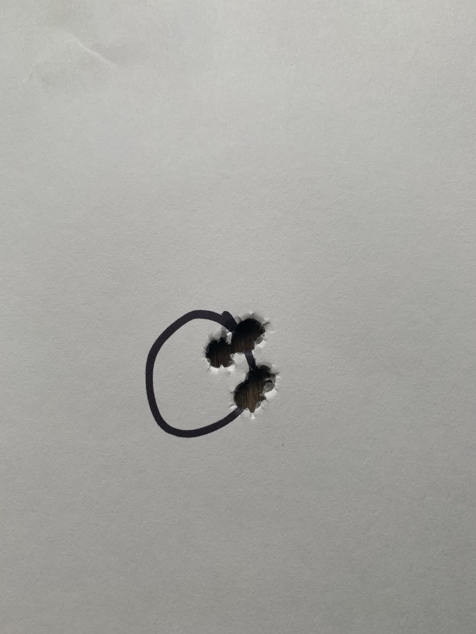

I am pretty happy. Shooting 1/2-3/4” with not much load development.
Here are pics

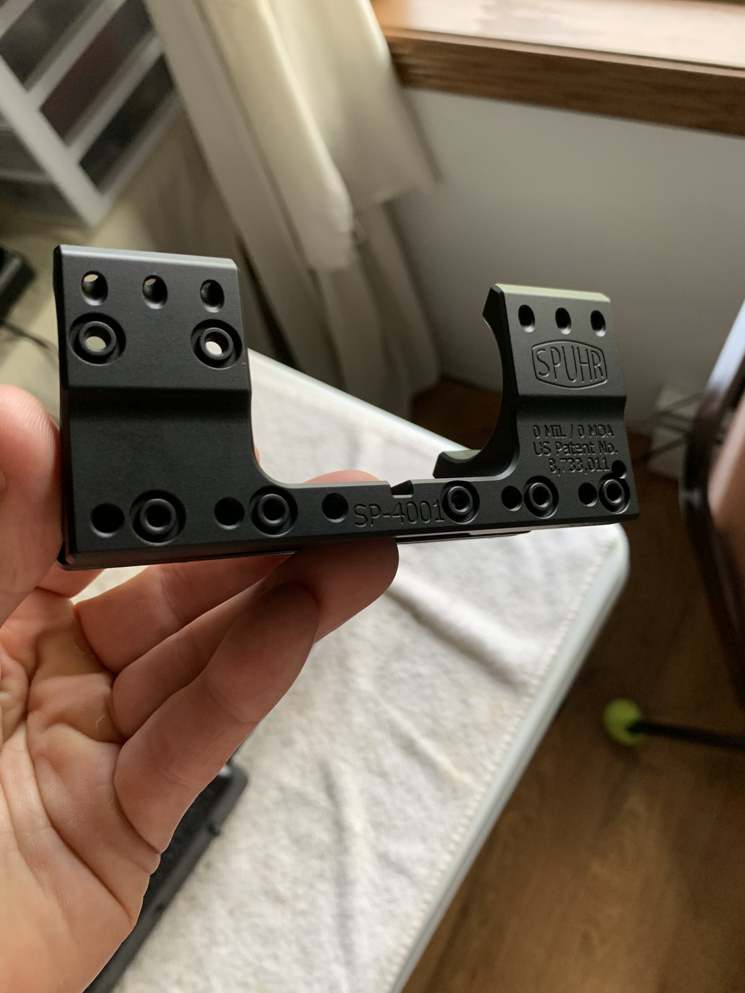

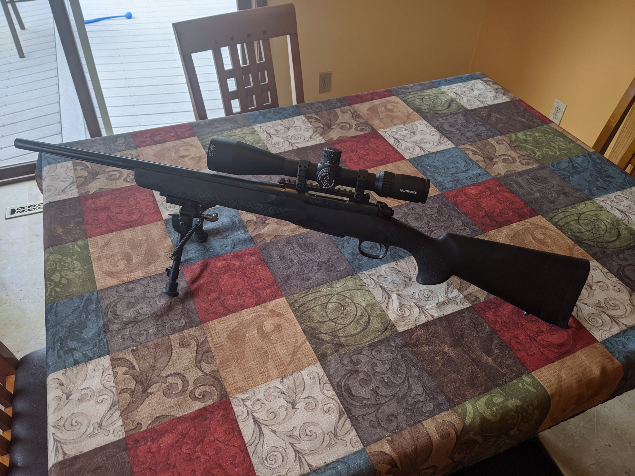

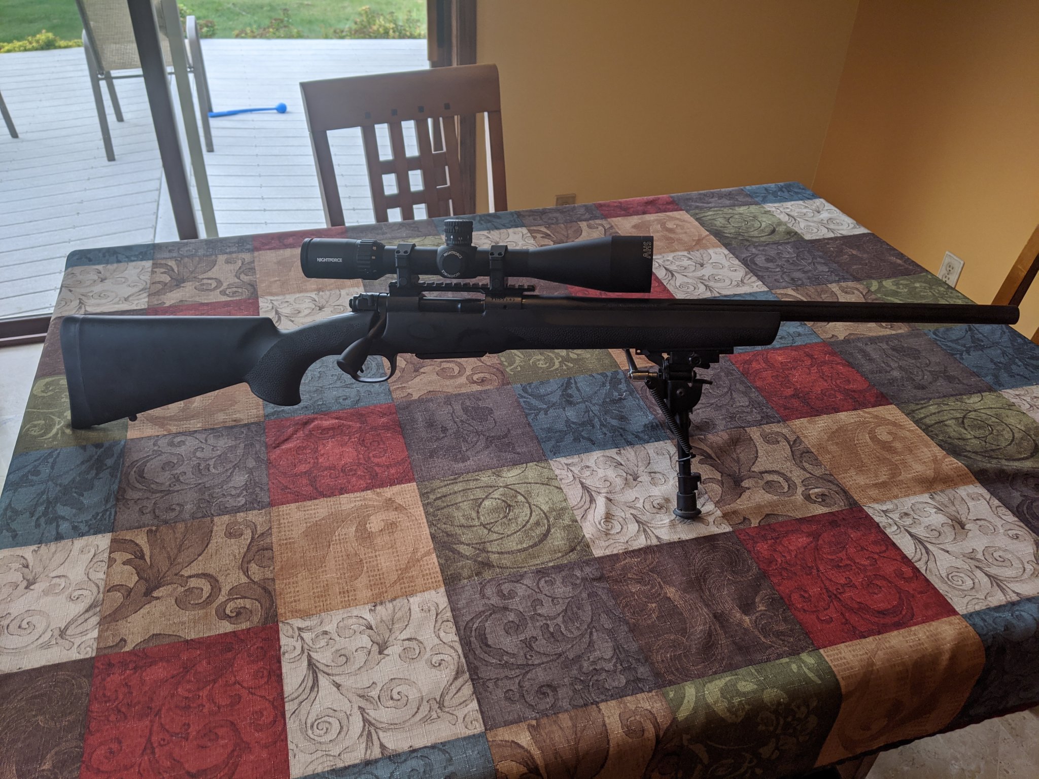

Rings showed up today so I mounted the SHV. I'll finally get to put some rounds down range next week.
LGS had three boxes of Hornady TAP loaded with 168g AMAX's on the shelf so I grabbed them.
I also picked up a few hundred LC LR brass a while back so worst case scenario, I'll load up a few.
I've got almost eight pounds of Varget and plenty of primers to play with. Just need to decide on a bullet but I'm leaning towards a 175g something or other.
I'm definitely looking forward to stocking the freezer this winter!

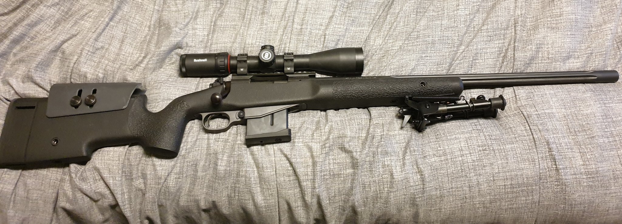

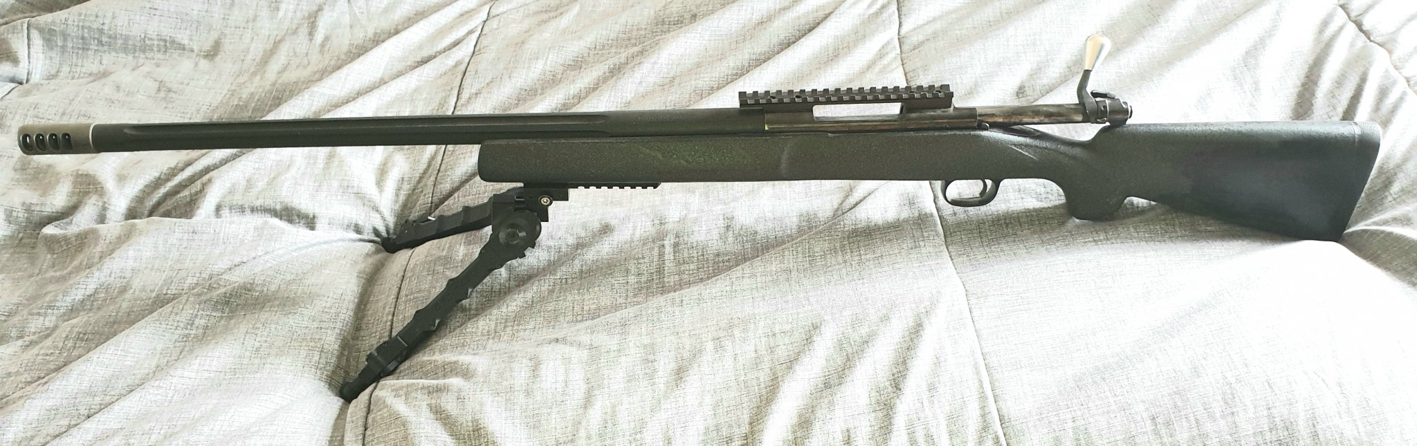

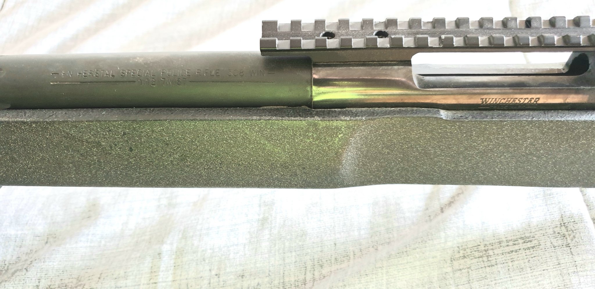

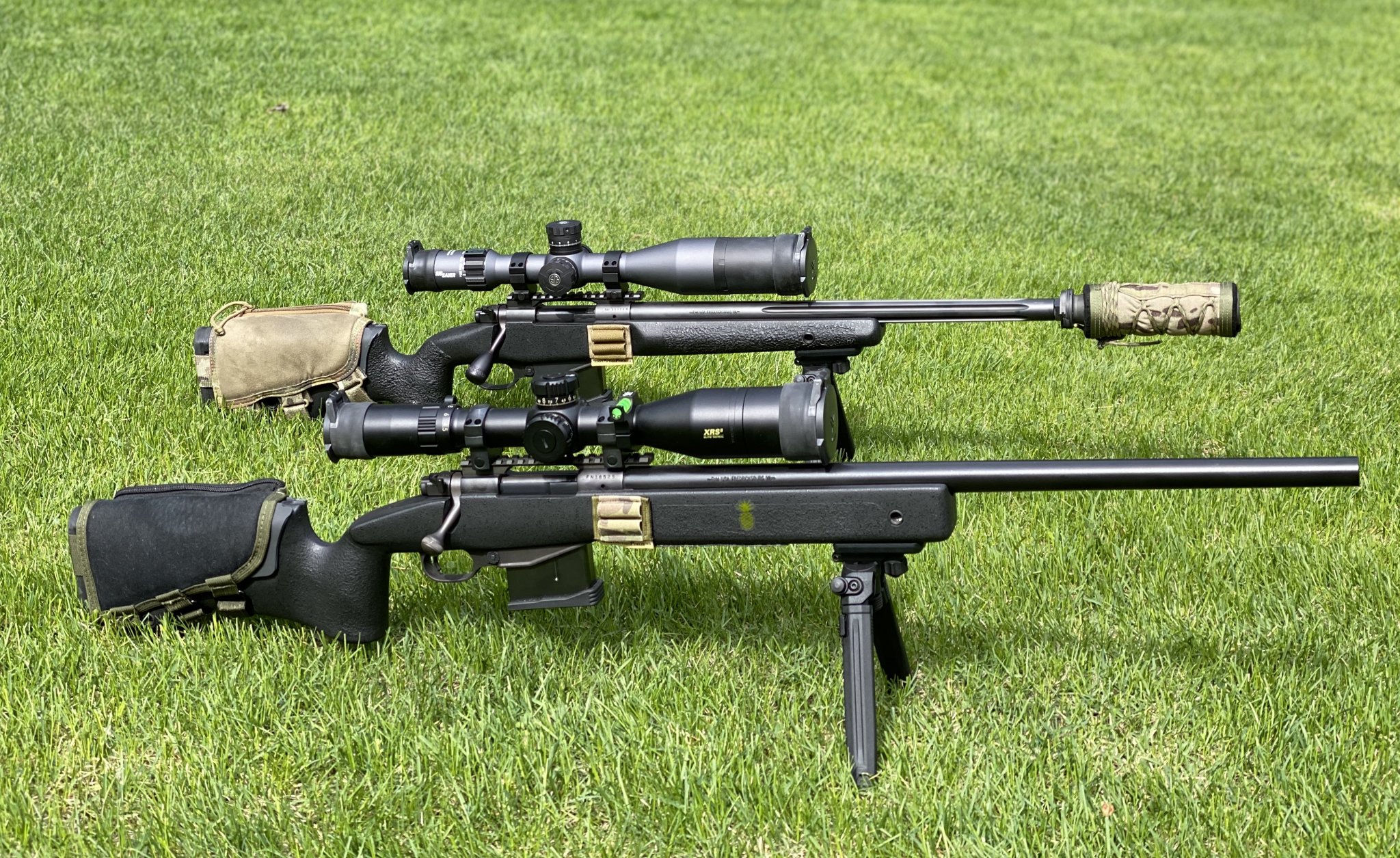

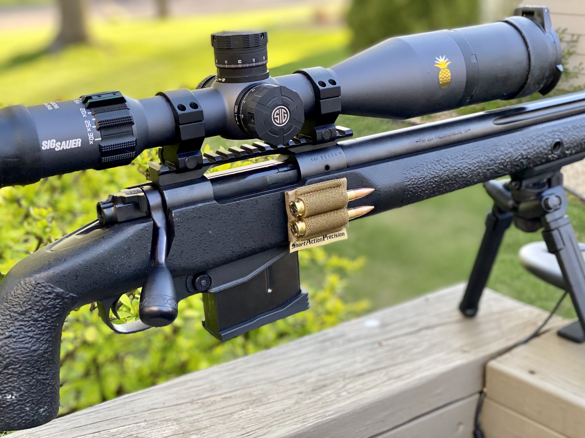

1st and 2nd pictures are my Gen 1 SPR. Built on the old Long Action Winchester in 308 chambering, rollmarked with the FN info on the barrel. Blind mag, HS precision stock no bottom metal of any type. I added the pic rail on the stock for use with my Accu-Tac bipods. Third pic is the new member of the family - FN SPR A5M, with the FN Tac magazines. I LOVE these guns!!

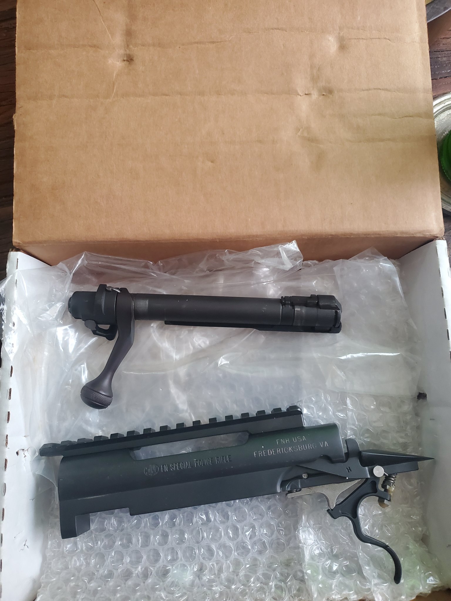

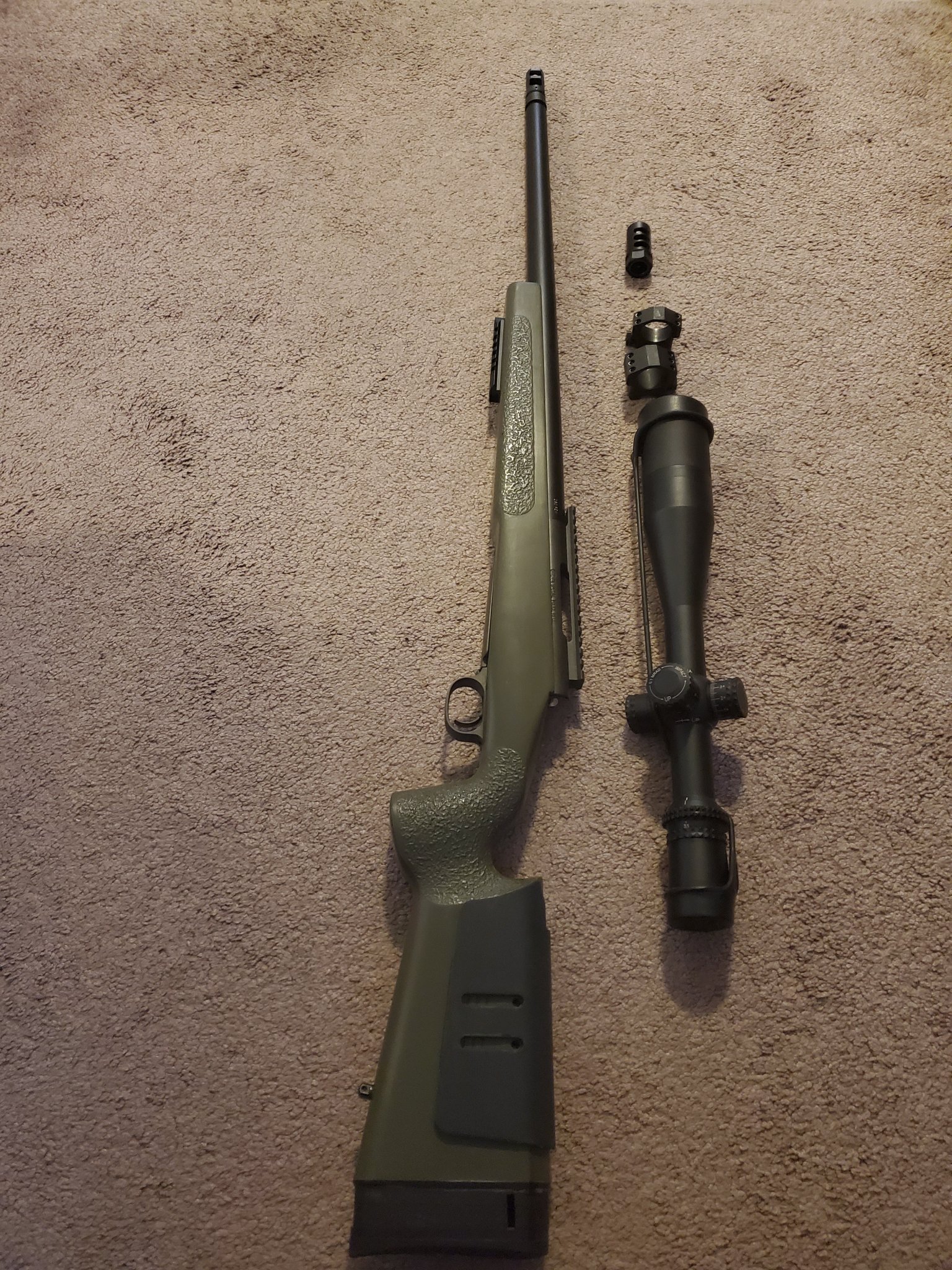

Thanks to this thread I got my hands on an SPR action. Cant thank Quarter Horse enough for giving me the opportunity to buy it.
I do have a question and hoping you guys can give me your input. Can I take the 260 barrel that was put on my a3g rifle and put it on this FN spr action. Since they were both trued by FN, shouldn't they be so close the barrel would fit properly on either action?
Also attached pucture of my a3g in 260 rem.
I'm glad the action is what you are looking for. The reason
I sold it is simply that I had been sitting on it for years along with three A-4s and FN TBMs. As regards your .260 barrel, here are some shops that may be able to answer you question. Moon Roberts at Crescent Crescent Customs, LRI and SAC are all knowledgeable as regards M-70s.
Another guy that might be able to assist is "Action Guy".
