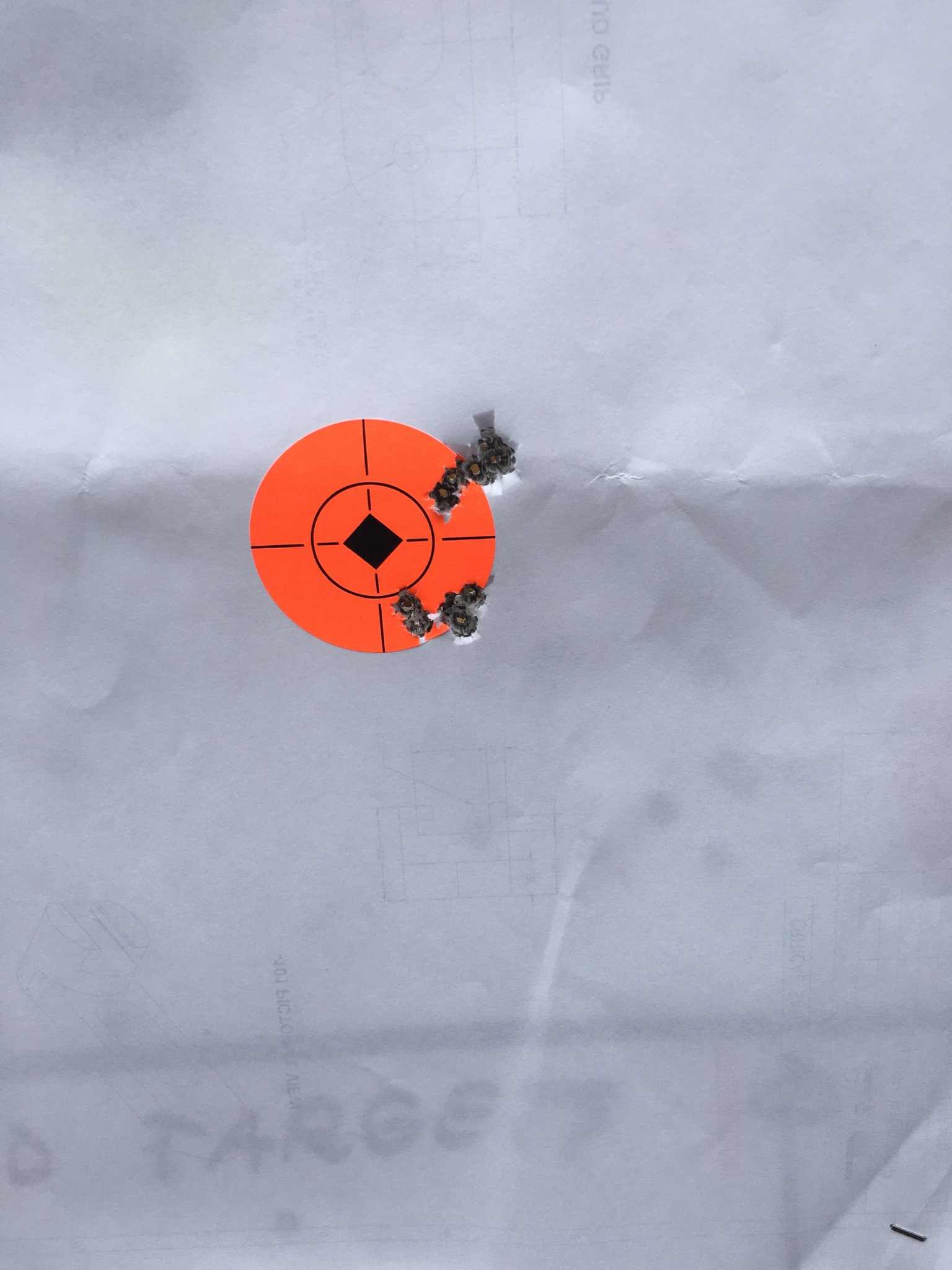

I tested the Area 419 system today and am very happy with it. Top group is with hellfire brake. Bottom is with Ultra 7. Forgot rear bag an called two with the suppressor. About .3mil vertical shift total. I can live with that for 2 stages a year.
Obviously I’ll have to rezero for the new brake, but I think I’m good to go. I may not end up using the suppressor, but this is good enough to at least bring it with me.
