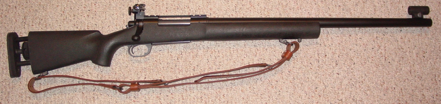

Let me give the short answer to your PM question to all here on the thread so we can all be on the same sheet of music.
This is the PST-024
It is the standard M24 stock that we've all come to know and love. It's the only one that comes from HS-Precision that has the floor metal area cut deep enough for the Army's floor metal be it, Dakota, Sunny Hill or the Badger M5 DBM. Note you will not get the Army's butt plate/pad from HS-Precision, that is a Remington product. If you want one of these, you'll have to order it from HS-Precision just like Remington would.
This is the PST-026
This is the stock being used on many M24A2 weapons. HS-Precision has told me and others that it does not and will not be sold over the counter with the floormetal area cut deep enough for the Army floormetal.
And this is the PST-013 Stock the one I prefer.

The early M24 contract specified Redfield Palma metallic sights on the rear. Palma's were very common sights, not special made for the M24. Just a proven product that Remington chose to fill the contract.

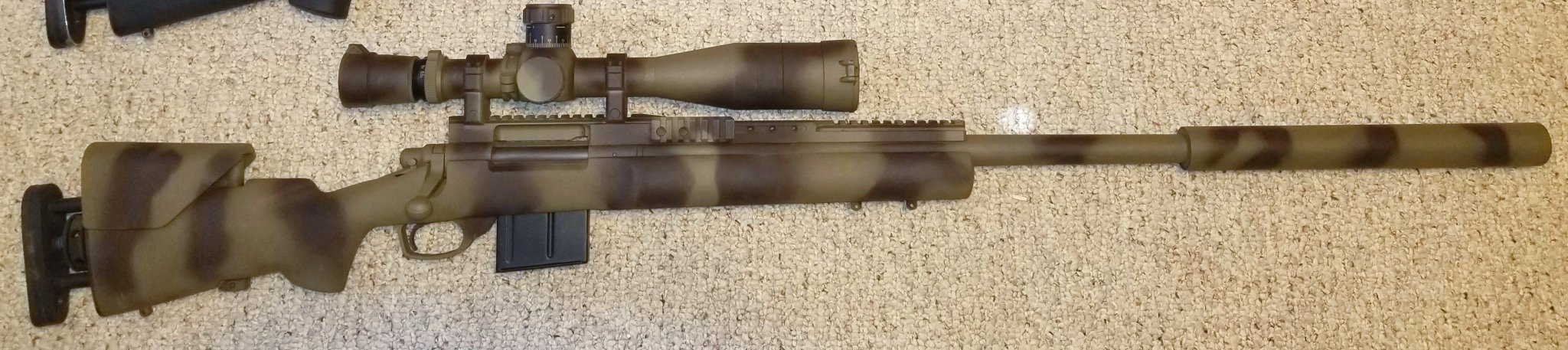

AN/PVS-10 night optic is a GenIII 8.5X magnification, illuminated Mil-Dot reticle. Built-in rail mounts fit the scope base. Weighs 4.9 pounds.
M24 Flash/Blast Suppressor was designed for use with the AN/PVS-10, but is sometimes used with the Leupold day optic. Installed, it changes the point of impact by up to 2 MOA.
Lockring has a groove that allows it to slide over the frt. sight base. Suppressor fits onto the barrel, its cutout slot aligned with the frt sight base. The lockring tightens against the rear of the frt base.

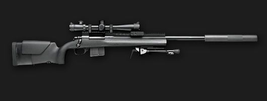

Hello; I just registered to answer in this topic. I already have some parts and in the process of ordering others. But I wanted to know if I have the right components to make the build.
Here's what I already own/will order.
-HS Precision PST011 long action with only adjustable lenght of pull from stockystocks.com
471$
-Harris Ultralight bipod 9-12 from amazon.
67.59$
-Remington 700 Dakota Arms custom long action floorplate from brownell.com
254.99 $
-Remington 700 long action receiver from gunbroker, says it's chambered for 30-06. But I heard there's an adaptor to change the caliber to 308W, I wanted to know if someone could tell me one.
315$
-Krieger Barrel; 308W, 5R 24 inch heavy barrel , with 1-11.25 twist.
285$
-Oversized Remington 700 recoil lug from brownell.com
32.99$
-Frontal sight from okweber.com, in 325D
10$
-Rear base from okweber.com
20$
-Remington 700 bedding pillar screws, 82 size. From brownell.com
35$
-PRI Remington 700 Long Action Scope Mount, from mountsplus.com (Should I choose 3.5 commercial cut out or 2.5 military cut out?)
98$
-Leupold Mark 4 30mm Rings, from opticsplanet.com
129.99$
-Leupold Mark 4 LR/T 3.5-10x40mm (30mm) M3 TMR from amazon.com
1154.23 $
-M24 sling from taticalintervention.com (Come with swivels)
80$
Total cost=2954.02$
I am missing something? A part you would like to recommend to change? Also my question about an adaptor for the receiver I have and the scope mount size.
Please and thanks for your help.

Some of those parts are not true to the original M24 parts, but all of them will work and make for a decent looking clone. Depends on how "correct" you want this project to be? This thread will disclose just about every part needed to build a rifle exactly to US Army specifications.
Tell us how exact you want your gun to be, and we can go from there.

Can you tell me which parts arent original? I know for a fact that the scope mount isnt the original one, but it looks very alike to it, just a little bit larger. And well, the barrel isnt exactly a Mike Rock 5R barrel, but it does the work well...and ooops, I didnt knew that the twist was actually 11.25 but not 10. I corrected my post.
I actually care for the looks of the rifle and the accuraccy of it. I want to have accuraccy as good as the real meal. I think that I'll change for a 40x trigger later on; Im on a tight budget.
Re: Army M24 Build Thread
<div class="ubbcode-block"><div class="ubbcode-header">Originally Posted By: Yustax</div><div class="ubbcode-body"><div class="ubbcode-block"><div class="ubbcode-header">Originally Posted By: lockedandloaded</div><div class="ubbcode-body">
Tell us how exact you want your gun to be, and we can go from there. </div></div>
I actually care for the looks of the rifle and the accuraccy of it. I want to have accuraccy as good as the real meal. I think that I change for a 40x trigger later on; Im on a tight budget. </div></div>
I wouldnt call spending $3,000 a "tight" budget!!
Here are the corrections to your list, printed in <span style="color: #FF0000">red</span>:
471$
67.59$
254.99 $
315$
<span style="color: #FF0000">Remington only makes the 700 receiver in 2 sizes, Long or Short. The .308Win cartridge usually comes in a Short Action (SA). But the Army wanted to have the option to change the M24 into a 300WinMag in the future, so this required using a Long Action (LA). The differences among calibers are based upon the diameter of the boltface. The 30-06 uses the same boltface diameter as a .308Win. I never heard of any "adapter" for caliber changes. Only machining of the bolt face can be done.</span>
-Krieger Barrel; 308W, 5R 24 inch heavy barrel , with 1-10 twist.
285$
<span style="color: #FF0000">Remington manufactures their own 5R barrels at the factory, the correct twist rate is 11.25" Right-Hand. Mike Rock only made a few of the barrels for the early prototype/testing rifles. Remington decided to start making their own barrels in-house after that.</span>
32.99$
<span style="color: #FF0000">The M24 uses the regular size recoil lug</span>
10$
20$
35$
<span style="color: #FF0000">The H-S Precision buttstock does not use seperate bedding pillars. The pillars are already machined into the aluminum bedding block itself. The action screws are stainless steel.</span>
98$
<span style="color: #FF0000">The M24 uses Leupold MARK 4 bases. The early versions were 1-Piece, but newer versions use 2-Piece</span>
