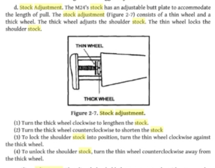

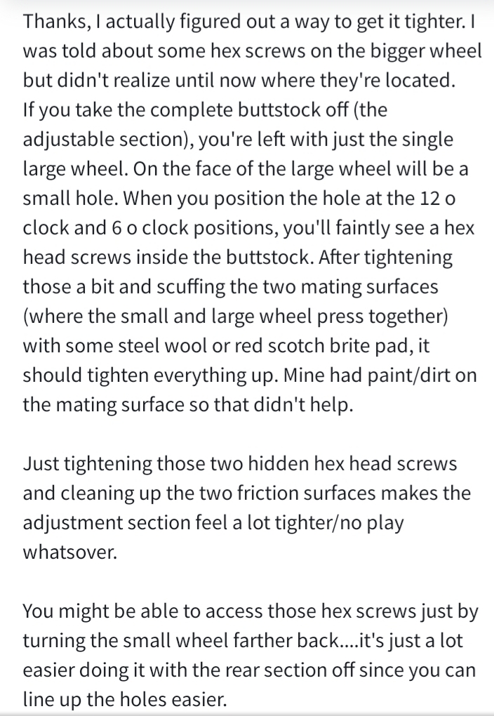

What is the proper way to lock in the length of pull on the stock?

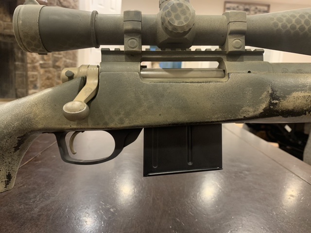

It may be in the thread but what is the story with these rifles? Are they still M24s? The top picture looks to still be a long action but the other picture appears to b e a short action.
View attachment 7321754View attachment 7321755
With regards the second picture, the mag doesnt appear to be flush, ie directly under the ejection port, but appears to be back a bit, pic looks somewhat deceptive
It is here in the thread somewhere but, short answer, yes this is a short action magazine in the long action M24. This weapon has a modified HS Precision floor metal and 10rd magazine. The conversion was problematic so Badger Ordnance designed a DBM floor metal that would use Accuracy International 5rd DBM which works very well.

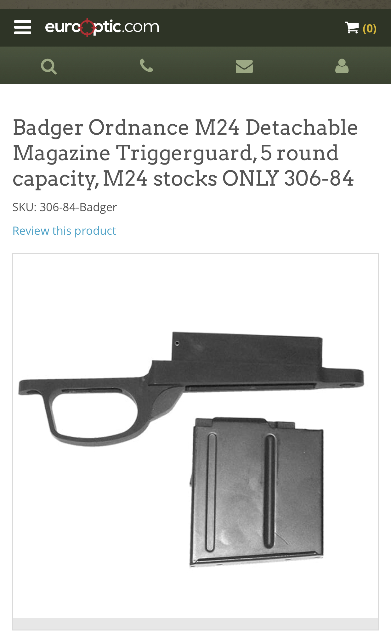

PSA: EuroOptic has the Badger M24A2 DBM in stock. No affiliation, just passing it on. I don’t think these have been available anywhere for a couple years now.
I just called them. They are not in stock and haven’t been.
Don’t know what to tell you — I got an in stock email notification this afternoon and when I click through that notification it’s appearing as in stock and moves to my cart:
I guess it could be a mistake on their part — that would be a bummer.

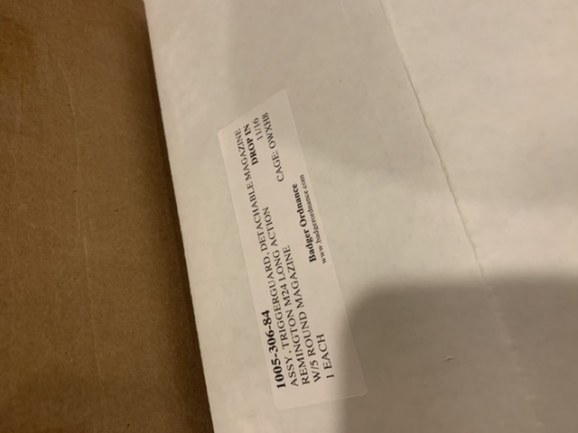

I just ordered the Badger Ordnance bottom metal set up for M24. It fits that stock set up. Are there any 10 round mags that fit it? Nobody can answer if there are any.. WTF?
It’s ok. Thanks for the heads up. I ordered the other version and got the last one. I just need to know if there are 10 round mags that work?
The one you ordered is the correct DBM for the M24A2 — glad someone here got the last one. It fits the long action HS Precision stock but with 308-length mags. Will fit either the original M24 HSP stock or the later M24A2 HSP stock with the adjustable cheekpiece. Don’t know about the 10-rounder availability.
Thank you. My biggest concern is magazines. I’d like 5 or 10’s. Don’t know which to get (part #). What is the purpose of this set up if I don’t get any more round capacity. If that makes sense.
Hopefully someone can confirm as I don’t have direct experience but I don’t see why an AICS short action 10-rounder wouldn’t fit — functionally it’s just a Badger M5 DBM but lengthened to deal with the oddball long action / short action M24 combo.

Question for you experts. I have a TBA M24 that I just put the A2 lower metal on. The trigger guard fits fine, but the magazine is extremely loose to the point it won’t consistently feed. Anyone else have this problem?
Reactions: sandwarrior
Mine are loose but no issues when feeding. The stock box Mag needed to be removed. If you leave it in the bottom metal still fits but Mag won’t sit deep enough to feed. I hope I am not insulting your intelligence but telling to make sure you remove the box magazine that is attached to action.
Everything was taken out. It’s just the bottom metal there and there is approximately 1/3” of up/down play in it. If I push the mag to the top, it’ll feed for maybe 2 rounds, but then drops and the bolt can’t pick up any rounds from the magazine. However, the magazine will not drop all the way out unless I depress the magazine release. The lower metal/magazine came directly from Badger Ordnance. Perhaps the wrong or a bad magazine was included with it?
And by “it”, I’m referring to the mag. The Trigger guard fits securely.
I take it you don’t have another Mag? Sounds like a magazine size issue.
Possibly. I got off the phone with them yesterday and what was communicated was that it is likely a machining error on their part. Likely will just exchange for a new one according to Badger Ordnance. To their credit, they’ve been very helpful about all this. I’ll update in a few days when I have more.
