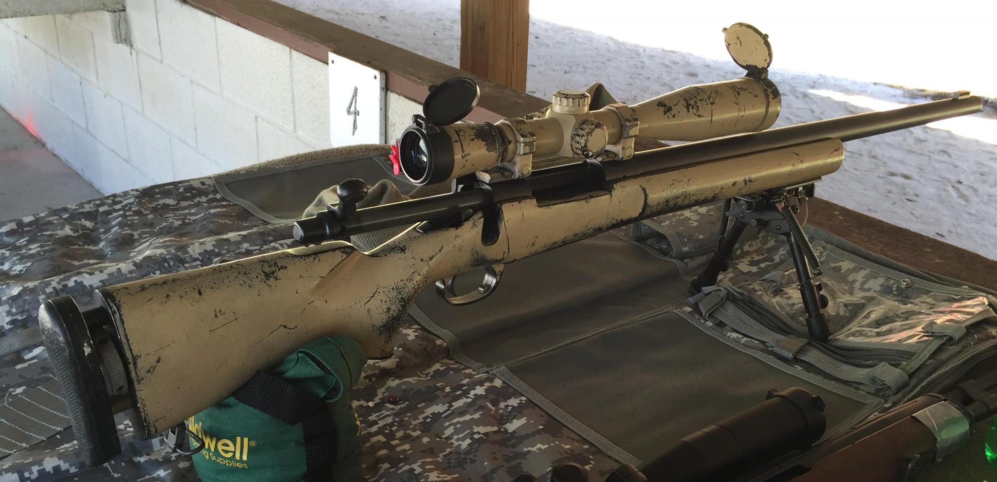

If that’s an M24R with a US Army take-off stock with camo job from military service - I would not modify it. The value of the rifle will be seriously and adversely impacted if you modify it from the original US Army take-off configuration. I’d leave it as-is, it’s a classic.
(I have one that looks fairly similar).
It is indeed an M24R. I added the MARS rail, but otherwise it's stock from when I bought it from Euro Optic a few years ago.

On mine it was clearly the stock and bottom metal. Per Remington's contract with the US Army, all serviceable parts that were removed for the M2010 program could be re-used on the M24R rebuilds. I think Remington apparently refinished some parts, ie, scope mounts, iron sight blocks, etc, so its hard to say exactly what small parts are take-off versus replaced parts. I think the old Redfield iron sight mounting blocks are refinished original parts, as the originals haven't been made since the late 80s. (Mine has the later OK Weber iron sight mounts which are a little different than the late 1980's Redfield parts).
To the best of my knowledge, there were 3 parts that were always new on the M24Rs:
1. M24R receiver's are new as the US Army re-used the serviceable ones for the M2010s, and US Army will not allow its serial numbered receivers to be re-sold to the public. (Note: Any M24/M2010 receiver that develops or exhibits a potential issue is destroyed by Remington as part of their support contract with the DoD).
2. M24 fire control unit (trigger and safety) are new, as it would be too much liability for Remington to re-sell a used trigger unit that might be been modified, worn-out, or otherwise 'messed with' in its military service, resulting in a unsafe firing mechanism. The new M24R triggers went through the same rigerous testing protocol that the military requires.
3. M24 barrels are new for obvious reasons - who wants to buy an M24R with a potentially worn-out barrel? Again, these are mil-spec M24 barrels that go through an extra honing process by Remington Defense, stamped '7.62 NATO' etc.

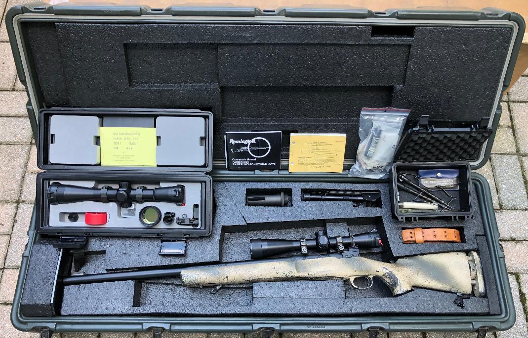

As for the other small parts, if they were serviceable they were apparently refinished and re-used. If not, they were replaced. Some kits had painted scope rings, scope rails, and some Harris bipods that matched the camo job on the stock, but I was not lucky enough to get the whole kit with such parts. (Pic #4 is not my M24R, but it came with the take-off/matching Leupold M3A optic and the long discontinued one-piece scope rail. I am 99% sure the scope, sunshade, rings, and scope rail are associated with that painted M24 stock while in military service....not all M24Rs had that level of matching take-off parts, but many did).

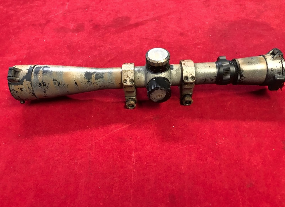

My take-off optic is a 1989 dated M3A Ultra that had its camo paint removed at some point in the past, with only some remaining on the rear lens cover, etc. I had it sent back to Leupold for a no-cost Warranty/Inspection process as it had fine grit or debris in the rear ocular. They replaced that glass and reticle and returned the scope to me with all the patina in tact, but with new glass. Rings are also take-off parts.

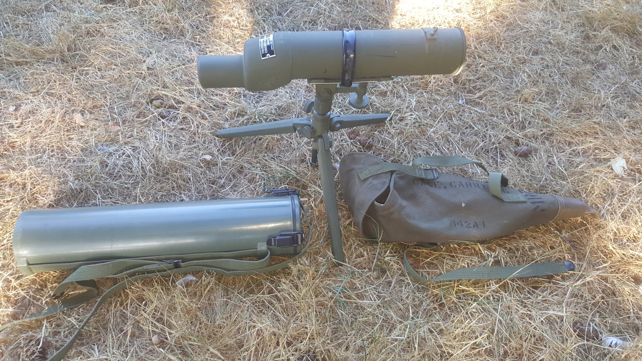

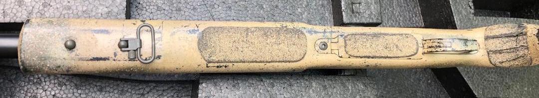

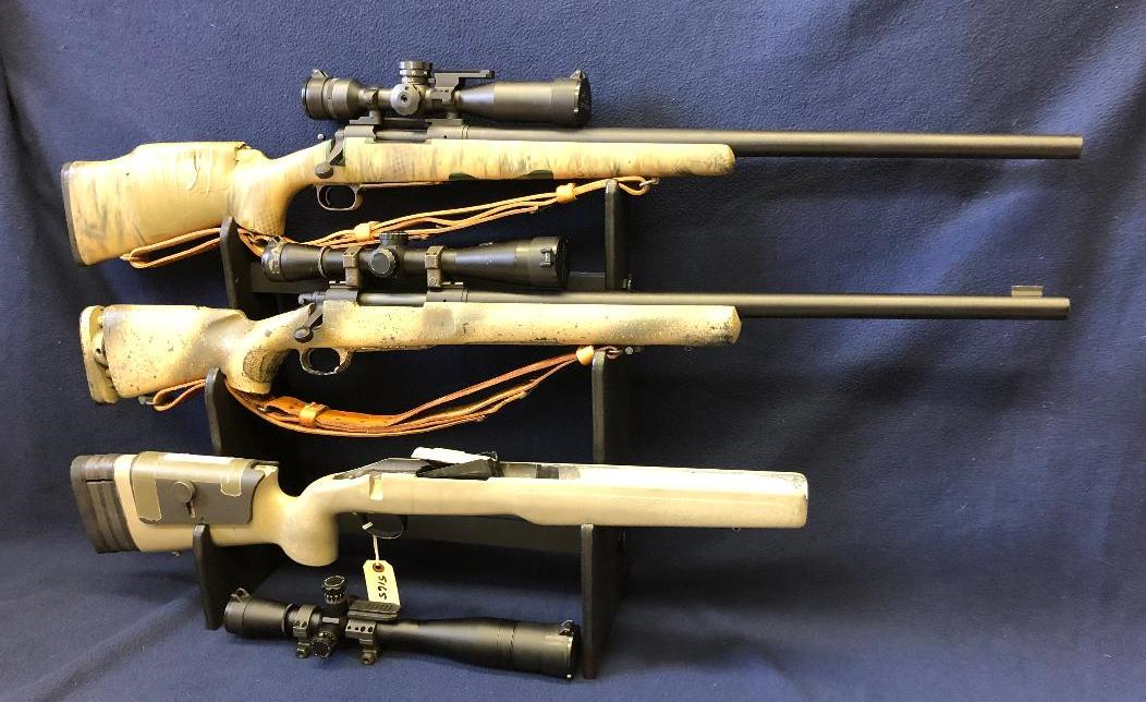

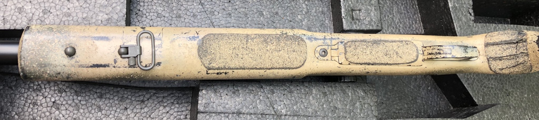

As noted in the last picture, my projects often start with a take-off stock: M40A1 on top, and my Navy Mk 13 Mod 3 project is in process (bottom stock).

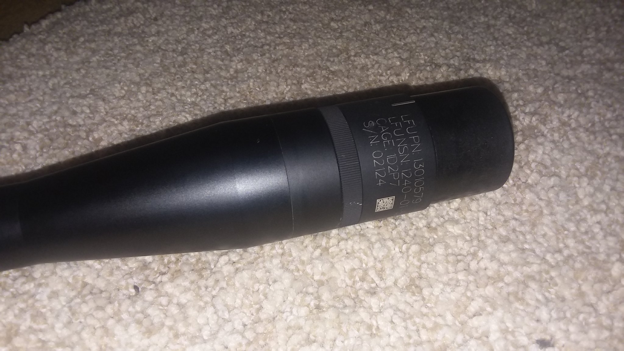

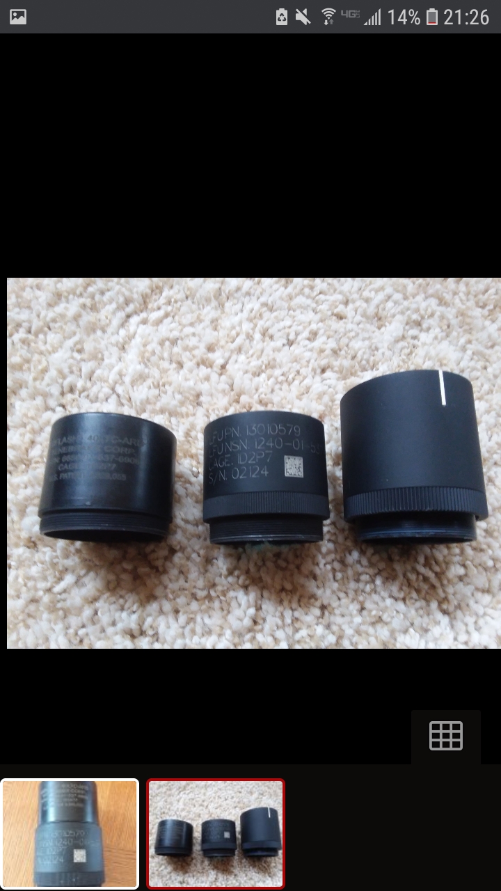

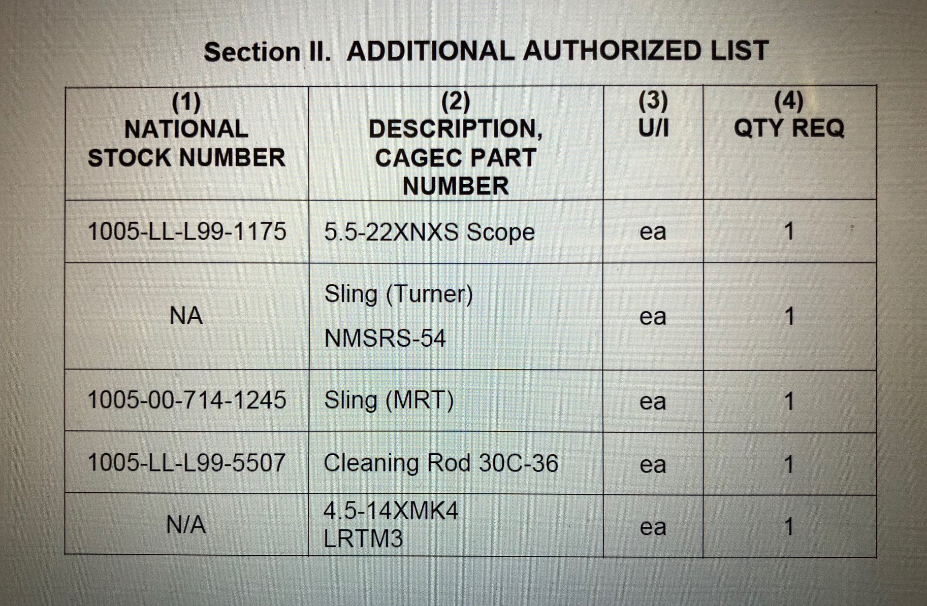

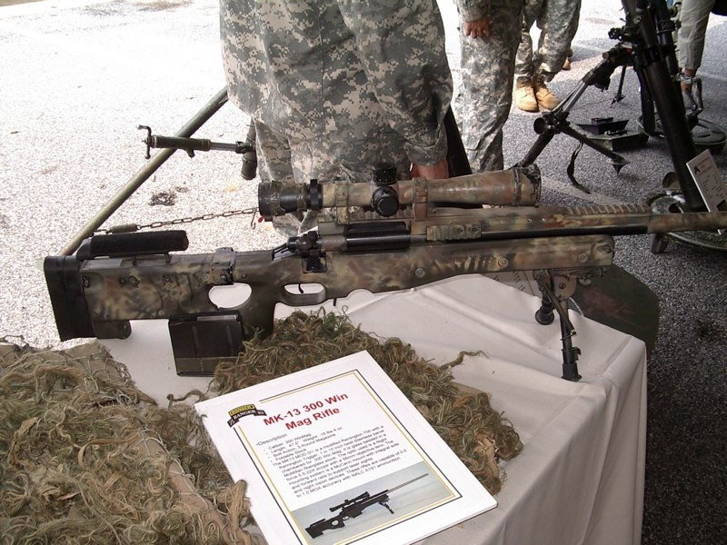

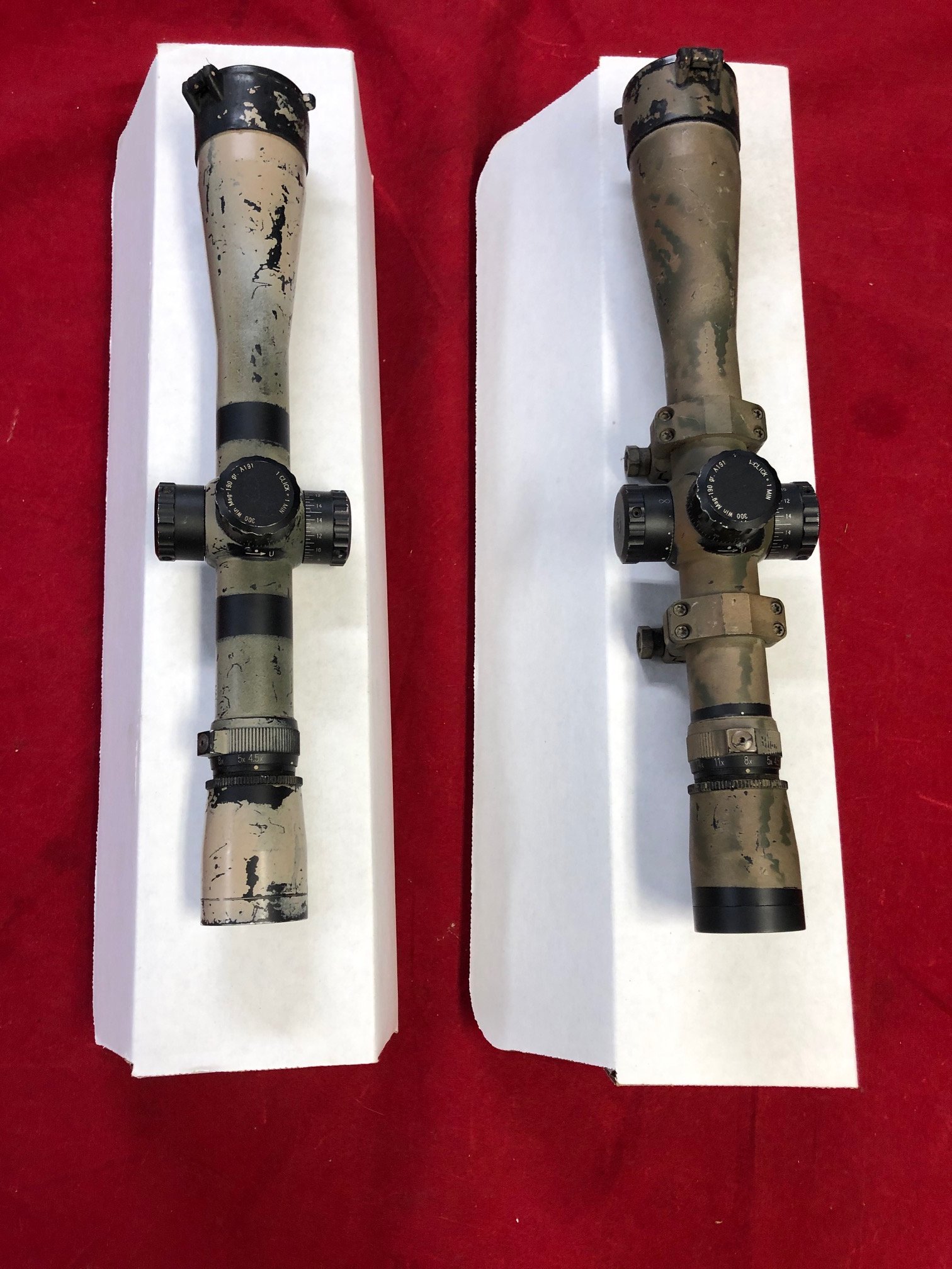

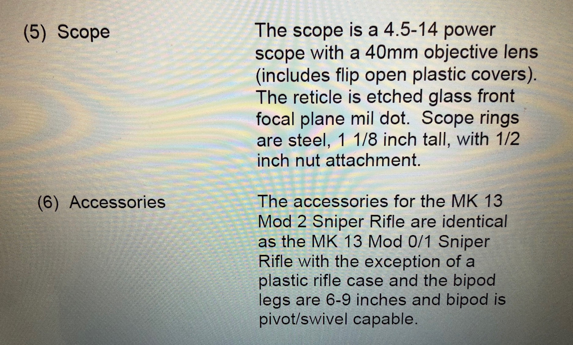

Does anyone know exactly which optic Nick is running on this rig? When you zoom in on the power ring it looks like the focal range is 4.5-14x, but I could not find any information about a MK4 4.5-14x40 with M3 turrets.
Today I finally learned the answer to that question about the mysterious Leupold Mk 4, 4.5-14x scope that Nick Irving was using on that M24 years ago (circa 2009). I am now convinced it was actually a specially-made scope used on the relatively low production US Army Ranger-specific 300 WinMag rifle, the Mk 13 Mod 2. Another forum member found one of these scopes, and apparently it's a first focal plane scope with BDC turrets for use with the "A191 300 WinMag" ammo. The scopes are reportedly dated to 2002. (K-suffix serial #). (EDIT: Perhaps Premier Reticles converted them to 1st Focal Plane?)
As far as I can tell from the Mk 13 literature, apparently they don't have a local NSN #, which is odd. Leupold's custom shop (or Premier Reticle?) must have made a small number for the Rangers's back in 2002-3. I don't think Leupold sold First Focal Plan commercial scopes with variable power until 2007 or so....hence the Leupold 4.5-14x scopes with M3 turrets used on the Mk 13 Mod 2's are really unique little scopes. Just an fyi to close the loop on this question from months ago...
As far as I can tell from the Mk 13 literature, apparently they don't have a local NSN #, which is odd. Leupold's custom shop must have made a small number for the Rangers's back in 2002-3. I don't think Leupold sold First Focal Plan commercial scopes with variable power until 2007 or so....hence the Leupold 4.5-14x scopes with M3 turrets used on the Mk 13 Mod 2's are really unique little scopes. Just an fyi to close the loop on this question from months ago...
Good invaluable info. Thanks for running it down.
here are the three 4.5-14x 40mm Mildot F1 m3 turrets. I have been building a mod 2 for a while and never expected to stumble onto these. Now i want to put one on an m24. Single scope is mine, USMCSGT got the other pair and posted photos in the mk13 thread.

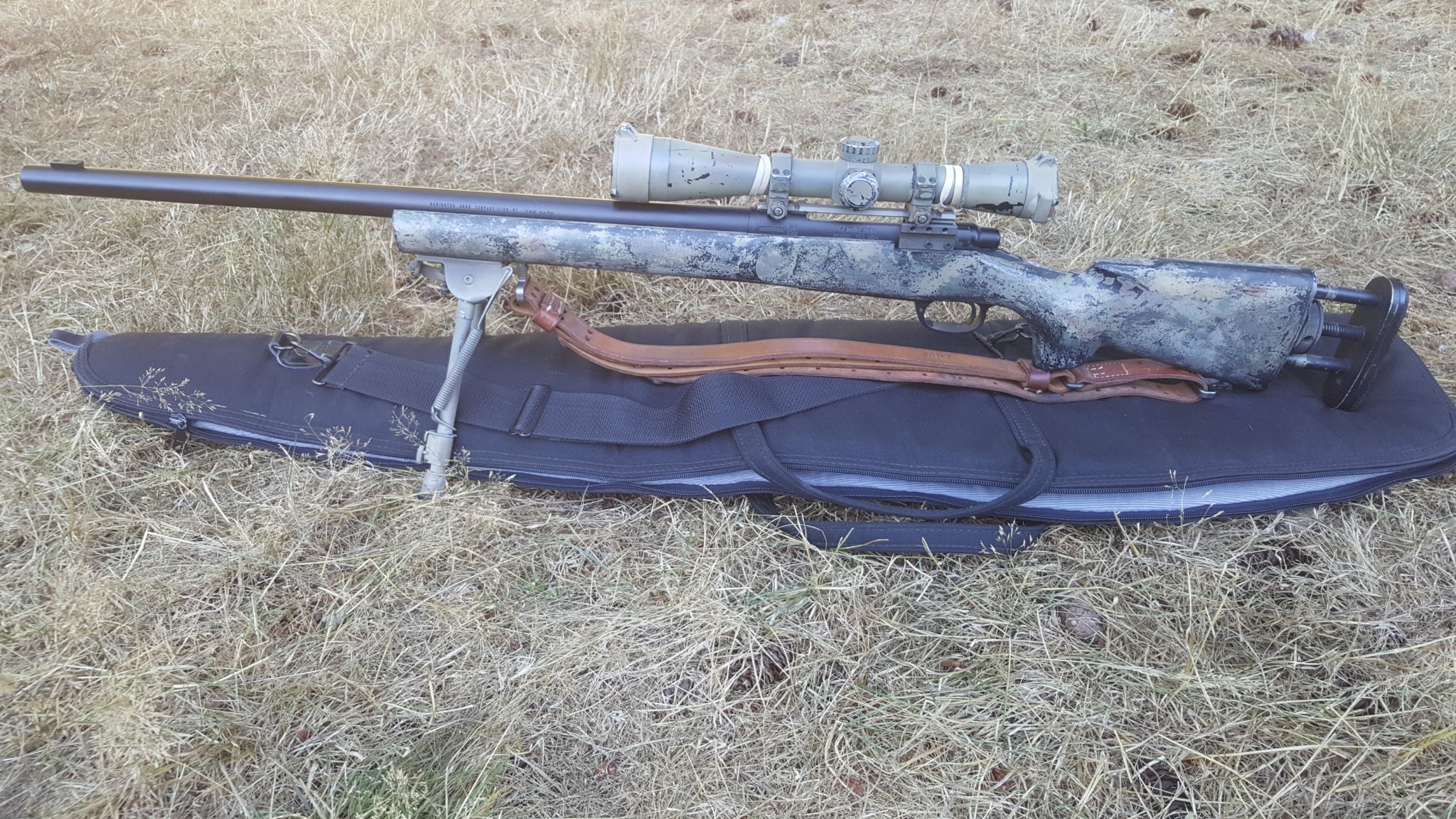

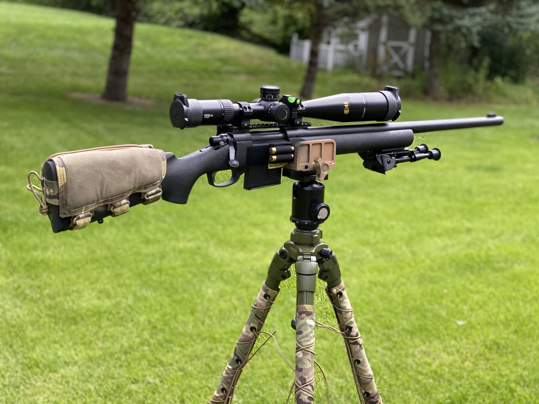

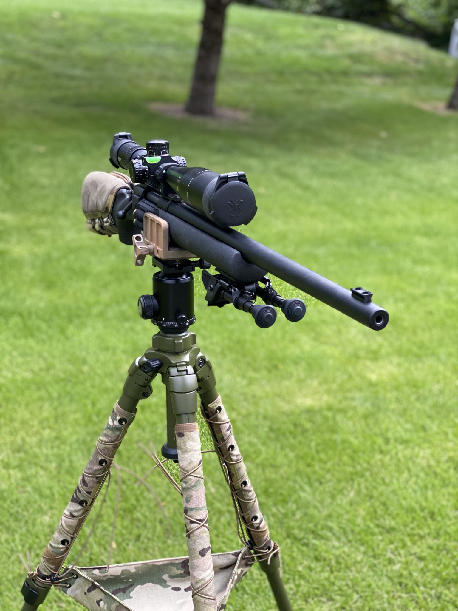

I took some cool pics today of her.

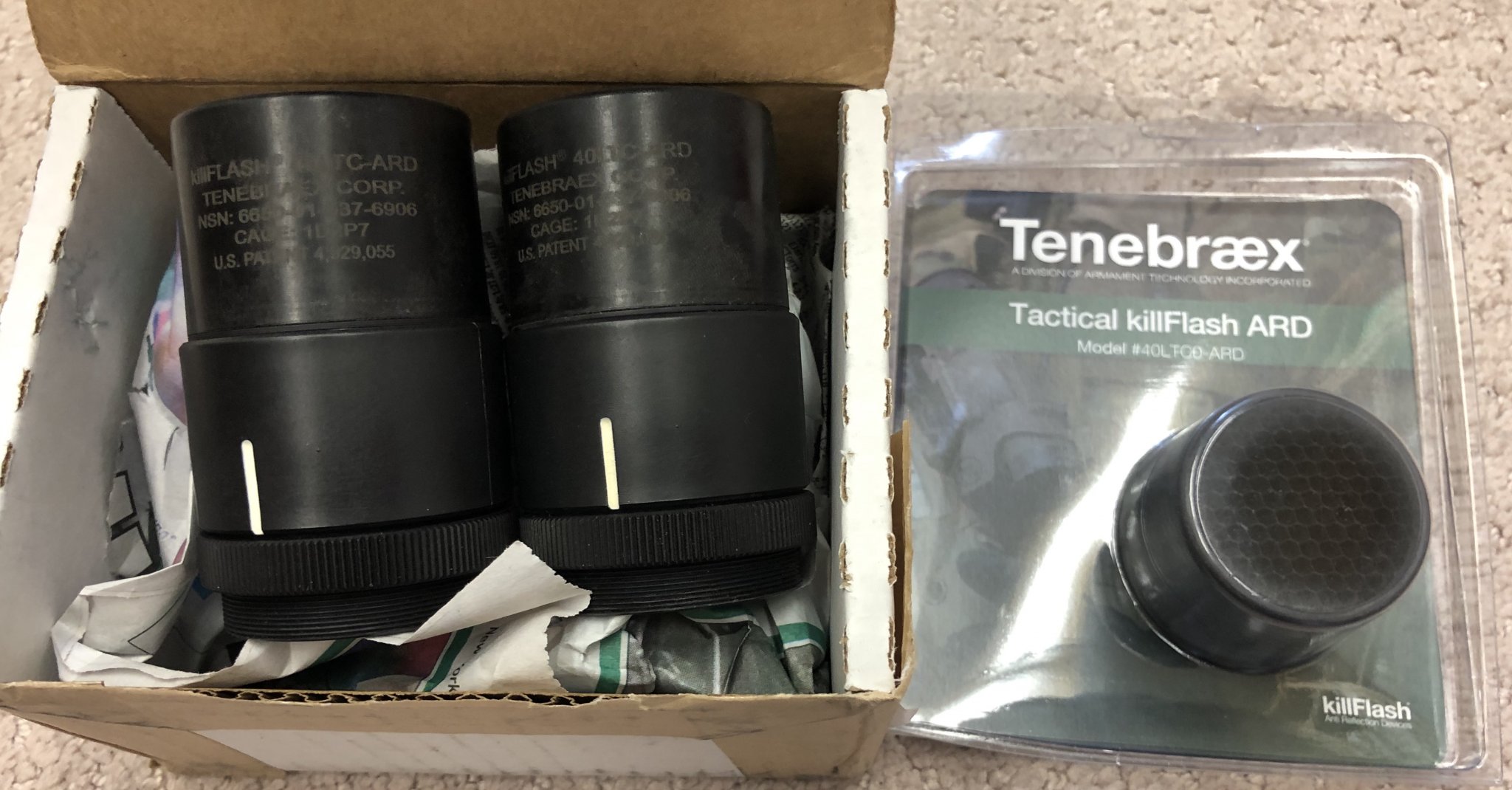

Anyone have an EMA ARD they're willing to part with?

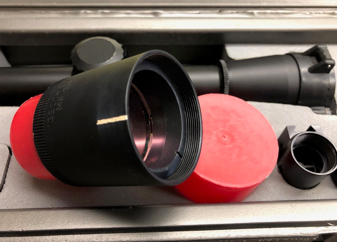

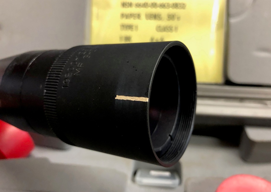

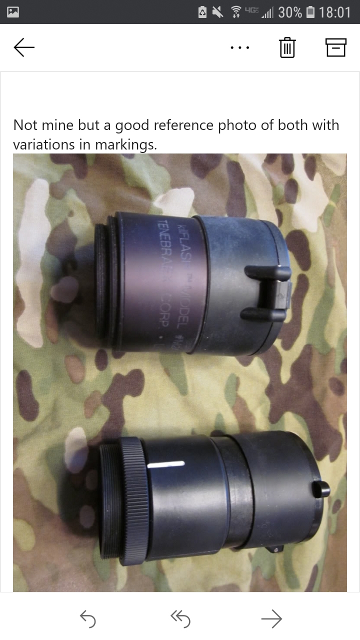

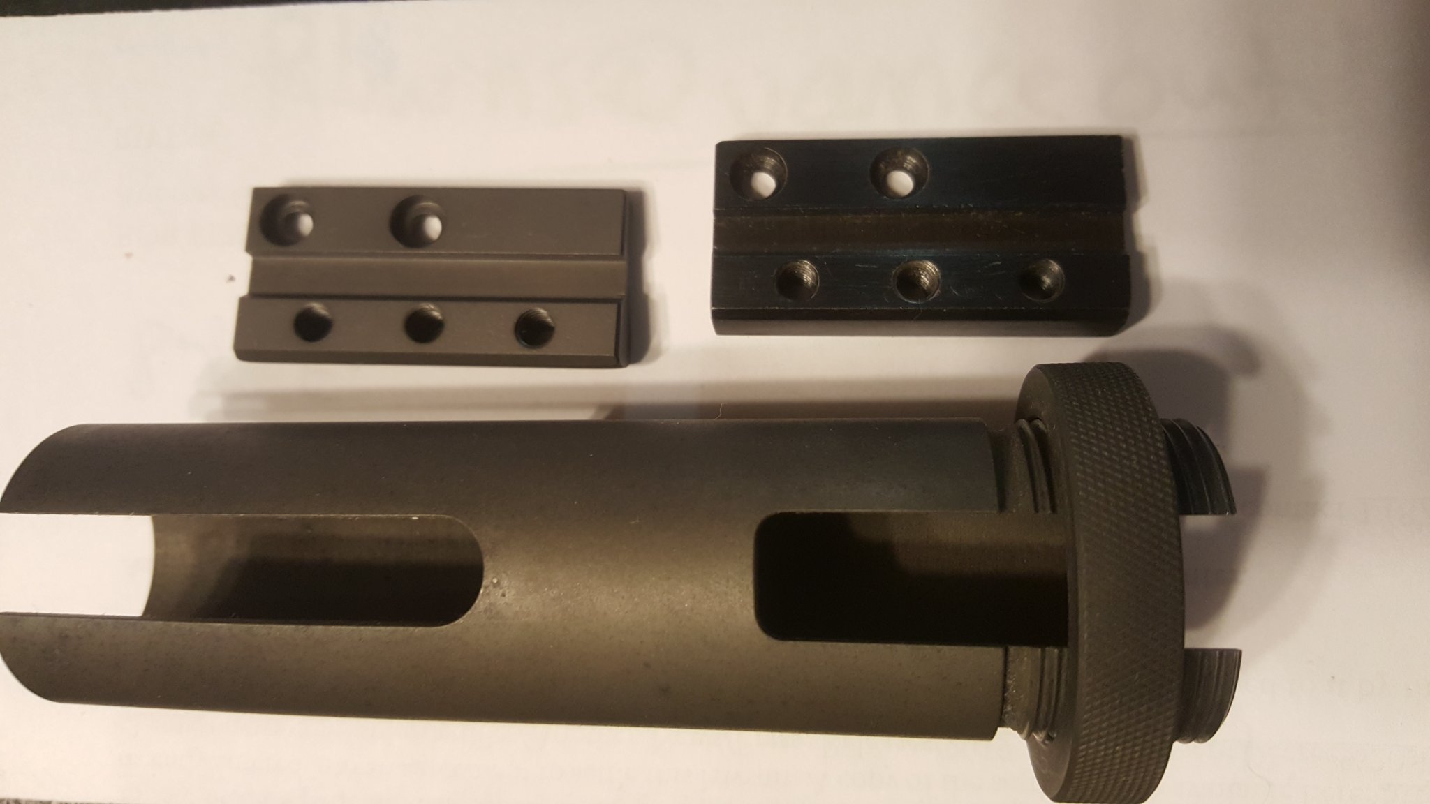

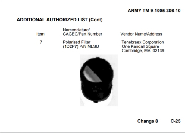

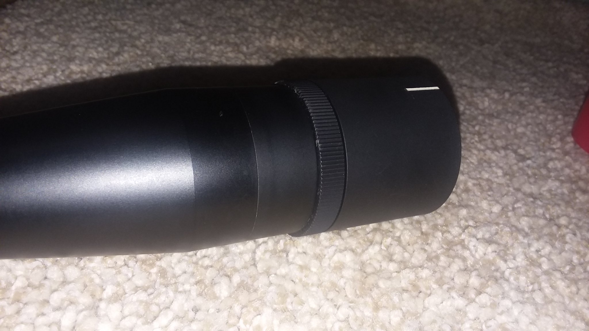

As seen in post #578, there are apparently 3 flavors of 40mm ERDs (aka LFUs) for Leupold scopes - but their is an important nuance to the part you seek.
Leupold changed the thread pitch in 2004 on their tactical scopes, so the sunshades (and ERDs) for the pre-2004 scopes don't fit the post-2004 scopes very well - if at all. The original ERD (on far right of that pic) is hard to find. Its fits the old Ultra M3A scope (circa 1987-1992/3) and the Mk 4, 10x scopes made circa 1993 to 2003.
The middle ERD with scan tag is reportedly an M110 unit, and fits the "post-2004" scopes (ie, M110 was adopted ~ 2008, and the Leupold FDE 3.5-10x scopes have the 'post-2004' type threads). You might be able to find one on eBay, maybe...
The plastic one on the far left (see attached) is more common and I think its still in production. I was able to find 2 of them this year. It fits the post-2004 Leupold scopes, and were issued with the US Army M14-EBR-RI beginning in 2009 (see 2nd pic of US Army M14-EBRs in training exercise).
Anyhow, just wanted to point out a thread pitch change occurred on Leupold tactical scopes circa 2004 - and how that impacts what ERD/LFU can be utilized. The majority of M24s likely had pre-2004 scopes (either M3A Ultra or the later Mk 4 after 1993) and presumably the large early aluminum ERD with the white alignment line as seen in the other post. If you have a pre-2004 era Leupold scope, then you'll have to hunt one down...
I suppose it is possible that some Leupold scopes were damaged in combat and replaced in the 2004-2009 era with current production Mk 4, 10x scopes - and thus conceivably some could have a post-2004 scope and possibly use an M110 type ERD unit, but that is just a guess. Good luck in your search.

Random Guy by chance do you have any pics of the original dual threaded ard.
I think 'IlikeBMXbikes' has all the goodies and might have a pic of what you requested. Attached is the ERD that I have.
Unfortunately I don't have the honey-comb ARD that screws into the front of this old ERD...but hope to find one at some point.

Have the same one, have you seen pictures of the original ard.
Not in person. Attached pics are not my rifle, but I know the owner with the attached set-up on his XM25 replica.
I tried to buy this ARD unit and the neat scope covers with an 1990-dated M3A scope I got from him, but he kept these two rare parts...

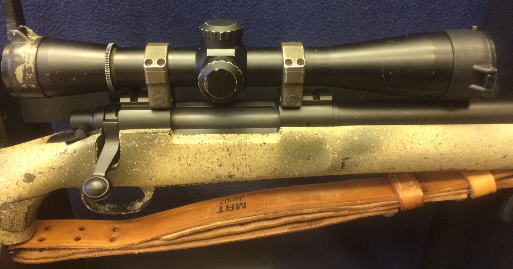

Finished up modding a WB490 rear and swapped out the OK Weber bases. Wanted to return this to an early issued configuration.

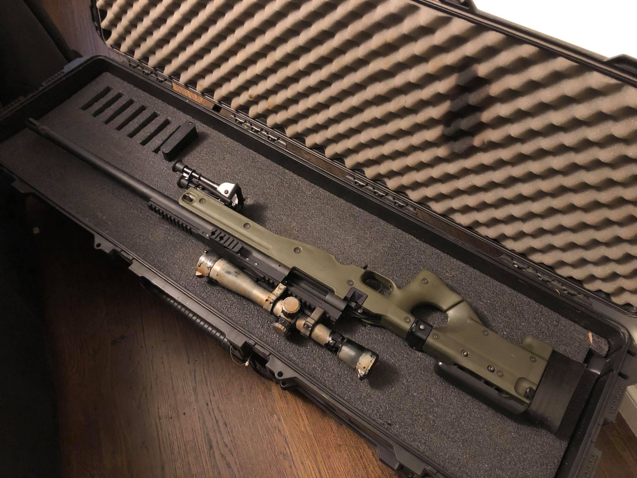

Rifle has small logo buttpad, Dakota bottom metal, 1989 Ultra M3a and rings/bases. Just received a 1995 dated sling and old style Allen case to finish it up.
Was also fortunate enough to snag an as new M49 kit to go with it.
Just a few more pictures, the original lsu(ema) decilog attached, the metal version with scan tag attached and the pair combined and finally just the ard, all mounted on a 90 m3a.

See post #671, this guy took two Mk 13 Mod 0 stocks, and built one replica in 300 WinMag, and built the other replica in 6.5x55 Swede, which with modern/full-power loads is a true long-range rifle that uses a long action. (Note: Lapua loads their 6.5x55 ammo at full power for modern actions, etc). Another option?...
View attachment 7420622View attachment 7420625View attachment 7420626View attachment 7420627
Your M49 is a nice find! I've got an M48 TM dated 7/59 you can have if you want it. Main differences are leather straps. Tripod & can are the same. LMK.
