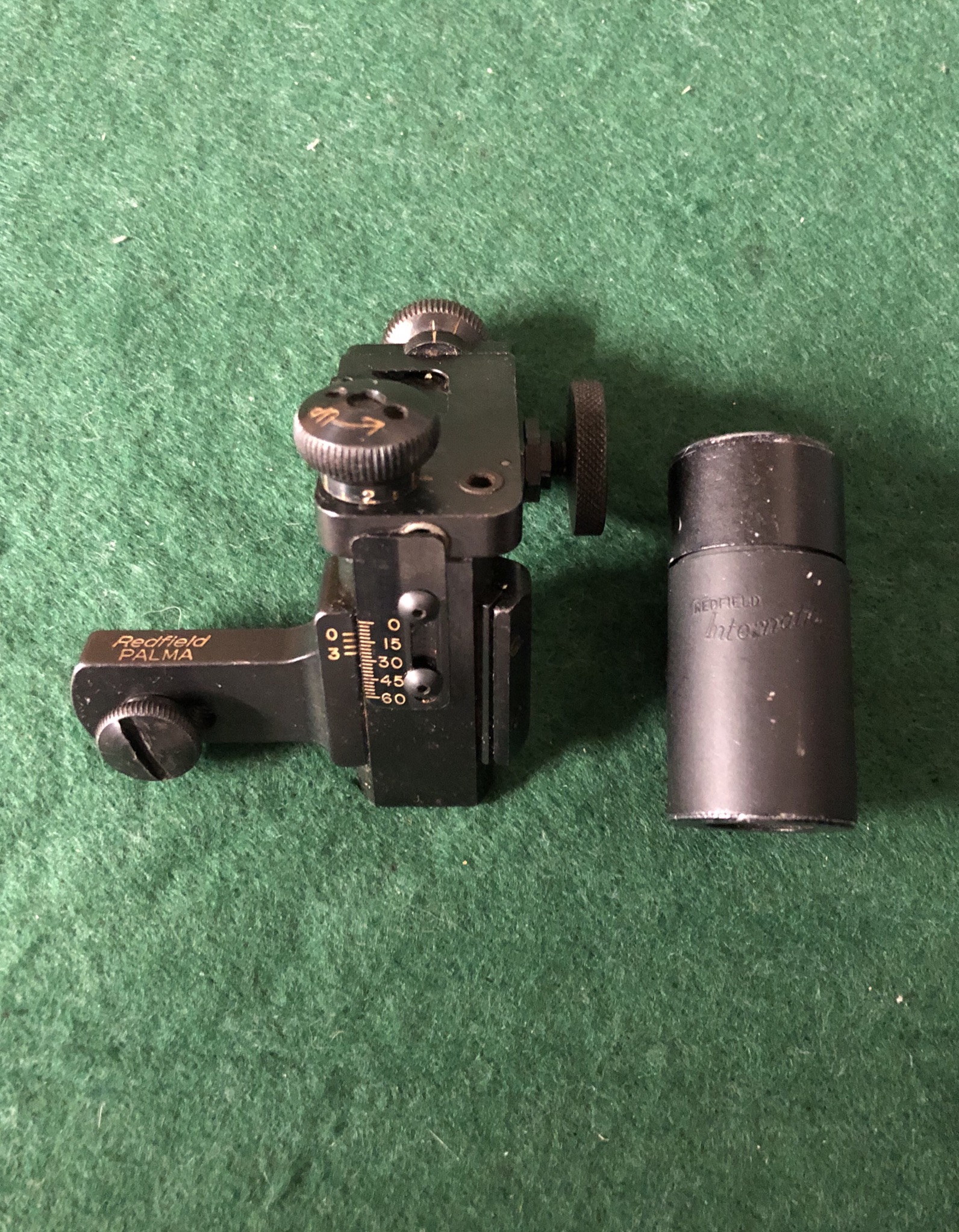

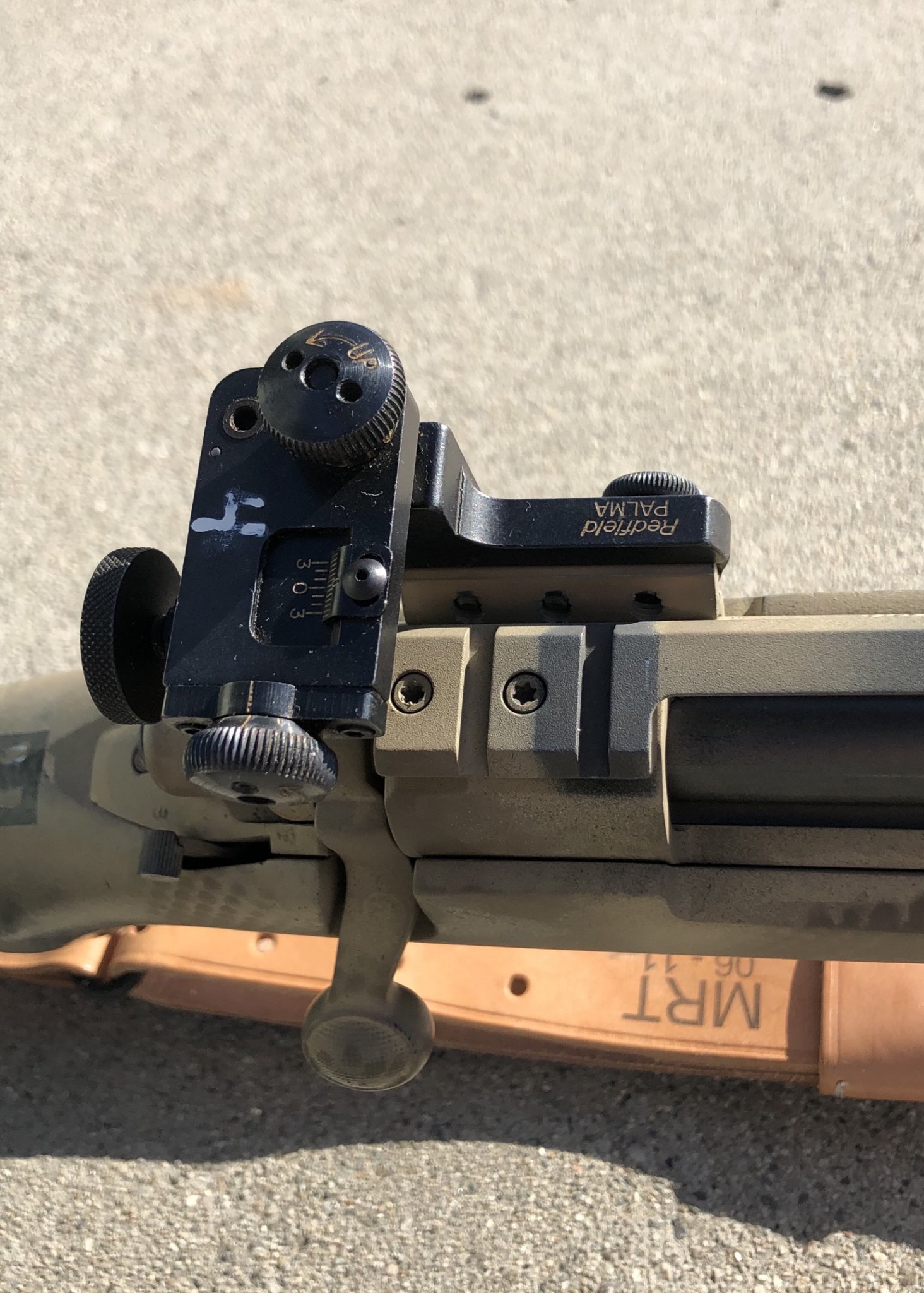

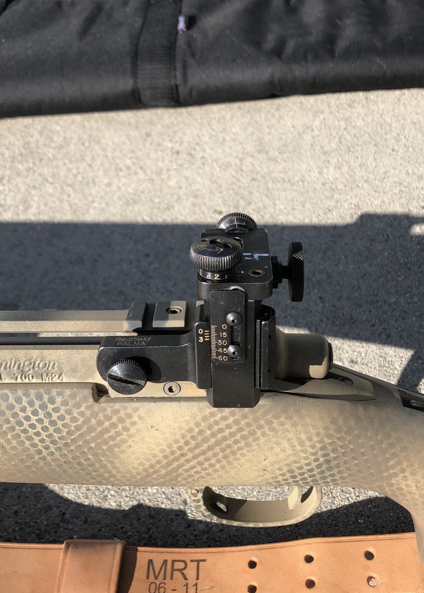

Why was the Redfield Palma rear sight spec'd for the M24? .308 155gr bullets were originally required in Palma matches. But now they allow 7.62 and 5.56. Did Redfield just choose that name for the sight, or was it designed specifically for Palma competition?

When I got mine, I looked some history up, introduced in 1979 to replace the older Olympic (1950's) and International (1960's). 1/4 moa depending on sight radius ( lenght of barrel). As for the name, no idea but I suppose as Palma shooters are iron sight guys it made sense. If I remember correctly from tge old thread, there was 3 models, mine has allen screws. Nice sights not that I uses them lol.

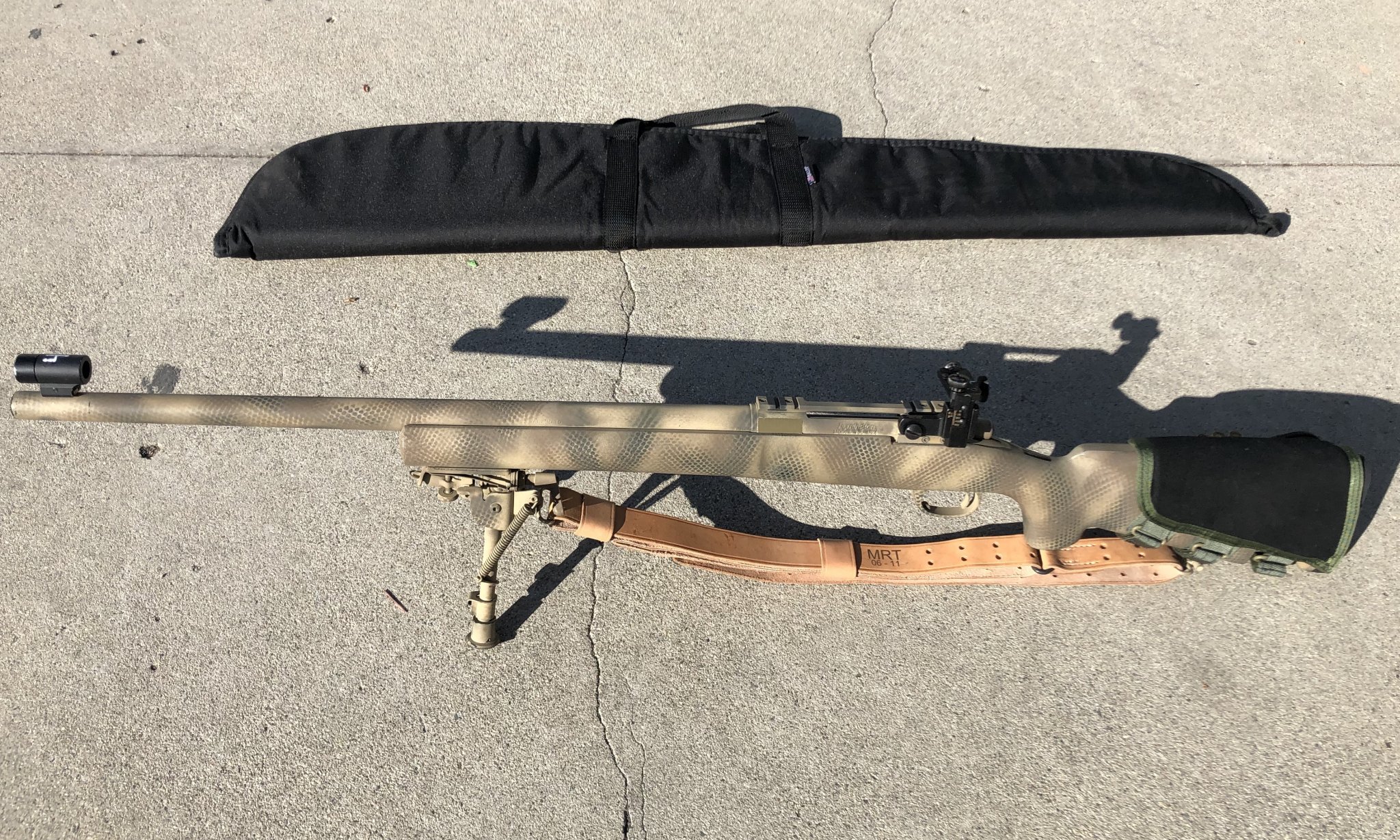

I have an ASAK related question? I picked up a box when I was still in, back in the day. I used the bipod for my M24R and have been using the Eagle drag bag as a regular use gun case for my various long range rifles. Should I start being nicer to that gun case? The rest of the bits might still be in the box.
I have a flash hider, still new( but opened) in the bag. They change the point of impact so they kinda suck to use. We had a five gallon bucket of them at one time that no one wanted, sadly I didn't want them either back then.
The Allen gun case was just a 48" gun case, not particularly interesting.

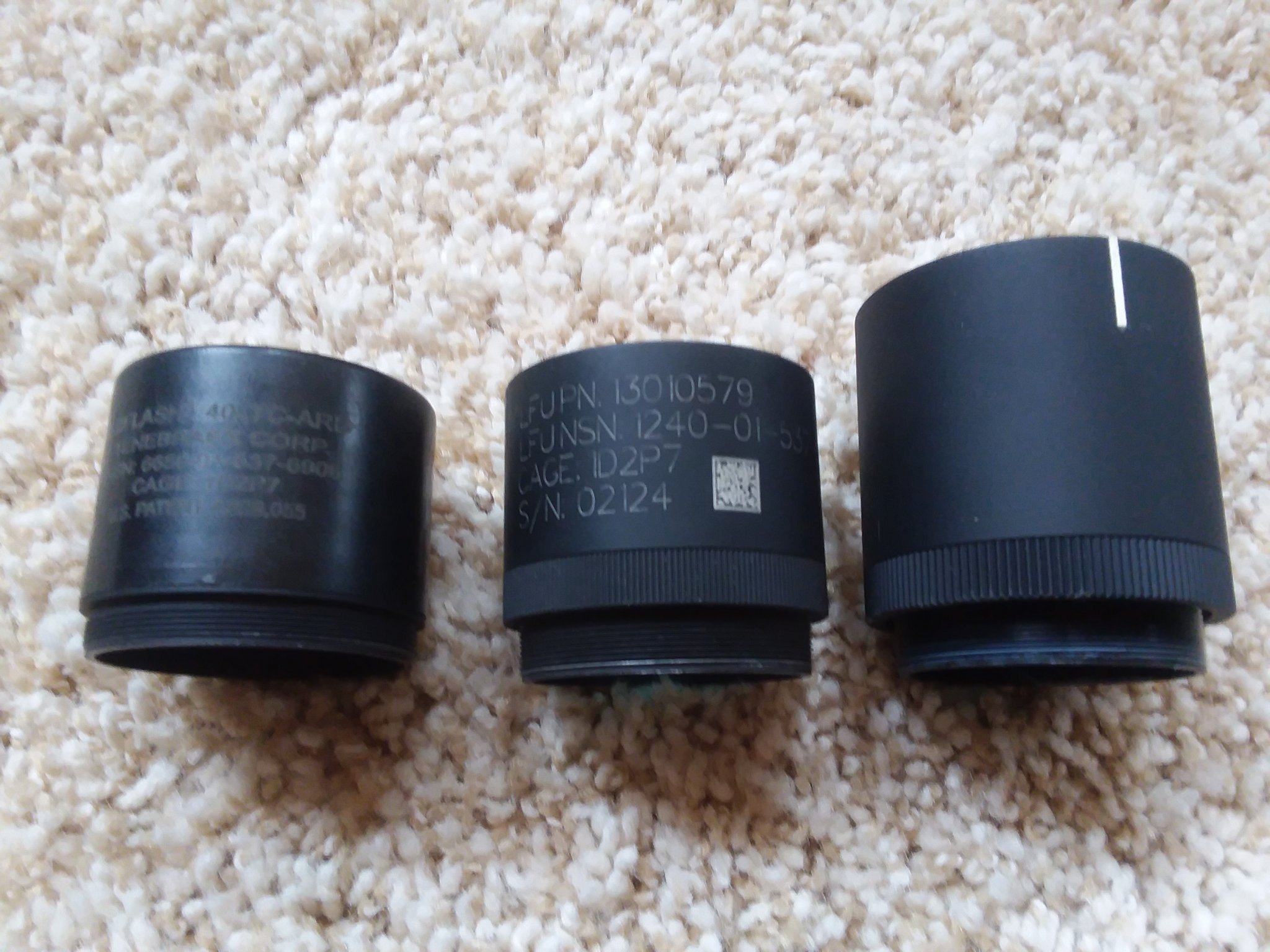

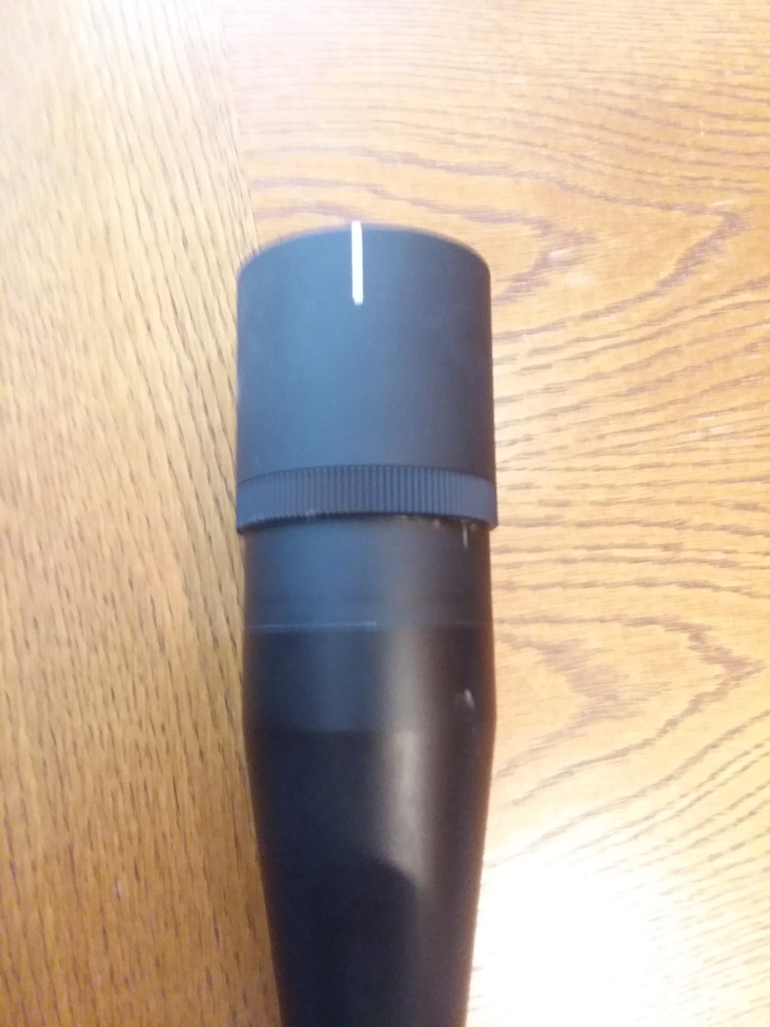

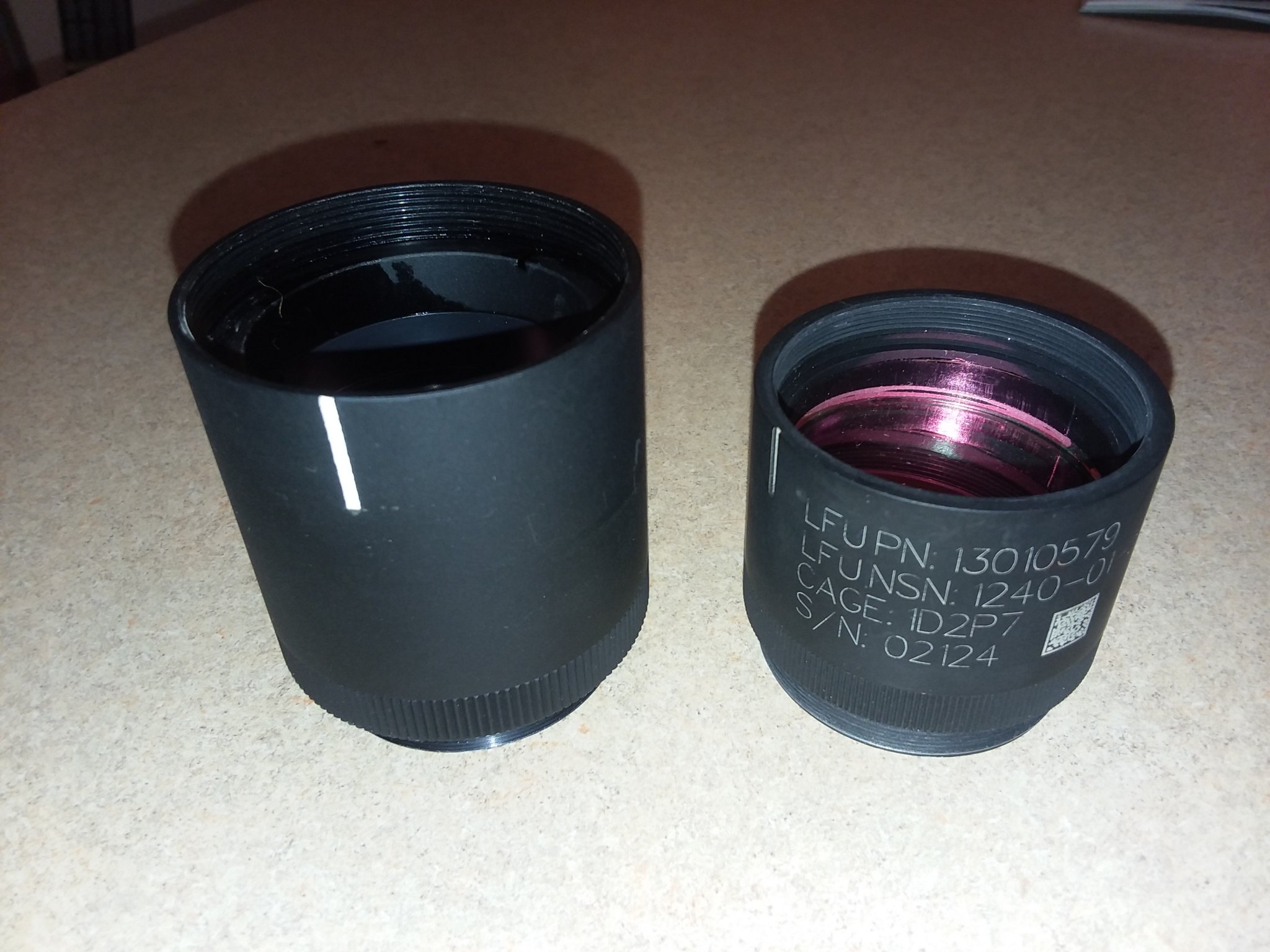

As far as I know these were for the M110 and not issued with the M24 sws. The plastic ones barely fit the ultra, they stopped making the plastic filters and made them from metal which actually fit on the Ultra without much slop. Early ema are from the nineties, when was that plastic filter made 2005.
Picture of the later metal filter woth same nsn
Plastic ard, metal filter and original
Decilog ema from 94

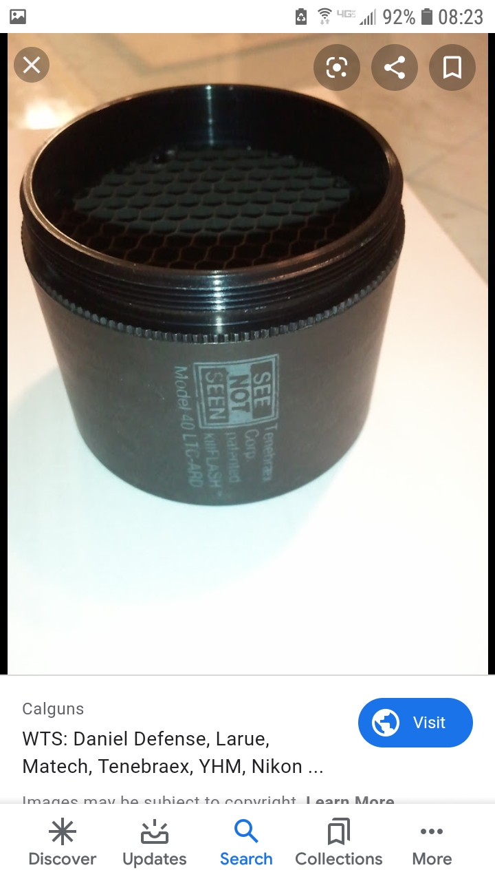

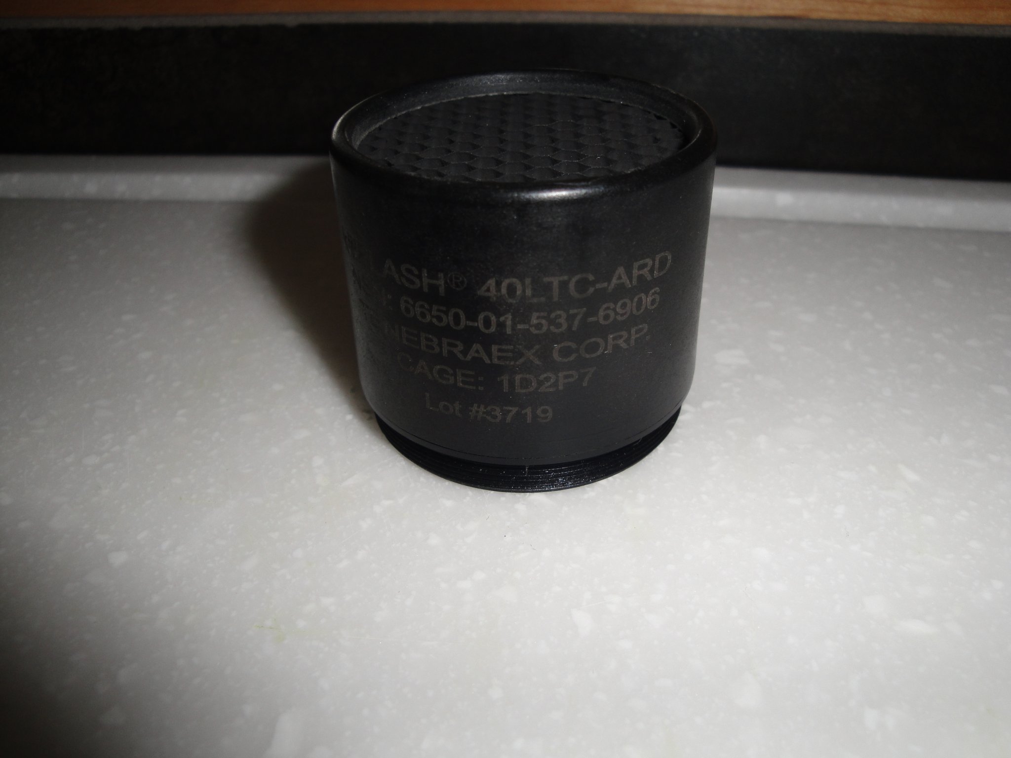

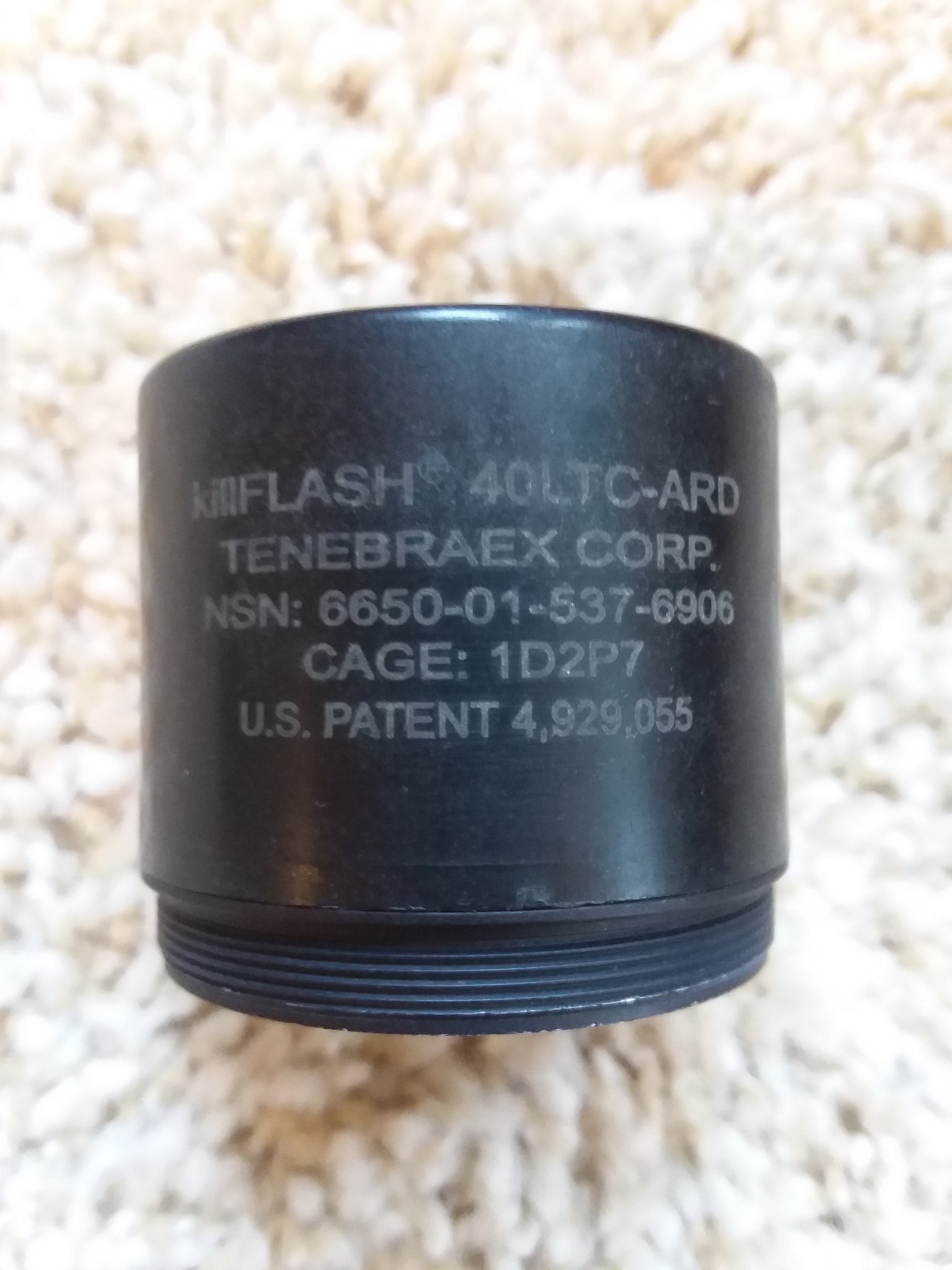

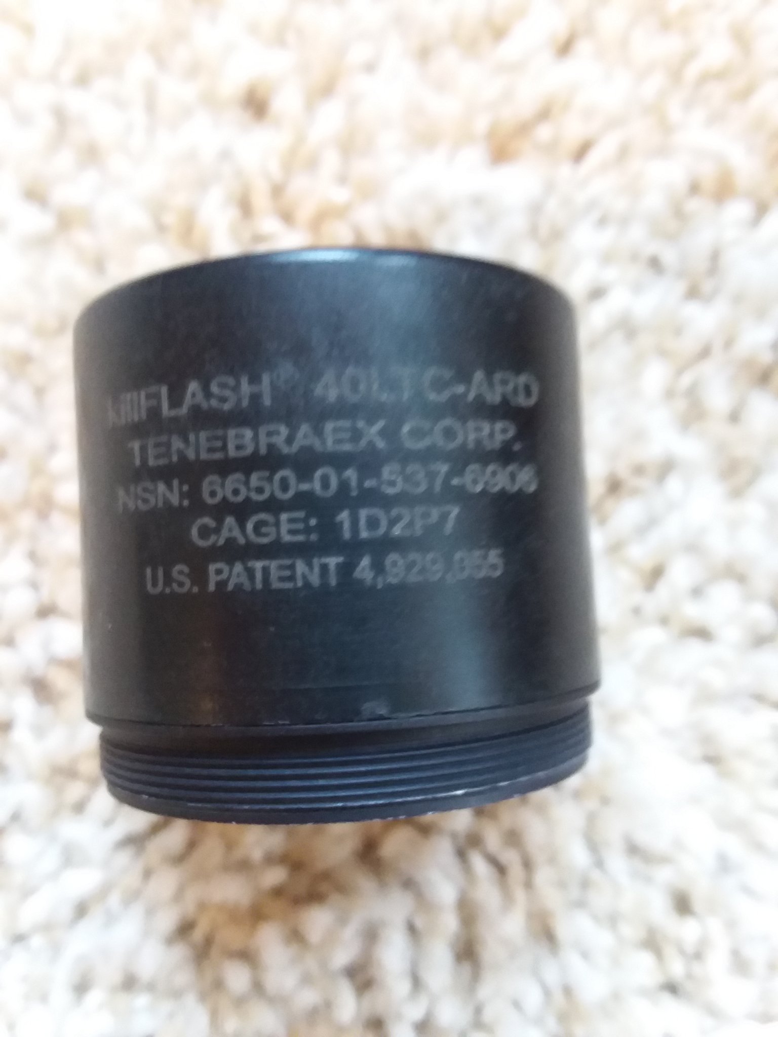

My Tenebraex ARD has a plastic main tube with an aluminum threaded mounting insert. Hard to tell because it only weighs 24 grams total.
With regards the tenebraex ard, they are basically all thr same but the writing on the side is placed a little different. This is mine, writing is placed a little different than yours

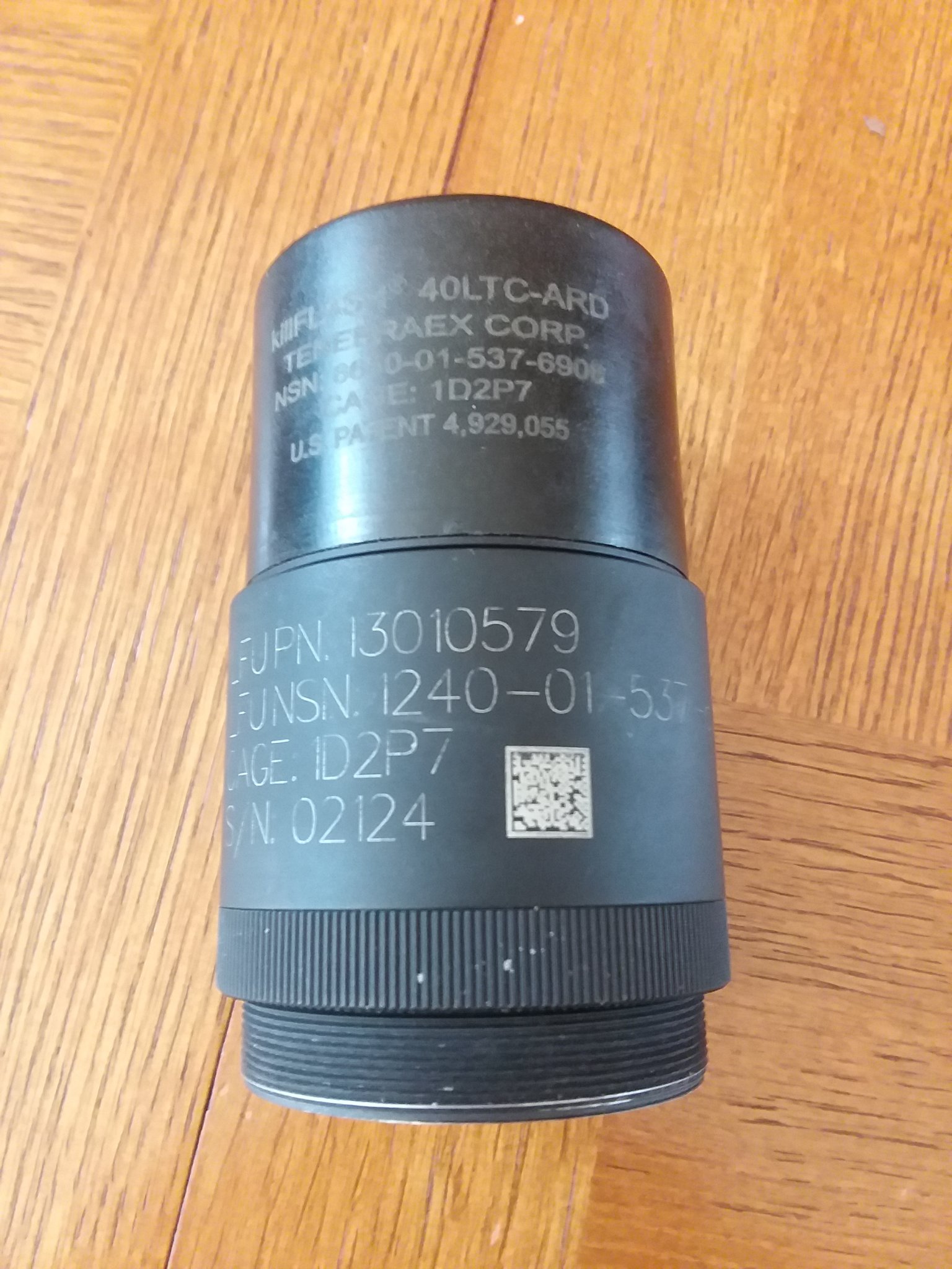

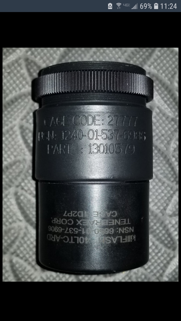

This picture is of the latest manufacture

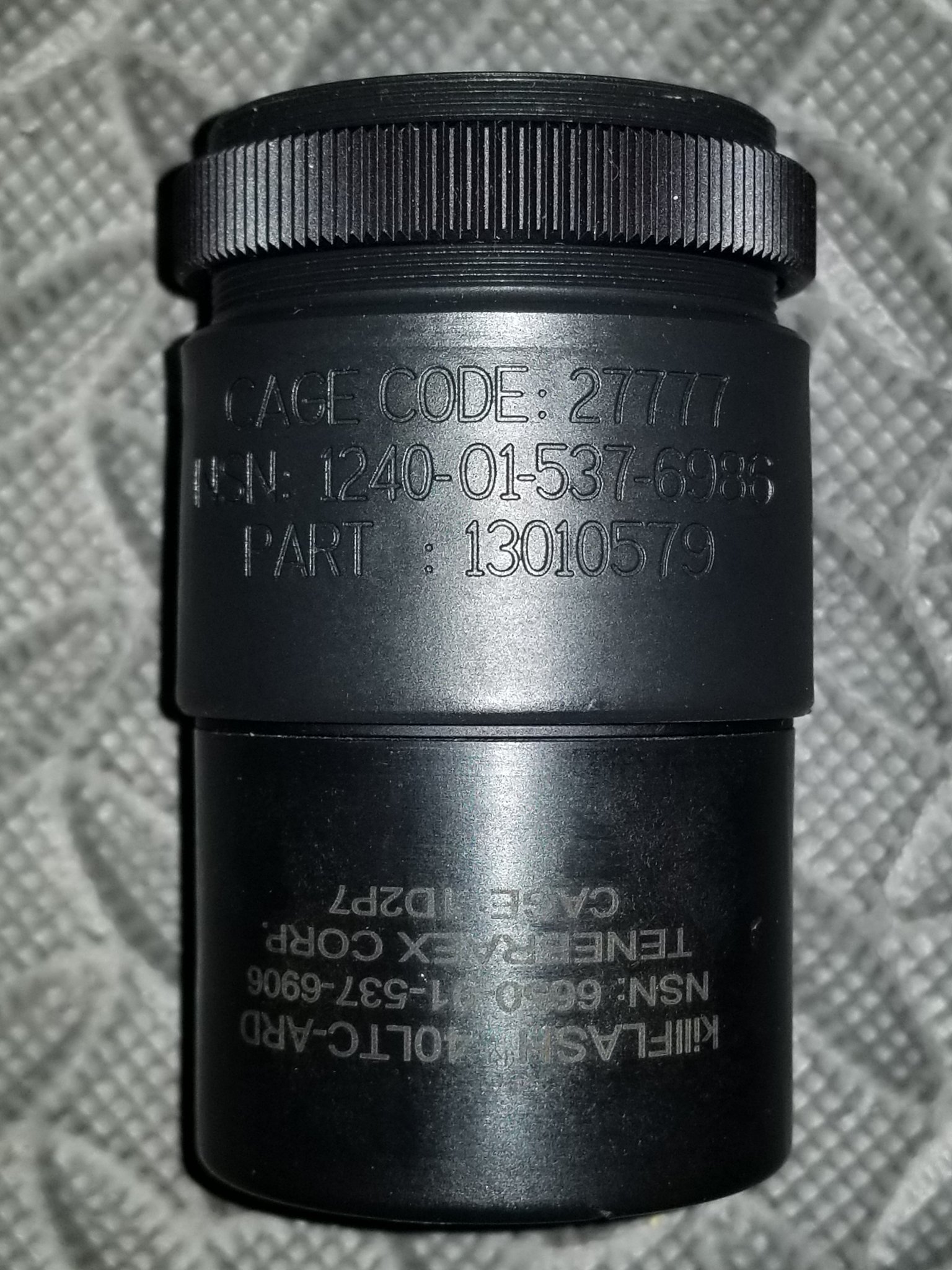

So this laser filter unit was made by L3 communications for the m110 and the nsn is from 2006.
The later metal one was made by tenebraex for the m110 and the nsn is also from 2006.
The original ema was made by the US Army ARDEC and then by Decilog, the nsn 1240-01-380-6326 is from 93.
The 40ltc-ard made by Tenebraex nsn 6650-01-537-6906 is from 2006 as well.

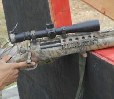

Two or three things I might note. One, Crane makes the sniper rifles for SOCOM, which includes Navy NSW/SEALs, Ranger Regiment, SF Groups, etc. Two, Nick Irving was in the Ranger Regiment. Three, its at least possible the MIRS rail in the above pic on an M24 was one of the 600 units that Crane acquired in 2004ish. (I don't think they had that many M700/300 WinMags at the time, maybe 300 or a little more? - not sure).
In fact, I have seen pictures of M24s with the MIRS/MRS rail being used by SOCOM guys and possibly Rangers like Nick Irving, I think in Iraq. (see below pic with 2 M24s equipped with McCann rails, along with a Mk 13 Mod 0 in the middle)
Hence I don't think the early McCann (MIRS) rails were unit purchases, but rather a Crane purchase for SOCOM sniper rifles, mainly the new Mk 13 Mod 0/1s, but possibly M24s as well. (I have no other knowledge other that what I just wrote, so its just my opinion).
