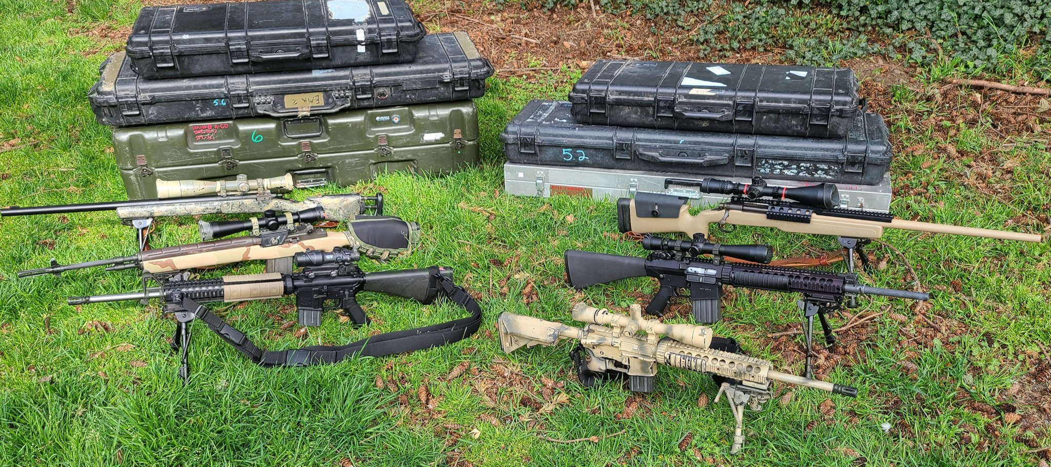

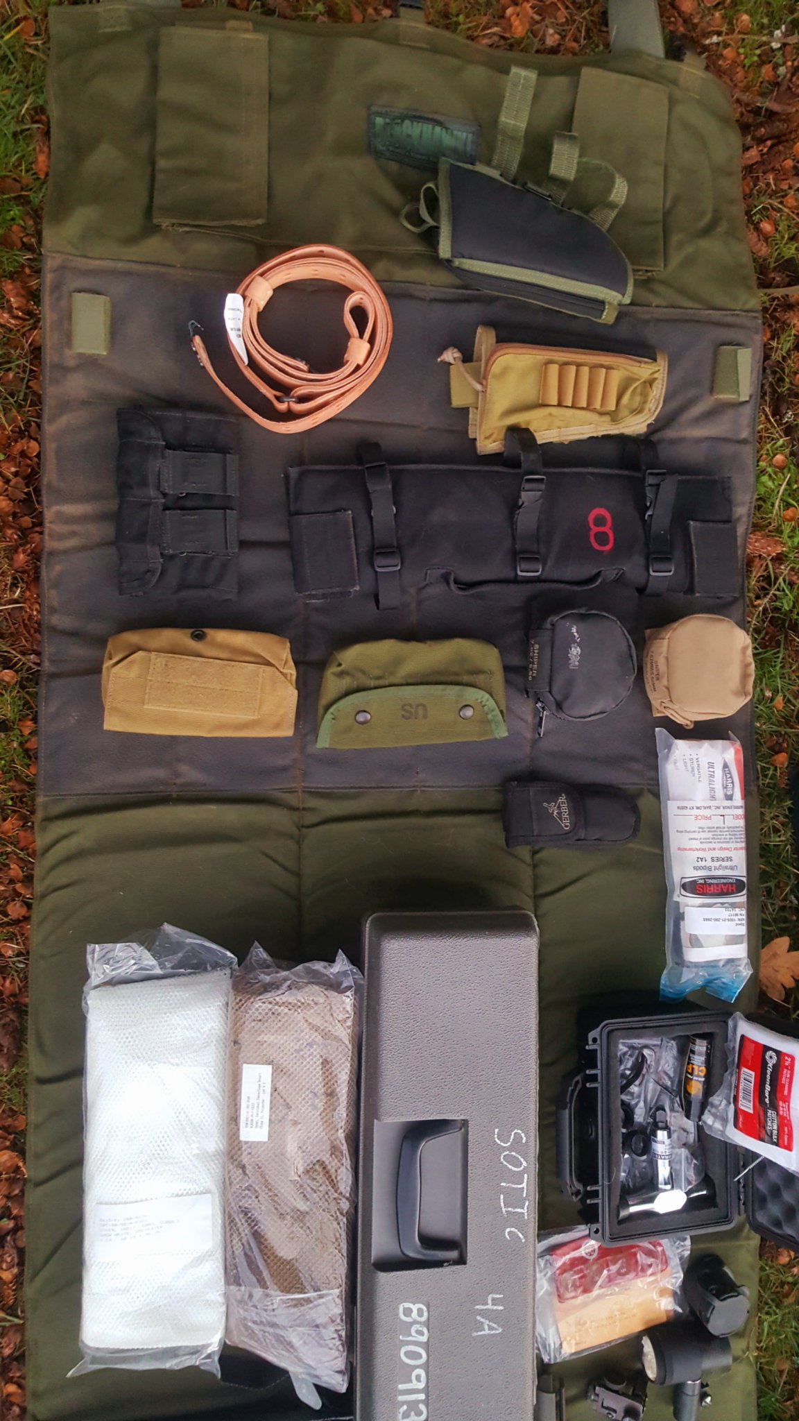

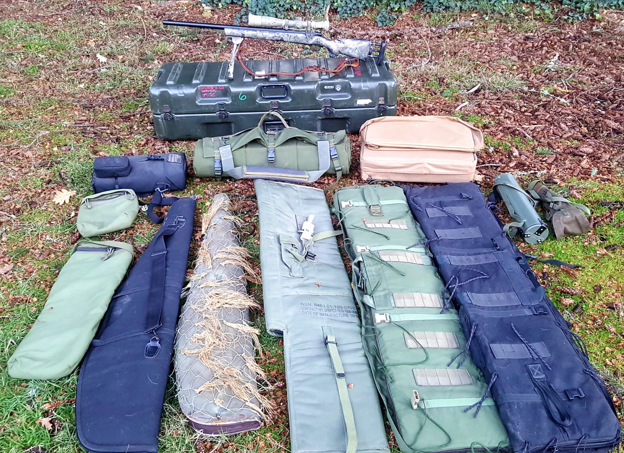

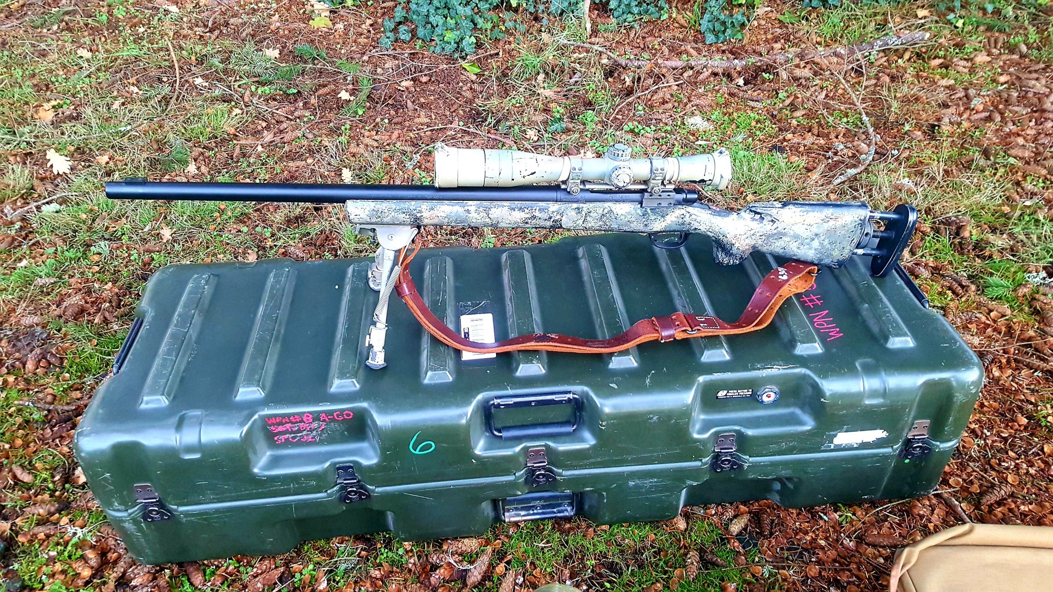

Haven't dropped in here for a while. Still collecting parts. Rifle still hammers.
I'm not sure at what point gathering kit items gout out of hand but....here we are.
Attempting to have most everything from initial issue to ETS. I modified and parkerized Redfield bases to go with the early stock, bottom metal and Ultra scope/rings/base. This is one of the M24Rs that was sold in the mid 20teens.
