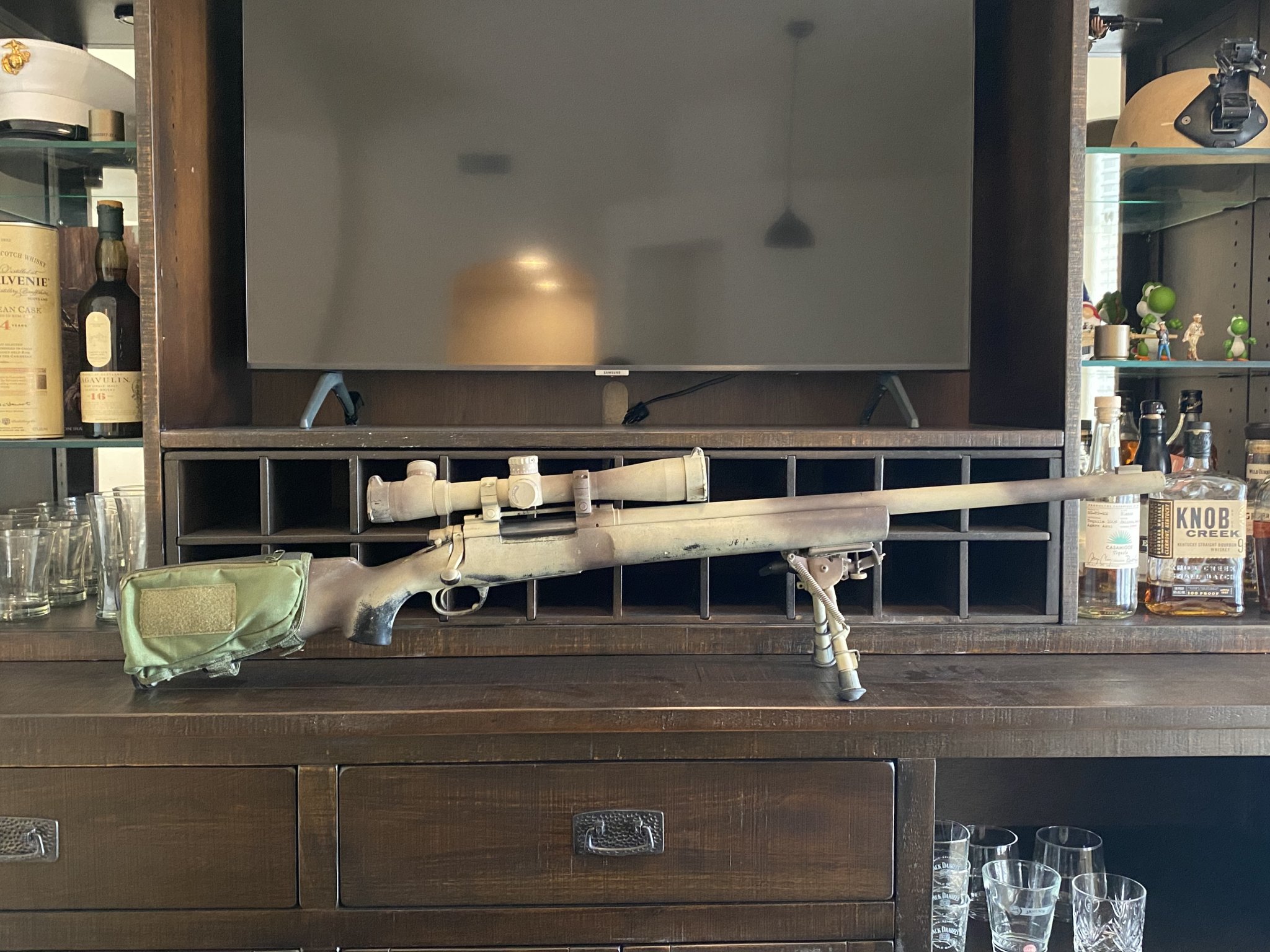

Damn that S&B looks good on there. What model is that??
4-16x42 PM II. It has the PR Gen II Mil dot, so I'm not even sure if it was built by S&B. I heard somewhere that PR built the S&B's that had their reticles in them. These may have seen limited use use in service, but I think the one with Horus reticle were more common, and they weren't common either. As far as I know S&B doesn't make this model anymore. I was told this was a T&E scope, but I have no way to verify or care really. It's a great scope.

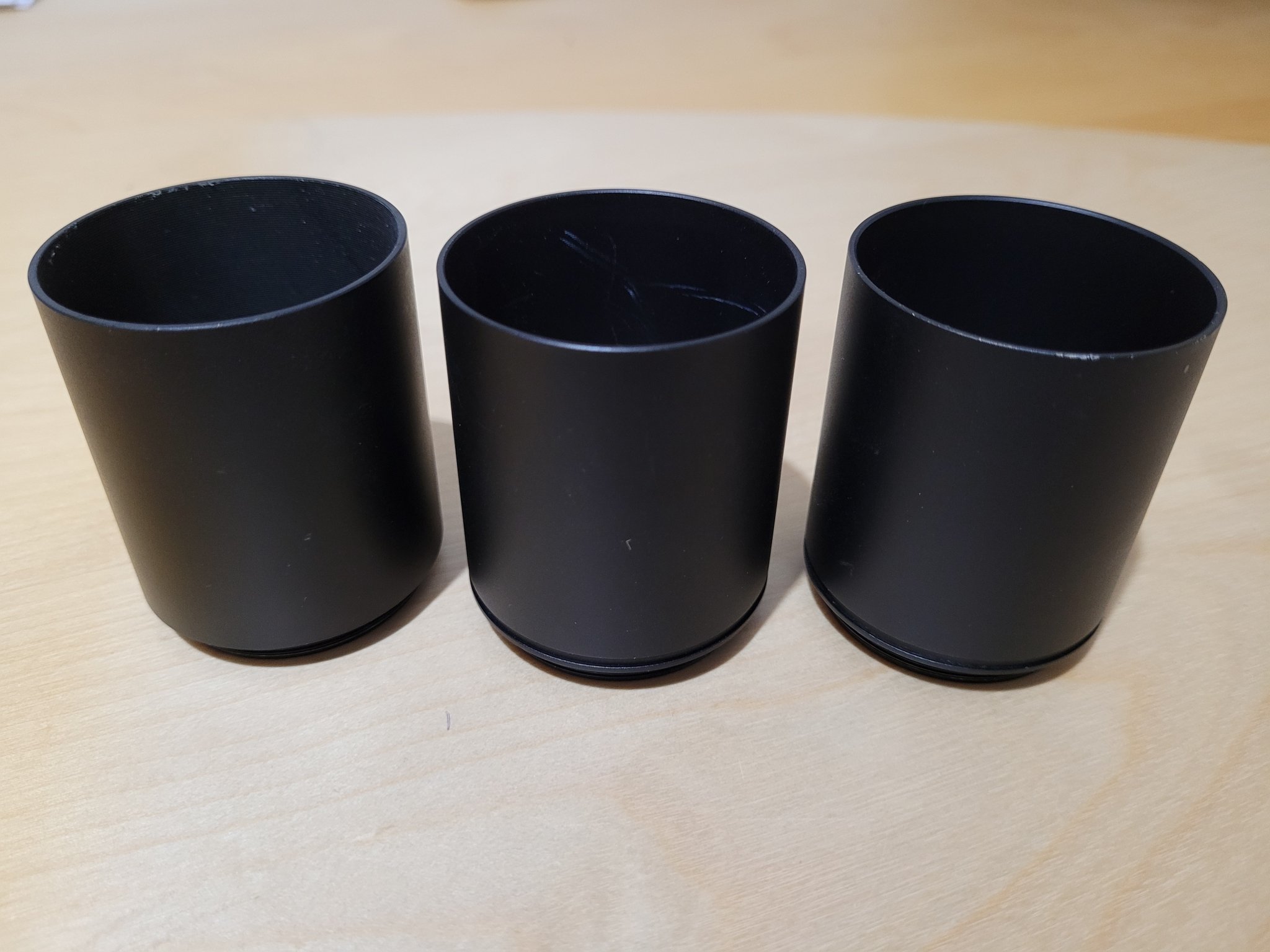

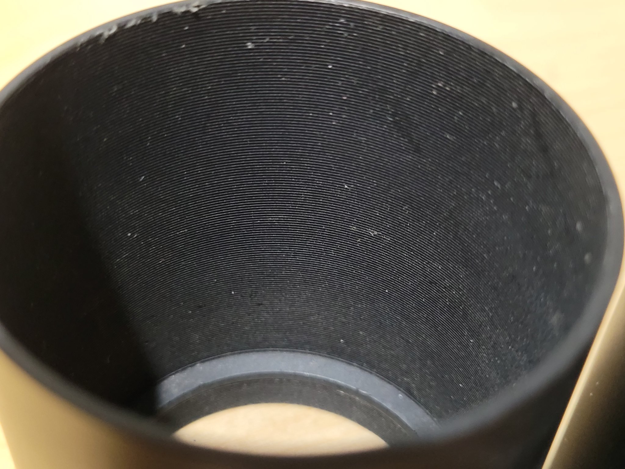

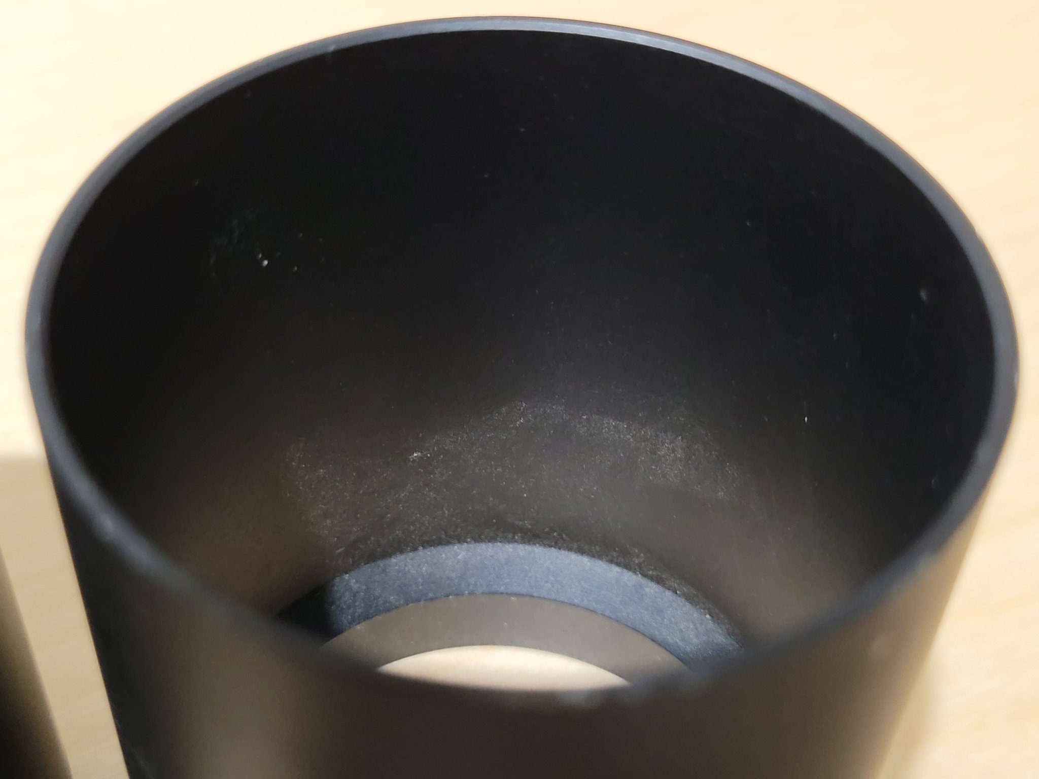

Looking thru some of my sunshades, obviously one is not grooved, the other two are. Always just assumed they were MK4 m3 versions, with the interior threads at the muzzle end so they could be joined. But it appears none have real threads that could actually used, the original on the left and the middle, have a faint thread texture, the one on the right is completely smooth inside.

PR built many 3-12's, 4-16's, and 5-25's in house, Germany would send parts and PR would build them. Mostly they got Gen 2 or Gen 2 XR reticles (4-16 and 5-25 only) but PR installed Horus reticles too. Horus would send several reticles but they were generally shit quality so you got what you got. There are pics of USMC Recon using some 4-16's with Horus reticles and an Army SMU used them, another government agency put in an order but I believe they switched at the last minute and got 5-25's. The crux of the 4-16 is its lack of elevation adjustment but otherwise it was an excellent scope.
I could definitely see this as an issue with any larger caliber than .308. For the .308, it seems just about perfect as it will get me out to ~1200yds.

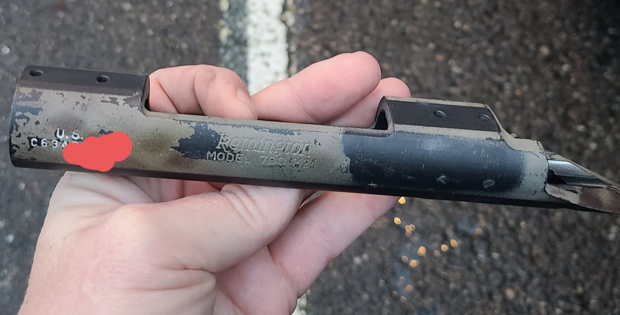

The NRA Museum serial number is higher!

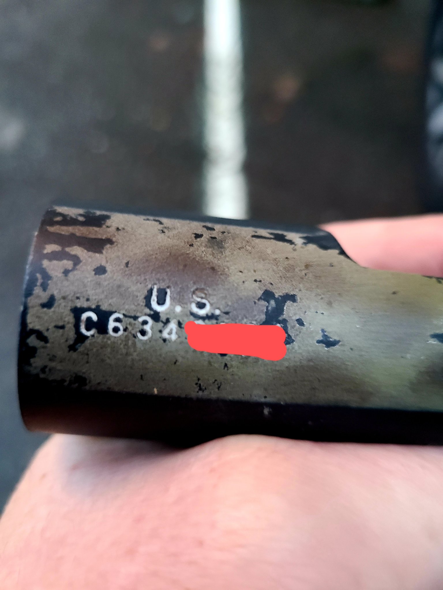

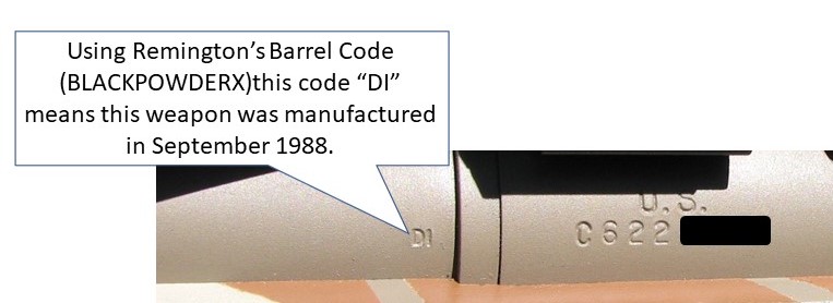

Just to be clear here folks before everyone gets too excited, the serial number range doesn't necessarily denote the date it was manufactured into a working firearm from Remington. The receivers are built in batches, serialized and then they're binned. Some of these receivers would be picked and taken into the Remington Custom Shop M24 line and assembled. The actual birthdate for the weapon is depicted on the barrel code. This is my 1988 M24 which was delivered to the Army either in the first lot of 100 in Oct 1988 or the second lot of 100 in December 1988.
Refer to this site to decode the weapon manufacture dates for nearly any Remington firearm. Remington Society of America

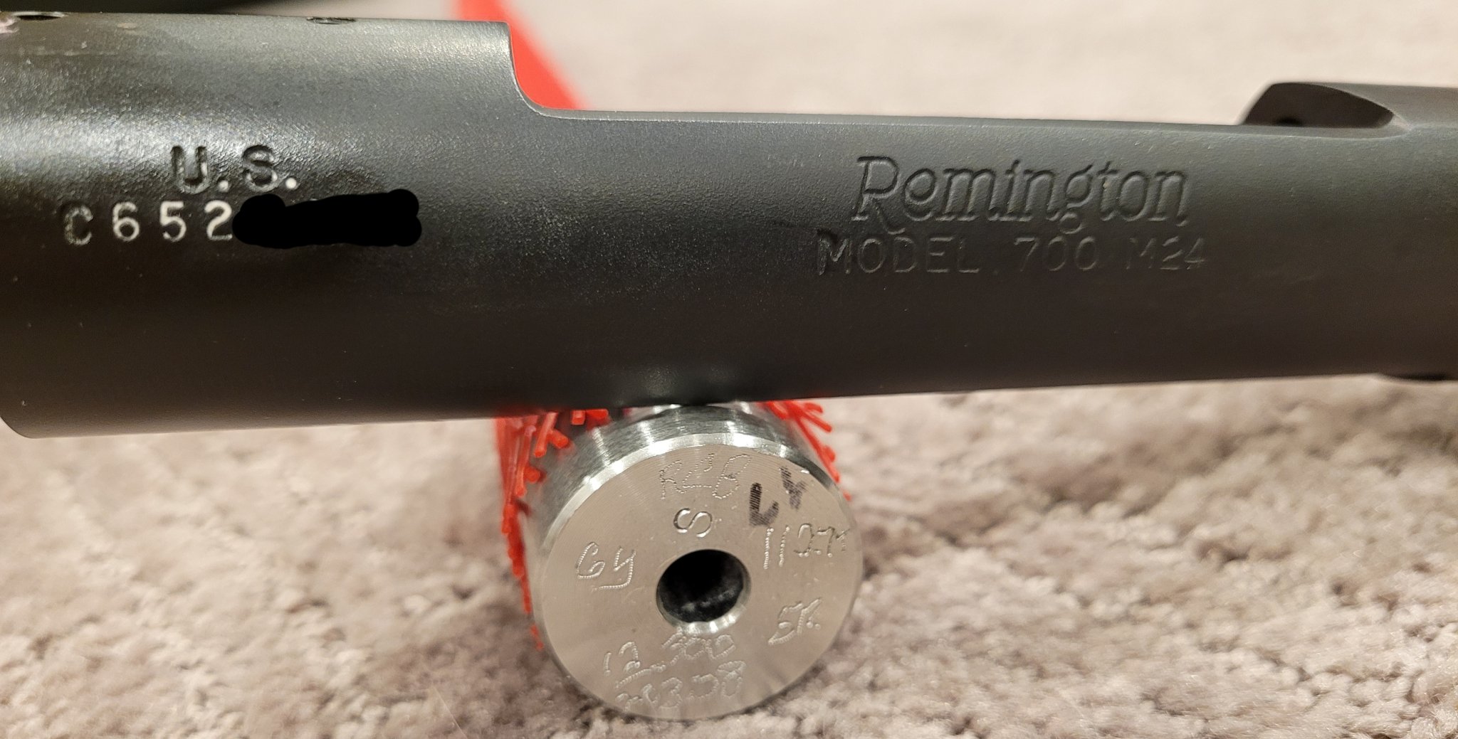

Long time lurker as well. Here's the beginnings of my build. Barrel blank is Rock Creek's M24 profile with the correct twist rate.
I still need the rest of the parts, including a bolt. Were they blued, jeweled, or stainless under the coating?
The bolt forward of the bolt handle was coated in dry film lube, the handle and the rear portion, the firing pin and housing, were powdercoated. The underside of the bolt handle has the serial number letter prefix and the last four of the serial number engraved (stamped) matching it to the receiver.

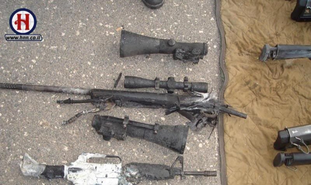

Didnt the Egyptian M24 come with these muzzle comps threaded on? This pic was recovered weapons from a bombing. It may be their version of flash hider for night vision use. Thats an Aquila 6X AN/PVS-12

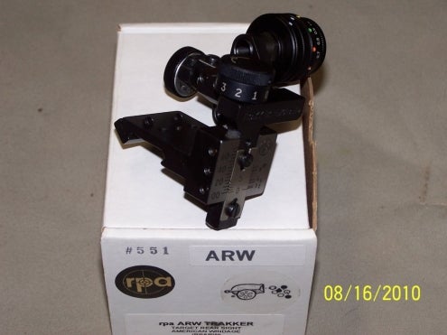

There's another option to avoid a rear iron sight base, and that's to use an RPA or Centra rear sight for Picatinny rails -- they clamp directly to a Pic rail base:

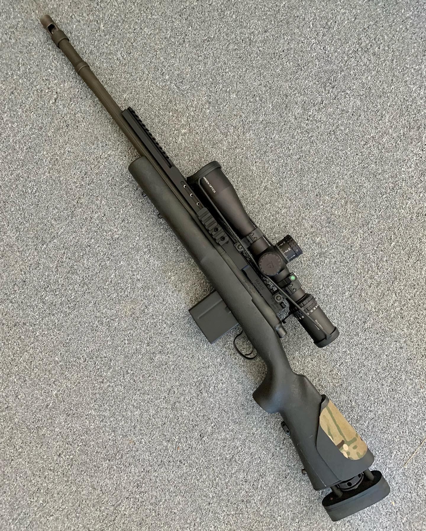

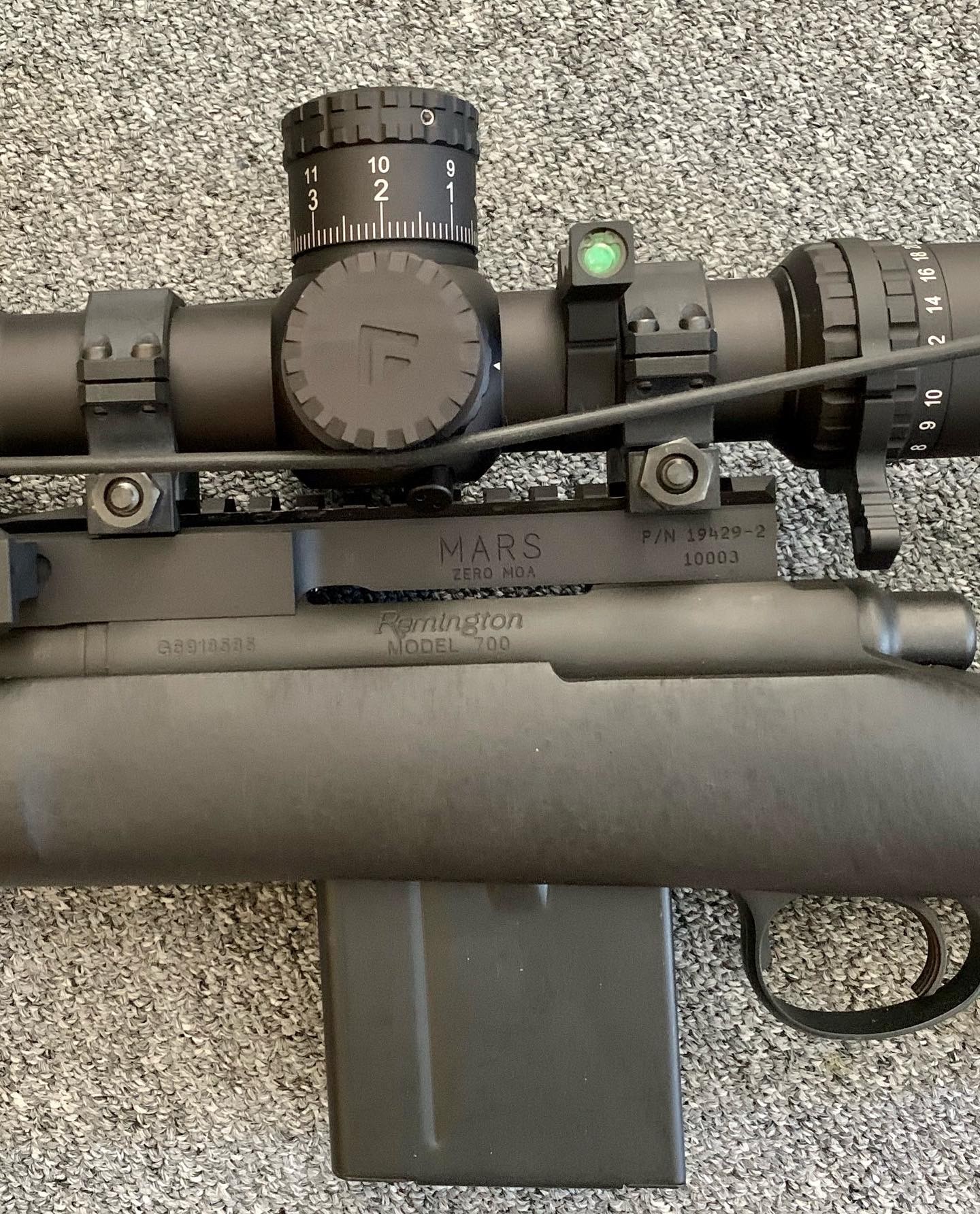

Yes, I developed it. The USR came about because there were a number of foreign countries that were looking for sniper systems but didn't want to spend $7K+ on one. Additionally the environment that their snipers would be working in was predominately Urban. On top of that our LE sales side was looking for something to promote to US LEA.
Ended up picking one up
