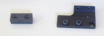

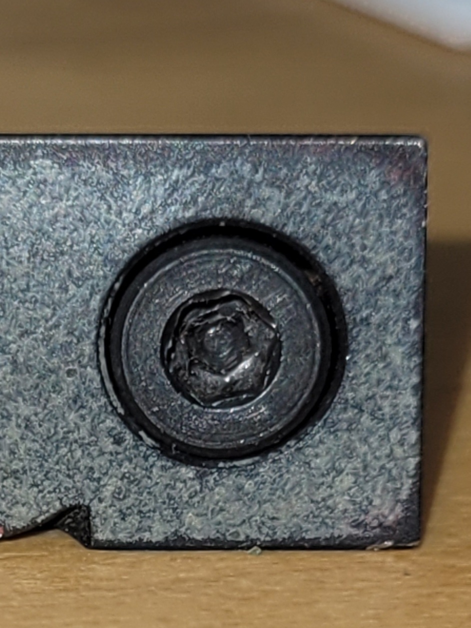

Just picked up my first long range rifle, happens to be an M24. Looking forward to shoot it in March when our range opens up the 600+ yard line, but in the mean time looking for some parts to finalize the build. I managed to snag the last rear sight base OK Weber had before they shut done, but they were unable to supply me with the correct screws.
Would anyone happen to know where I can get the screws for the rear iron sight base? I believe the specs are 6-48 thread, 3/8 length, with a 7/64 low socket head(which appears pretty unique, my google-fu has been fruitless)
NSN number is 1005-01-260-2653 but I believe is exactly the same as the front iron sight base 1005-01-260-2654.
Any help is appreciated, pic is of the screws I’m looking for.

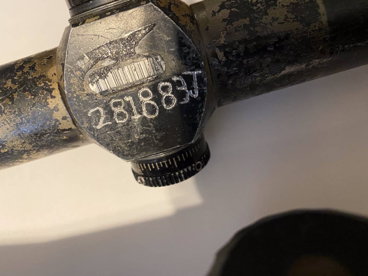

Thank you. I have another question you may have the answer to. Curious as to why this Ultra M3A surplus scope had a new serial number electro-penciled over the original serial number?

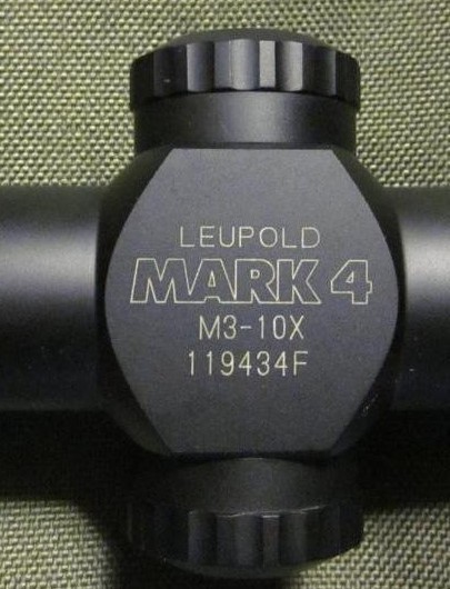

That's a puzzling photo. The M3A scopes had markings that covered the bottom of the scope turret. If this is a M3A, they not only electro-penciled a new serial number but they defaced all the markings on the bottom. I see no trace of the M3A markings at all. If this was a later model M3 the same can be said. There are later model scopes that I THINK only have a very small serial number which, if this is that type of scope, could be covered up by that bar code sticker. Anyone else have any ideas? As to why the serial was electro-penciled, it could be that the engraved serial is concealed by said bar code and they wanted it visible.

If you hold the scope in the light just right you can see the Ultra as well as the SN, which begins with an 88.
Must be coats on top of coats of paint. If that's the case then it is indeed a new serial number because in those days, L & S prefixed the number by the two digit year. I would bet though that electro-penciled number matches the bar code.

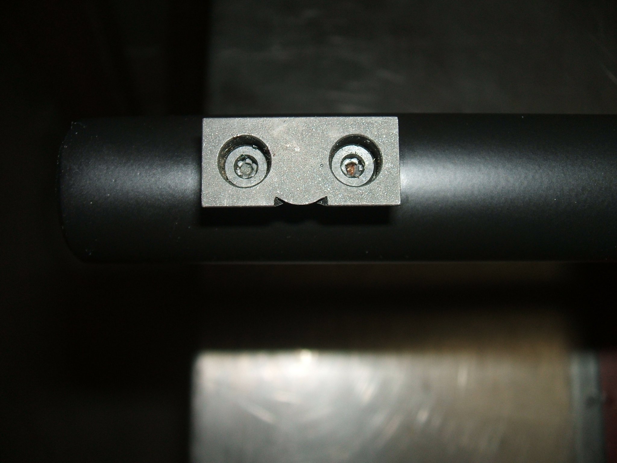

What tool is needed to remove the front sight base? I got nothing that will work. Looks to need a specific tool. Photo attached.

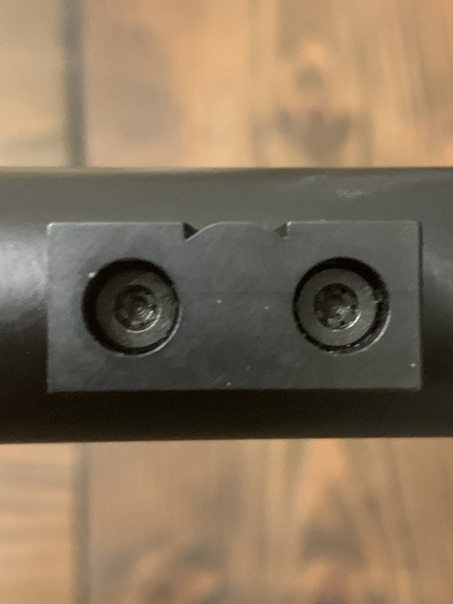

Question regarding the Rpa sight bases: I know the front bases that came on the asa models are blued, but for military shipped rifles does anyone know if the correct finish should actually be a manganese park? It’s difficult to tell from photos I’ve seen, as some of them look to have a more matte/dull finish than the straight up blues pieces.
Perfect, now does anyone know where I can send these off to get parked? OK Weber has shut down their doors(I managed to snag the least rear sight base and front globe from them) so if I lose these I am SOL
I've had very good experience with Gunblack.com for parkerizing.
It's really, really easy to do yourself. I do all small parts at home using Allegheny Arsenal park solution.
