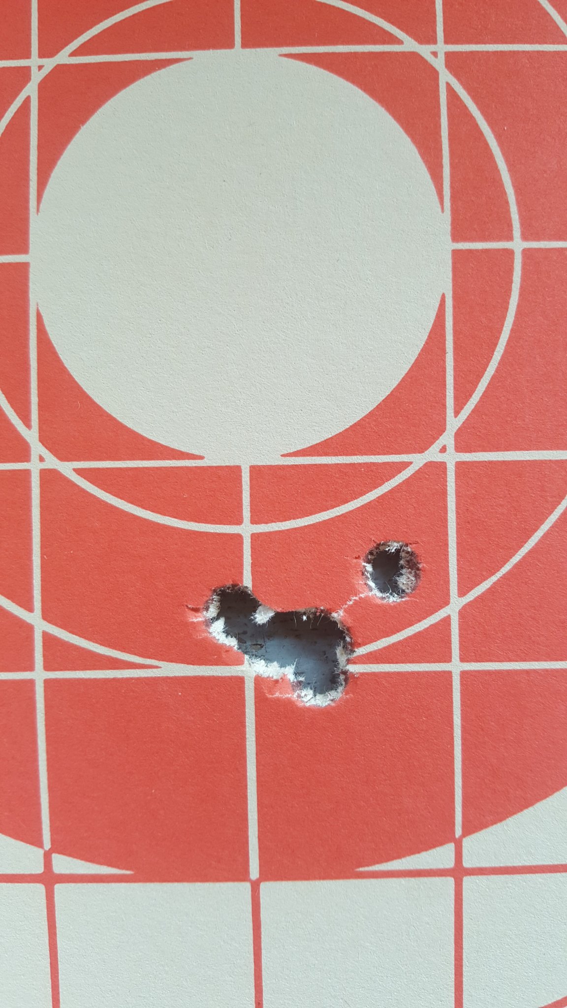

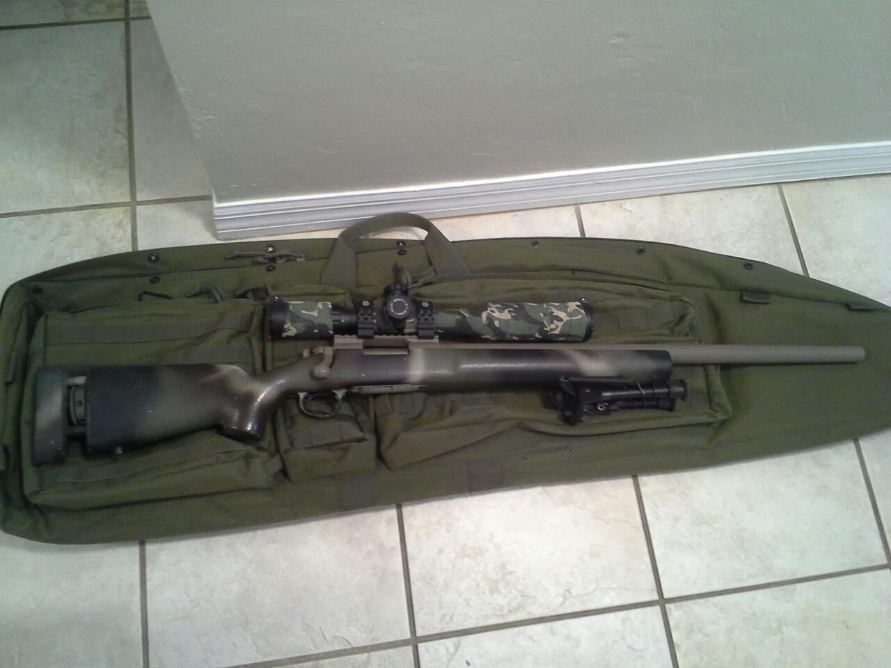

My M24.
Holds half MOA all day with FGMM 168gr.
Bout to sell it and gamble on a GAP in 6.5 though. I never thought I'd be moving away from 308, but here I am.

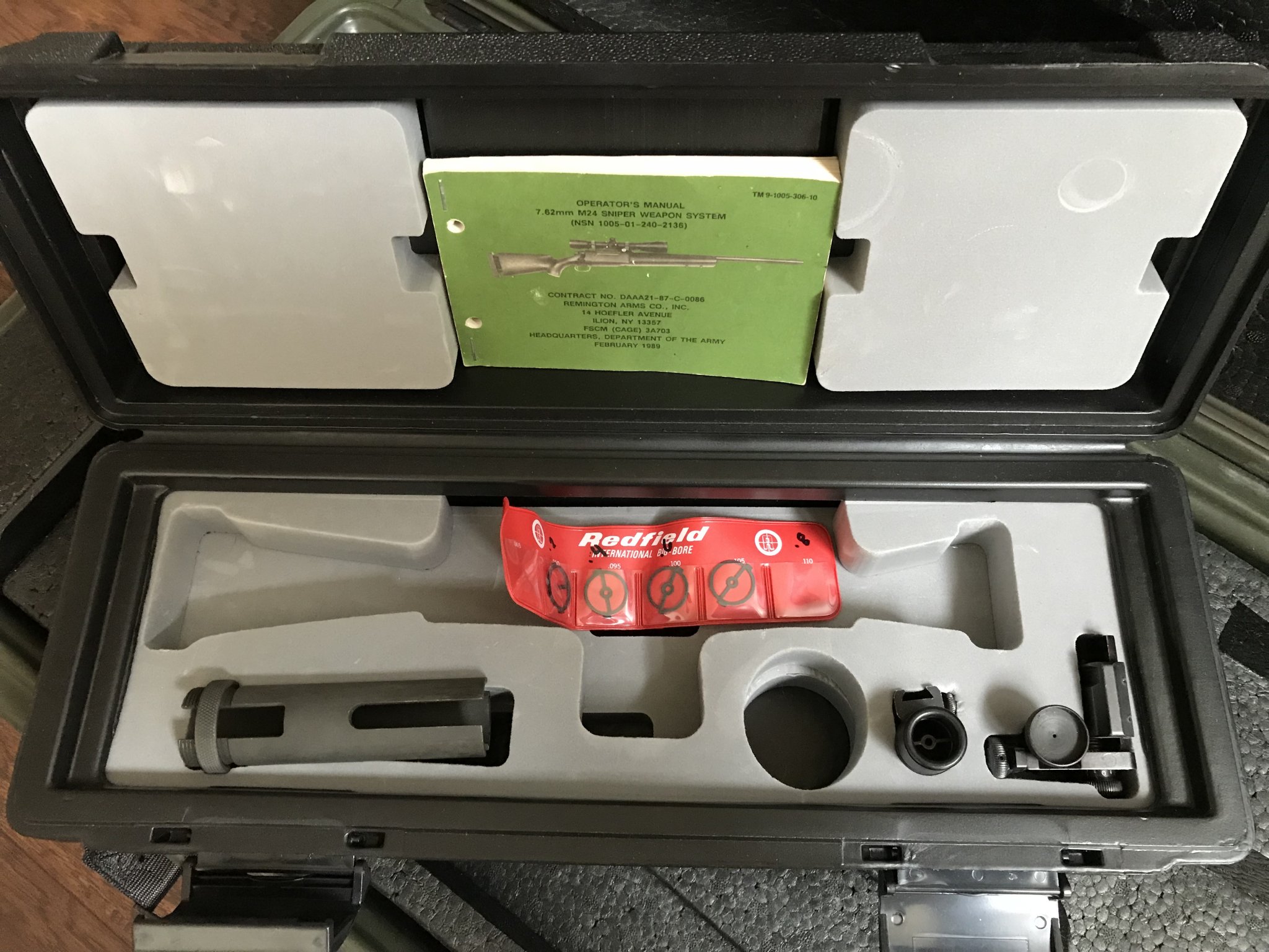

Can anyone identify which hard case this version is for? Its different than the original one. Grey plastic, different liner, etc
Its just a generic Pelican case, comes in different colors, dont believe it was an issued item, something Pelican was marketing for the rifle presumably the civilian side.

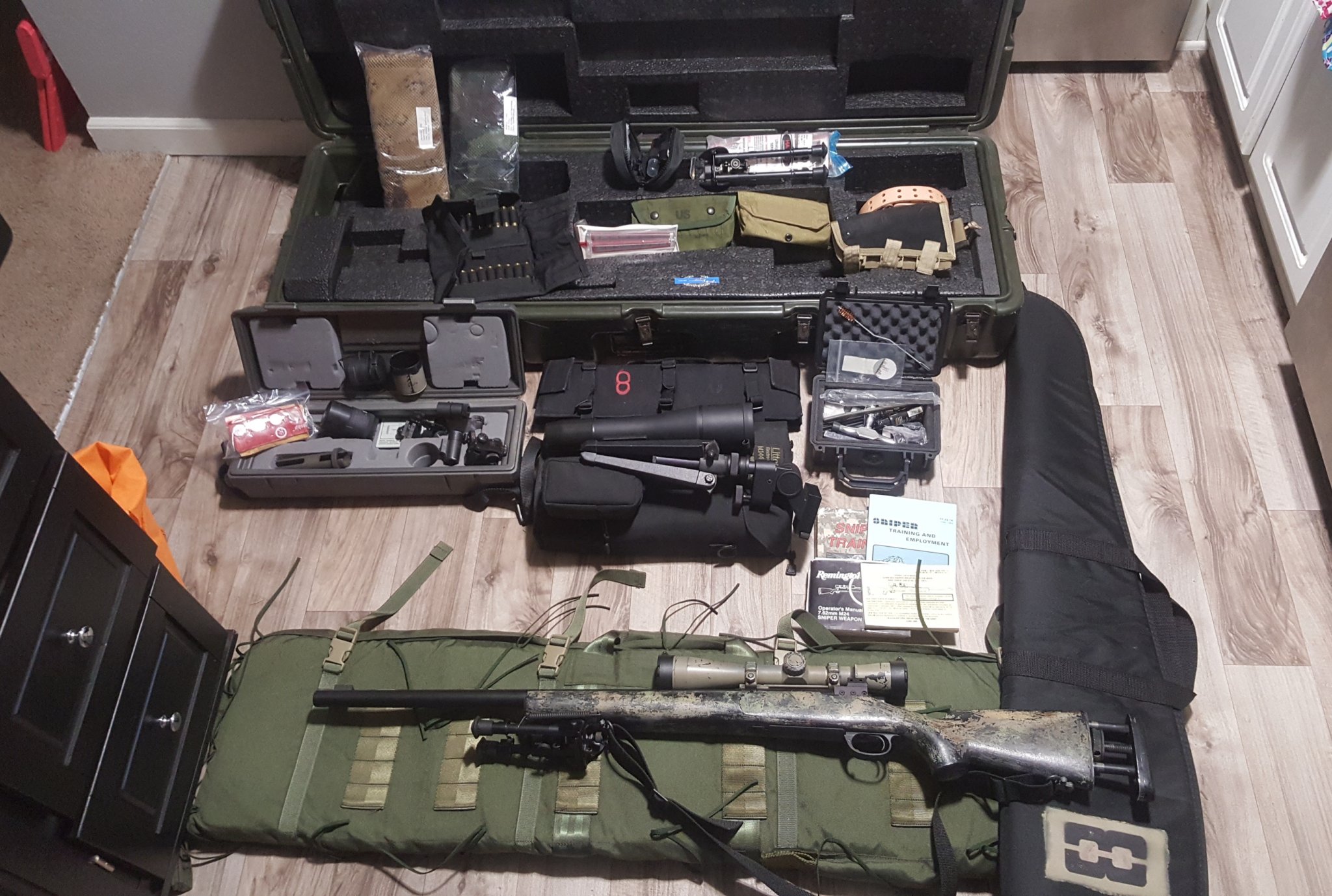

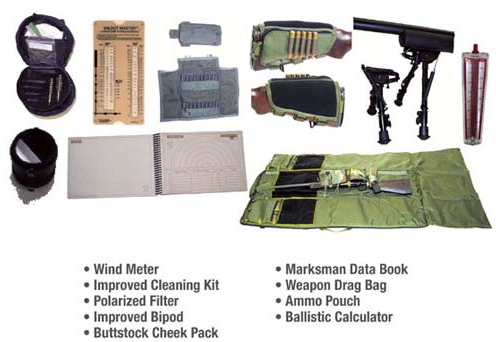

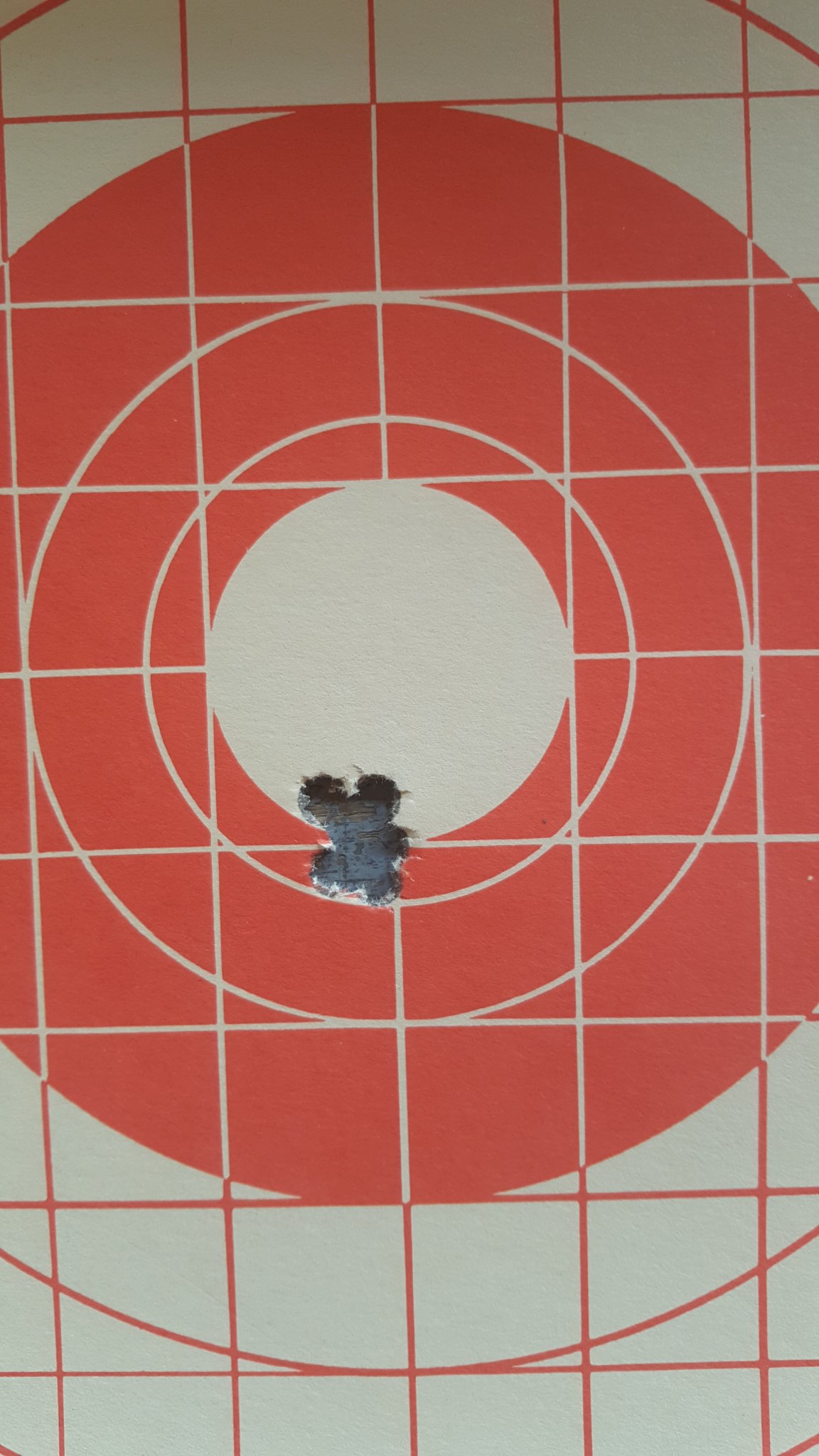

Some photos of my clone build, while all the accessories are legit the gun itself is a build as close as I could get, including a 5R 1-11.25” Krieger and a legit M24 trigger and floorplate.Also have a complete deployment kit, flash hider and Redfield sights plus the optional MARS rail and Badger DBM for the M24A2. The cheek riser is kydex wrapped in OD 100 mph tape to look like the field expedient ones but be removable.
70448817044880704487970448827044883
Remington still makes and sells the complete kit, it is not cheap, close to $8K if I recall. A good clone is about the same price as an actual original.

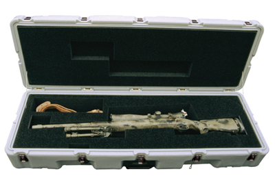

It's definitely made by Hardigg with the pressure release valve. Same company that makes the original issued case. This one is smaller, not as deep, no foam cutouts for the spare parts/optics cases.
Some speculation that Remington used these to ship M24's back to the units after warranty repairs if they received the rifle without the original coffin case.
View attachment 7044881View attachment 7044880View attachment 7044879View attachment 7044882View attachment 7044883
Awesome build out!
Have you ever fired it with either the fh/laser filter/Tennabrex attached? Curious if you recorded any changes to zero with those?
Thanks! It wouldn’t have been possible without all the documentation people put up on the old site way back before the refurb kits became available.
The sight picture is darker with the EMA laser filter, but I haven’t checked for a zero change, my recollection is that it was nil after first installing it. I haven’t tried it with both the EMA and the Killflash on at the same time. I have shot it lots with just the EMA attached.
I temporarily put the Killflash on as well and the sight picture got pretty dark. And no I am not in any imminent peril of getting hit with a laser at my local range, but I wanted to spin the thing on and shoot with it. I do the same thing in service rifle and shot with the issue EMA on my Acog RCO-just felt like it!
As for the flash hider, well......I am a dumbass and despite all the other attention to detail, including 5R rifling and twist rate, I used an HV profile which finishes at .960” at the muzzle, not .920-940”. End result is the flash hider won’t fit until I get the barrel re-profiled and re cerracoated. Doh! The thing shoots so well that I am hesitant to screw around with the barreled action now.
That’s an awesome set up, love the ammo pouches. Are they a retro use of something older by Big Army, or are they M24 specific?
Funny story on the polarizer. Tenabrex runs a tight ship when the package says “LEO only”. They are owned by ATI, a Canadian company in Nova Scotia I think. I try to buy one up here, as an LEO but in full disclosure I tell them up front it’s for a personal rifle, not a duty gun. Their answer, and no sense of entitlement when I say this, “sorry bro, departmental purchases only” Lucky I found a private sale on the classifieds up here. Hey I get it, rules are rules it’s all good.

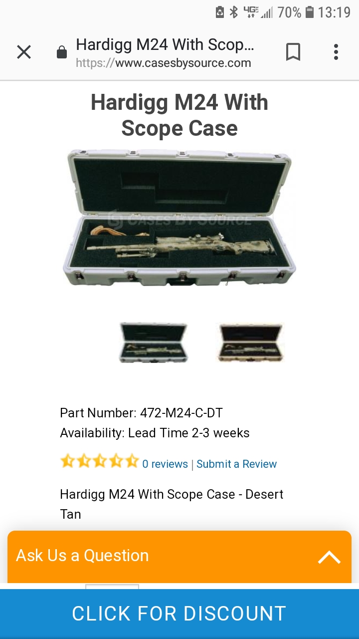

Yup you are correct, same pattern as thScreenshot_20190320-131949_Chrome.jpge pellys
