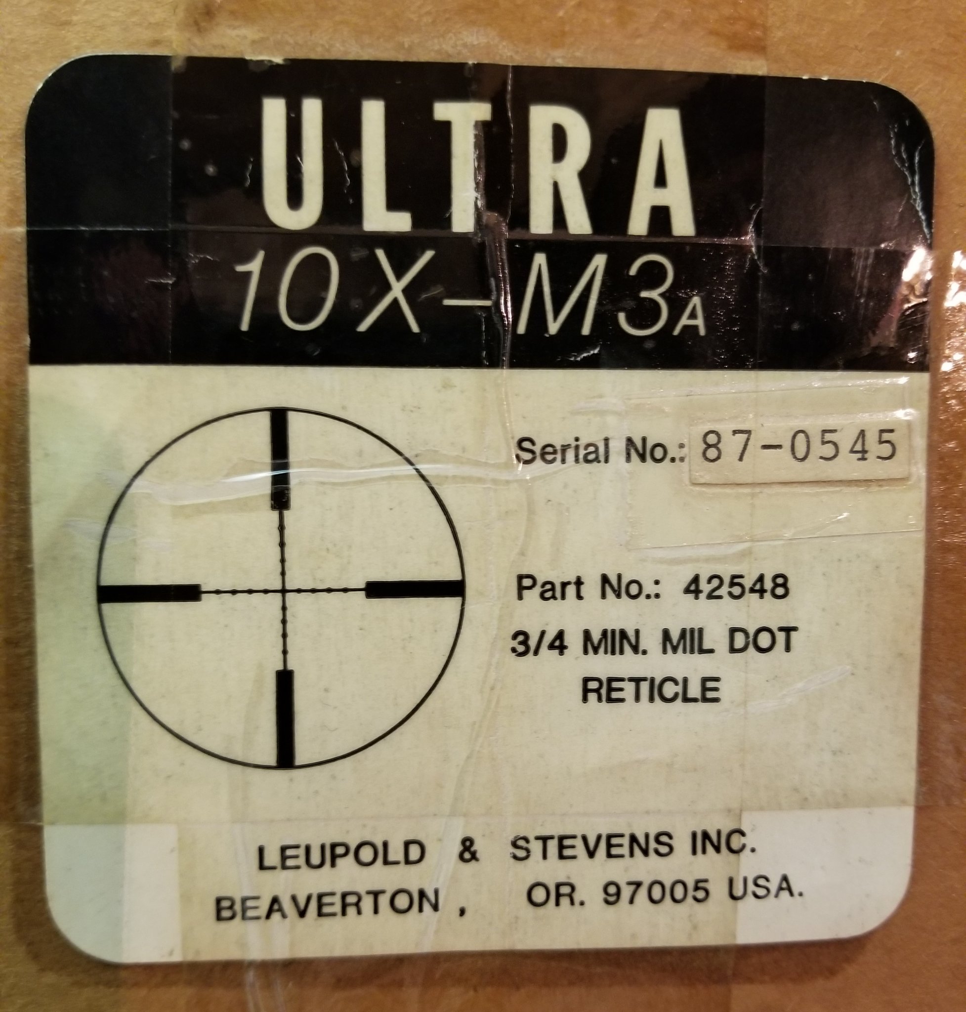

Here's the end label from my L&S Ultra 10X-M3A shipping carton, 1987 date code. It would be interesting to find other M3A serial numbers close to first run production.
An important distinction among Leupold 10X scopes is the difference between M3 and M3A (alpha) versions. Original US Army contract scopes are engraved with "10X-M3A". Later production rifles came with Mark 4 M3 10X.

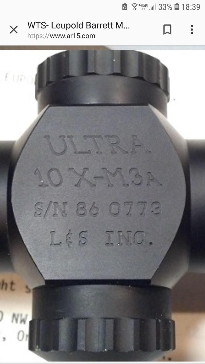

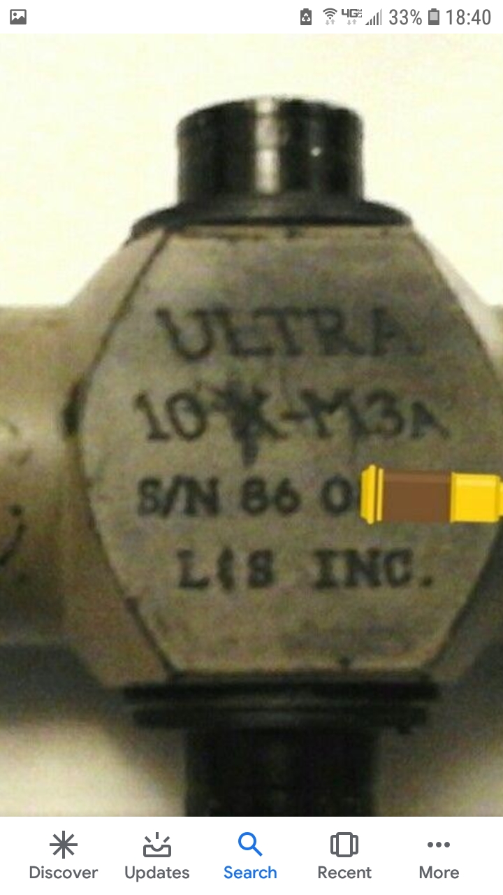

The earliest M3a Ultra I'v3 personally seen is 1986, although I remember someone mentioning once the manual was dated 1985. The M24 wasn't approved to July 88 and the first rifles weren't delivered to Oct 1988. As for the scopes, latest I've since was dated 92.

As for documenting the scopes, with regards the USMC Unertls only 1800 or so were made and none for the civilian market. The initial order for the M24SWS was somewhere in the region of 2600 rifles. 15000 rifles later theres an awful lot of M3a's and MK4 M3 10x's issued along the way. I've had 3 now, still have 2.

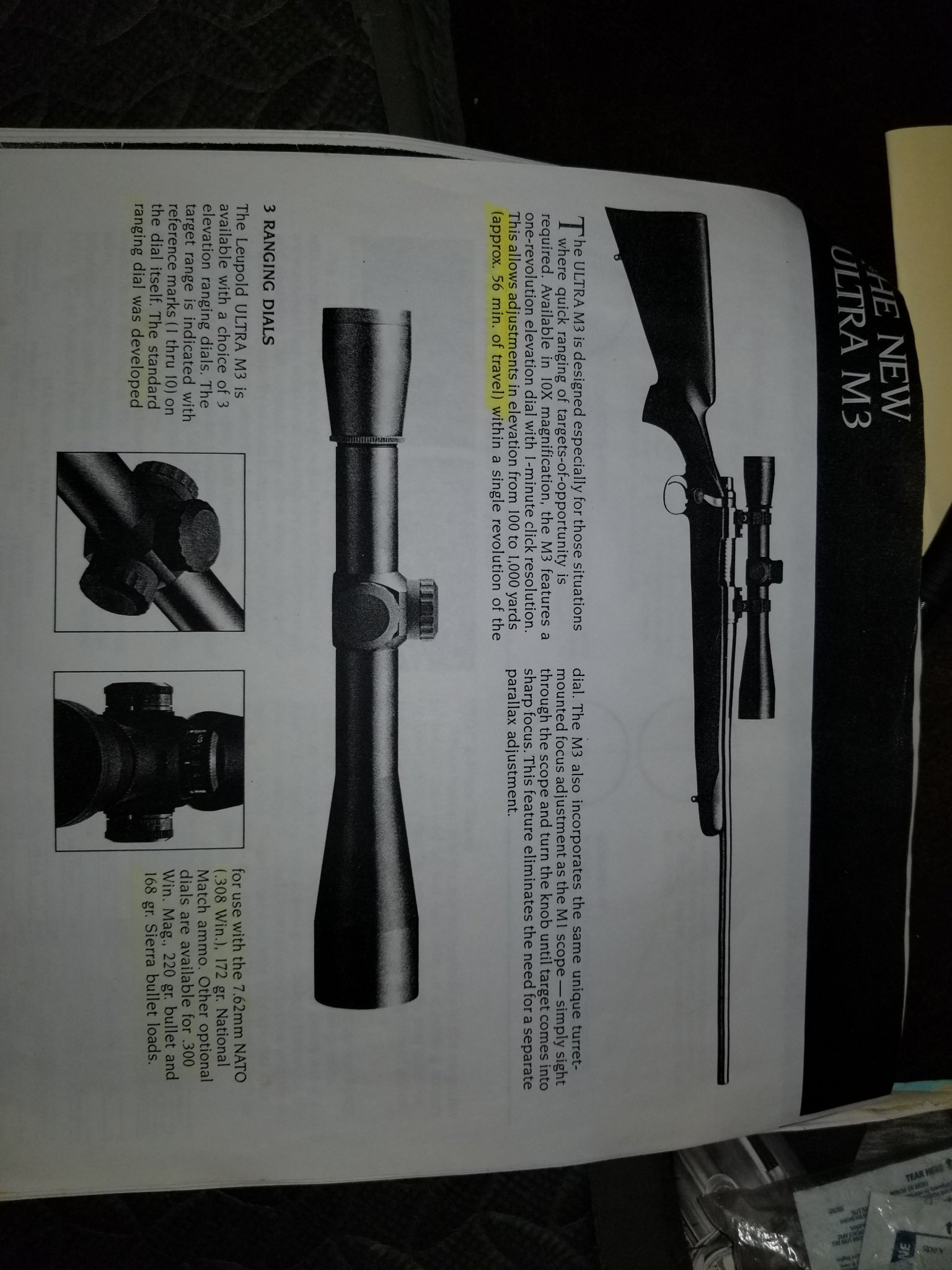

I have a copy of the Leupold LE Products brochure dated 1986. It features "THE NEW ULTRA M3". The brochure also does not include a 1-piece LA scope rail, only the 2-pc version.
But it only lists the M3 version, not the M3A.
mjh30 That catalogue page is dated 1986 and lists 3 different reticle options including a Wire DUPLEX #42549 reticle. While I dont own any catalogues prior to 1986, its understood that a wire reticle is completly different from the laser etched reticle of the M3A.
M3 is different than M3A.

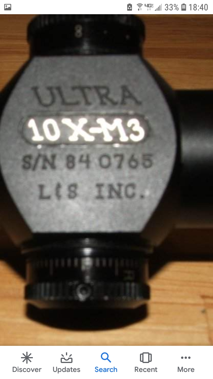

Theres really very little difference between the M3's and M3a's that I can find documented. Visually they are exactly the same, the original m3 Ultras I believe had a wire reticle and 1 moa windage, obviously issued M3a had the laser etched reticle and 1/2moa windage.

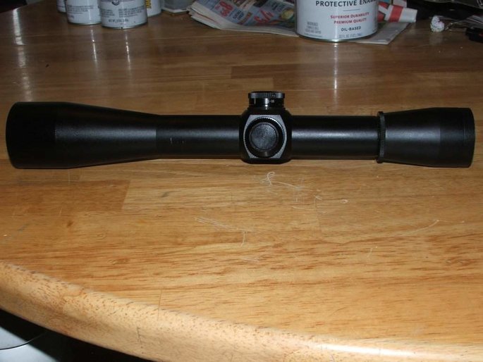

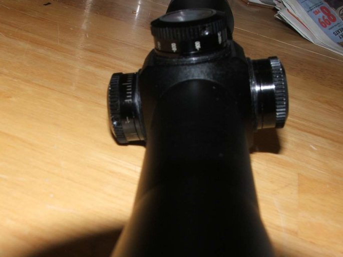

1984 dated M3 ultra not the best picture in the world. Not sure the exact date the Ultra line was introduced, perhaps 1981. There was the m1 ultra, the m2 ultra and the m3. The odd duck being the m2 ultra with no parralax adjustment and no turrets to speak off.

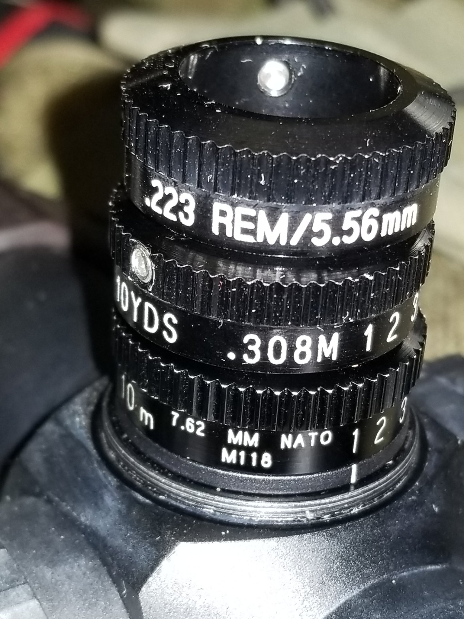

The 168 dial, at least in my kit (and several others I've played with) has rotation opposite of the M118 dial found on the Ultras. It is set for the later Mk4 series that went to CCW rotation.

These are clockwise (right hand rotation) dials for M3/M3A.
The 308M is for 168 grain M852 MATCH

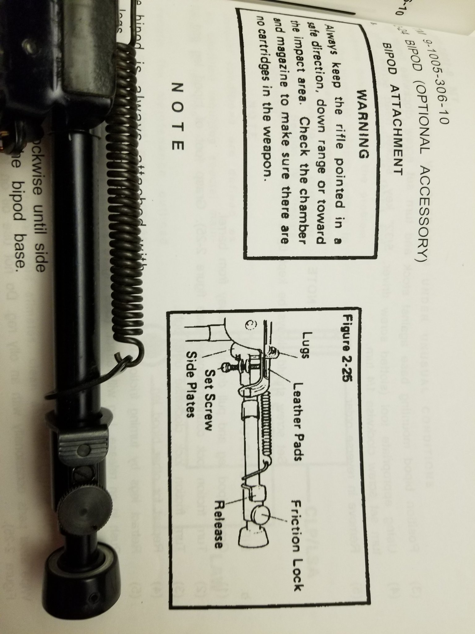

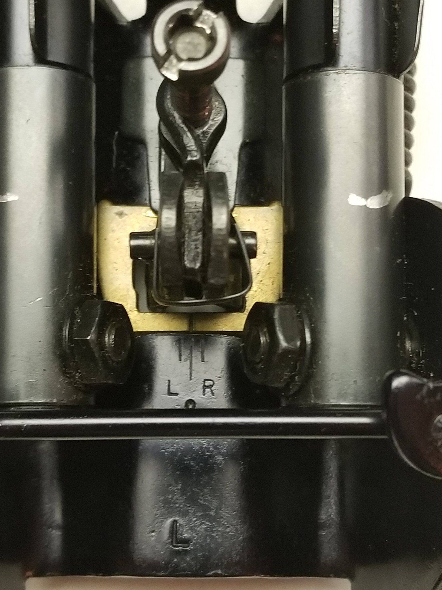

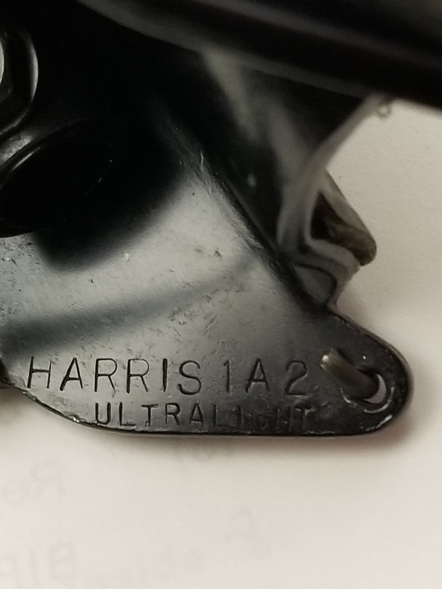

Bipod illustrated in the Army Operator's Manual is an early version of the Harris 1A2 Ultralight with hard plastic foot pads. Legs were smooth without notches, and are spring assisted retraction. Non-swiveling, but has an adjustable brass insert plate to compensate for off-center stud location. The mounting claws (side plates) have holes that would allow a QD sling swivel to be attached, but the Harris instruction sheet specifies not to connect a carrying sling to this point on Series 1A2 bipods. This is the reason why 2 swivel studs are mounted on the stock forend. One is for the bipod, the other for a sling. Tightening the bipod setscrew puts tension on the swivel stud, and the additional load of a sling could cause the stud to strip out of the stock.

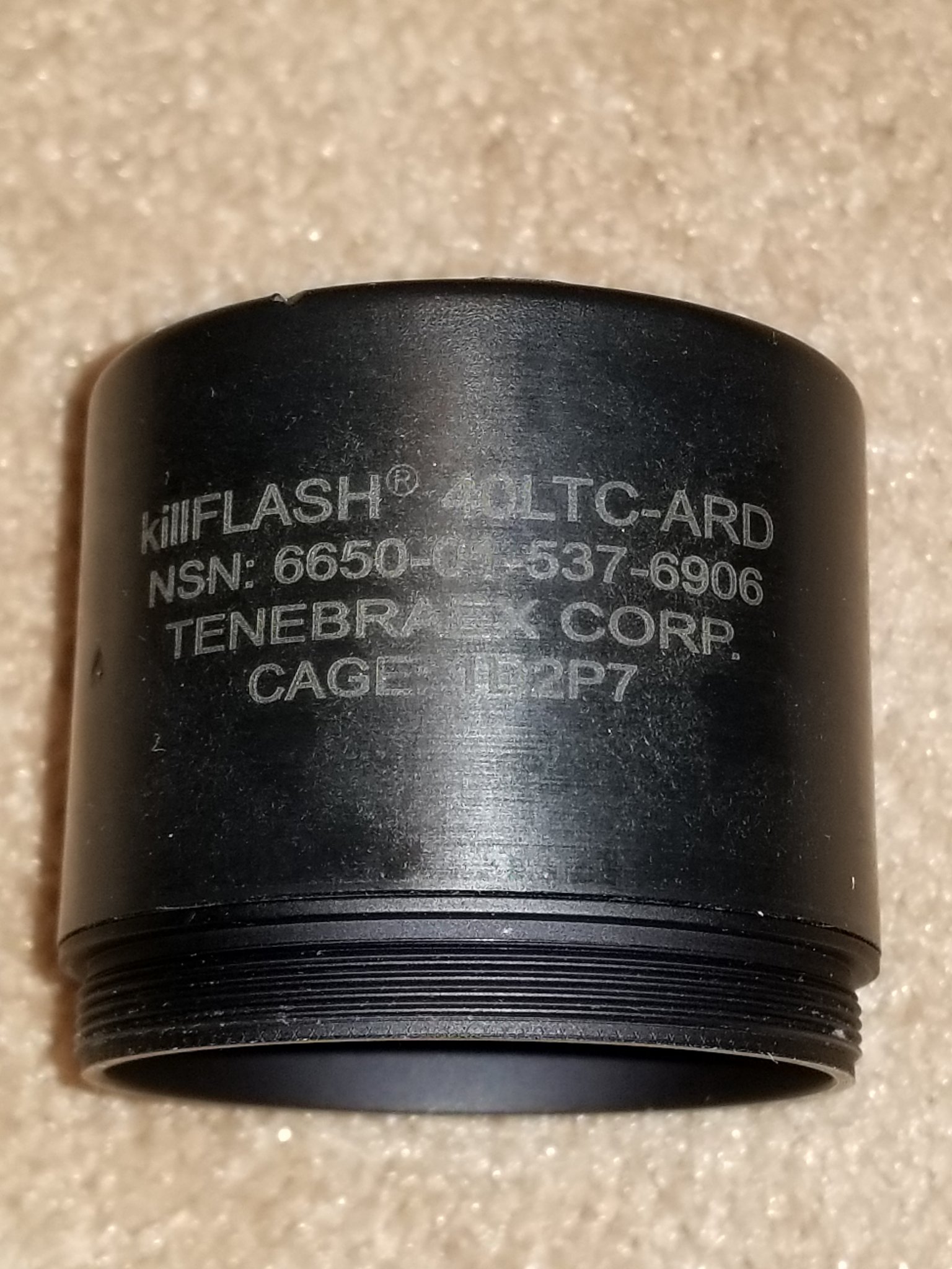

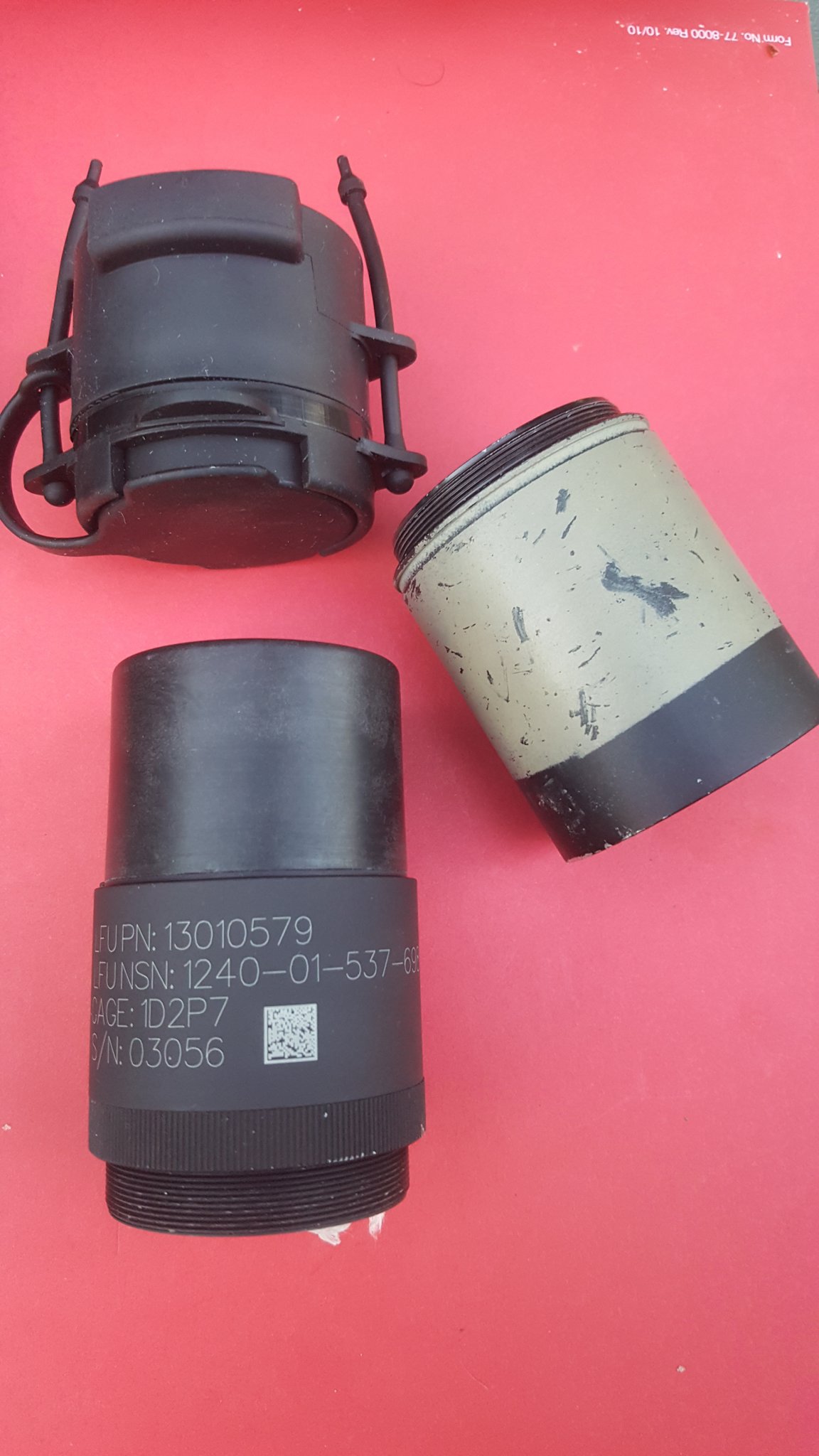

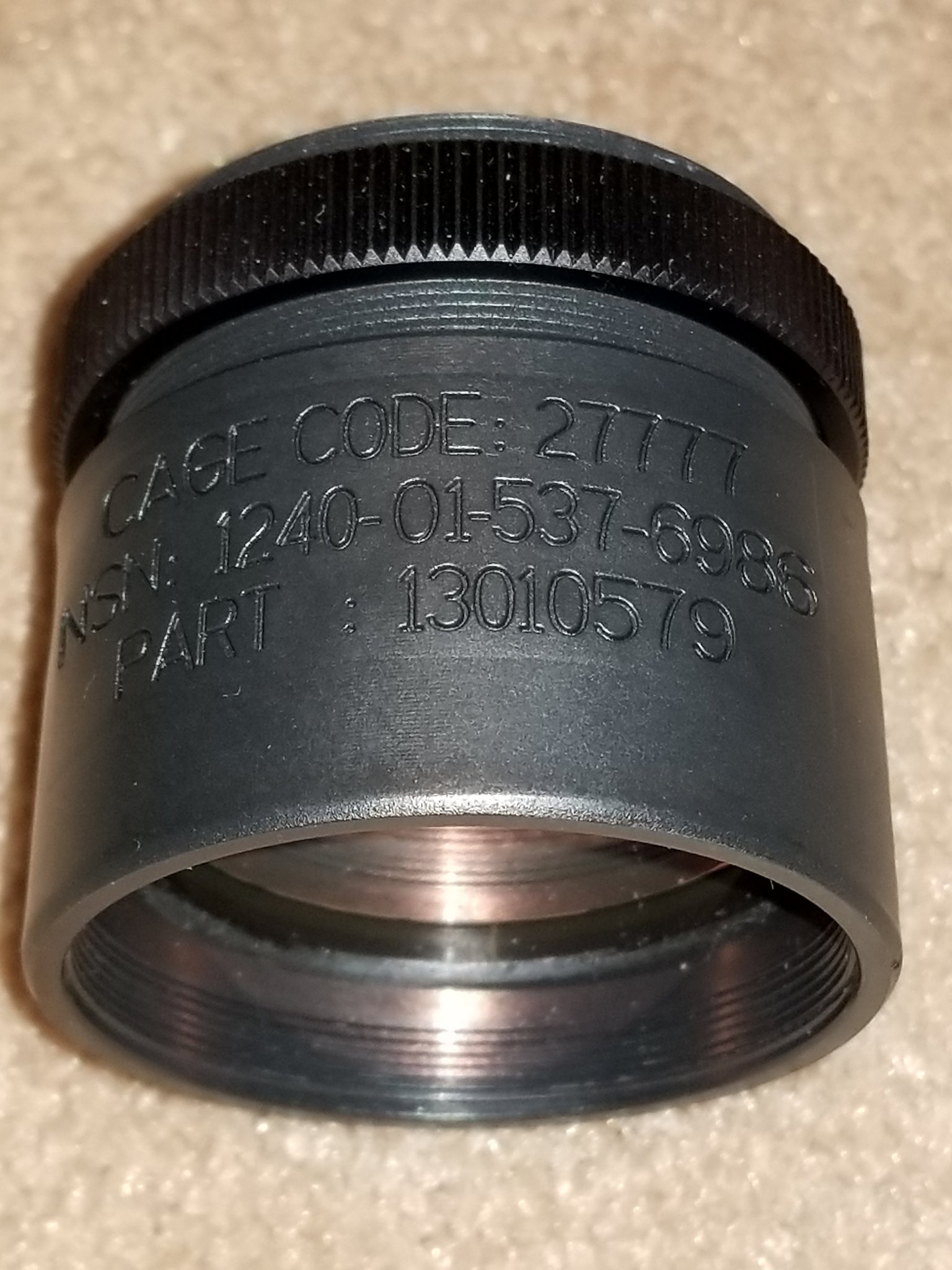

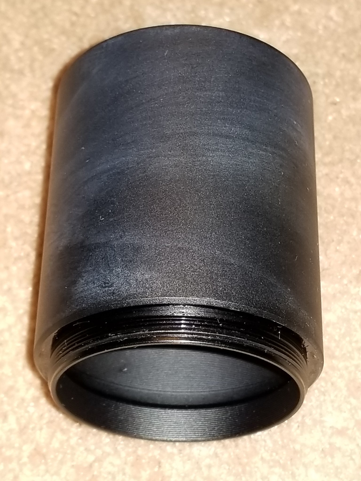

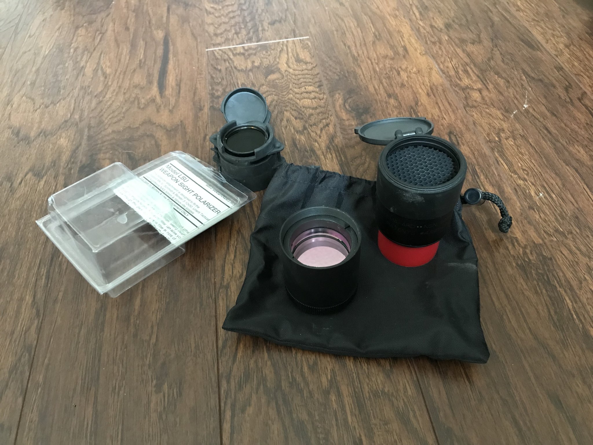

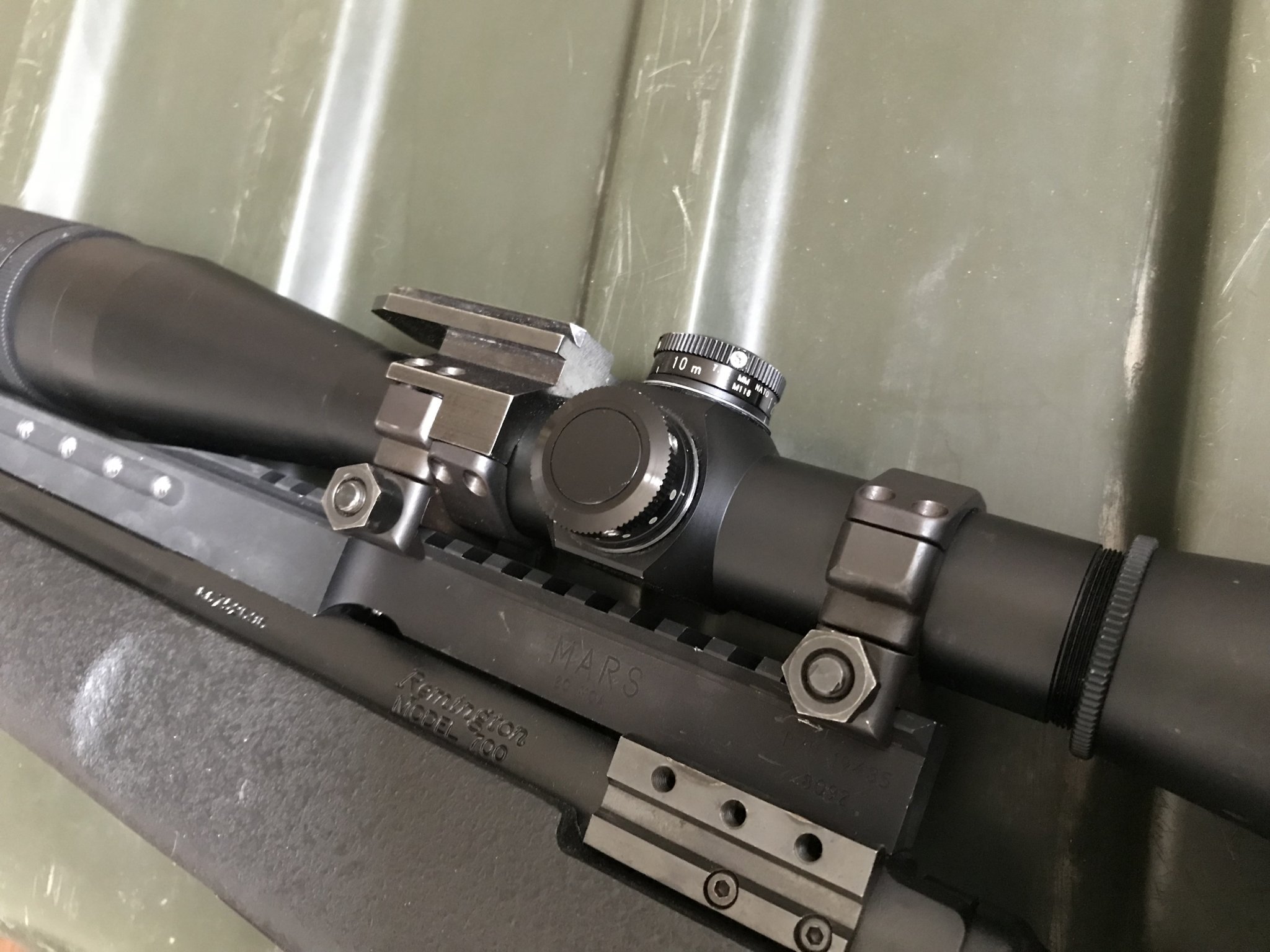

M3A scope attachments Sunshade, EMA (External Mount Assembly/Laser Deflector), and ARD (Anti Reflection Device). Revised versions were issued depending on manufacturer.

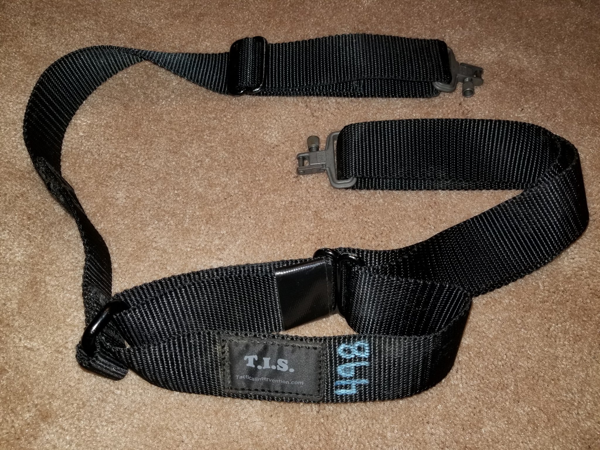

This is an older Tactical Intervention Specialists M-24 sling that came on my rifle. I modified it similarly to their current US Army contract (#USZA92-02-M-0008) Quick Cuff Precision Rifle Sling by adding a forearm loop. They use GrovTecUS swivels.

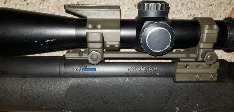

A couple of questions were posed to me today. Instead of answering him privately, I want to post them here for general consumption.
Q1: How many years did the M24 have US marked on the receiver?
I can't honestly answer that, I don't really know. I could only make the assumption that it stopped sometime in the early 1990s, some time after the initial order of M24s was finished and issued to the Army.
Q2: Where can I find pictures of the US marked M24"s ?
That I can answer but I have to repost a picture of it since the previous photos and threads are long gone. This is a close up of my personal Sep 1988 production M24 that was delivered to the Army in Oct 1988. This was saved from the Army long before the Army/Remingtion Rebuild Program. Note the roll stamping of the Remington logo isn't as deep as more recent builds.
7108104
eodsix, I was under the impression that only the first contract run of 3600 rifles had the US stamp, that would be I surmise rhe c prefix rifles. I agree about photobucket soo many great pictures lost.
Reactions: m1marty
You and I are on the same page. I'm away from my source info this week but can be more specific week after next. Only the first 100 production weapon systems were delivered in October 1988 and 100 more by December 1988. It took a bit longer than one would expect to fill the Army's order. 1990 might be too far off but it's close. The rifles delivered in 1987 were more or less test pieces. Test pieces may not be the correct terminology but you get the jist.

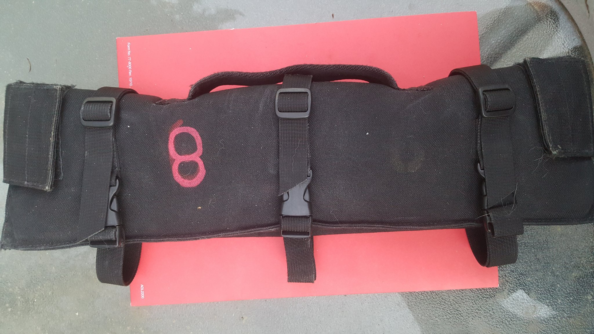

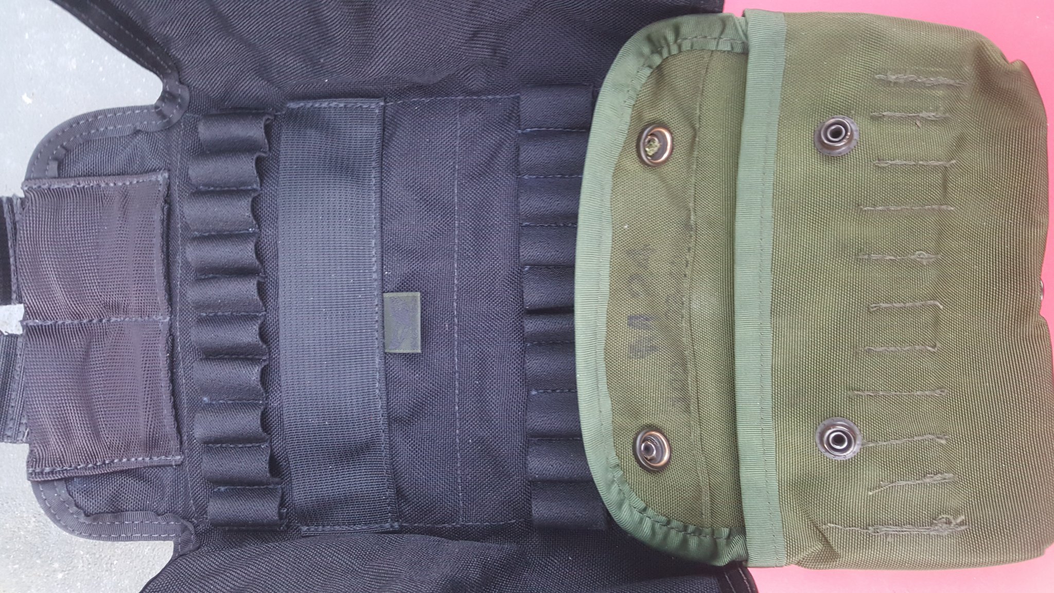

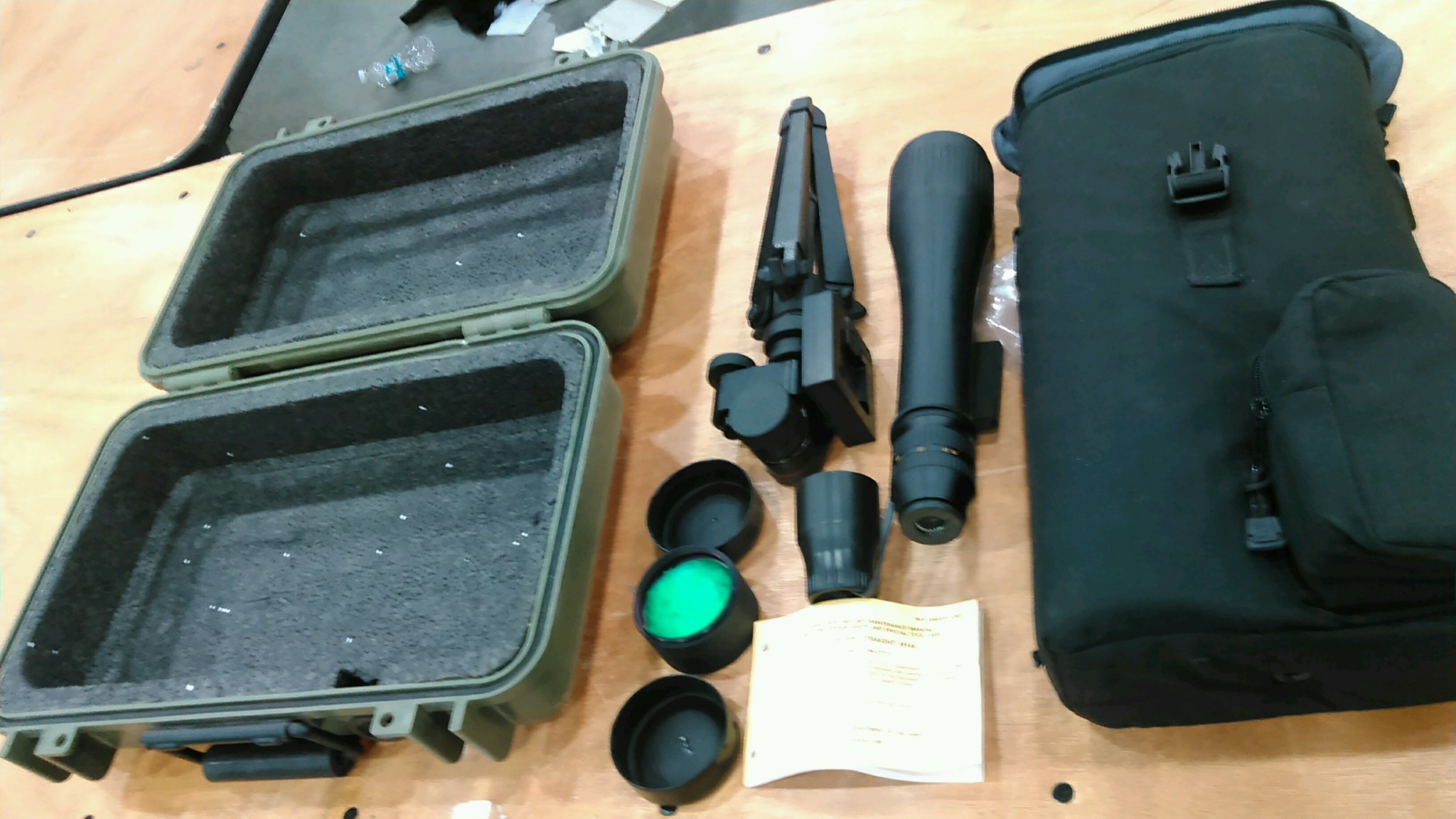

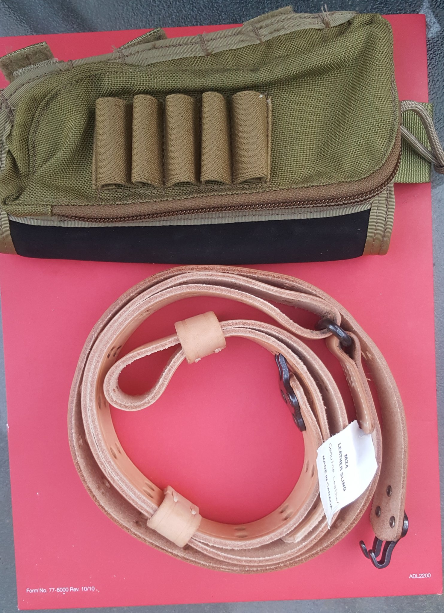

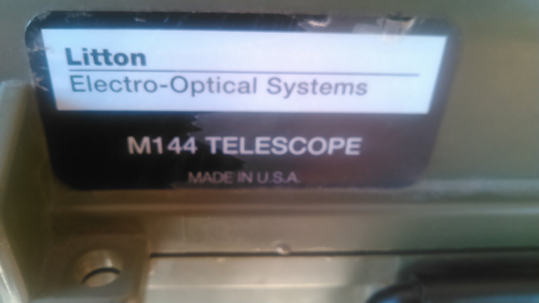

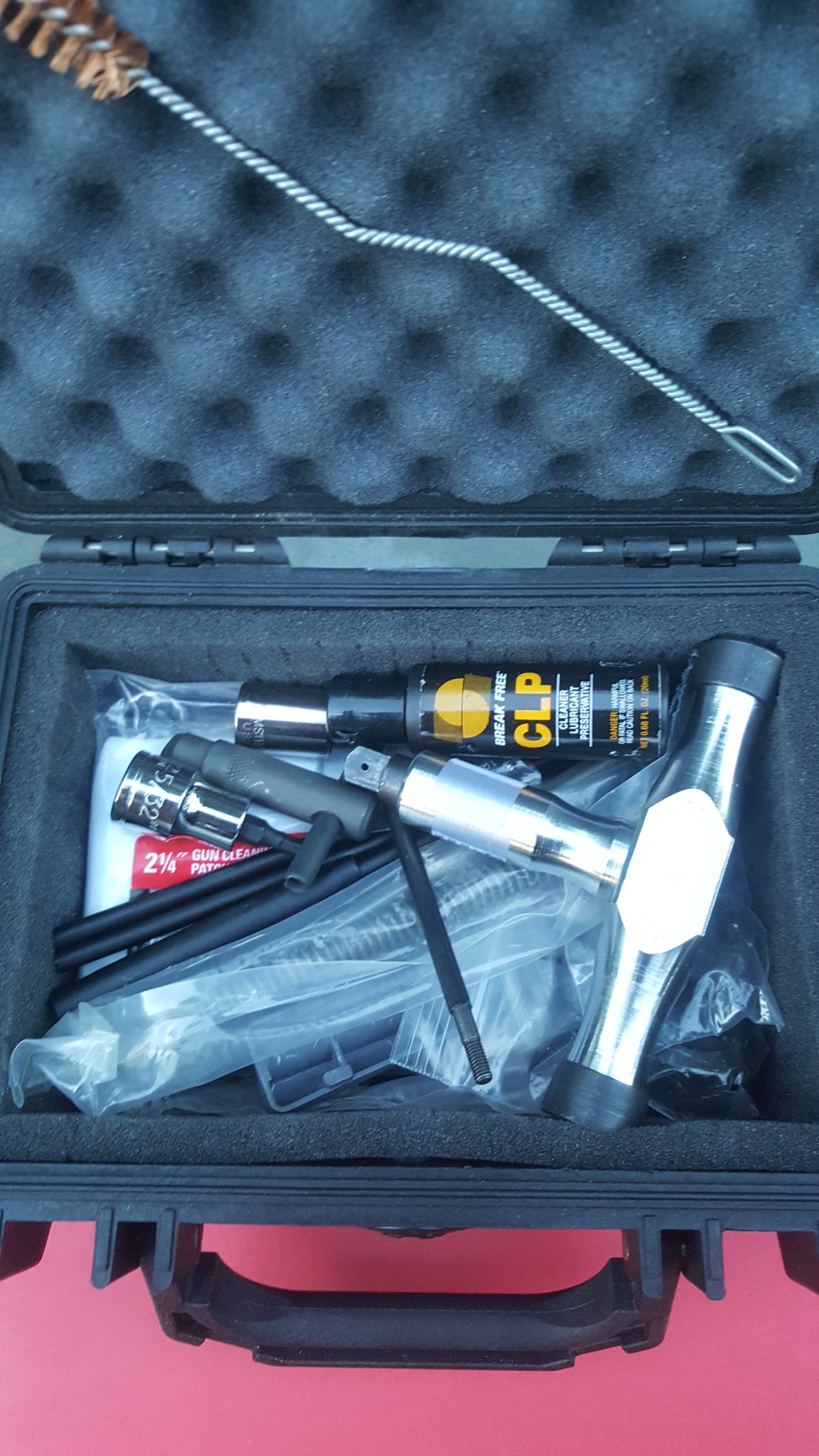

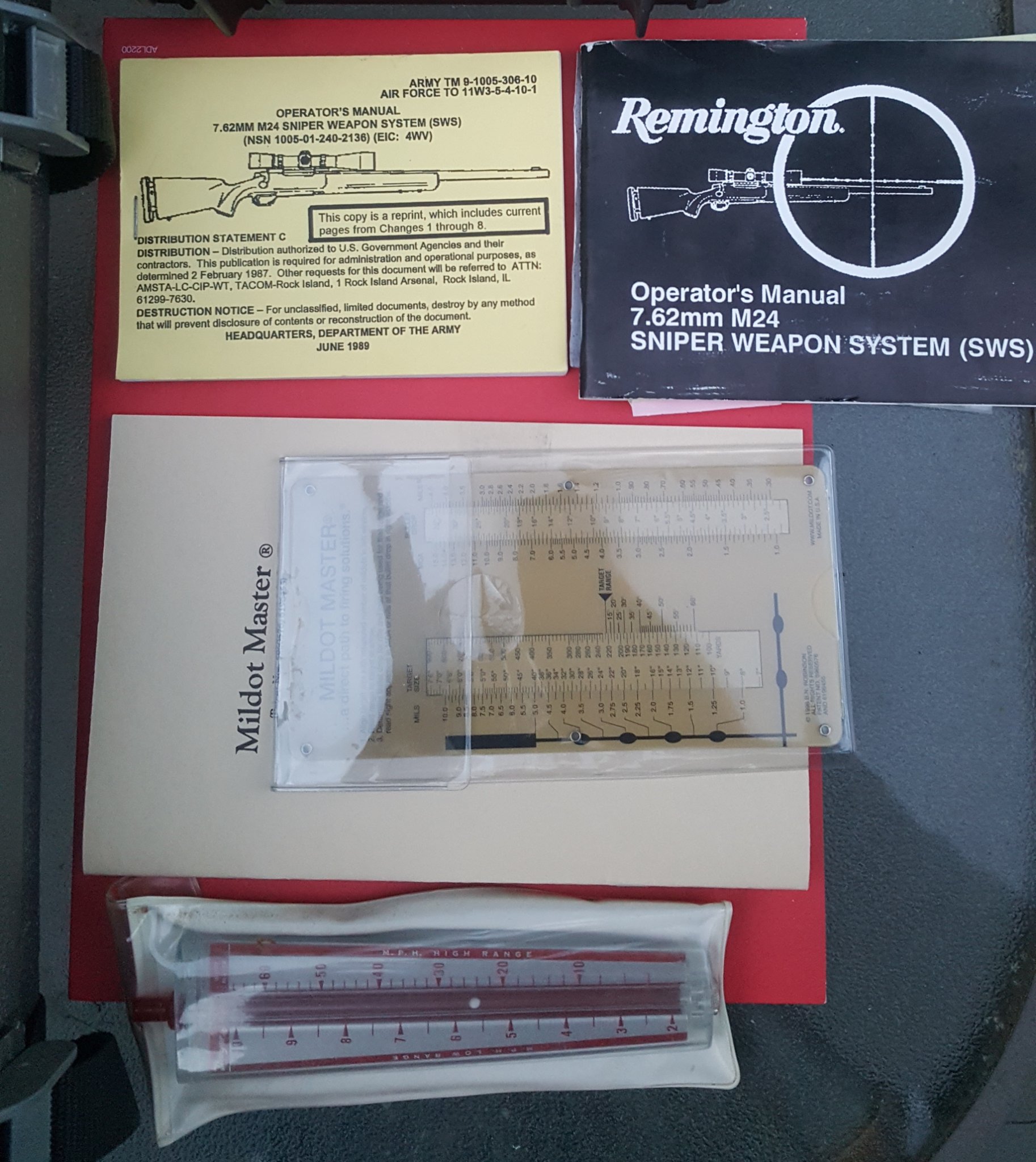

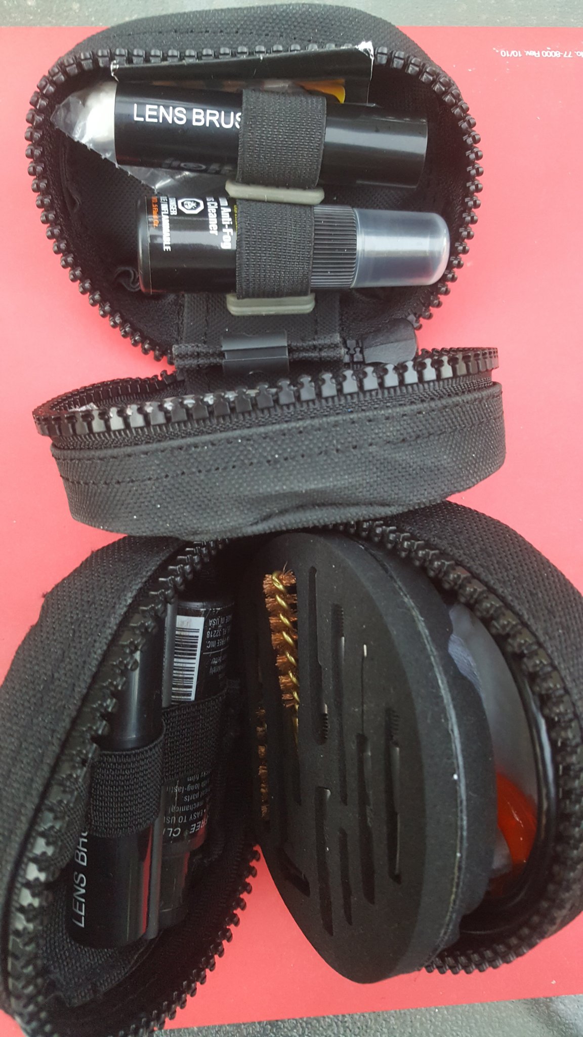

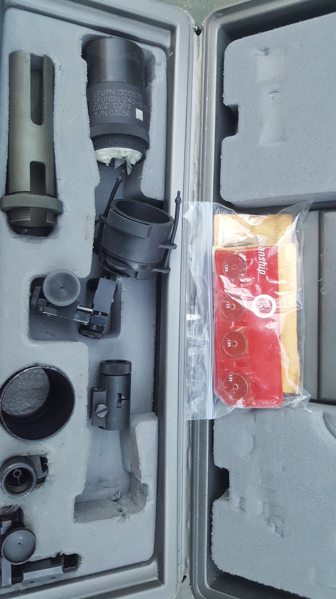

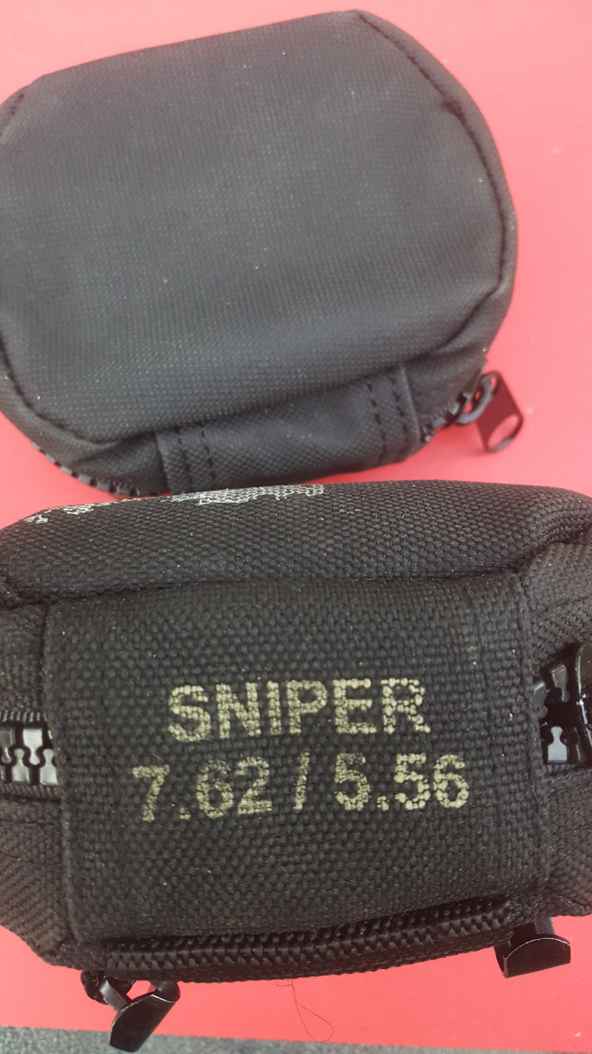

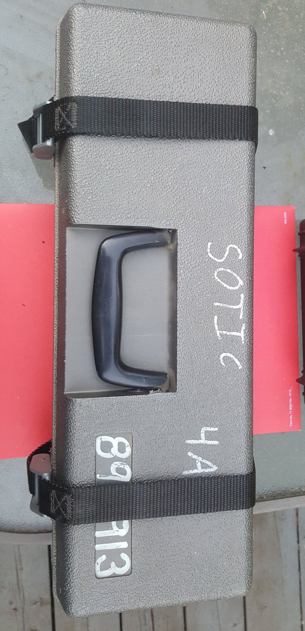

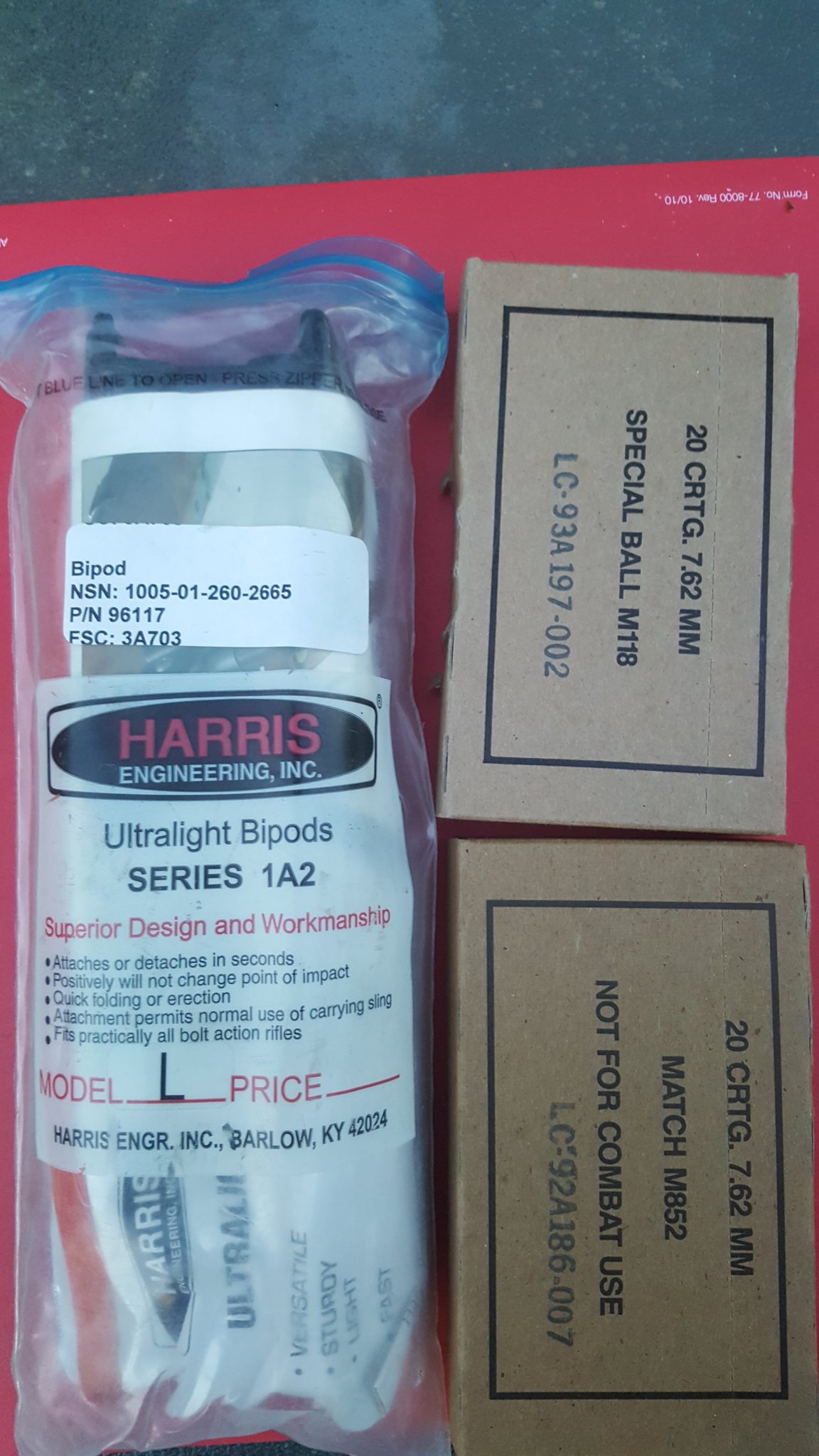

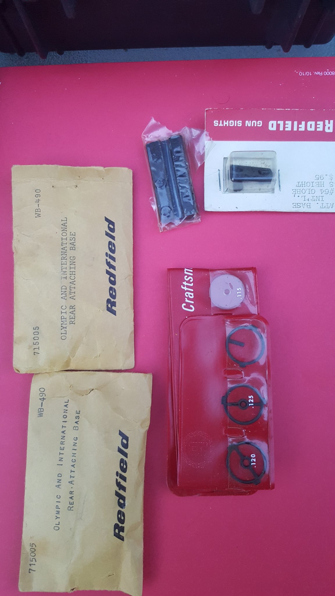

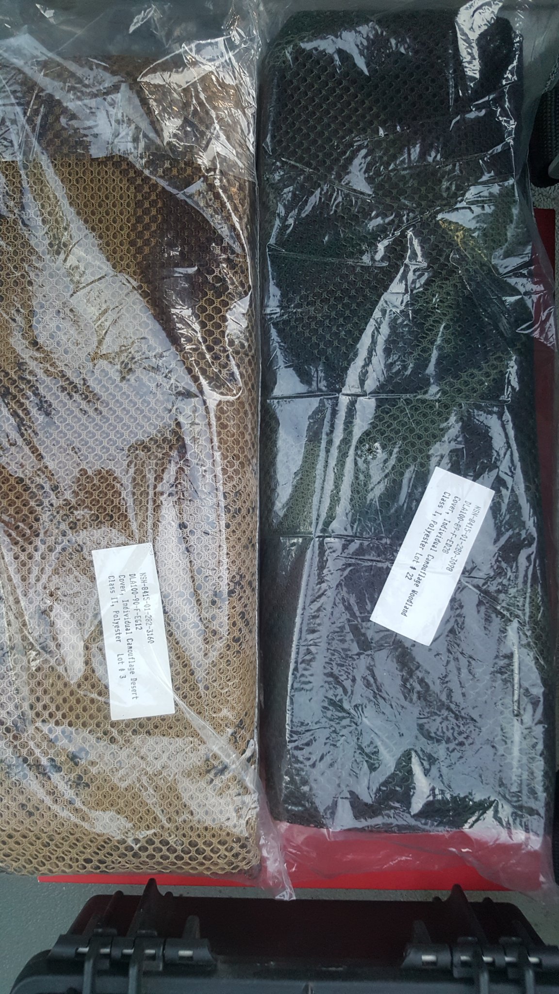

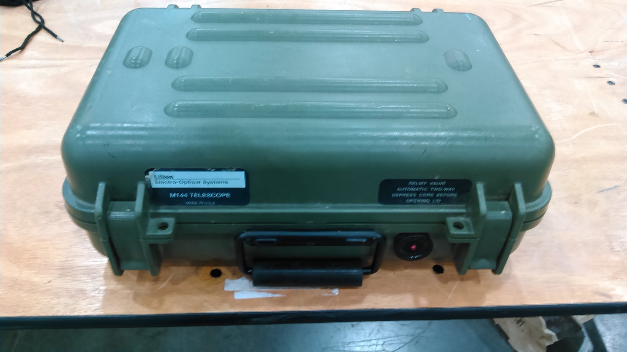

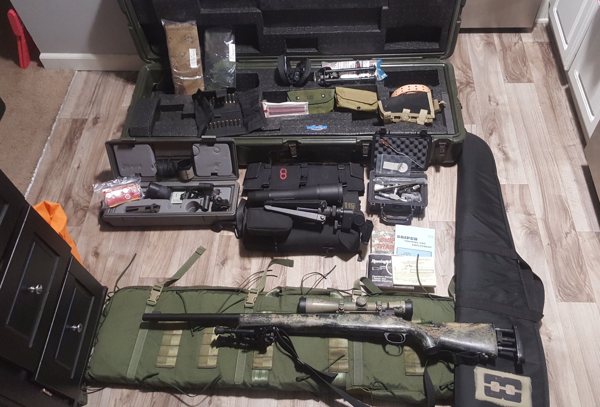

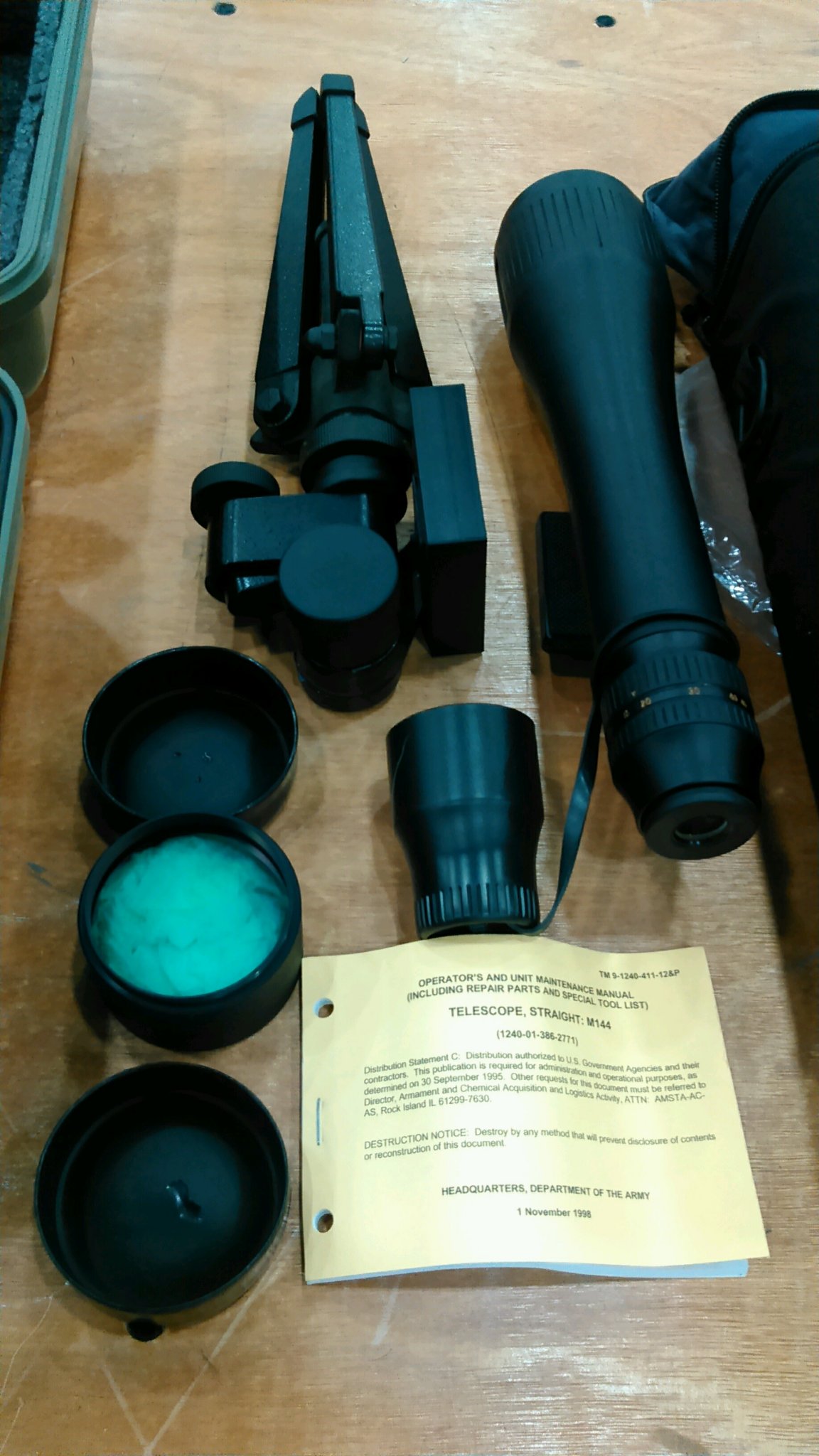

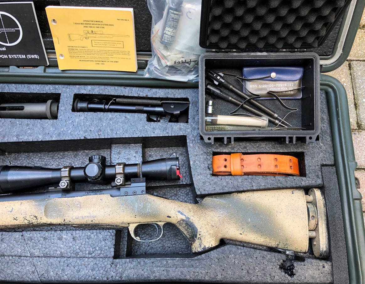

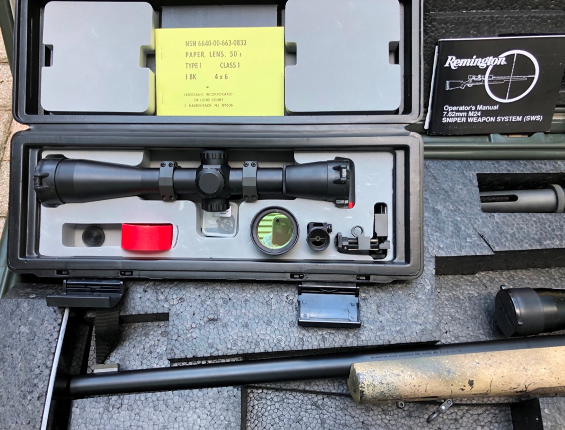

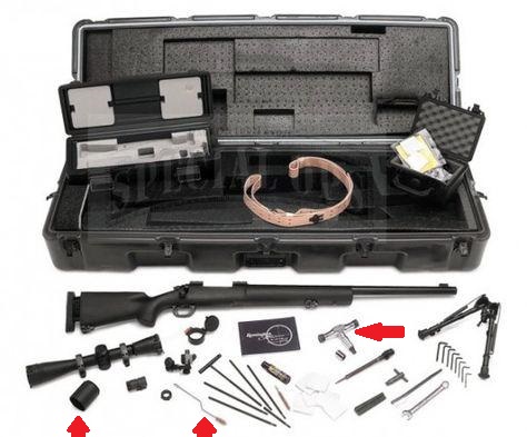

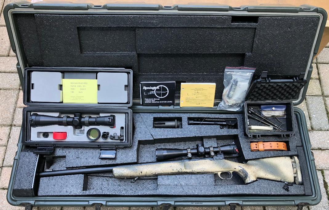

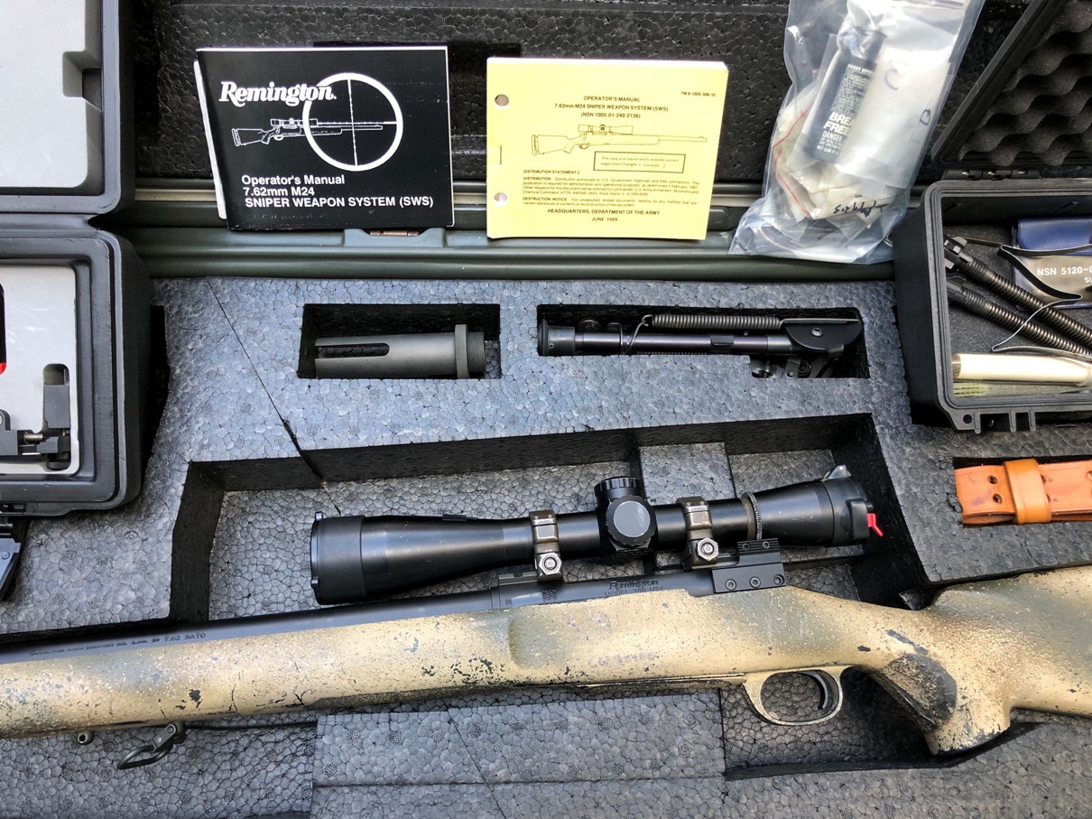

My 24R stated as the rifle and sling only, but over the past couple of years I bought the deployment case and about 95% of the goodies. (extra M3A optic is shown in the optics deployment box). I really like this rifle, and the character of its stock.
Re 4th picture: The three items I need are the correct T-shaped torque wrench, the sunshade for the pre-2004 Leupold M3A/Mk4 scopes, and the curved brush that came with the original kits...if anybody has a spare of these items that would sell, please let me know.
Re 4th picture: The three items I need are the correct T-shaped torque wrench, and sunshade for the pre-2004 Leupold M3A/Mk4 scopes, and the curved brush that came with the original kits...if anybody has a spare of these items that would sell, please let me know.
It's a lot of damn work collecting all the orignal part and pieces. The original torque wrench without the hammer faces on the handle are rare but they show up from time to time. The sunshade for the 42mm M3a that's correct and not threaded on both ends is even more rare. On the bright side, the curved brush you desire is a common item at MidwayUSA.
Get a half dozen when you buy them because if you use them, they won't last long, they're expendable. Good job on collecting the pieces.
As you are a stickler for detail, you need a Pelican 1100 d-kit and not the 1150 you have pictured. There are at least 2 of them on eBay right now. Check them out.
Reactions: saddler
Thanks for the tip re the brushes, I'll pick those up. Its the sunshade that I really want.
Regarding my tool kit, its a Pelican 1120 and I'm pretty certain its 100% correct for a late M24. Why? Well, a buddy of mine went thru US Army sniper school in 2009 and was issued an M24. He spent time in Afghanistan with it, and retired a few years later. When he turned in his M24, he was told it was to be converted to new XM2010 variant.
When he saw my M24R in 2015, he asked me to give him first right of refusal if I ever sold it, as it reminded him of his old M24...and later offered me his original M24 tool kit as it didn’t need to be turned in, which I gladly accepted. It has basically two of all the little wrenches and items like magazine springs, firing pins, followers. The Pelican 1120 was apparently issued to him in 2009, and we talked about certain items that were updated over the 20 plus years of the M24 when in service (1988-2010).

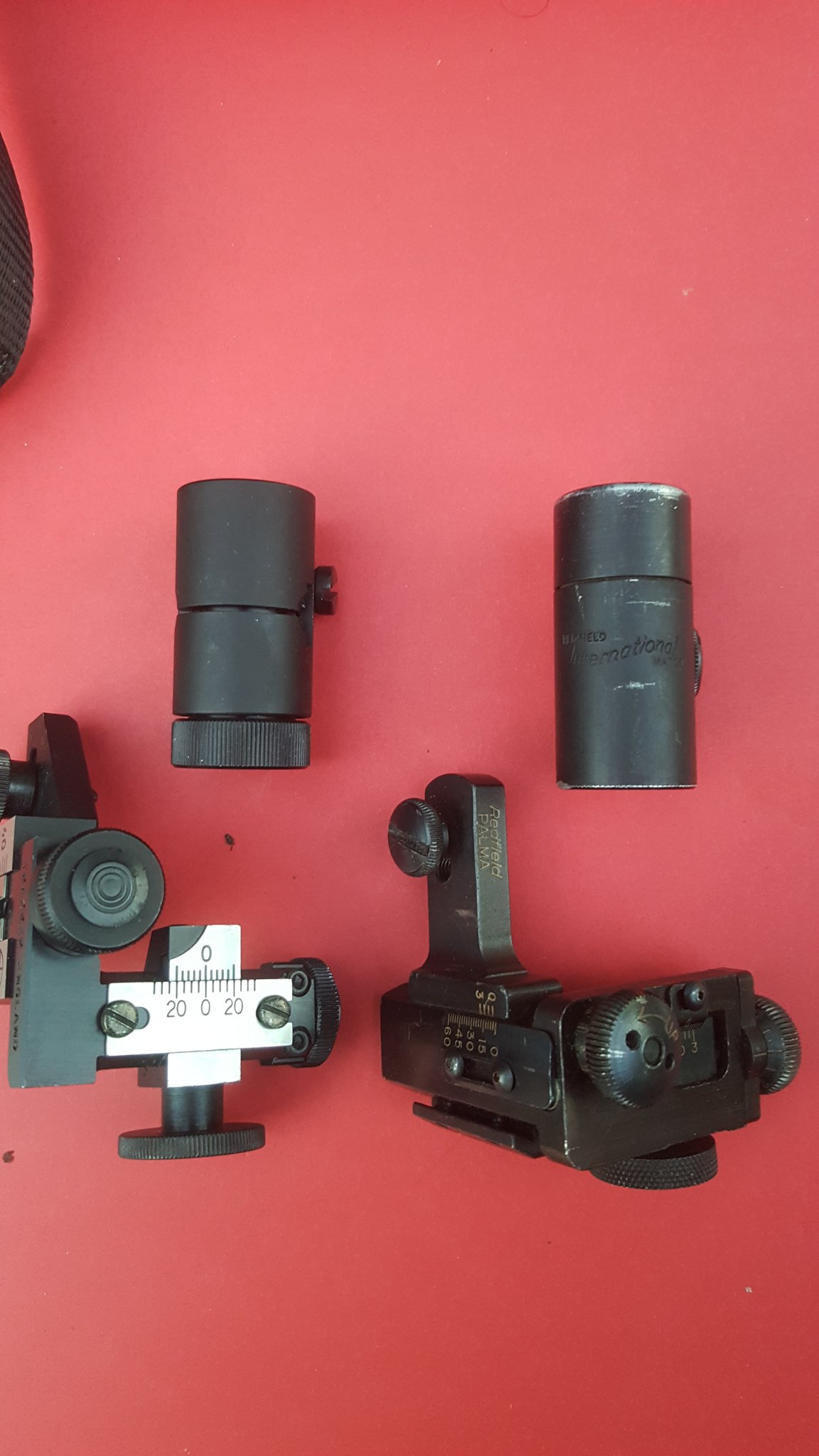

Iron sights: Redfield (early) vs OK Weber/RPA Trakker (late)
Flash hiders: One style for Redfiield front sight block, and a later style for the OK Weber front sight block.
