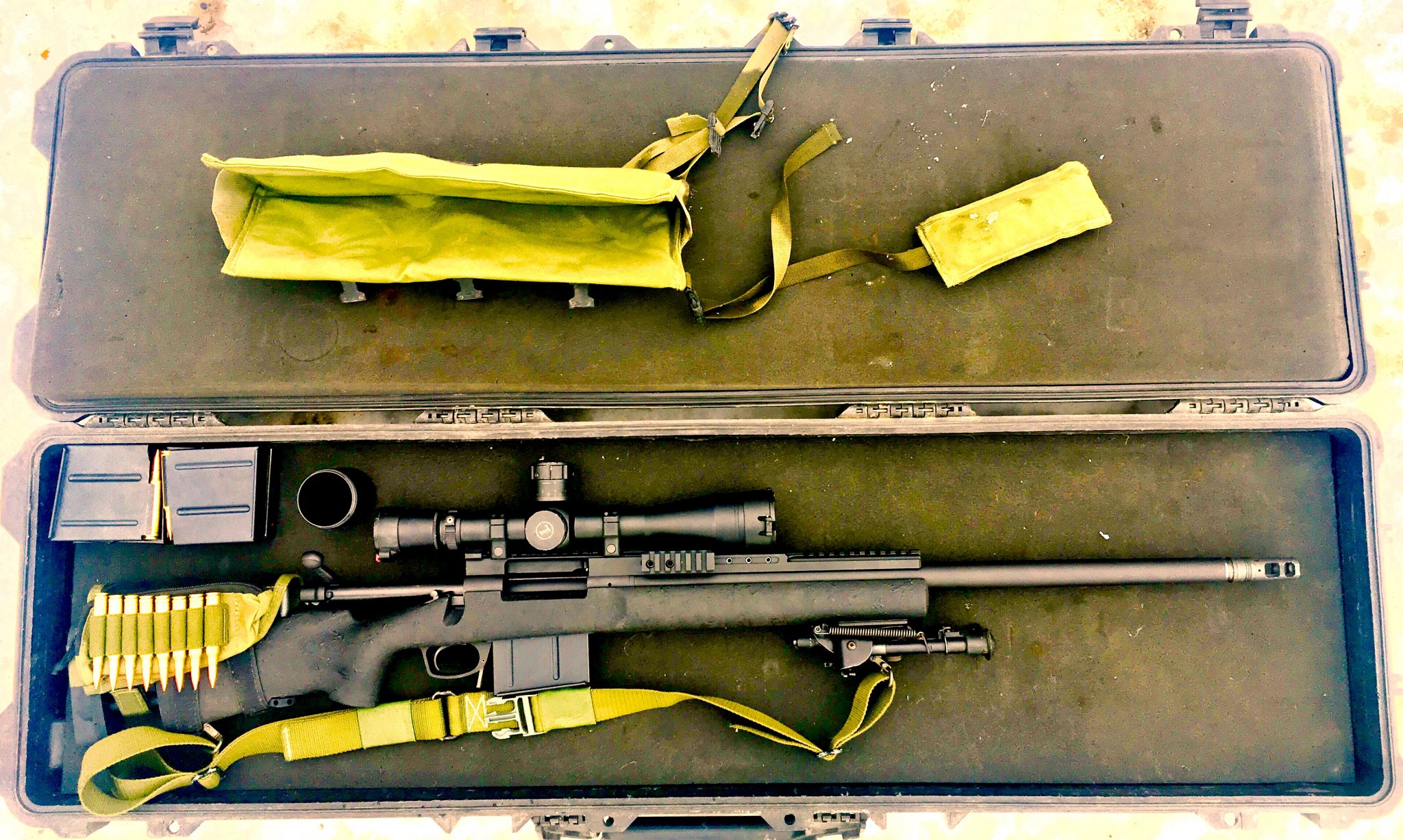

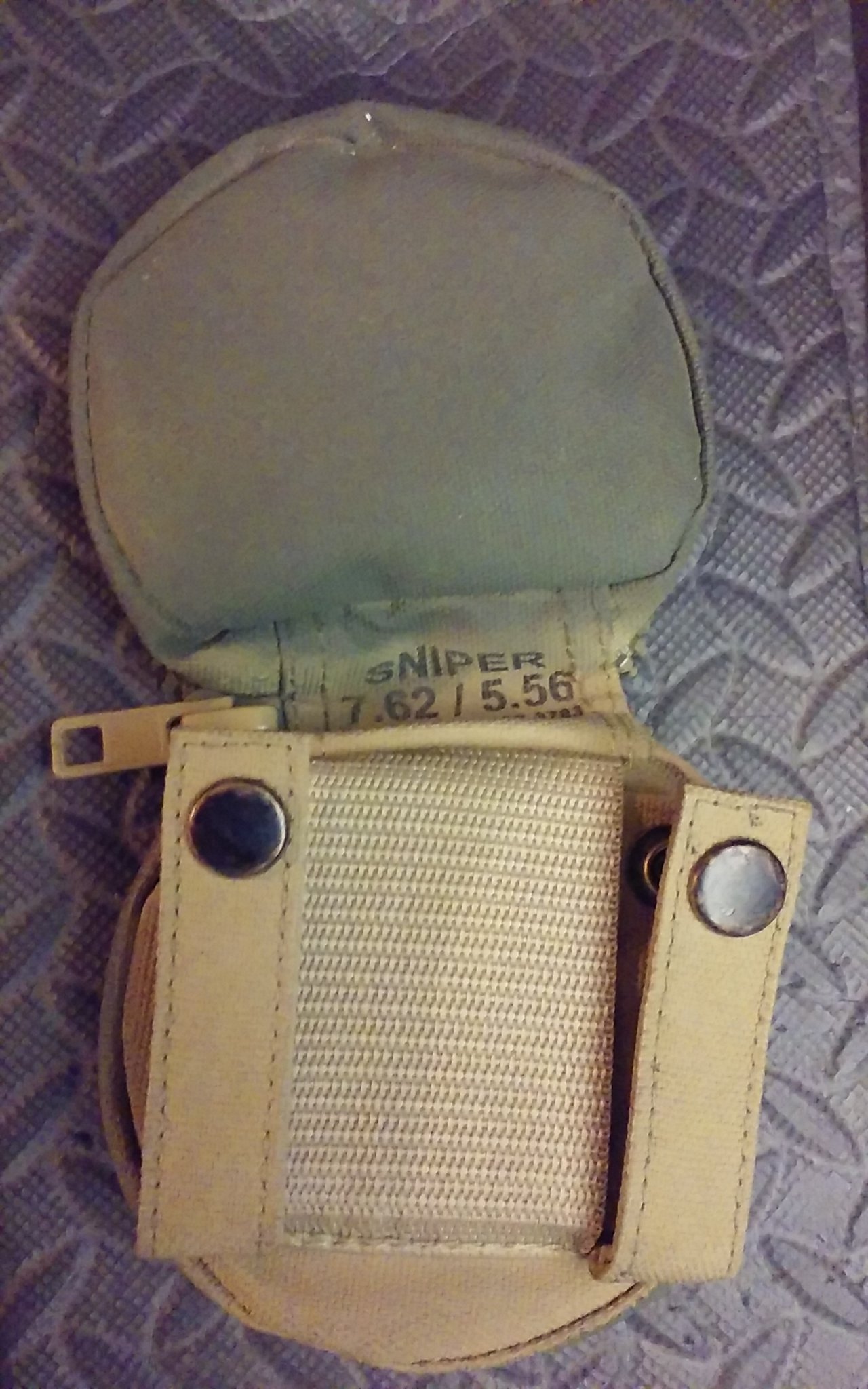

I need some help putting together a deployment kit for me M24A2. I am not really looking for every exact item but more so to just fill in the empty spaces in my Pelican rifle case. The case i have is (472-PWC-M24A2 Rifle Case) that came pre-cut from the factory. Here is what I have so far:
mr_fullmetal The round cutout above the stock is for an OTIS Technology, Inc. cleaning kit NSN:1005-01-453-3783 Sniper 7.62/5.56
The rectangle slot directly in front of the scope objective is for ammo. I think you'll find that M118, M852 or Mk316 boxes will fit that perfectly. Commercial ammo cartons are a bit larger and won't fit. The rectangle slot under the butt stock is for the sling.
Reactions: lockedandloaded
thanks for the reply guys. Any guess what goes in the bottom right corner?
That large pocket is undoubtedly for a Deployment Kit though I don' t know what container goes in it. It's not a Pelican 1100 or 1120 for sure. Check this link out http://www.rifleshootermag.com/rifles/featured_rifles_essentials_030306/ Scroll down there is a H-S Precision rifle with a case that might fit that slot but I have no idea who makes that or what's in it. Your suppressor slot is cut for the Ops Inc. 3rd Model (now the AE M24 Suppressor) which is 12.5" long.

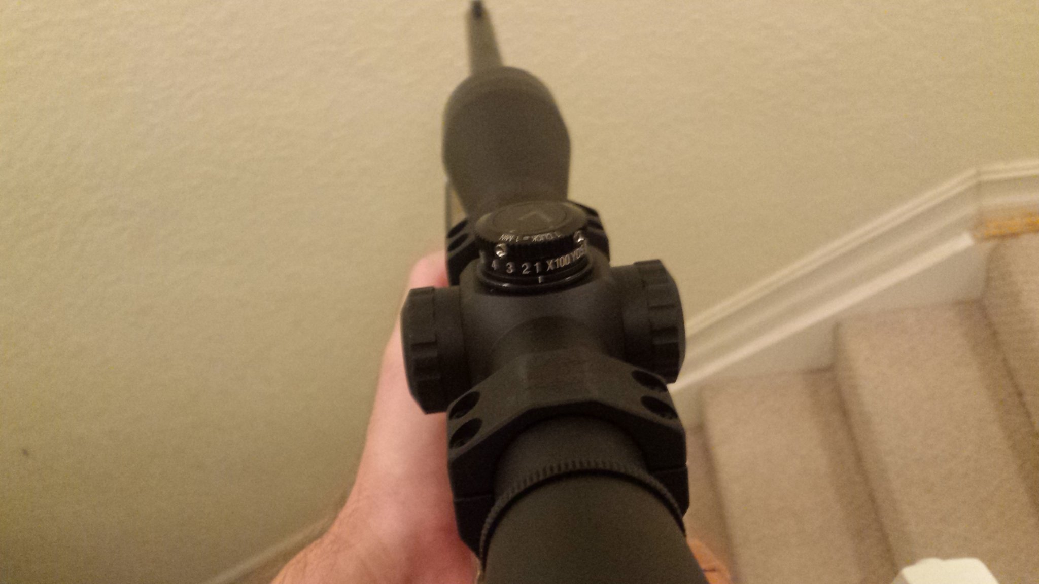

Thanks mjh30! Thanks for the insight on the spare elevation dial in the deployment kit. I have the newer mark 4 m3 10x40 LR/T. I'm curious if the m118lr m3 dial will work on the newer scope. As my elevation know turns counterclockwise. And I think the old M118 m3 dial turns clockwise.

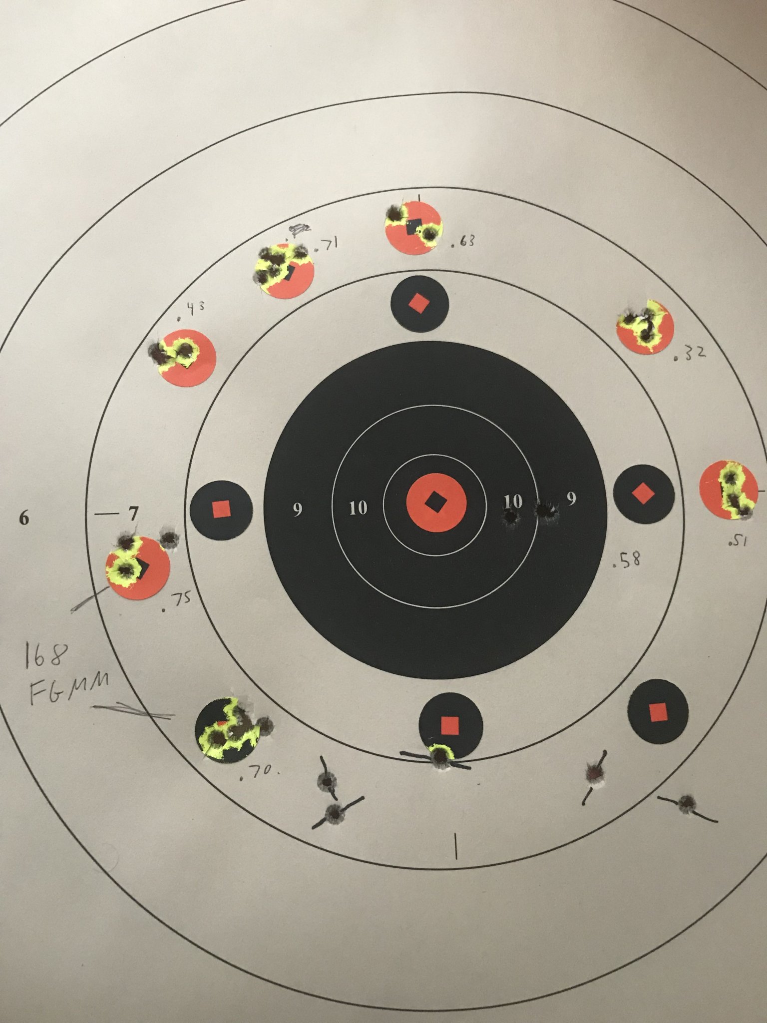

Went out shooting this past weekend and finally got some time behind my 10x mark 4. I’ve shot my m24 before with irons and a target scope but never really shot the gun as it would have been used/issued. All in all I was very please and quite impressed what these guns are capable of. My brother has one as well and his shoots like a laser beam too. The majority of the shots were with handloads, 175 smk w/ 43grs of varget, and the two groups at the 8 & 9 o’clock position were with 168 FGMM. All shots at 100yds. The group in the black was supposed to be on the black sticky at 3 o’clock but I incorrectly adjusted the scope after getting it on paper. Obviously you can tell which ones were sighters and 3/5 shot groups.

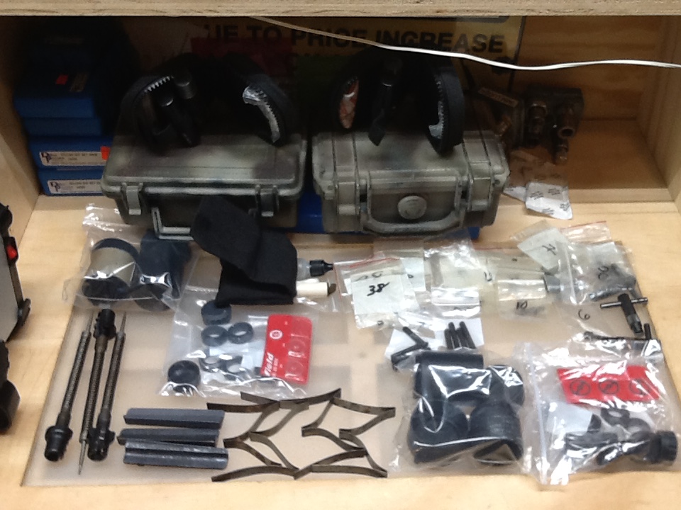

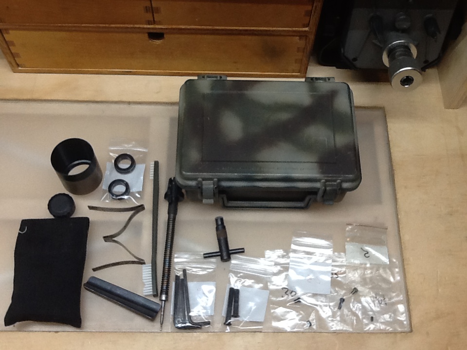

I actually joined this site to sell some old M24 parts I have around but need 100 posts. Let me know what you guys are after and I will dig through the kits I have. Not looking for a killing for it but want it in the hands of those who will use it.
Leupold Stevens discontinued manufacturing BDC dials for the Ultra series scope many decades ago.
Picture added.

I could use a firing pin, Allen wrench set. sun shield for the scope. Extra rings
Scope rings or turret rings? Don't have scope mounting rings and were not part of the deployment kit. Honestly you are better just putting an Allen wrench set together from Lowes or something off a listing in the TM. I am going to try to make two decent partial sets rather than going part by part. I do have a stray firing pin, sunshade (some camo paint on it) and a follower and spring. Also action screws and a few other items. Really have no idea on prices. Make an offer and I will do some research. Like I said not trying to make a fortune but saving for a project build.

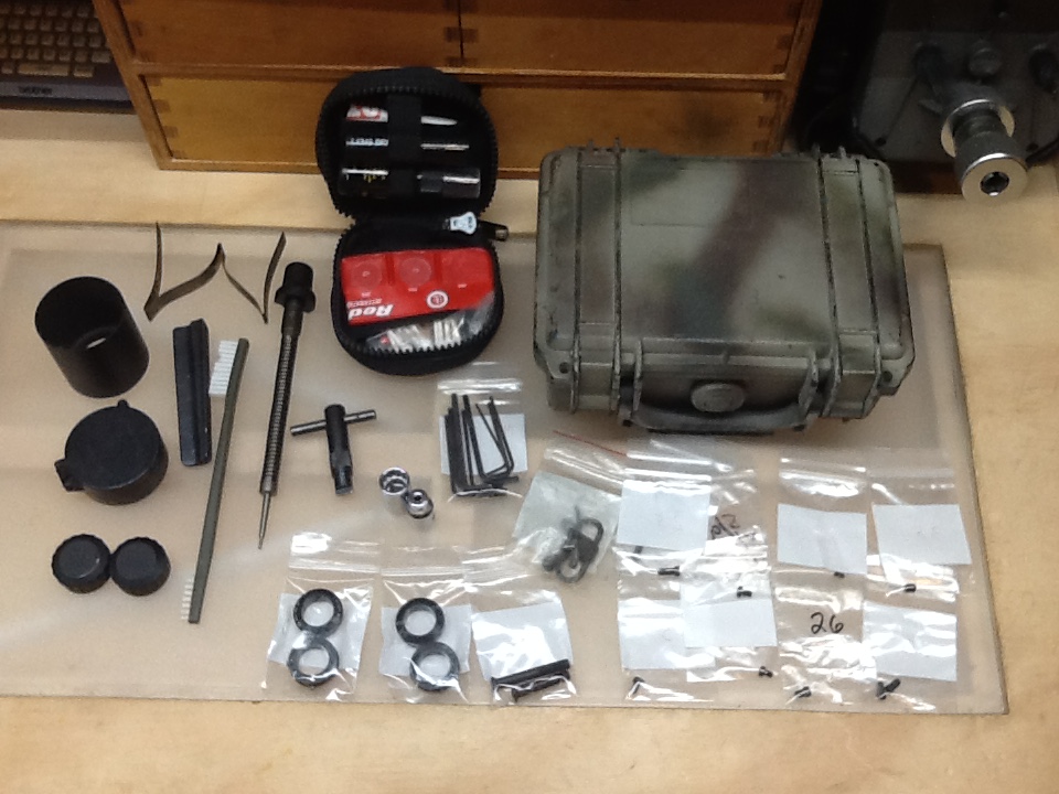

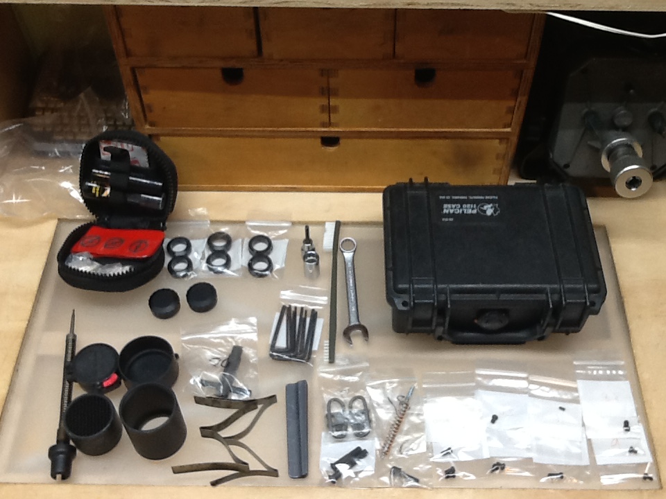

Okay sorry for the delay. Work has been hell combined with a broken windshield and a tree falling on my shed. Anyway I did get the parts split out and the pictures are below. Kit one (first picture) is the most complete with newest parts. None of these kits are complete by the TM but you should be able to see pretty well what is there in the pictures. Kit two is less complete and kit three is left overs but all functional.

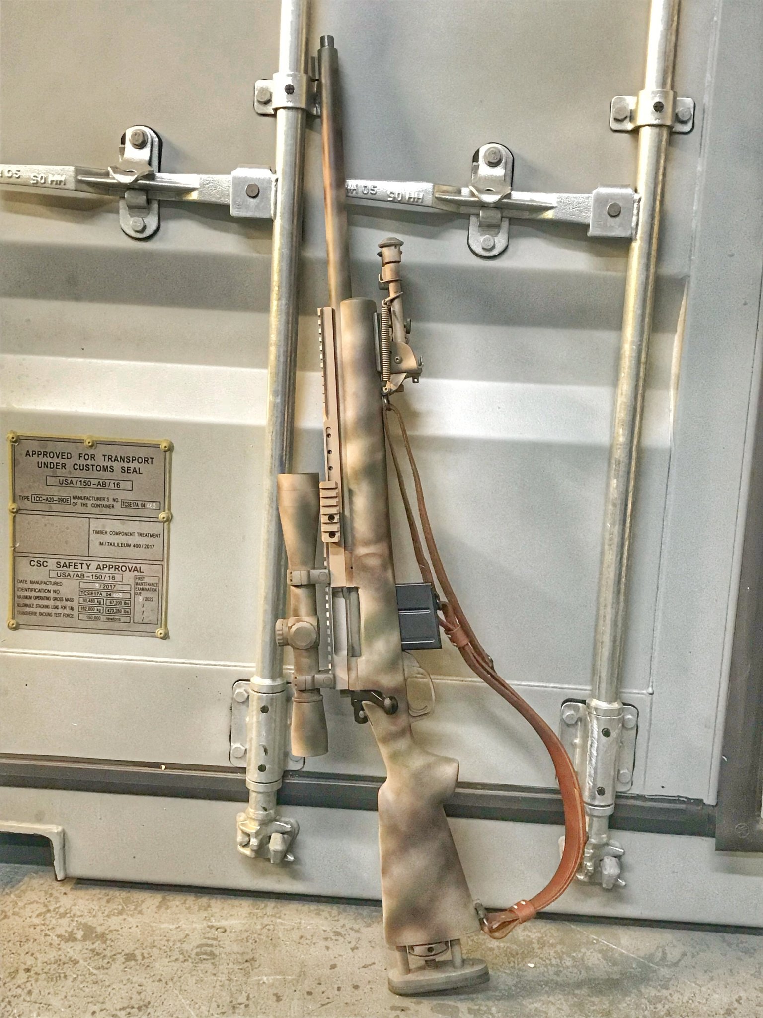

Alright right got a little teaser, M24A3ish. Since I have more .308’s than I can shake a stick at I decided in needed something more “practical “ like...a .300WM, Lol!
She has about 100 rounds of A191 down the pipe and at 16lbs it’s not bad but you know you been shooting.
Here is a side by side of MOD 0 vs MOD 1, looks like she prefers the 190’s a bit more, then again it could be that recoil, those 220’s are shout!
I’m also thinking about putting something else on the muzzle, as I’ve had issues with this SF brake before, it shoots fine when suppressed but I think it’s producing some weird turbulence when unsuppressed. 3 rifles now and it’s alway the same trend. However I just wasn’t that eager to hop down behind those 220’s without a brake.
