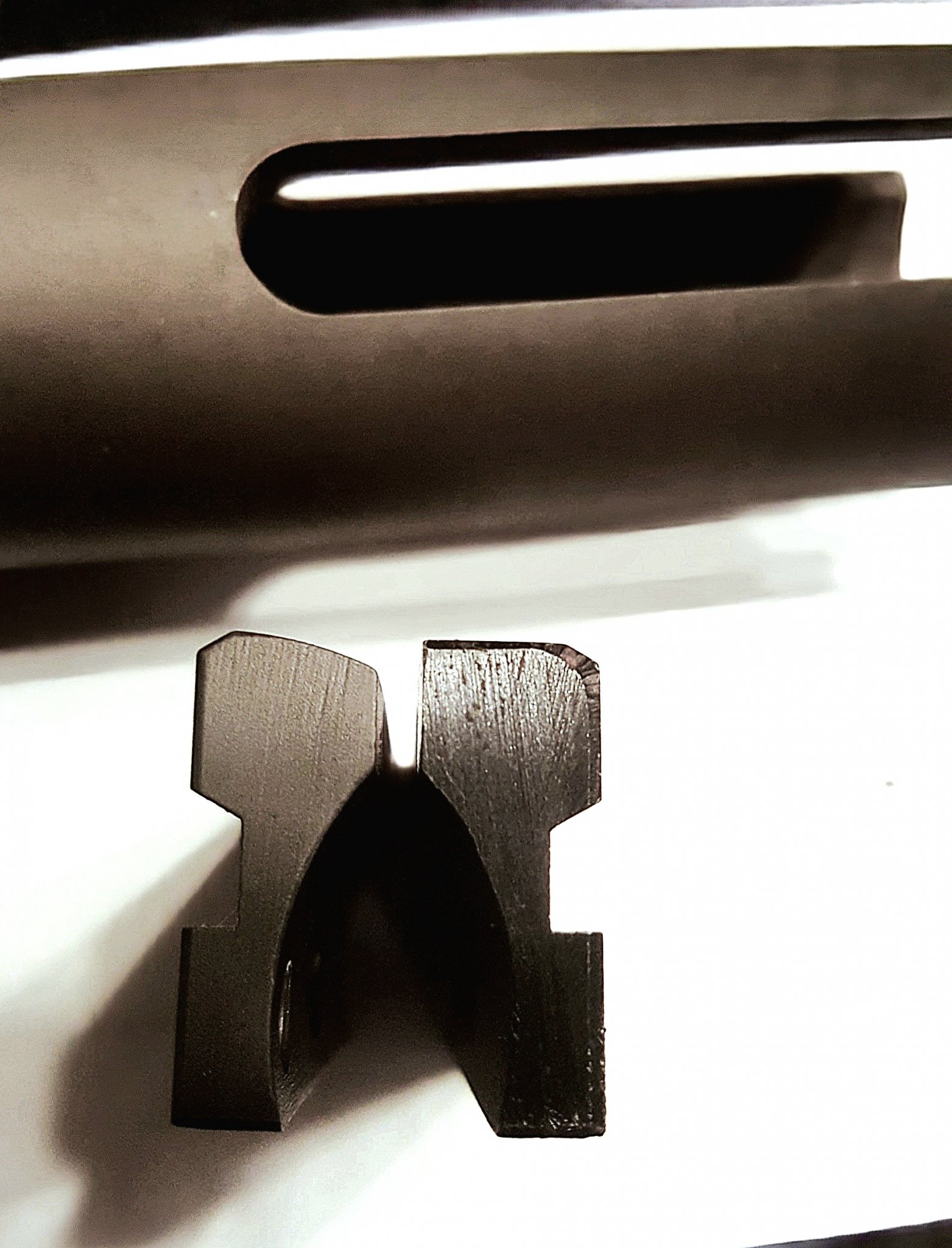

Thanks.Is there any machining needed to make these work with the Ultra rings?
As was said above- the inside edge needs laid back. This was done by hand at Rem prior to glass beading and parkerizing. The relief was filed down to the mounting holes.

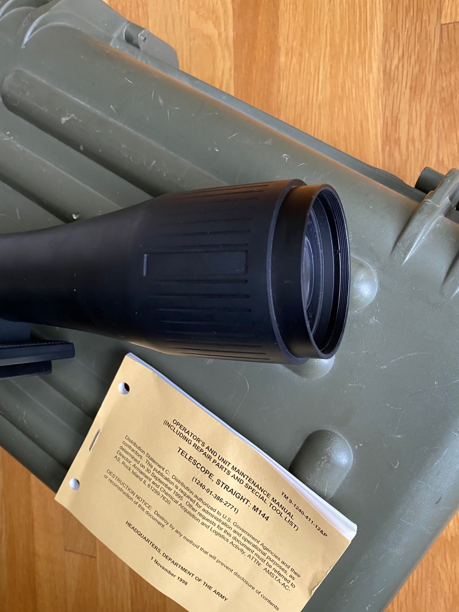

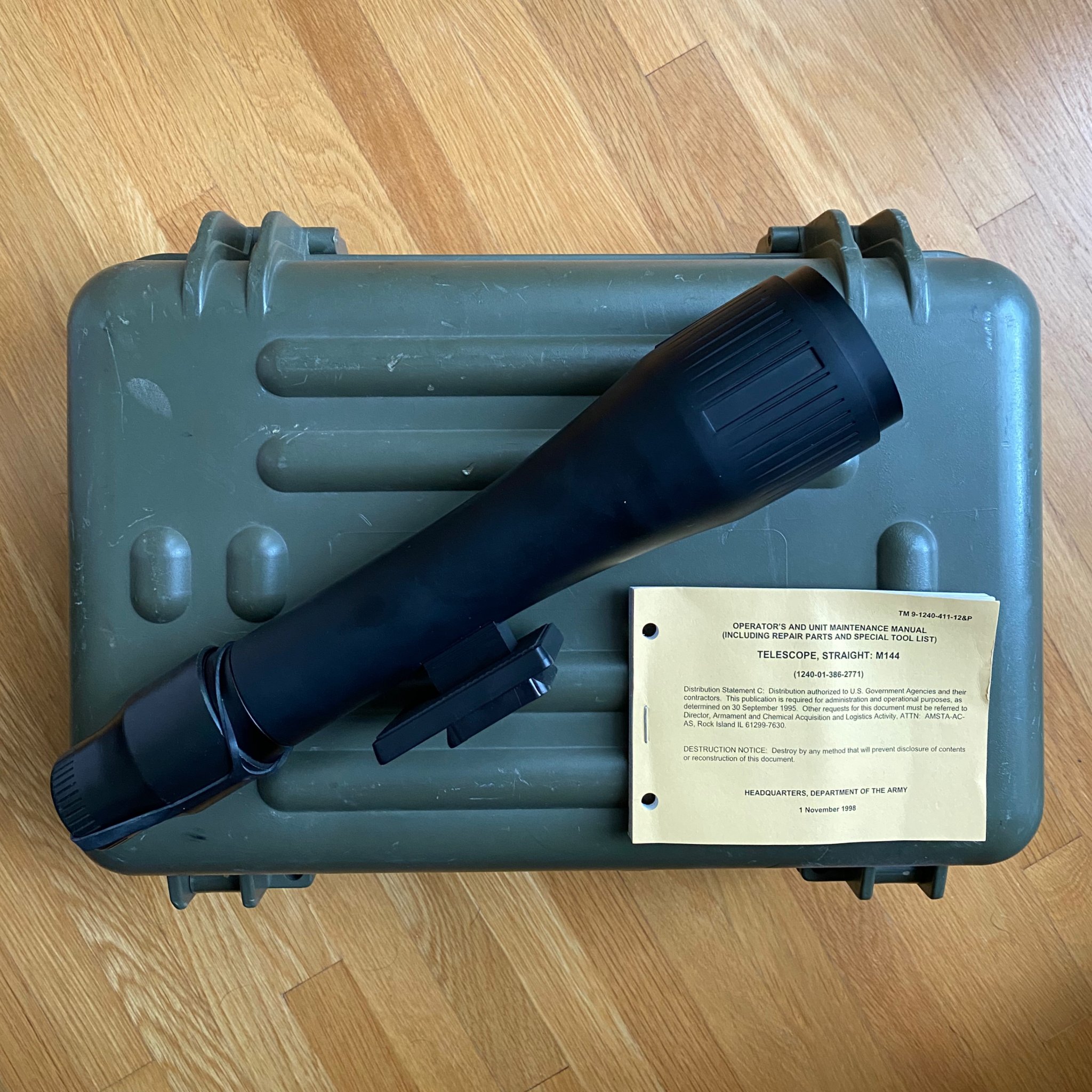

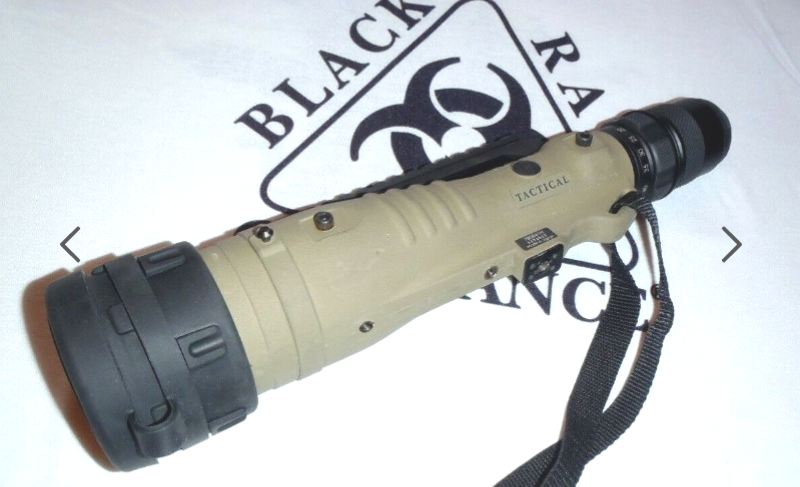

Just acquired an M144 spotting scope courtesy of another hide member. It does not have the front lens cover. Based on photos found online, looks like it originally had a binocular style flip off lens cap. Anyone know where to obtain a suitable replacement for this? The external dimension of the front “lip” measures at 66mm almost exactly. Thanks for any help!
View attachment 8313230View attachment 8313231View attachment 8313232View attachment 8313233

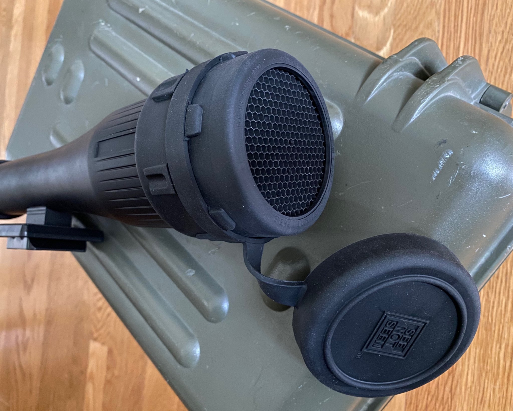

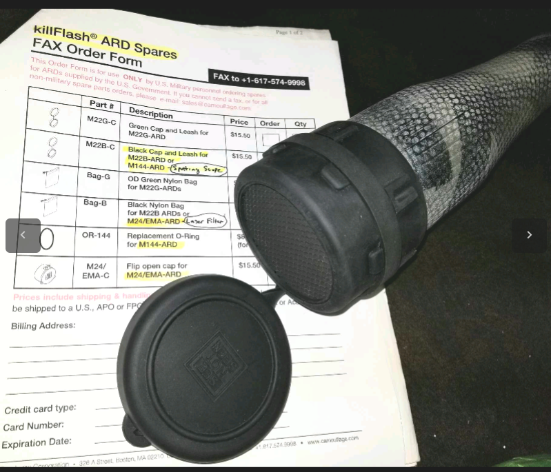

Look on eBay for L-3/Steiner Fujinon Military M22 7X50 Binocular lens cap covers 70mm/2.75" These are a slip fit rubber cover that should work.
If you want to get fancy, search Tenebraex KillFlash M22B-ARD anti reflection device nsn 6650-01-456-9093 Black.

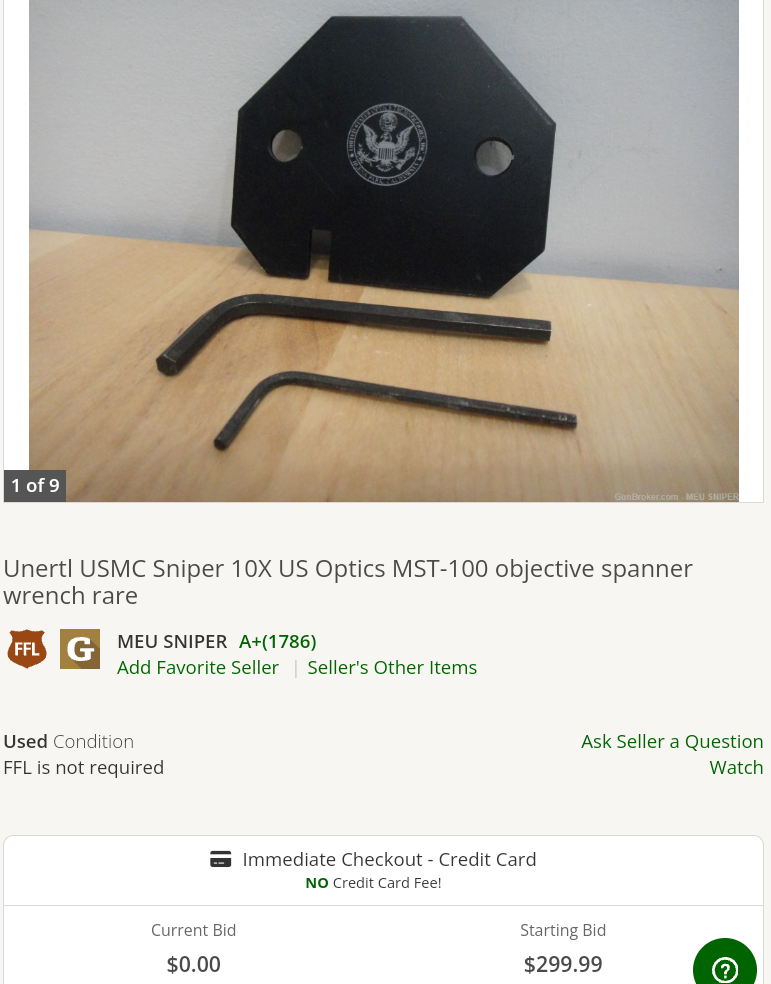

Col. Norm Chandler would prowl USMC sniper ranges with a pocket full of spanner wrench copies made in his machine shop. He'd trade them with snipers for their original Unertl-built spanners. Pretty smart idea. Wonder how many he collected over the years?

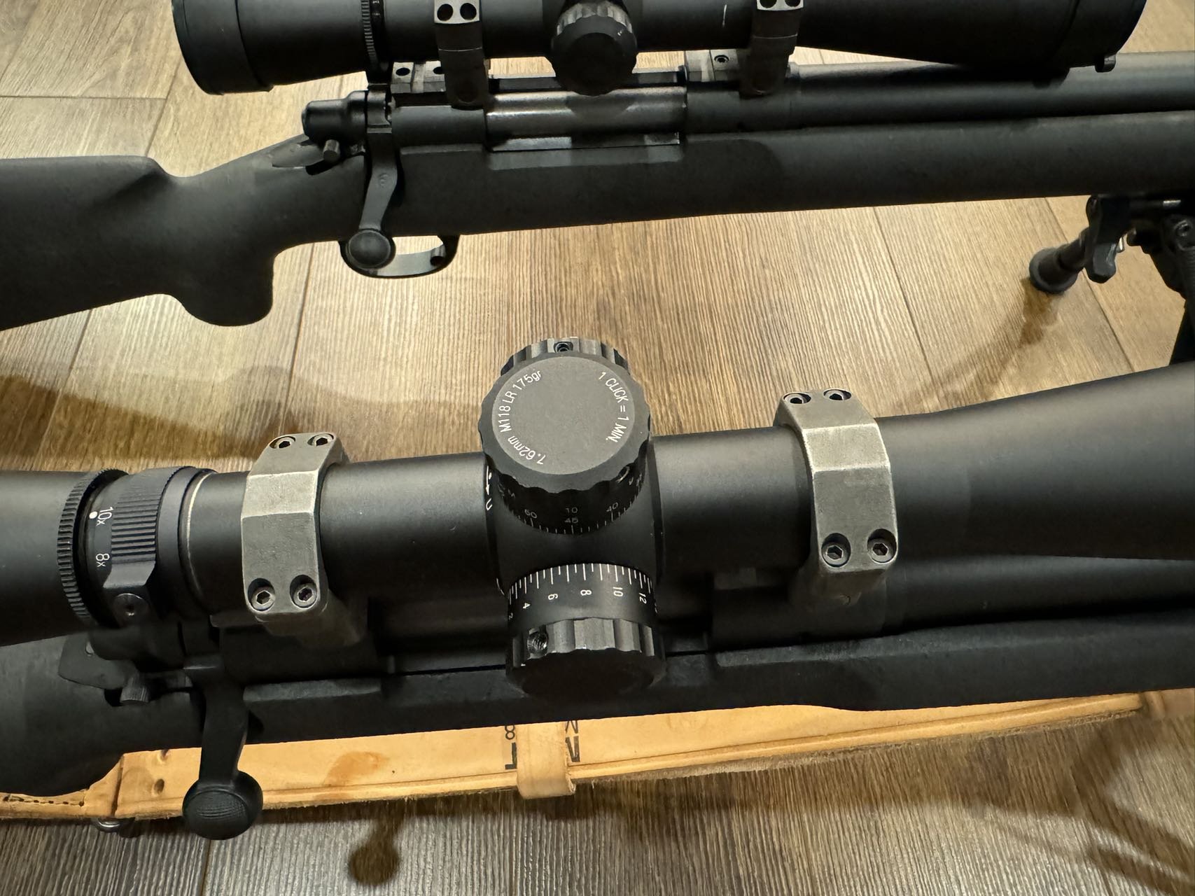

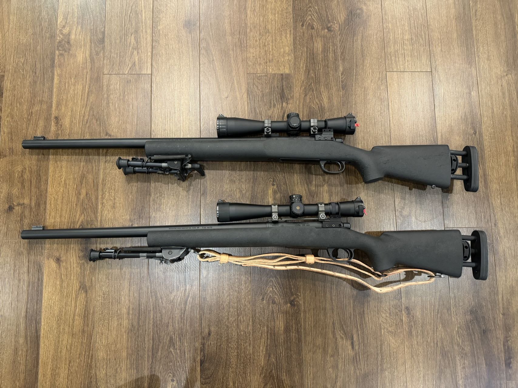

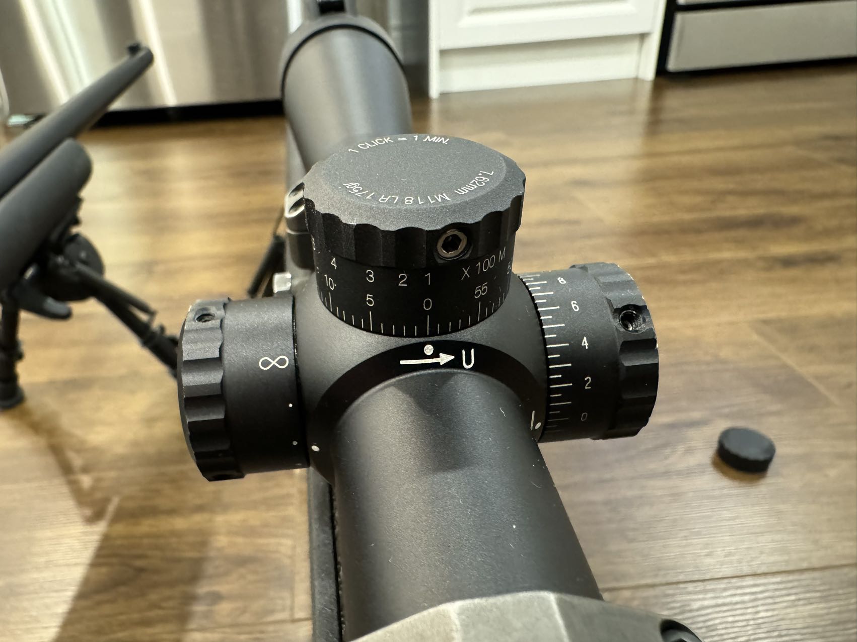

Asking a question to the knowledgeable people on this forum....So I acqired two M24s and one comes with the correct leupold M3 10x scope and the other one is equipped with a Leupold mark 4 3.5-10 FFP, I am not too sure if the 3.5-10 was ever used on the earlier M24s that do not have mccann mirs rail installed. Should I hunt down another Ultra or fix 10x and pay stupid amount for it or just be happy for what I got? What are your thoughts?
Asking a question to the knowledgeable people on this forum....So I acqired two M24s and one comes with the correct leupold M3 10x scope and the other one is equipped with a Leupold mark 4 3.5-10 FFP, I am not too sure if the 3.5-10 was ever used on the earlier M24s that do not have mccann mirs rail installed. Should I hunt down another Ultra or fix 10x and pay stupid amount for it or just be happy for what I got? What are your thoughts? View attachment 8319205
View attachment 8319208View attachment 8319209
They were absolutely used with 3.5-10s
Find a MIRS maybe? that way at least the rifles have a point of difference
Well if you're wanting to match the scopes to the rings and their period, the rings on the 3.5-10 are the appropriate rings for the Ultra and visa versa. Both rifles are late models so which scope to which rifle is a crap shoot. A MIRS or a MARS would be period correct for the 3.5-10 for sure but some rifles that had MIRS put on them could also use the Ultra scope.

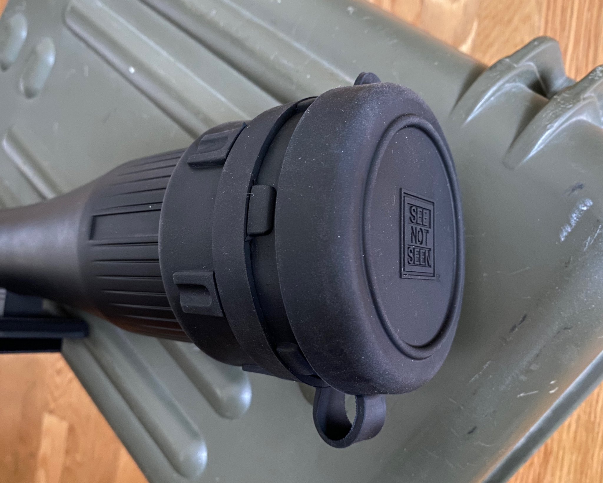

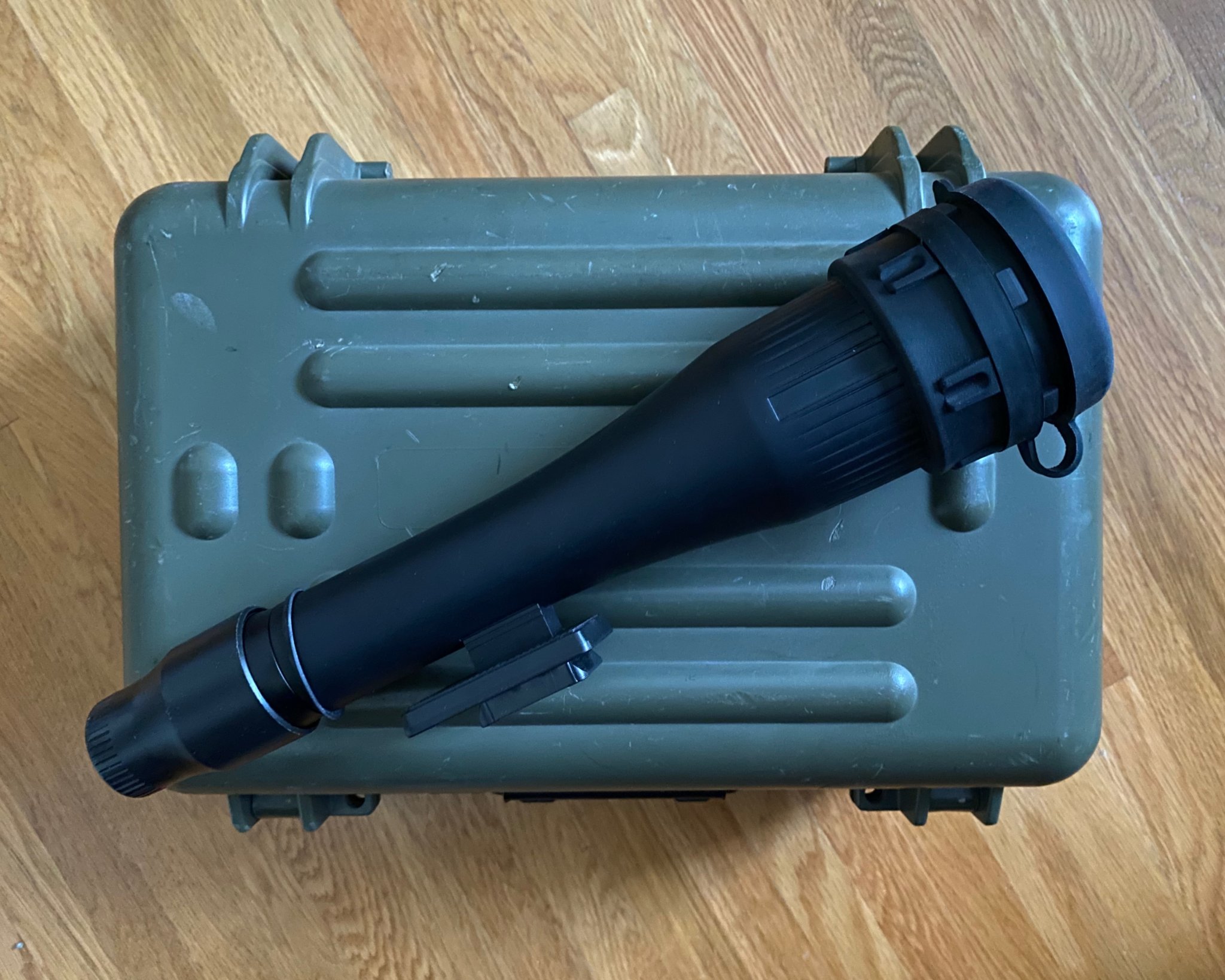

@lockedandloaded Thanks for the info. The M22 ARD covers work great! They are pretty inexpensive on eBay, especially since they are both an ARD and a lens cover/protector, and come as a pair too (for those that lose stuff, or like to have backups 😉).

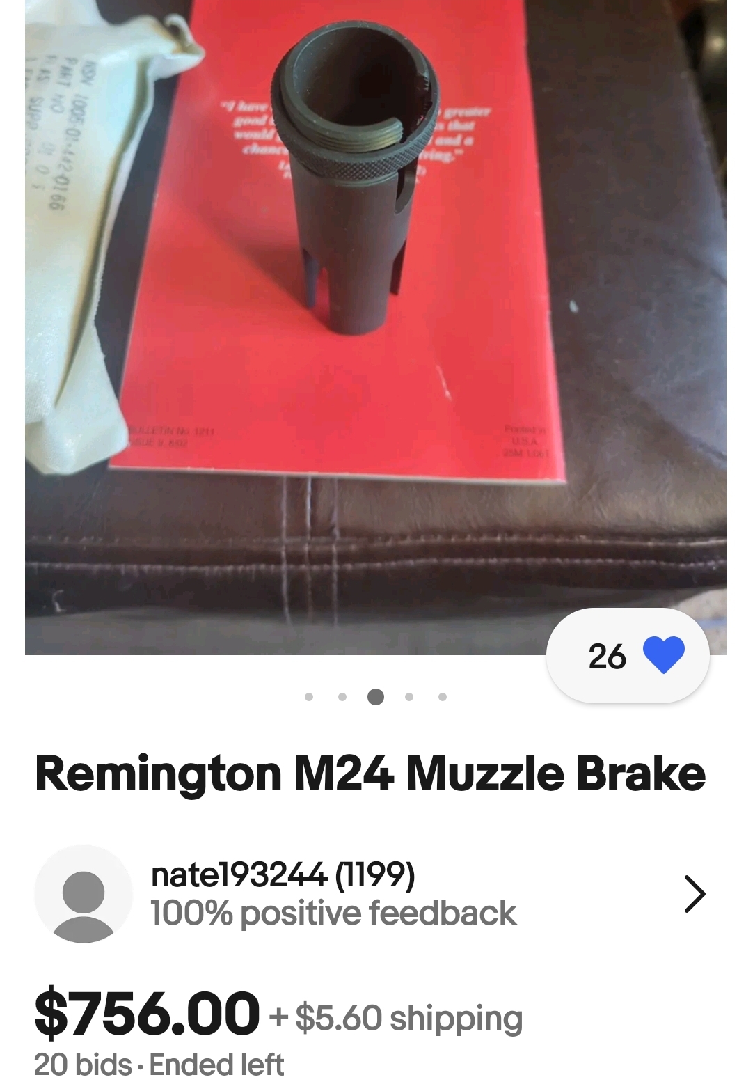

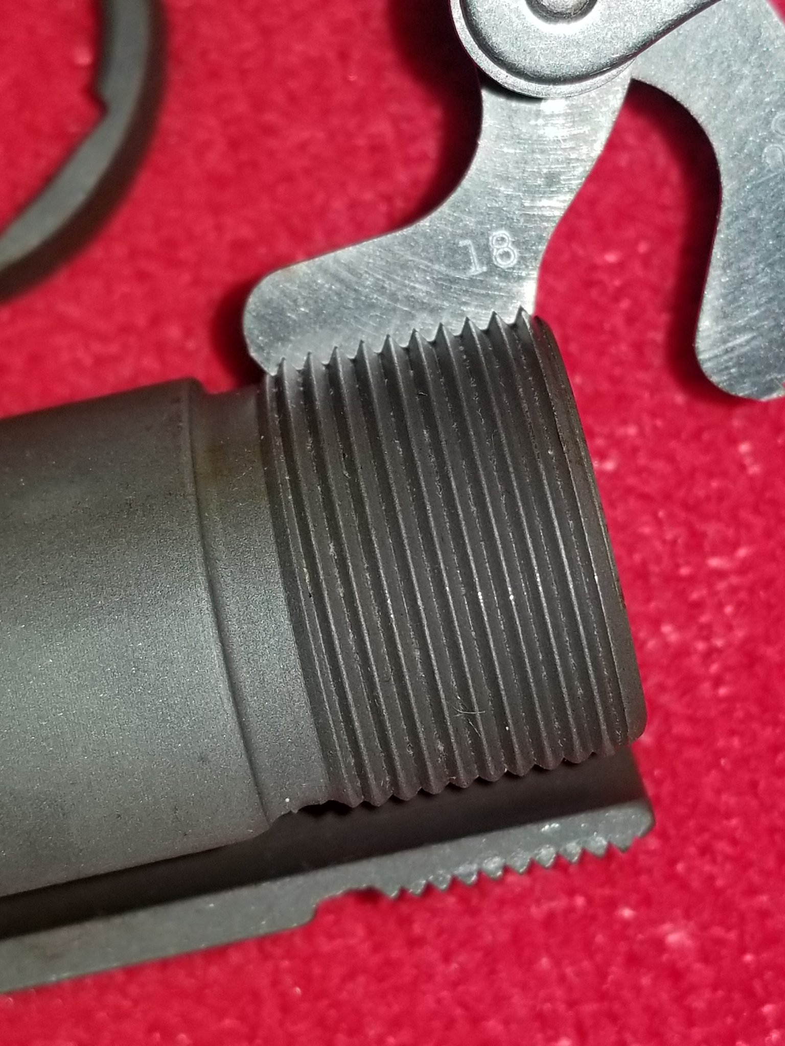

Does anyone know the thread pitch for the over-the-barrel flash hiders? I'm trying to get extra lock rings (both original and larger thickness versions) made, and cannot find the correct thread pitch anywhere. Thanks in advance!

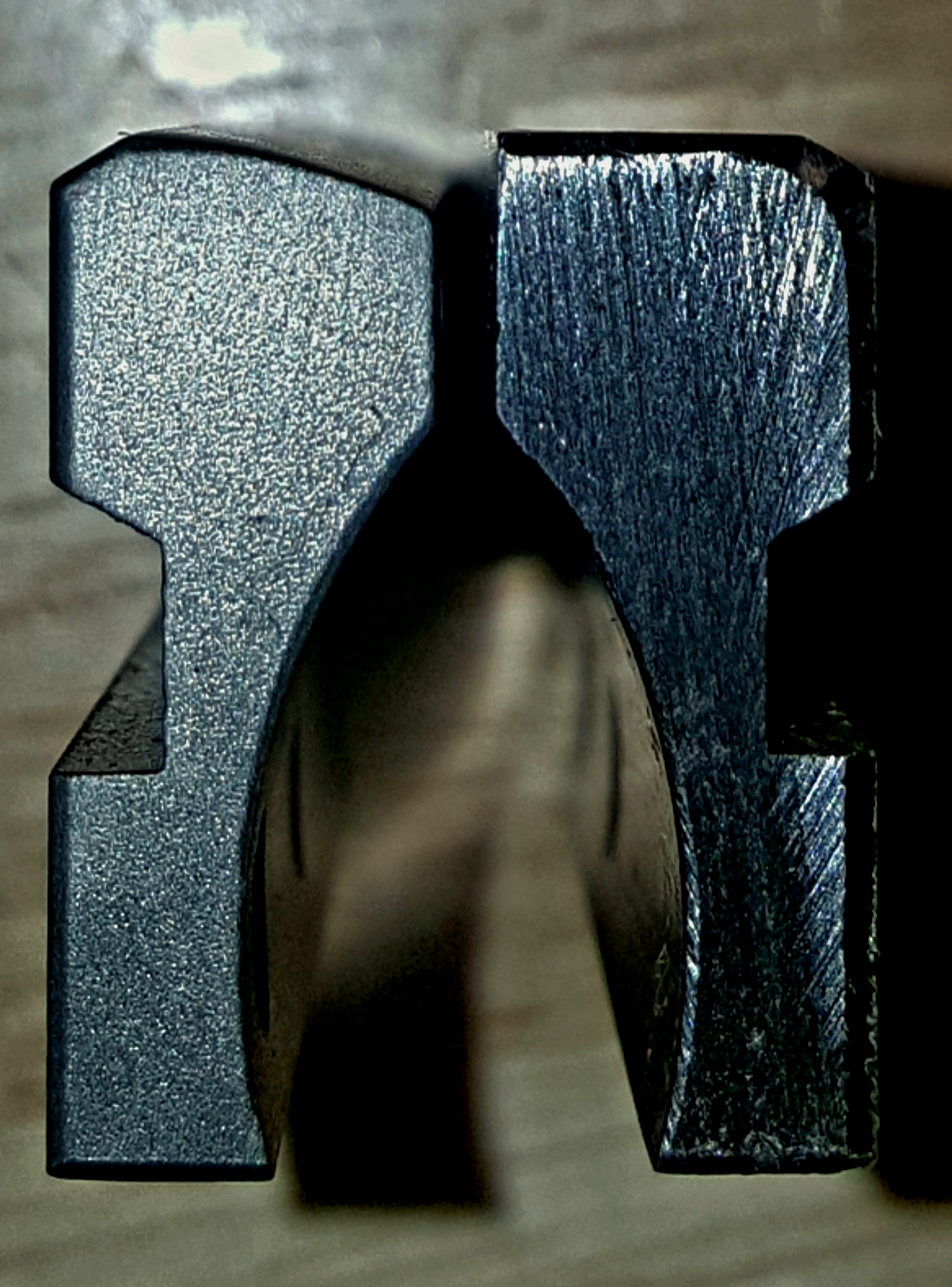

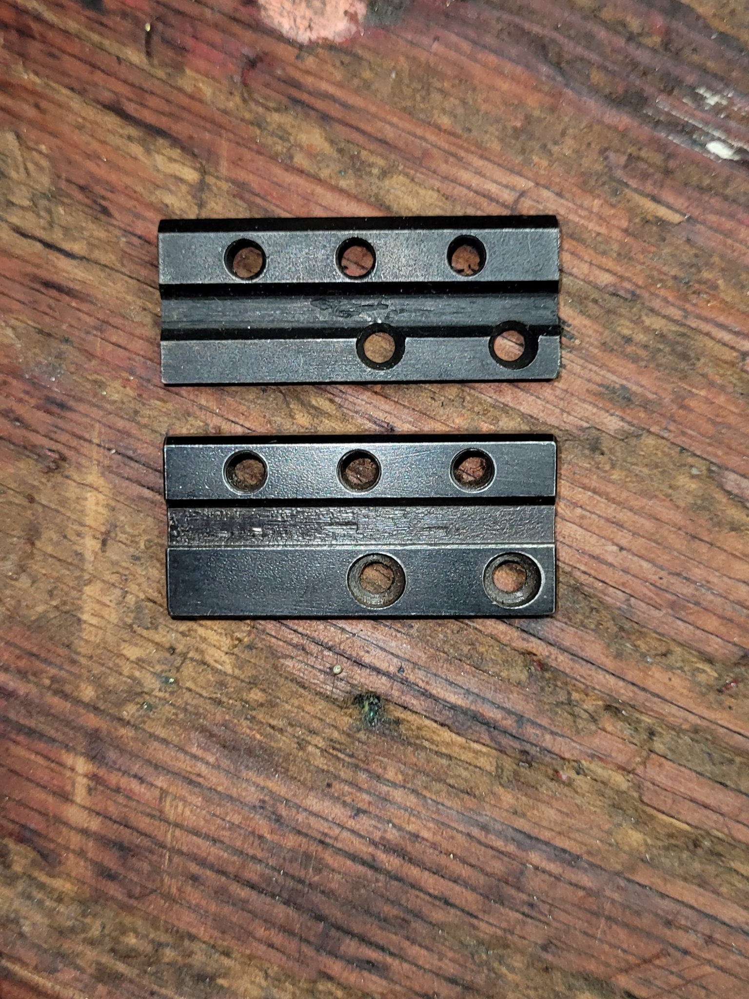

Mentioned earlier in the postings about the Cloward made rear sight base, had previously gotten one many years ago from Outback but quickly discarded it as dimensions were off. Afew pic, Clowards version, the outback and obviously original wb490.
The hole spacing dimensions are spot on. What dimensions are you referring too? I know you've shown how Remington had to hand-file the Redfields so they cleared the earlier L&S ULTRA 30mm rear scope ring. But Leupold began using longer shanks on the ring nuts to clear the sight base.

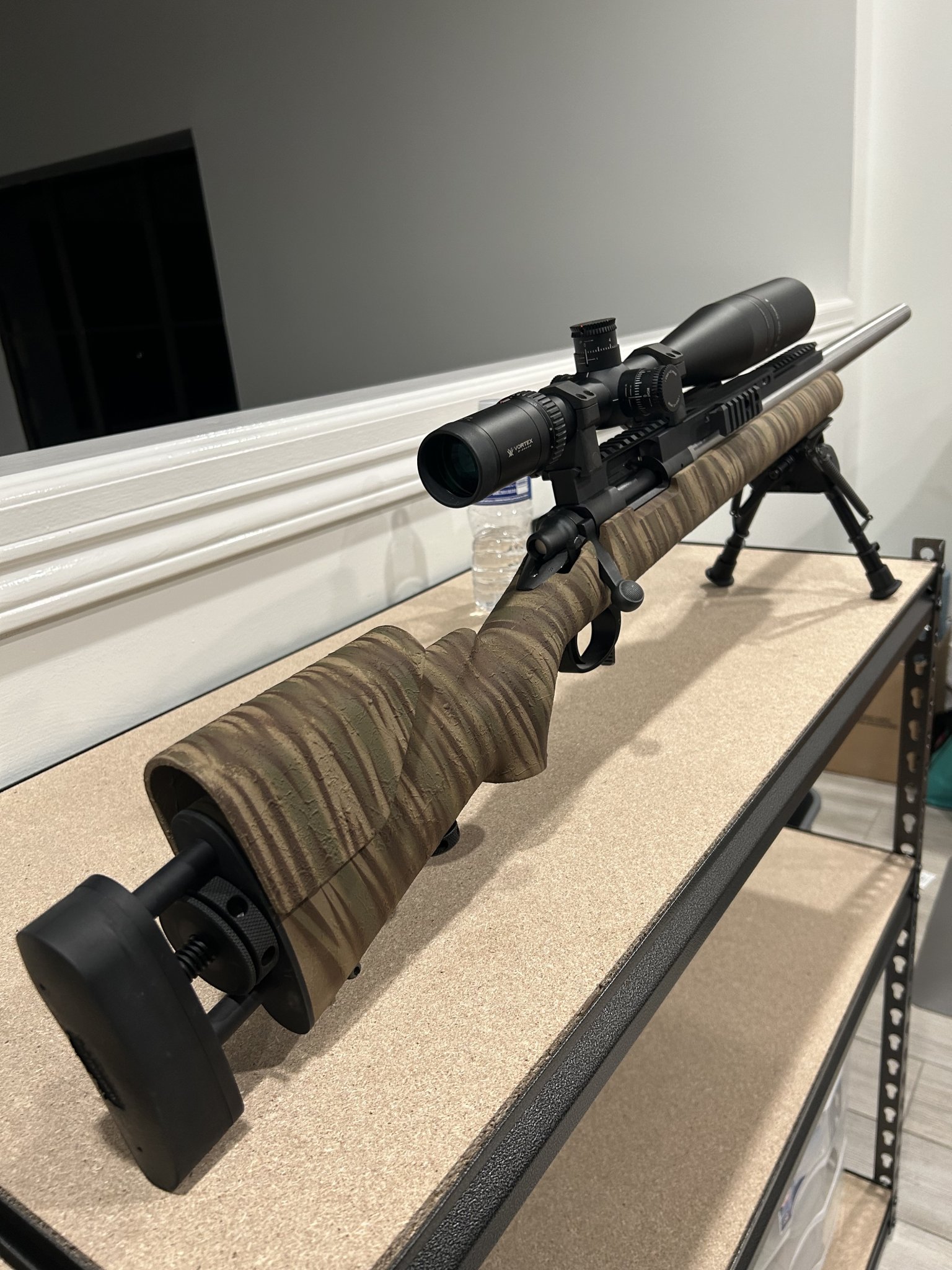

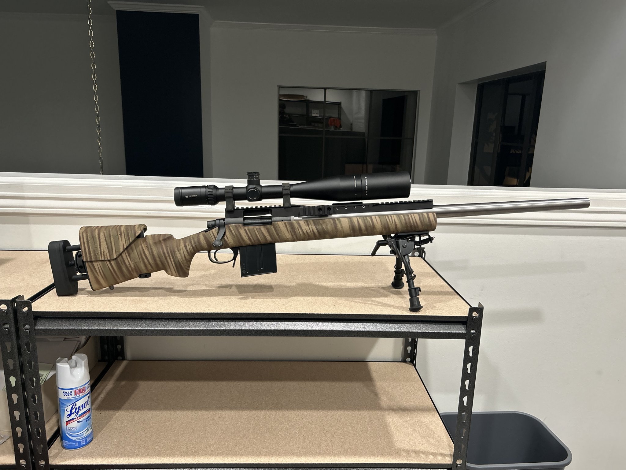

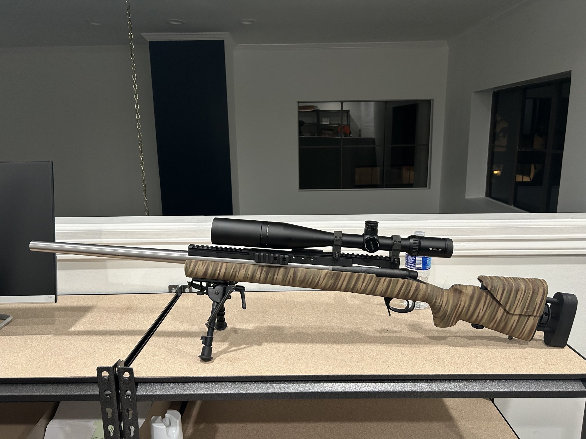

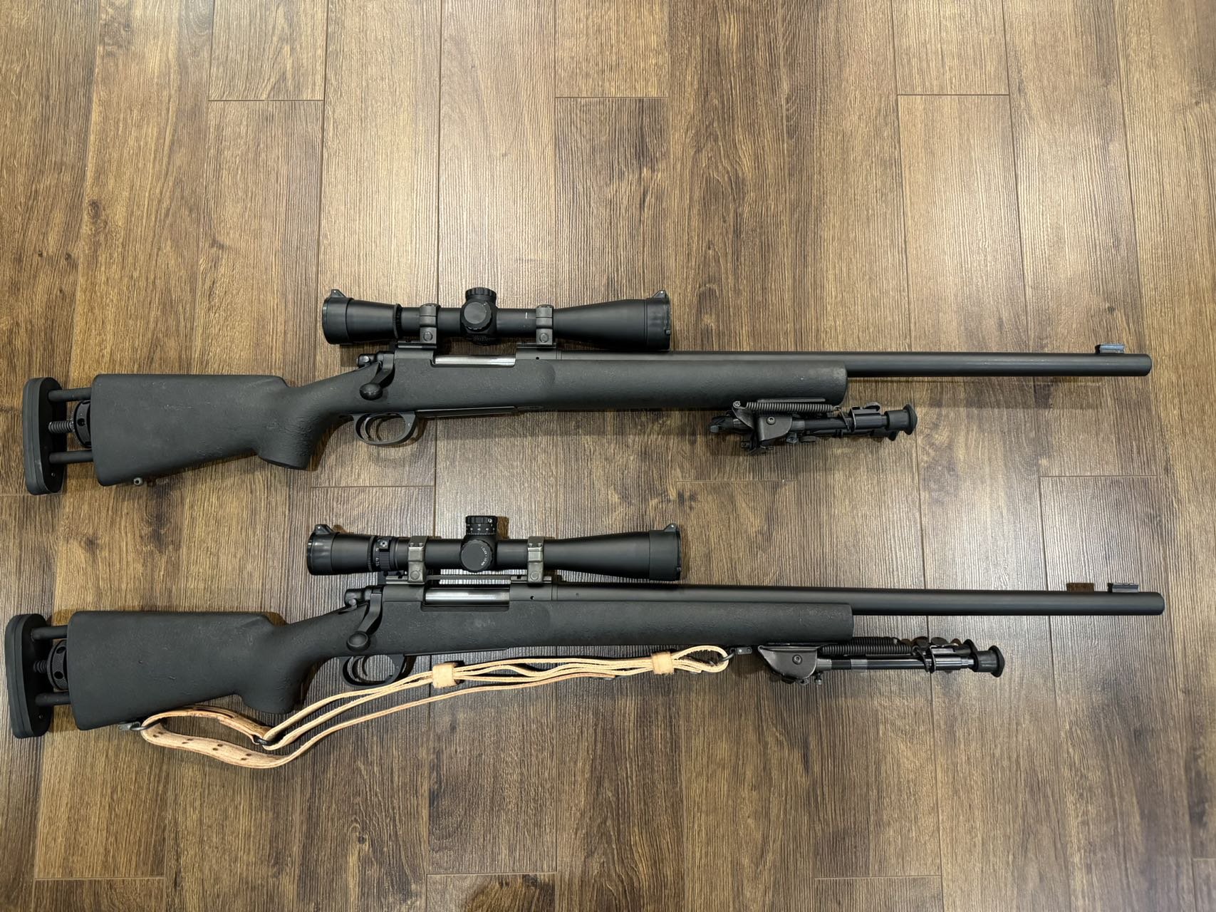

Just wanted to share my m24a2 inspired build I recognize some parts are not exactly clone correct but here it is. View attachment 8328409View attachment 8328410View attachment 8328411
Recommend you figure our your cheek height for that riser....measure it....and make a sleeve out of plastic or aluminum to slip over the posts underneath the riser. Those cheekpieces suck.
Your rear bag or support hand will turn that thumbwheel and it will cause the riser to go up/down if not locked down. Not good for consistency. I complained directly to HSP over a decade ago. They still haven't addressed it. Even if the solution is a chinsy one.
Reactions: Balor and Rem.243
I'd be fine sending it to you so your machinist can mic it himself. This one fits the early Redfield front sight base. I need a spare lockring that fits the newer OK Weber/RPS Trakker front base. LMK if I can buy one.

@Rem.243, thats a nice looking build. Its always welcomed to hear about the details like bbl maker, gunsmith, parts, etc.
Wish i had more information on the barreled action.
This is a remington 700 short action chamber in .223 rem. Barrel is a 1:8.5 twist.
When rifle was purchased it was set up for fclass. The action was definitely worked on and barrel did not seem to be fired much. Contour matched a rock creek m24 barrel i have. However, was unable to find any additional information on it. It really likes 77gr fgmm will put them in 1/4” @ 100. Have gotten the opportunity to stretch the legs to 600 and consistently get hits on an 8” gong. It has a harris bipod, Mars gen2 0 moa rail, a timney 510v2 trigger, and a ptg m5 bottom metal it feeds out of mdt .223 metal mags flawlessly.

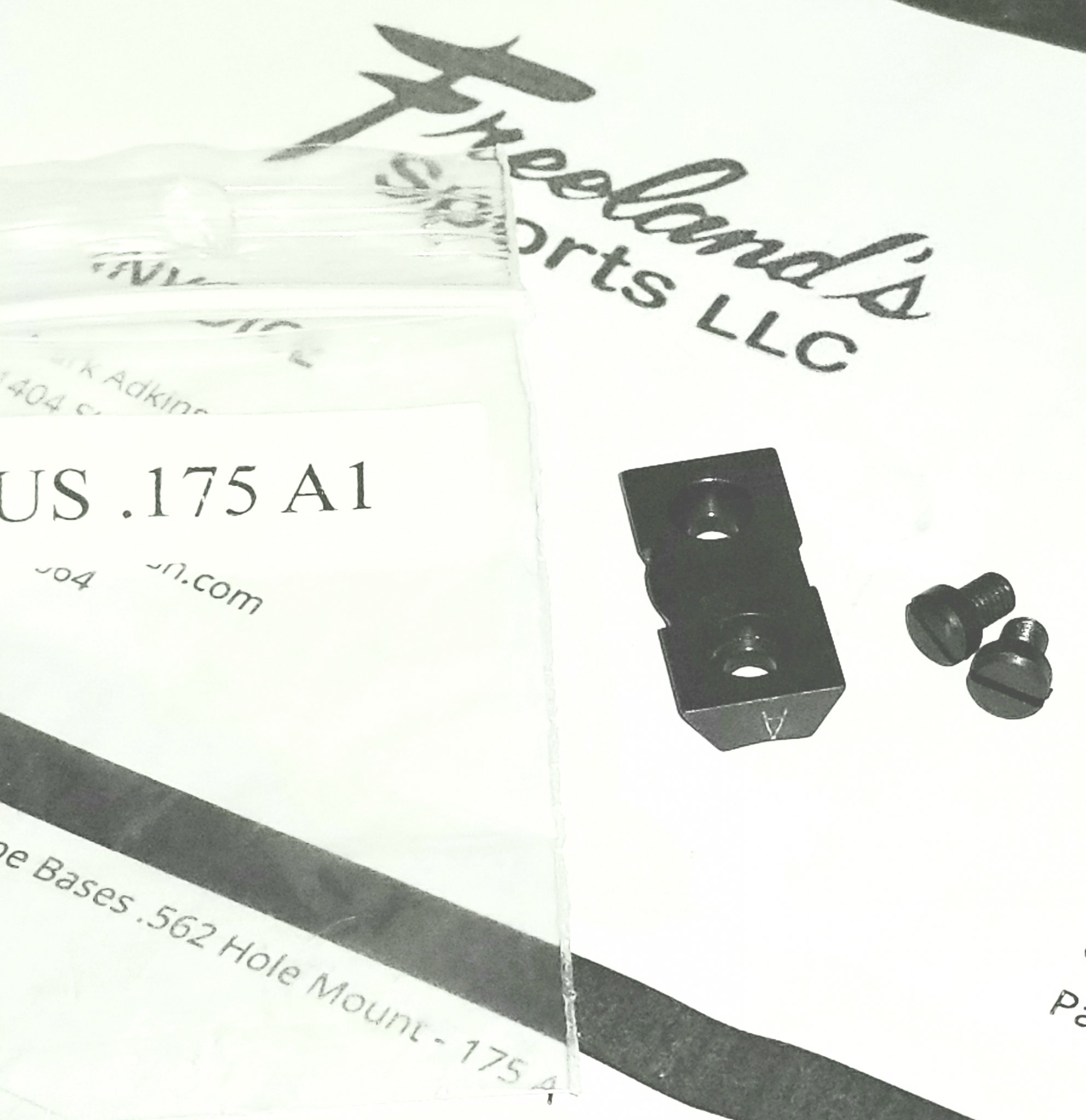

If you need a Redfield front sight base, Freeland's Sports still offers an original spec version. It's stamped with an inverted "A" on the end, and comes with 2 slot-headed screws, not the allen key type used on the M24. Height is .175" correct for alignment with the rear Palma sight. Hole-to-hole spacing is standard .562" to fit factory Remington threaded holes.

Just what I needed for my early C prefix m24. Has anyone ordered from them yet?

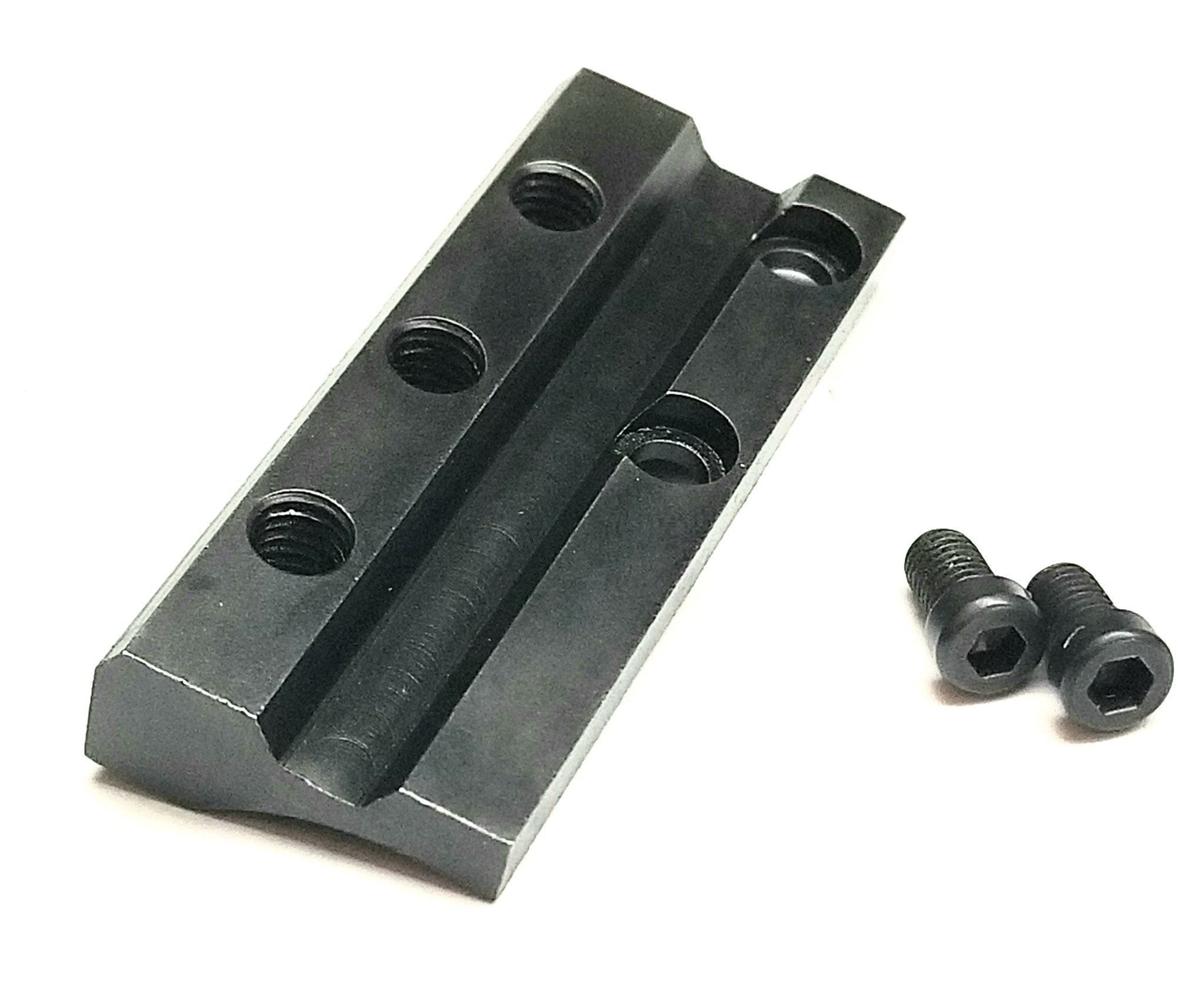

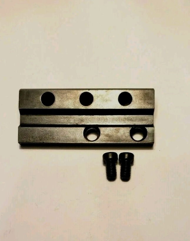

If you need a Redfield WB-490 rear sight base, there are several dealers offering repros. This version was made by mastersmith James Cloward. It comes with two 3/32" allen head screws spaced .562" to fit the Remington receiver holes. Blued finish.
$30 on eBay

Already have a set from an old 40xb rimfire figured i use that set. My understanding they are redfield. I just need to take it to the smith to drill and tap I appreciate the help!
