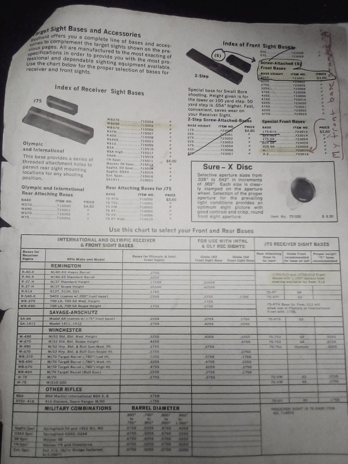

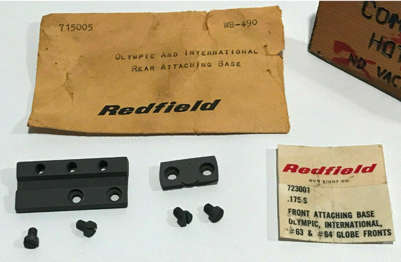

Is there difference between the .175-S redfield vs the .175-A1 besides the maker.
Whats the difference between the .175-S vs the .175-A
The "S" designates Screw-Attached front bases. Without the S would be a 2-Step Screw-Attached special base for small bore shooting with two heights, one for 100 yards, the other for 50 yards. Purpose was to prevent wear on the rear sight from cranking the adjustments back and forth when switching course of fire. You move the front globe instead of adjusting the rear sight.
The "A" and "A-3" were customized "Special Front Bases". I havnt deciphered exactly what the differences are. I'll post a pic of the Redfield catalogue so you can understand why I dont know the answer
You edited your question while I was typing, no problem.
The question you're asking is whats the difference between the Redfield 175S (item # 723001), and Freeland's .175A1 (sku: US-175-A1). I do not believe there are any differences in dimensions or screw-hole spacing.
Reactions: USNavy06
The geometry of the rear sight & front sight are very specific. This has to do with the click-values of the rear sight dials. They need to be an exact distance away from each other in order for the rear Palma adjustment dials to be accurate. Just like a +20° MOA canted scope base, you could run out of adjustment clicks. Different height front bases also compensate for varying barrel profiles among manufacturers
Original Redfield parts

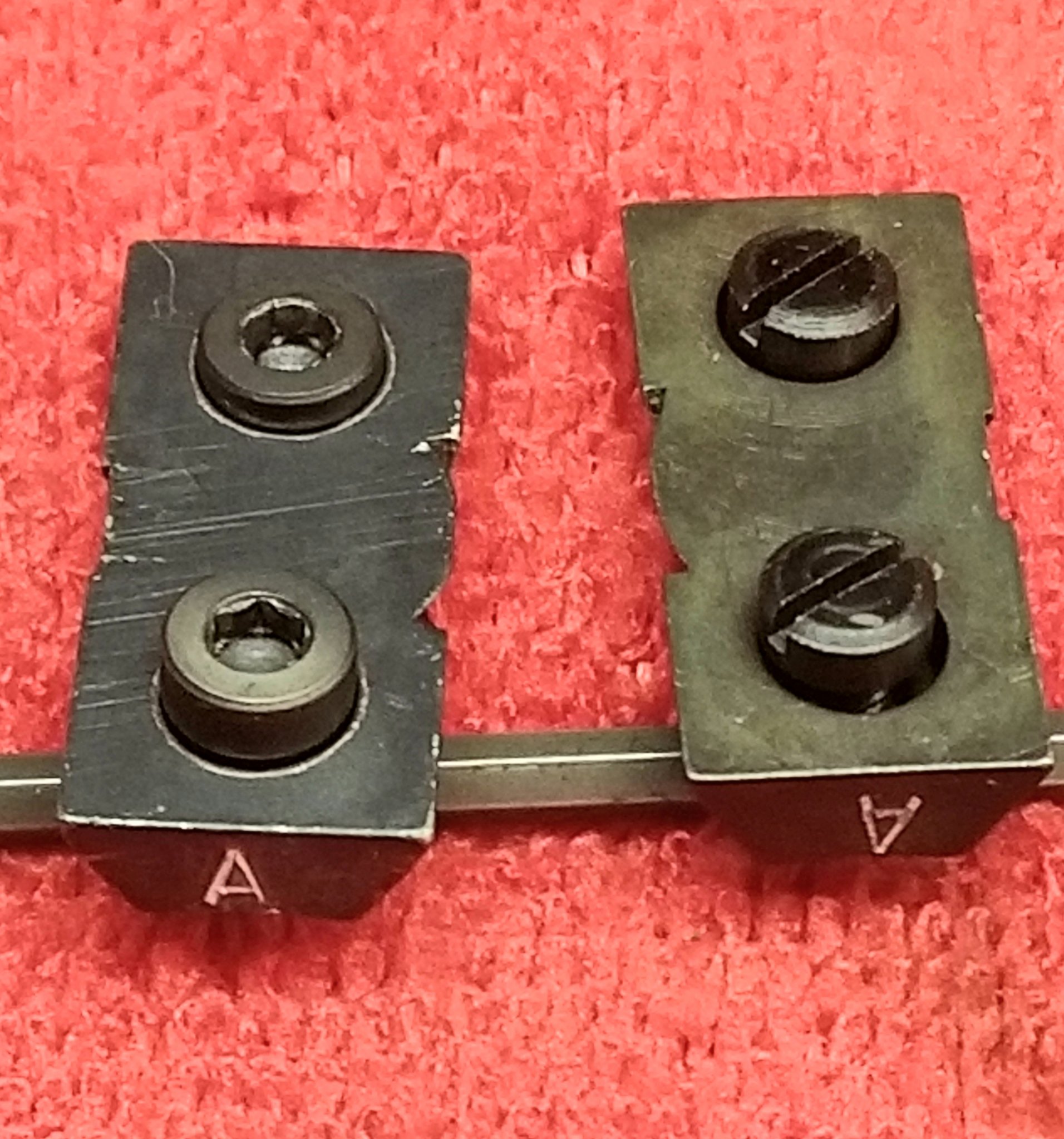

Quick update on the Freeland's front sight base.
On the left is a Redfield base that came installed on a Remington M24. The "A" is upright and stamped on the rear end. The screws are 7/62 allen socket caps.
On the right is the Freeland base. The "A" is inverted, and stamped onto the front end. Screws are flat-bladed.
The allen heads do not fit into the Freeland base holes, just a smidge too wide.
Anyone thats worked on firearms knows they often have uncommon thread patterns. Finding allen heads to replace the Freeland flat-blade screws will be difficult. Maybe a McMaster-Carr or Fastenal store could source them. Or a local gun store. If anybody has a source, let us know.

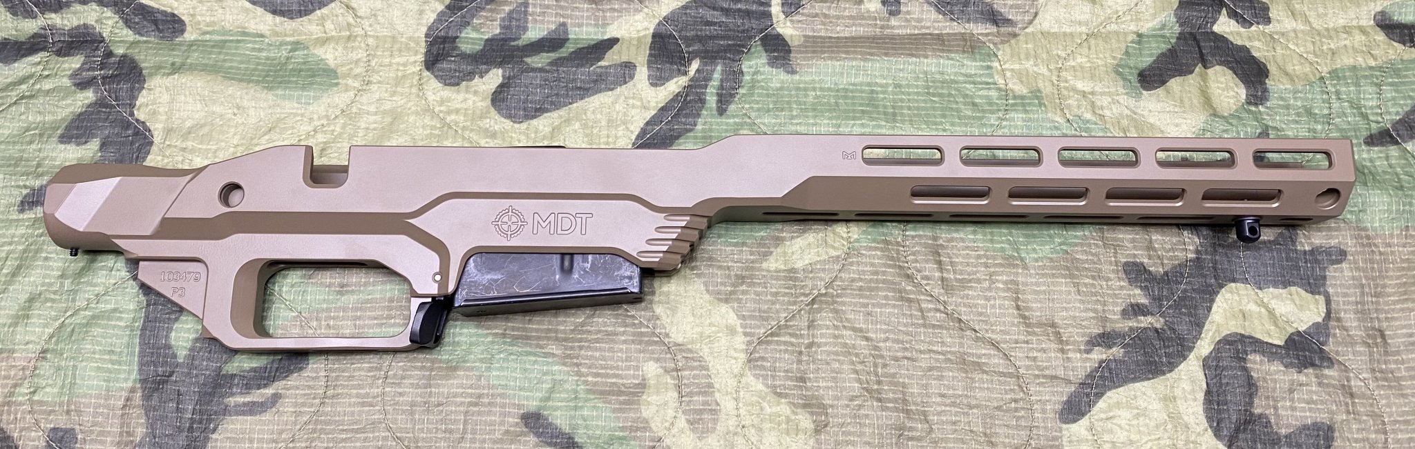

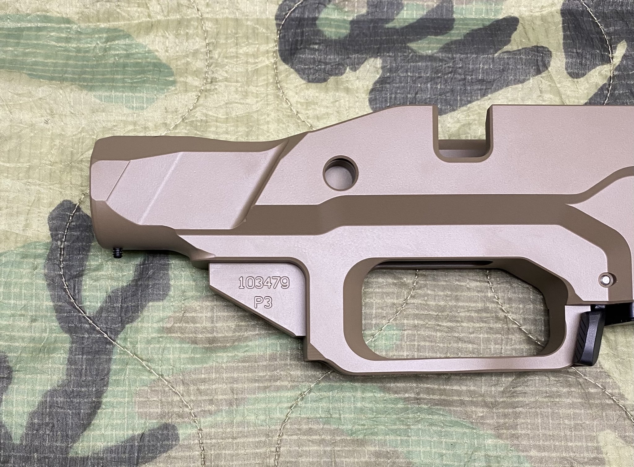

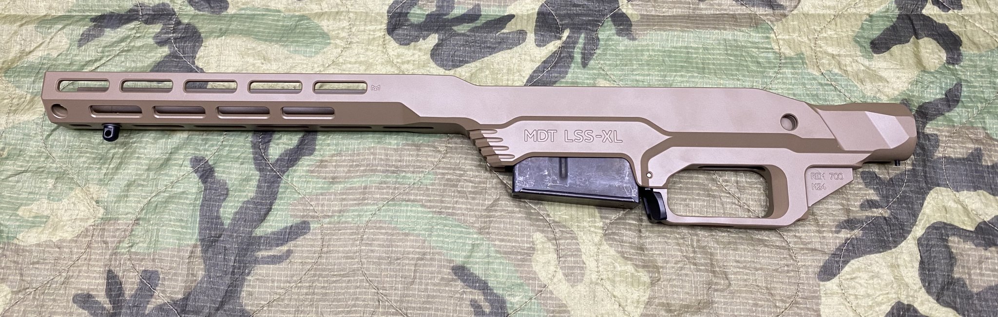

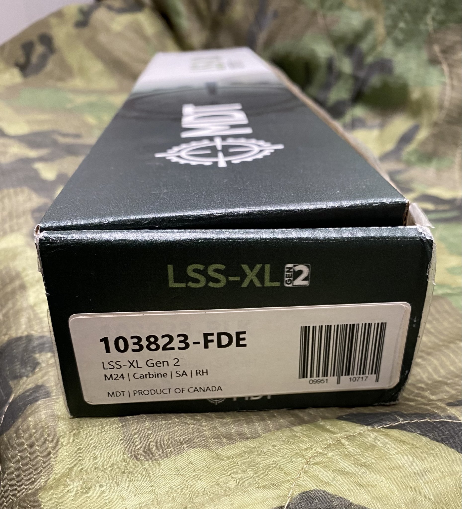

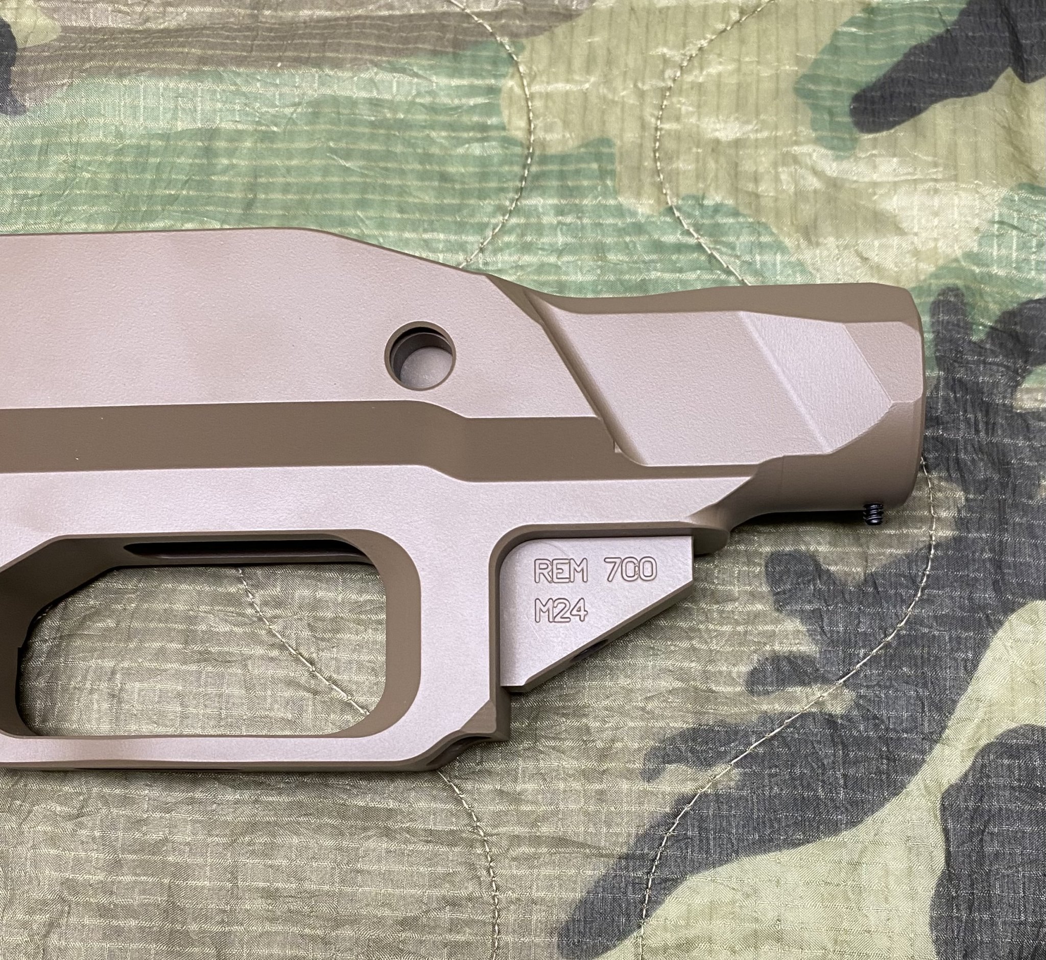

Not sure where this fits in as far as issued rifles, but I picked this up from a guy who stated when he got it from MDT it was from a cancelled contract. Emailed MDT, and Josh confirmed it was a very limited run they did and no plans to do another. With MDT supplying IDF with updated M24 chassis systems, I wonder if this was an alternate considered.
M24 marked MDT LSS-XL GenII. Long action receiver, takes SA mags.

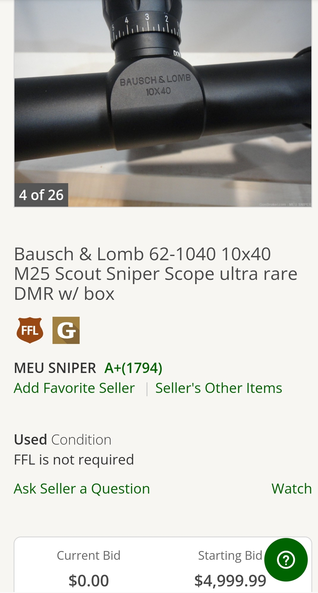

I just saw this auction for a DMR M25 scope, super rarity B&L 10X optic. The 10TH Special Forces developed that rifle for the Army. That reminded me I was coined by one of the hide regulars, a 10thSF Major (Ret.), @buffalowinter. So have to be a show-off, and post the goods. Thanks sir!
To put it into perspective, Unertl USMC 10X scopes sell for less than half of this auction

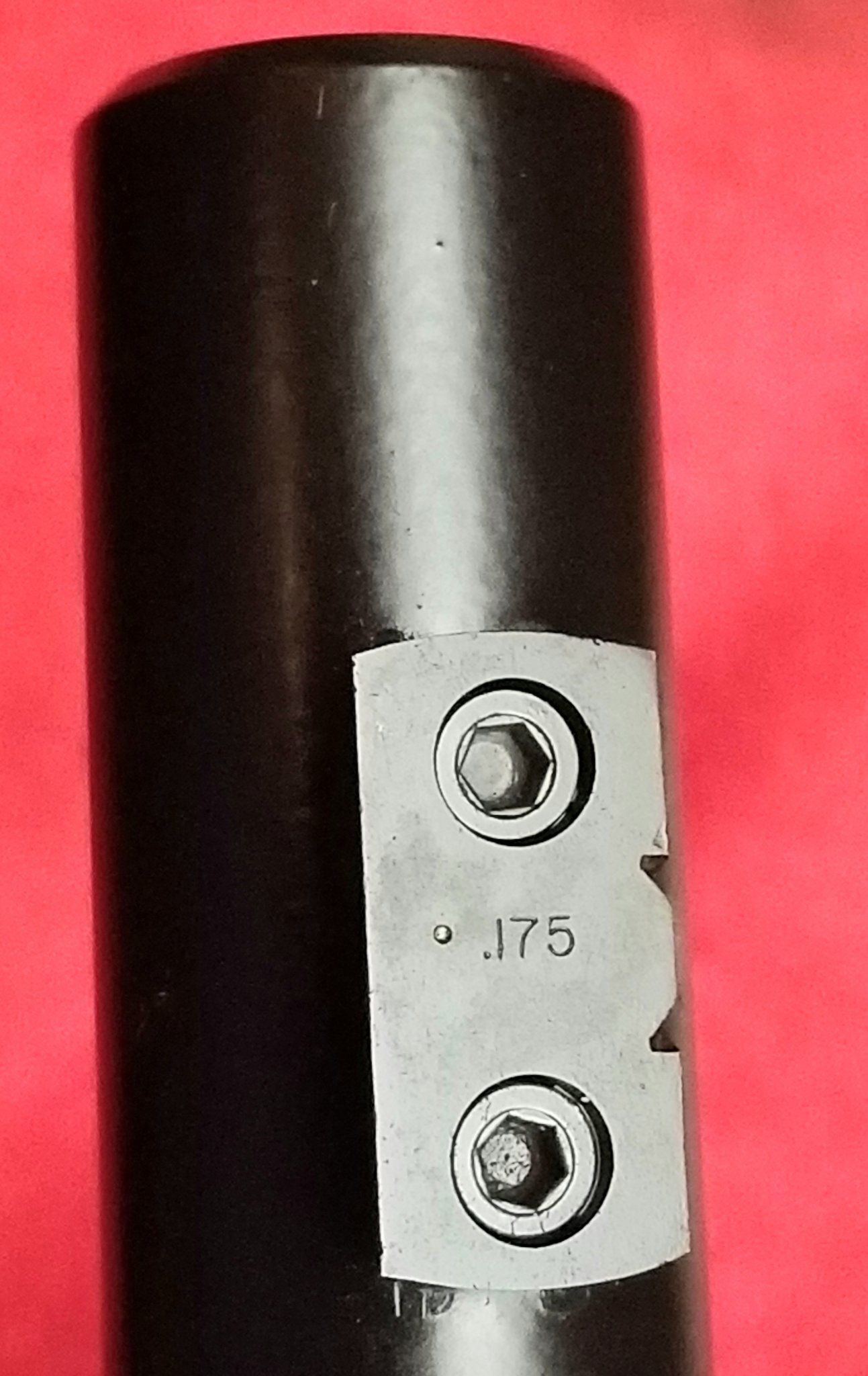

A differently marked front base, .175
This appears to be an original Redfield produced item, but not certain.

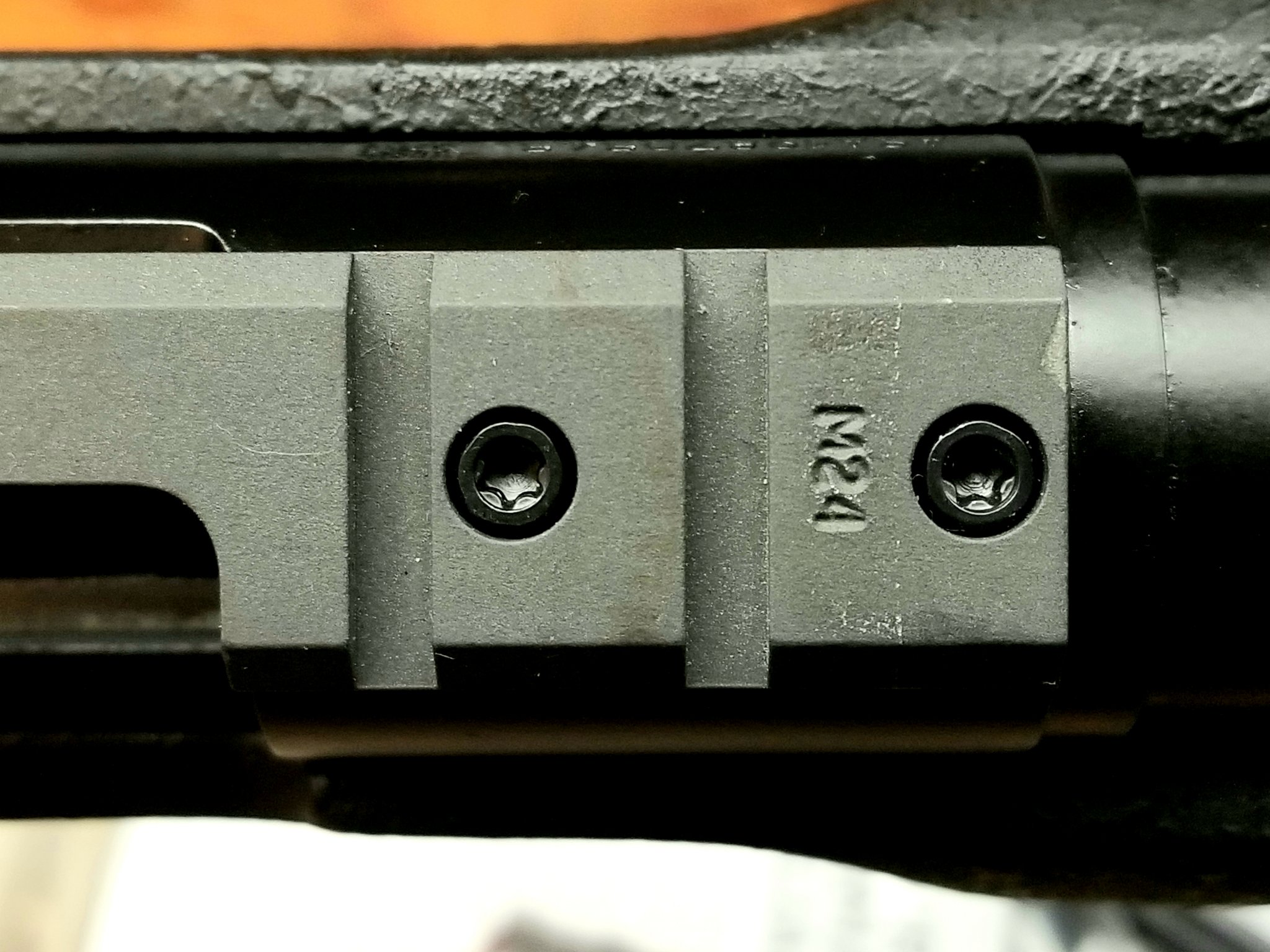

Badger Ordnance 1-piece LA scope base stamped "M24" on front pad.

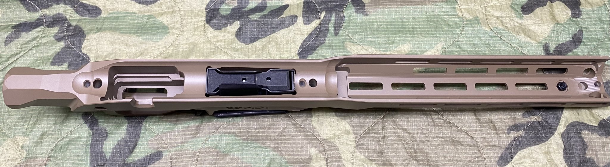

Oh nice! I would be down for one and I know at least 1 other person. @kft101
Yup, I’d be down for one or two of these chassis kits if we can get a run going. But looks like someone has to have the will and bank account to fund an order of 50 first, from the sounds of it. To quite Bob Dylan, “It ain’t me babe” 😂

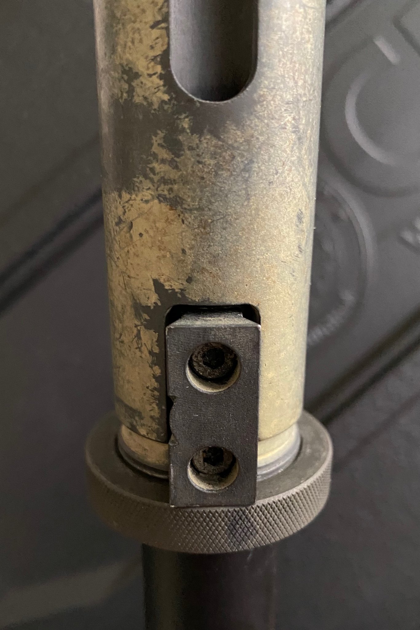

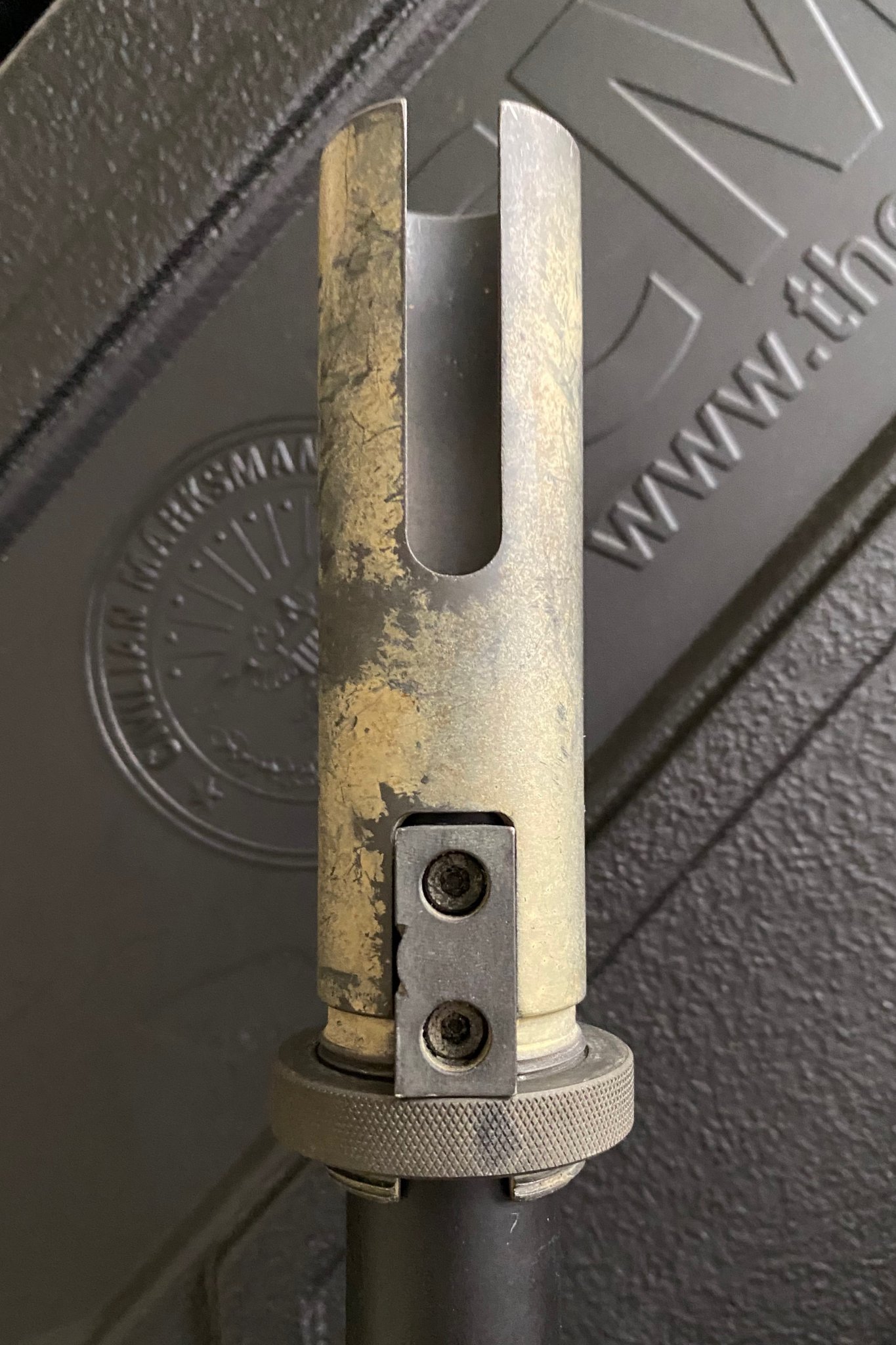

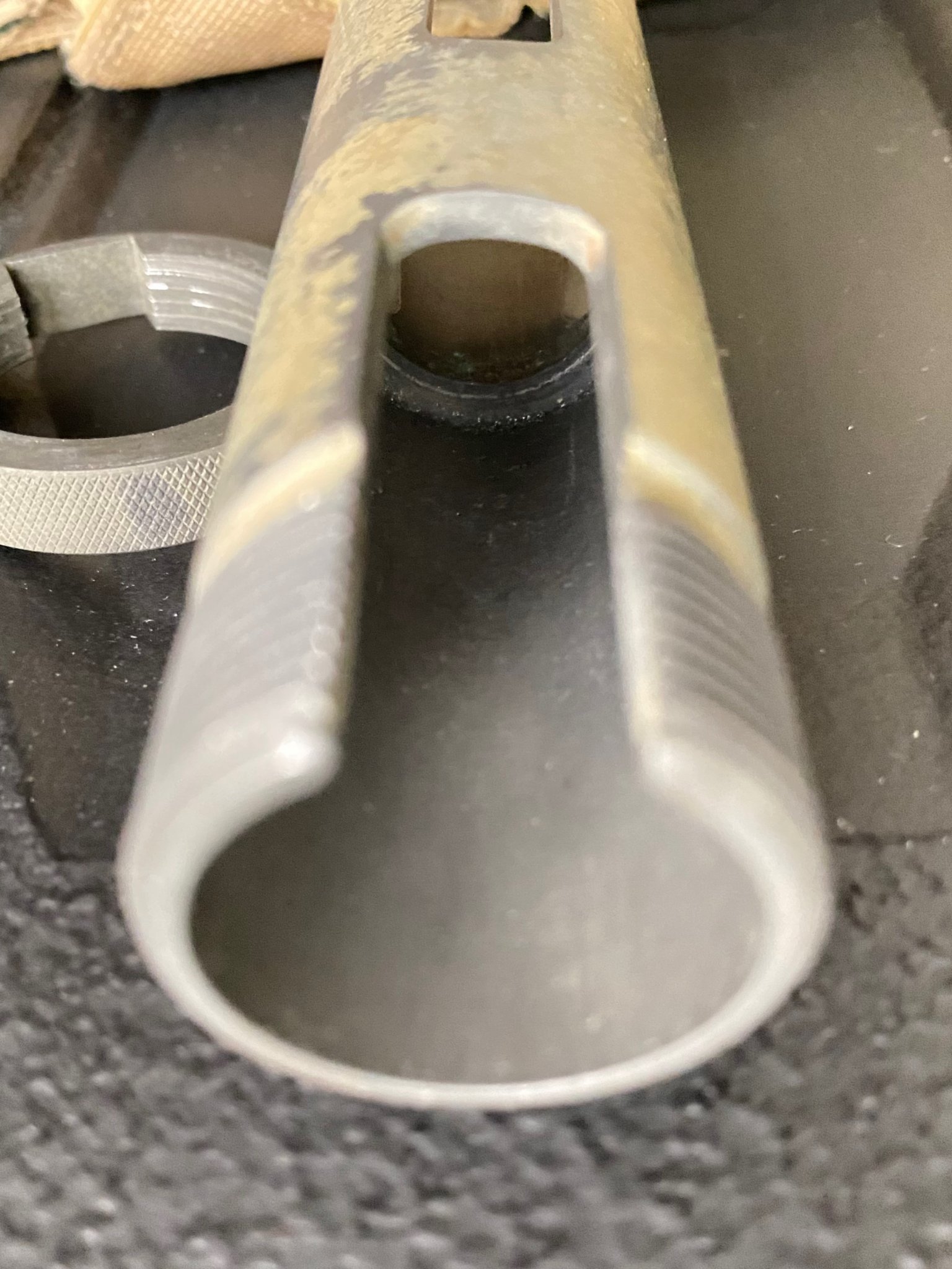

Makes you wonder what design they would have gone for if the muzzles could easily have been threaded on all the existing inventory.

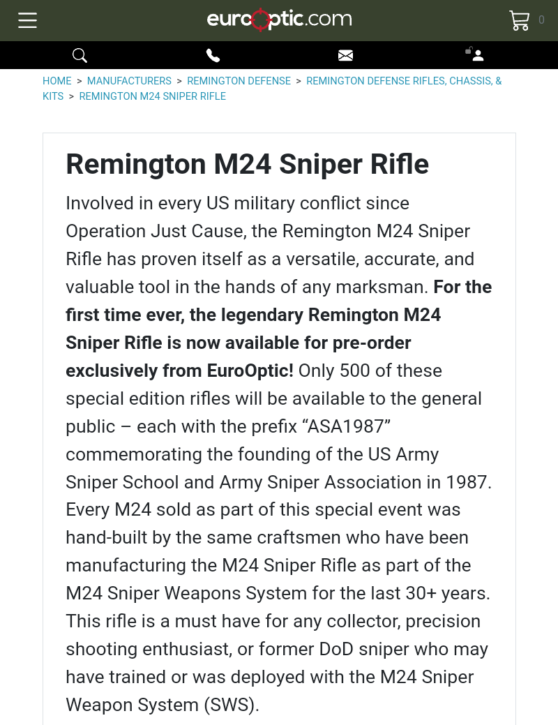

The EuroOptic M24 Limited Edition rifle hasn't been discussed in much detail. Having recently acquired one from a Hide member, want to go over the specifics.
These were a joint collaboration between EuroOptic, Remington Defense, and the Army Sniper Association. 500 rifles produced. Serial number prefix is ASA1987 to commemorate the year of founding for both the US Army Sniper School & the Army Sniper Association (www.armysniperassociation.org). Initial delivery date was September 2019. $100 from every rifle sold was donated to the A.S.A. Congrats to EuroOptic for putting this deal together

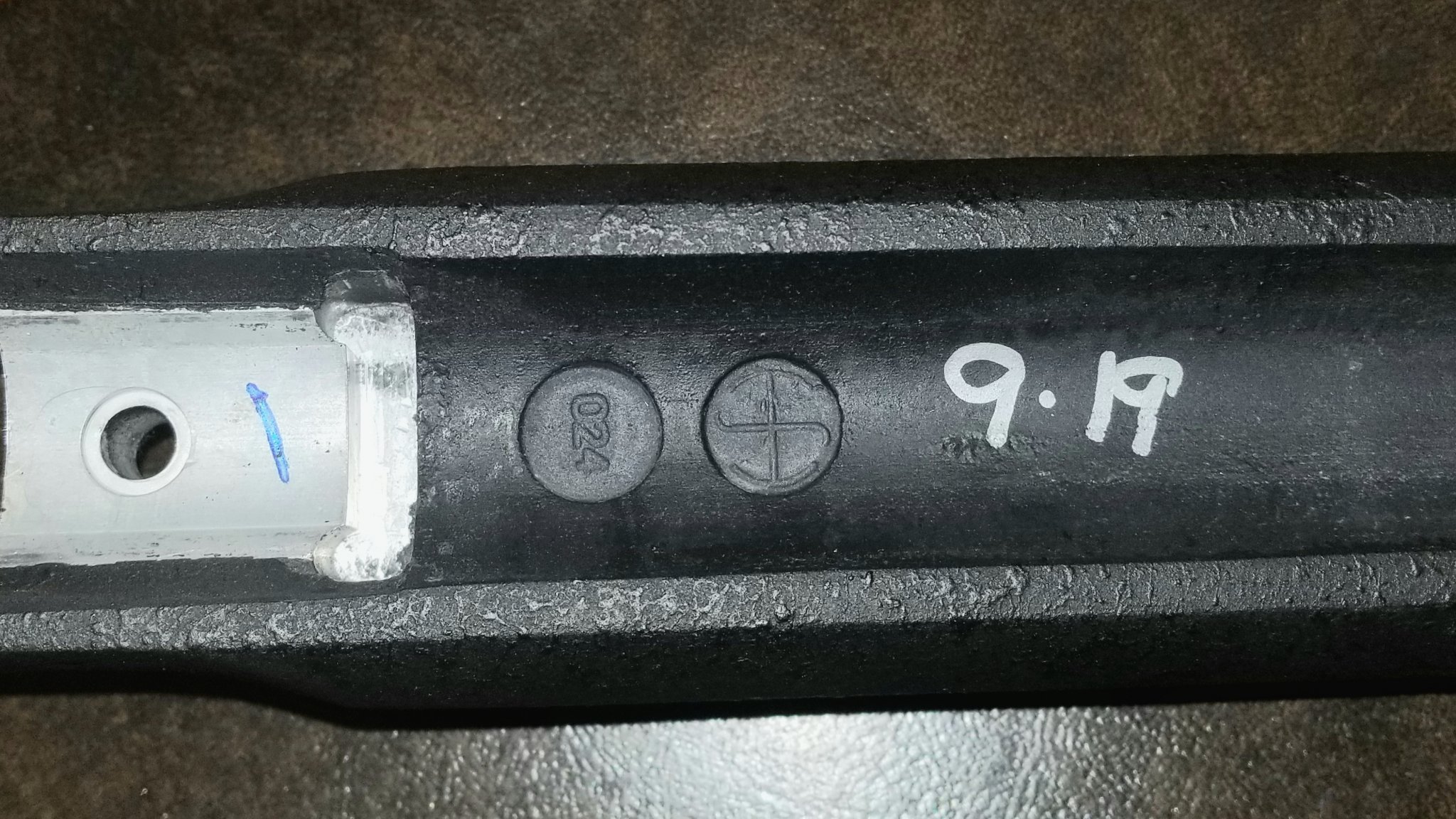

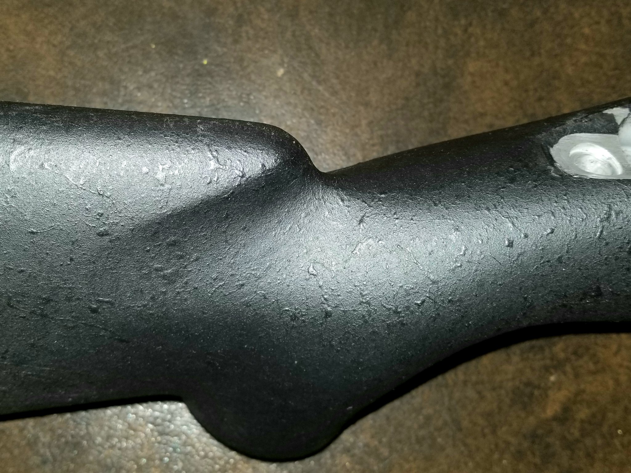

The H&S Precision stock is their latest version -024. Mine is hand dated 9-19

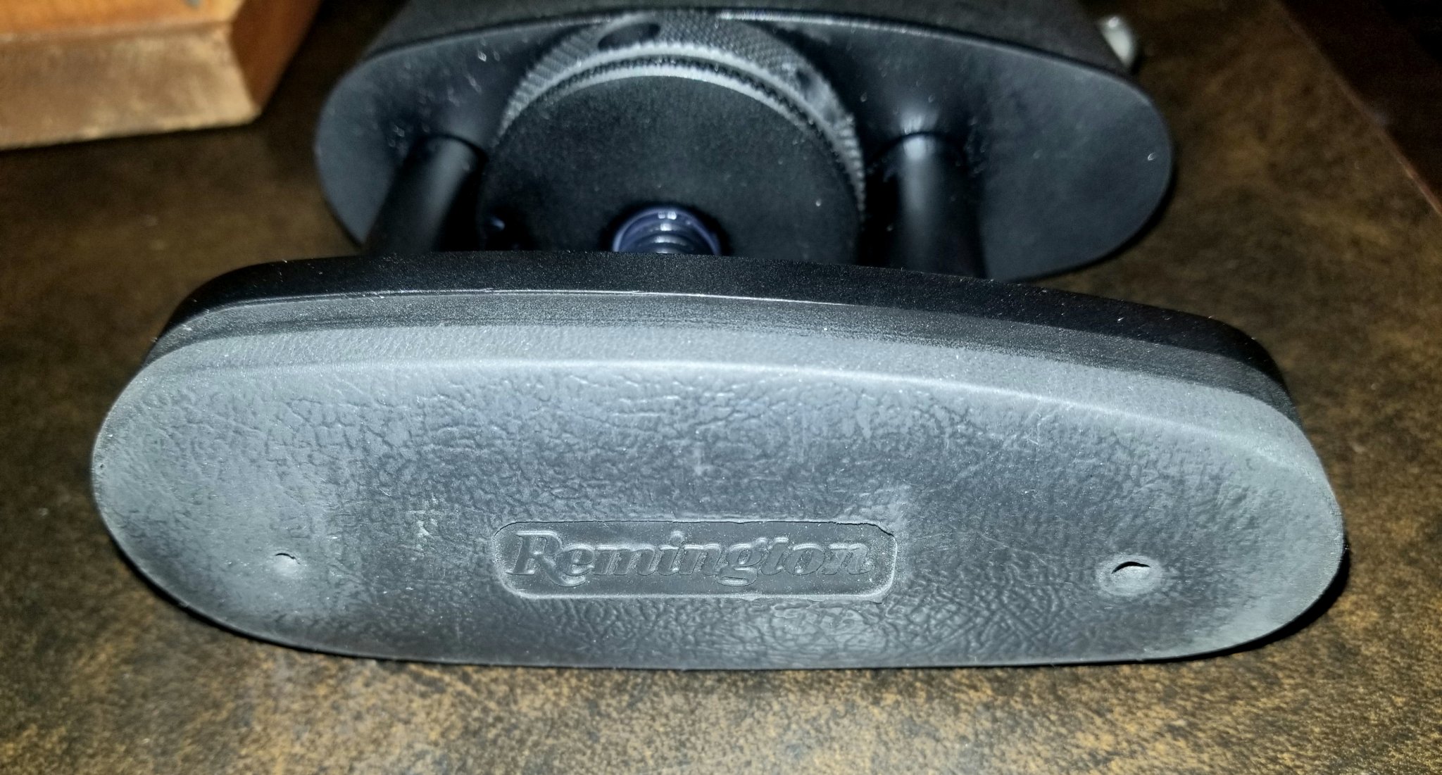

These do not include the comb clearance area of original issued stocks. The stock coating is a textured finish, different from earlier issued versions that were smoother. Large Remington logo buttpad.

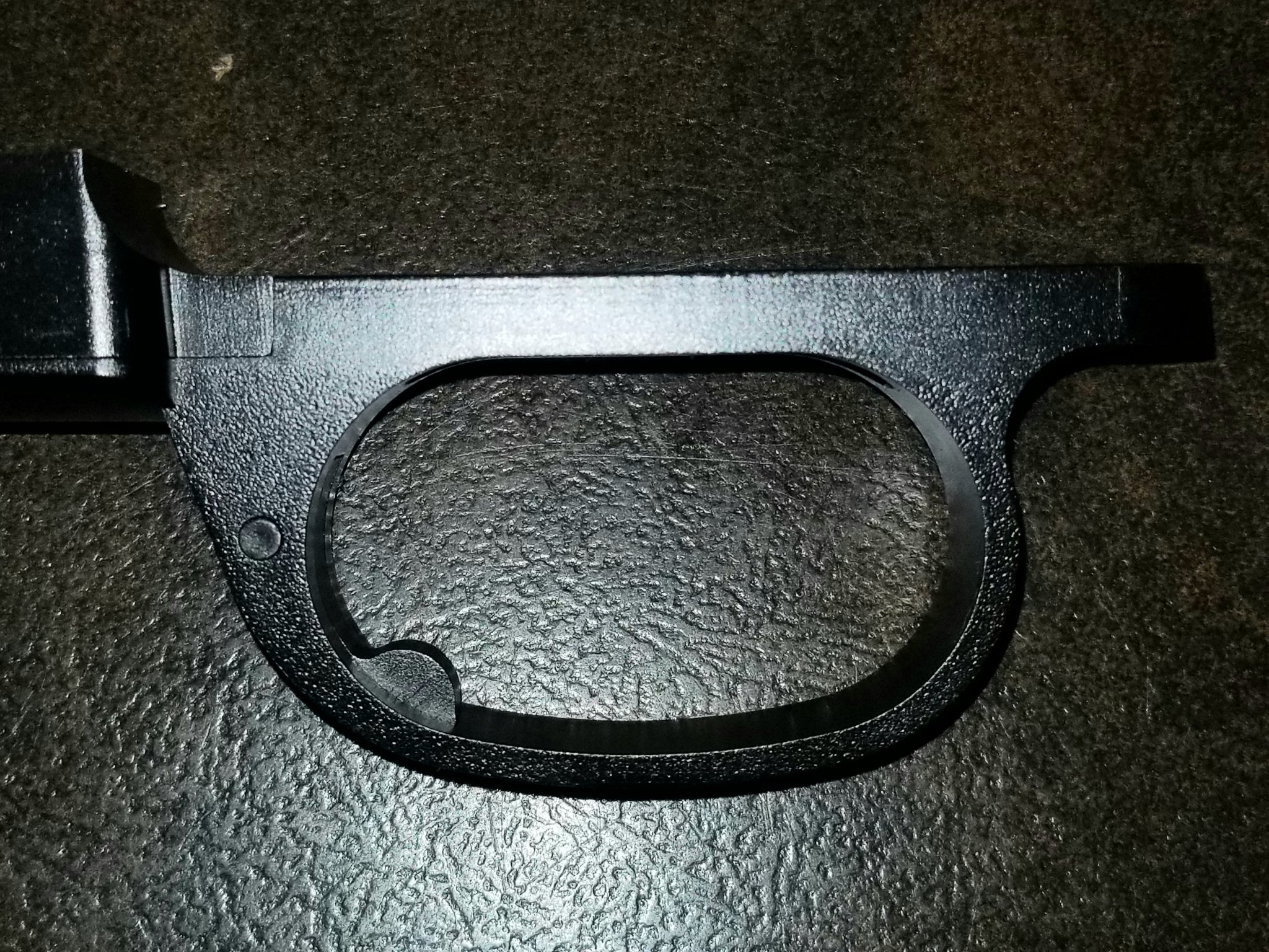

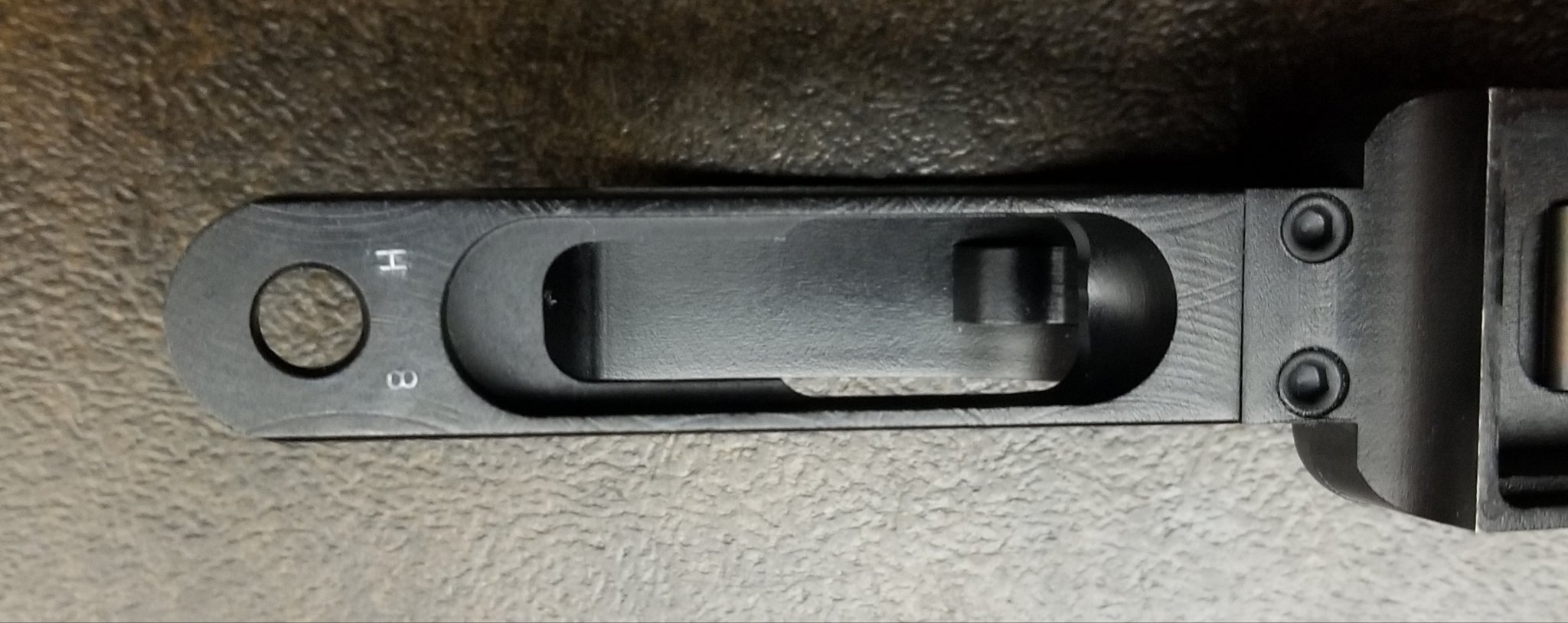

The trigger guard assembly is the 2-piece design bolted together with 2 allen screws. It does not display a Magnaflux proofmark. Stamped id appears the be SH (Sunny Hill), but possibly HS (H&S Precision), or even H8.

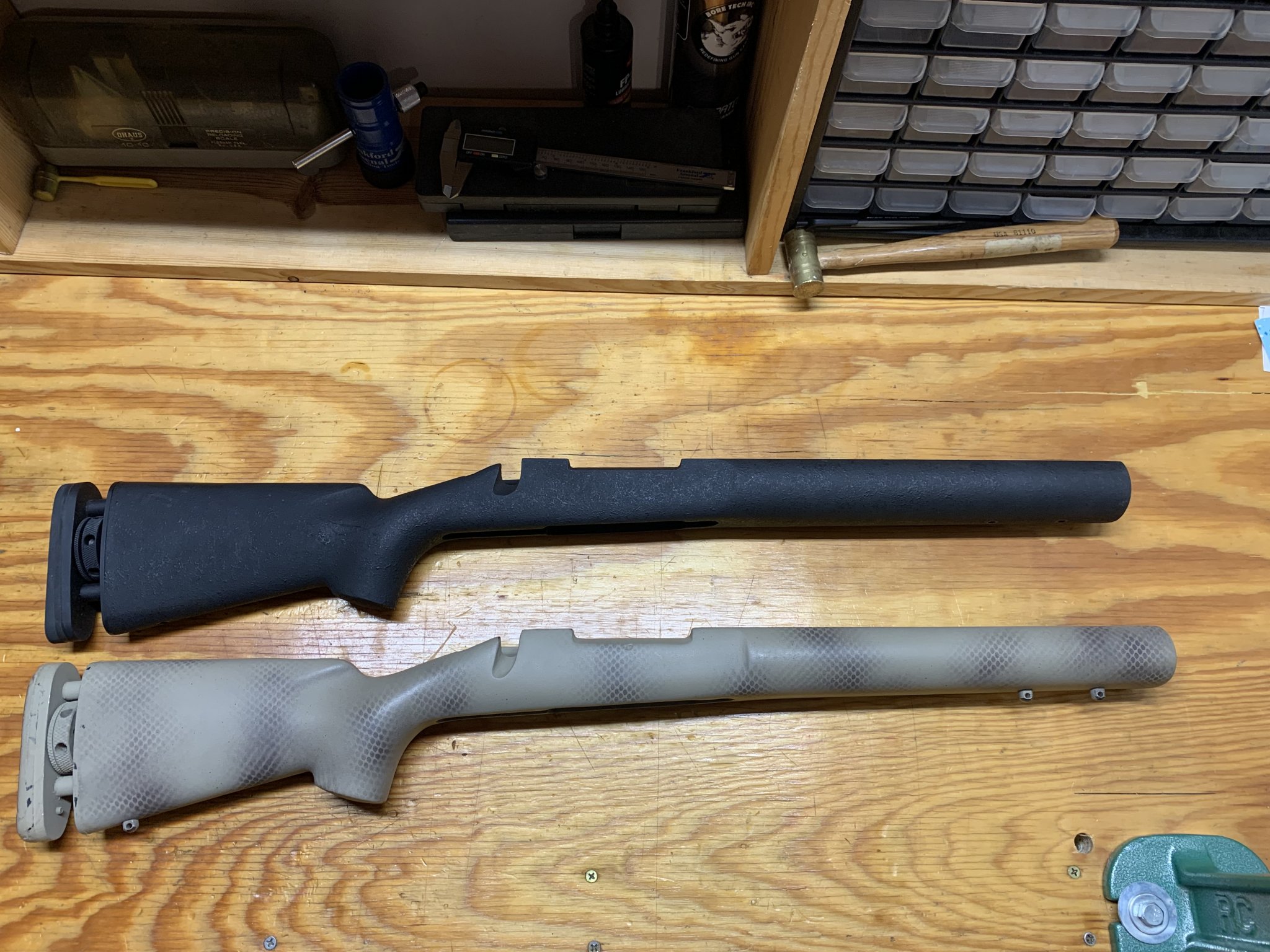

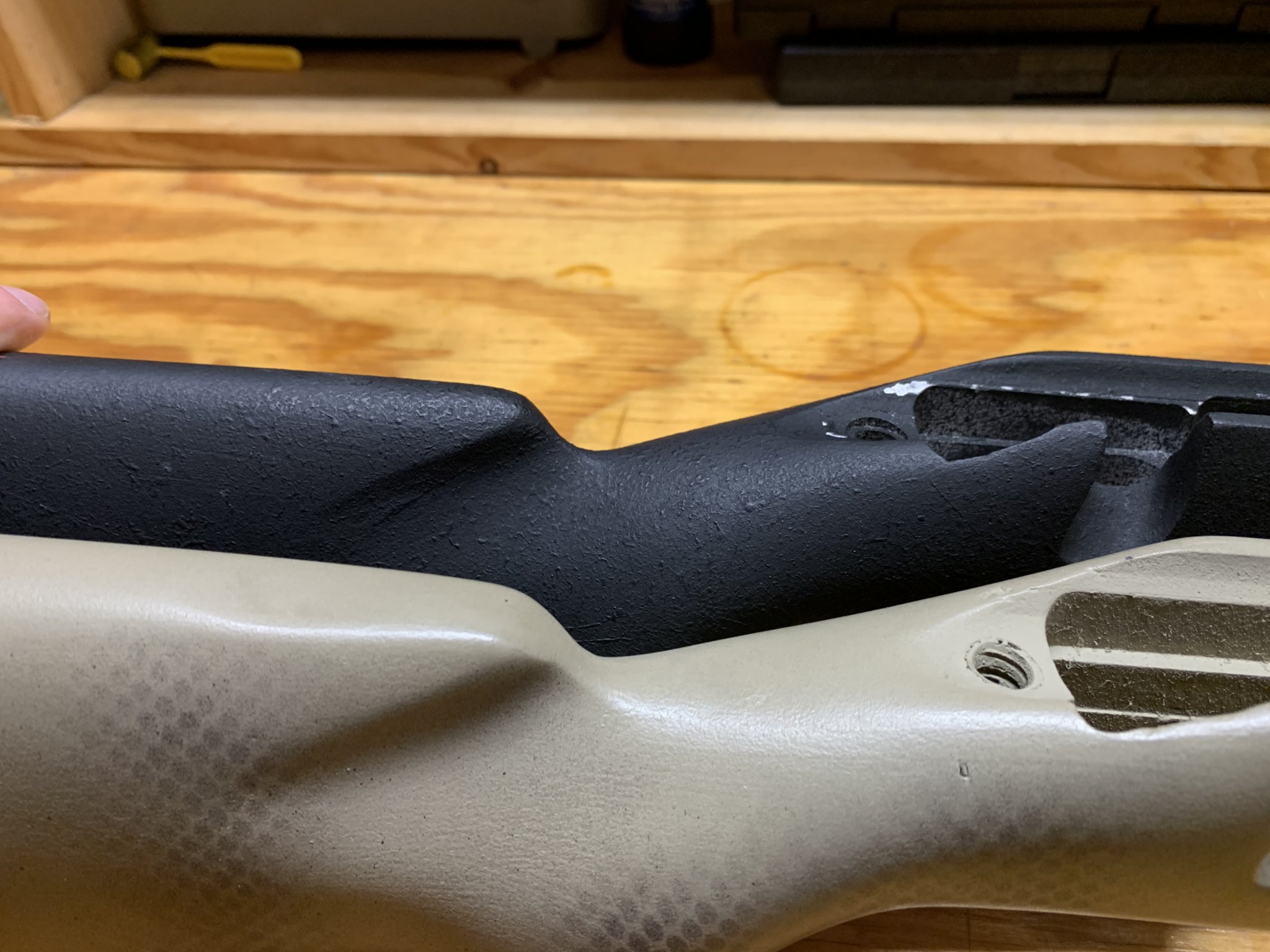

Just to show the difference between an early stock and the later produced m24 stock

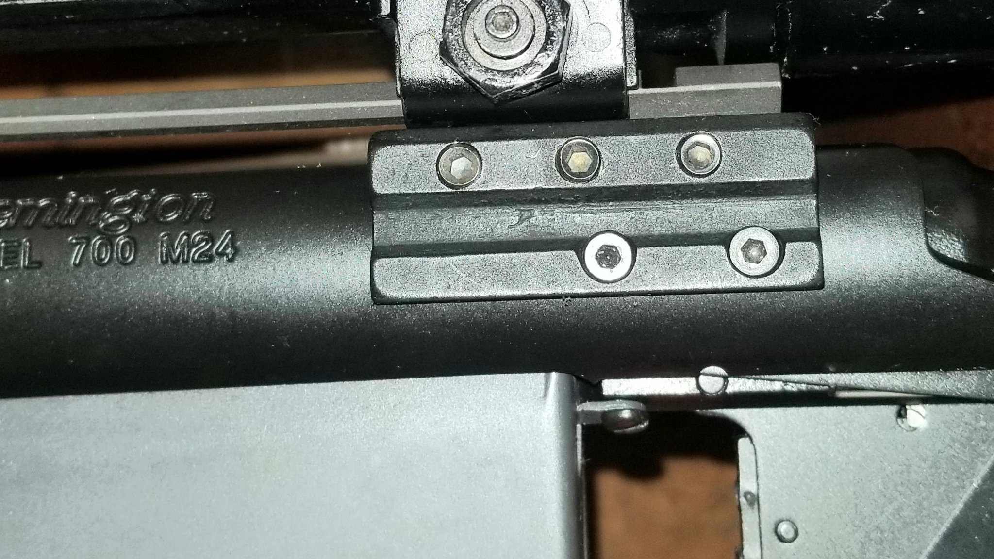

The earliest released rifles did not include the Leupold Mark 4 2-piece scope bases. EuroOptic said they would provide them to the purchasers. Im not sure how that worked out, but mine came with the Badger Ordnance M24 1-piece 0° cant mount. They also did not include the rear sight base, but were drilled/tapped and had filler screws. Mine was upgraded by prior owner with an original Remington WB-490 base.

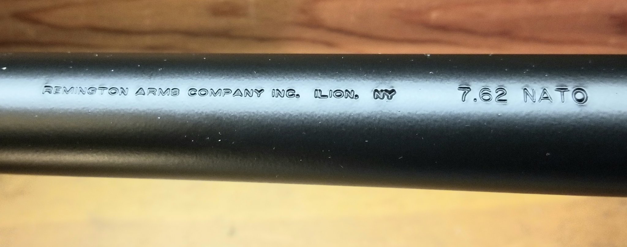

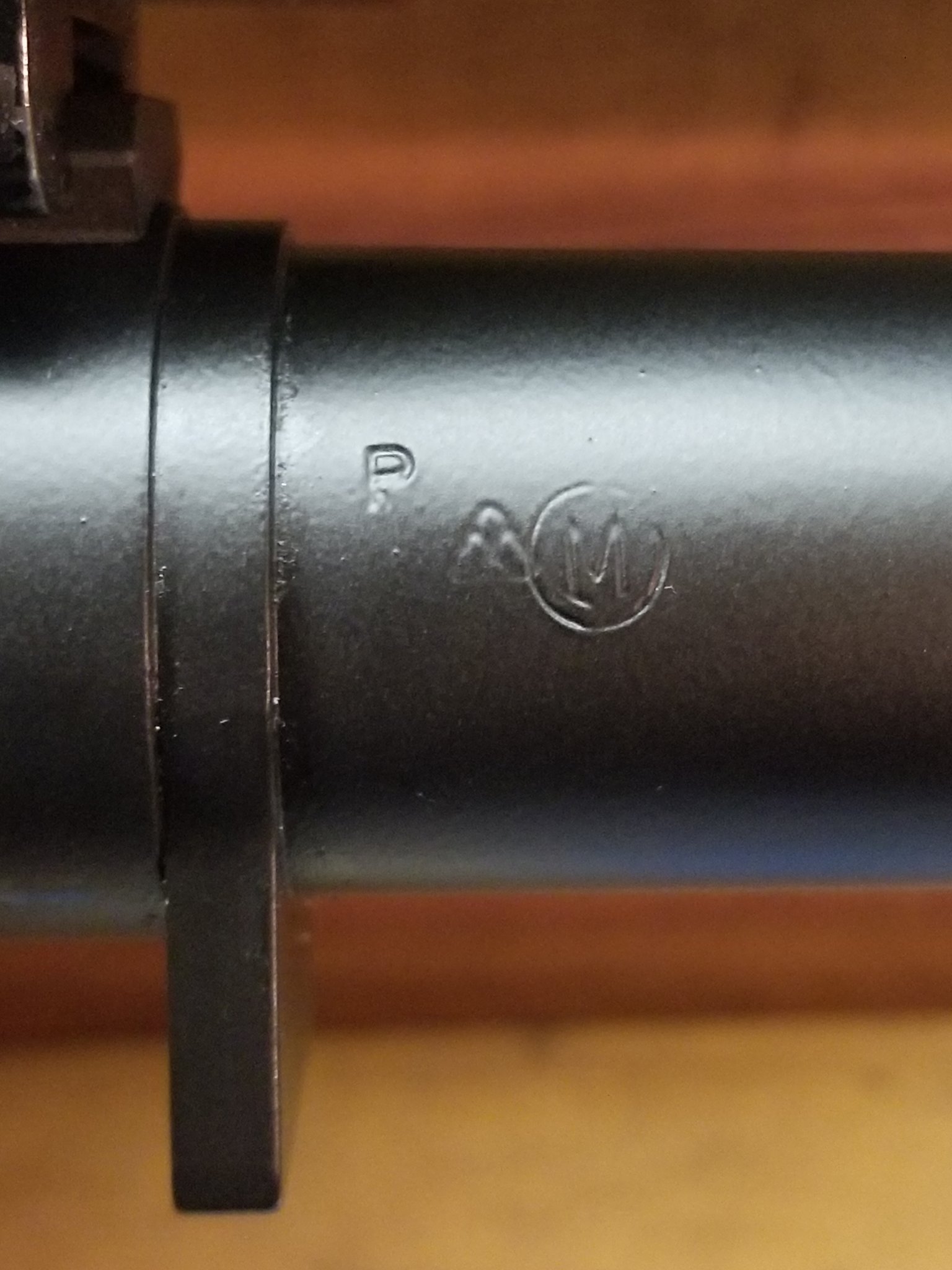

Barrel marking includes Remington full address which is an ATF requirement for civilian rifles, and the 7.62 NATO chamber. US Army issue only have caliber stamp.

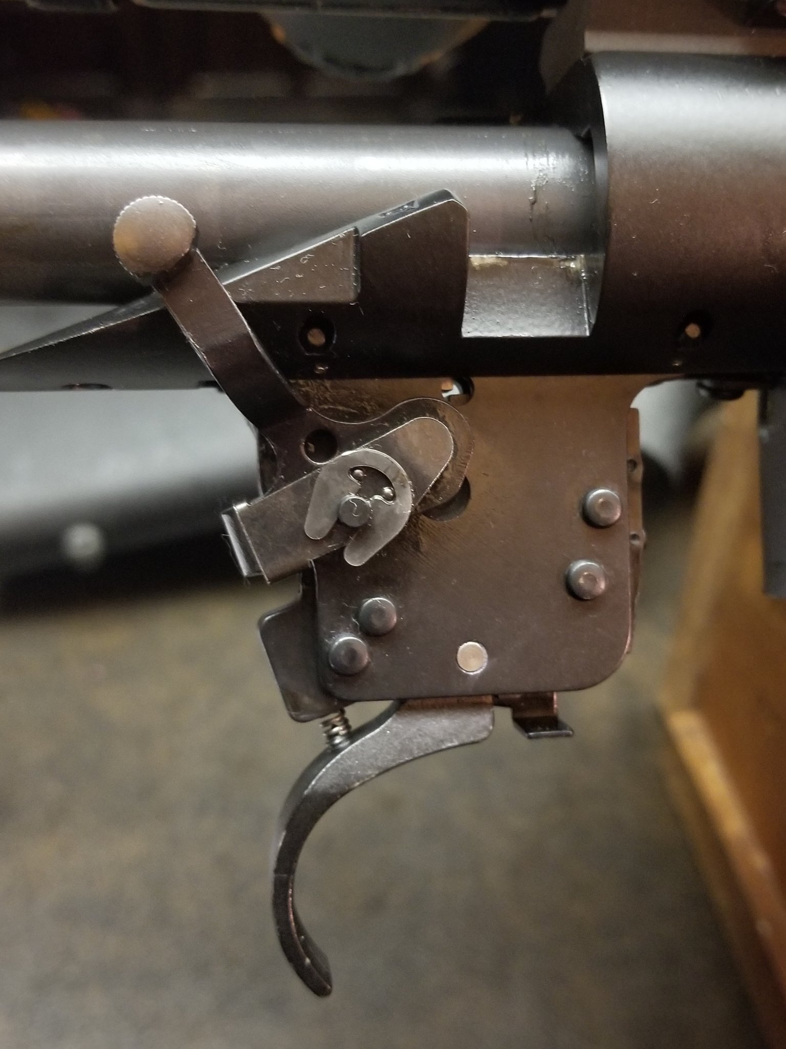

Trigger is the factory built M24 pattern with adjustment screw on trigger face. This one has no marking stamps. Prior posts have shown some variations of trigger markings on original issued units. These are pre-set at Remington to meet Army specs. Anyone familiar with the Walker designed Rem700 trigger knows they can be fine tuned to better performance by tweaking the sealed adjustment screws. But the M24 isnt allowed to be fiddled with

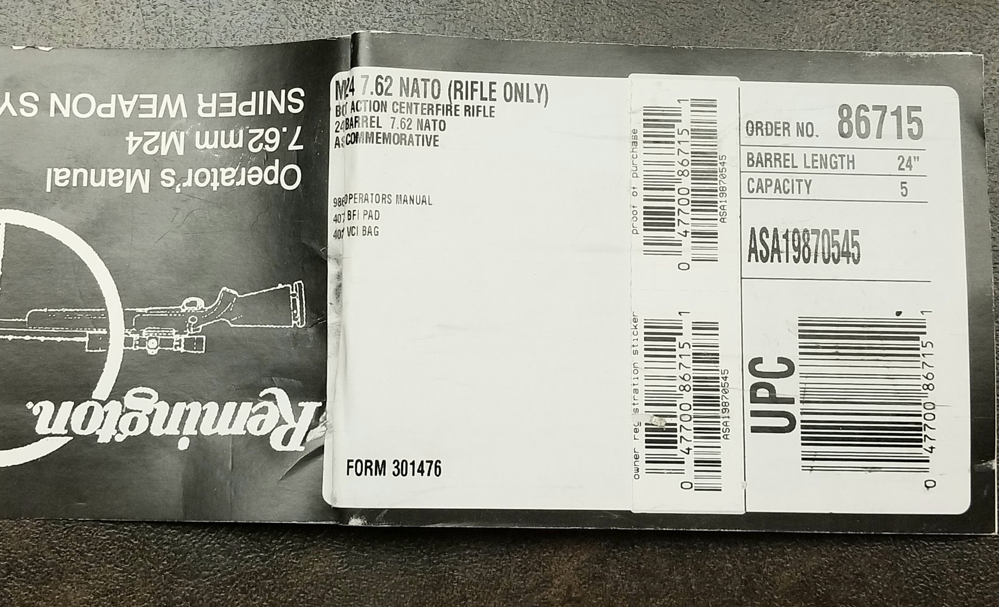

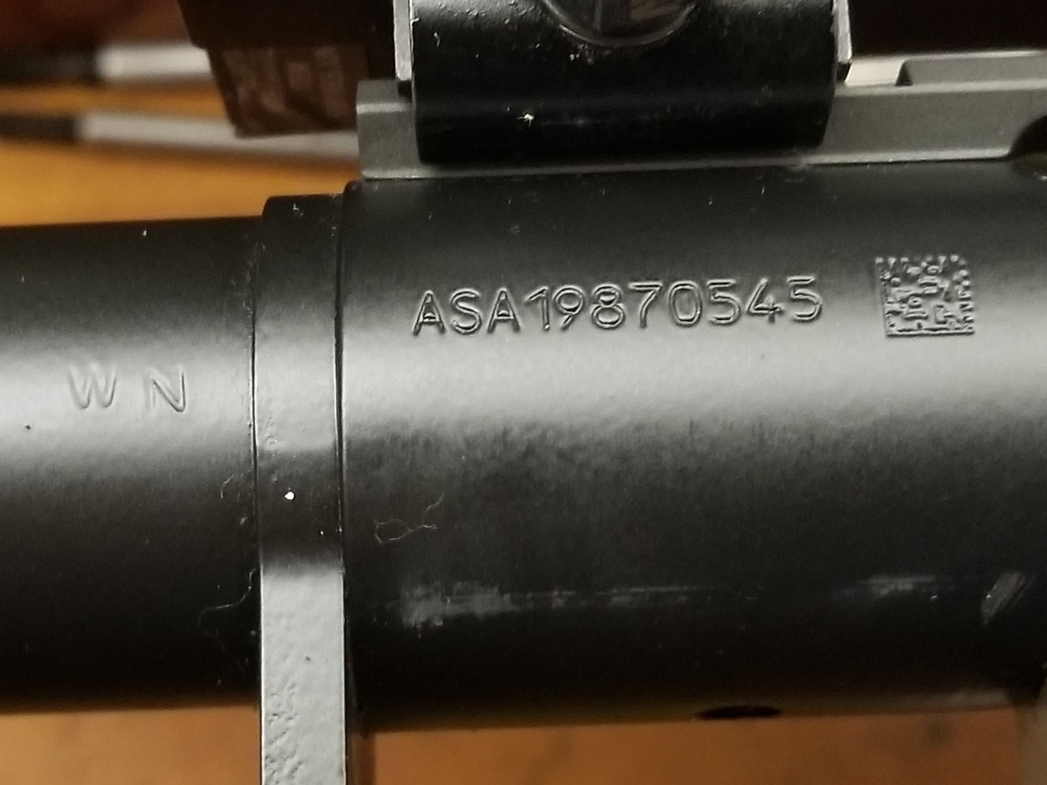

Serial # is 0545 that seems to indicate it was beyond the 500 range of the EuroOptic 500 units. Not sure of the exact starting number for this run. Interested if anybody has #'s over 500. Some of the other proofs are shown. "WN" barrel stamp indicates W=August/N=2019 assembly month. Bolt & Barrel both have Magnaflux proofs.

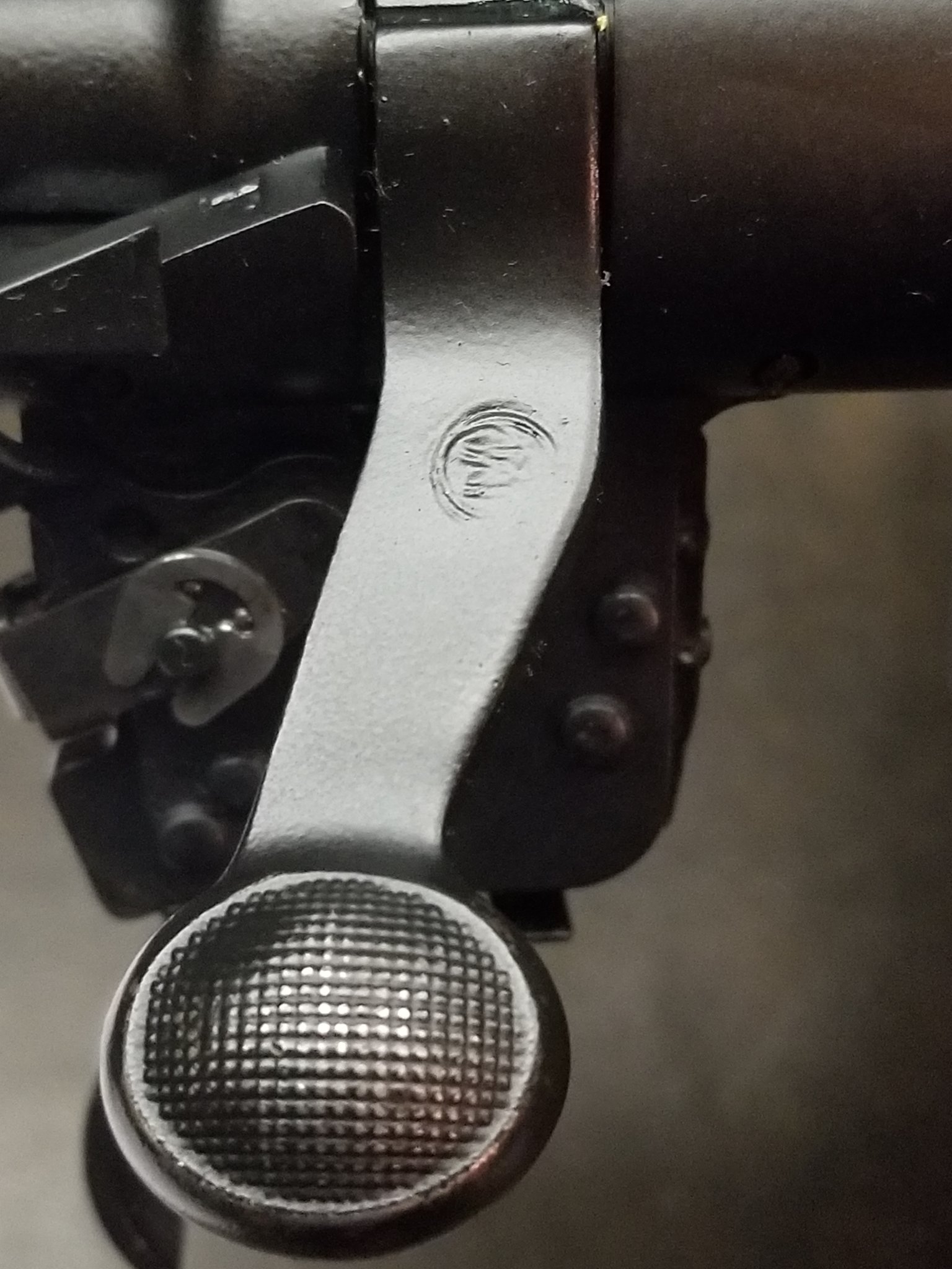

I have not yet measured the chamber dimensions for reloading purposes. Bolt lug wear looks very good after prior owner firing 900 rounds. The firing pin/collar had a few machining marks that needed polishing out. The floorplate hangs up slightly when closing, and its hinge pin fell out while reassembling since it isnt staked in place. The trigger crosspins were heavily staked in place that prevented removing it for cleaning. Flushing it out with lighter fluid to clean it produced lots of graphite powder residue. Torqing the stock bolts to 65i/p produced a decent pull weight. It's my personal opinion these rifles were not assembled to the same exacting standards as military issued rifles. Your results may differ. Regardless, its the last of the Mohicans manufactured from Remington Defense. I envision collectors 30 or more years from now finding this thread to source details about the rifles. Feel free to add any other info you want. It may be important to mention the EuroOptic rifles are called Limited Edition (ASA Commemorative) And the Remington reissued rifles are known as Collectors Edition.

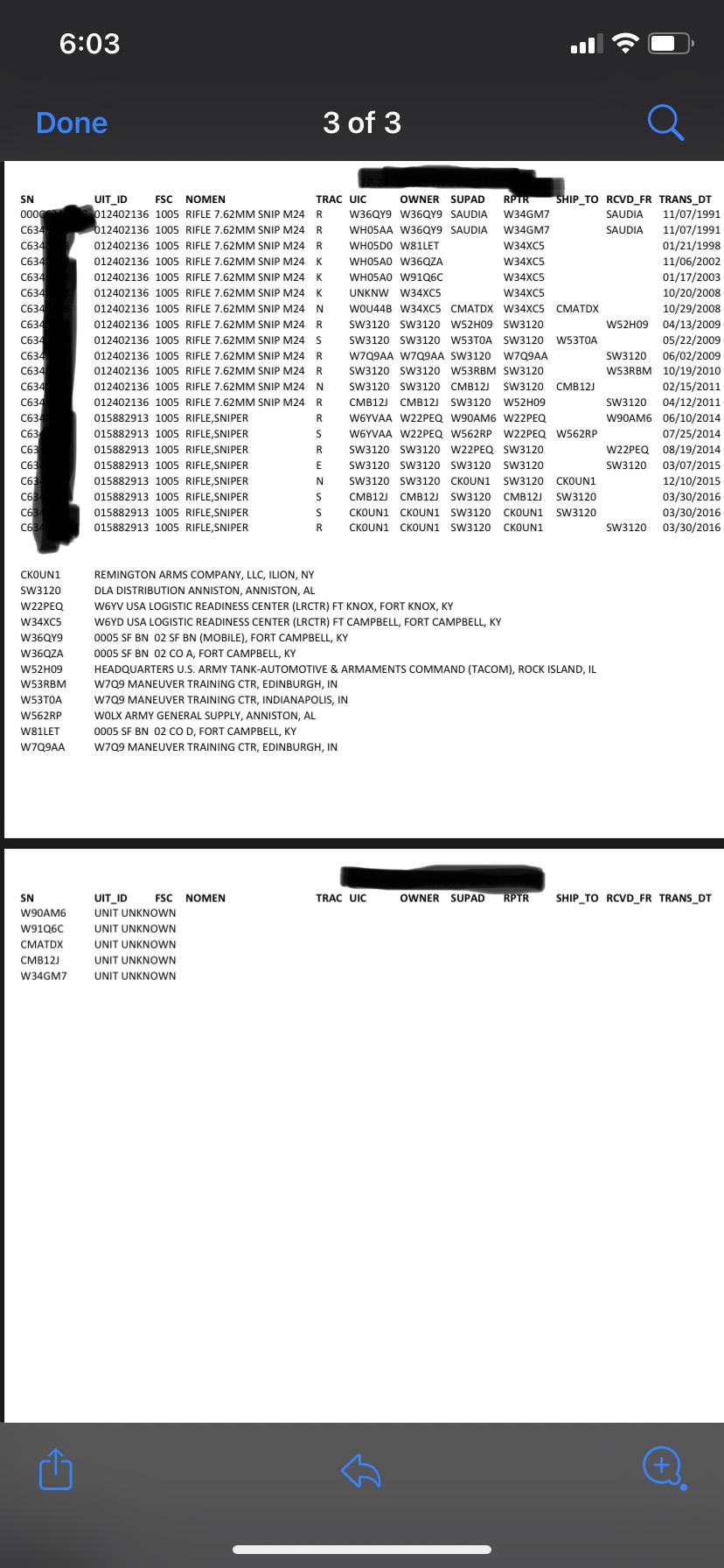

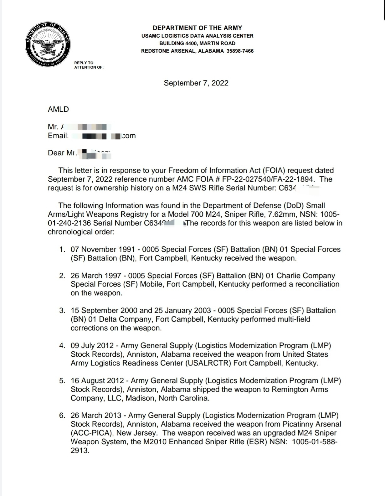

Did this receiver go through 3 different model rebuilds?
It's hard to tell exactly when it was rebuilt, some FOIA's are more specific on that. It started as an M24 based on the date, and I would say it's last configuration was an XM2010/M2010 based on the plugged rear sight holes and the adhesive residue from the tag. I think the "reconcilliations" are just inventory checks in between issues to the various units.
Reactions: lockedandloaded
Had to look it up, served with 5th SFG Airborne. They deployed everywhere in 2016...Mexico, Jordan, Syria, Iraq. It's seen some shit. Totally amazing this information is available!

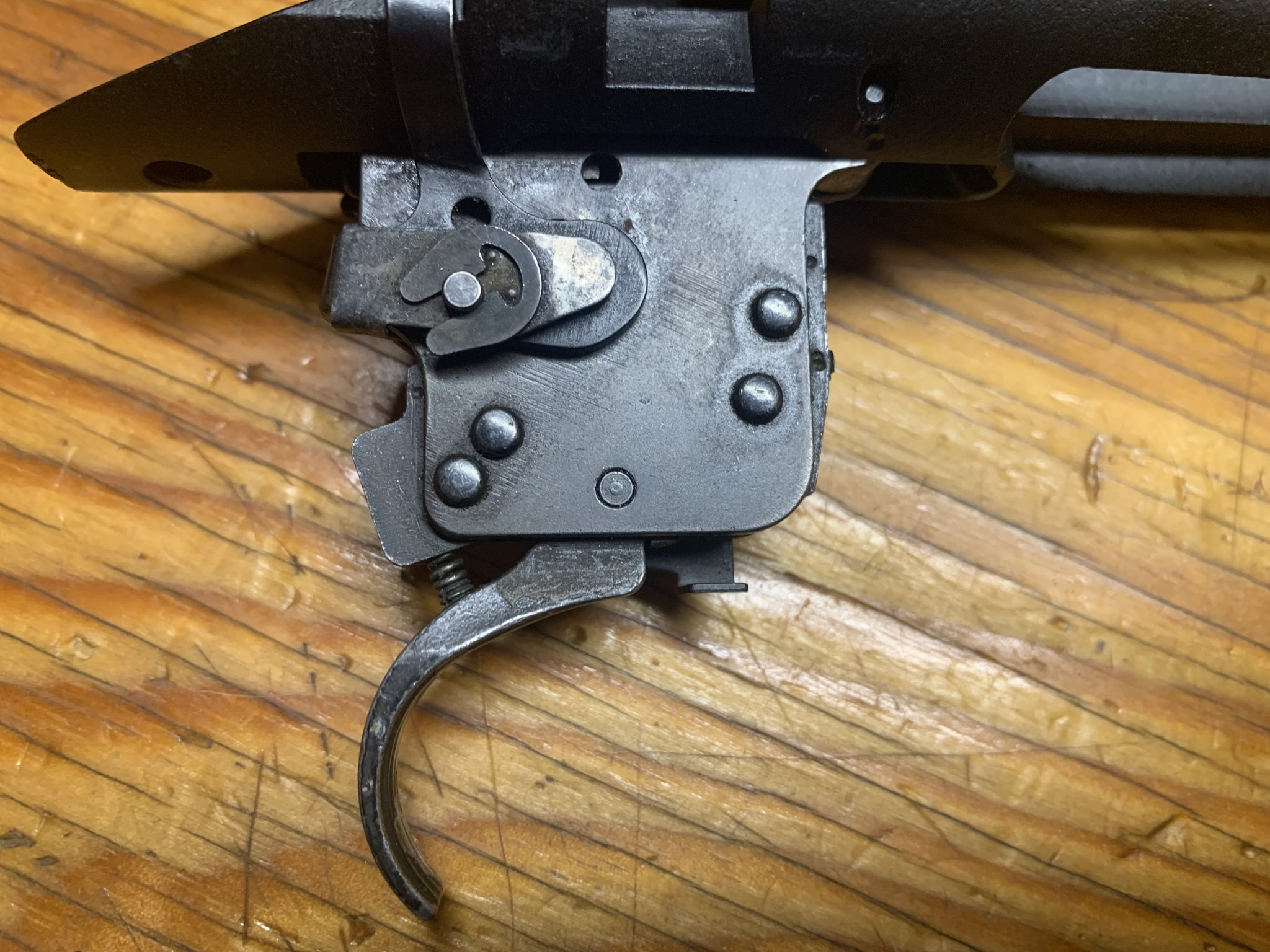

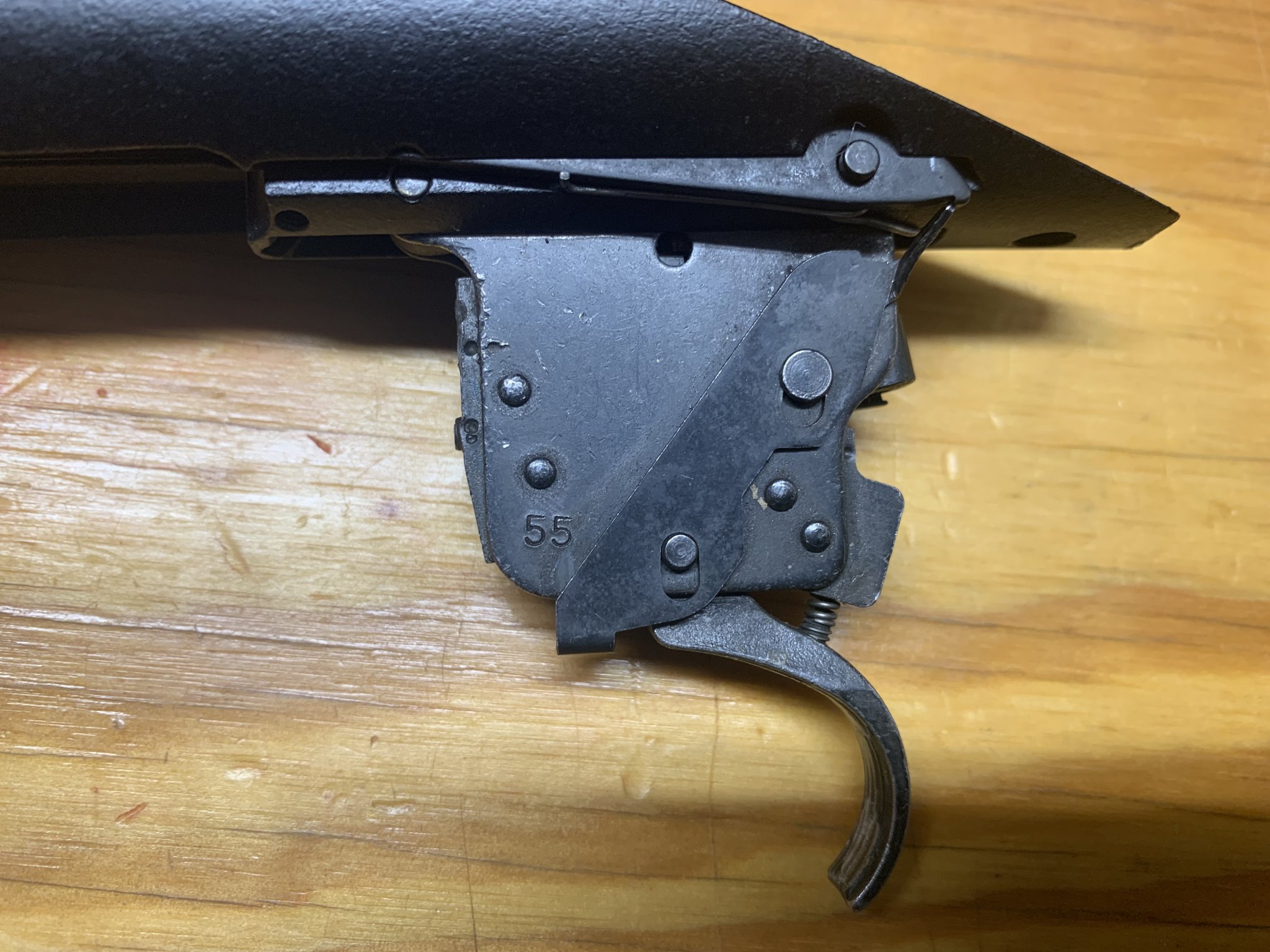

Here’s my example of an issued m24 trigger. The only stampings on it is the number “55” whatever that means.
One of those details lost after the bankruptcy we may never know. I live a few hours away from Ilion, NY. I'd like to go there someday to meet the men & women who worked in the M24 gallery. Ask a few questions, gain some insight, maybe write a magazine article. I know there were some direct sales to current employees at the time. One was a US Army Sniper School leased M24 with supporting paperwork that was later auctioned for serious money. Ive been hounding that rifle for a year or so to get more info. Who knows what else might be laying around in that historical town? Ive worked in a manufacturing plant before, and tool & die makers usually retire with their gauges and handmade jigs. Bet a weekend scouring garage sales would turn up a shitload of Brown & Sharp or Starrett tools stamped with the Remington logo. Doubt I'm the first person to consider that. They're also probably still pissed off by how Remington shafted them out of their severance pay & pension, that they wouldn't speak with me.
That is the thing with these FOIA's. It's very unlikely that this M24 sat in storage at Fort Campbell from 2012-2016 when issued to the 5th SFG. The same is true of its earlier locations.
Here’s one of my early US marked m24’s. The new format they use for the FOIA is hard to translate but this one looks to have a few interesting dates.
