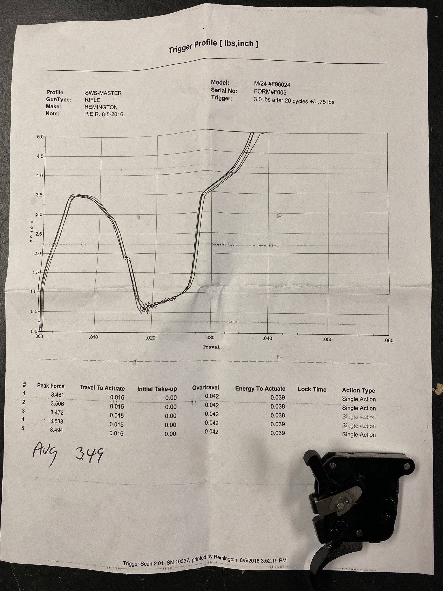

Imho, it's a long shot Remington could still manufacture the M24. The main reason is they shuttered the Ilion, NY factory a few months ago. All the employees were let go who worked there. This is the location they built the M24, and those workers were the reason this rifle was a superior build. The 2 main components of the rifle are the barrel, and the trigger group. Rem had a dozen hammer forges there that made the 5R barrels. No info if those forges were sold off in the auction, or moved to their new factory. Also, they had a very expensive trigger testing machine there that gauged the M24 trigger groups to Army specs. No idea if that is still around either. Other parts like recievers, stocks, bottom metal, scope bases, etc are still available. Prices for the original EuroOptics Limited Edition ASA Commemorative M24's are starting to climb well over the original price. And same for their earlier Collector Edition rifles built using Army take-off parts.

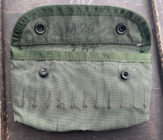

These ammo pouches have been advertised for years in Shotgun News and other sources. Anyone have info of they are actually made for M24 use?

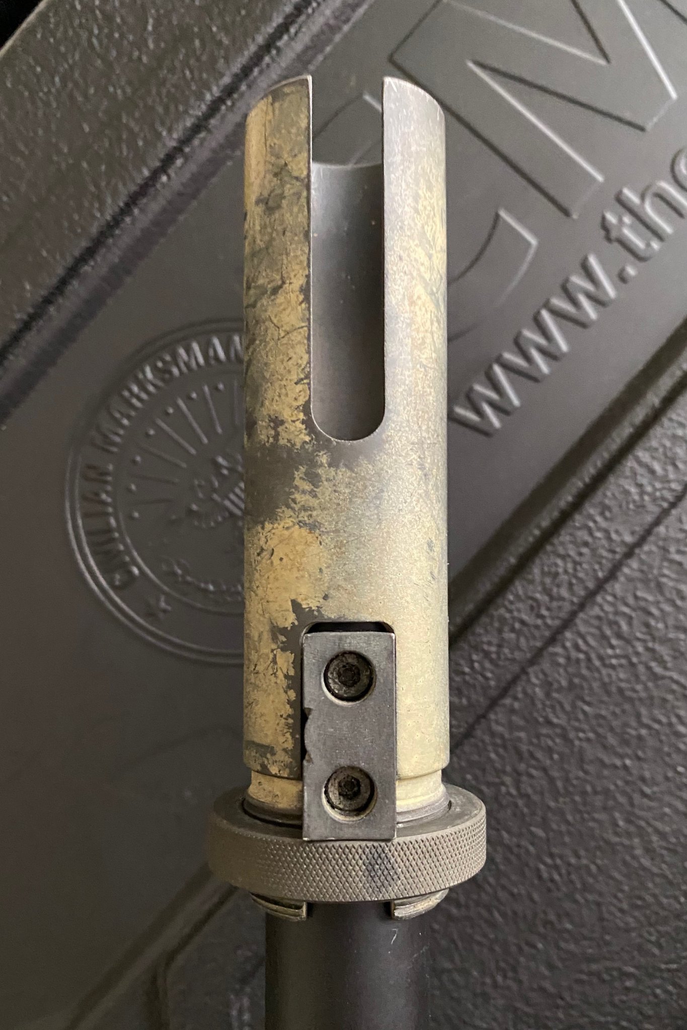

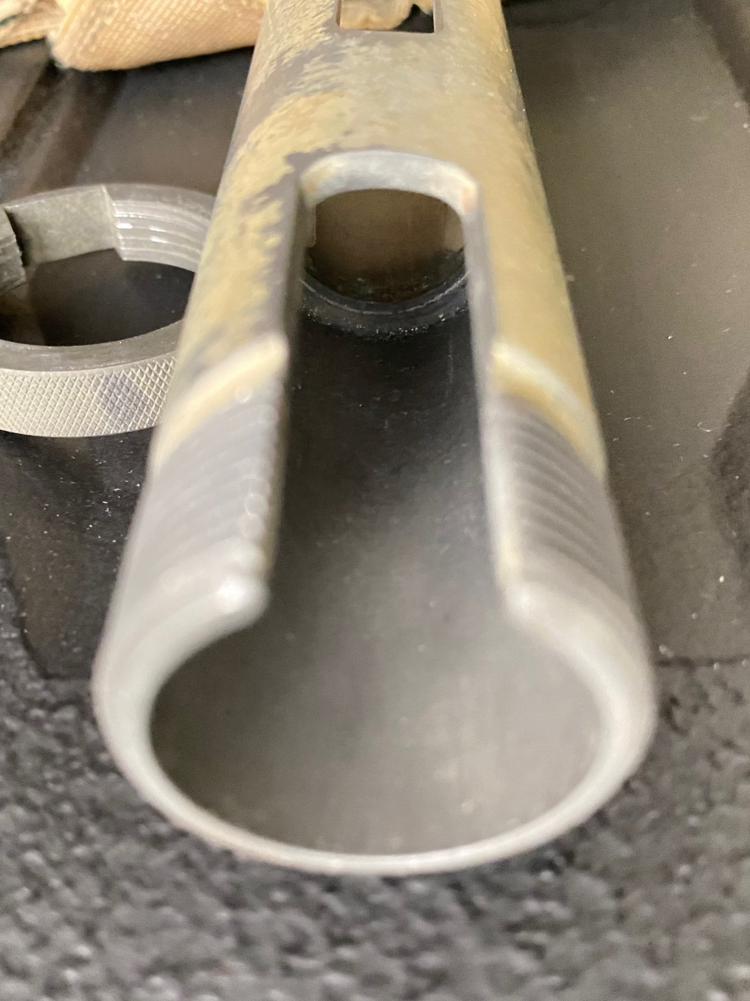

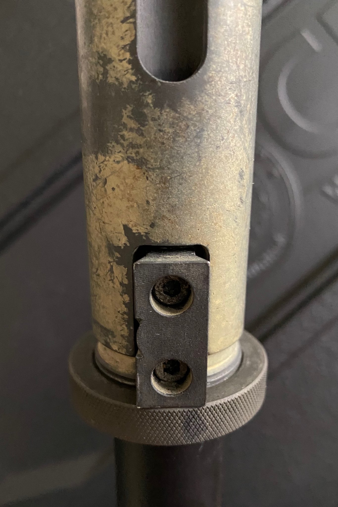

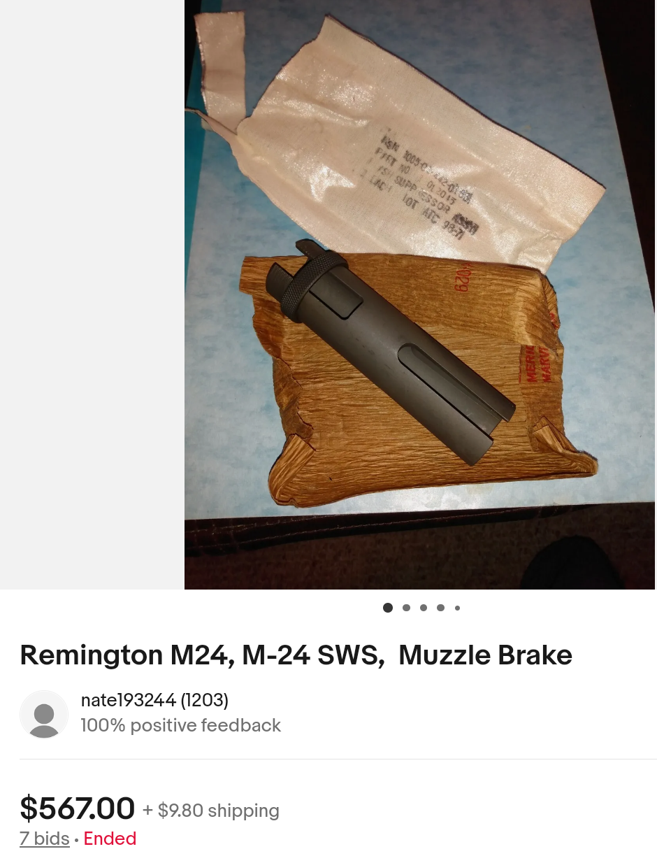

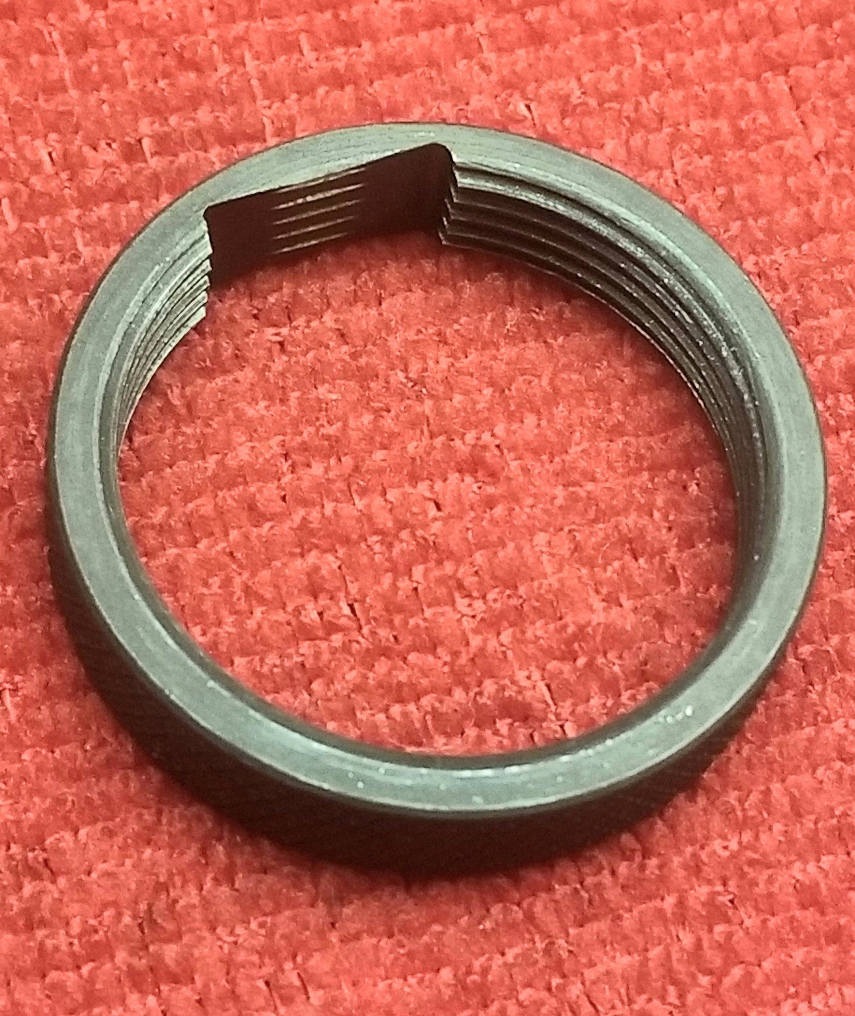

Also, a neat detail noticed by @lockedandloaded about the M24 flash hiders: there is a lip machined into the inside of them so when attached, the flash hider seats against the muzzle of the barrel at that lip, and so does not push on the front sight block.
View attachment 8332389View attachment 8332390View attachment 8332391

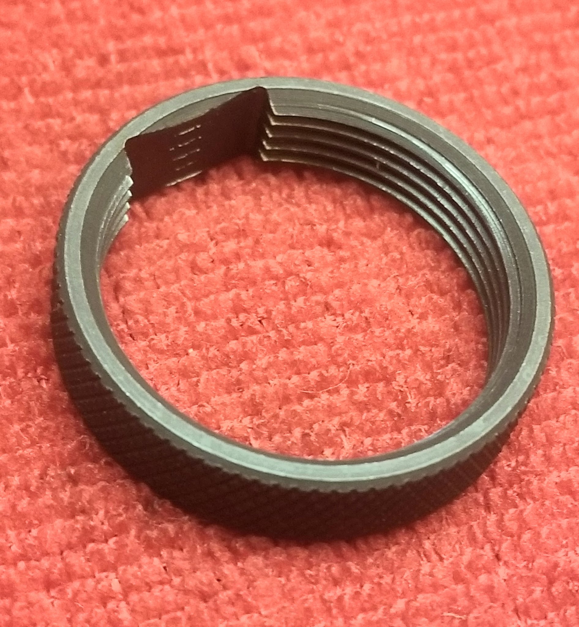

Found a detail I hadn't noticed before. The lockring has 2 different mating profiles on each side. One perfectly flat, the other is beveled. Not sure which side is supposed to contact the front sight base

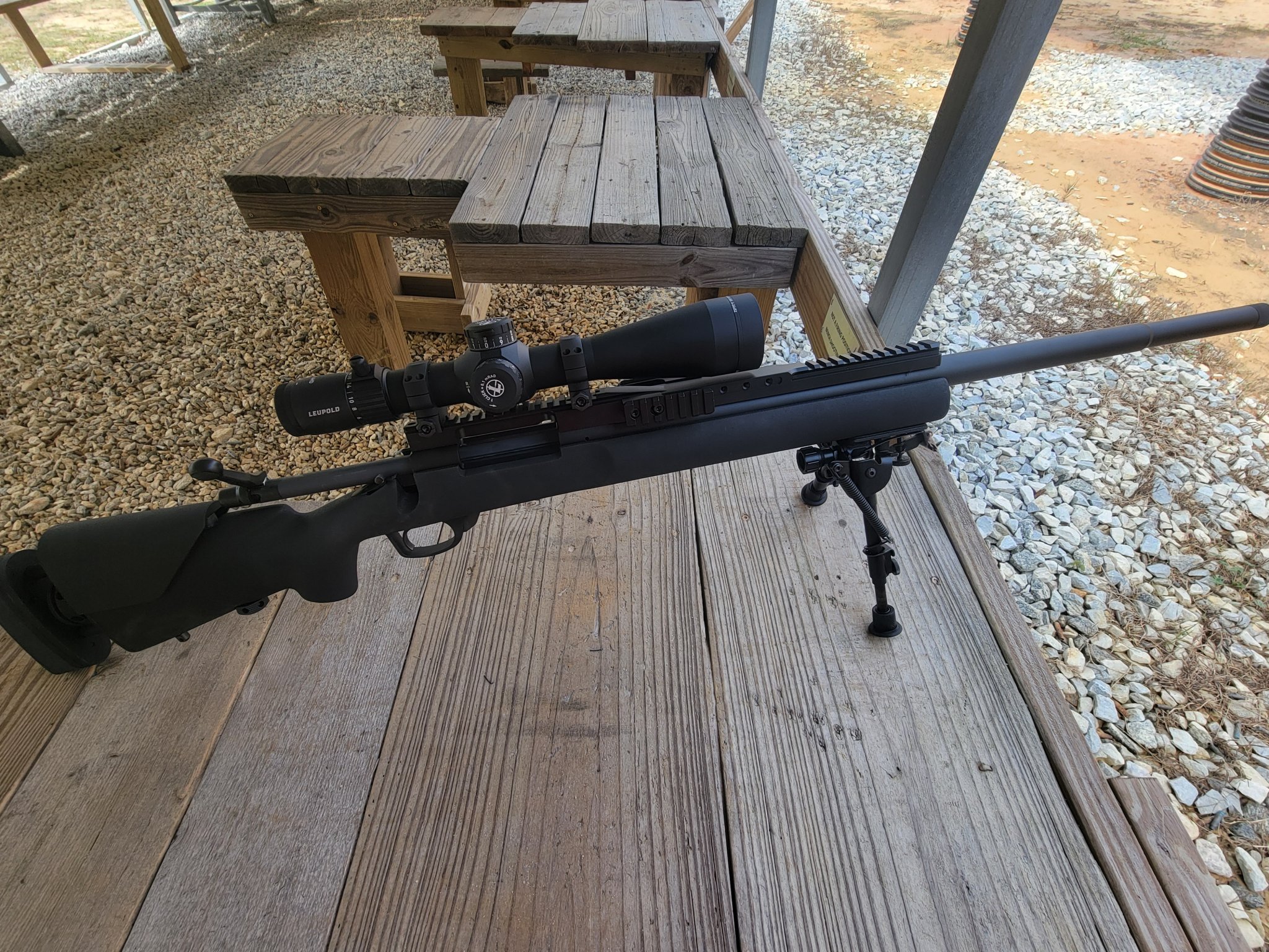

I’m putting the funding together (taxes) to do an M24a2 inspired build and since I’m not flush with cash, I’m doing it on a budget and I'd like some opinions please…
First…. I’m planning on Altus Shooting do the work and assemble the rifle. Aden and I talked a good bit the other afternoon, and he guarantees 3/8 moa with his actions and rifles. Is that a true statement? Second…. What’s the general opinion on the PRI rail equivalent to the Badger Mars rail? I know they’re aesthetic differences, but is the quality there? Third… How long does it usually take Allen Engineering to crank out a batch of M24 suppressors or are there alternatives that are available?
Thanks to all for the input.

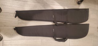

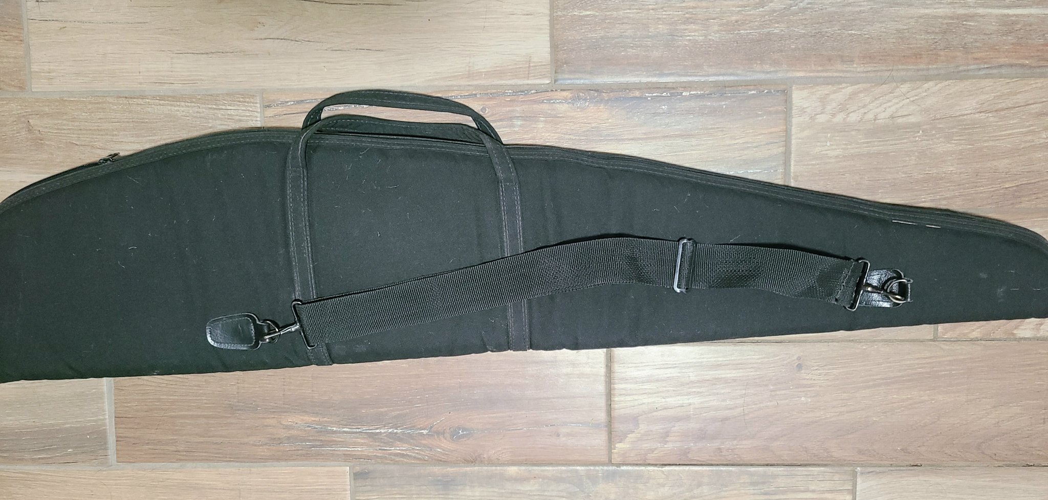

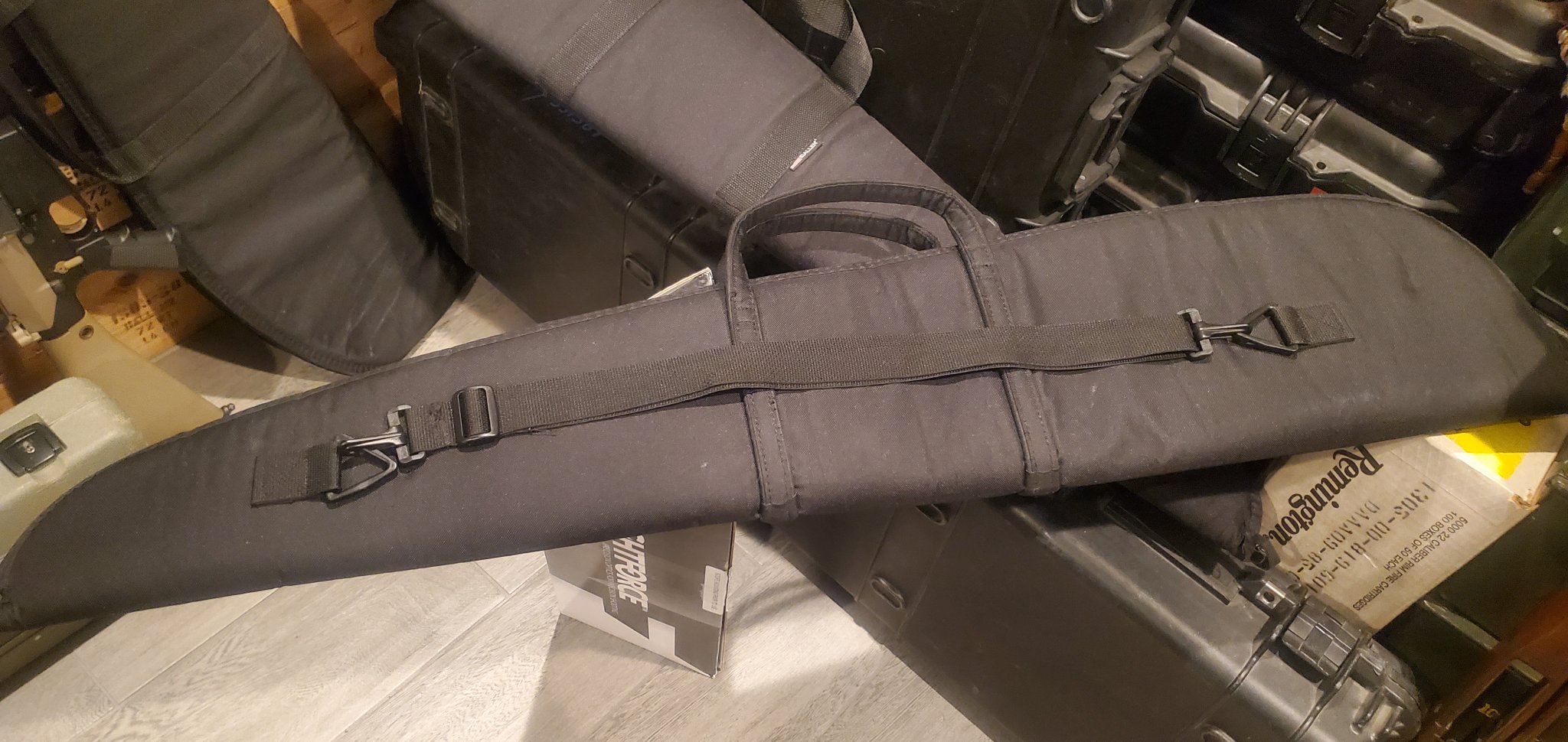

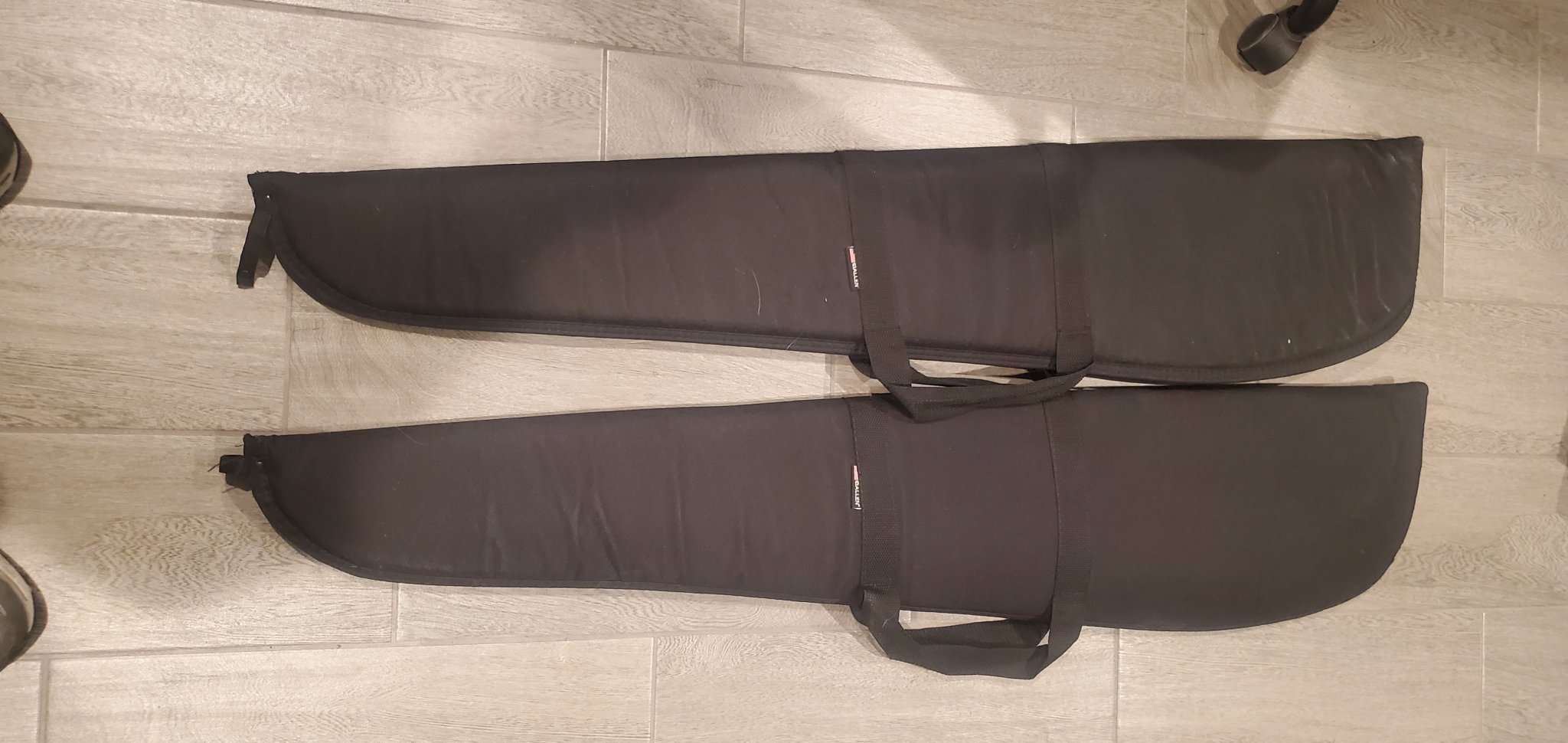

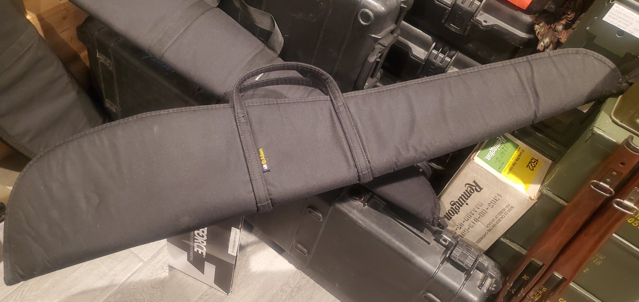

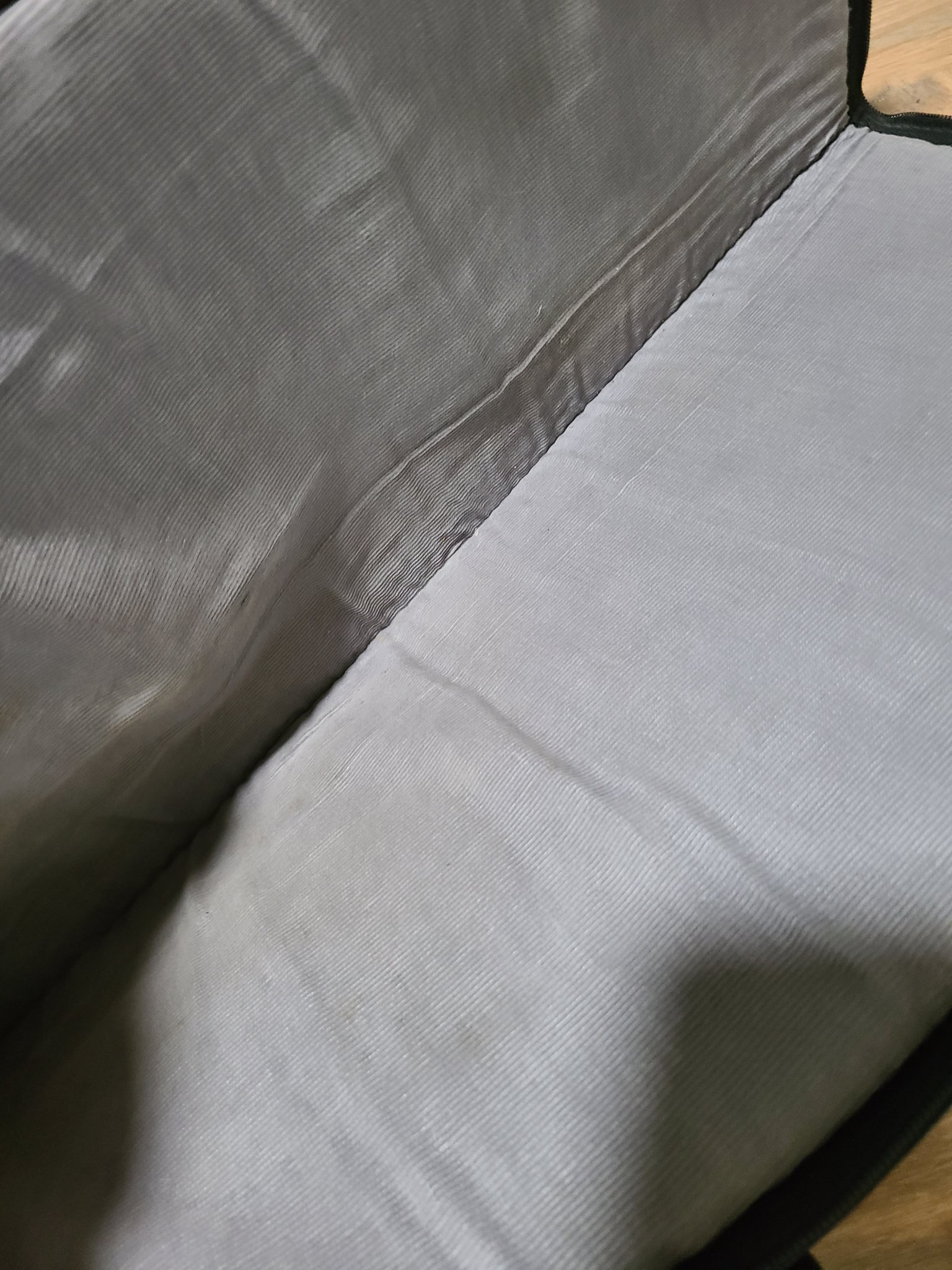

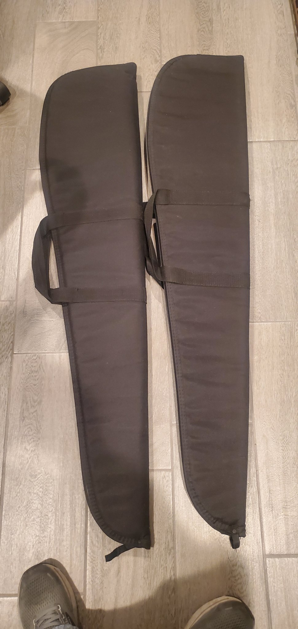

Can anyone tell me if these are the Bob Allen soft cases that were supplied for the M24
Need to see the inside of the case. The one I got from Remington has a black, shiny nylon lining. It was slightly different than commercial ones I have. The Uncle Mikes sling swivels have a Remington logo on them as well.

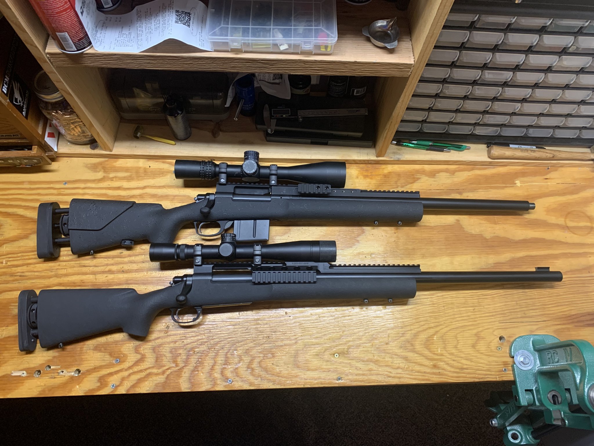

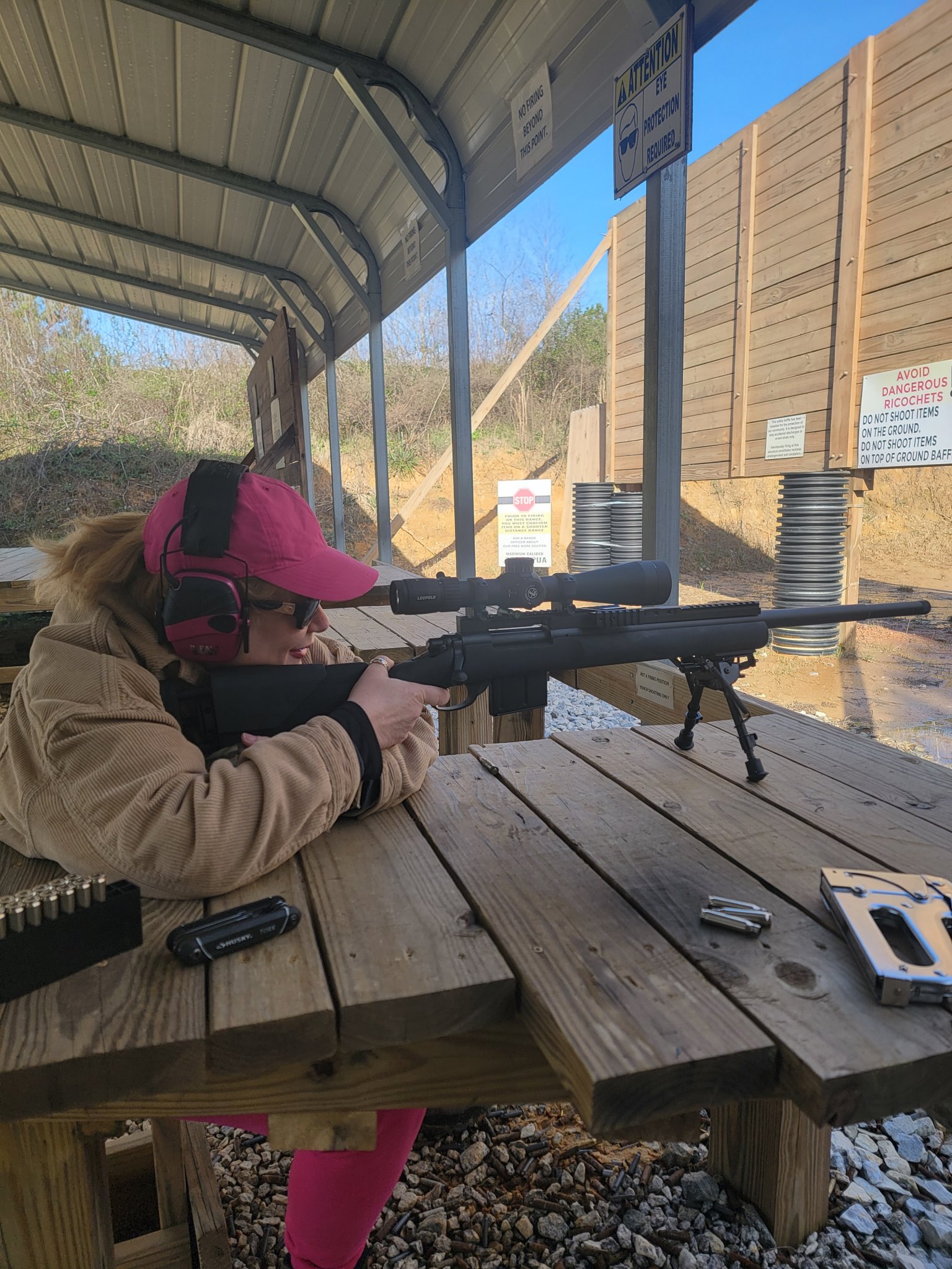

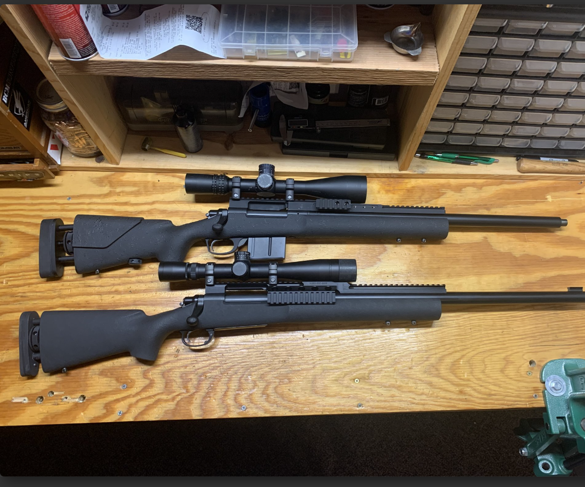

Just bought an M24a2 from Robert Snyder (I’m not patient enough to wait and look for parts) and until my gun budget account recovers some and I can afford the correct scope, I’m pulling my newer MK4 off of my .300wm to use on it. The scope being a 52mm objective, what height rings do I need with the MARS rail?
This Redfield Olympic is just a placeholder until I locate a reasonably priced Redfield International Big Bore. In the meantime, does anyone have a spare quick detach thumbscrew for sale.

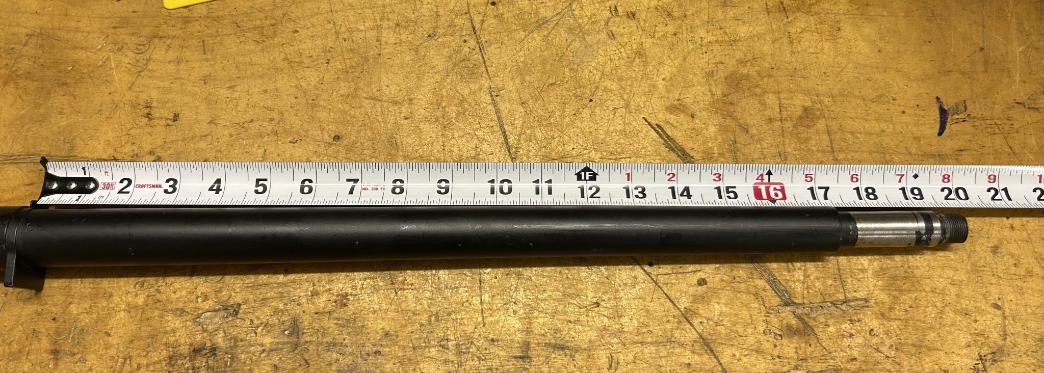

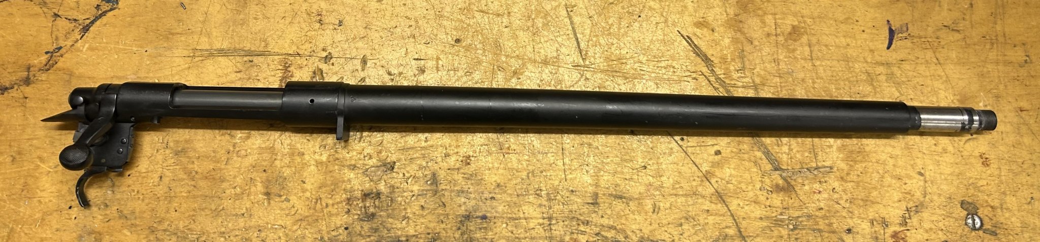

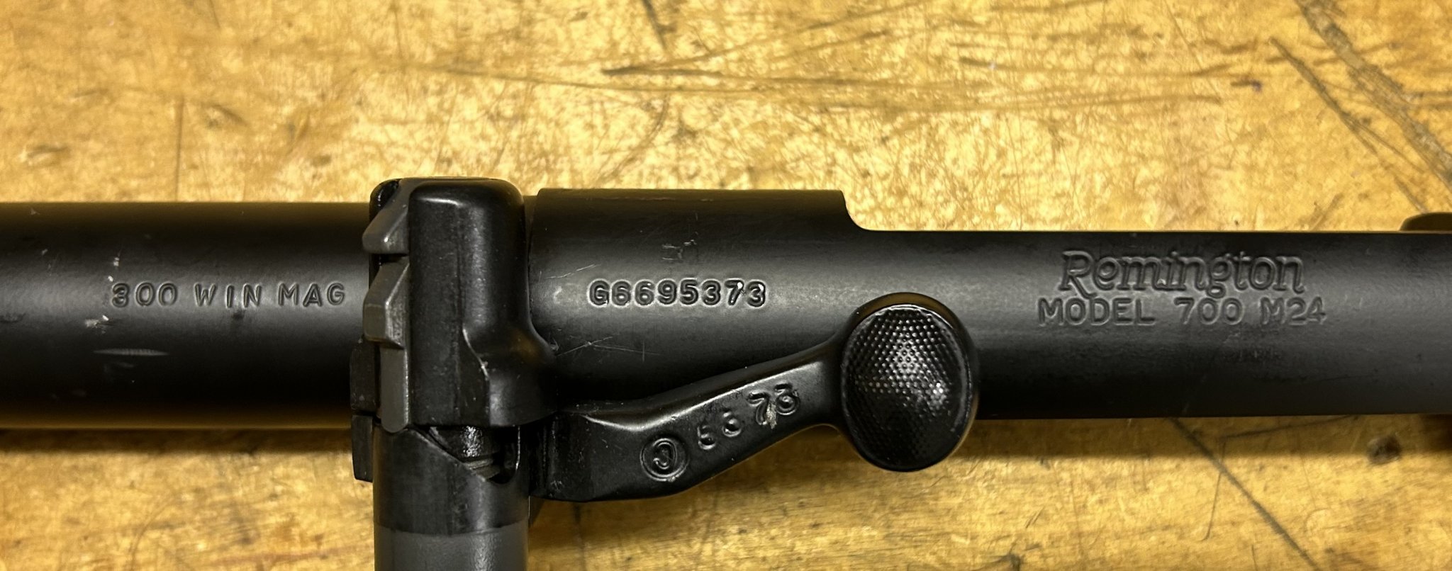

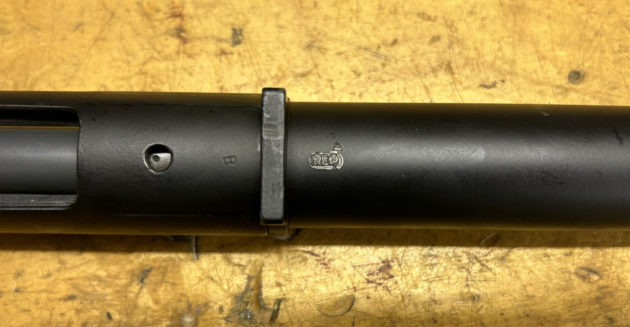

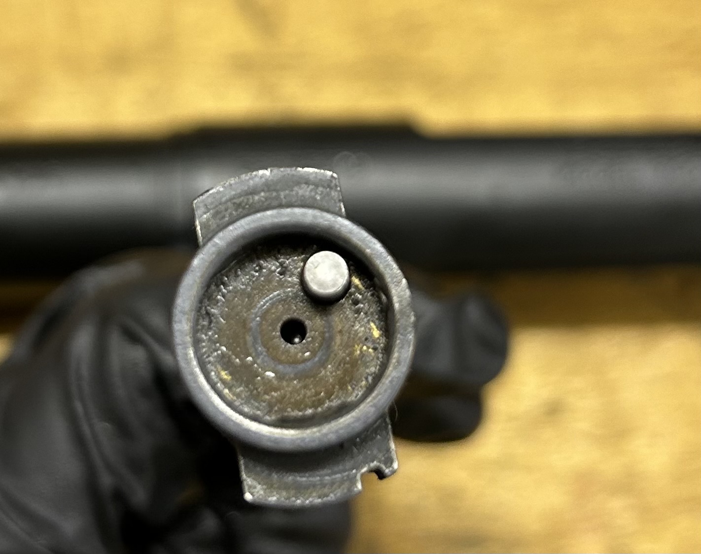

Picked up an interesting barreled M24 action and I’m trying to figure out what it is. G prefix serial, rechambered in 300 WM. Bolt matches receiver and the bolt face is opened up. 20” barrel has been turned down to 0.775” about 2.71” from the muzzle.
I know the XM2010’s were built off of M24 actions, and some M24’s used Ops Inc. and AAC suppressors, but the barrel appears to be profiled for a Surefire FA762-SS suppressor mount.
I don't think it’s aftermarket since the barrel has Remington proof marks and the paint on the turned down section of the barrel matches the rest of it.
Any clue what this is? I plan on doing a FOIA request to see where its been.

Hrrrmm.....
There were some 300WM 24s. Both "unofficial" and some T&E pieces.
Yours looks an awful lot like it was one of these. Barrel length and muzzle device look right

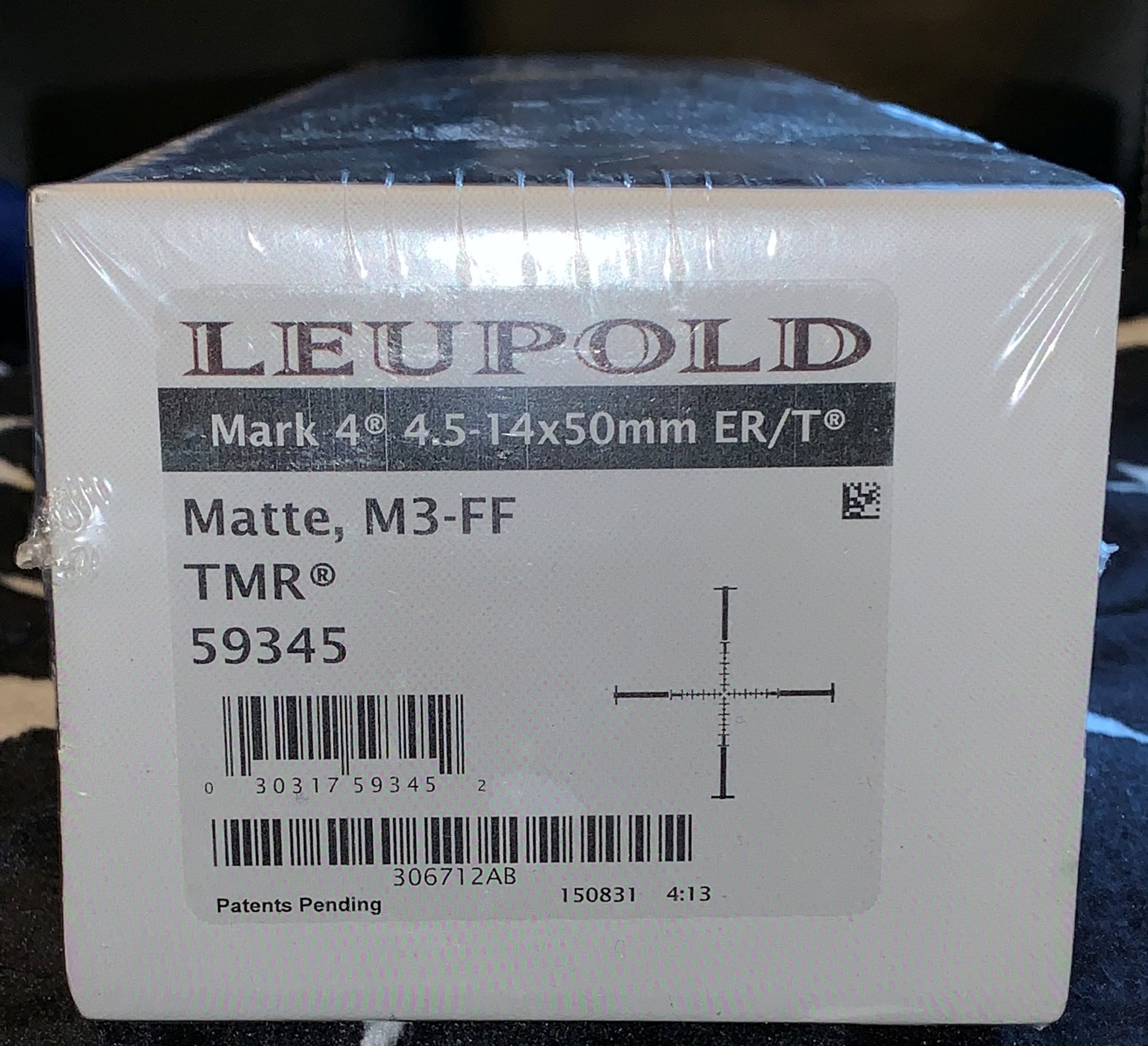

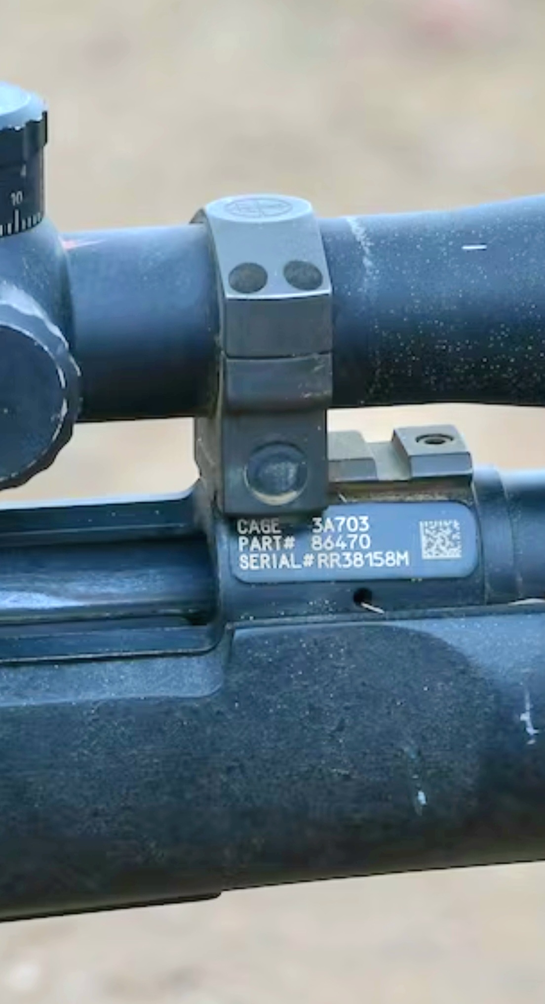

Determine the number made or that one is one of them?
Zooming in on the photo you can faintly see the intermediate numbers on the mag ring match the other 4.5-14 models.
For number made, it was discussed on arfcom once upon a time. I’ll see if I can dig it up
Someone zoomed in on that photo and you can see 14x on the eye piece.
Thank you.
Your monitors and eyeballs are much better than mine.
I thought the objective bells were bigger:
4-14x-jpg.7147347

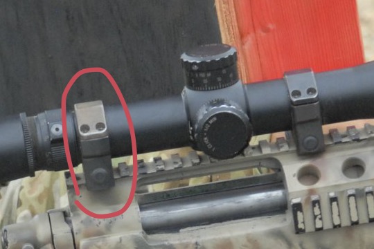

Also, did anyone else notice what looks like a mismatched rear ring? The top ring half looks like an Ultra, and the bottom/base looks like a Mk4? Probably the nature of using what was available at hand at the time.
