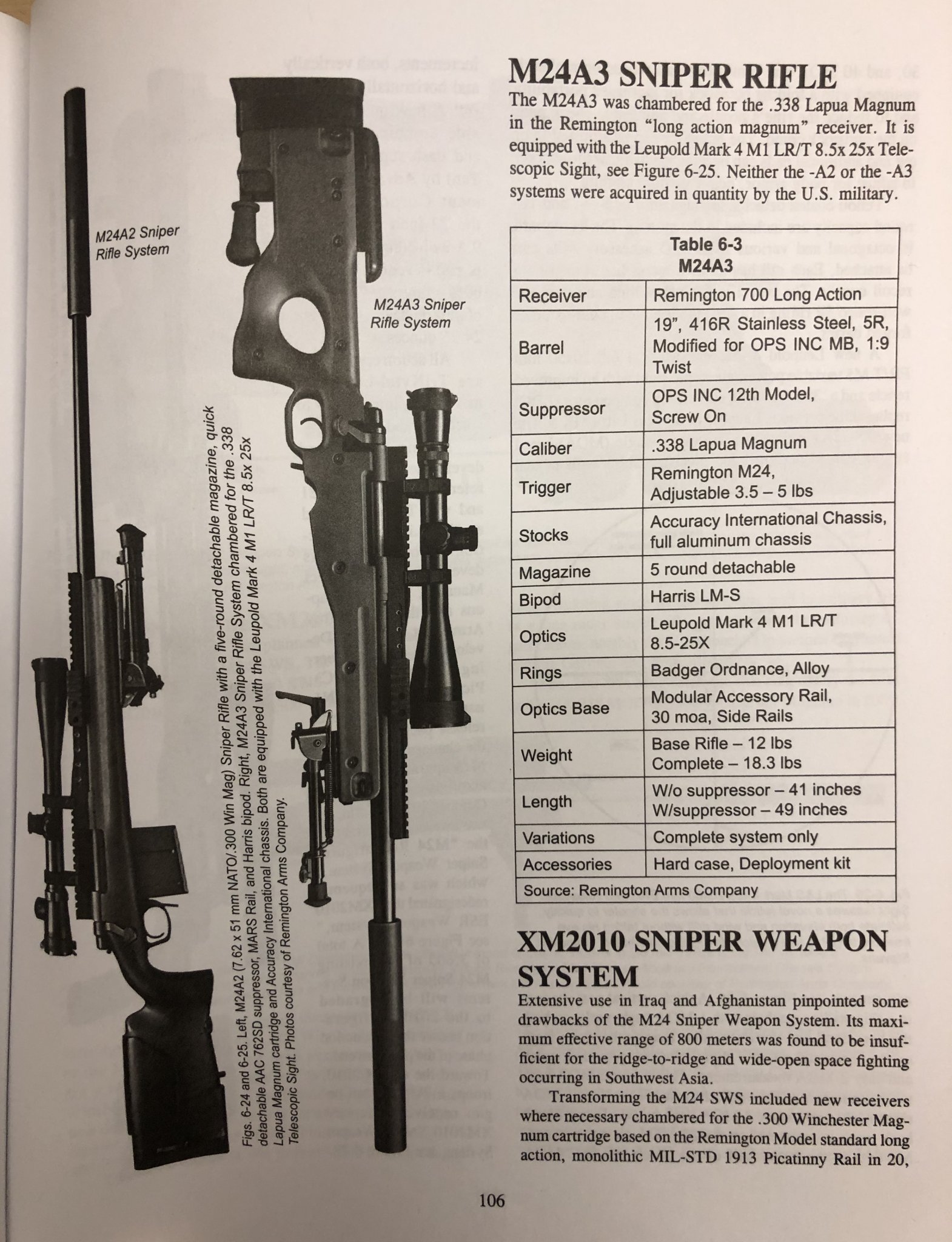

Here's one pic of an A3 from Joe Poyer's book on US Snipers post-1945 (attached).
FWIW, I read that only a few samples were evaluated as T&E items in the mid or late 200Xs, but unclear if any were actually procured.
The performance specifications of the then-new circa 2009 Mk 248 Mod 1 300 WinMag cartridge developed by the Navy was effective to 1500 yards (up from 1200 with the original Mk 248 Mod 0 ammo). Perhaps the Army decided around that time to just rebuild the M24s into the M2010 configuration (300 WinMag), as they presumably didn’t see enough performance difference to justify the additional recoil and cost of adopting a new platform to handle the 338 Lapua cartridge. At least that is the impression that I get, which is sort of reinforced in this article:

Thanks for posting that - some great information
As the 338 had an M24 designation I was under the impression that that was an "official" naming once it was in the system, not something from the Remington marketing department.

Great pic, sku 29172 for the m24a3 with aics and ops inc can

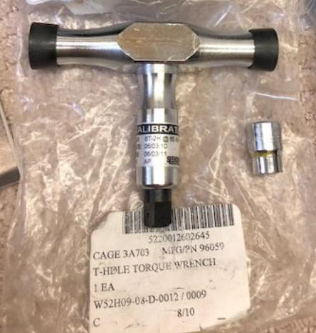

I received one more piece for my M24R kit this week, the proper 65-lb T-handle torque wrench. This one made by SEEKONK, and it came in a bag with the Cage code, Mfg/PN and the calibration sticker is dated June 2010,. Some sellers want too much for this item, but I found some for $65+$8 shipping ($73 total)
If any one needs one:
eBay item number:
283484831344
eBay item number:
283484831344
eBay item number:
283484831344

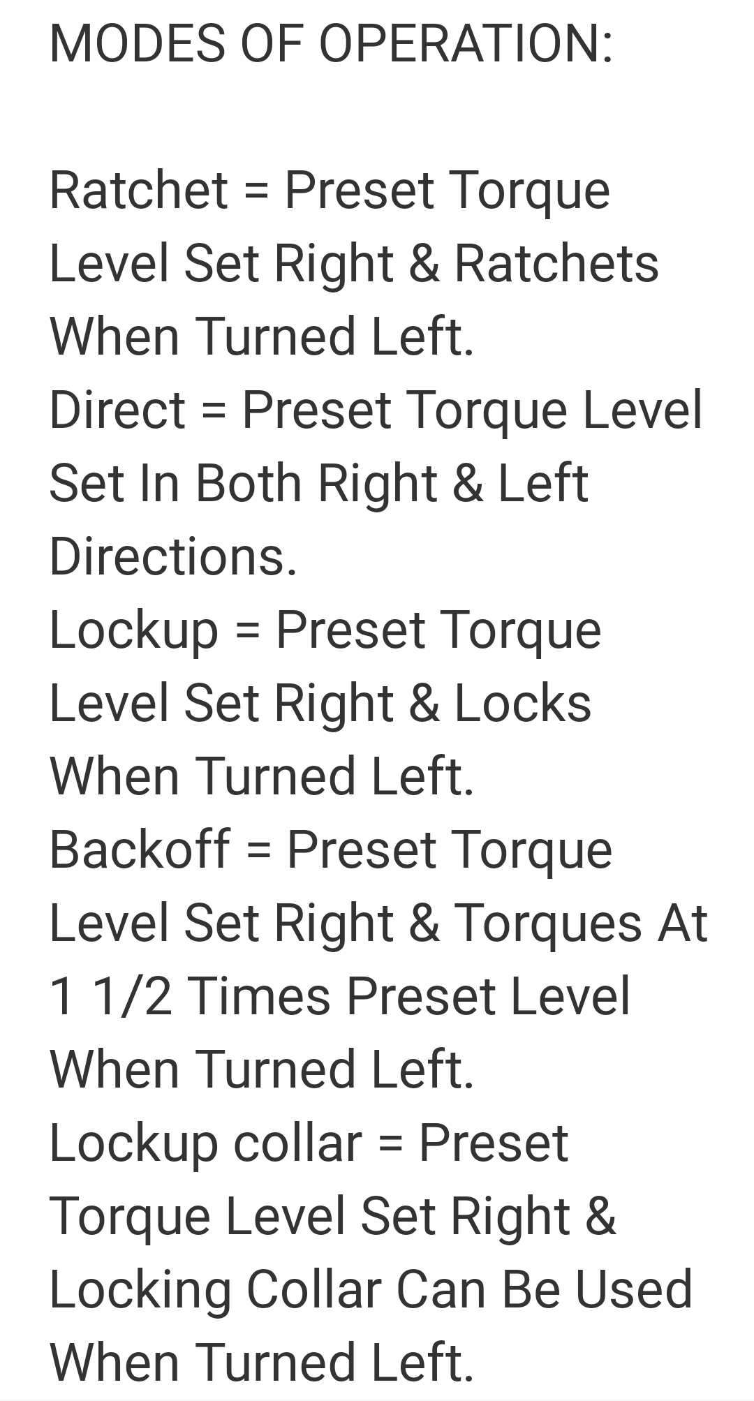

This looks like a 3/8" drive?
Do you know which version it is from this chart?
Hmm, I need to check what I bought. I recall that it ratchets when turning left, so it might not be quite correct after all, but it is right torque value so I suppose it will work from a functional perspective. (It has the Cage code, Mfg-Pin code and an NSN was listed, so it appears to be a military contract item). Apologizes if I mis-identified it on the forum.
I asked the seller on eBay this question as the one I got does rachet, but the item description notes this:
Action:Non-Ratcheting
...not a big deal as the goal is get the rings on at the proper torque level, but anyhow...
ON EDIT: Here's the NSN for the wrench for the M24 in the 1989 manual (1005-01-260-2645)
The NSN listed by the eBay seller is different, its 5220-01-260-2645
...which is indeed associated with a Remington Arms Company NSN that was established in July 1987, which would correspond with
the same time that the Leupold M3A Ultra scope and other M24 parts were authorized.
...and it is listed as unique to one weapon system, which we can assume is the M24.
...but my feeling is the lockup version would be better if one lost the 1/2 wrench and sought to remove the rings/optic.
Reactions: mjh30
I just checked the ones that came in the deployment kits on 2 of the M24 SWS "complete systems" and confirmed that they both rachet when turned left. It appears that was the version Remington was buying and supplying.
I also bought several of these from Uncle Sam's Retail a couple years ago before they lost their contract. Those all locked when turning left so you can use them to loosen as well as tighten. They did not have any packaging.
Based on Trigger Monkey's report, the ones I bought from Uncle Sam's retail, and what we see on the kits Remington sold and the auction in the link, it appears that both the lockup and rachet left types were in the government system.
Guess which type I carry in the tool bag?
Dave
31+ years, Seekonk probably made some product improvements in that ti.e, I do agree that the lockup type is best, but probably unobtanium at this time, except used.
