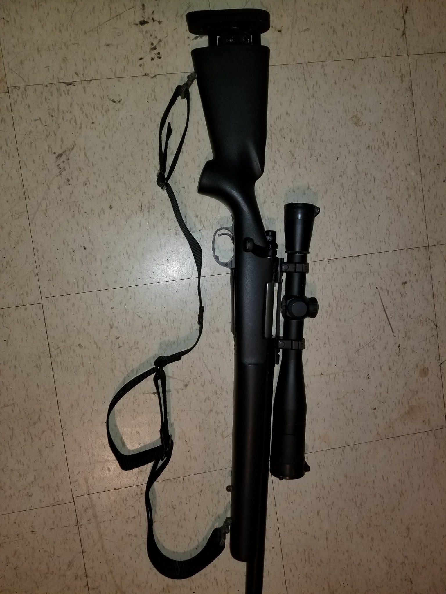

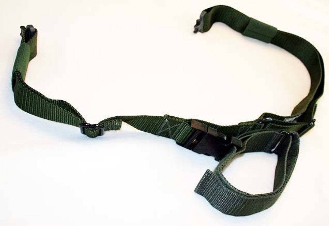

Hows the issued tis sling, anyone
Modded my TIS sling for a more manageable forearm cuff. This is an earlier version.

Drum13, TIS sling is aftermarket sling bought by the Army for the M24, early TIS slings had Uncle Mikes swivels, later ones had Talons I believe.
Thanks, I remember them. I wasn't clear but was just mentioning what the earlier M24's came with (pre-TIS).
I believe the original TIS slings had Talon swivels and were later changed because they don't lock and the swing gate can be pulled open without using the push button.

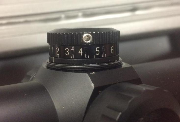

I just acquired a complete M24 :D. The Leupold on it has a ccw elevation turret with the .308 BDC.The BDC in the deployment kit is also in .308. Was this common with the M24's?
True that, I think at one point I tried swapping the bdc turrets out to see if one felt better than the other, it didn't really work, still felt mushy as hell haha.
LOL completely understand. I went through the same deal "back in the day" when I was carrying a duty M24. I always hated that mushy none distinct adjustment, finally pulled the elevation turret off to see what was going on, after playing with it a little I ended up lubing up the O ring and it was much better. Years later I was at Leupold talking to one of the engineers and he mentioned that unless you are diving the rifle down a couple of atmospheres, removing the O ring should not hurt it all. Its there more to keep debris out of the cap area rather than water proof it. I've always left the O rings in, but I always lube them up.

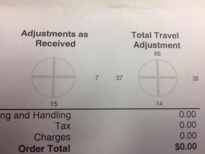

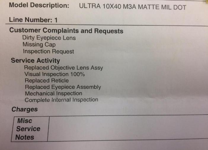

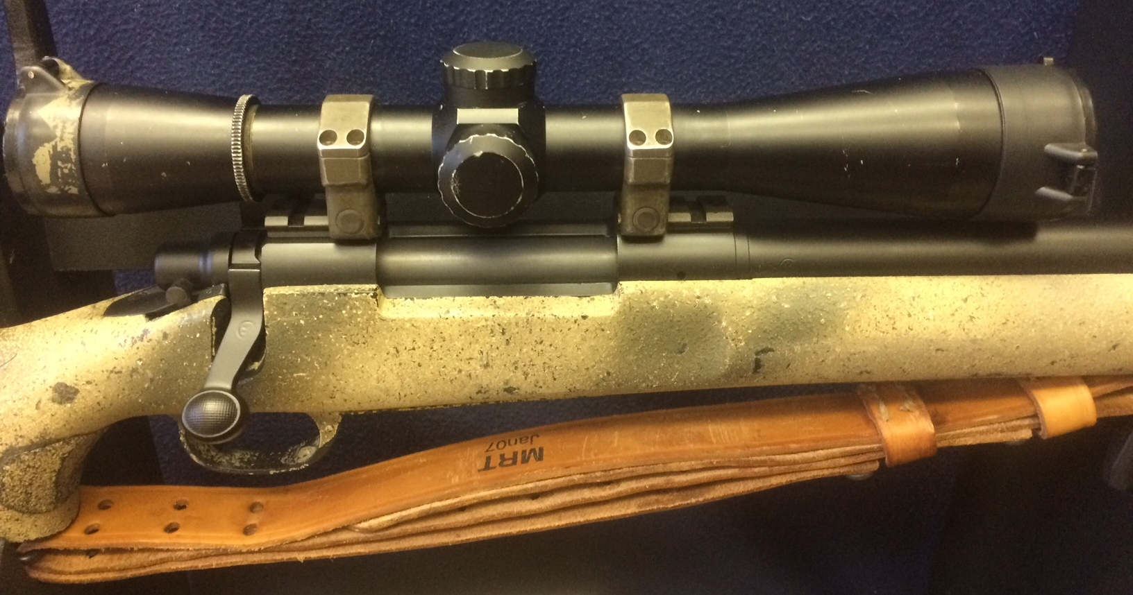

Regarding the old Leupold M3A scopes, the one on my M24R is dated 1989, and it had a lot of fine debris on the rear ocular lense and the adjustments were limited when I bought it back in 2015. I sent it back to Leupold a few years ago under the "Warranty Inspection" program, and a couple of months later it came back working new again and the glass looked new too - and it was no charge to me other than the $15 or so when I shipped it them. The scope was 28 years old back in 2017 when I sent it in. So Leupold really stands behind their products. Just an fyi...
Exterior of scope has patina from its service life - but works well and most of the glass is new again thanks to Leupold’s awesome warranty...
..just an fyi re an oldie but goodie scope.
You don't mention what type of Leupold came with your M24. The original M3a ultras were cw (clockwise) as were the first Mk4 m3's that were issued with M24's. These scopes were later changed to ccw as we knpw today The original deployment kits, not the ones that came with the rebuilds came with a spare cw 168 grain elevation turret for the m852 round, these were in yards theres some relevant pictures on page 4 of this thread.

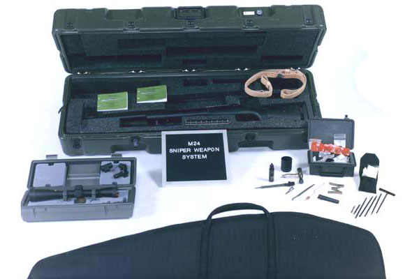

Did the A2s that were built on PST013s have Remington marked buttpads or HS Precision marked?

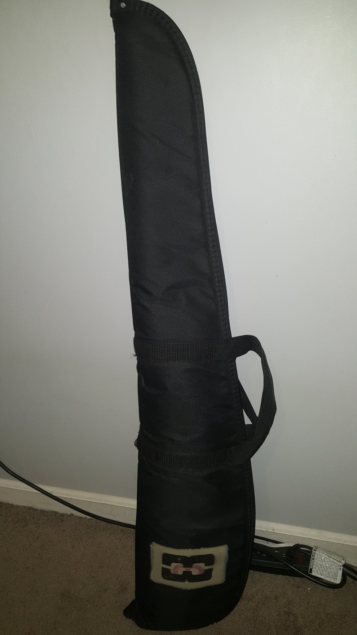

You mean that POS soft case that came with the M24? We used to throw them away in the Army because they were terrible.
Yeah they were pretty crappy gun cases, they were generic Walmart type deals that would fall apart rapidly, I still have one or two (one for sure that goes with one of my M24 systems), but they were junk in and of themselves. Kind of a nylon material with a thin foam inside.
We shot with some guys from our sister battalion once and they still had their cases but if I remember right the scope rings and sight bases really tore up that foam and there always little bits of it everywhere.
Yeah they didn't last very long. I ran a lot of sniper courses and in every class someone would bring out the soft case, it would be done by the end of the first or second week.
Here's a picture for anyone interested. I have not hunted down the NSN for the soft case, but it looks pretty generic...
