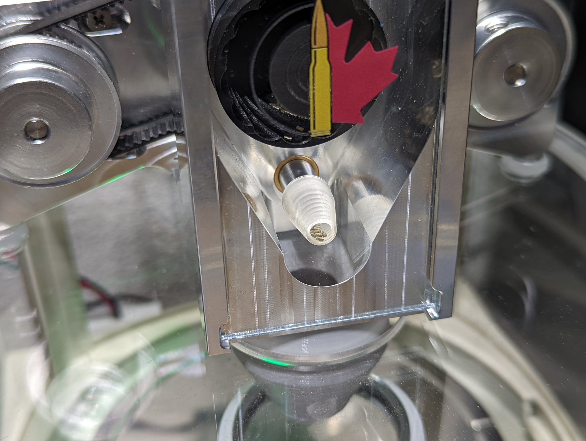

Maximum success looks like this:
Cut Jthors tip down like so:
Install on the back of the unit thusly:
Pull the transition weight to tune specific powders:
Basically, a series of varying diameters in the rear, would ensure a single file line of kernels out the front regardless of powder. I like this, because I don't need to mess around with the little tip in the front every time I want to empty the machine. I'm seeing 10-12 second charges with Varget, H4350, H4831SC, H1000, Retumbo, N150, N560, N565, N570, Ramshot Magnum, RL26, RL15, IMR7977, and IMR 4955.
You can literally tune any powder on that setting screen without touching the tilt of the machine with shims.
Glad the tip is working! @NiteQwill
Just to reiterate/clarify for everyone I offered to sell the tip just to help others. I think just as of recently I just made out positive on on the tips I sent out for others to test in the beginning, free of charge. I did spend my own my money shipping the initial resin tips out. Me selling the tip was never meant to take a stab at the V4 at all, just helped fix a minor issue. Making this tip in CAD and then resin printing it is a lot easier than building a whole system and programming it. Lol I felt some sort of obligation to help since I was a beta tester. Let’s also note that Adam is a shooter/competitor as well and there is only so much time in a day; he doesn’t have folks working with him in numbers like RCBS, Hornady and so on. Those that innovate in this sport are passionate shooters also. I’d hate to see these people walk away from the sport because others unwarranted criticism. Not saying critism is bad, it’s not, but sometimes it can get a little out of control on these forums. Just my .02

For me, personally, adding @jthor cap to the front of the small tube perfectly aligns kernels in a single line to prevent overthrows. The best part: it's fast. I have tried this for H4350 and Varget. I am unsure if this will work with ball powder. I load most my ball powder rounds in a Dillon anyway.
I did this with approximately 150 rounds recently and had maybe 3 overthrows (by 0.04-0.8 gr). I have a long reloading session next week with approved 400 rounds so I'll see how well it does.
I’m still in the unsure camp on the tip. It does appear to reduce the flow down by .04gr a second. Maybe this allows a higher small tube speed which it almost appears the powder is better behaved. I do see the kernels approach the end in a more organized manner.
I did notice that if you just run the small tube continuously you can adjust the tilt until you get a nice flow that does not cause the scales stability indicator to light up. I think if you keep adjusting until it mostly never comes on, you have achieved a good flow with no gaps. It is imperative you run the small tube for a minute or two when you make level adjustments so it is purged the previous kernels that populated the tube at the old flow.
