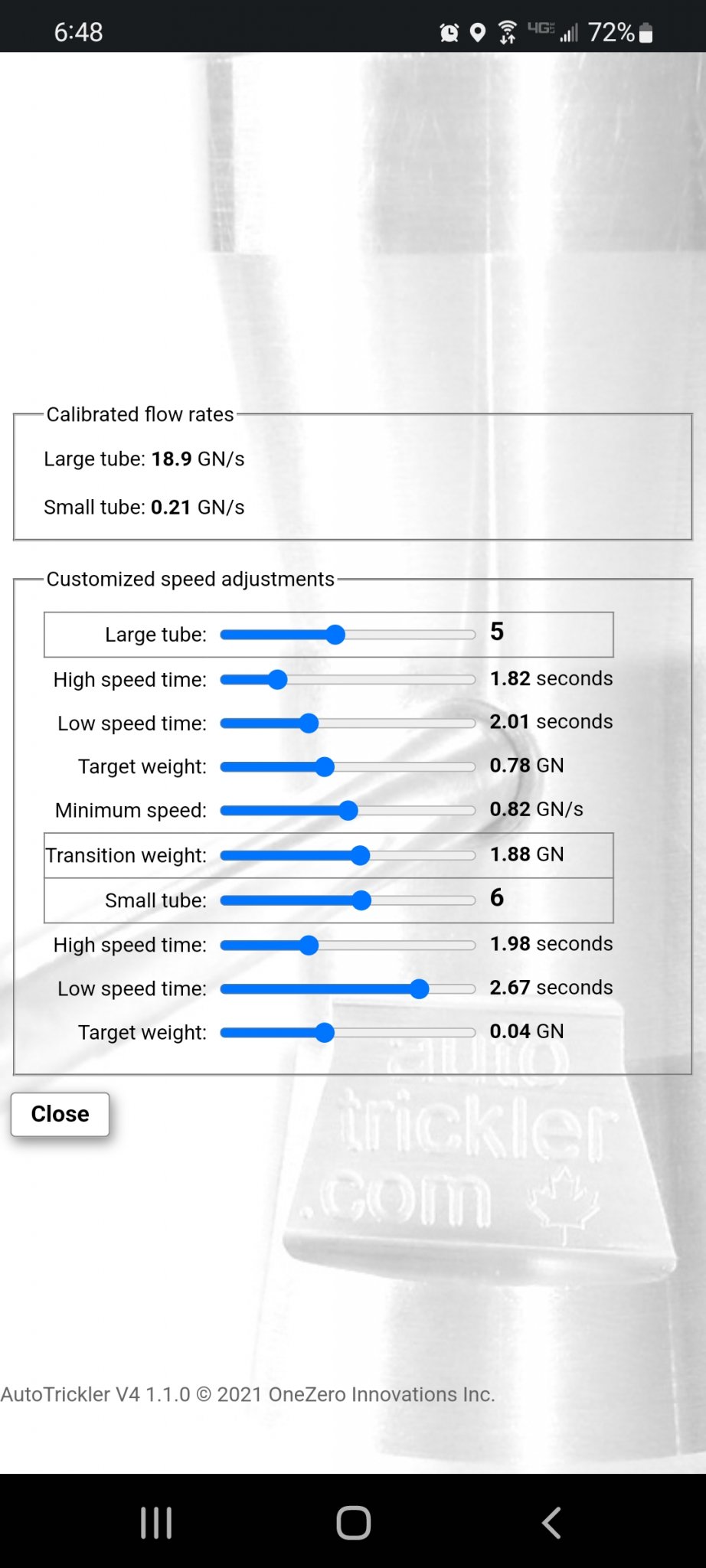

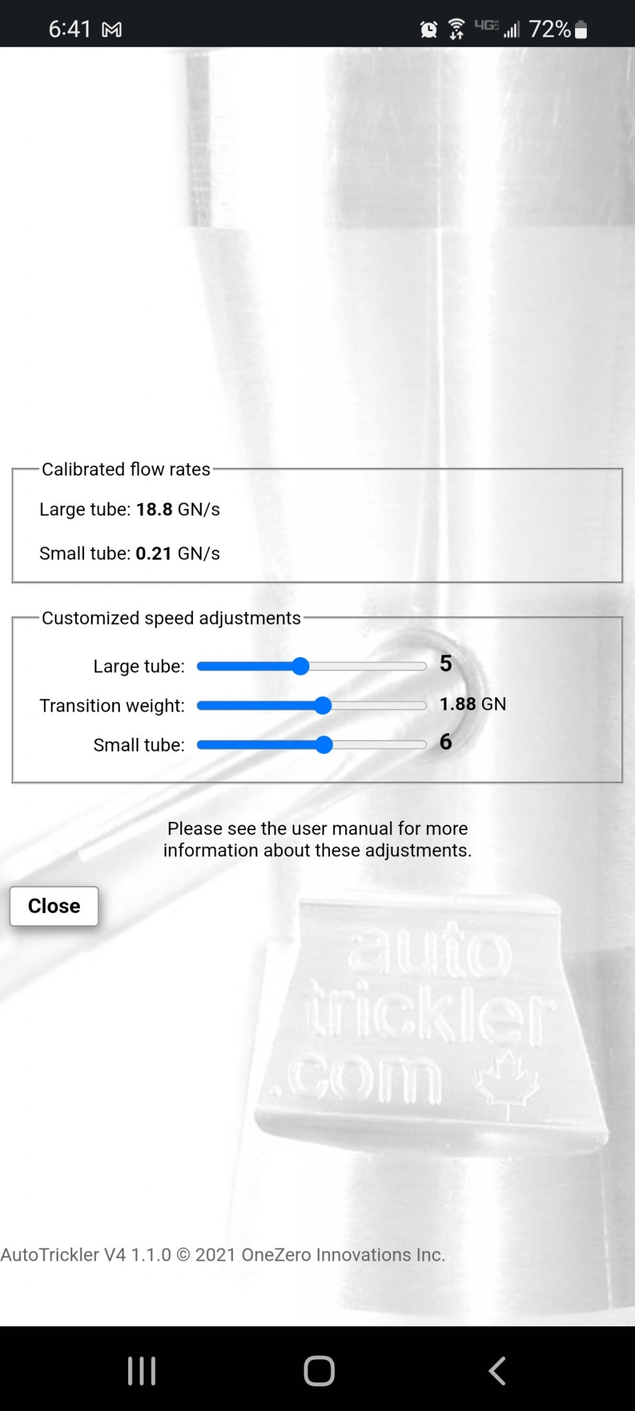

Here are my settings.
Maybe this will help

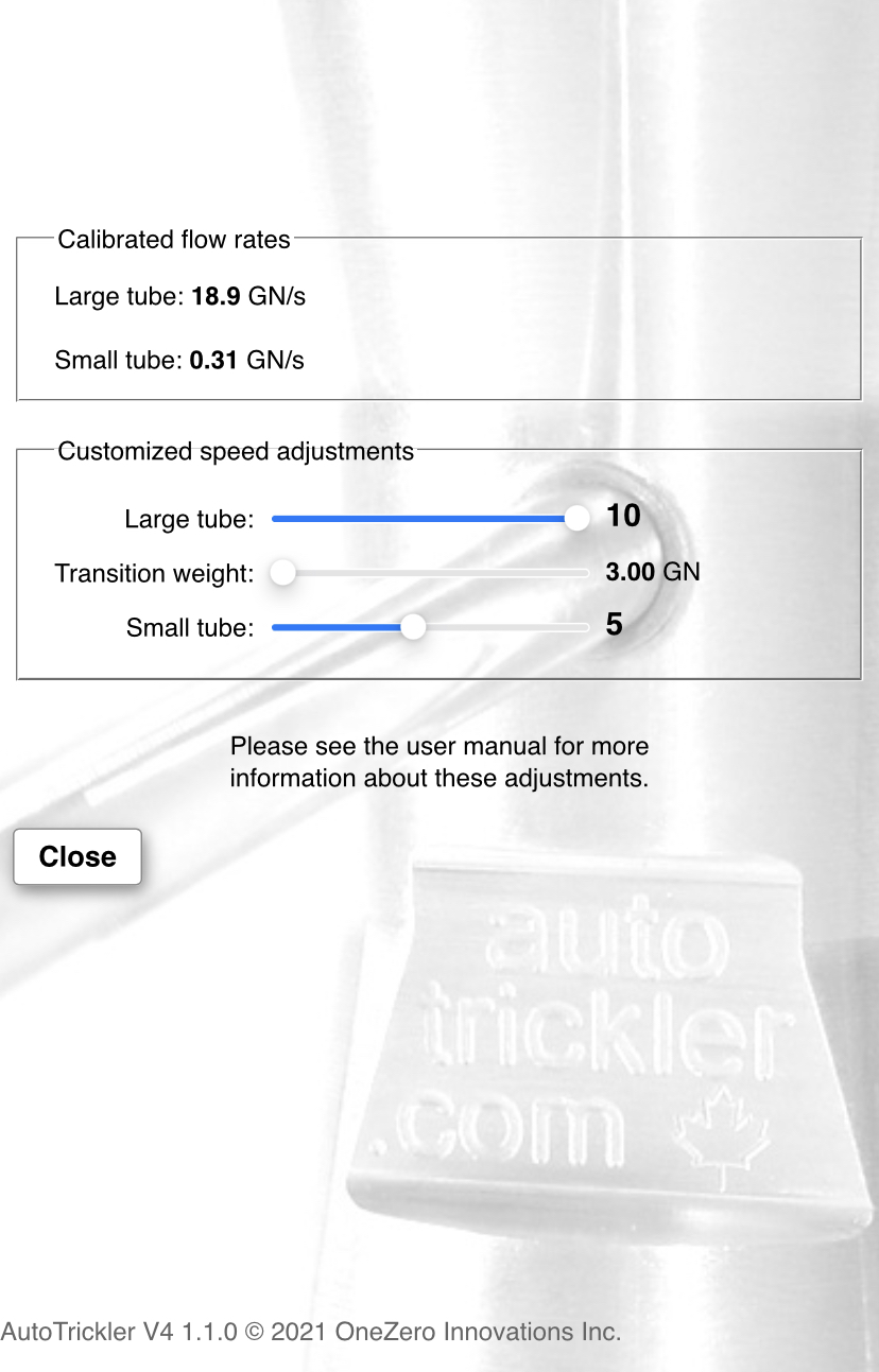

I just got mine. How do we get to those additional customized settings? Right now I can’t stop the overthrow without slowing the fine tube to a CRAWL. So far I’m not too impressed but willing to do some fiddling or chalk this up to a solution without a problem and go back to my V3.
Reactions: Obone
Hold down the CLOSE button under settings

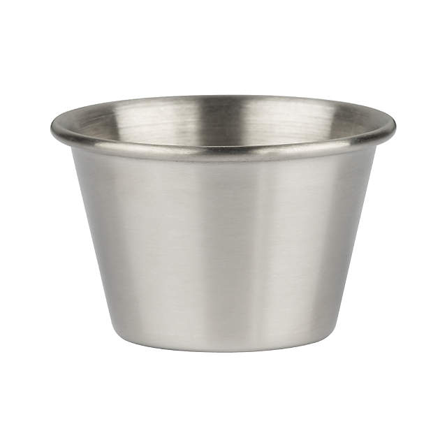

Empty the hopper first
Take a condiment cup (metal or plastic) and empty the rear
Run large then small tube into powder cup
Use the condiment cup to remove the rest in the rear, again
That’s what I do, but to run the tubes to empty them I’m playing with the desired charge weights and hitting +1 continually to keep the tubes spinning as they approach the target weight until empty.

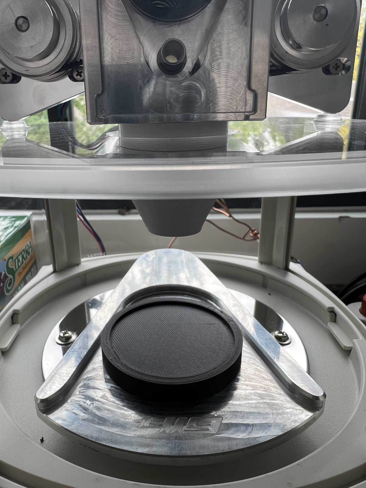

For those of you who have the Area 419 scale upgrade and the (in my opinion) better cup, I've printed a riser that holds the cup nicely closer to the funnel to avoid splash. PM me if you'd like the file to print yourself.

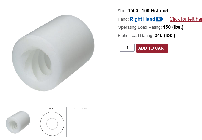

My thoughts are that the small tube threads are to fine. I think it would improve performance if the thread pitch was considerably steeper and deeper. I'm thinking the large stick powders will lay single file in these big threads. I've got some N570 to try.
Going to machine one of these to slide over the small tube. This is 10 threads per inch, high lead and has 2 thread starts vs 1 for std thread.
Might not work worth a damn in the end, but I don't expect it to plug and play without tuning.
I'll let you all know how it works.

Try the following settings with the tip as a base line. It’s what I’ve been using for quite a while with 4166/4350/H1000/Retumbo and a few other powders as well. Generally my flow rate for the small tube is around .25-.29
I tried out the settings Adam posted in #769 in this thread. It worked just as he said, lots of overthrows initially, but it settled in after 5 or so, and sped it up dramatically. No other mods to mine, throwing n133 and varget.
