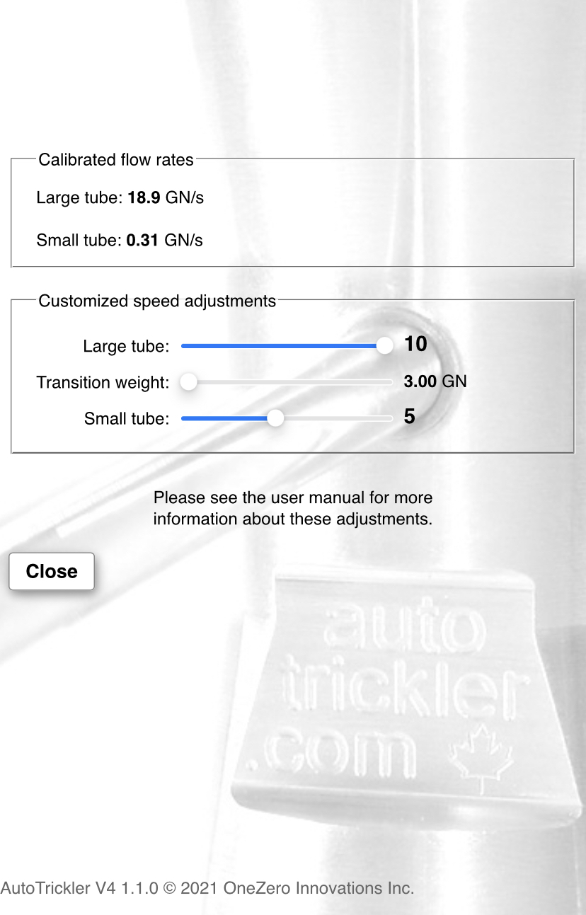

For anyone who'd like to test out some improvement in the short term, there is a way. It would be nice to get some feedback at this stage.
Use a powder with kernels under 0.04 grains. H4350 or smaller. Calibrate twice in a row. Make sure it's close to 0.20 GN/s. Then open the V4 settings page and hold down on the Close button (long press). That will open more advanced controls. Set "high speed time" and "low speed time" all the way to the left (1.5 seconds). Set "target weight" to 0.04.
The first cycle will probably overshoot but give it 5 cycles to settle in. Then if it's still overshooting like crazy increase the times to 1.7 and see if that fixes it. Try a real target weight, but also try dispensing 2.0 grains repeatedly which is a more focused test case that only uses the small tube.
You can always reset to defaults by changing the main screen's speed slider.
I don't expect perfection but it might give you a sense of where we are going - it should be nearly twice as fast.

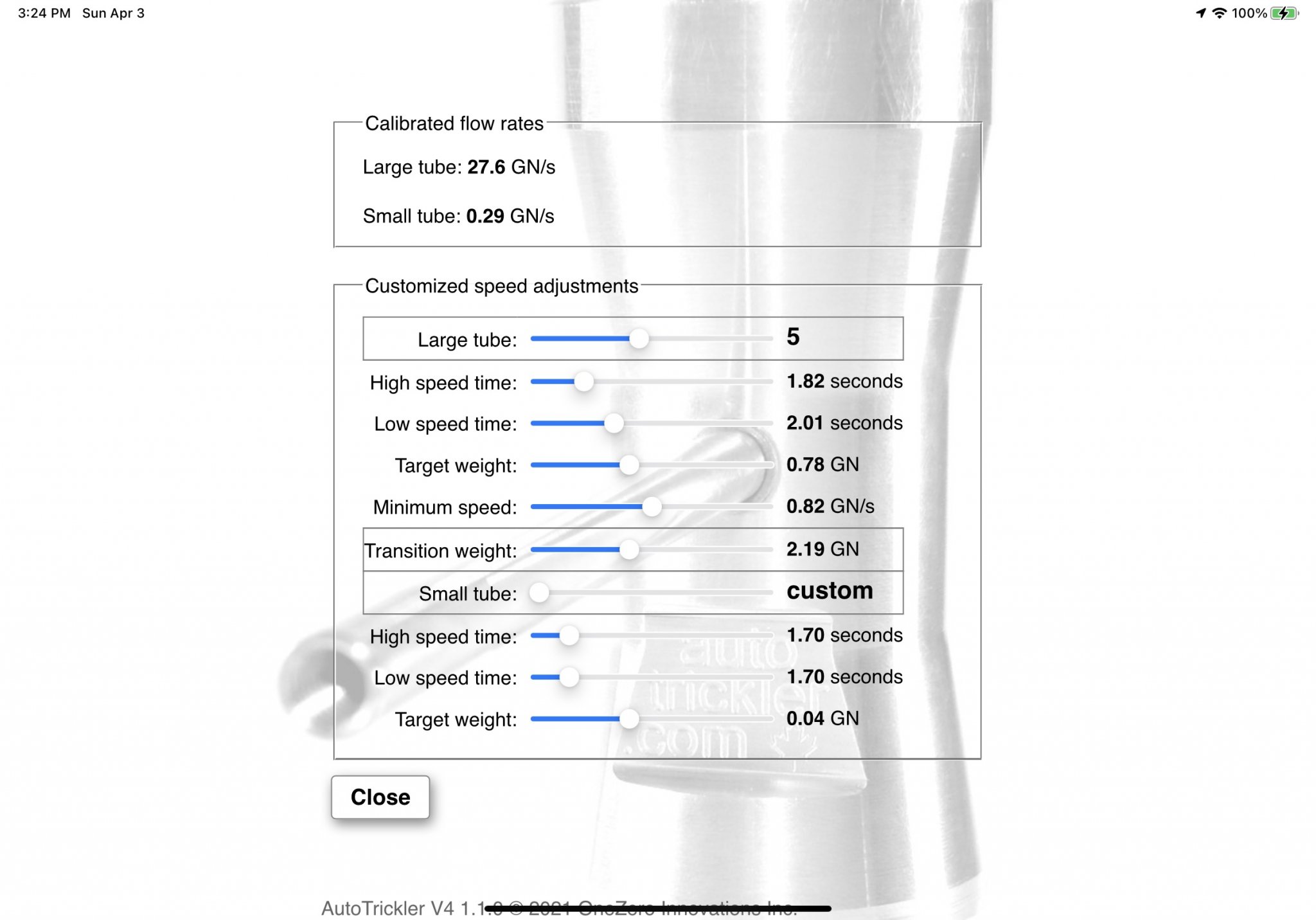

@adamjmac I ran the test and results look promising; here's my observations.
Using H4350 I calibrated twice; 0.21gn and 0.19gn.
I'm using the Jhor tip
I started with stock setting 5
Made the changes to 1.5 high/low speed time.
Set a charge weight of 38.0gn.
I started out first getting huge overthrows. The overthrows were from the large tube and the small tube never moved. I turned Large Tube "Target Weight" to 2.00gn to try to spin down the large tube sooner. That had a positive effect but I was still getting overthrows from the large tube which was throwing right up to or past the target weight. 6 out of 10 throws where overthrows (after 5 throw-away runs to let the machine settle in.) Overthrow weights were from 38.08 to 38.40.
I changed the high/low speed time to 1.7 sec. First throw overthrew by 1 kernel; 38.04. The next 10 throws were accurate (+/- 0.02gn.) Throws were fast but I think the large tube could still throw a bit closer than these settings. And sometimes the small tube would run slow looking for the last few kernels which I feel is the culprit of the occasionally extra long throw.
If there was a minimum speed slider for the small tube I think that might be a helpful addition.
I spend some time messing around with settings sorta blindly not really knowing what all the settings do. I was pretty happy with this setting, it seemed to throw sorta close with the large tube but still not consistent. And the small tube never got stuck creeping looking for the last 2 or 3 kernels.
Reactions: Rich4
Thanks Tyler, a few points
- Large tube tuning is separate and wouldn't be any different than before. If it's overshooting, adjust transition weight first.
- The tip has a huge effect on the small tube flow patterns and requires a different strategy altogether for tuning. If you are testing these numbers below 2.0 you should remove the tip.
- Minimum speed is not in the app now but you are right it is the solution to the long waiting time for the last kernel.
It's good to hear that it wasn't overshooting at 1.7, and surprised that was the case while using the tip.

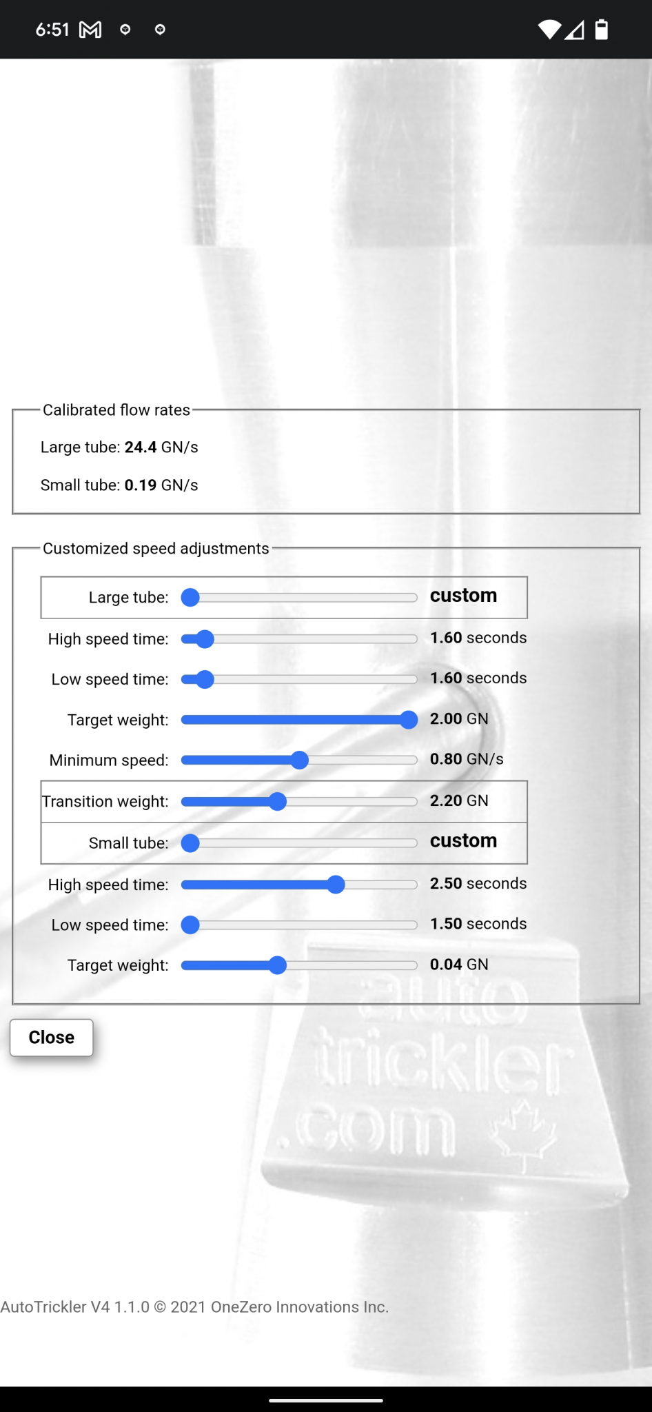

I have the jthor tip and tried the hidden settings with limited success. Definitely got the times down, but had trouble with throw consistency.
I took the tip off, recalibrated and settled on the settings below. Definitely brought the drop speeds down - from about 13 seconds to 9-10. And a single overthow in 50 pours.
30.7 gr H4895
