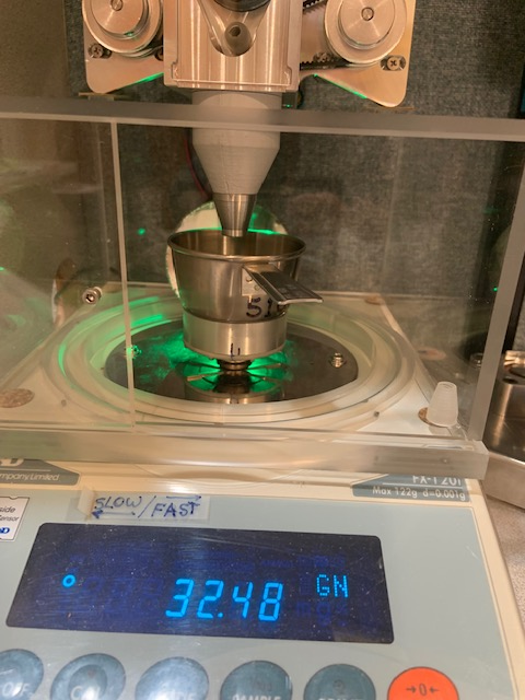

Wanting a more obvious green light, I set an old mirror in the back of the scale under the green LED and came up with this. I'll eventually find a smaller square mirror and make a stand to set in the back of the enclosure so it doesn't look like an afterthought.
Ive been using my V4 along side my pair of V3s for a bit now. Maybe have 1,000 rounds through it. I am really liking it. I have adjusted the rates enough to be quite consistent. I would consider the error rate to be improved on the small and mid grain powders, and likely improved on the large grain powders. I currently have the gap set at 1.5 grains and keep flow at 9/8 for smaller powders and 7/6 for the larger ones. Having three machines side by side, it is more important to not over throw than to squeak out an additional 2 seconds of speed..
One big bonus for me is charges over 100 grains. The V4 is much faster there. I am very happy with the system overall. I have not added a tip or messed with angles at all and I am getting good results. I was skeptical initially because I was having a hard time believing the V3 could be improved on. Now, after some use, I am in favor of the V4.
Side bonus, it is much quieter.
For perspective, I loaded over 30,000 rounds in 2021 and am planning on 50,000 rounds in 2022.

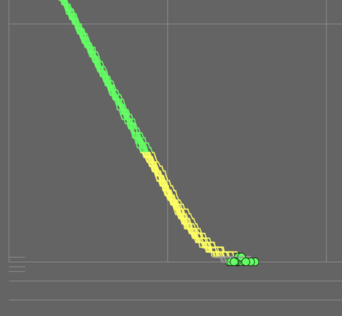

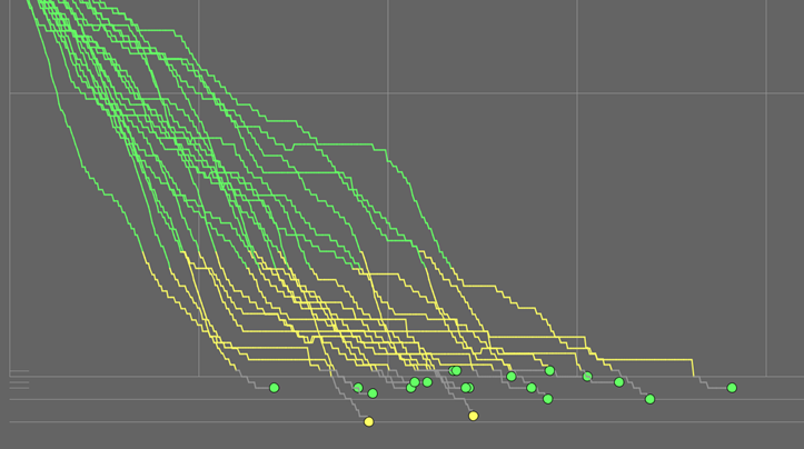

I've been doing a lot of testing over the past month or two and I had a bit of a breakthrough yesterday. It's too early to say much right now but I am excited and I think V4 can potentially go about twice as fast as it does now, with only software changes.
The speed sliders in the app right now are controlling around a dozen numbers under the hood. The gains come from tweaking how they change in relation to each other. Different powders have very different flow characteristics at high and low speeds so one size does not fit all. Also the density of powder in the tube is hugely affected by how fast the tube has been spinning over the last few seconds. Starting and stopping at low speeds for a while allows powder to settle in and fill up the tube which leads to more flow.
The best possible performance is found by understanding what each number means, and individually adjusting them to improve each part of the process, for that powder, for that tilt angle, for that target weight.
To give you an idea, dispense 2 grains of Varget repeatedly (press Re-Zero). It probably takes 15-20 seconds. You will hear it ramping down smoothly and the last 0.5 grains will flow cautiously to avoid overshooting. Sometimes you will get lucky and finish quickly and other times it will take 20 or even 30 seconds once in a while. The speed slider has a pretty minor effect on the overall result and even at speed 10 it's still pretty conservative.
With more tuning, the powder be made to flow basically at full speed directly to the target and stop. From the point where the motor starts to slow down to when it stops is under 5 seconds. Tweaking specific parts of the process in more detail lets you minimize the risk of overshooting without compromising much overall speed. It's actually not super sensitive. There is a lot of wiggle room and it's possible to get very close to optimal speed with almost zero overshooting.
I have an objective to understand this more completely and bring the potential to everyone in the simplest possible way. It won't be 10 separate sliders. It will be a step by step guide which anyone can follow without frustration. There needs to be an "easy mode" for getting decent results and then the power to optimize beyond that. This is my project. It will take some time but it is a high priority.

Yes, to clarify, I expect this is an app update and a guide which includes clear instructions for tuning sliders as well as tilt angle.
There may be upgrades to mechanical parts for other reasons but specifically for what I'm talking about now, I am using the stock hardware and only a free app update is required because the app can control all of the parameters I am adjusting and the mechanics are not holding back performance (at least with Varget).

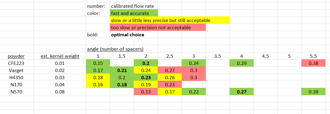

I have a question.
N570 appears to be an outlier. I expected N170 to fall in between in terms of tuning but it doesn't. It flows much more like the other powders despite having large kernels.
Can anyone suggest another common, easily obtainable powder, similar to N570, which has issues flowing at normal tilt angles, which I should be considering?
I already have some H1000 and H50BMG and will test these soon.
I'll be writing this all up soon in a document but for now here's two opposite ends of the spectrum of how powder can flow. Just look at what we have to work with...
To me the key will be the slow tube flow, H1000 and 4350 are the reason I bought this unit, clumping appears to be the only reason for overthrows, thus jthors tip and the sawtooth McDonald's straw in a chargemaster, have you considered other pitchs (courser) for the slow tube.

I have a question.
what about RL33? I have not tried it but it is close to N570. I agree with those #s though. Mine runs better with tilt that produces a calibrated flow from .18 to .23, I am keeping it at .2 - .21 for now. The tip helps too, allows me to turn the speed up a little. I am running 9-12 seconds per charge without issue or over throws.
