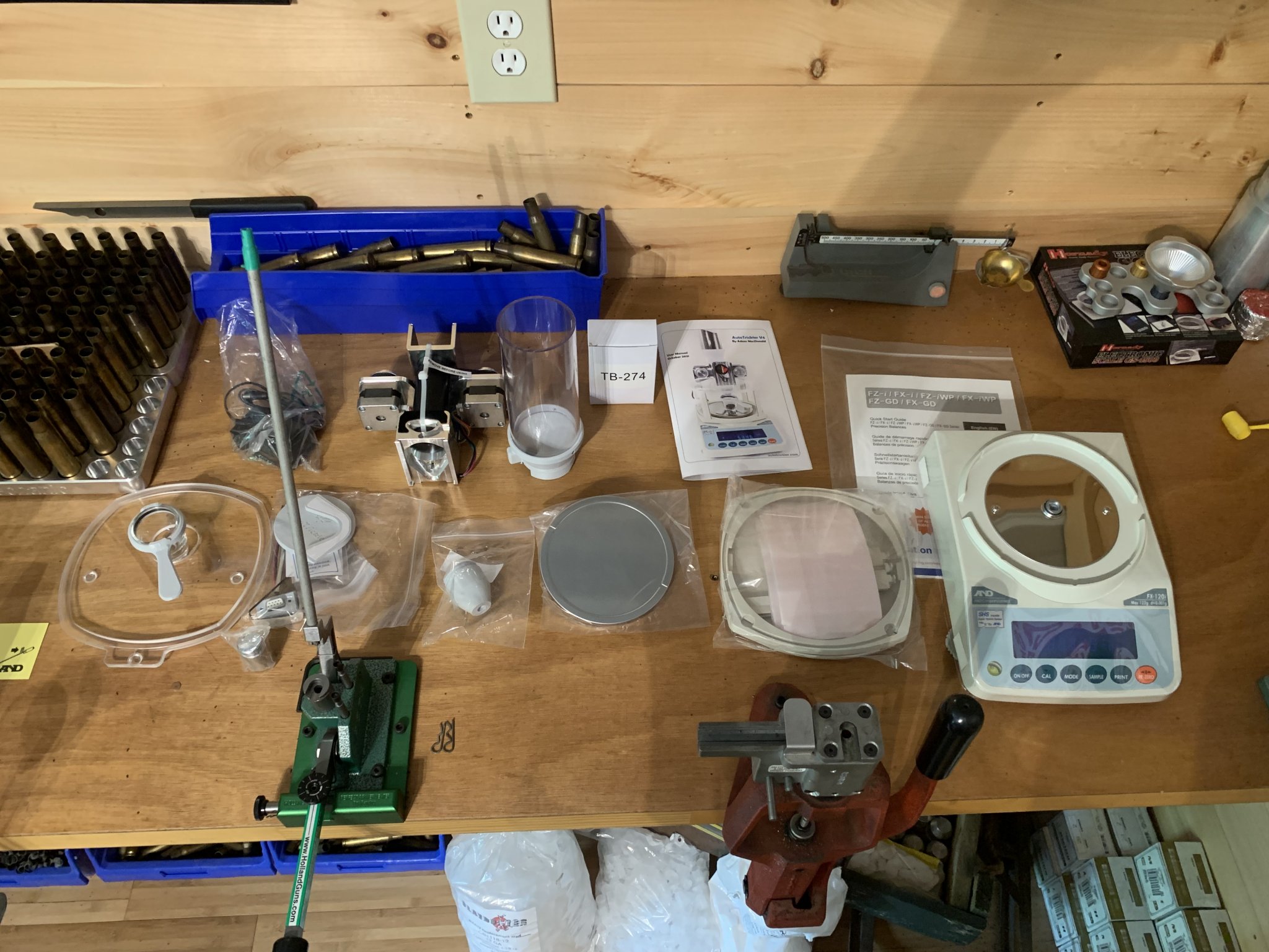

    My place in line finally came up! Yay!
    Box showed up last week and my heart sank… UPS which is usually really good had done the goon squad on the box.
    Thank goodness that CE Products understands double and triple boxing and how to really pack for success! Perfect condition (as far as I can tell) and everything inside intact.
    Now that I have my IKEA auto trickler… I am off to enroll at MIT to learn to put it together….
    In seriousness, the instructions are great. Going to take them to the house and read them tonite about 5 times before I even open the little baggies. Saturday is supposed to be 80 here. Air conditioning in reloading room tells me I’ll be putting a scale together.
    Kudos to CE products for everything so far! It is also so refreshing to get instructions in The Kings English, and not translated in to some kind of mock Spanglish from Hindi by a dyslexic Azerbaijani poet.
    Gives me hope for America. Even if they are Canadian!

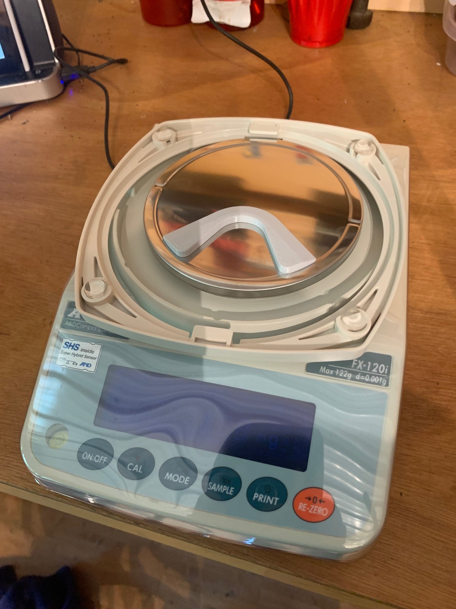

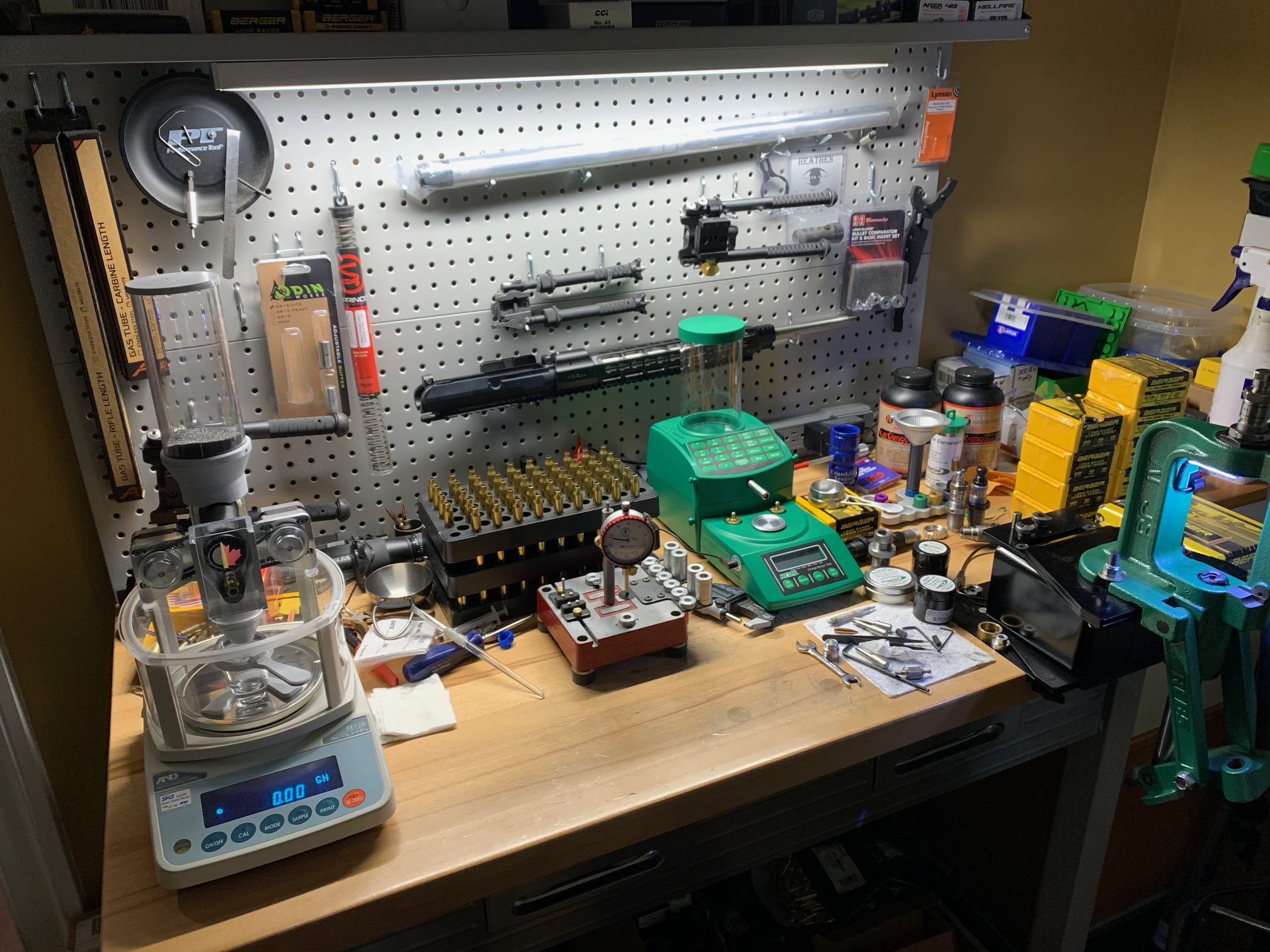

    Just did a test to see if scale drift is solved/mitigated by grounding the scale. I took my v4 and plugged it in for about an hour. I then tested the following setups for drift:
    1. Glass measuring cup / scale grounded using the grounding bolt plugged into my house ground
    2. Glass measuring cup / scale not grounded
    3. Area419 metal cup / scale grounded
    4. Area419 metal cup / scale not grounded
    I put the measuring cup on the scale, zeroed it, and then checked for drift from zero every 5 minutes three times (so the total time the cup sat on the scale was 15 minutes). No activities were taking place while I was testing. The room was empty except for when I entered to do my measurements and then left.
    I observed no drift. This leads me to conclude that drift is caused by actions taking place during the reloading process. I am now going to have to come up with a way to do more testing to see if I can narrow it down.

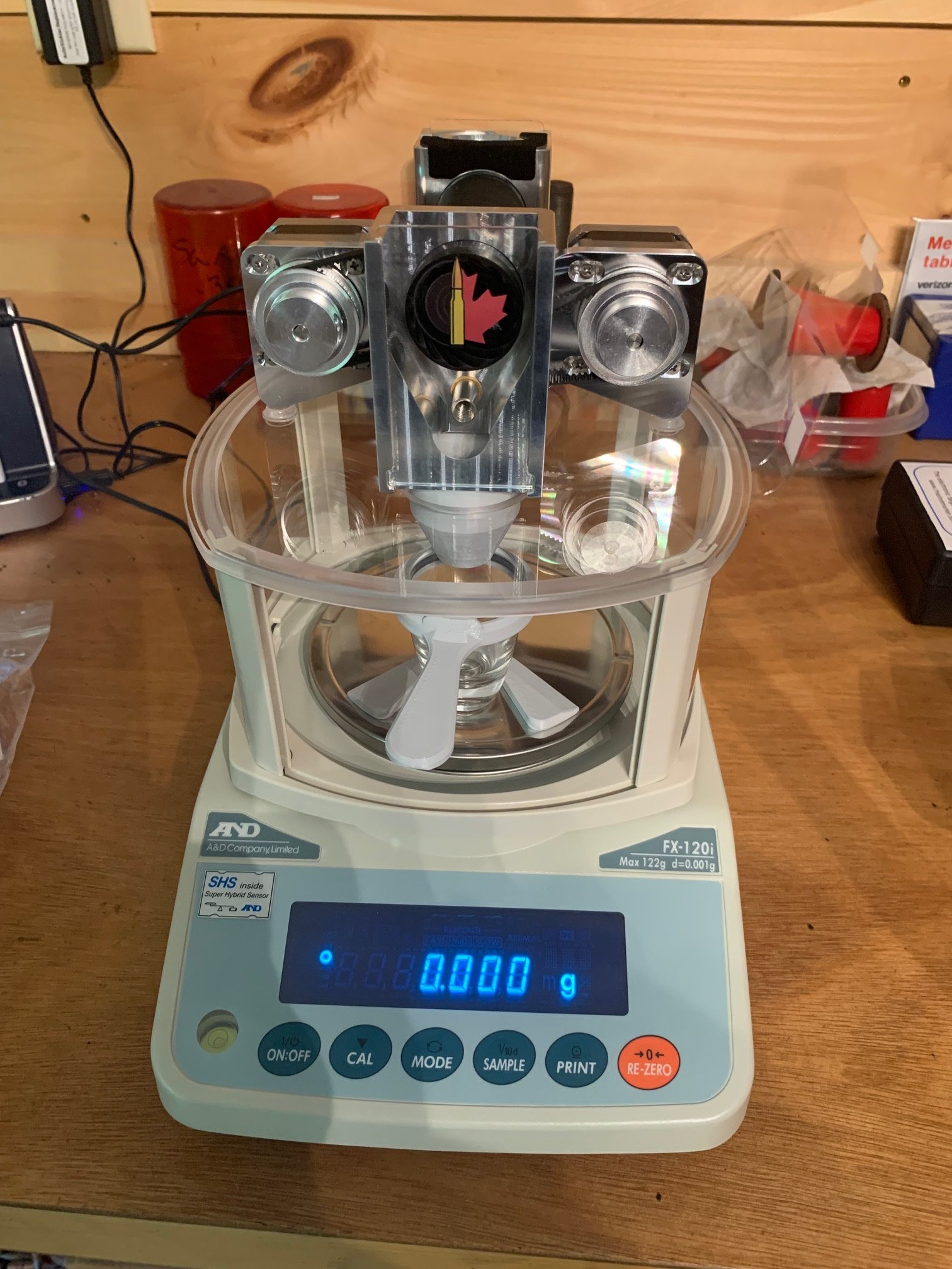

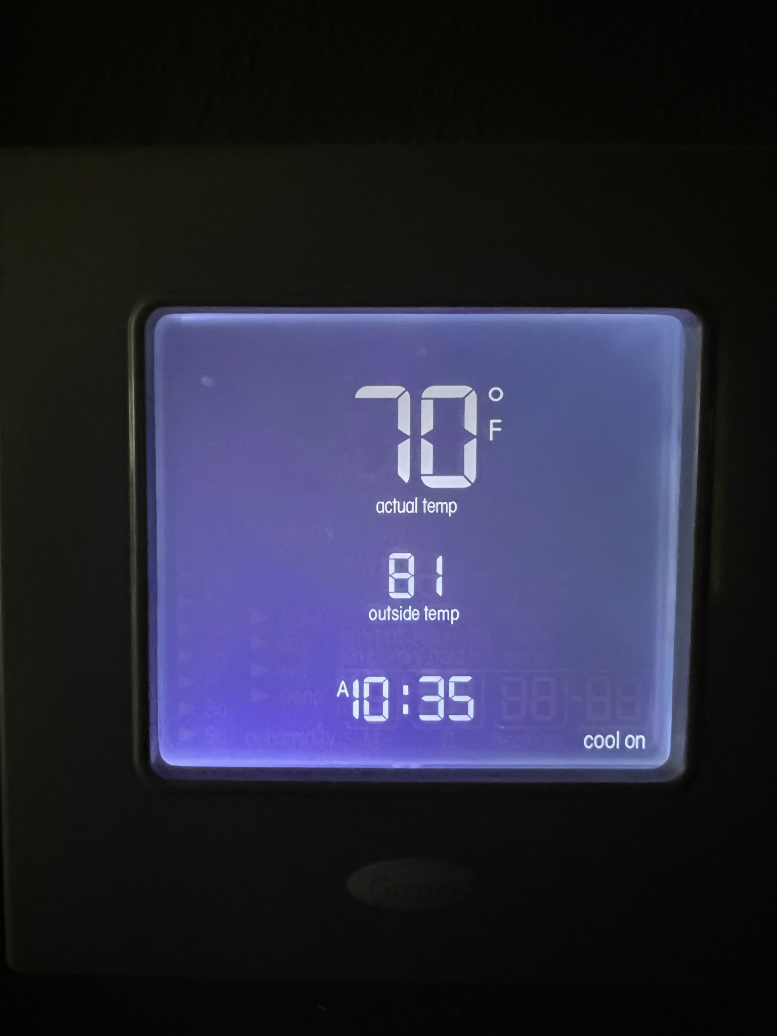

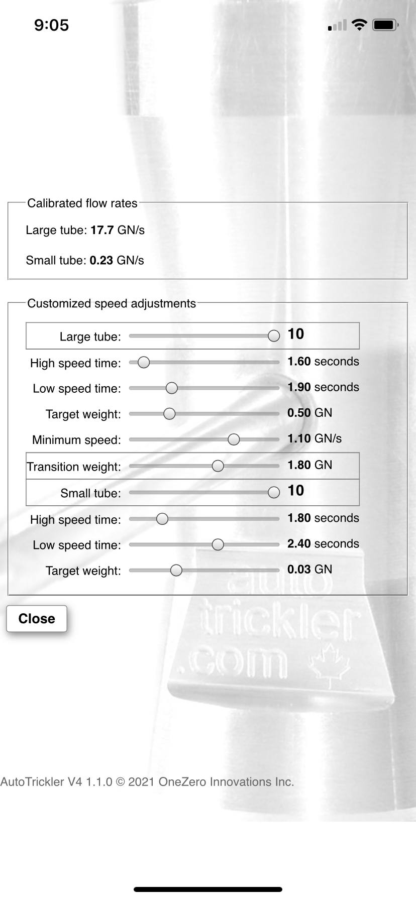

    I just finished for the night. V4 has been on for 4 hrs.
    My V4 has no extra ground. Its just plugged into the strip that came with the bench. Surge strip I think. Using the glass cup that came with it, LED's on press near by, florescent was on (underside of bench shelf above V4).
    Still dead on zero & giving 5.5 - 6.25 second drops of Lever @ +- 30.0 gr.
    My house is a very stable 77 degrees with 55% humidity FWIW.

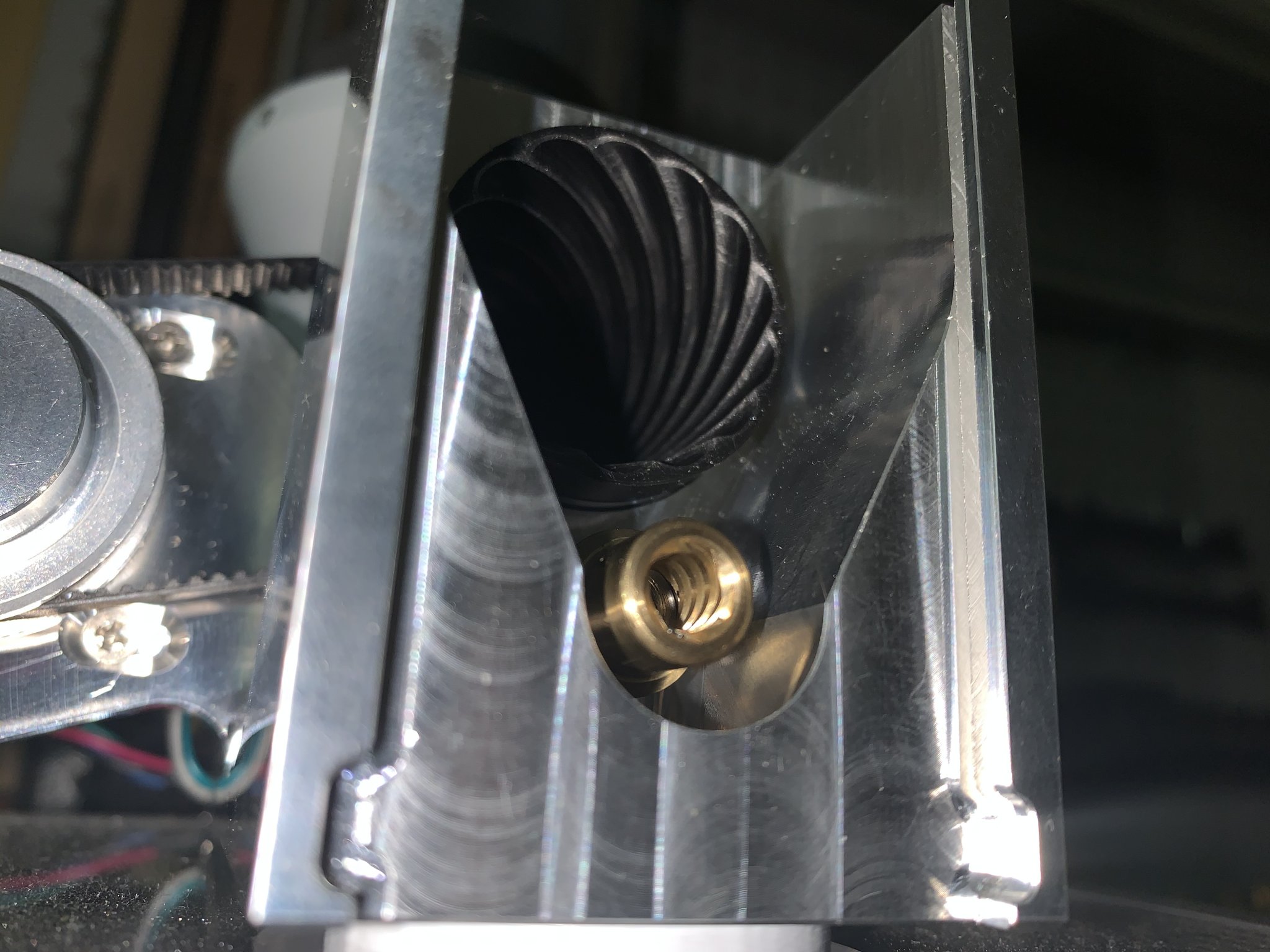

    I have since tapped the small tube about 1/3 the way in with 1/4-20 tap. That was as far as it would reach.
    I’ve also ordered an Acme 1/4-16 Tap and new .310 tubing. I’ll be making a new small feed tube Acme tapped all the way through with the current tip.
    With larger grain powders like H4350/N555 I need to much tilt to get smooth feeding from the small tube. Then the big tube overthrows on small charge loads in mid 20-30gr range. The advanced settings are to fine to account for it hence why I’m making a new small tube that’ll auger coarse powder through.
    My current settings are great for all fine ball powders, but of coarse this only works with my small tube configuration.
