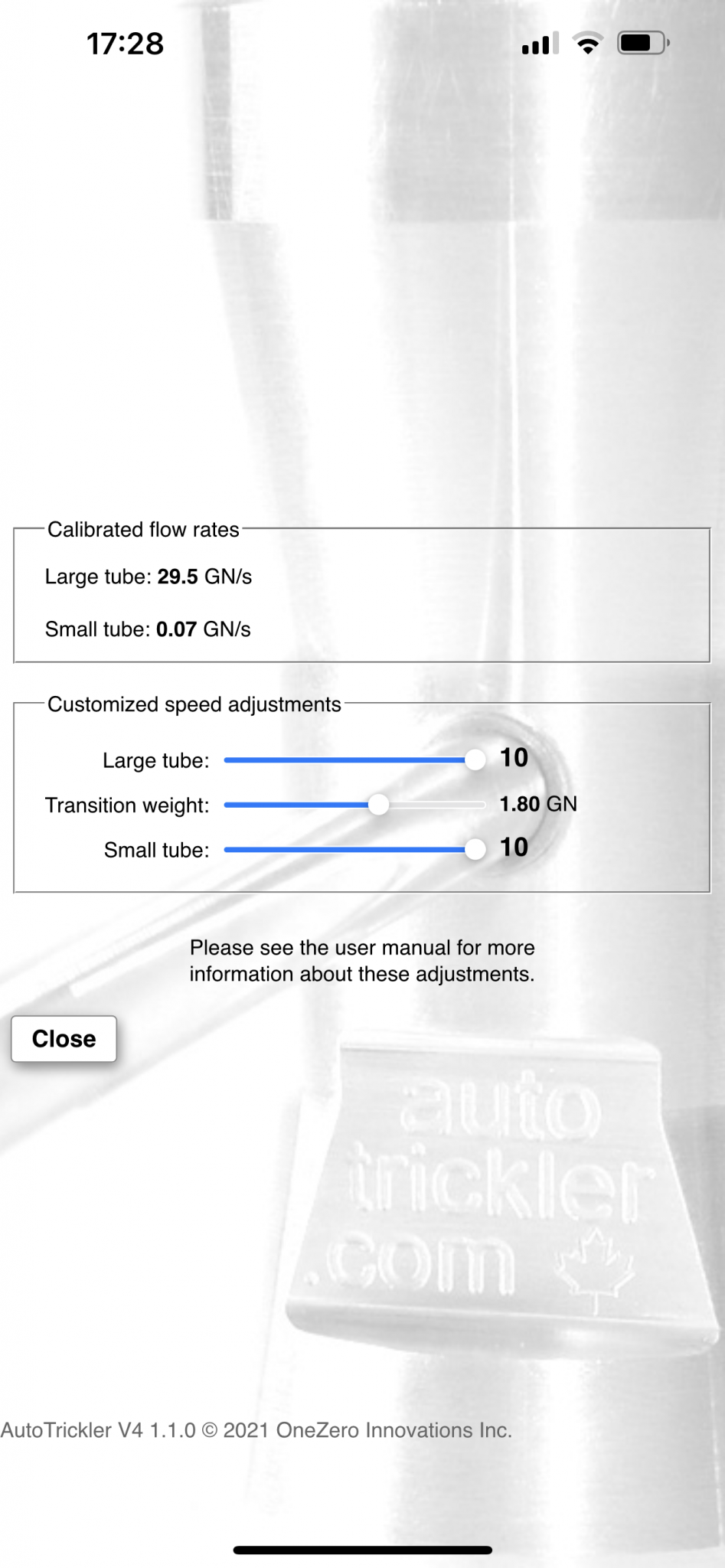

With RL50 at least, the issue is real. Fully 1/3 of my throws are overages and the small tube just cannot effectively dispense the kernels. It can spin for several seconds and drop nothing, markedly increasing the throw times, and then a bunch of kernels bunch up and it goes over. Changing the settings is not going to fix this, it is a mechanical problem with the flow of large extruded powders in the small tube.
For the disbelievers, I made a video to illustrate the problem. I can drop charges with a uniflow and hand trickler in half the time of the ATV4
Reactions: NiteQwill
there is much debate on here about whether the issues with ATV4 are "real" or just the grumblings of a few malcontents and incompetents.

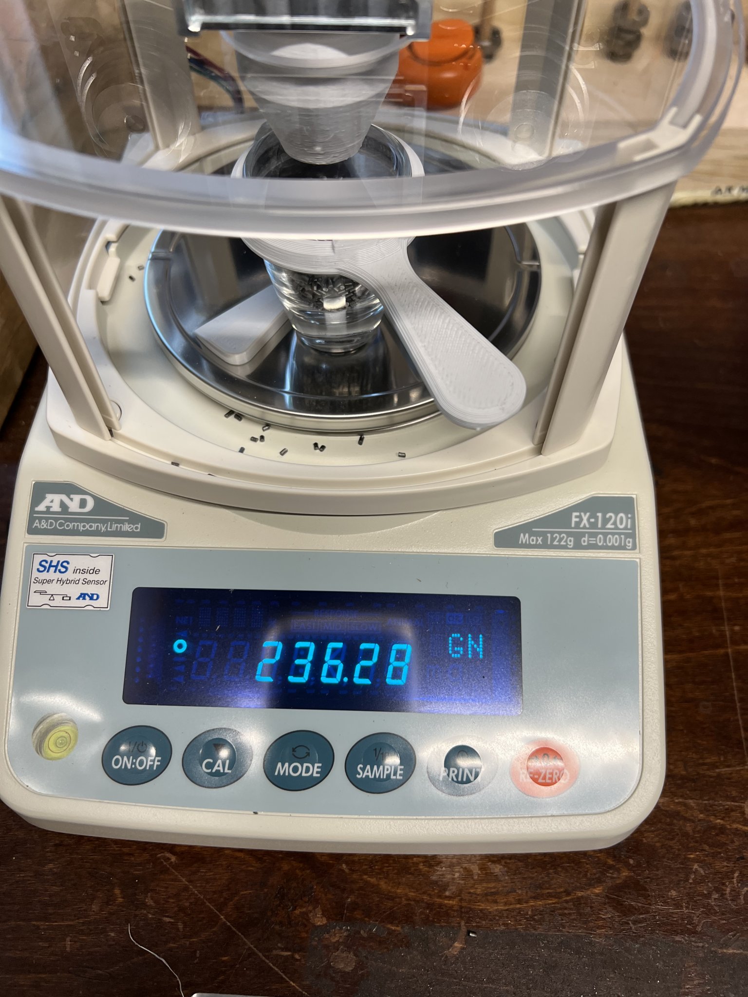

Let me get this right... you have multiple 0.04 overages on a powder kernel that weights on avg. 0.063..?
I forgot to mention that of the 1/3 that are overages, 1/3 of those are LARGE overages

and there is a problem. .07 for flow is not good. It needs to be around .20. Try adding tilt, shim the back under the V4 where the rubber foot is. It is going to take a bit too. If you have some card stock try adding 2 or 3 pieces and run the powder calibration on the V4 and check to see where it is. Keep adding until the small flow rate is around .20 then try doing a few throws. You will likely need to readjust speeds.

Your small tube flow rate is way to low. Shim the back with small allen keys or something to get .18 -.23.
The problem I ran into was the large flow rate will go to .35++ when you get the small flow rate in that range. The bigger the kernals the bigger the split in flow rate. It may start overthrowing via large tube.

It’s not just flow rate of the small tube since that is averaged over time. It’s how smooth the flow is from the small tube. I watch this during calibration. The scale should count up during the small tube calibration cycle in a smooth fashion on both high speed and low. If the flow is inconsistent you will have problems.
The shimming is needed for the small tube, the problem is that it also increases flow on large tube that doesn't need it. It’s a balancing act. You may need to slow the large tube once you get the small tube flowing smoothly between.18-.23

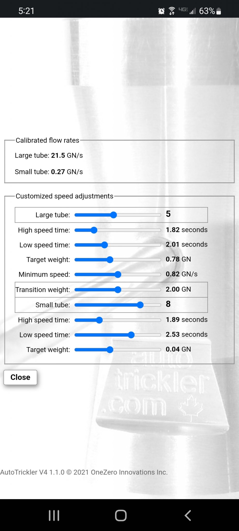

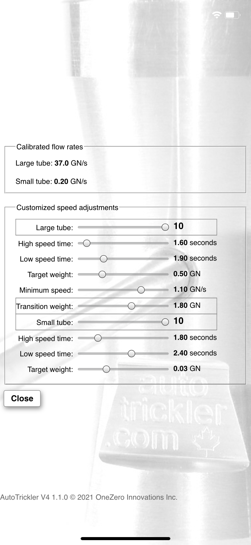

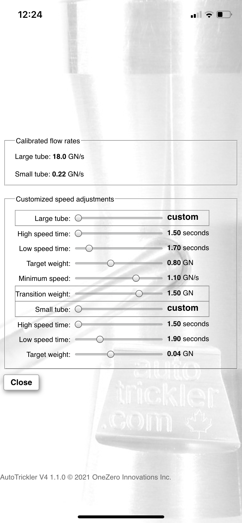

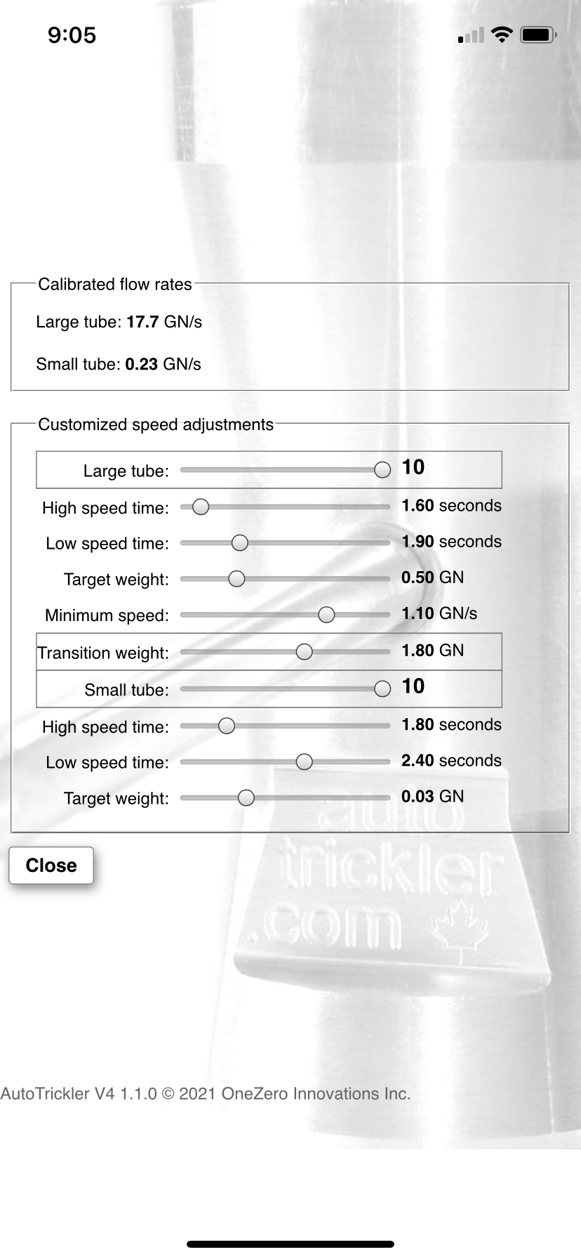

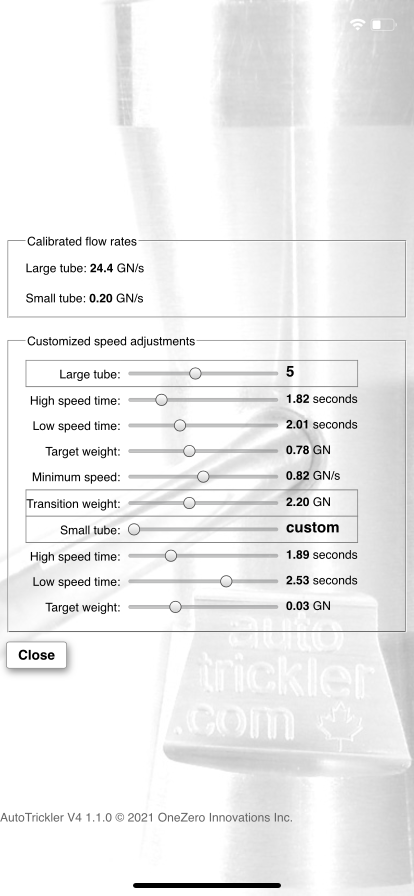

To illustrate my point & the main design issue IMO with the V4 here are 2 settings captures. Disregard the settings and just look at the split in flow rate large tube to small. The first is with Lever
This was giving me consistent sub 6second drops and no overflows.
Now look at H4350. The large tube flow went through the roof in order to get decent flow from the small tube.
Here is where I landed Setting wise to work across a pretty broad range of powders (fine ball - N555). These settings are for my machine only because I made a new small tube that is Acme threaded.
The split is much better now. I have plans to make the small tube elevation adjustable but it’s on the back burner till Thanksgiving.

Remember. Once you get the small tube flow around .20 you will have to play with speeds. For example: I run RL15.5 and VV N555. One requires shim #1, the other requires shim #3. They both run with large tube speed at 5 but the small tube speed is 5 and 7. They both throw dead nuts 8 to 10 seconds. It took some time playing with numbers but once you have it, write it down. I put that data in the load book for the rifle. Every powder is different but don't be afraid to play with tilt and speed. Once you spend time with it, it becomes more intuitive.
Really down and dirty test. Ran the biggest #5 shim and calibrated with N570. Set to throw 90 grains and it would over throw by a single kernel. 90 to 90.08 but the flow rate is a bit high. If I went to #4 shim and adjusted speed it would be fine. Took less than 5 min.
OK, I put a .010" cardstock shim which took the small tube flow rate up to .15. Still had 2/10 overthrows (one greater than .1 grains) and 3/11 (I intended to just measure 10 throws but put the cup back on and it overthrew on #11.
So we're still at about a 25% overthrow rate (remember the slogan "To the kernel in 10 seconds"? it's still on the autotrickler.com website) and the throws are still taking about 25 seconds.
This is what we call "overpromise and underdeliver" (even with a hillbilly engineered cardstock "shim") and I think this is what has people frustrated with this version.
I'm open to any other suggestions of other things I can do. The small tube just cannot handle large extruded powders. The machine was designed around ball powders and H4350, I'm guessing. PRS stuff.
For the big stuff try closer to .2 or .23 for small tube flow rate, so shim a little more. Set your transition weight to 2.0 grains. Set large tube speed to 4 and the small tube speed to 6. This is just a start point. To get to added features hit settings then press and hold on close. The advanced features will open where you can set transition weight and speeds.

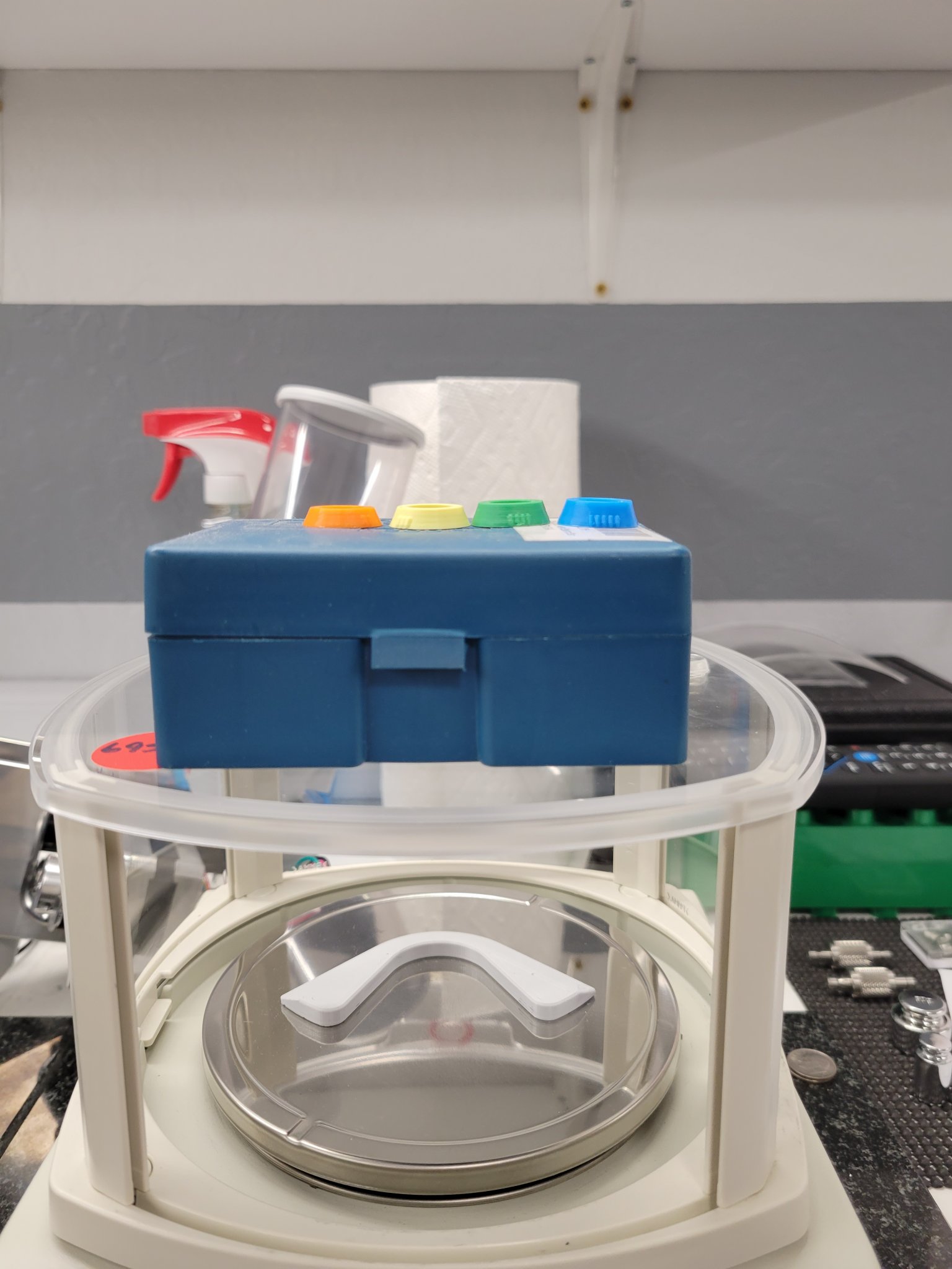

I had the opposite problem. My flow rate for the small tube was at .35 and I was getting overthrows with R23, R26, and H4831SC.

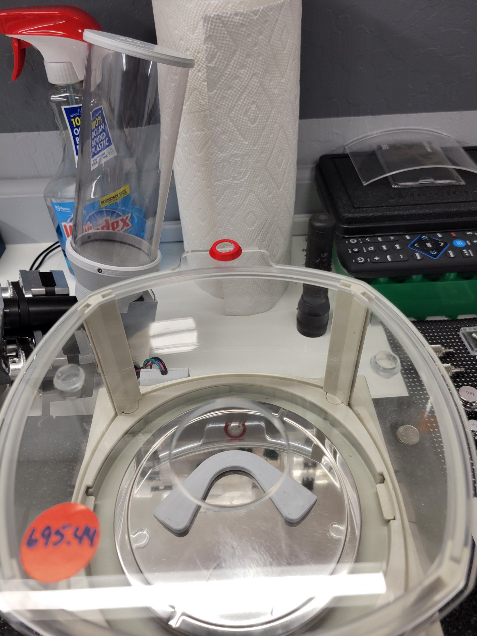

I bought some cheap 1/16 plastic bumper pads from Amazon that are for glass table tops and stuck them to the front legs. I then tilted the scale up in the front as far as it would go, took off the tip I had purchased, and calibrated it. The level bubble is now in front of the center dot but still centered in the window.( level left to right but sitting higher in the front)
I had near perfect results with R23, R26, and H4831SC after I installed the pads.
I played with the transition weight and speeds and I am getting quick throws. I did not time it but I loaded up 20 243 ackley rounds to fireform the cases in quick order.
I love the V4. It works fine for me and it is so much quicker than my old RCBS charge master.
I took all the aftermarket parts off of my scale and now just use the bumper pads on the front legs.
