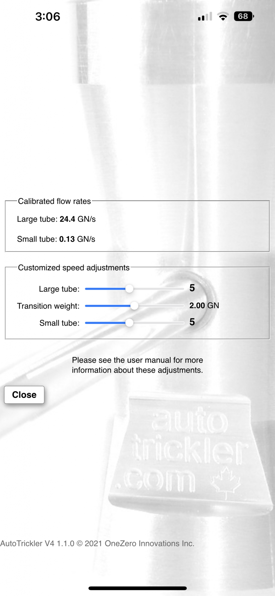

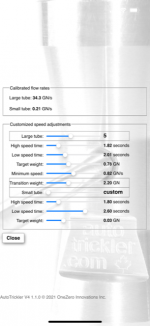

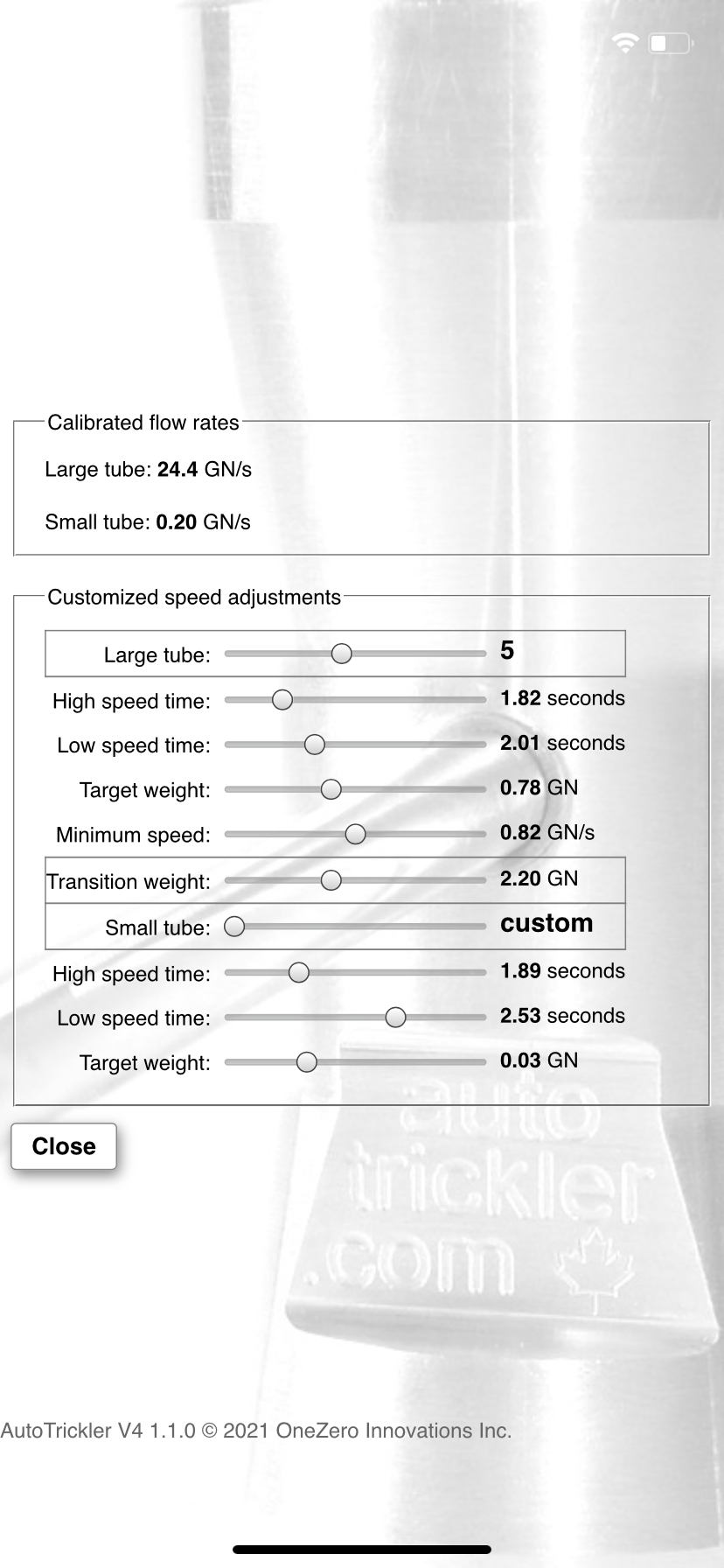

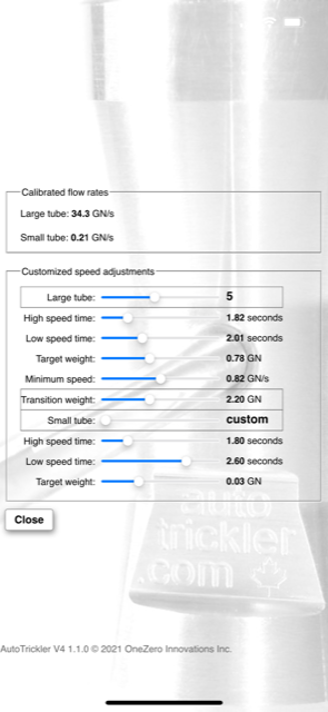

Here is where I landed Setting wise to work across a pretty broad range of powders (fine ball - N555). These settings are for my machine only because I made a new small tube that is Acme threaded.
The split is much better now. I have plans to make the small tube elevation adjustable but it’s on the back burner till Thanksgiving.
@357Max
Thank you for sharing so much info. I have the plastic tip, but was able to dial in really well based on the second set of settings above. After adjusting the high speed time a little lower to 1.80 and the low speed time to 2.60, I ran 50 charges of 4350 and all landed within a kernel. I would guess they averaged around 12 seconds which is plenty fast for me as long as they are accurate.
Calibrated flow rates were:
Large 34.3 GN/s
Small 0.21 GN/s
Though it may take a little tinkering to fin the settings that work for you, this thing kicks ass compared to anything I have used before it.

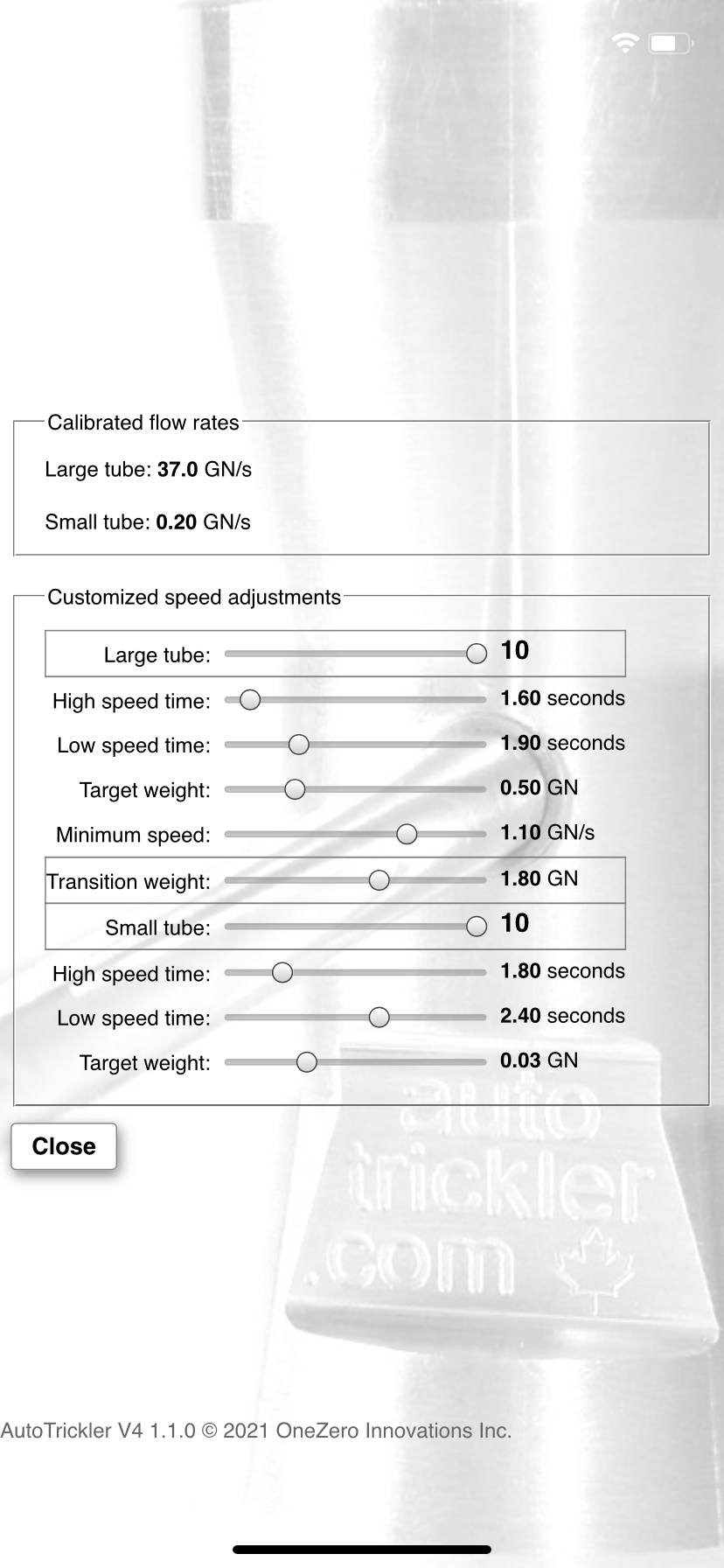

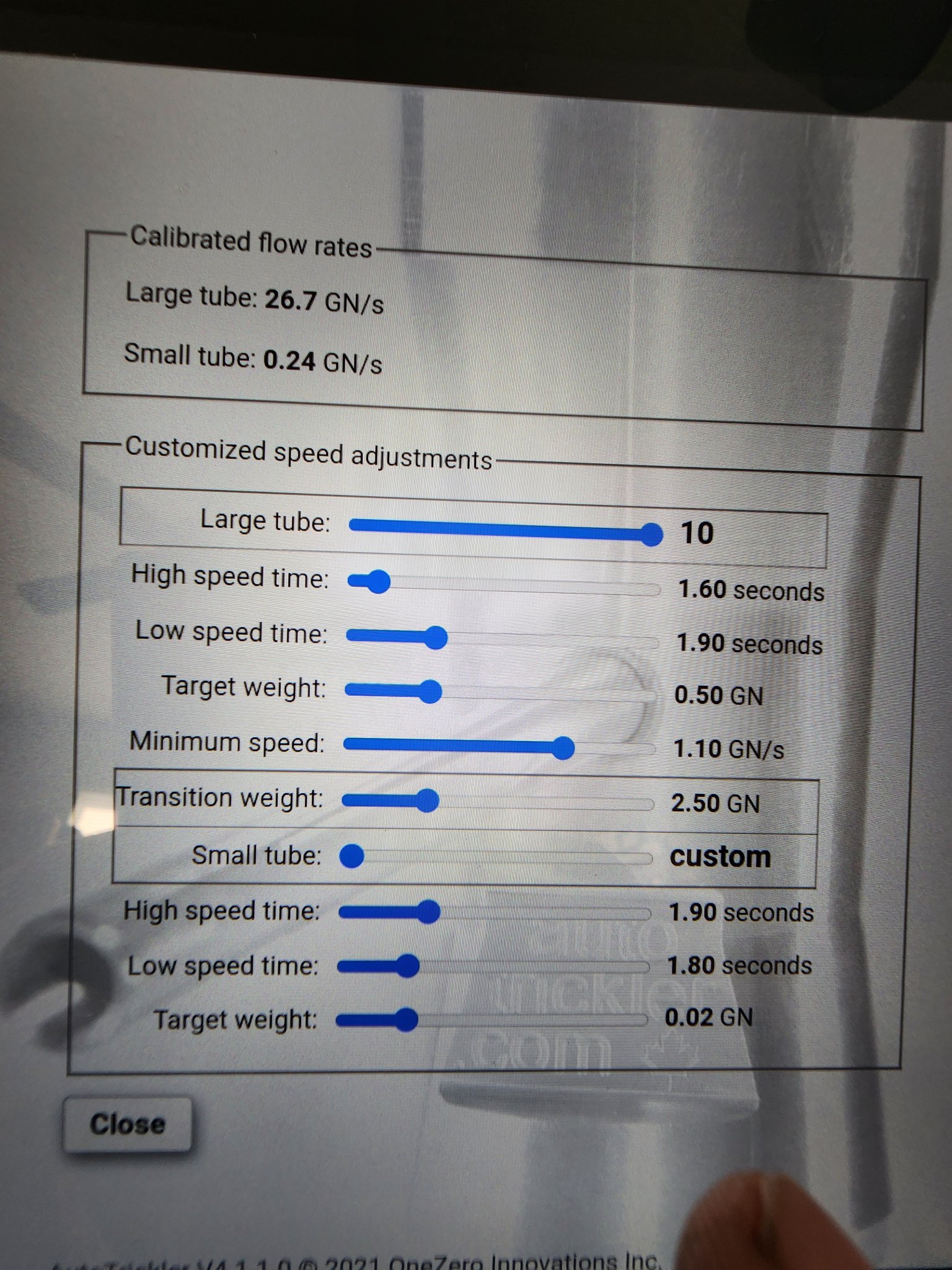

If anyone is interested I have some settings that has worked very very well for me for H4350 and powders like it. Very fast between 8-10 sec. Maybe 1 out of 100 large over throws and the random .02 .04 over. Usually faster to dump it rather then pick out a kernel. I have the scale level as I have found I don't need tilt like I thought it did at first and keeping it level and not moving the scale has helped me stay consistent. I think one of the issues people aren't considering that, any time you move the scale u have changed the tilt slightly. I have it set where I don't have to move anything to empty the scale and just tilt the v4 forward to prime or empty the last few kernels out of the small tube.
When you do overthrow, is it from the large tube?
8-10 seconds is faster than mine, but, I actually have not had a large over throw, only the .02 or 1 kernel over.

My Settings.
Thanks for sharing and you hold the close button in the setting screen to go advanced?
