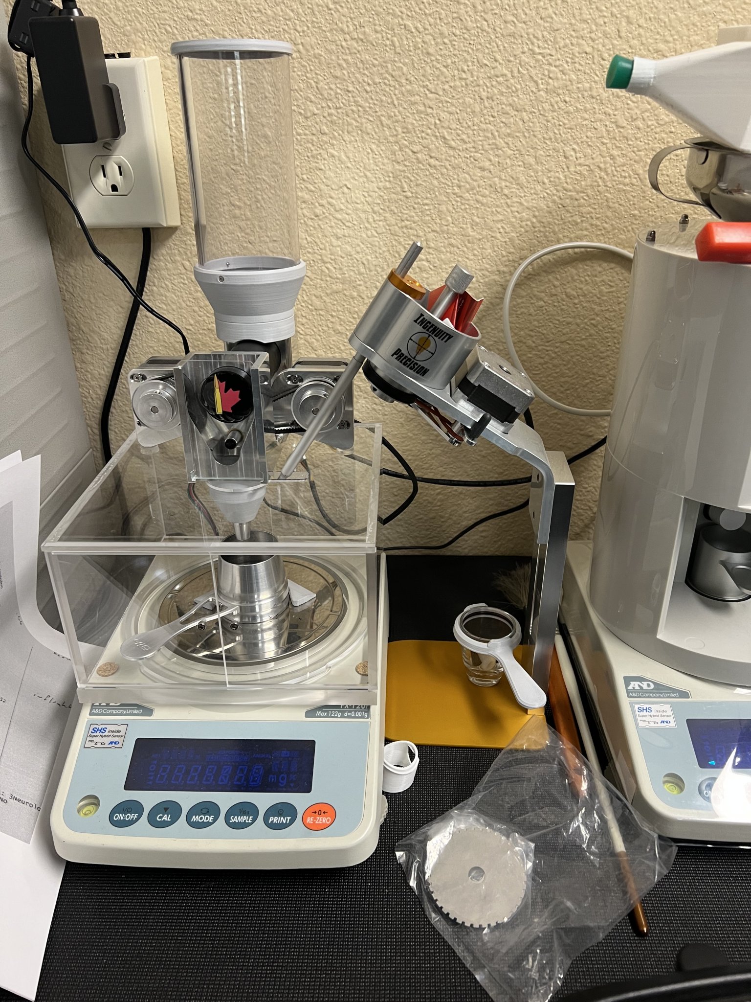

We appear to be collecting reviews here and I have been using my ATv4 for 5 months now so I feel I can chime in. The v4 has lived up to half the claims. I was expecting ~10 second and kernel perfect. I would say I get 40% a grain under and 40% a grain over and the last 20% is repeated ~10 grains over. I have read the SH forums, watched Adams videos, and filled both tubes before calibrating twice as well as reducing the slow tube rates in the menus. My v4 and A&D are stock, no shims or tips, level on wood and dryer wiped for static. I have used Varget, H1000, H4350 and Bullseye. I get largely the same experience all around.
Would I buy the v4 again? Yes, I think so. It is faster than me hand metering it out with a GemPro. Is it more accurate? No. Just faster, which makes my reloading less tedious, and is enough for me to put up with the flaws. Adam seems like a decent fellow so I hope the fix I hear about is soon and effective. The idea to continue pouring money into other tools to fix the v4 is a non-starter though.
Interesting . . . I've had mine for almost a year now (Feb 18, 2022 was when I got my shipping notice), but probably haven't used it quite as frequently, so we probably have about the same amount of time with it. I've used mine for H4350, N570 and IMR4064. My most recent loading sessions (from just this week) have been with H4350 and are fresher in my mind, so I'll report my experience with that powder:
When I loaded the first 70 rounds for load development, I had 1 round tip over the +.02-.02 error boundary (.03-.04 being the approximate weight of one kernel of H4350). Following that initial 70 rounds, on a different day (and having cycled power of the Unit and recalibrated, etc), I loaded an additional 50 rounds and I had three instances of busting the threshold. In all cases the error was the quantity of one kernel, so I just removed one with my finger, double checked the weight and it was spot on.
I consider that an extremely positive result given that the V4 is on the same bench surface on which I am performing my bullet seating while I'm waiting on the V4 to drop the next charge which may actually be causing the rare errors that do occur.
I didn't even realize people were having issues, but got a notification that someone had tagged this thread so I opened it up to see what was new. And believe me, I'm familiar with reloading equipment sucking (i.e. the trash heap that is the Mark 7 Apex 10 - an absolute piece of garbage and waste of $3K (or 5K if you start talking about all of the extra stuff I bought for it).
I'll pay close attention to see if I get any increased errors (and maybe whether my unit is tilted slightly forward or back?) and report back if I notice anything.
FWIW, I haven't done any "mods" to my unit and have only added the cover plate from "Obsessed's" kit (I didn't bother with his side walls since the cover plate did all that I needed).

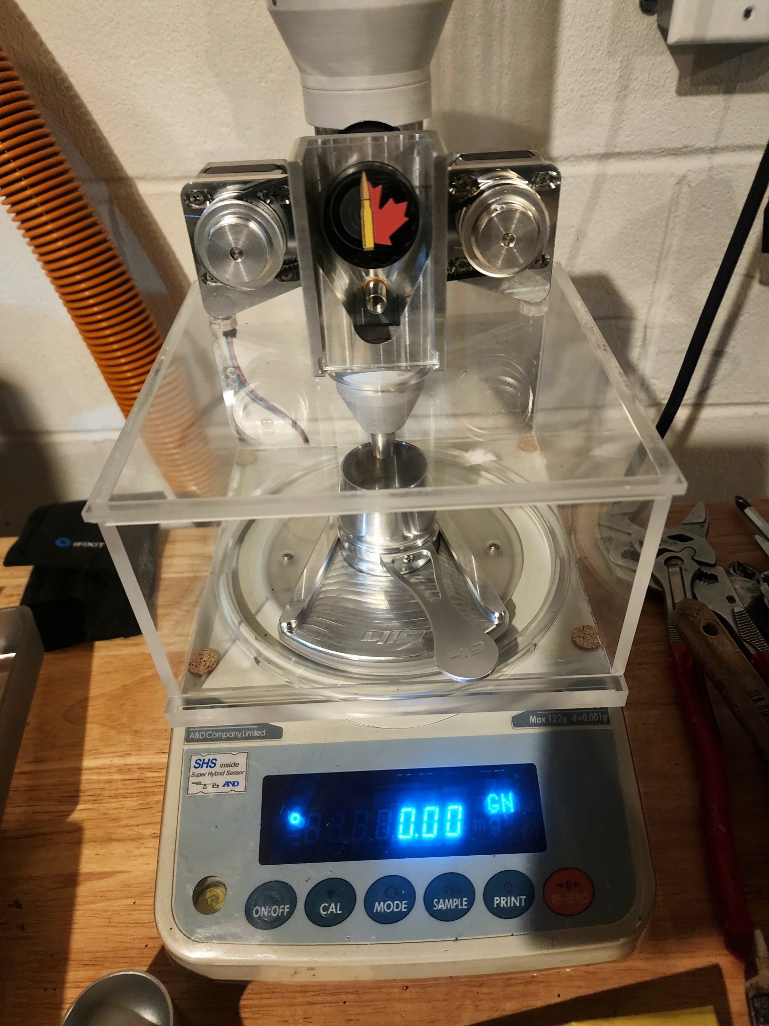

Does anyone know if there was a design change on the V4, specifically to the bottom of the aluminum housing directly below the hopper? I noticed a video of the unit Fclass John had in his video looked to have a divot where the rear rubber bumper interfaced. Looking at my unit it does not appear mine has the same divot. Curious because I am using a shim kit and it made my trickler perform worse than without them so I am wonder if the people using the shim kit have an earlier model or I just dont have them set correctly.
The threaded portion was part of the beta/earlier units that allowed the unit to adjust tilt. None of the current ones have it. Hence the reason for shims.

Oh ok, I was curious with the success people were seeing with the shims that their unit may of had this divot in it. I tried the shims and it made my flow rate too high even with the shortest one, seems my unit worked best with the factory configuration. Goof flow rates on the tubes and quick throws in the 10-12 second range. Maybe im doing something wrong, havent messed with any advanced settings either.

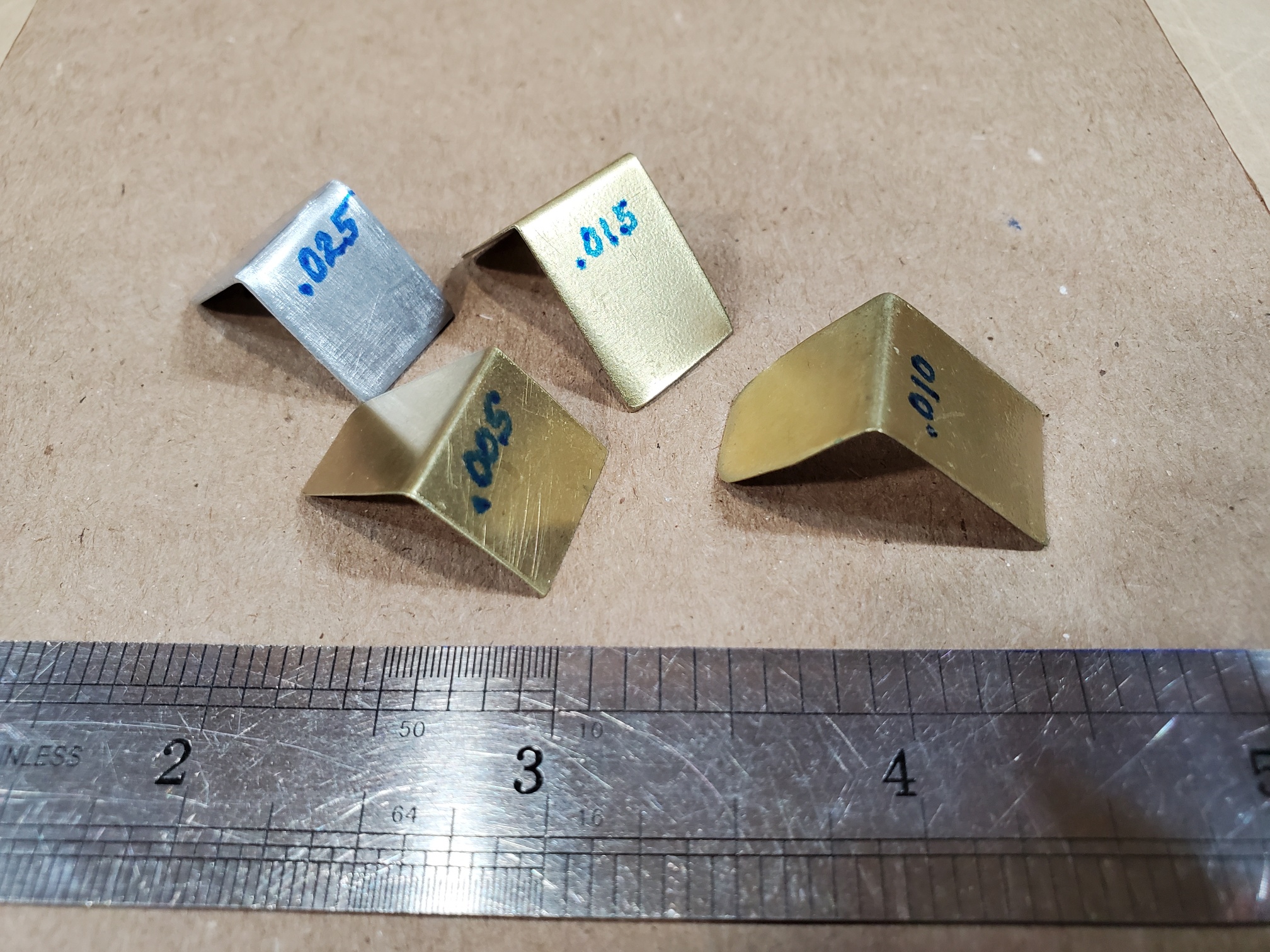

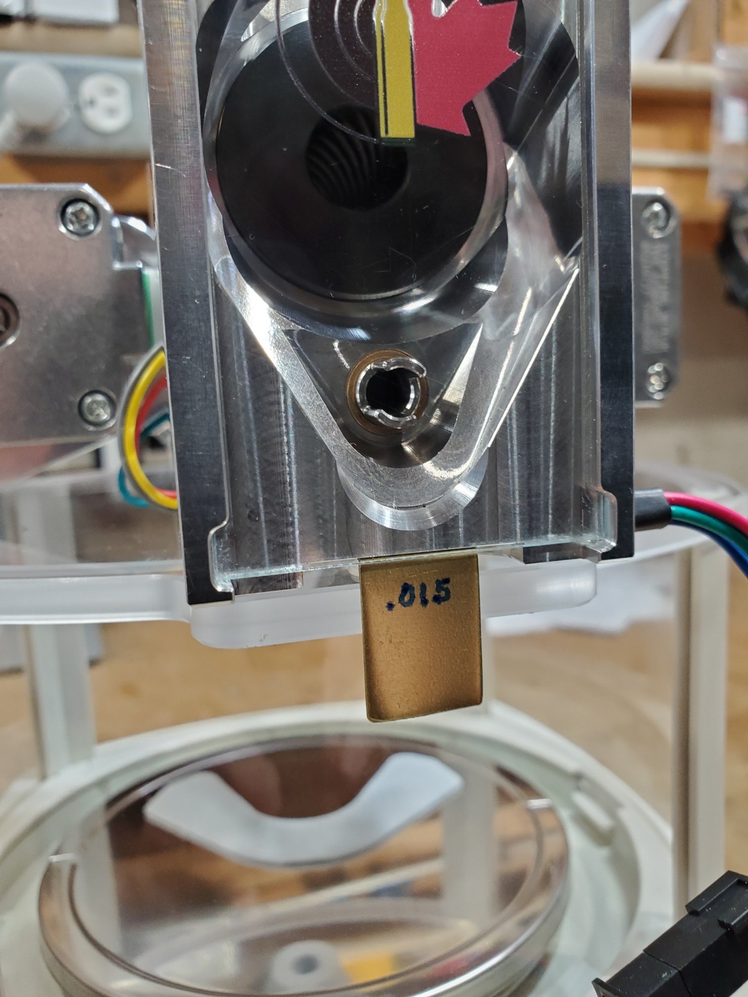

I don't like the plastic shims. They are a PITA to install and they are not very accurate. I use bent pieces of shim stock. They are easy to insert/remove, can be stacked to create different heights and I get very repeatable results when I set up for a loading session as long as I level the scale fairly precisely.
Reactions: CP Rifle
Does anyone have pics of the shims they are providing now?
My son makes a set of spacers for it-
I bought your spacer kit but I started having over throws and the flow rate was really high but I didn’t play with it very much so I’m sure with a few adjustments and speed settings I could get it right

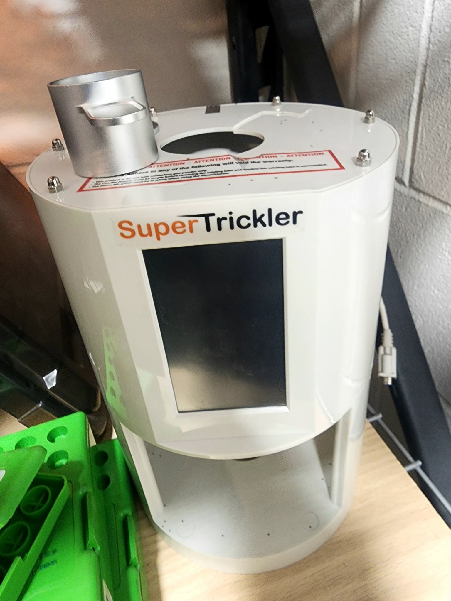

So I think I have something to add to this discussion. I had a v3, I have a v4 and super trickler now. I will say they both have advantages and disadvantages.
The biggest disadvantage for the super trickler are the position of the Straw. I've probably bumped the straw no less than 10% of the time. Even being careful you have to slide the pan vs picking it up. Very very annoying and I'm betting many are doing without realizing after their charge is finished. That tiny little weigh platform makes this problem much much worse than it needs to be. If he had to cut out to accept 419 plate or something like it it would help. But the fact that it's so close is challenging. You don't even have to hit the tube. You can bump the cup into the back of the housing and it'll spill powder.
The other problem I'm running into that a lot of people probably won't, is how easy it is to spill powder due to vibration. I normally use a progressive and powder funnel die and when the Press cycles, it's dropping powder either in the cup or on the plate. During my routine, this happens just as I set the cup back down, as the press cycles up, after finished sizing. Spilling powder just as the Auto trickler re-zeros the cup. You can tell because when you set the cut back down, it weighs a good -.15-.3. Maybe a reducer would help in the tip of the Straw. Idk.

I just came back here to say I got those shims and the Tip and it has reduced over throws to almost zero. The other day after loading 100 rounds I noticed I had some how moved the speed slider to max and only had like 2 over throws. I run big powders. (N560 and 570)

I also got the tip and mainly run H4350 and can easily drop a charge in under 10 sec with maybe 2 slight overs or maybe one big per 100 cases. I like to run my scale and V4 level and have very good luck that way. I talked to Adam, several times for a couple weeks and he explained all the settings and how he sets the v4 up without the tip and it worked great but I just felt, level with the tip was more consistent for me with my powder.
