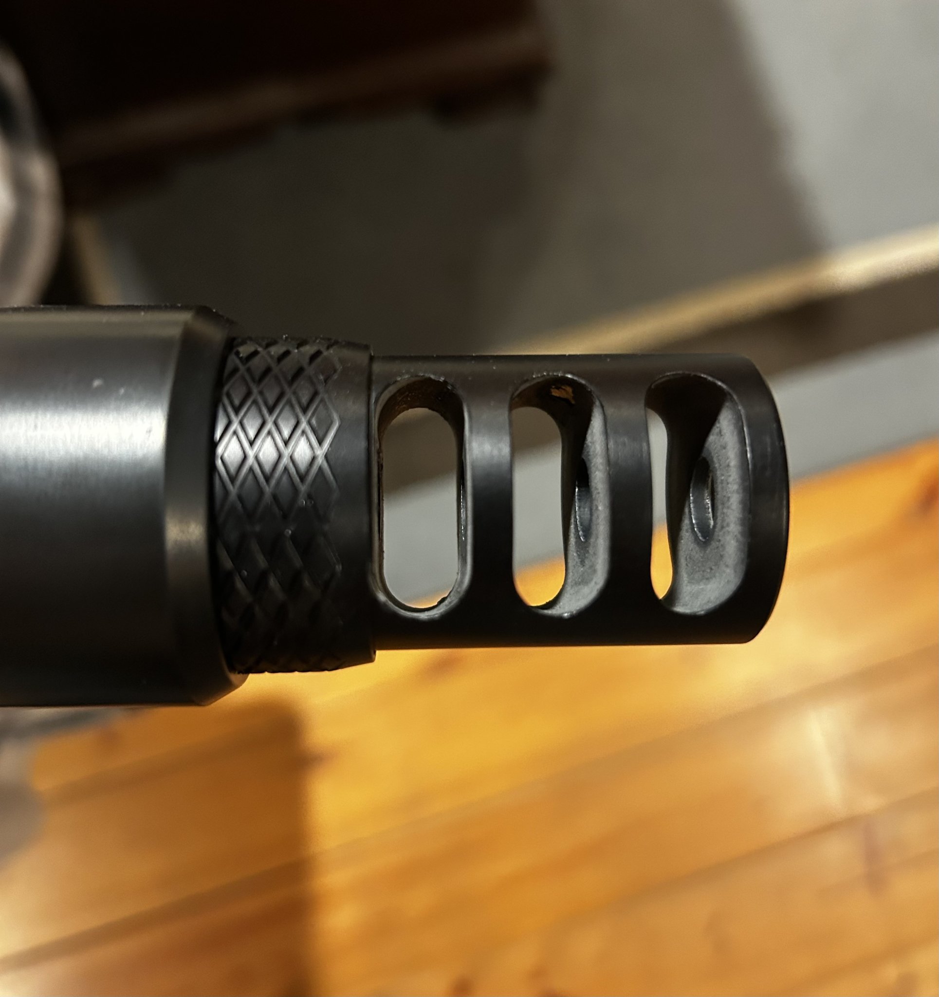

Got mine in and screwed on nice but a question for you guys. How deep do you screw it in? I can screw it deep enough so the collar is in the first port and I know that’s not right but I want it screwed in enough so it won’t shoot off under pressure. Any advice?
All the way is what I did. Keeps the threads from getting dirty and filled with carbon, at least on the omega anyway
Reactions: spife7980 and Rob01
What can? And glad you said something I need to check one of mine.
I didn't want the lock collar up into the port on my scythe so it's like 1.7 turnes out from fully seated, maybe this is bad idea? Idk......shrouding the brake port, also poor idea.
Reactions: ID_Matt
I am using a Nomad Ti XC. I was thinking as long as it’s deep enough to cover all the interior threads like the cap it should be fine. Tough to get that measurement exactly but can get close I think.
Hmmm that’s the one I just went up and looked at. I bottomed mine out in the suppressor and it was timed almost perfectly. Tightened the lock collar and while it’s very close the collar is not over a port, there is a tiny lip.
Reactions: Rob01

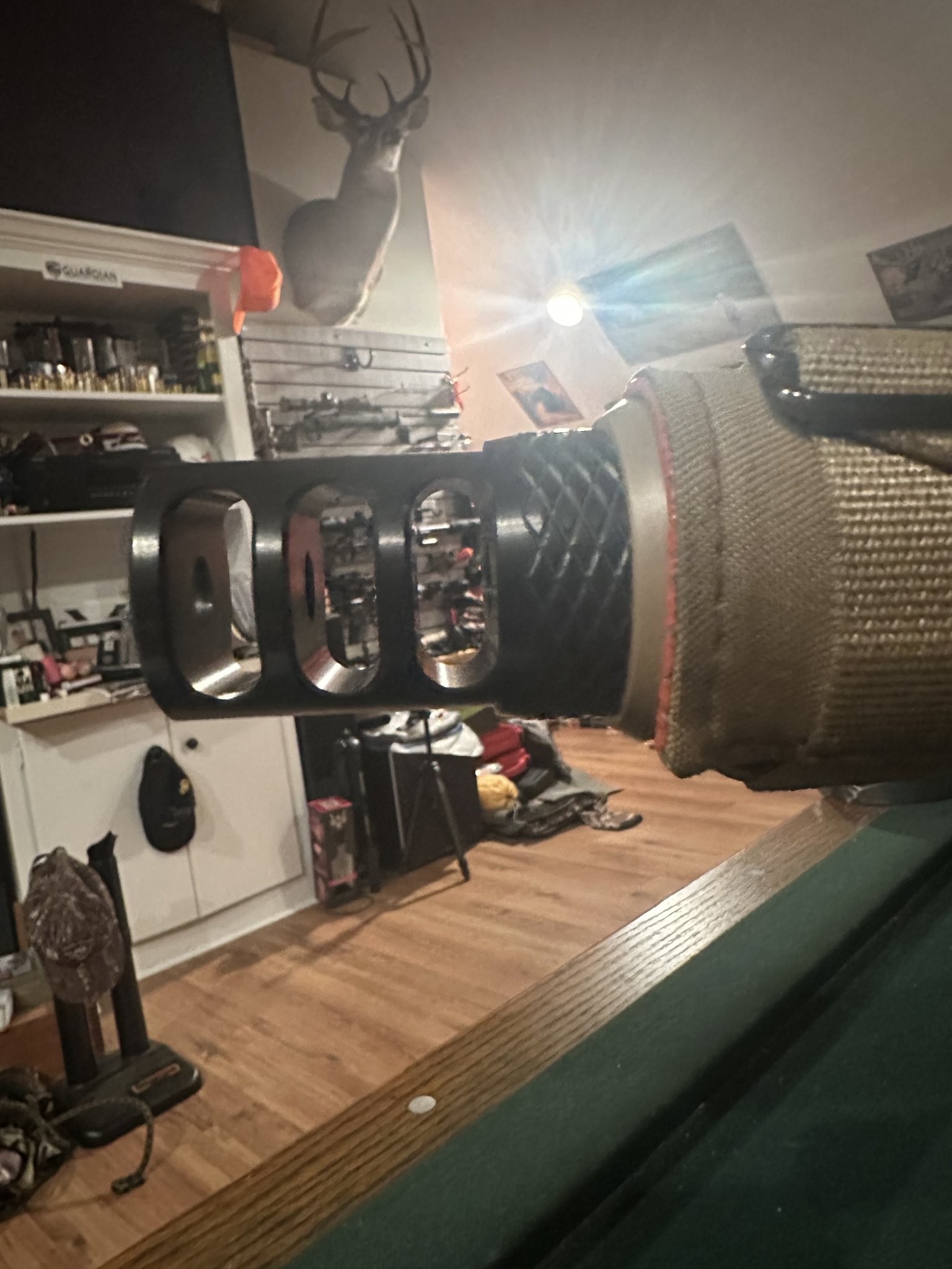

Yeah it doesn’t cover the port but is into it making a lip of about maybe .1”. Have you shot yours like that? Can you post a pic?
Hard to get perfect side shot:
Reactions: Eric_F
Rob I screw mine in until it makes contact, then back off about 3/4 of a turn and then lock the collar down. There’s a small space between the collar and the edge of the first port, but it’s something to keep an eye on. Nomad Ti XCView attachment 8639999
Thanks. That is where I was thinking of setting mine also. Glad to see it works.

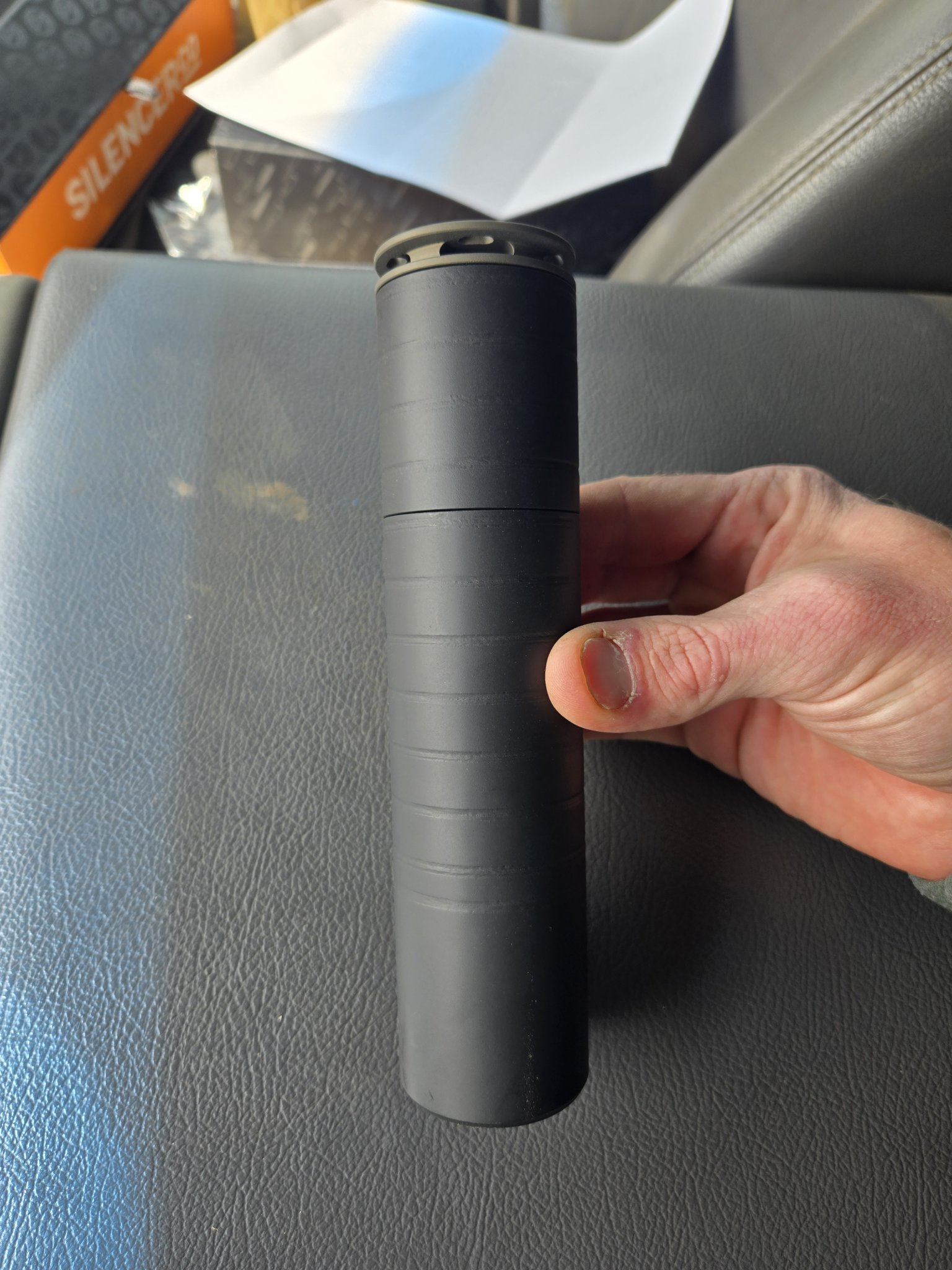

Got my Scythe-stm today and will be testing tomorrow in the short config/ long config and with single port brake and the RecoilX brake at both lengths.
Well, because of you degenerates, I have one of these sitting in the front room of the house right now. My range is closed for renovations for the next few days, but I’m excited to try it out.

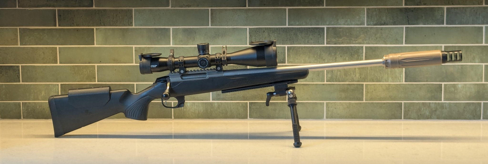

I don't disagree, but it's very very nice as is. I shot with it on my 12 lb (with can) 6.5 Creed yesterday and it was doable to spot hits at 200 yds in awkward positions.
